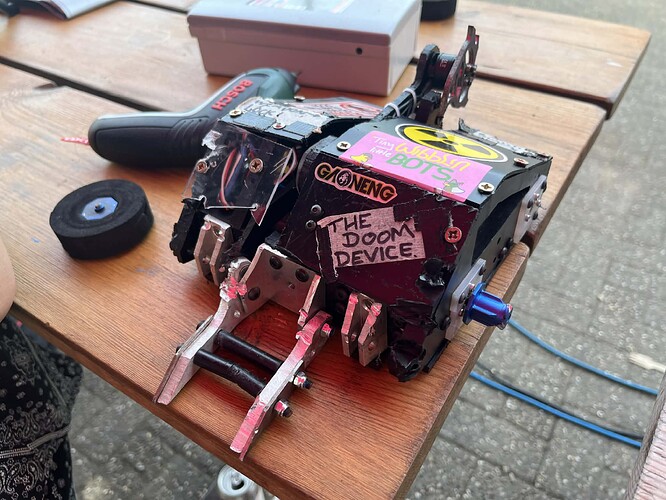

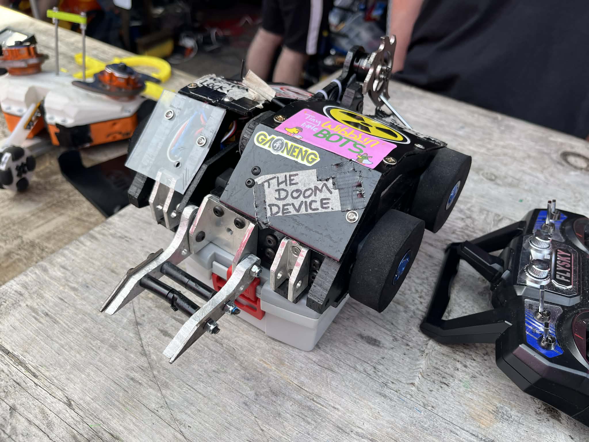

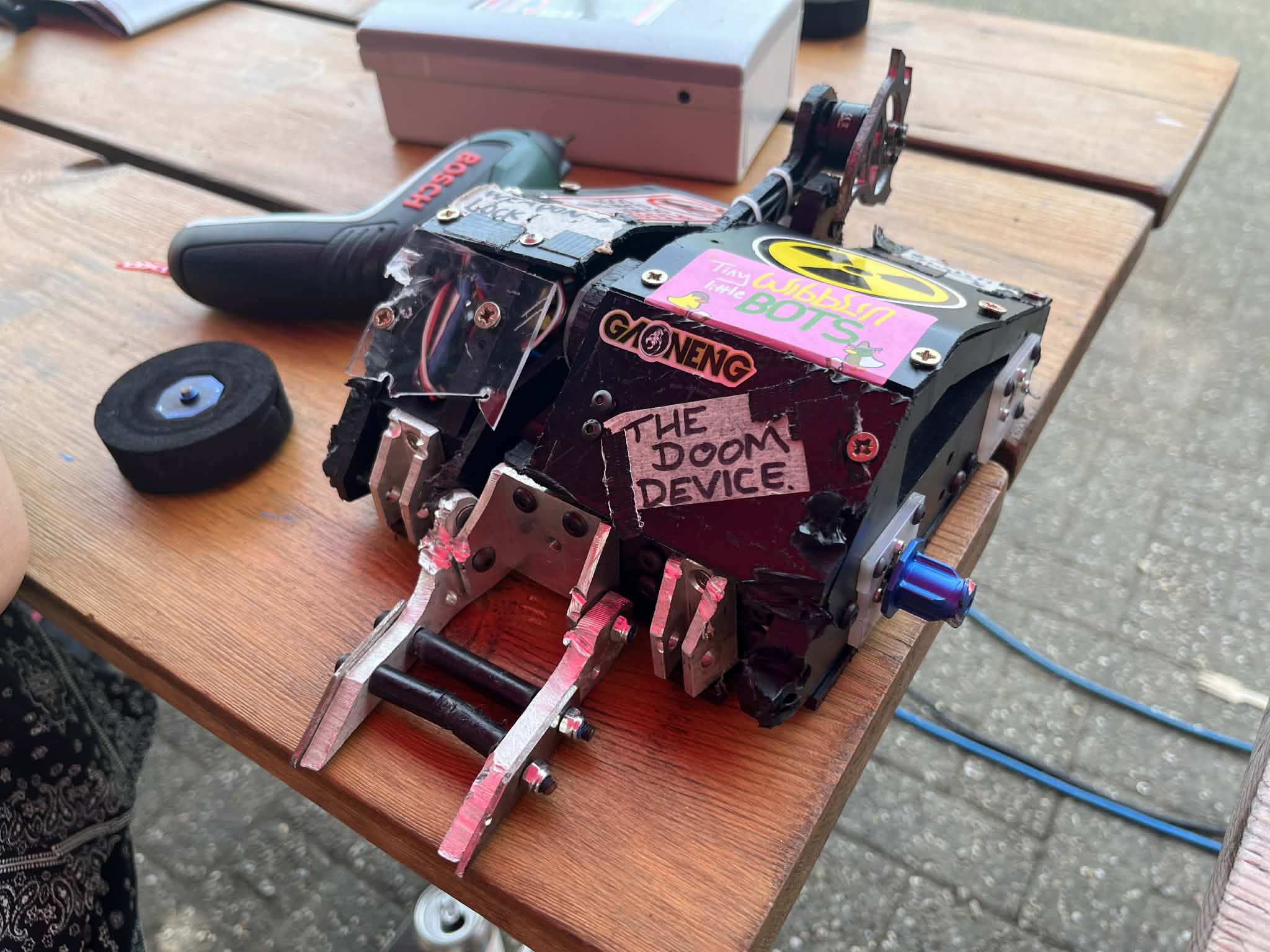

So, that wasn’t too bad! 2 wins and 2 losses at BBB new blood! I got quite lucky but this bot was really just meant to use up some old parts and material I’ve had lying around for a while. All things considered - really happy with the outcome!
So now… how about a Doom Device sequel?
Two main problem areas with V1:
Robot too smol - weapons had poor reach & effectiveness
Robot too chonk - side armour and ground game forks had to be removed to fit in 1.5kg.
Even tho “make robot bigger” and “make robot lighter” don’t go usually go hand in hand - there is a clear solution: :sparkles: Brushless :sparkles:
I reckon I could save around 200g by going brushless on drive and weapon with some Repeat tech. And there’s definitely some ways I could optimise the armour/chassis as well. So let’s say roughly 250g to play with.
