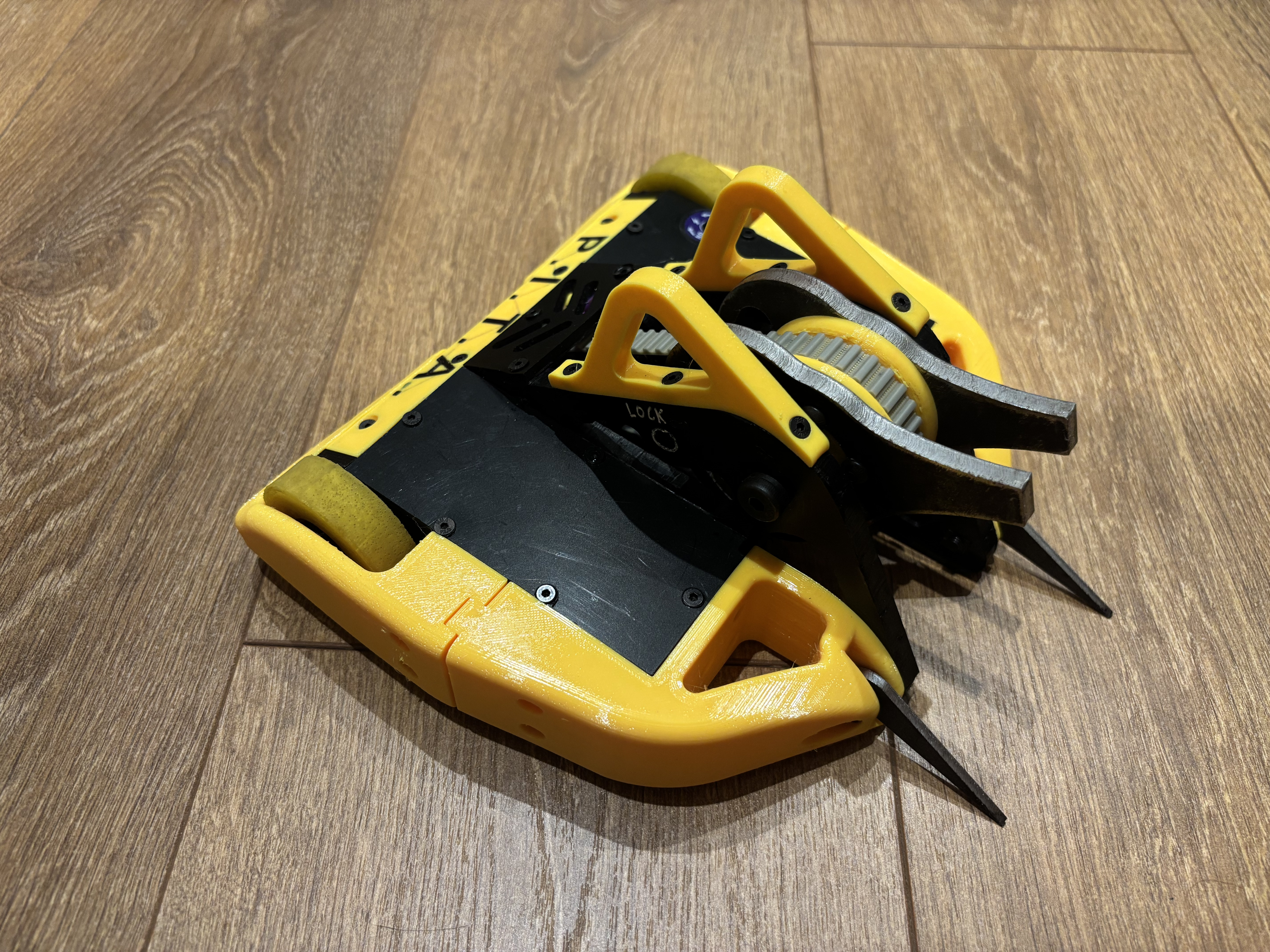

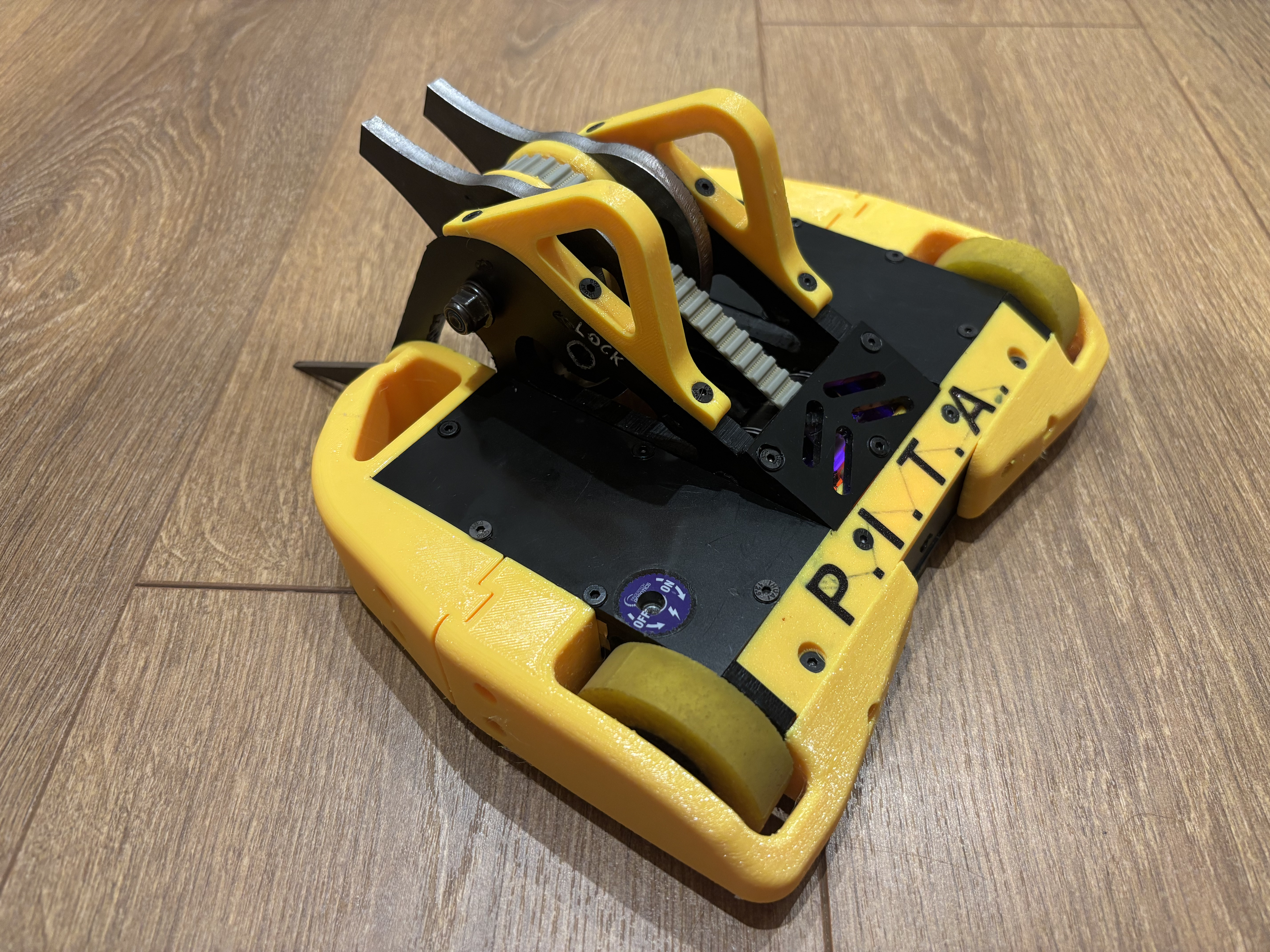

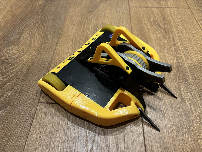

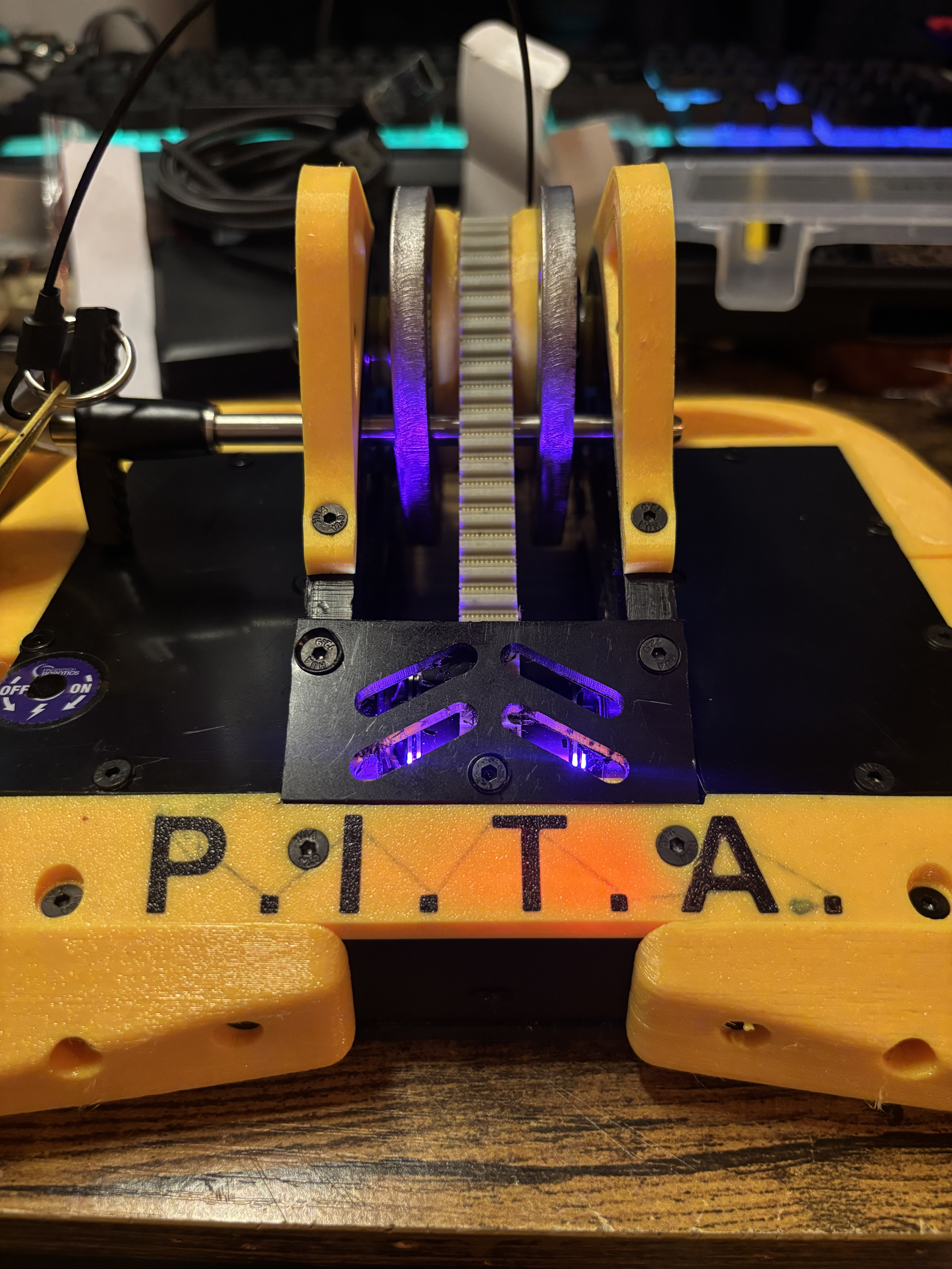

PITA is fully together in its final form for the competition, upgrades have included the chassis now being fully HDPE, thanks to a CNC router side project working out. Lasered have delivered on some great Hardox disks and forks along with some parts for a future idea.

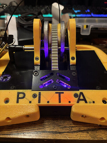

Power Lights

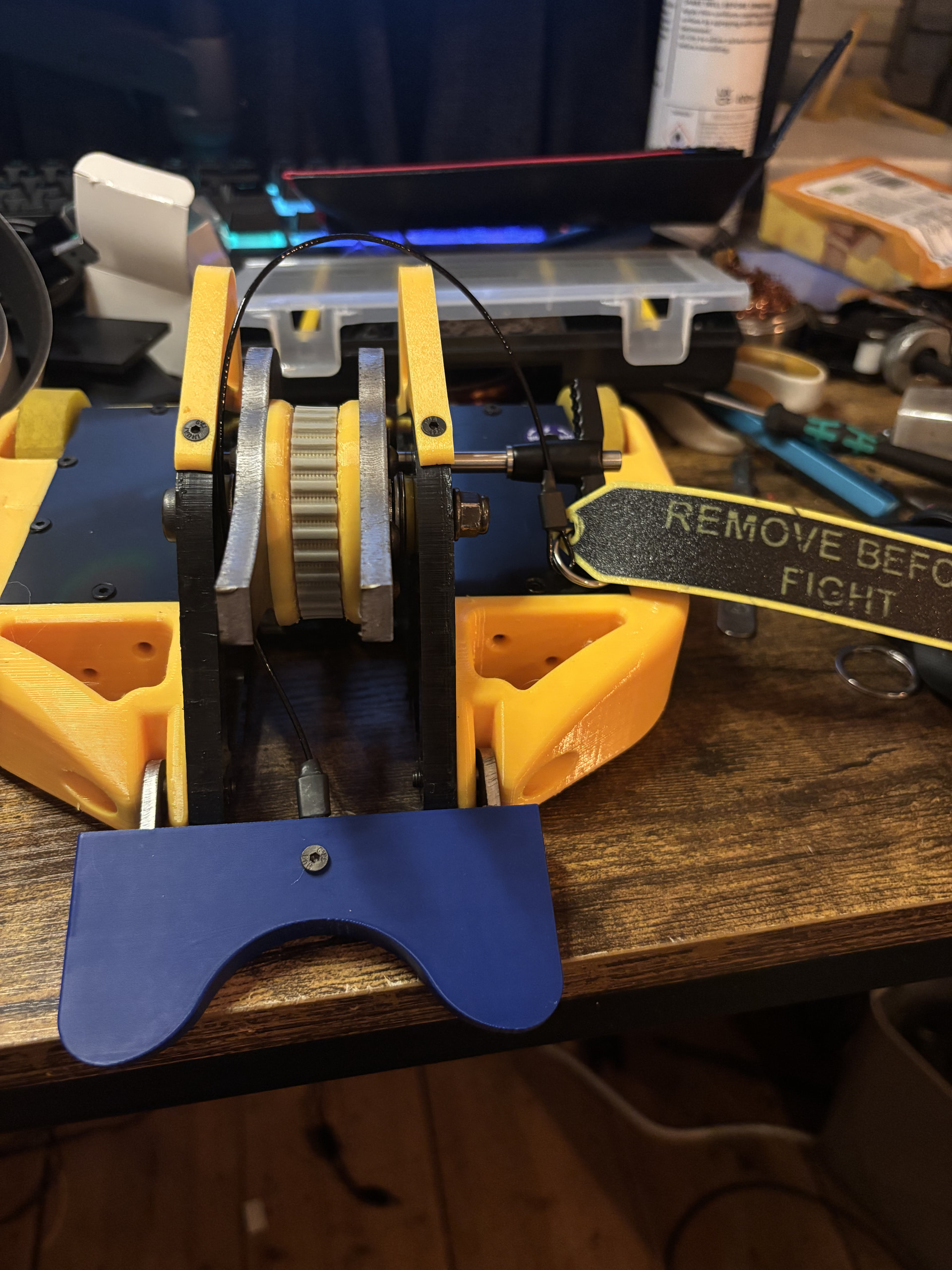

Sharp Fork Protection and Weapon Lock

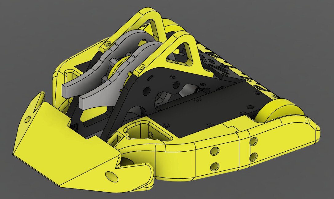

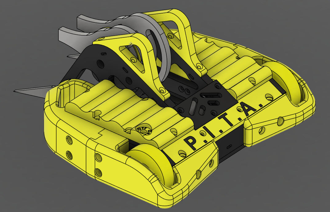

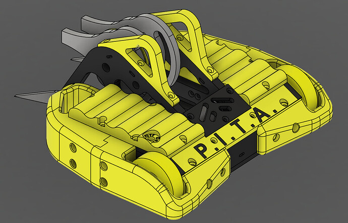

Final weight for the bot is a hair over 1.4 kg which is perfectly where i wanted it to be. Have got a couple of optional armour pieces waiting to be printed to help deal with hammer saws and horizontals, if and when needed. CAD renders of these are below.
Hammer Armour
Horizontal Wedge
