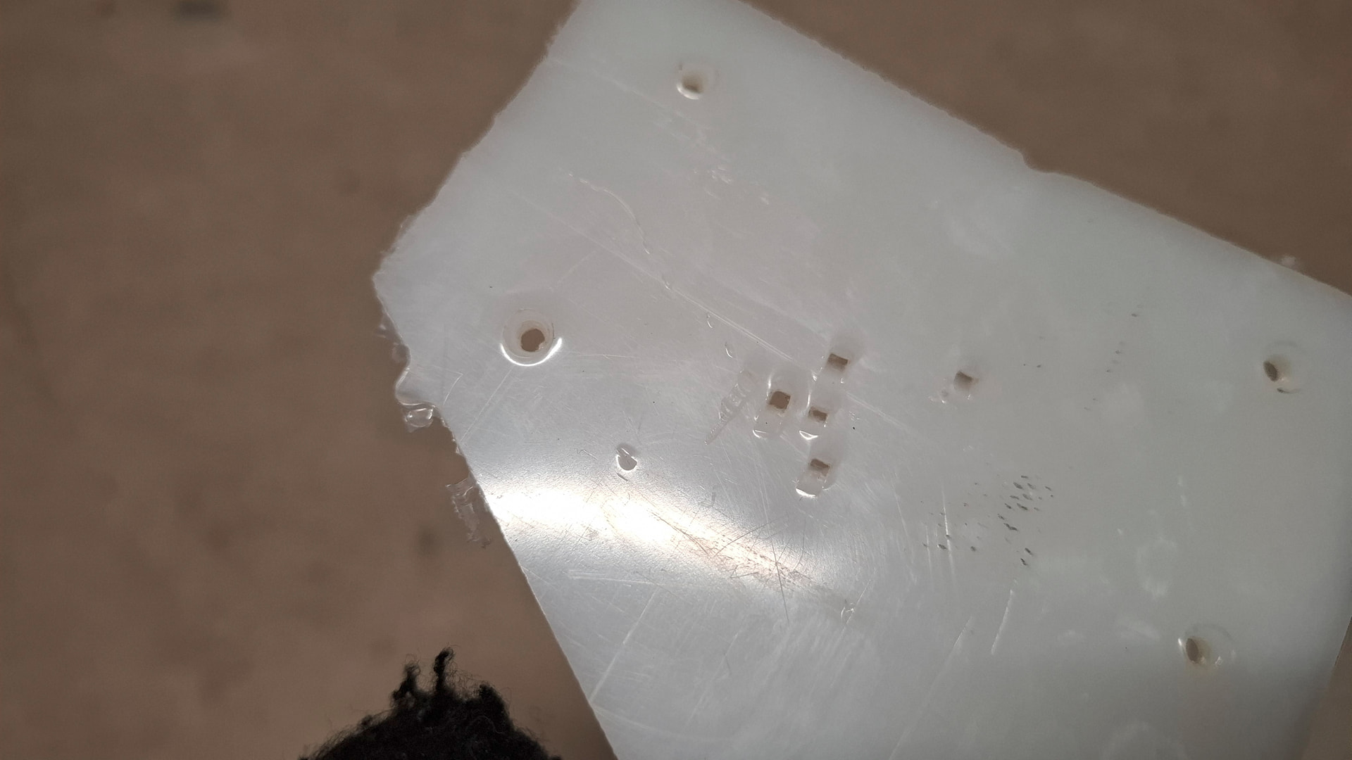

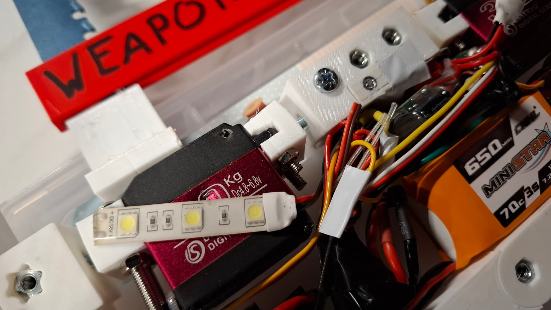

Fight 3 was against newcomer Pi, with a 4WD cam lifter. I was concerned about the length of the lifters, so I removed the rear armour again for more control. I got pinned early, but firing my axe let me slowly point towards them and start pecking away. An early shot took out one of the LED strips, and later got lodged in the casing for a servo, requiring an unstick. The pit got dropped, and I was nearly pushed in, but I fired the axe a bit more and managed to get away. Eventually, I got lodged again, this time in the thick top plate, so the fight went to the judges which I won.

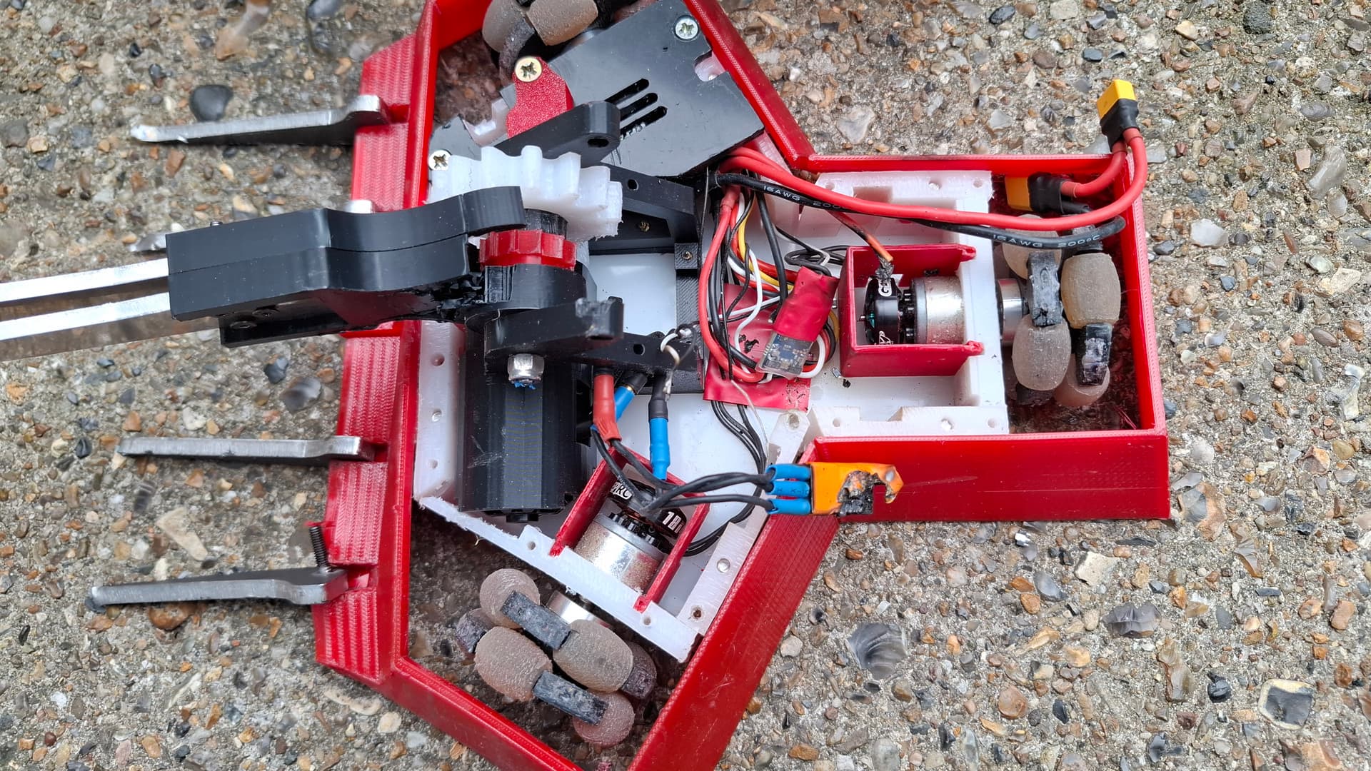

Finally, I went up against Icebreaker. My forks worked quite well when we went head on, but axe shots to the body didn’t do anything, as he now runs carbon fibre lids. On a few occasions, the axe went into his weapon, sending me cartwheeling. Despite the punishment, the axe seemed to continue to work. He continued to juggle me several times, but I managed to self-right from all, save the last one, which ended with me with a dead weapon and over the pit.
Fire! Of course, I lost the fight here, but what an amazing fight. After evacuating the robot and getting it open, it turns out the weapon ESC let out the magic smoke. When packing up the robot afterwards, I noticed several SMD components at the bottom of the chassis - my working theory is (because this is also an older ESC that has seen many events), the repeated shocks from Icebreaker dislodged some chips and/or the power wires, which then caused a short!

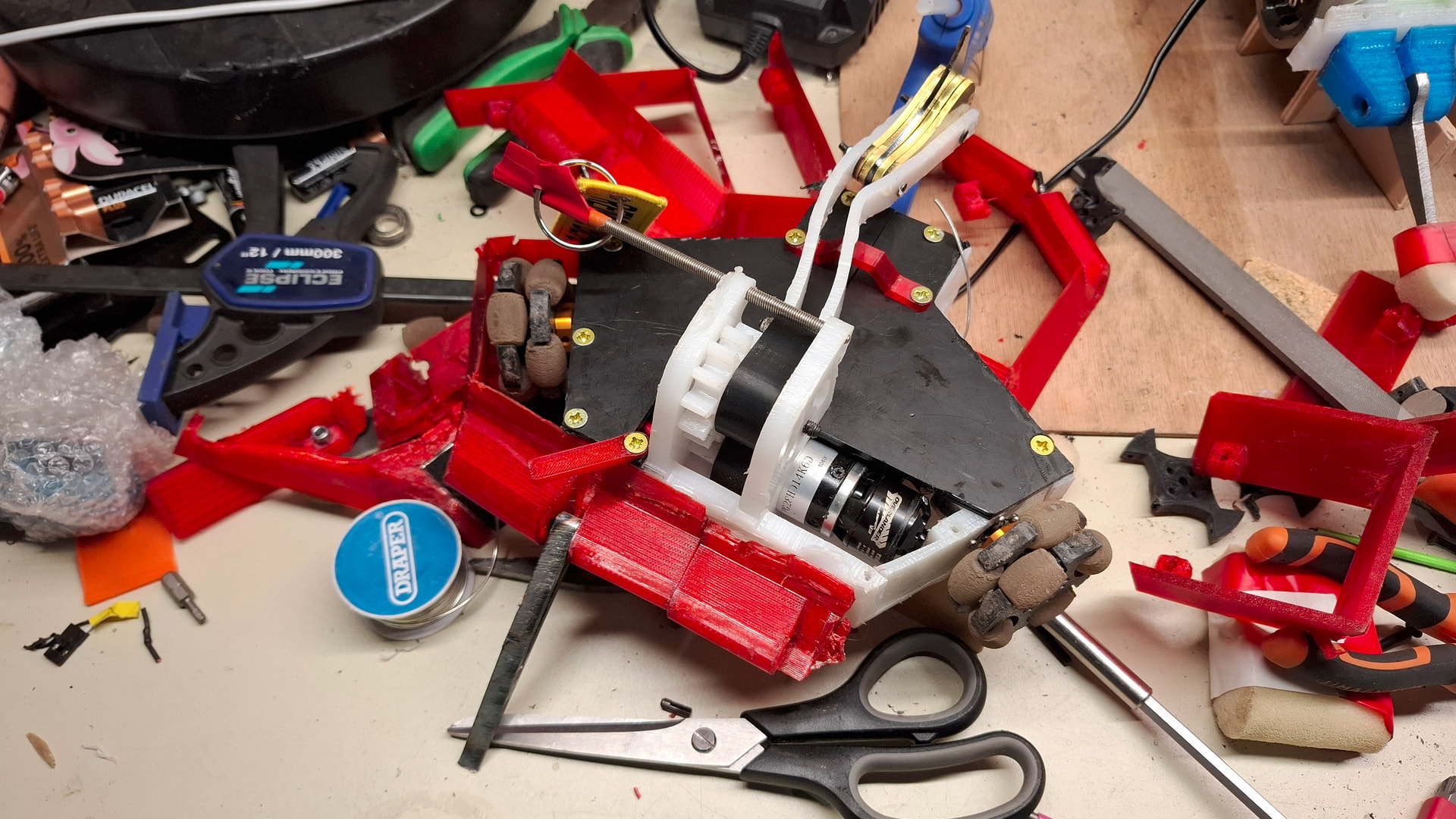

Really loved the vibes from not having a bracket here, and I think these fights were a great sendoff to PMXL V2. For now, I’m going to be focusing on the new DJ2 for beetles, while this chassis gets a well-deserved retirement! Definitely not done with PMXL of course, but the next time I get back to it, I want to redo the CAD completely (i.e. proper F360 CAD).
The last time PMXL fought was 6 months ago, and it ended with the weapon ESC going up in literal flames.
So I built a new one.

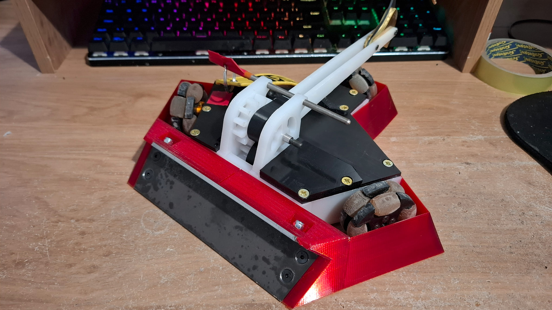

Finally moving to a fully F360 model for PMXLV3. It’s still very similar to the previous version, using the same drive and weapon motors and having a similar profile. Drive is still on Repeat Daul ESC + single ESC, the weapon ESC is now also a Repeat single ESC.

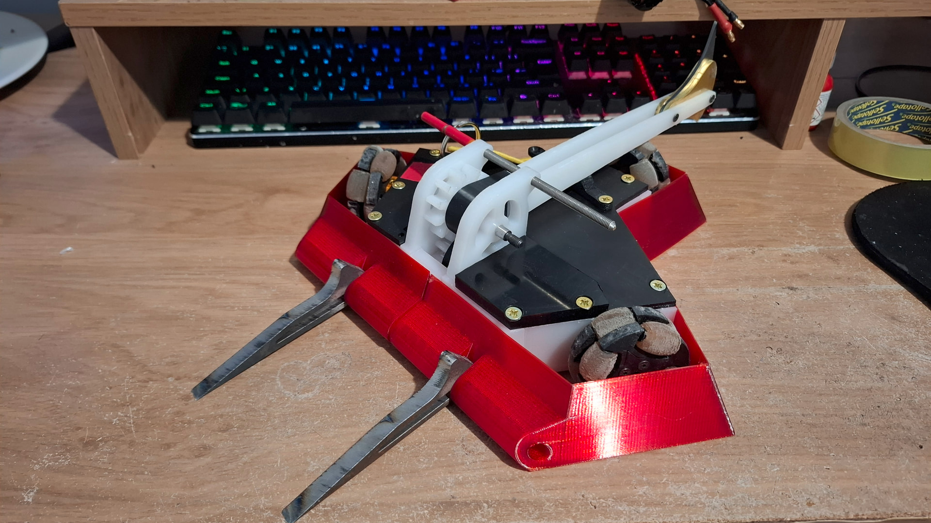

The front end has had a bit of a rejig. I’ve swapped from the 4x 5mm forks to 2x 8mm forks, and redone the profile of them.
The anti-horizontal setup has also been rethought, adding hardox to the top lip.
In terms of changes to the axe, the HDPE gear ratio is now 10:12 from 10:14 in V2.x, and the axe head has been redesigned. It now uses a 2mm impactor and brass plates to concentrate mass at the head.
This results in clean punches through 4mm HDPE now!
