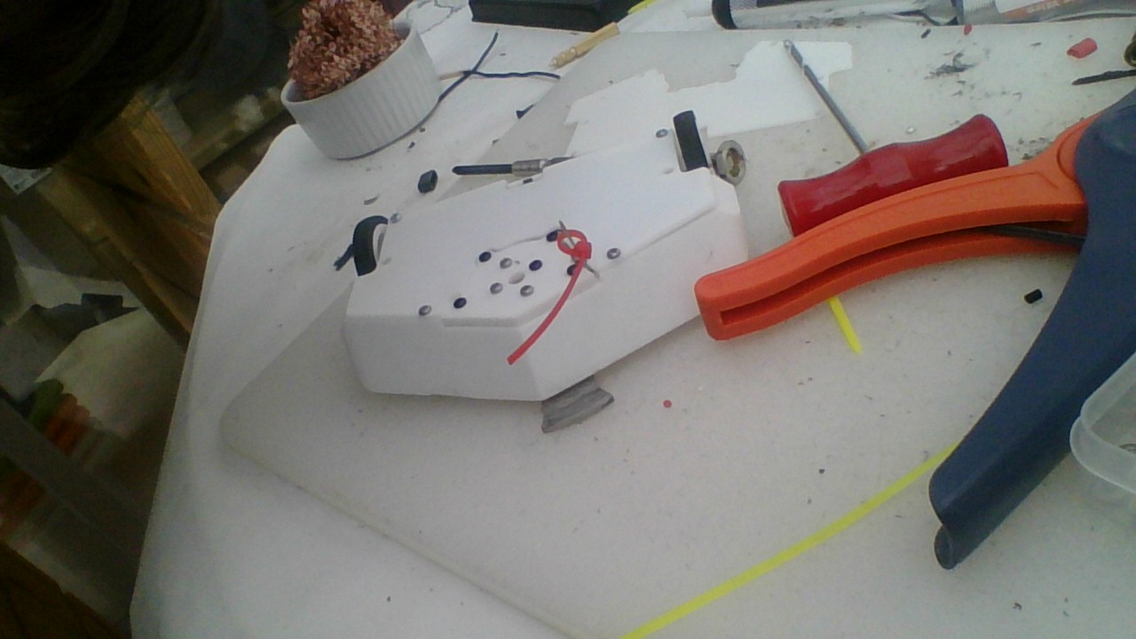

Guess who’s finished! After Ollie made his first contribution to the forum by reminding me about locking bars, I found a pin and drilled a hole through the top. But (there’s always a but) the motors are yet again wired up wrong! I’ll have to go poking around again to see what needs switching. I’ll admit, it isn’t the best locking bar, it’s just a needle with a red ziptie, but it should work long enough to drop it on the floor, and will allow for a half rotation at worst.
Edit: Consider the wires poked! During testing, it delivered some mean scratches and yeets to the testing targets, launching one out the test arena (Don’t worry, the arena itself may not have walls but I was behind a thick glass panel) and taking a chunk out the other!
