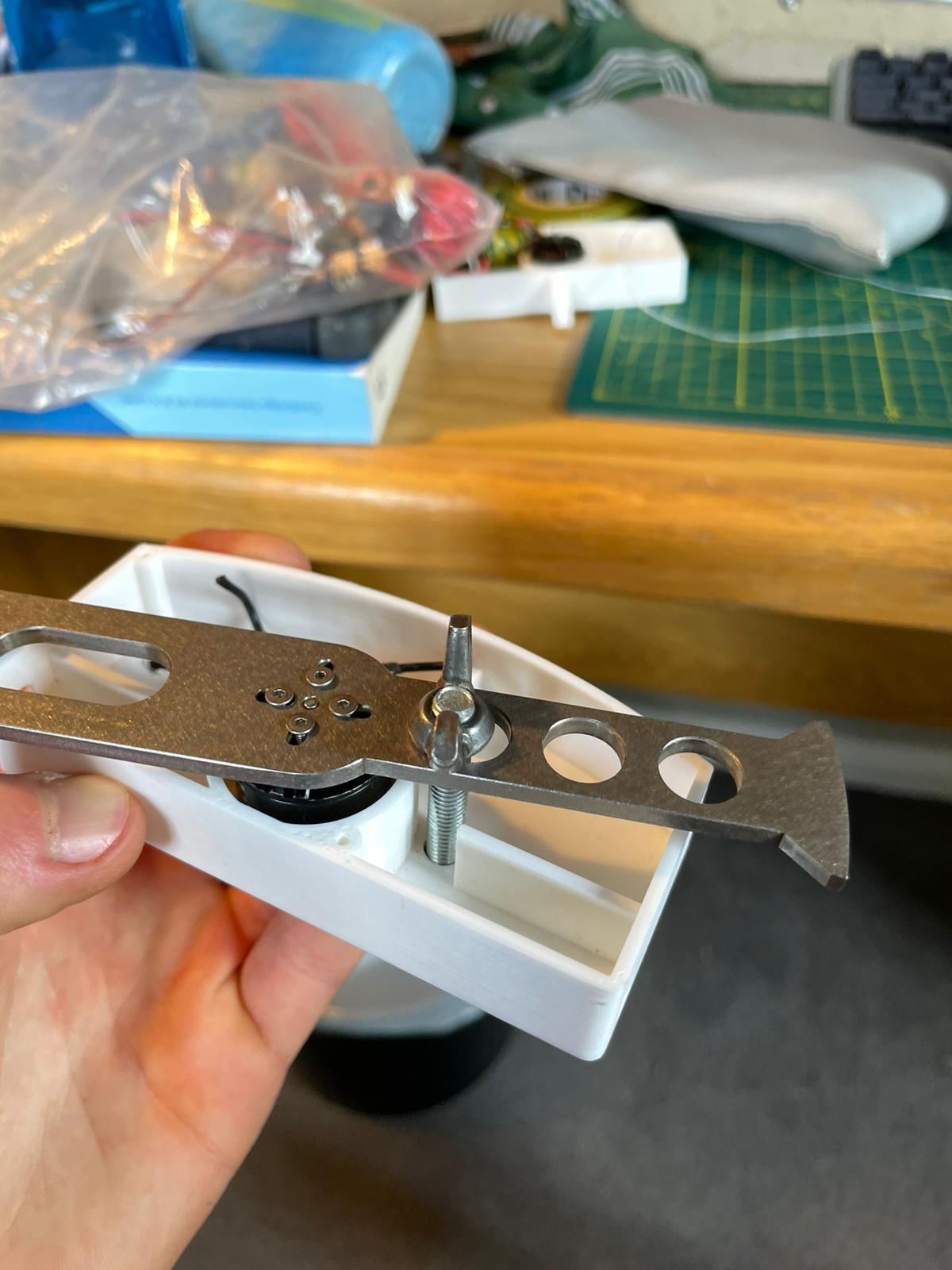

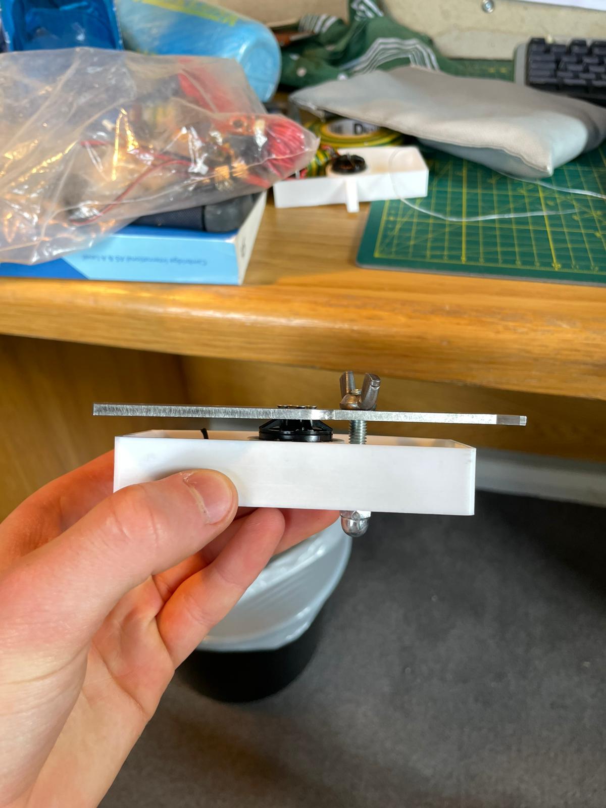

Is this a valid weapon bar? (in case its not clear, this is a threaded rod with a wing nut one end and an end cap nut on the other, screwed through my weapon and chassis)
Cheers guys,
Ollie.
As long as it stops the weapon spinning it’s valid! that looks more than enough. I’d make it so you drop the bolt in from the top though so you don’t have to pick up the live and dangerous robot in order to put the locking bar in
thanks a bunch - you mean spinning when powered by the motor right?
When or when not powered. Of course, you can always remove it when you’re working on the robot itself, but if you’re away from the robot, you gotta put it in.

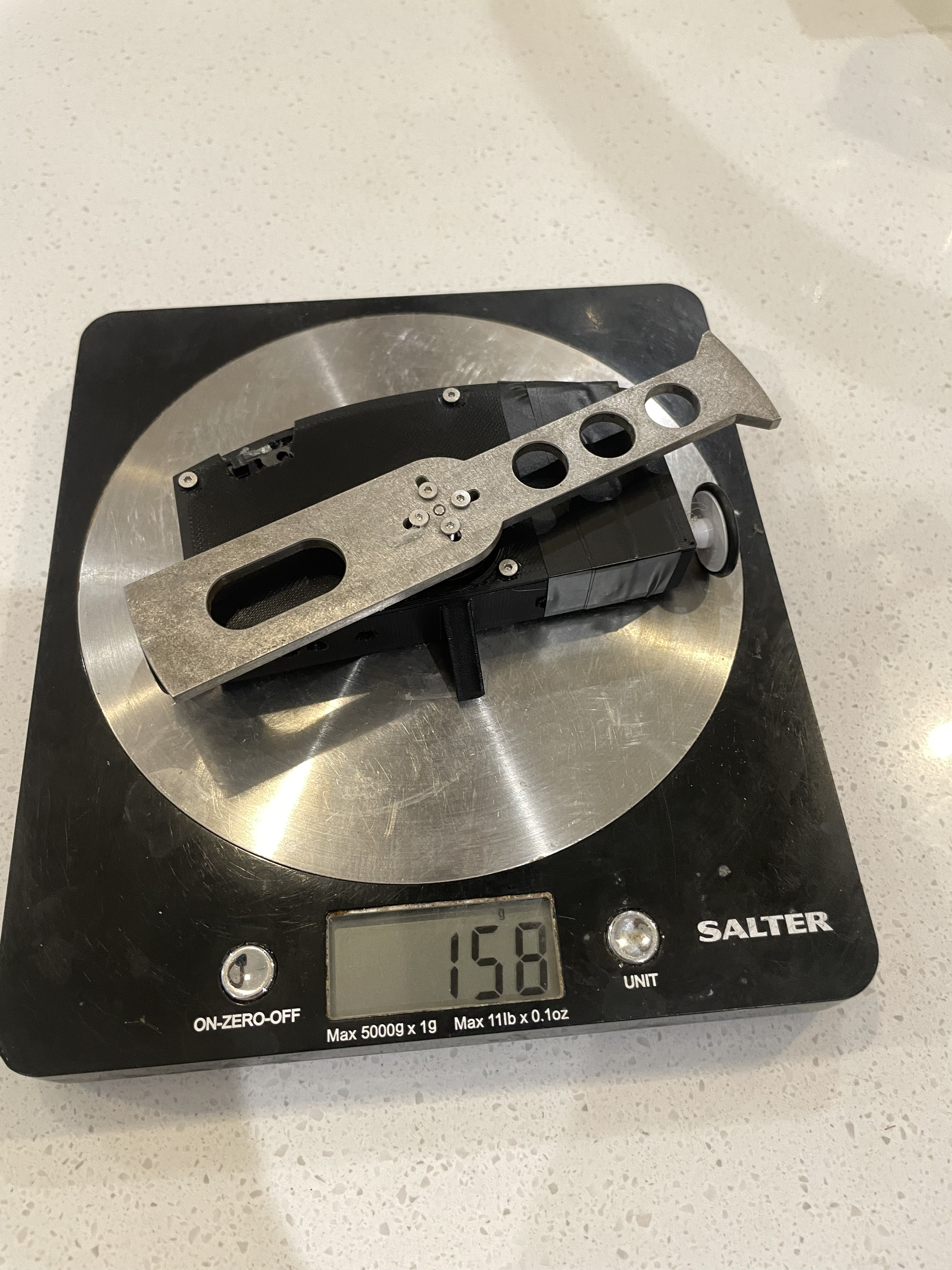

What isn’t fine, is that I’m sitting 8 grams overweight, which means that I need to (unfortunately) take some mass off the spinner. Sadly I don’t have the means to accurately do this myself so I am going to have to design a new one.
About spinners for antweights, would using the same spinner design (#45 steel from JLCCNC whatever that is) and making it about 2-2.5mm thick be viable - as in would you say it is strong enough for antweight hits?
If not, then I will definitely be redesigning, and I have some design constraints. I can only really afford to make one spinner, so it’s going to have to be designed for all-rounding. I watched a bunch of the bloodsport weapon blade design videos, but I’m still unsure as what to go for. I ideally need something that counters the antweight meta of pushers & flippers, but also be somewhat resistant to verts. Can anyone give me a general shape for which to base my spinner off?
