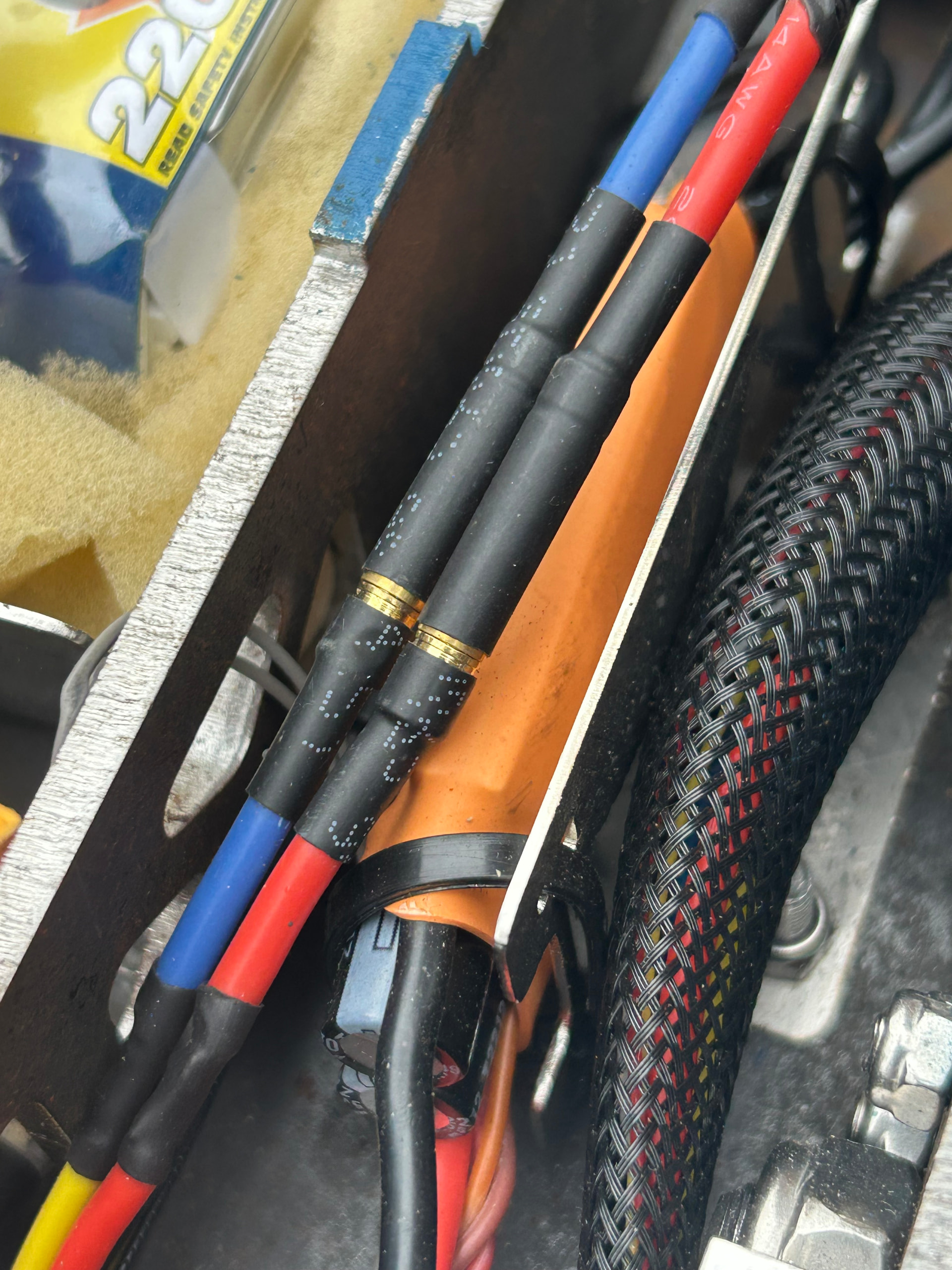

Hello there, does anyone know a beginner friendly alternative ESC, it’s a 80a Ranglebox ESC and I can’t find them anywhere the motors I am running are 200kv 5045 sensored motors and the battery I am running is a 2200mah 6s 70c lipo.
Many thanks
( I have attached a photo of the esc connector I need I am a bit new to the featherweight class)
