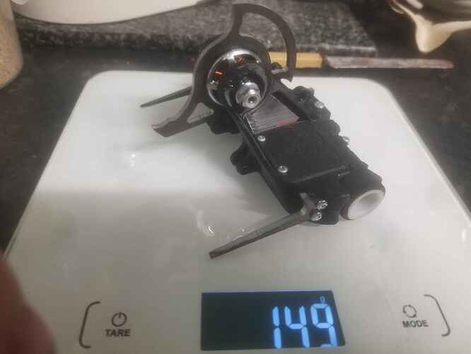

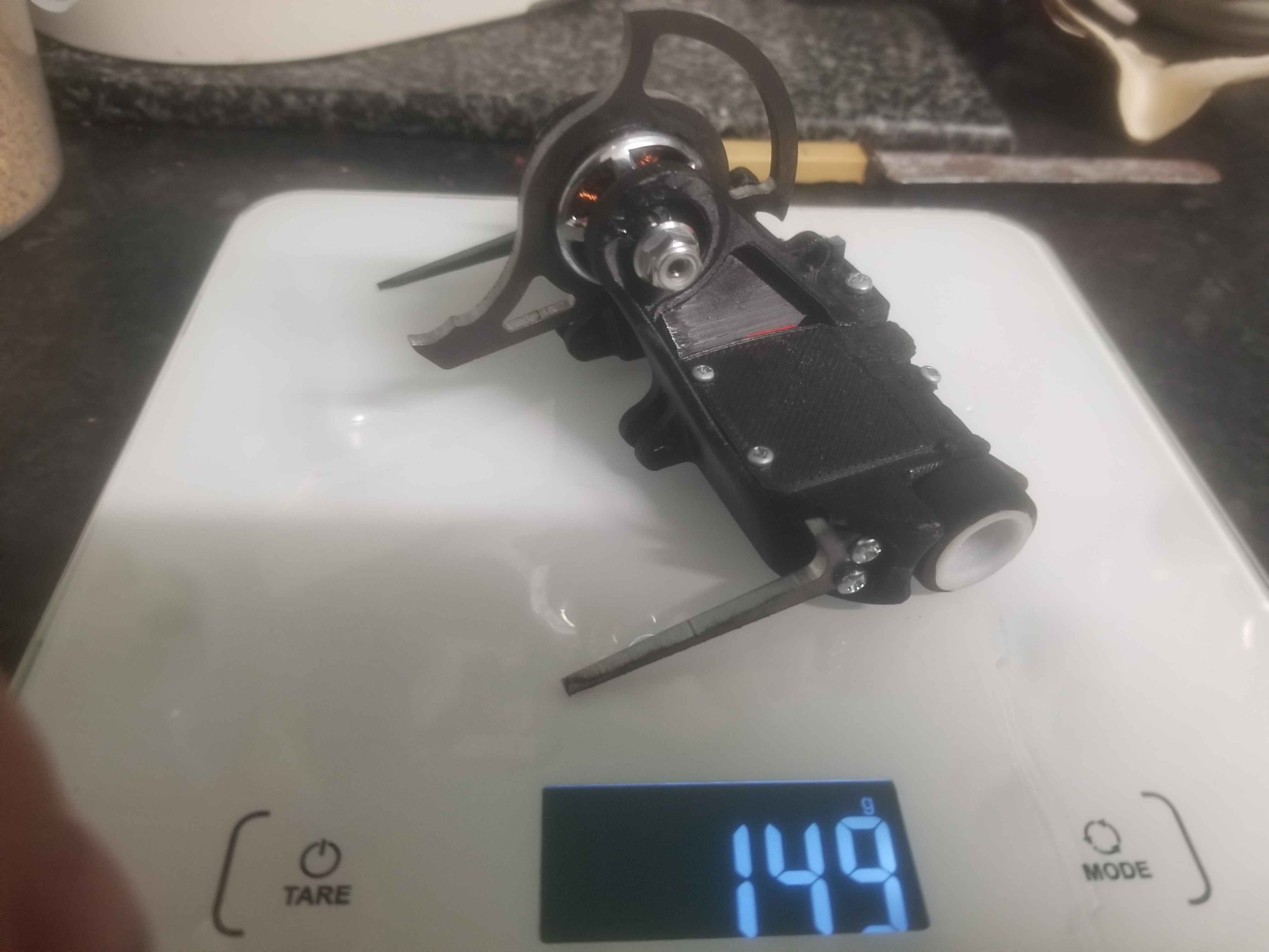

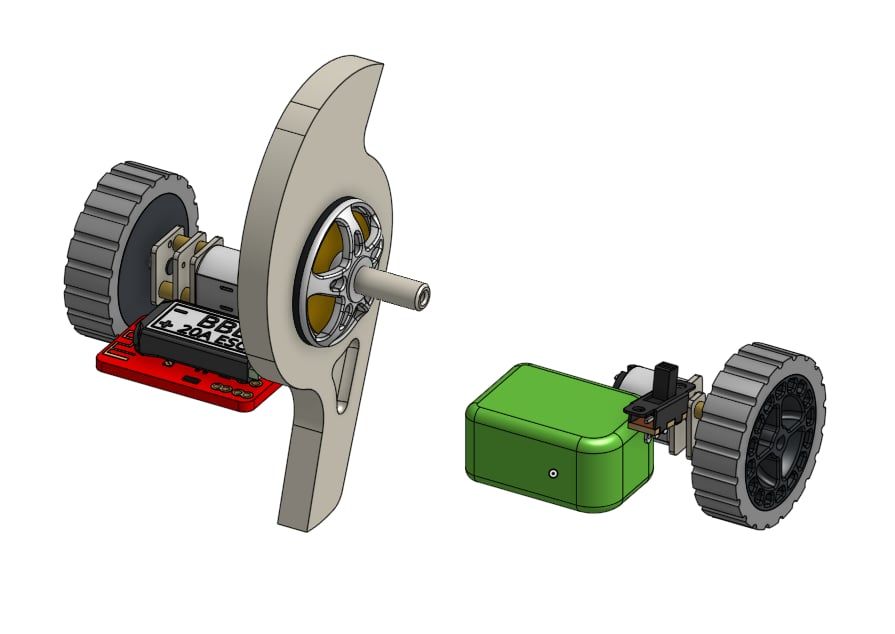

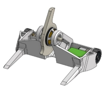

Vanquish originally was going to be a much more extreme machine than it is today, with a frankly ludicrous 120mm 5.5mm thick titanium blade, this was a little optimistic however as with all of the parts in space, we had a monumental 11g for an entire chassis, top plates, and wiring. Needless to say this version of Vanquish did not go forward.
Vanquish was then reimagined with a slightly more sane 85mm sweep diameter and a very good 15mm of biting tooth. This was yet again done in 5.5mm titanium and came out to 36g. What differentiates Vanquish from most other large verts of its class is it’s very overkill 3s power system, its microscopic M10 drive motors, and it’s very very large weapon motor, that being a 32g 2306. This motor is actually so heavy that I could fit 6 more drive motors in its place weight wise. This puts it overall just shy of 70g in the weapon system while still being on wheels. Such a large motor is used as with it, it could probably self right with a shuffler ontop of it, and for better (or for worse) spinup time was near instant. What I failed to account for however was torque reaction, which proves to be the number 1 killer of this robot to this day. Such a large heavy weapon being spun up so quickly to such high rpm’s made the thing an absolute menace to floors, and very near impossible to actually spinup without rolling forward and hitting the floor. Regardless this was the first iteration of the robot and now it was time to actually build the thing.

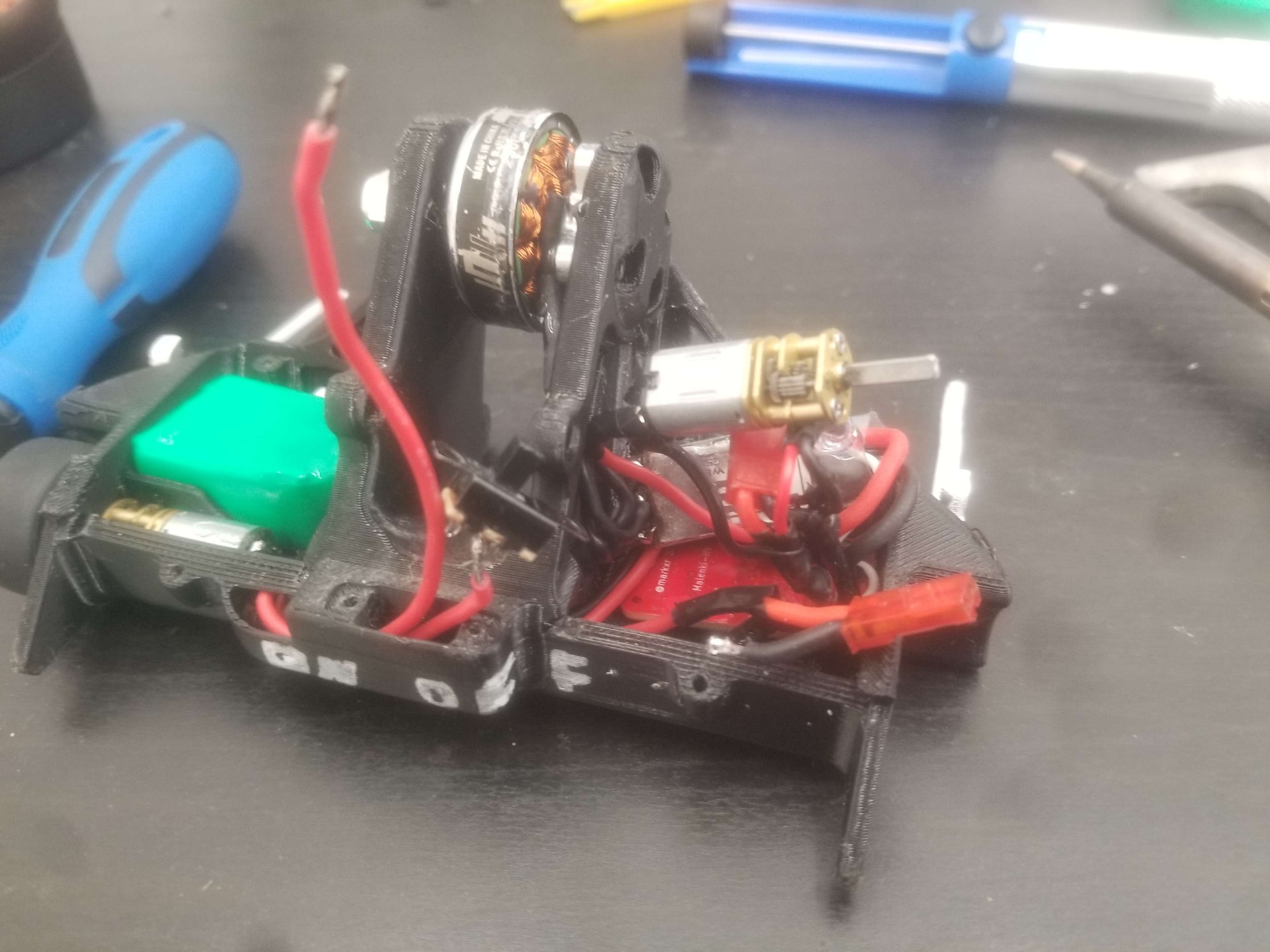

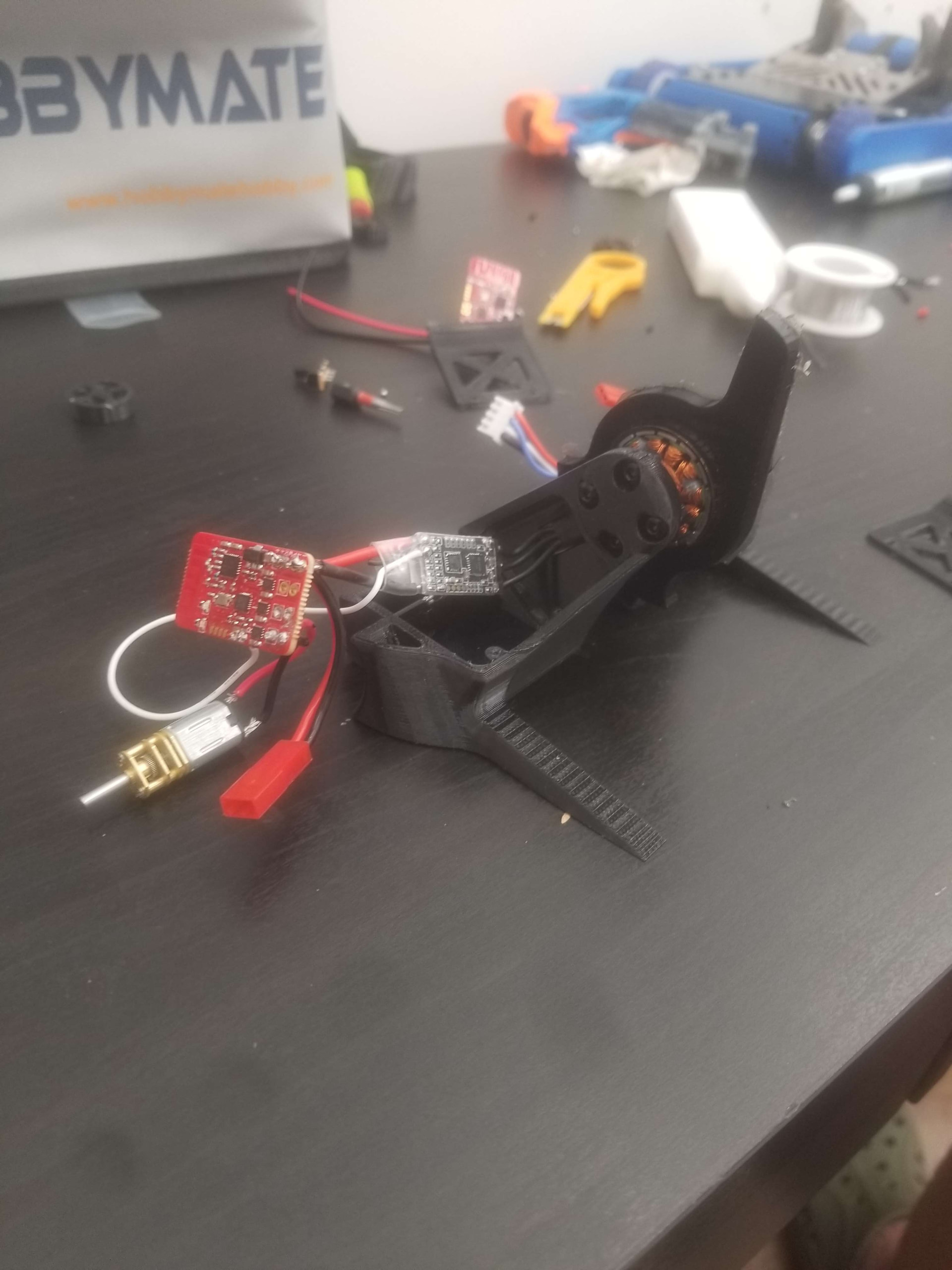

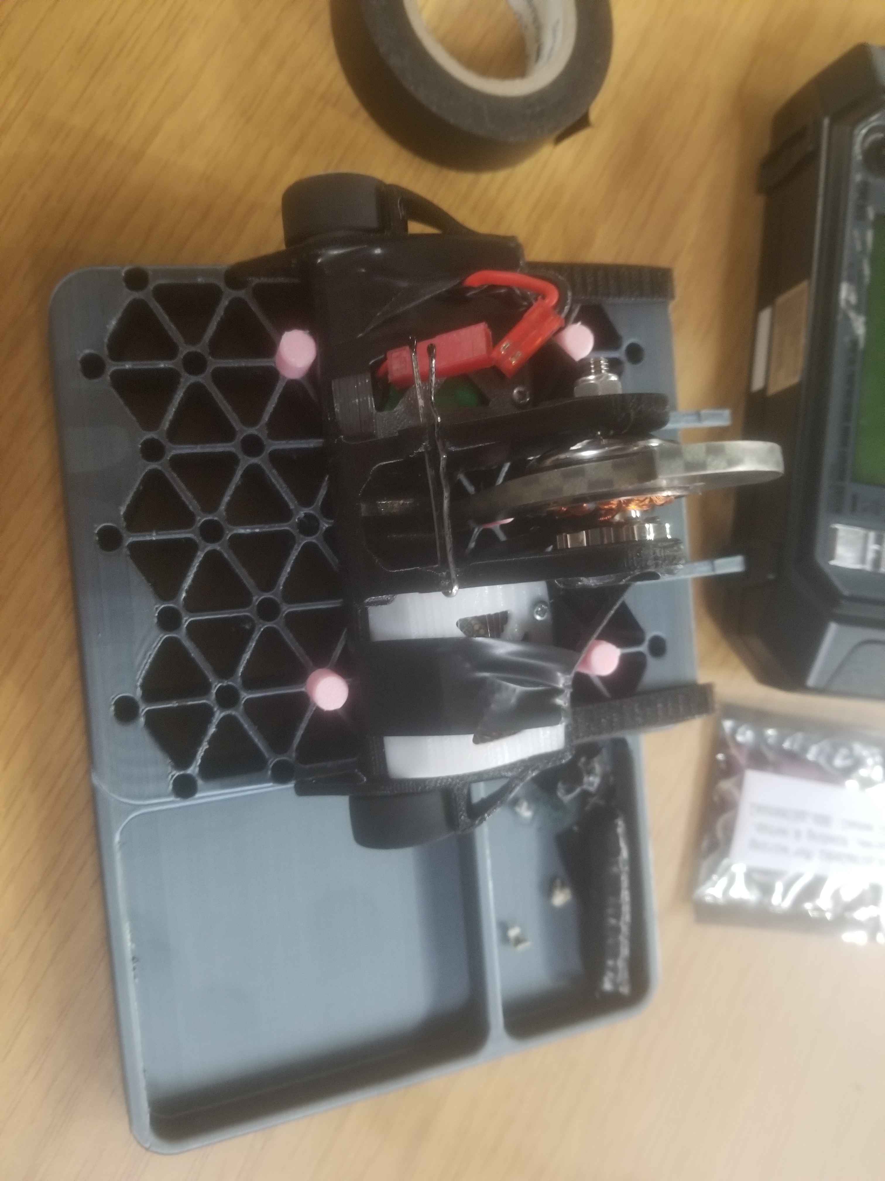

I dont think there are words to describe the experience of wiring this bot up. It being my first time ever actually using a soldering iron I naturally killed 2 HV malenkis, which is never a good start. Describing the process is near impossible, but the wiring itself is very easy to describe. The word to describe it is tight. Really, really god damn tight. Accessibility is also an absolute nightmare, with everything except the battery (in this version) being hard soldered and so closely packed together. Eventually after a few revisions that included some more forks, I got it good enough for a spinup test. Headphones warning, seriously.

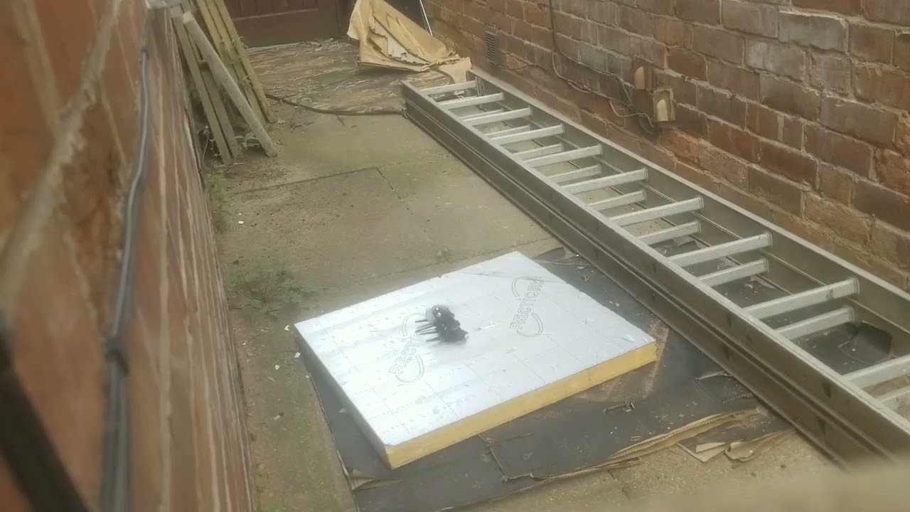

Sweet jesus this thing is loud, despite being a good 5 meters away from it behind a brick wall, my ears rung for days. Probably should mention that the weapon has a tip speed of around 319mph hypothetically, so it’s no wonder it generates abit of noise, but this was entirely unexpected.

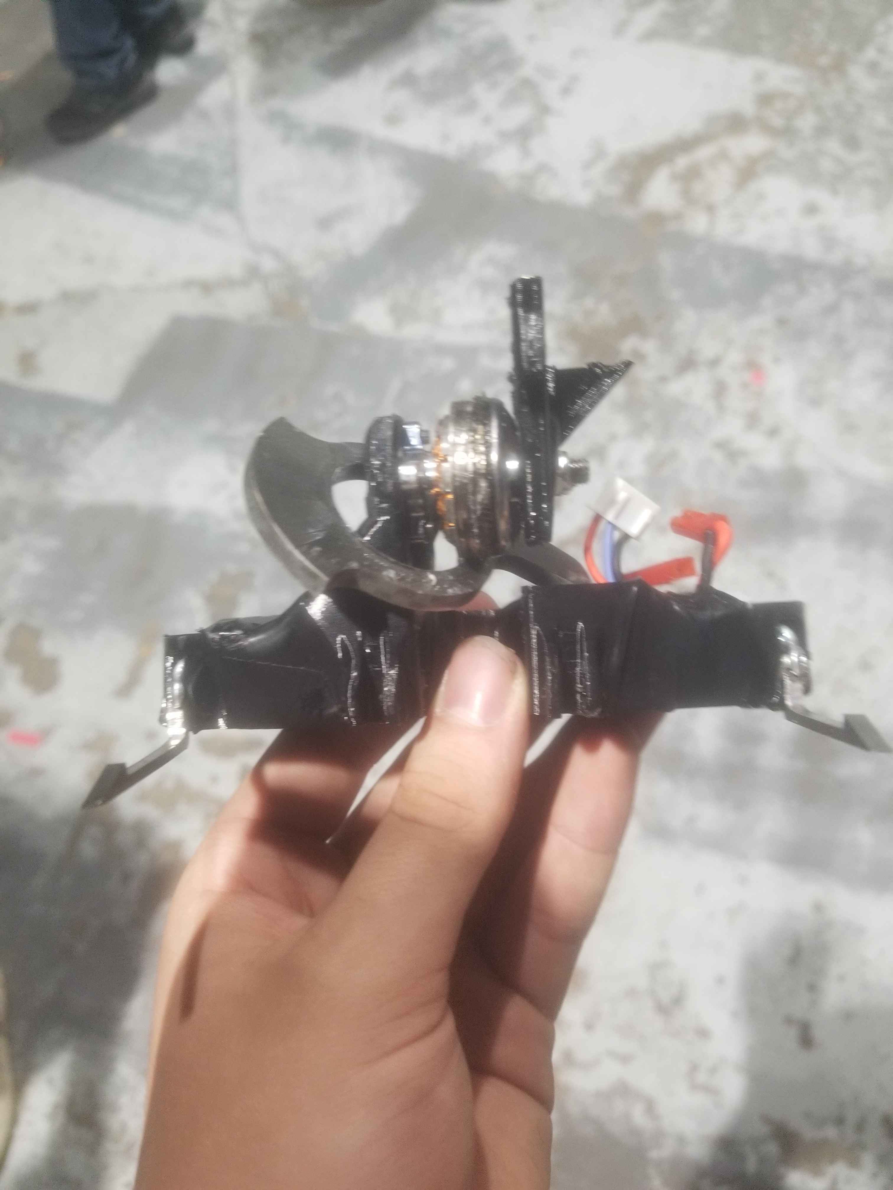

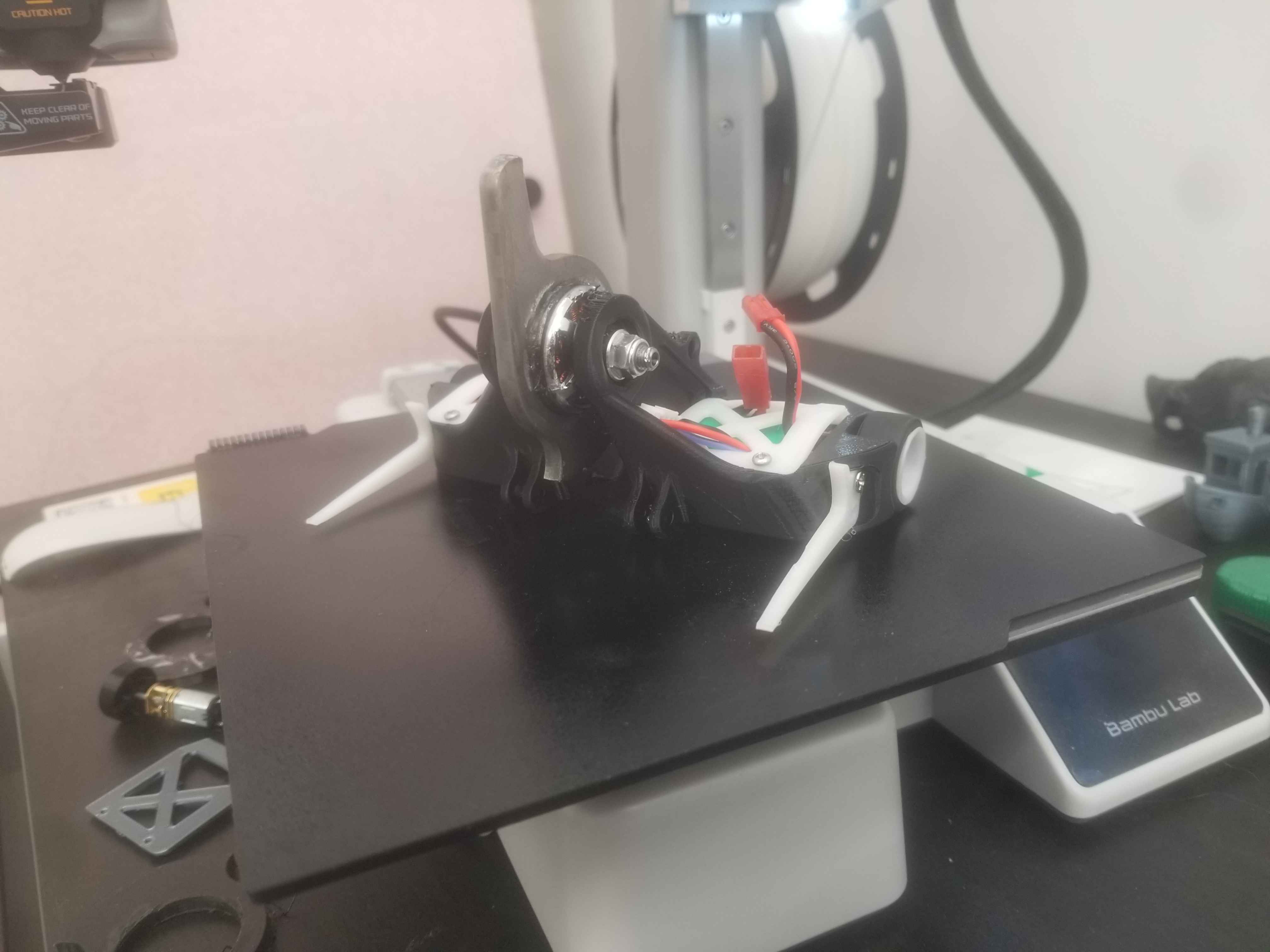

Most notable was the new stability forks, now being separate from the chassis. These would later be cut from 3mm hardox for something very strong and very stiff. This version of Vanquish was taken along to the beetleweight loughborough event, which did an ant rumble in the beetle arena later.
Yeah not a good look, but on the other hand it was awesome so who cares. Due to poor print settings the 64d tpu chassis had cracked severely and the weapon had come detached from the rotor due to improper super gluing.

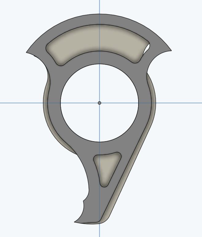

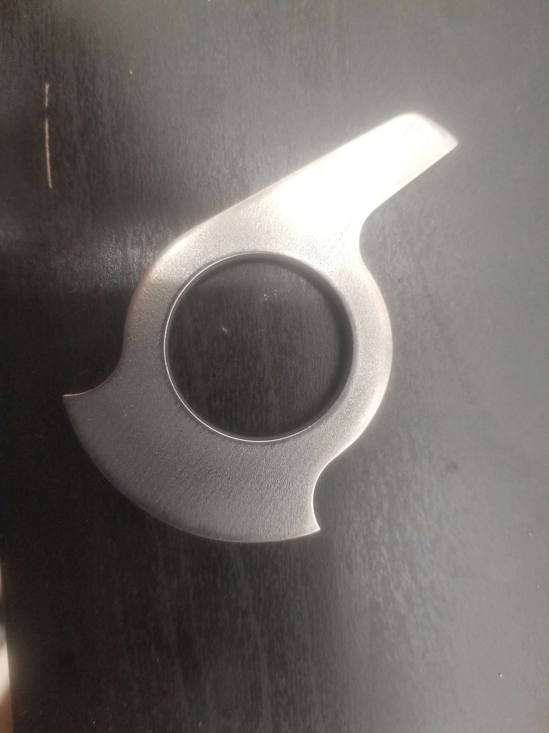

After a few events with minor changes I decided to make a hardox anti tpu weapon, which would eventually become my main weapon, as it was becoming apparent pure concussive force with such a wide tooth on the titanium one would not do against tpu spam control bots.

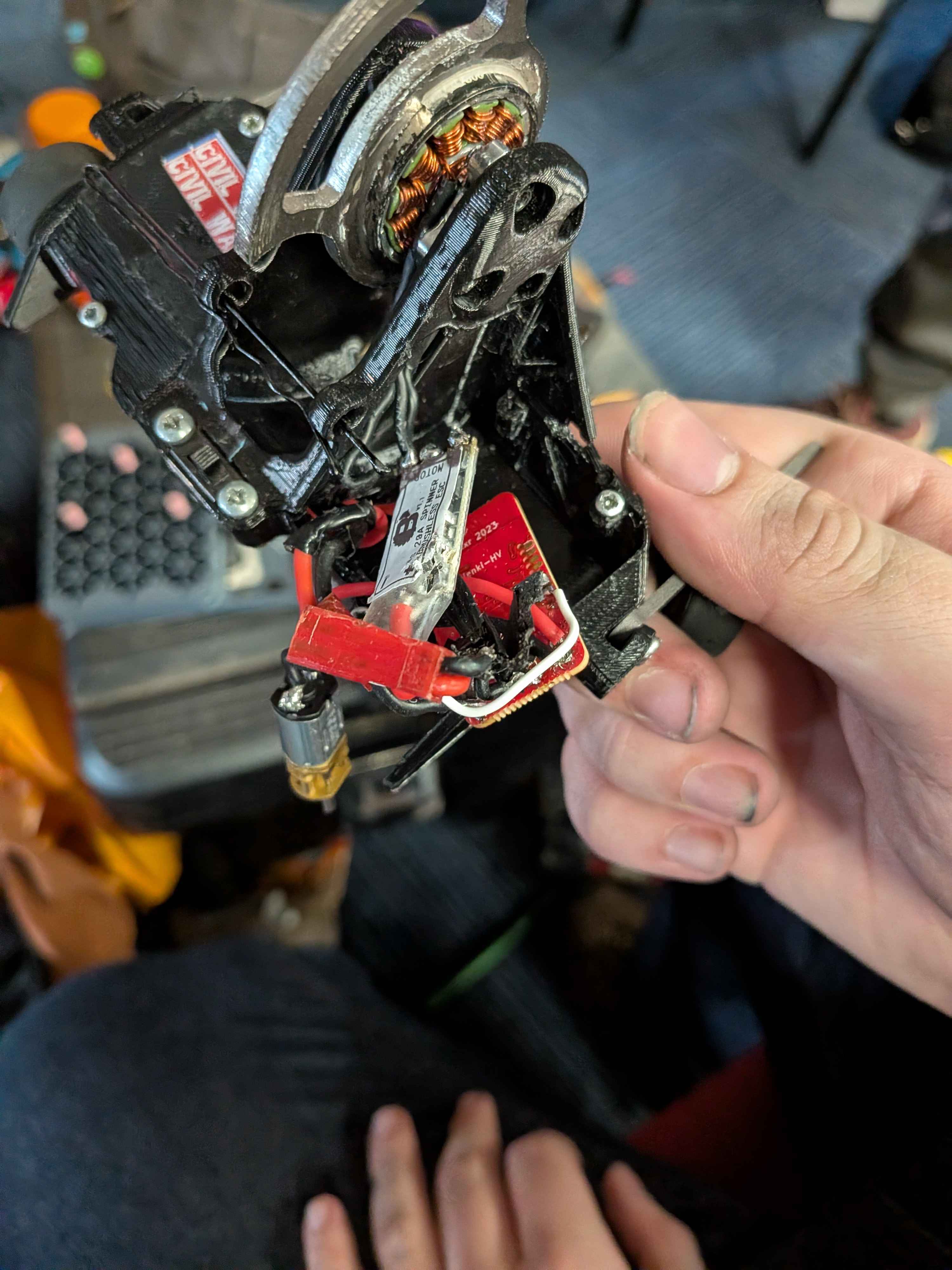

After yet again battling the million headed hydra that is the wiring in this thing, this version of vanquish was showing some promise, with some frankly terrifying hits, notably against Birdemic and Jungle man, 2 good robots that were very very damaged within a very short time frame.

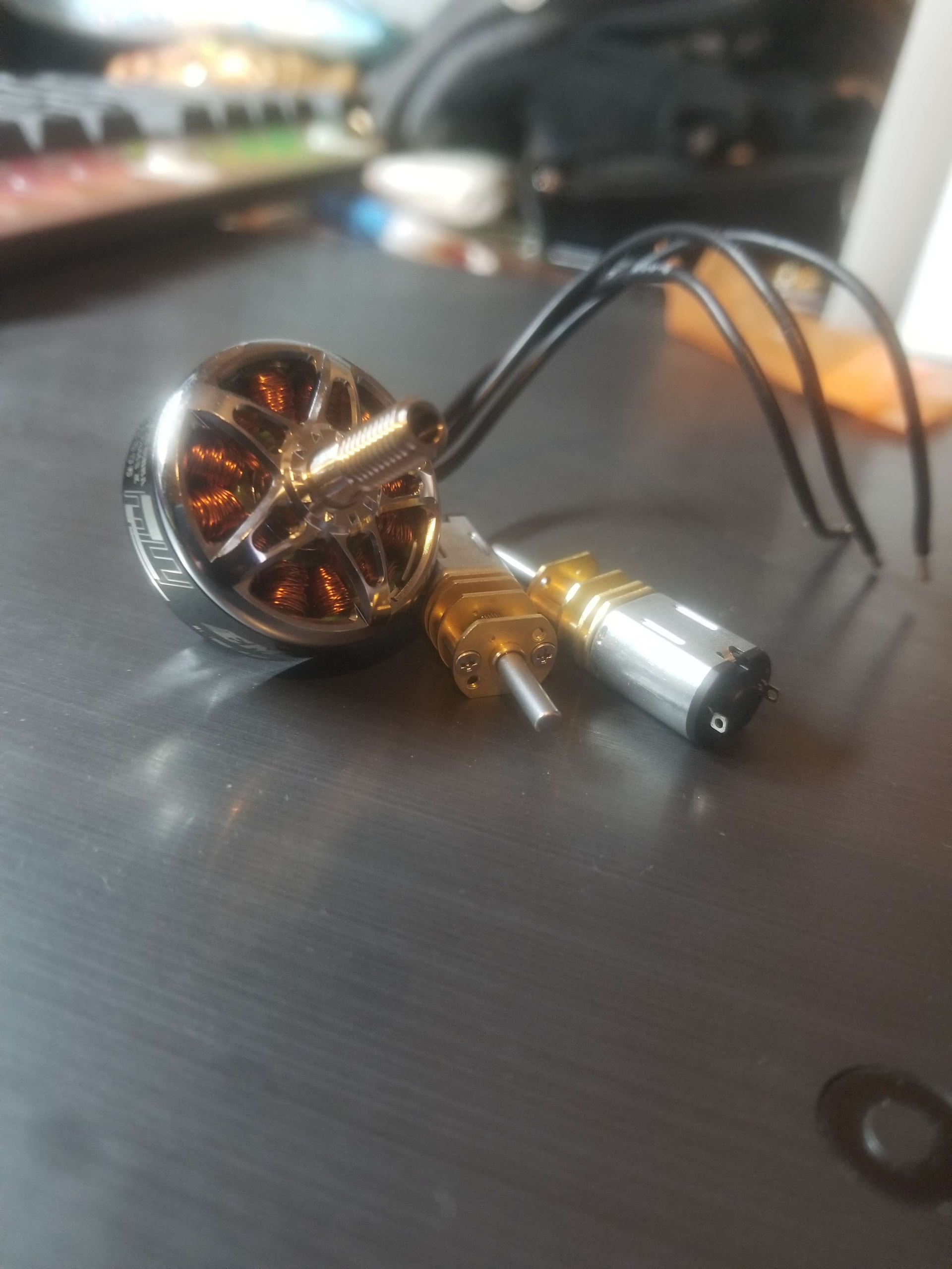

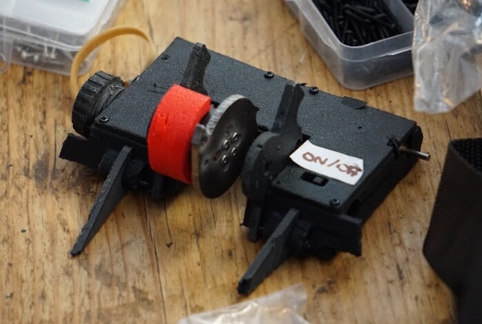

After a couple dojo’s and a visit down south to ORCS 11 and GROCS 5 and 6, it was time for some stability and drive upgrades. Along the way I picked up a radiomaster zorro, a controller that can do some fancy things, in my case this would be custom ramping limits, this allows me to set a speed and how long I will spinup for to reach the speed. This dramatically helped with piloting the thing as I can focuse more on driving the thing than slowly ramping up the throttle manually. The upgrades listed below took the bot from like a 4/10 to an 8/10 instantly. Who would have guessed staying on the floor and being able to move toward the opponent is useful in a fight?
The upgrades that debuted at AWS77 were long 100 walled PLA-ST forks, the switch to n10 drive motors, new wheel hubs and stiffer top plates. The difference was immediately noticable just driving around at home, it was incredibly fast and in a pinch had some shoving power. In competition the new forks proved themselves worth it, as they provided a much needed stability buff which allowed it to get all the way to a joint 5th place at AWS and a put on a tremendous show at ORCS 12 and Loughbrough Ants.

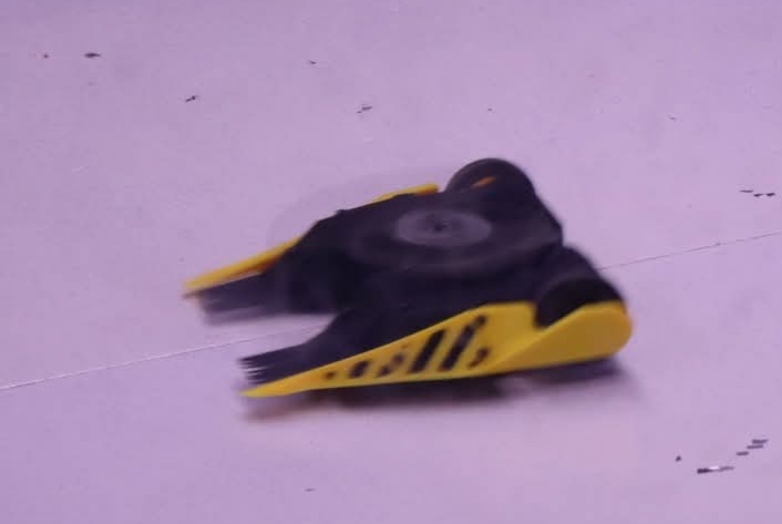

Fight 1

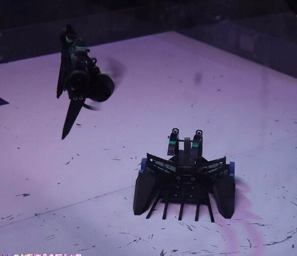

First fight of the night has me drawn against Pinky. From what I had seen previously of the bot I thought this would be a pretty good display of reach dominance, due to its spinner being much smaller than my own. However for this event Pinky was fielding their own large disk which dramatically changes up this fight, I still had the reach on him but with my terrible gyro there was quite the possibility of them ripping through my front wedge and hitting the lipo.
Timestamp;
Overall a really good fight, surviving 2 bounces without ending up in the pit is awesome. Judges definitely got it right though, despite bashing in their front end, disabling their weapon motor and mangling their TI plate Vanquish had a solder joint on the switch come off leading to intermittent power throughout the second half. This allowed Pinky to get some good hits and control in, ruining the tips of my forks and some minor cosmetic damage on the front end. A loss for Vanquish but definitely a fun one, maybe this will be my encouragement to get good at soldering.

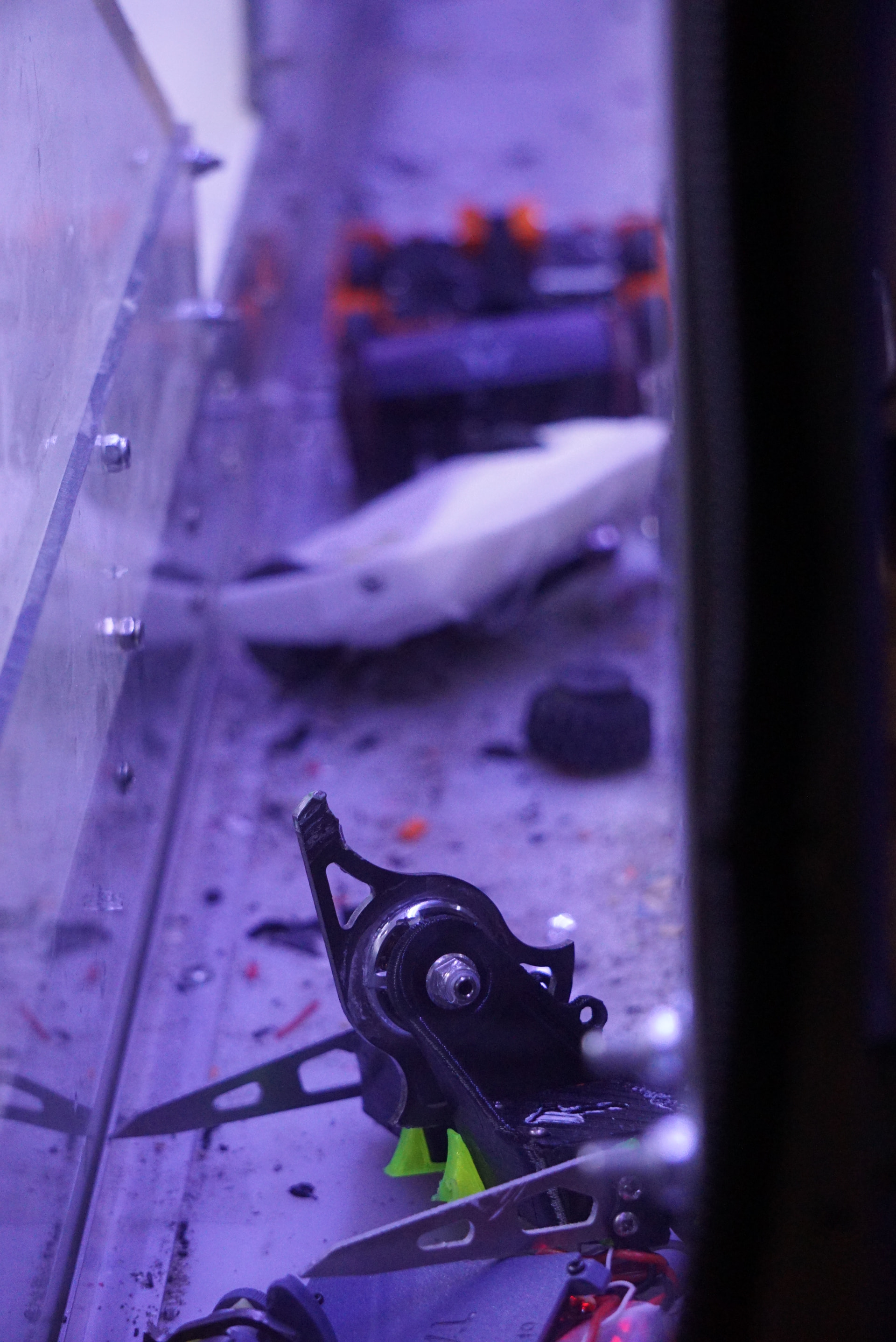

Fight 3

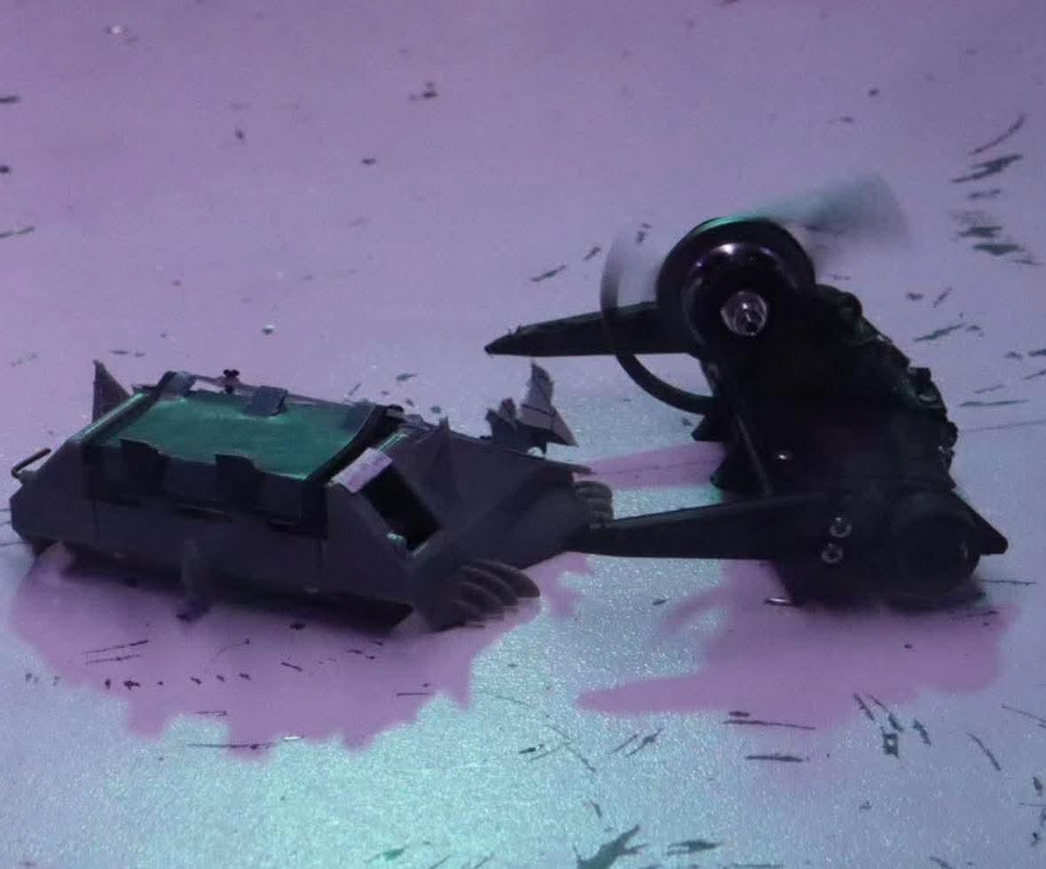

Now desperate for a win so I can get to the playoff rumble, I fight hazard. It’s a horizontal overhead spinner wielding the titanium monsoon bar. I’ve bent thicker and stronger materials so I was pretty confident one even minor hit could turn it to a pretzel. Still it was not to be underestimated, it could hack at my uprights and cut my phase wires, which would be a death sentence.
Dont think I could have really asked for a better fight for myself. 1st hit bent the bar and put quite a good twist on it, and the second shattered the entire back end and roofed it. Most impressively though Vanquish sat smooth throughout it, not flying away under my own big hits is huge for the viability of this bot. Good damage too, my weapon went through the back of the drive motor and broke everything in the wound channel, writing off the chassis. Thankfully didnt hit anything expensive and I believe the weapon motor was still fine.

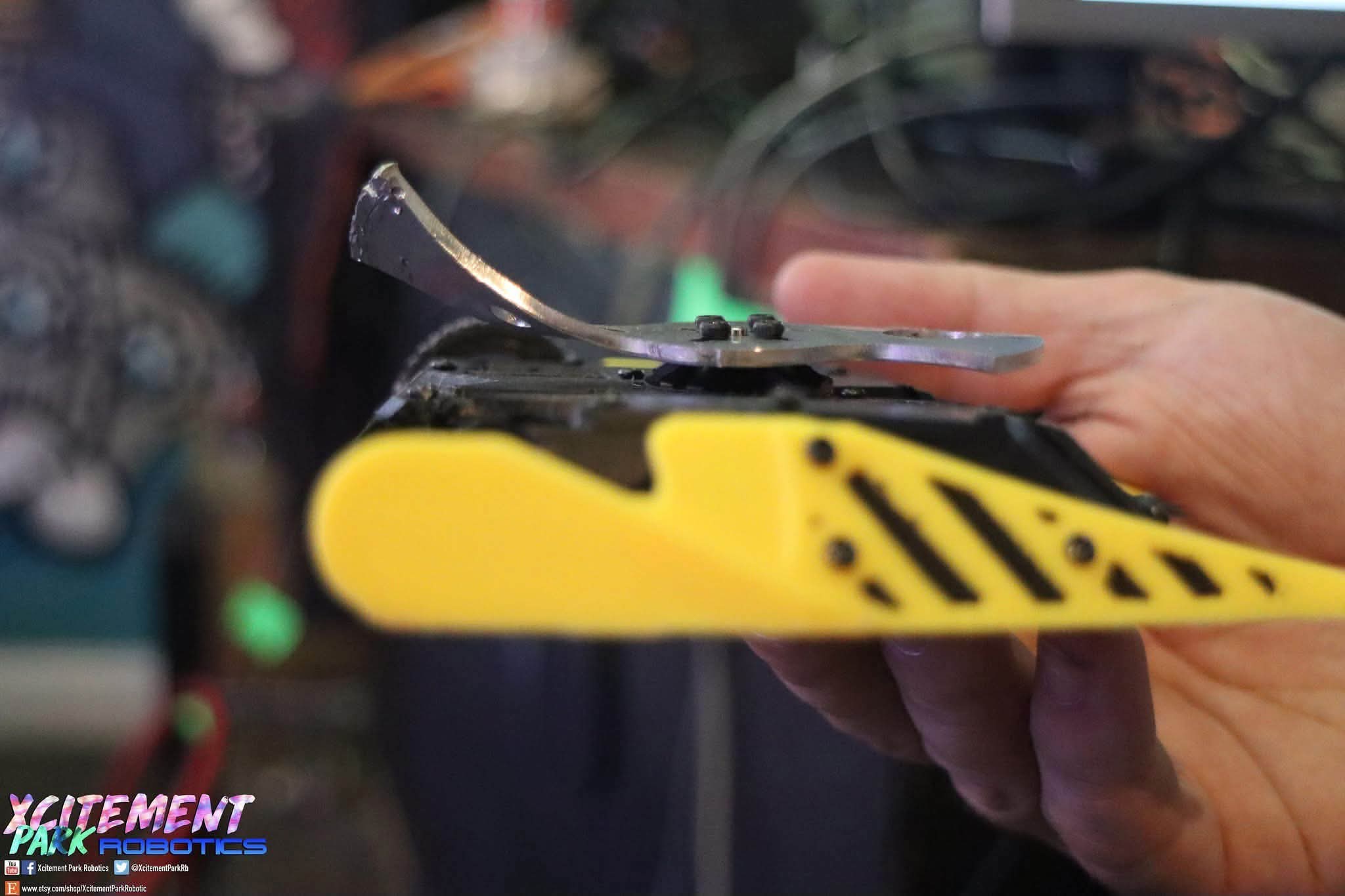

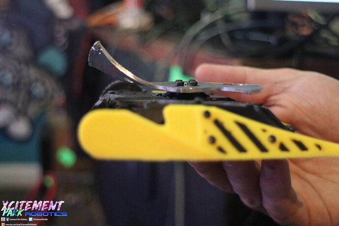

Now 1-2 and desperate to make up for lost fights, my next opponent was Buzzkill. It’s the matchup Vanquish was built for, a small vert with a tasty weapon motor, even if guarded by a brick of TPU. Strategy for me was to just spin slow for good bite and keep being aggressive, it’s hard for the opponent to counter attack if you never get off of them.
Normally has 4 wheels but this is the best pic I can find, note the 4mm thick TPU motor guard

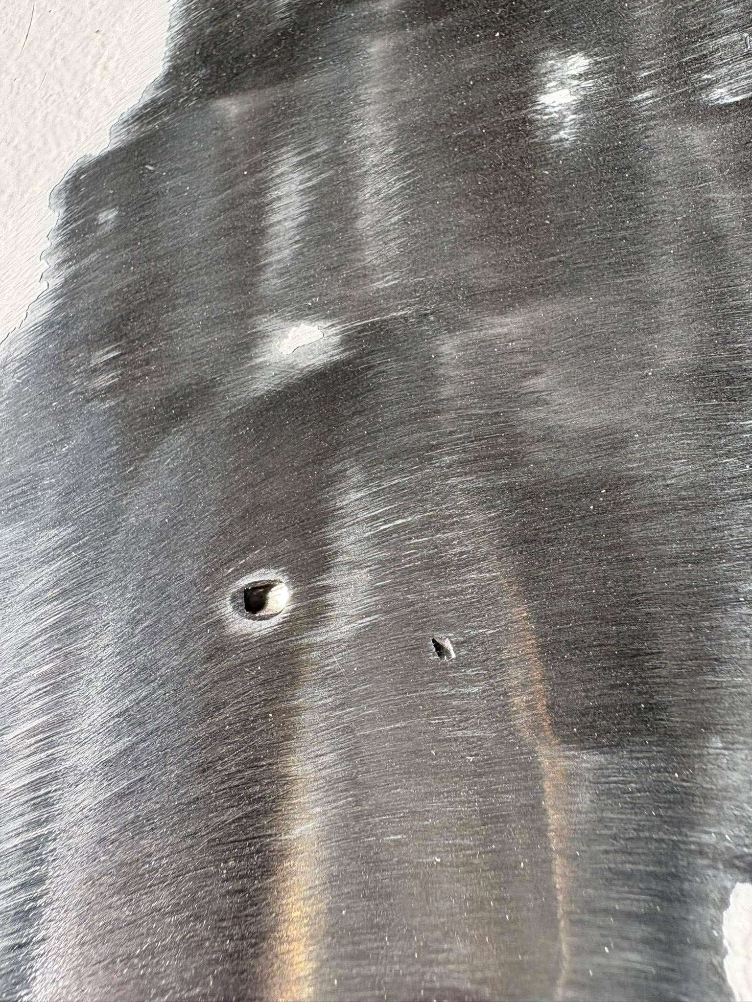

Half decent fight, first proper engagement had Vanquish punch clean through the motor guard and put a big hole in the motor, and a small followup hit bounced Buzzkill into the pit. Adam seems to have found some kind of super tire tread though, it had actually wrapped around my weapon and entangled it on that last hit, which explains why the hit was so soggy. Why it entangled and didnt split immediately I have no clue, it was still usable once i had got it out of the weapon.

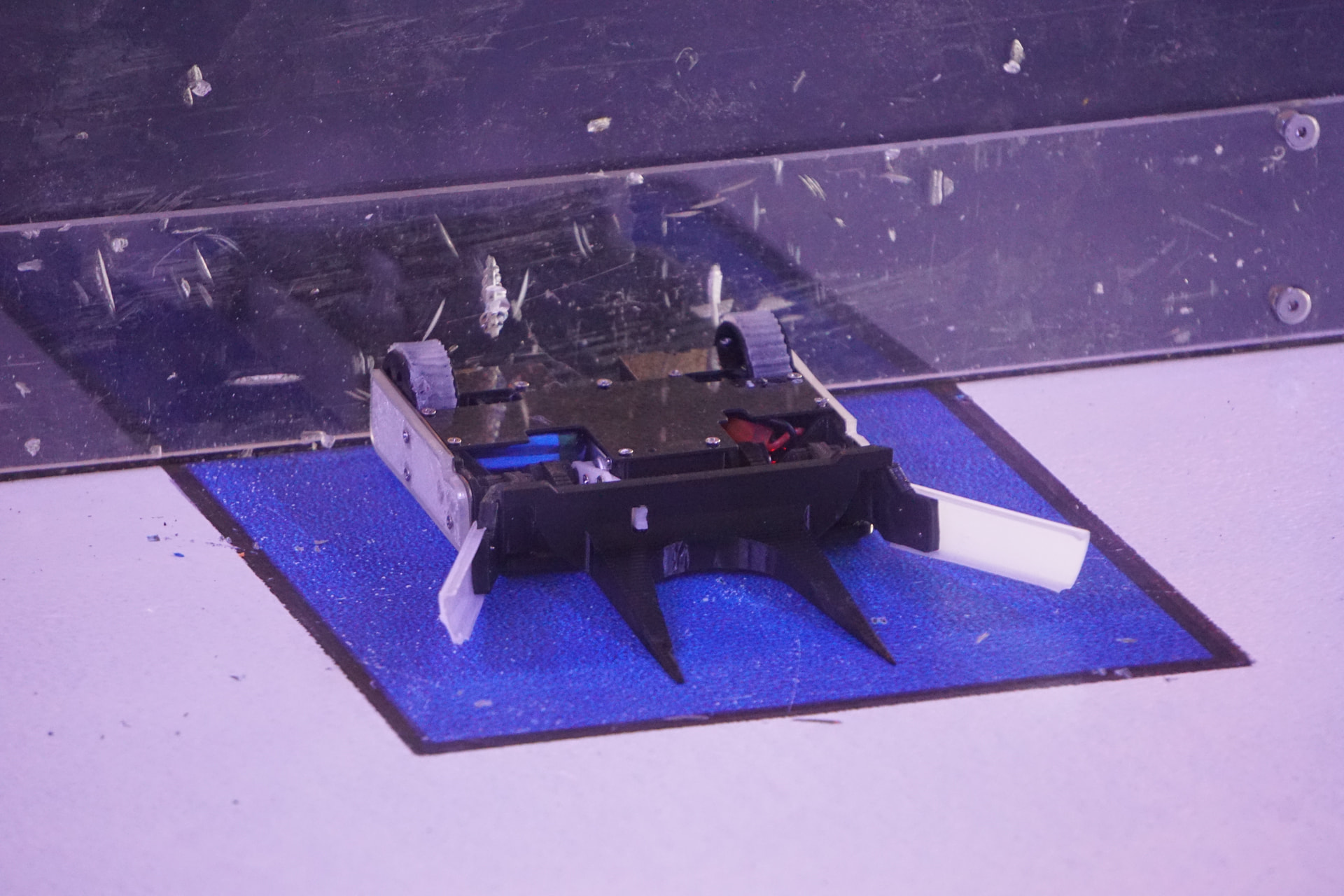

Top 8

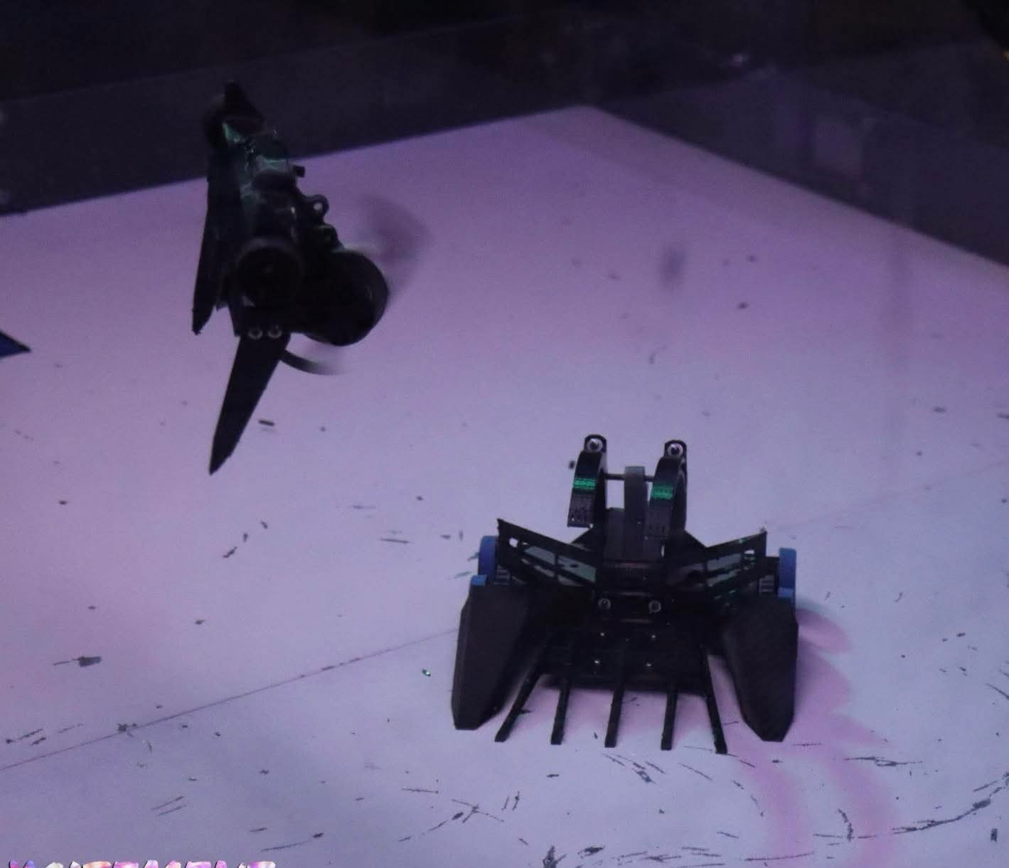

In my way to the semi finals was Bolt. A great matchup for me on paper, low profile drum vs a reach vert. Problematicaly adam is known for this love of fork configurations, and he delivered with some heinous tendrils on the front of Bolt for this fight. Unfortunately the fight wasnt recorded but I’ll do my best to describe it.
Basically I didnt get a single hit off, and just sat on his forks until he drove us both into the pit. It was exactly his gameplan and it worked, upsetting but as long as there are pushout zones there will be bots that take advantage of it and it’s completely within the rules at the end of the day.

Anyways yeah that’s the end of ORCS 13 for Vanquish, ORCS 14 is in a month or so and I dont intend to miss it,so I’ll see you lot there. Vanquish has got a new disk for this event too, ridding of the old worn one. Should cleave through TPU as well as the floor and get excellent bite

Got the blade at 3mm thick now, so i’m hoping it’ll be a lot harder to bend, we will find out for sure at ORCS though hahaha.
