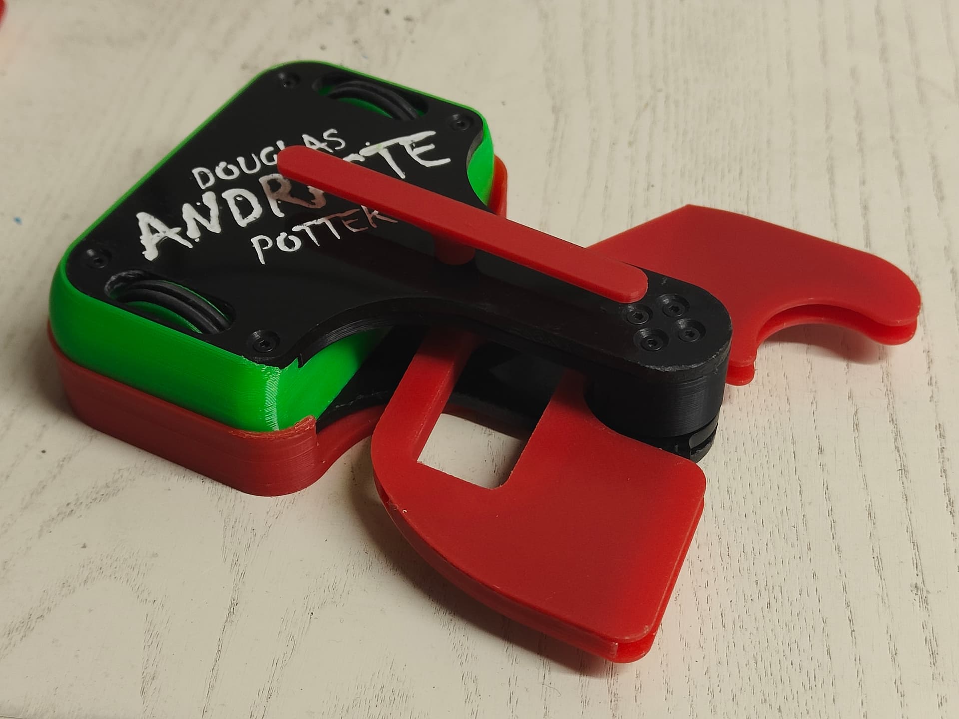

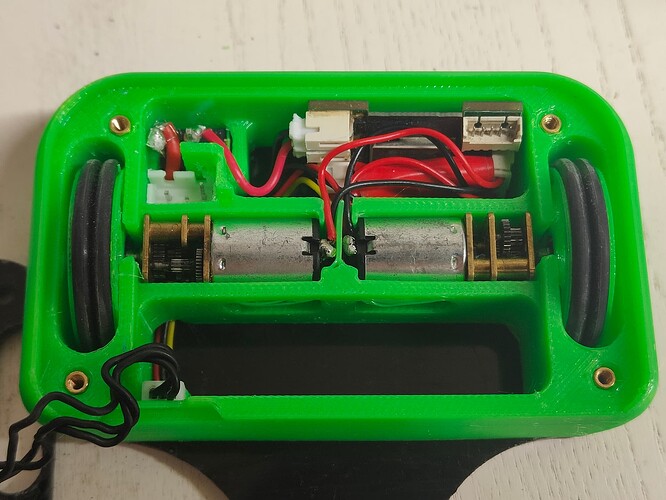

Hi all, this is Andraste which is my first antweight build designed to compete in the Bristol Plastic Ants 2v2. I would greatly appreciate some feedback from those more experienced as to how well this may or may not work, and if i missed anything in the rules before i take it to comp.

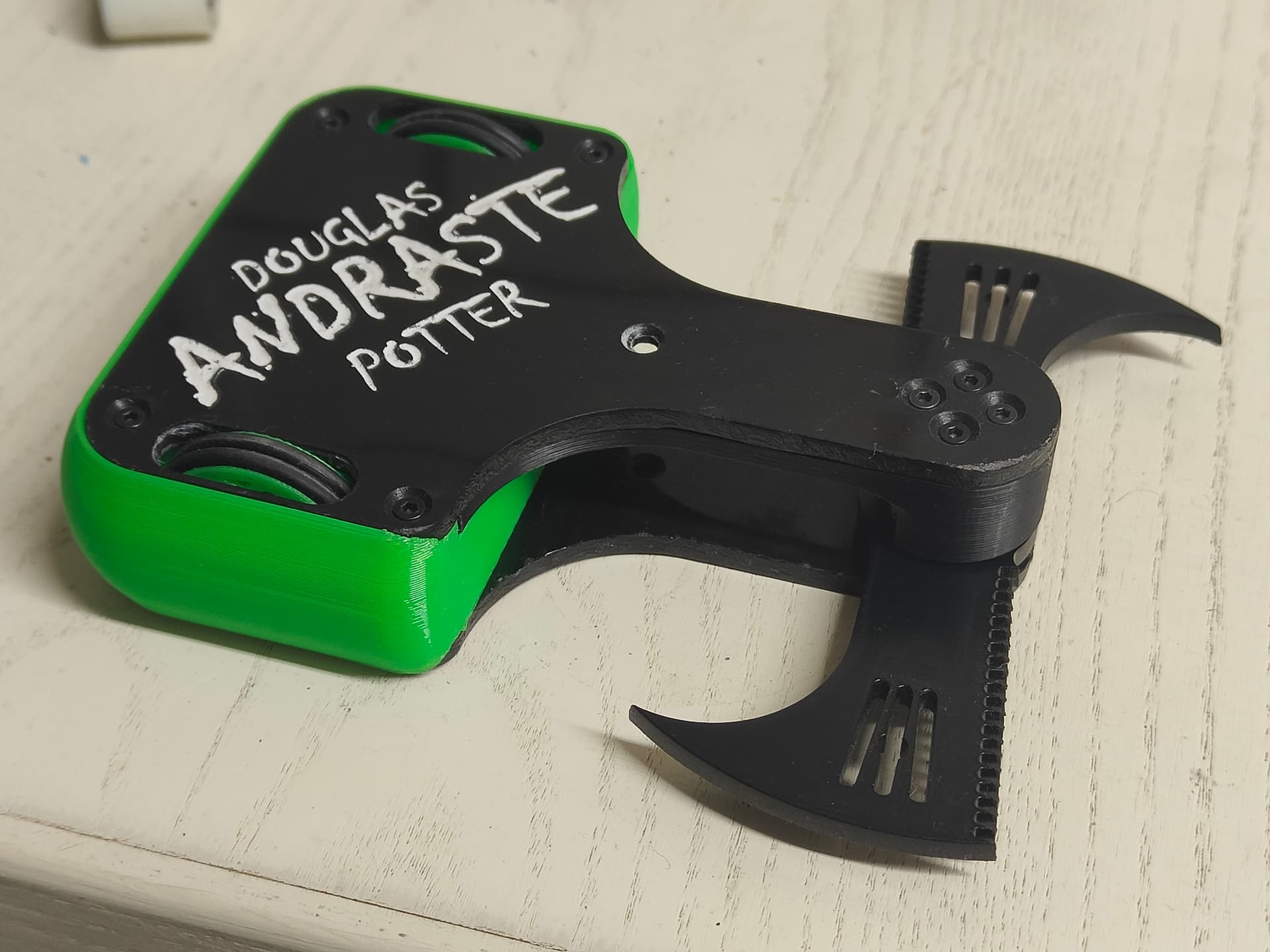

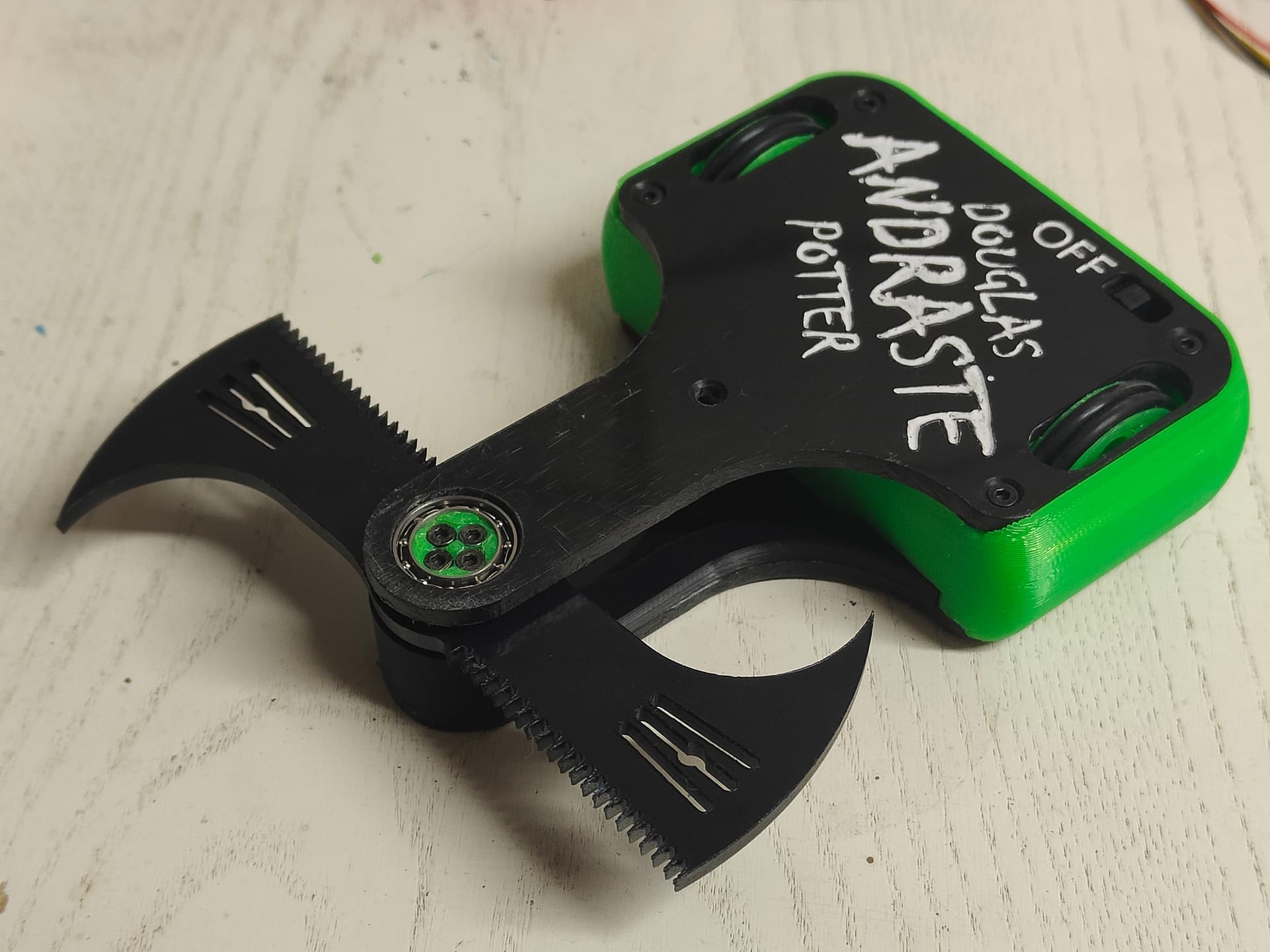

Mechanics: The total robot comes in at 148g with a fresh unblunted spinner. I’m using green 3D printed TPU armour for the sides and laser cut POM for the top and bottom armour plates. Wheels are again TPU 3D printed with O rings for grip. The spinner is 3mm laser cut ABS with a symmetrical design for simplicity. The spinner is directly mounted to a brushless motor which i know might destroy the motor pretty quickly, but for simplicity on my first build, it’s easier than messing with belts.

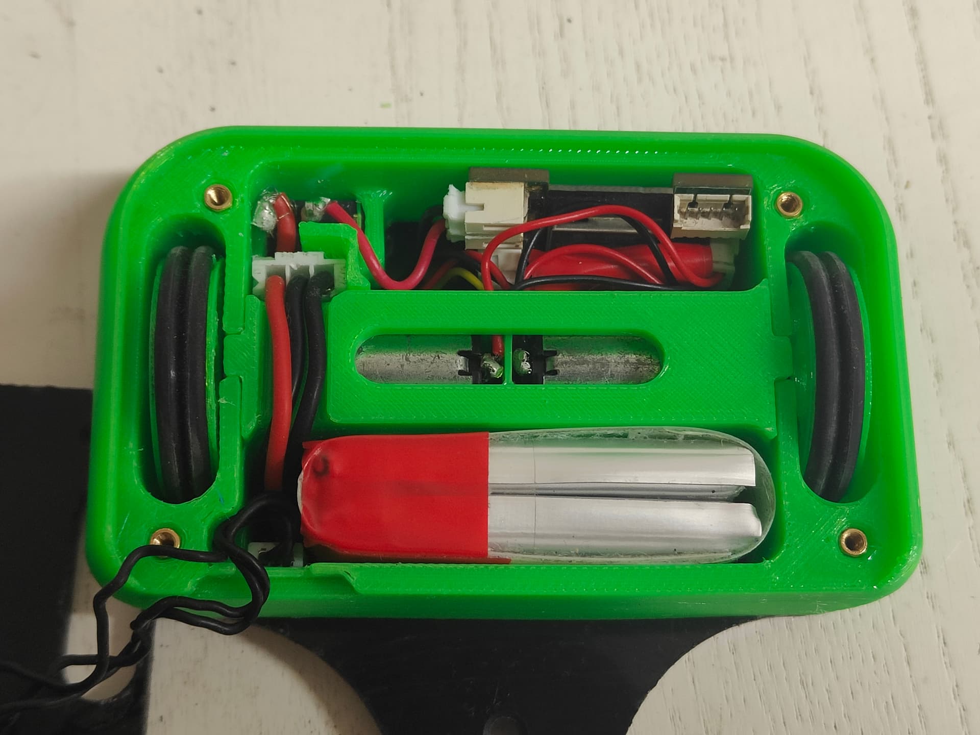

Electronics: The robot is running on a 2s lipo (i know this one is very puffed, it’s just my test one). Simple on off marked switch and then into a custom control PCB. The drive motors are 500rpm 6V N20 gear motors which seem to give decent speed and controlability. The spinner motor is a 2750kV 1404 drone motor, giving me a theoretical tip speed of almost 275mph, although in practice it makes the drive fairly uncontrollable at anything past 200mph. I’m then using a stadia gamepad controller to operate the robot in a near identical way to “Kurbstop” our University of Surrey beetleweight that we entered in February.

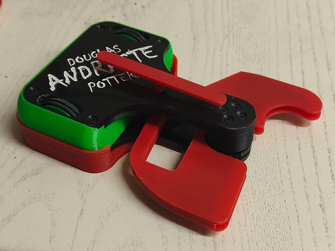

Safety: 3D printed cradle with a “shield” that covers the whole spinner and then a pin that locks through the top armour, shield, bottom armour and then screws into the cradle. The pin can also be inserted just through the hole in the spinner and armour to lock it. The on off switch has the off position laser engraved into the bottom armour next to the switch.
Thanks for reading and i hope someone can give me some feedback, good or bad, on my first bot.

Hi Douglas, this looks great! I think your internals look as neat as any antweight I’ve ever seen, never mind for a first build and the cradle/weapon lock is very nicely done indeed.
I have no idea how the weapon will work but it looks very classy, which is 90% of the job done (in my opinion anyway).
Best of luck at Plants!
Not bad for a first build, I can say. If you aren’t planning to upgrade to the full combat ants sometime than I would say the tip armor is a tad overkill, but you don’t have have to listen to me. Overall though, nice build!
Do you mean the sharp edge protection? Always better to be safe than sorry

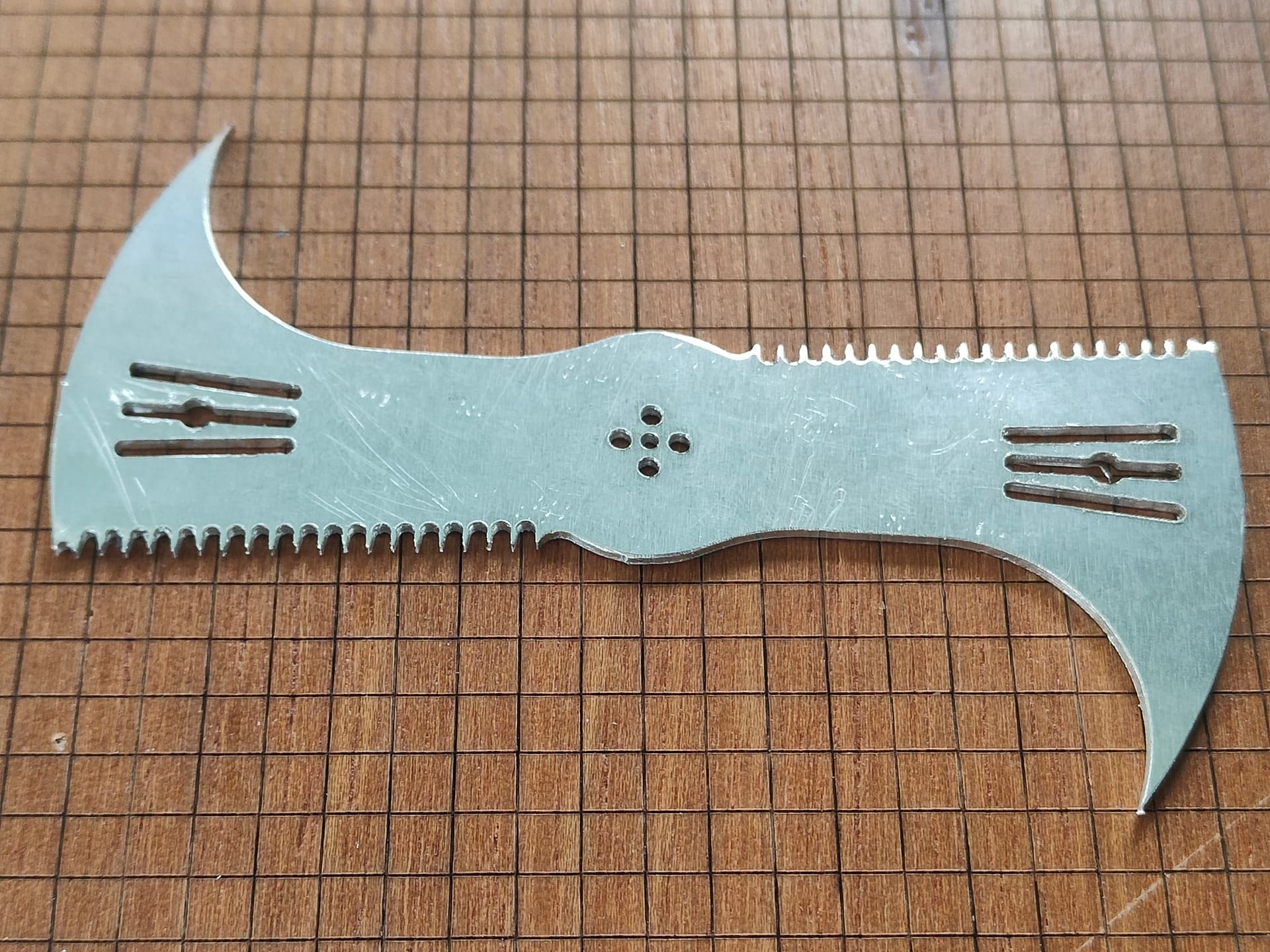

Thanks. Yeah I’m hoping this design should be fairly easy to convert to full combat in the future by just swapping the 3mm ABS spinner for a thinner metal spinner to keep the weight the same.

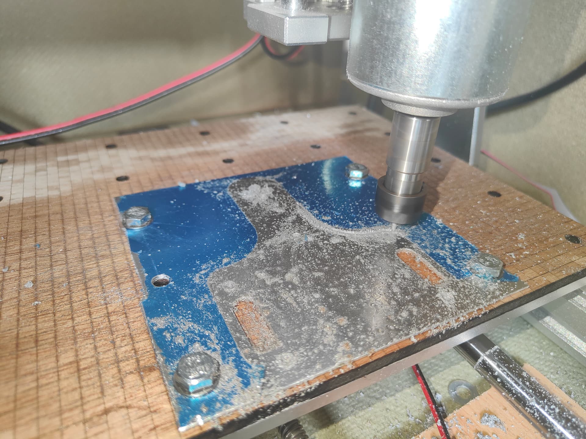

Have been machining some concept aluminium parts over the weekend for a future full combat build. Conviniently aluminium is about 2X the density of Delrin so I just halved the thickness of the spinner and top and bottom plates.
Thats such a cool looking bot you’ve made! I love the combo of the smooth curves on the chassis and the spikey weapon.
A warning, though: A 1.5mm aluminium bar won’t hold up well in full combat. It’ll bend as soon as you go weapon to weapon. You’d be best off trimming some weight and running a 3mm hardox hardened steel bar. Chances are some of the uni beetle teams will be getting hardox cut for next Feb if you ask in the Discord.
