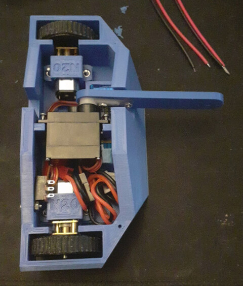

After that massive failure I began work on a new ant which was a four bar lifter. As I was not intending on competing I did not focus massively on weight, which is lucky as the robot was 148g without a top plate, and remains without one to this day. This was, however, my first working robot, and it finally felt rewarding to see something work as intended after wanting to make these for years.

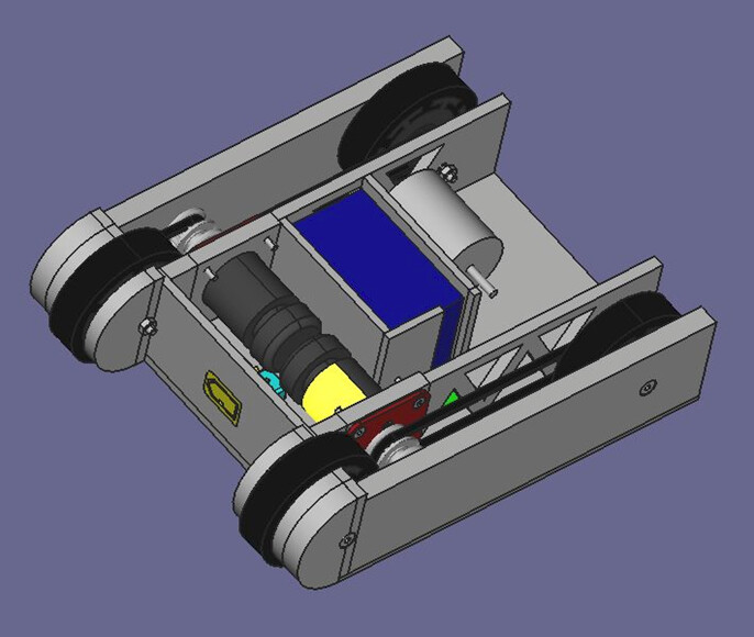

My second attempt at designing the robot was much more successful as I now had an idea of what I wanted to make and was much more knowledgeable at CAD. This version reached completion in CAD and was much closer to the robot that I wanted to make, however looking back on it there were still many problems with it. This included there being a grand total of 0 space for electronics, as I completely forgot that wires do exist, and also that I did not know about TPU at this point, meaning the entire robot was going to be printed from PETG. The robot still had custom moulded wheels and had the back wheels mounted directly to the drive motors with the front wheels driven by a belt. The height of the robot was still constrained by the mounting plates that I was using for the drive motors, which didn’t give me nearly as much freedom as I wanted, however this version did finally look like an actual robot.

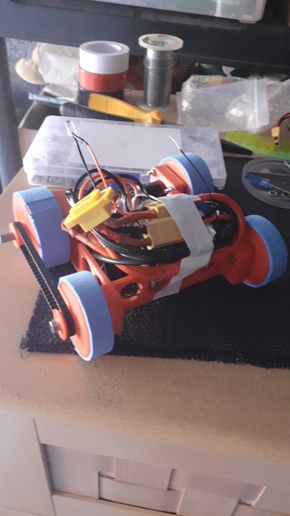

After making this I built a test platform to test the drive and it was at that point that I realised just how much space wires take up. This led me to realise that the amount of space in the current version of the robot would be nowhere near enough, and that I would need to change a lot in order to fit everything into it.
After this discovery the robot was updated once more to include much more space internally. This resulted in a very weird drive configuration where the back wheels were driven by gears from the motor, while the front wheels were driven by the belts. This was a result of not knowing that you can purchase pulleys and belts from places other than fingertech, and not wanting to spend £40-50 on shipping for a few belts. I signed the new version up to the BBB new bots event in August of 2023 under the name Dave, however a mixture of inexperience and lack of knowledge resulted in me having to drop out of the event as there were a few “minor” problems with the robot, those being: Not enough space, not having any parts made, and my proof of mobility being… unideal… to say the least.
Not only could the robot barely drive in a straight line, the wheel falling off was the final straw and I decided that there was no way that I was going to be able to get to the event. That paired with the entire robot being made from PLA and if I was to attend it would not end well for me. This was a wakeup call for me to finally start creating an actual good robot, and doing my research.

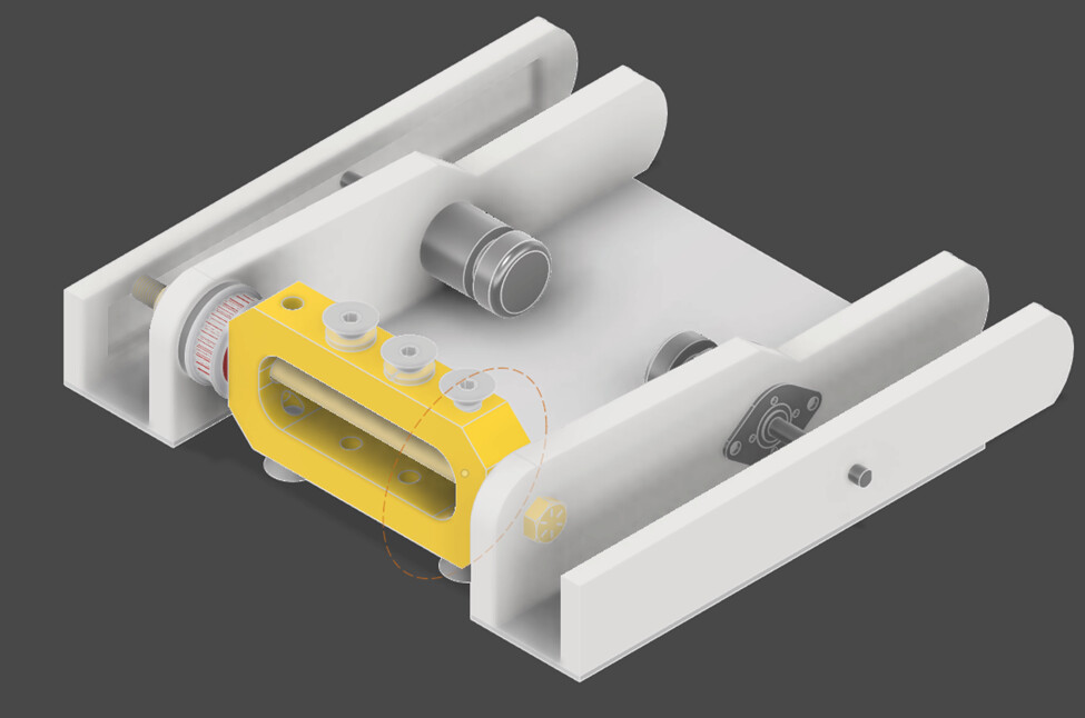

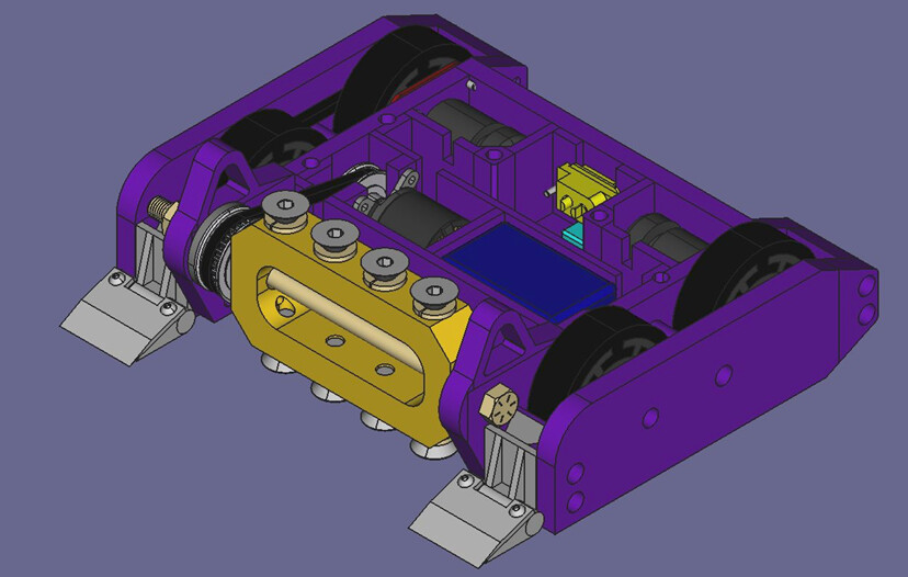

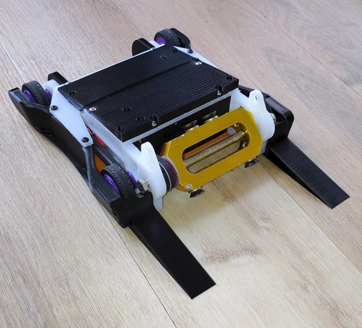

After doing some more research and completely starting over once more I slowly began to develop the first version of Antimatter that would finally see use in an arena. This version of the robot was still very much inspired by lynx, however that was primarily in terms of shape, this was mainly to do with cost as I was still in school at this point and had no real form of income, and just 1 repeat pro motor was a tough pill to swallow, so I didn’t want to shell out more on armour. Initially this version was going to have carbon fiber base / top plates, UHMW side rails, and a titanium top plate above the battery / weapon motor, however this was way too expensive and so that was very quickly changed. I did, however, still 3D print this version as I was itching to have something that I could hold after not having anything overly interesting and having the weapon in a drawer for well over a year at this point.
The first version of Ant1matter was completed very hurriedly in July of 2024 as I wanted to show a couple of my teachers before leaving for summer break, and the first drive test of the robot was completed and I was happy that I was finally getting somewhere with it.
While showing the robot to some of my friends I noticed that one drive side seemed to be being temperamental and I had no idea what was causing this. After doing some digging it turned out that one of the phase wires had snapped on the drive motor incredibly close to the can and once that had been resoldered upon testing again the motor was now once again working. Well, that was after I had created an entire help thread on the forums because I had plugged my receiver plugs in upside down and didn’t notice…
After around a month of procrastinating and small changes here and there I finally drilled out the centre of the pulley I had to be large enough to fit it onto the motor shaft, however this was drilled by hand and as such it was not entirely straight, however it did work and in August I was finally able to do the first weapon test. The tip speed for this version of the robot was around 200mph, and at the time I was absolutely terrified of it. I will also take this moment to say about the importance of test boxes, and how spinning weapons should always be tested inside of them - what I do is incredibly bad practice and should not be replicated.
After testing the weapon in my back garden I printed the remaining parts of the robot and went down to the local skate park with the robot and the old PLA chassis of Dave to finally put that horrendous thing to bed. While slightly underwhelming I was still proud of what I had created and I felt that I was finally worthy of saying that I had built a combat robot.
A month later nothing had really happened, however my 18th birthday was rapidly approaching so as a birthday present I was given tickets to go to extreme robots and go backstage, so naturally I took antimatter. I used this opportunity to fanboy slightly, and this was my first opportunity to talk to other builders, along with getting my robot signed by many competitors from Robot Wars too.

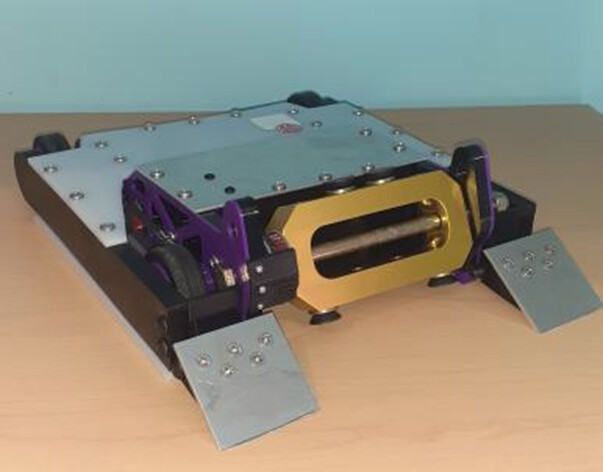

But anyway, back to the build. Over the next few months I slowly began to print parts and some magnets were also purchased. I also bought some UHMW sheet to make the inner side rails, along with some carbon fiber to cut the baseplate from, as I was told I could use the router at school for them. Unfortunately this was not the case and the sheet of carbon fiber I purchased is still missing to this day. I was also provided the opportunity to give the UHMW to someone who works in machining and for the price of a couple of packs of shortbread he would machine me some siderails. With the carbon fiber no longer being an option as I have no way to cut it I switched to UHMW as it was not too heavy and was hopefully going to be rigid enough. At this point the new rules for BBB were released and finally switches were allowed. I quickly ordered some Just ‘Cuz PD boards to use and picked them up while I was in America, along with ordering a couple of fingertech switches from BBB. Upon returning from my holiday I soldered up the switches to the PD board (one of which was upside down and I am yet to find a way to fix it) and made my new base plates / top plates with help from some people at school. I signed up to the BBB Beetle Brawl in February of 2025 with the knowledge that I would finally have a robot that would actually work and not fall apart this time. I was just waiting on the side rails.
While testing the robot in my kitchen 2 weeks before the event the worst thing possible happened with one of the drive speed controllers suddenly catching on fire. This panicked me as I no longer felt comfortable using the BBB 25A speed controllers with the Repeat Max drive motors. It turned out that this fire had also caused further damage to the drive motor that I had already had to fix on the same wire, this time with it snapping underneath the can of the motor. This was resoldered and help in place with hot glue, however I did not want to use them in a fight so I quickly bought 2 repeat max v2 and 3 repeat 35A drive ESCs. With the new motors and AM32 ESCs the robot drove even better, however I still did not have any updates on my side rails. It was at this point that I decided I would need to print custom side rails from TPU with PETG to reinforce it (I am still not entirely sure what the reasoning for this decision was, however it is what I went with). And with those made it was off to Bristol for my first competition.

Punctual as ever I finished the robot after waking up at around 5AM and had left at 6 to make it on time, but after ~3 years I had finally made it to an event. I arrived, got set up, and passed safety easily.
My first fight was against Sir Lance-A-Frog and Strongerhold. This fight went the full 2 minutes, however I got beached on the edge of the pit and was counted out with around 10 seconds to go in the fight. I did manage to cause a bit of damage to both of my opponents and was gifted Sir Lance-A-Frogs lance at the end of the event. While I lost the fight I was not too disappointed as I had seen glimmers of potential in the robot, especially with one shot punting the frog halfway across the arena.

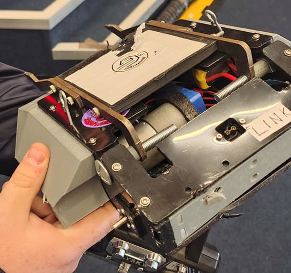

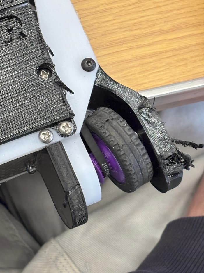

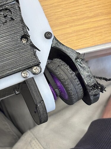

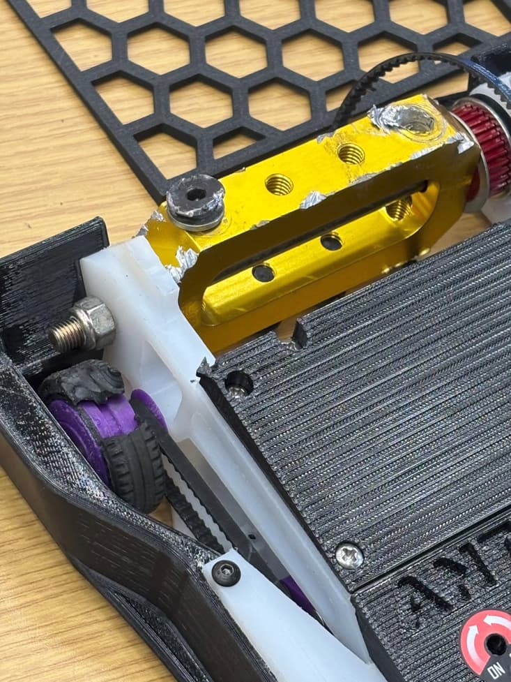

My second fight, however, was much less successful. It was against Wheely-Big-Lad and while the first couple of engagements seemed to go my way, he soon got a good hit on my top plate which snapped my weapon motor mount in half (as it was only printed PETG) and then another hit that destroyed half of my drivetrain, leaving me completely unable to move. As I do not have too much top armour above my important electronics I decided to tap rather than risk losing a lot of stuff.
My final fight was a whiteboard against Chucky, Everest, and Wheely-Big-Lad. In this fight I got a few decent hits on most people, however the setscrew for the weapon pulley soon shook loose, and with no weapon Chucky took the opportunity to make me do the thing. Other than the loose pulley there was no damage taken, so it was simply a case of taking the battery out and sticking the robot back in its box.
During the event the robot was driving nowhere near as well as I expected. I originally thought this was a result of the fuse wire being too low and not allowing enough current to the motor controllers, however upon further inspection it seems that the bolts not being countersunk combined with the magnets resulted in the robot being high-centered on its own bolts, just enough to impair the drive. Please enjoy this sleep deprived damage report I sent to my friend after the event.
I also discovered after the first fight that the batteries I was using were not able to deliver enough current and as a result of that one of my batteries became slightly puffy.

With the lessons that I had learnt from my successes and failures at the Brawl I took around a month off, and then went back to designing a brand new robot from scratch. Well not quite scratch, the siderails had finally been delivered, so it was designed around knowing I had those, along with the electronics. With this version my main goal was to fix the drive issues that I was having, so I recessed the magnets into the base plate, and switched to countersunk bolts. I also upgraded to a 4s 650mah LiHV battery with a much higher C rating so that I would no longer be at risk of damaging my battery from just using the robot. As I already had so many things sorted out for me the design of Ant2matter went much faster than its predecessor, and after around 2 months of work I had a full PLA chassis to finally test with. I grabbed a friend, threw some spare electronics in a copy of Antimatter, and put together a dummy chassis to test the weapon on. We had a few pushing matches with the two robots, and then tested the weapon. Luckily for this version I actually decided to document much more of the process and make it into a nice little video.

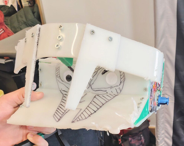

My next fight was against an undercutter called Angel Slice who was next to me in the pits. Angel Slice had been having weapon problems all day so I was not too worried, however this would be the first time I had fought a truly destructive robot, so no better way to test my anti-horizontal setup. Turns out it doesn’t help when you fail your box rush and then get flipped over, that paired with Angel Slice’s weapon working fully again and suddenly I have no more bunny ears, my weapon is hitting the floor and I am slowly being destroyed. I ended up having one of the teeth ripped from my weapon, another tooth partially ripped out and the hole being oval shaped. I also had one of the shoulder bolts for my weapon bent to a 45 degree angle, and another tire was partially destroyed. The solder joints for my weapon ESC also snapped, stopping my weapon from spinning and the bolts holding the weapon motor into its mount started vibrating loose and were rubbing on the weapon pulley. I luckily stopped trying to spin my weapon before the motor smoked.
While I may have lost this fight I can not complain as if I am going to lose, I want to get completely destroyed, and I still got my first win.

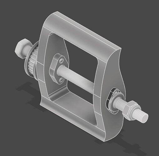

With an extra couple of years of CAD experience under my belt I have decided it is finally time to make a custom weapon. This new weapon is around 300g, and will have a tip speed of 250mph. It is also larger in diameter than the fingertech one, meaning I can run it at a lower RPM while still hitting the higher tip speeds. In order to account for the new batteries being 6S LiHV the weapon motor has been shrunk from an 1800kv motor down to a 1120kv motor. Larger wheels are also being used in an attempt to somewhat simplify the bot, and the drive speed has been upgraded from around 6mph to around 10.5mph. This will hopefully help me get good engagement more consistently. Along with this the magnets have been upgraded from 10x2mm to 20x3mm, giving me much more downforce to hopefully counteract the gyro of the new weapon.

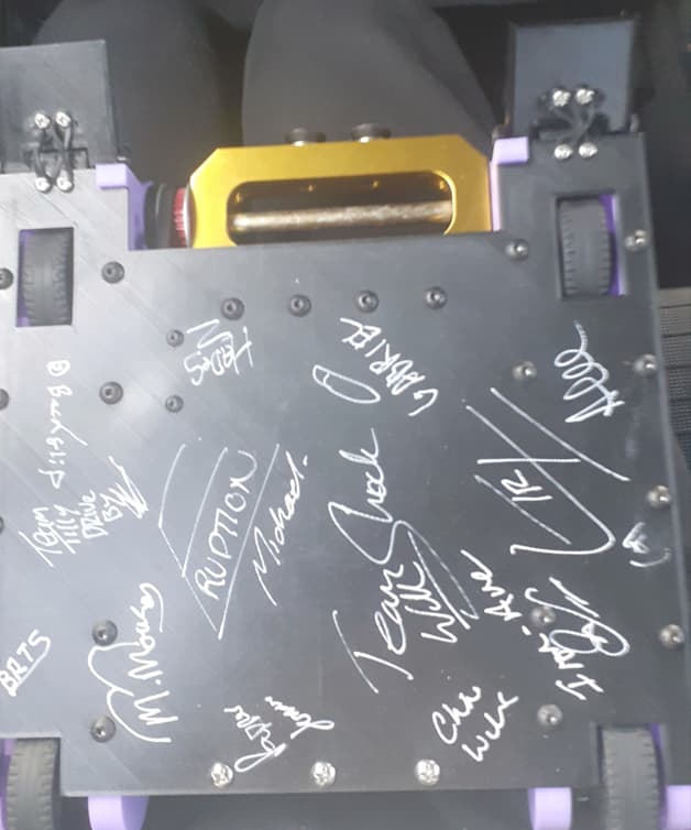

That wasn’t in Colchester was it? Because I’m fairly sure I recognise that floor pattern from when I went backstage to meet some of the roboteers. Didn’t think to ask for any of their autographs though… ah well.
Loved the fight against DOOMBot and Gunfinger. Seeing them fly across the arena was awesome.
It was at Colchester yes. I am so glad I thought of it, although I had to go out the night before to buy a paint pen that would write on the printed base plate.

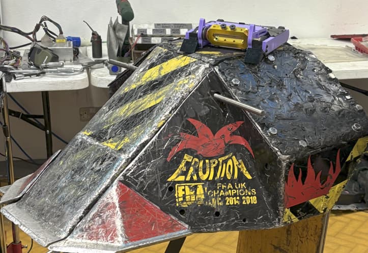

Well it has been a while. Will update this properly covering Brawl 2026 when I get an actual chance. Just wanted to add this as I think the people here will find it cool.
With AntIImatters performance over the last couple of events and finally having a robot with a positive win loss ratio I was incredibly proud of what it had achieved and wanted to immortalise it in a unique way. As a result I ended up getting a tattoo of it on my shoulder.
