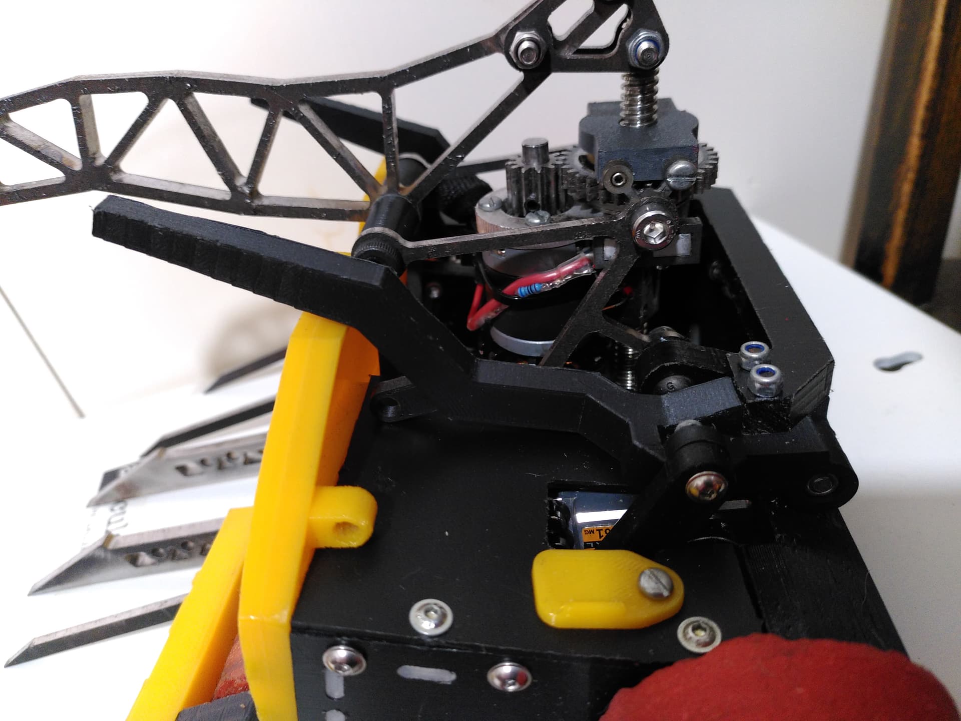

I built AntiThesis version 1 with Matt Crees, so it was a bit of a fusion of our very different building styles. The crusher was my CAD, overanalyse, reCAD, prototype, rereCAD, get machined; while the rest of the bot was his preferred hand cut HDPE.
This is the only nice photo I have of AntiThesis V1, and I don’t have it to hand to take more. This post will be low in pictures, sorry
This ran the standard BBB brushed drive kit, but with double thickness foam wheels. It used two 300mAh 2s ant batteries in series, which gave it just about enough battery life to make it through a fight. We had to have two chargers running constantly to get it charged up between fights though.
The crusher mechanism was shamelessly copied from inspired by Unconscious 514. It had a pair of 3mm hardox frames with forks built in, and a 3mm hardox claw driven by a custom made linear actuator.
The linac, minus the hole drilled through the leadscrew. The screw with the hole is currently in V3
The linac used a lead screw with a steel gear grub screwed onto the nut. This was driven by a 30:1 37mm gearmotor mounted to a hardox panel. A pair of aluminium side panels gave the linac gearbox structure, and a place to attach to the hardox frames. The claw bolted into a hole drilled through one end of the lead screw.
Version 1’s performance wasn’t amazing. It couldn’t push anything, couldn’t self right, and a very high centre of mass made it prone to popping wheelies. It managed to do alright at Showdown though, simply because most of our opponents had bots that were just as unreliable.
The main success from V1 was the crusher. The first sign that we were on to something was when it bent the 6mm steel screwdriver that we used for the locking bar. It punctured a couple of top plates during the comp, but hit empty space rather than any internals. The only issue that came up was a tendency for the 3mm claw to flex during crushes. (It would definitely have bent horribly if it was hit too)

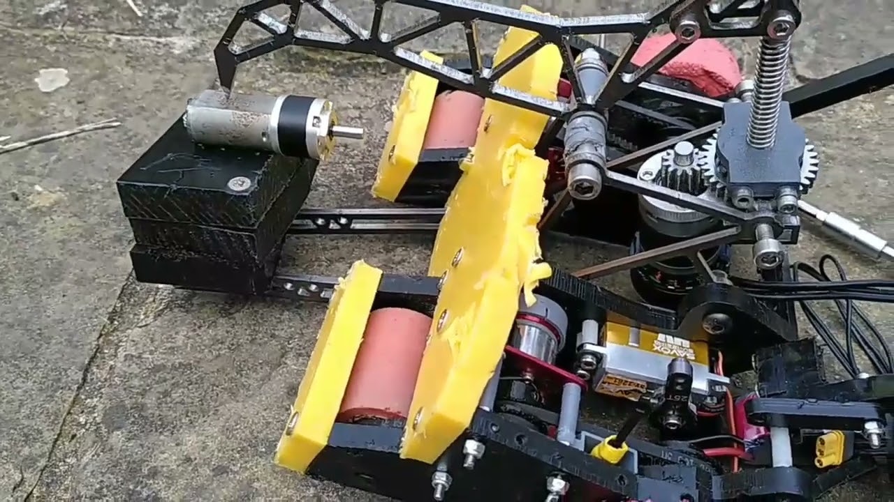

Instead I went for a dedicated self righter driven by a servo. I was uncomfortably tight on weight and space, so a standard size servo wouldn’t fit. I couldn’t risk cutting down on speed and torque though. The solution was a ludicrously expensive Savox mini servo, with a four bar mechanism to cushion it in case the self righting arms were hit.
V4’s self righter (ooooohhhh spoilers!)
Its close enough, you get the idea
V2s now a sad shell thats been gutted for parts. Them servos ain’t cheap
It self rights!
This worked perfectly, but set a bad precedent for my future self. Now whenever I’m looking at some new part that will save me a tiny amount of weight, there’s a little voice at the back of my head saying “Why not? You bought a £75 servo to save 20g”

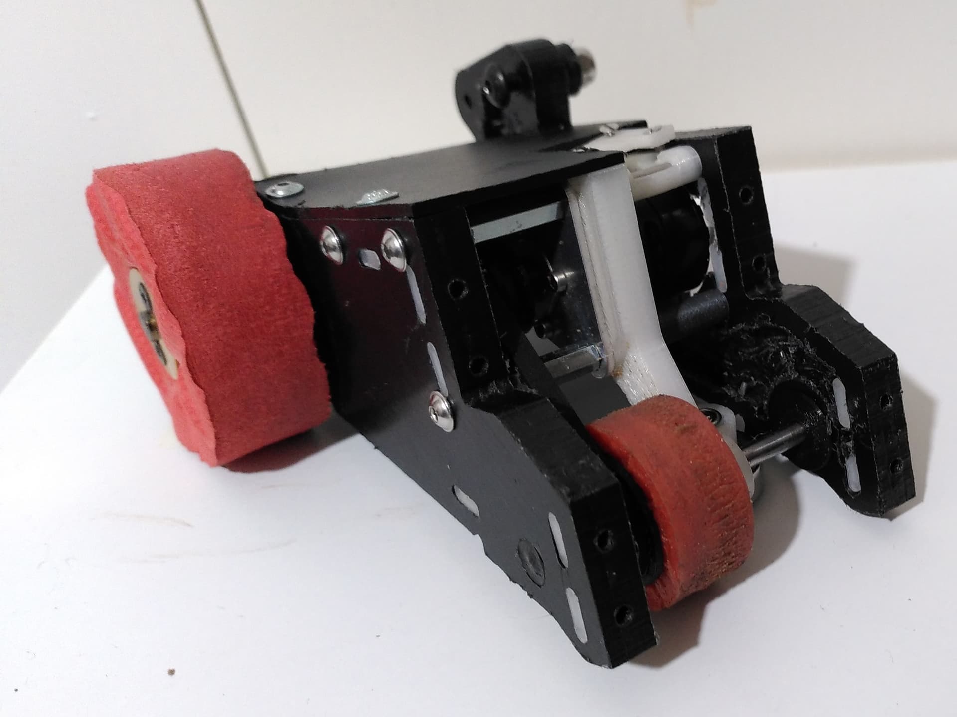

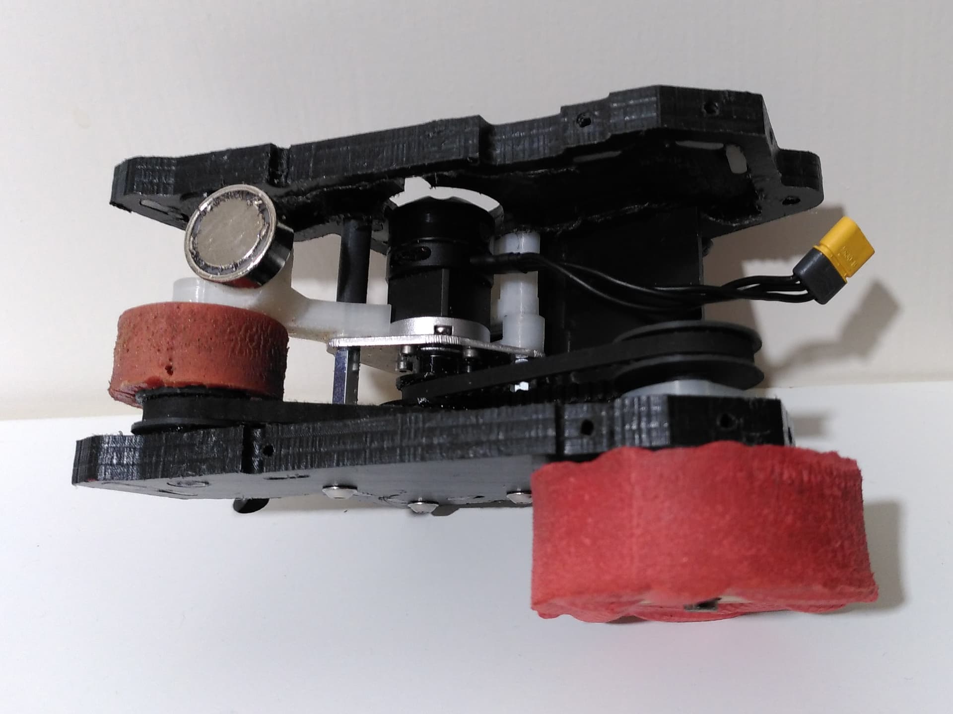

This meant belts, and making the centre of mass even worse. I raised the drive motors up, so they sat above the other electronics. A couple of timing belts and 3D printed pulleys drove the wheels.
Drive unit! Motor, wheels, belts. Everything you need to make a bot go vooom
This one is a horrible mix of bits from V2 and V3
you
get
the
idea
I designed the drive so that it all attached to the side panels, to make repairs easier. Rather than having to disassemble the whole bot in a tangled mess of belts, I could remove the side and drive train together

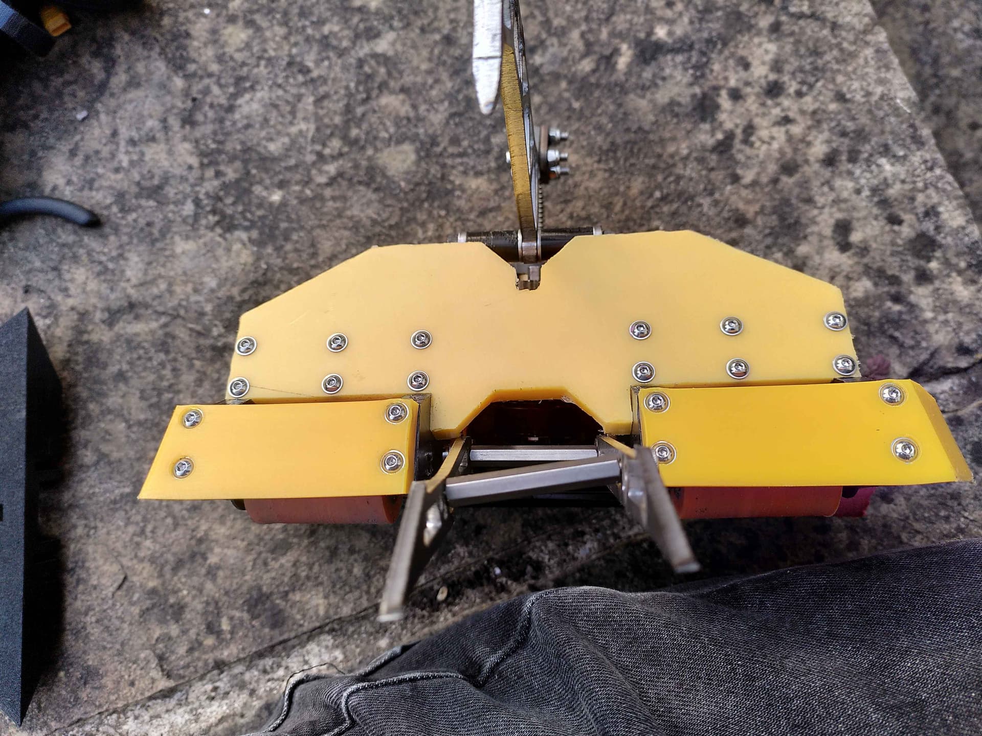

I finally fixed my drive issues with separate PETG pulleys that keyed into the TPU hubs, with a side order of chonk magnets for extra downforce. It was ready for the first MITE. It was retired afterwards
Half the back is gorn
Photo by David Harrison
MITE actually went pretty well. The drive was good enough for me to hold my own (sometimes) against some pretty tough bots. I didn’t take any expensive damage. And all the issues that cropped up were ones I was expecting and/or easy to fix. I already knew V2 was going to get retired after the event. I had too many changes I to make

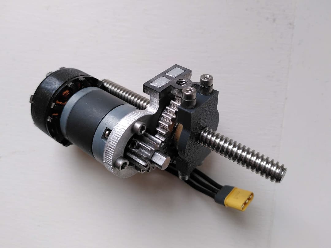

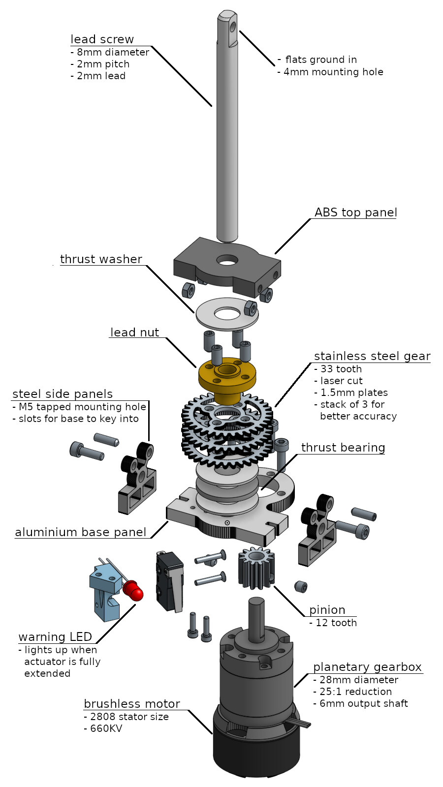

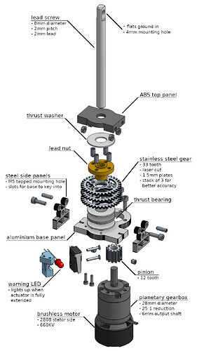

It was time. The brushed linac had given me a year and a half of faithful service. It had earned its retirement
The new one was designed to be a drop in replacement, cos the rest of the crusher mechanism was being kept. Its also more compact, and something like 60g lighter

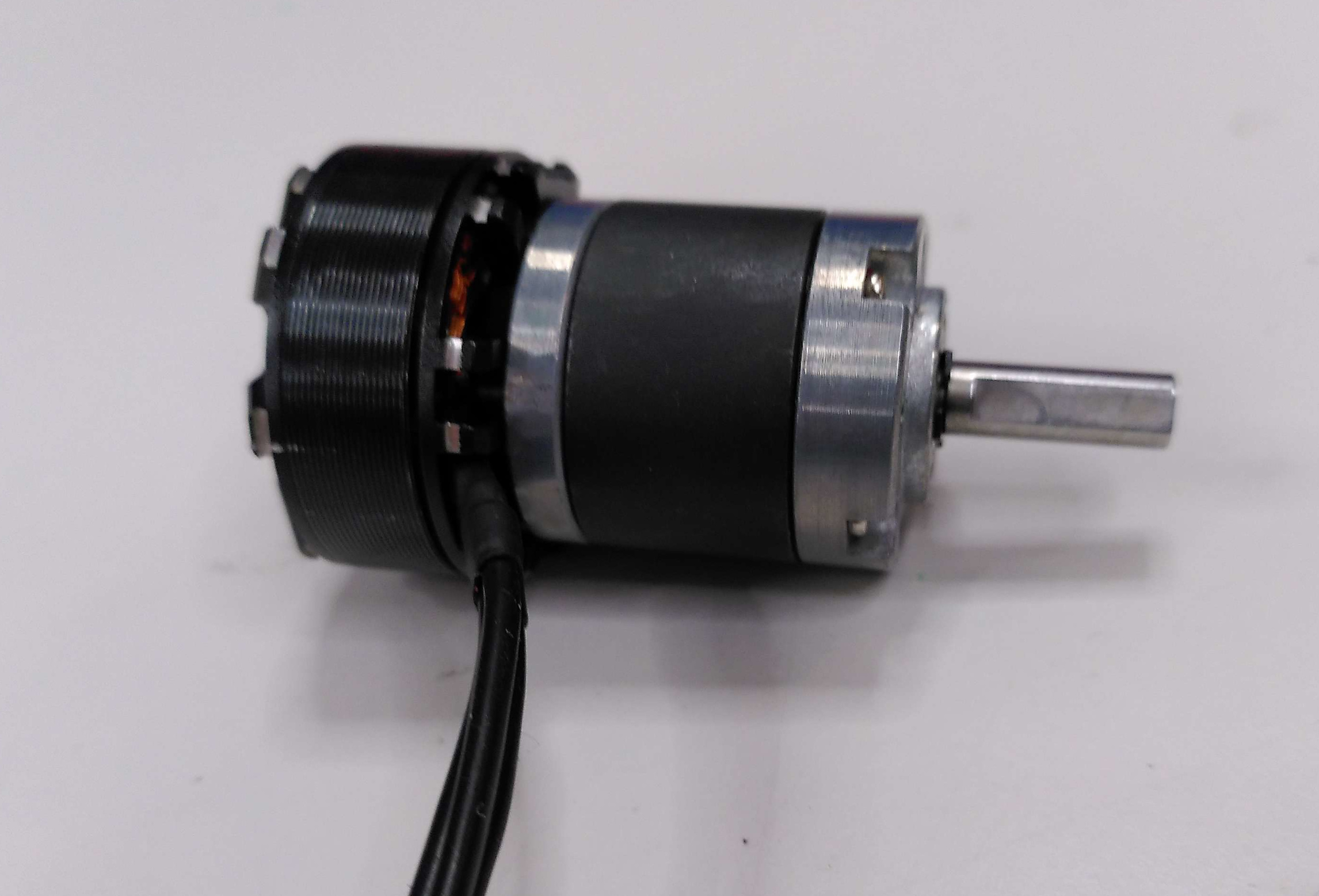

If you’re familiar with brushless motors, you might be wondering why the motor is only 660KV. A typical StrangBox (brushless motor + gearbox conversion, sized for beetle lifters/grabbers, named after the legendary Henry Strang who pioneered their use) has double the KV, and 4x the reduction. High KV and reduction is typically how you get maximum beans
Backwards compatibility is the reason. More reduction means longer gearbox, and it had to fit in the same space as the comparatively short 37D brushed motor. By using a lower KV motor I got a similar effect to adding more reduction, without taking up more space. It just makes it less efficient
My beautiful brushless gearmotor child
The assembled linac! (before the mounting hole was drilled through the screw)

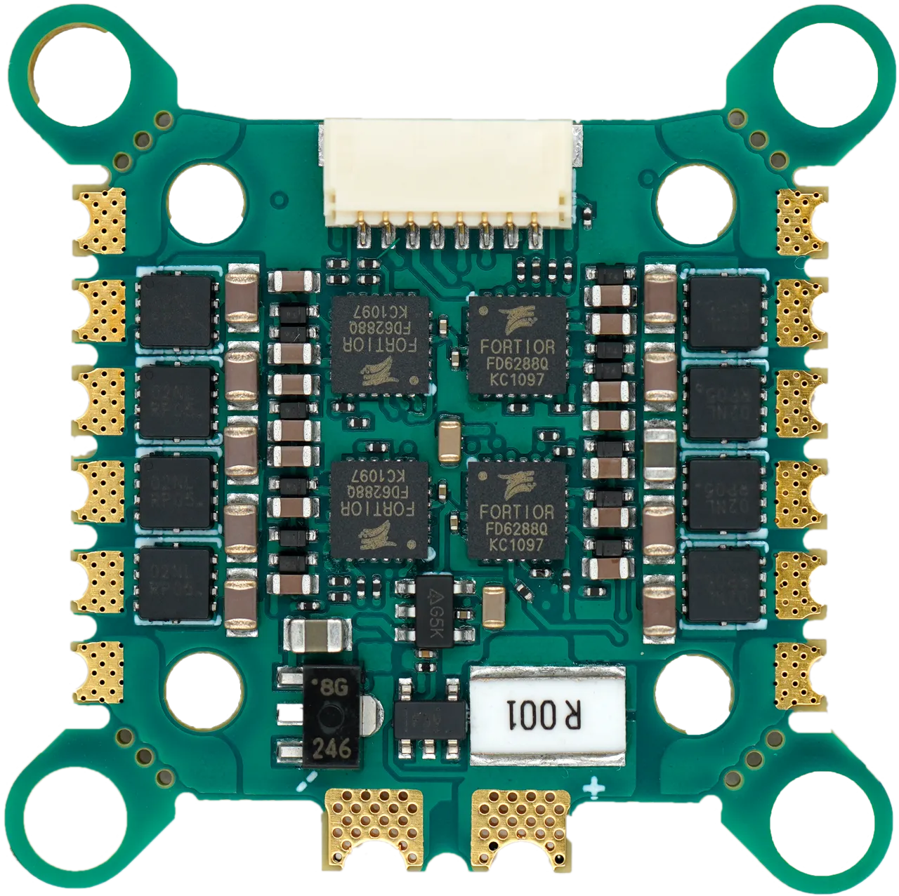

The final thing to get the linac working was an AM32 ESC. The torque that a brushless motor can deliver is very dependent on the ESC. AM32 is designed to work for RC cars, so can deliver a fair amount of torque at low speeds. If I had used the more common blheli ESCs, which are designed for aircraft only, then there would be a real risk of the ESC giving up as the crusher bites down
I went for a NeutronRC AM32 4in1 for the ESC. This gave me weapon and drive ESCs in a single compact package. It also helped with the twitchy drive from v2 - the twitchiness was partly the old blheli ESCs refusing to move at low speeds
the ESC in question

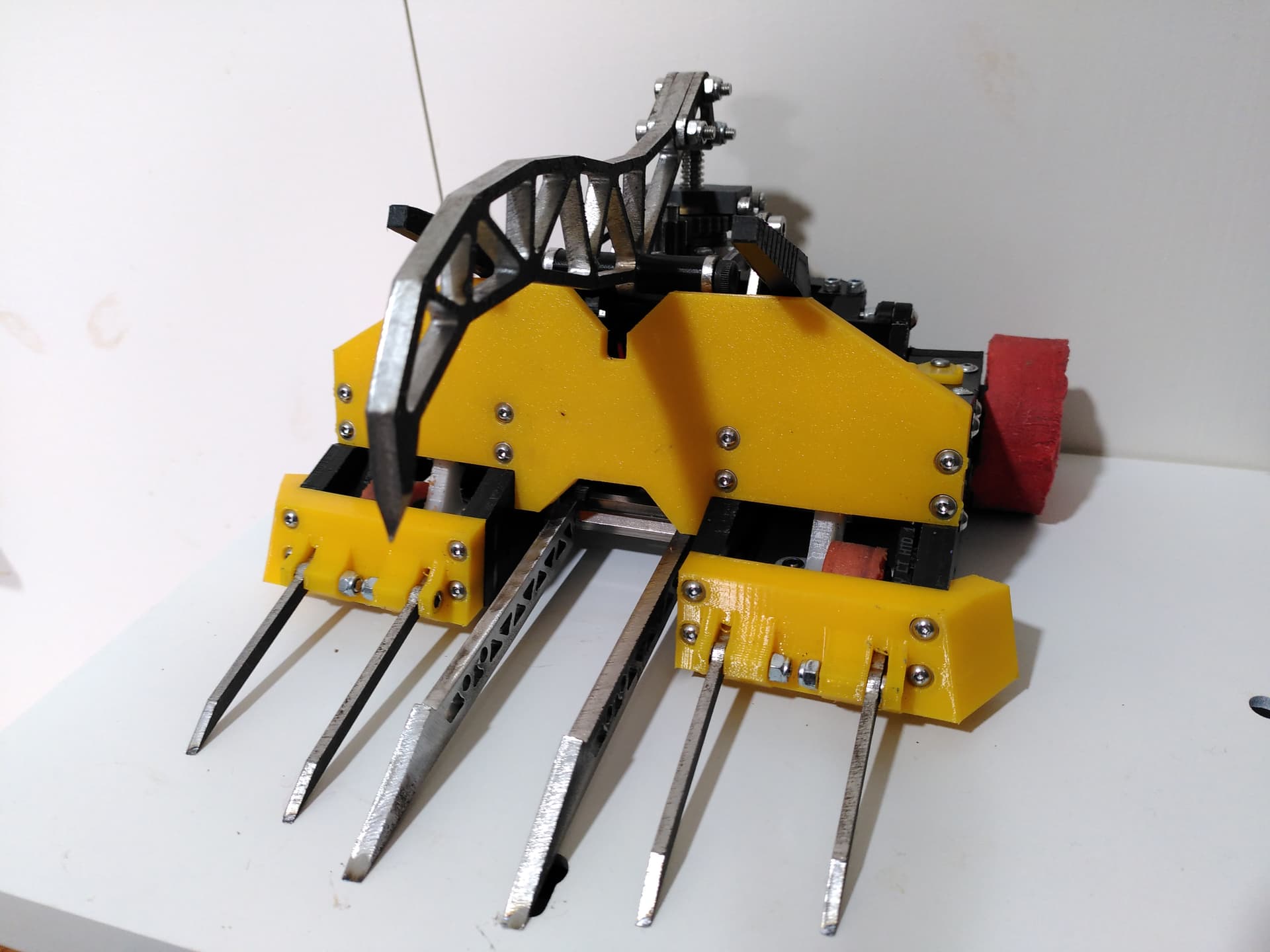

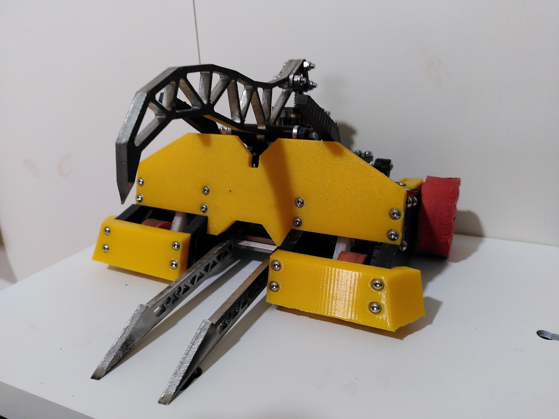

Armour time. As I was now happily printing TPU, it was time to TPU! It! Up!
Single part TPU back panel, less likely to completely fall apart
TPU guards for the front wheels
WITH EXTRA FORKS :0

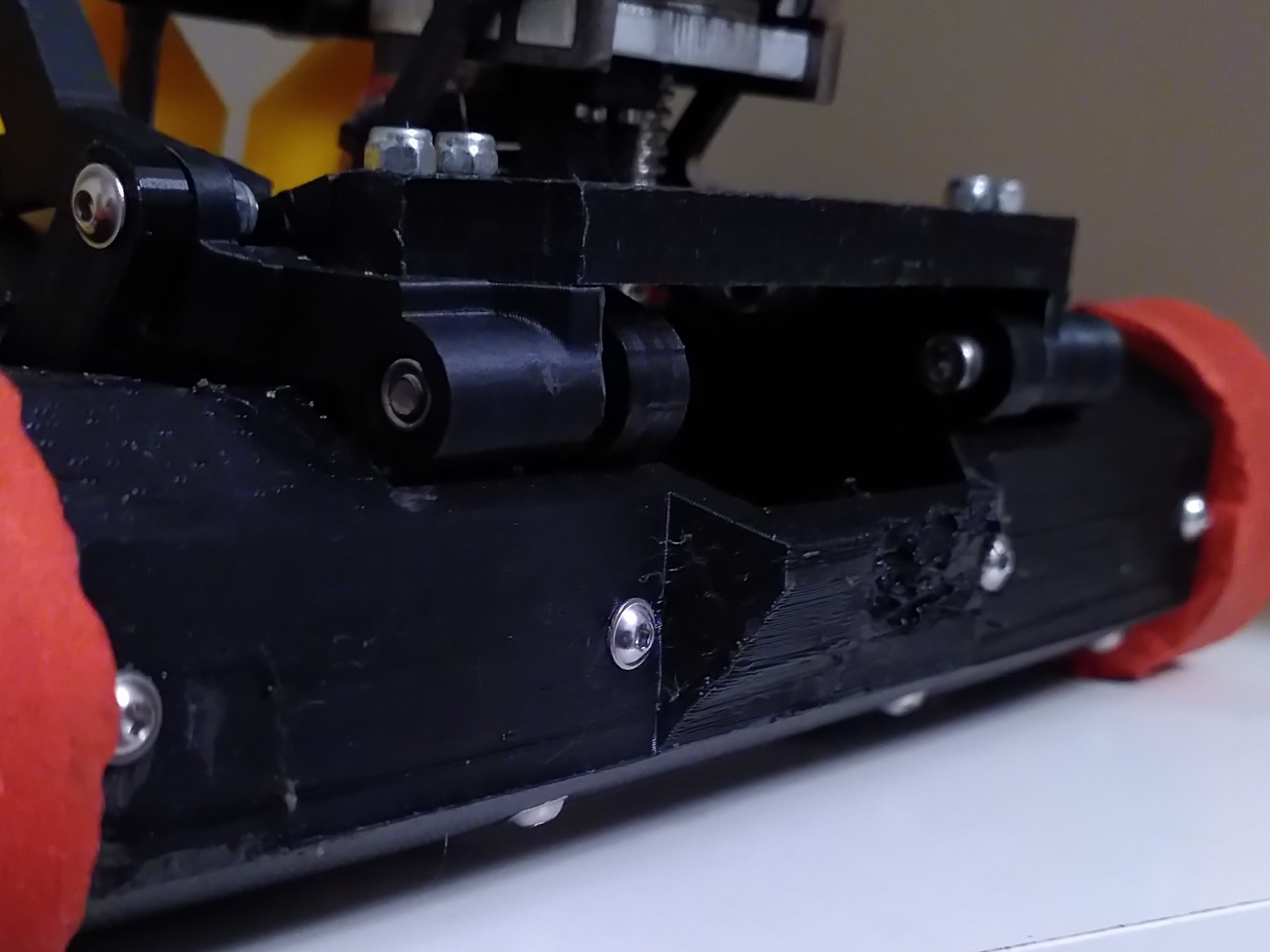

For v4, I also switched to a TPU front panel. v3 had a bit of a flaw - with the new wibbly TPU back panel, the front panel was the only thing holding the chassis square. A big hit to the back bent the front panel, so the whole chassis was at a weird angle and half the wheels off the floor. There wasn’t really space to add more bracing to the back, so it was easier to make the entire thing flexible so it bounces back into shape

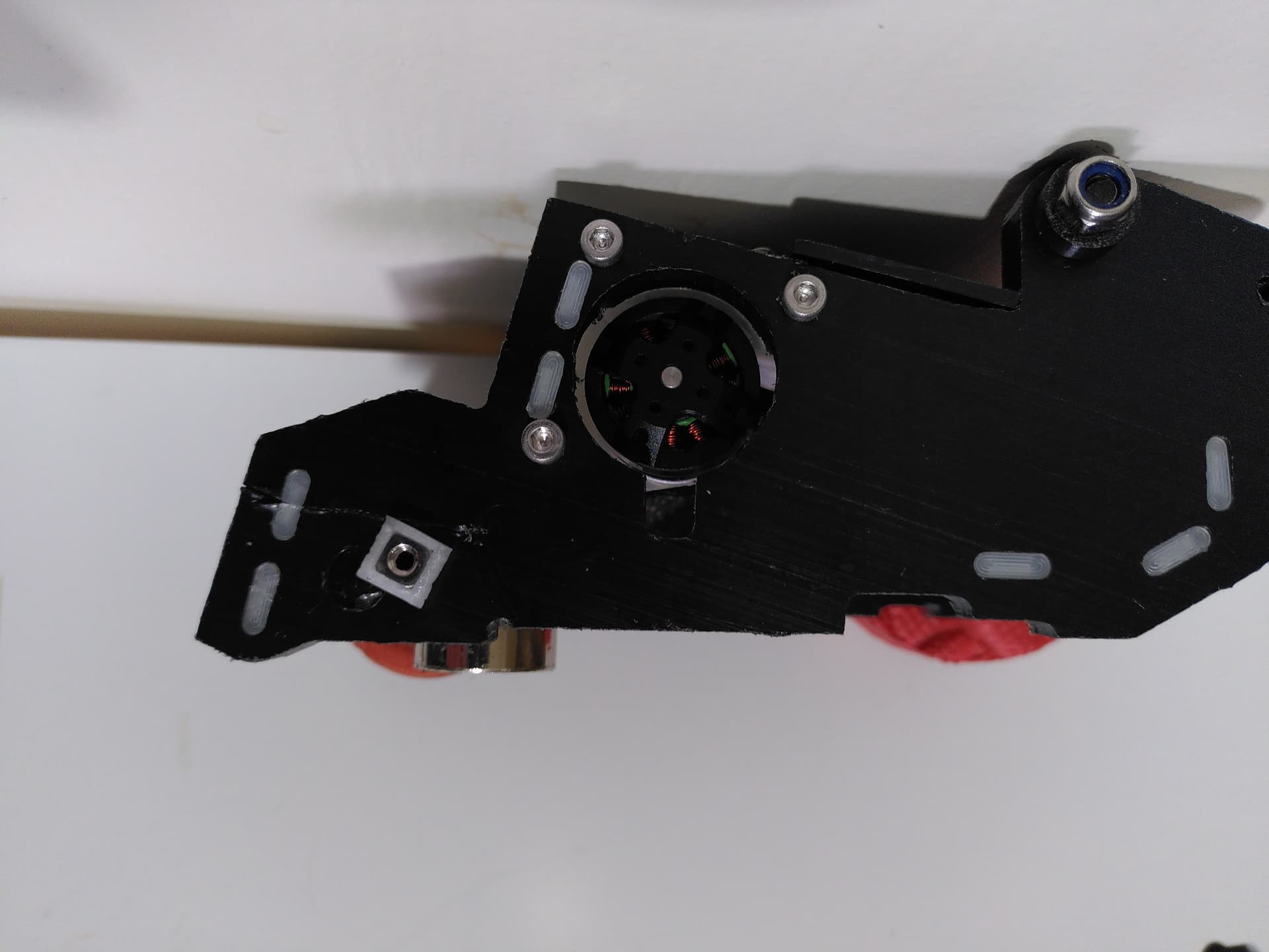

This did lead to one problem. The drive units depended on the front panel to hold the motor in place. With a flexible front panel the belts would lose tension and the motor can would smack into things. The solution: bolt the motor to more stuff. Make v4 mainly drive unit. Swap out 1/3rd of the bot between fights cos thats easier than replacing one wheel
drive unit. look at this unmaintainable chonker

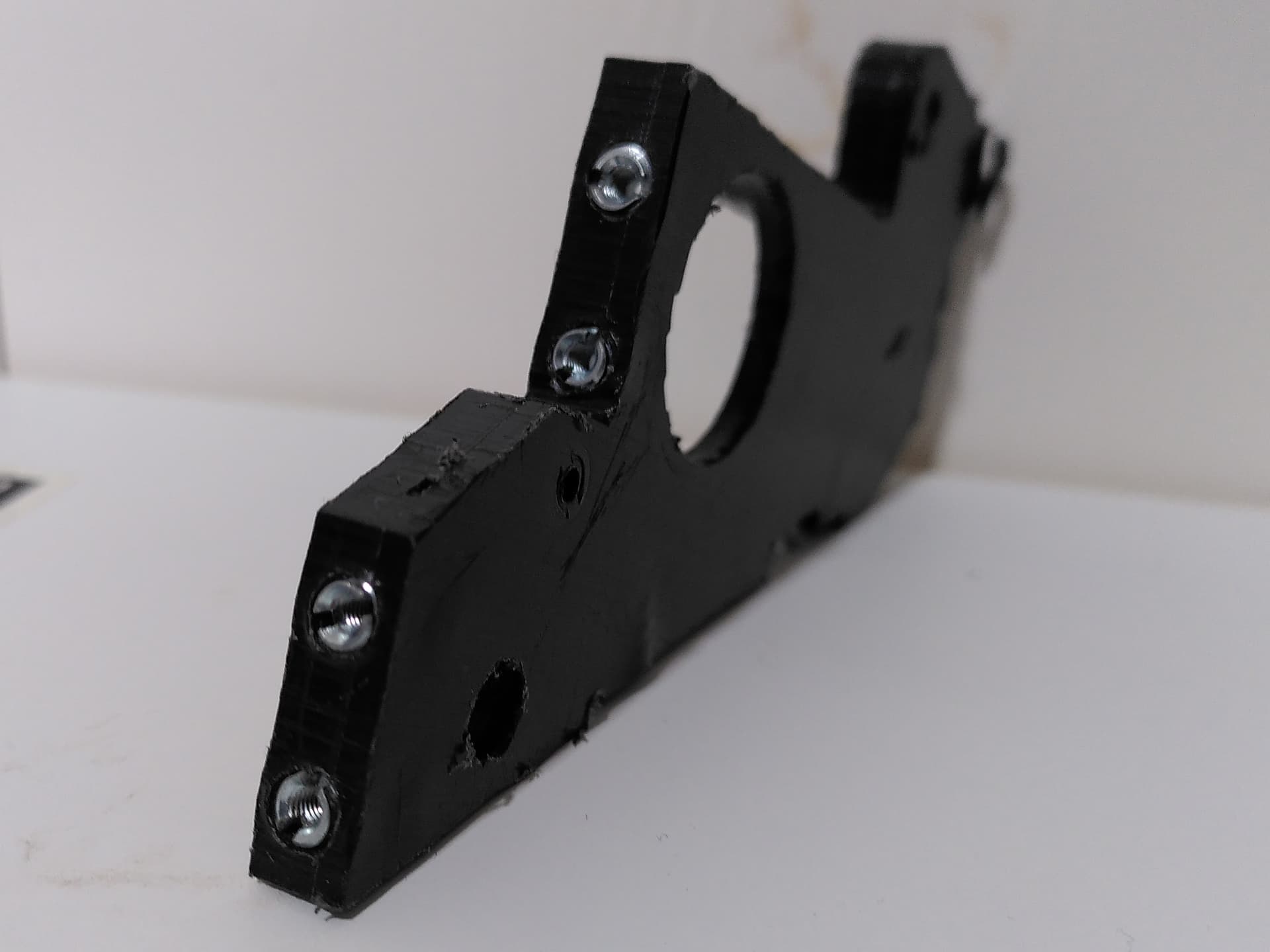

And, to hold it all together, bolts. The wood screws that hold v2 together had chewed loose with how often I disassemble the bot, and I was fed up of it. Bolts need something to screw into though. For v3 I used threaded inserts that tap into the plastic. These worked fine, until I realised that if one was ripped out then I could only fix it by replacing the entire panel. v4 runs captive nuts in 3D printed inserts instead, which are lighter, less likely to pull out, and can be easily replaced
left, threaded inserts
right, captive square nuts

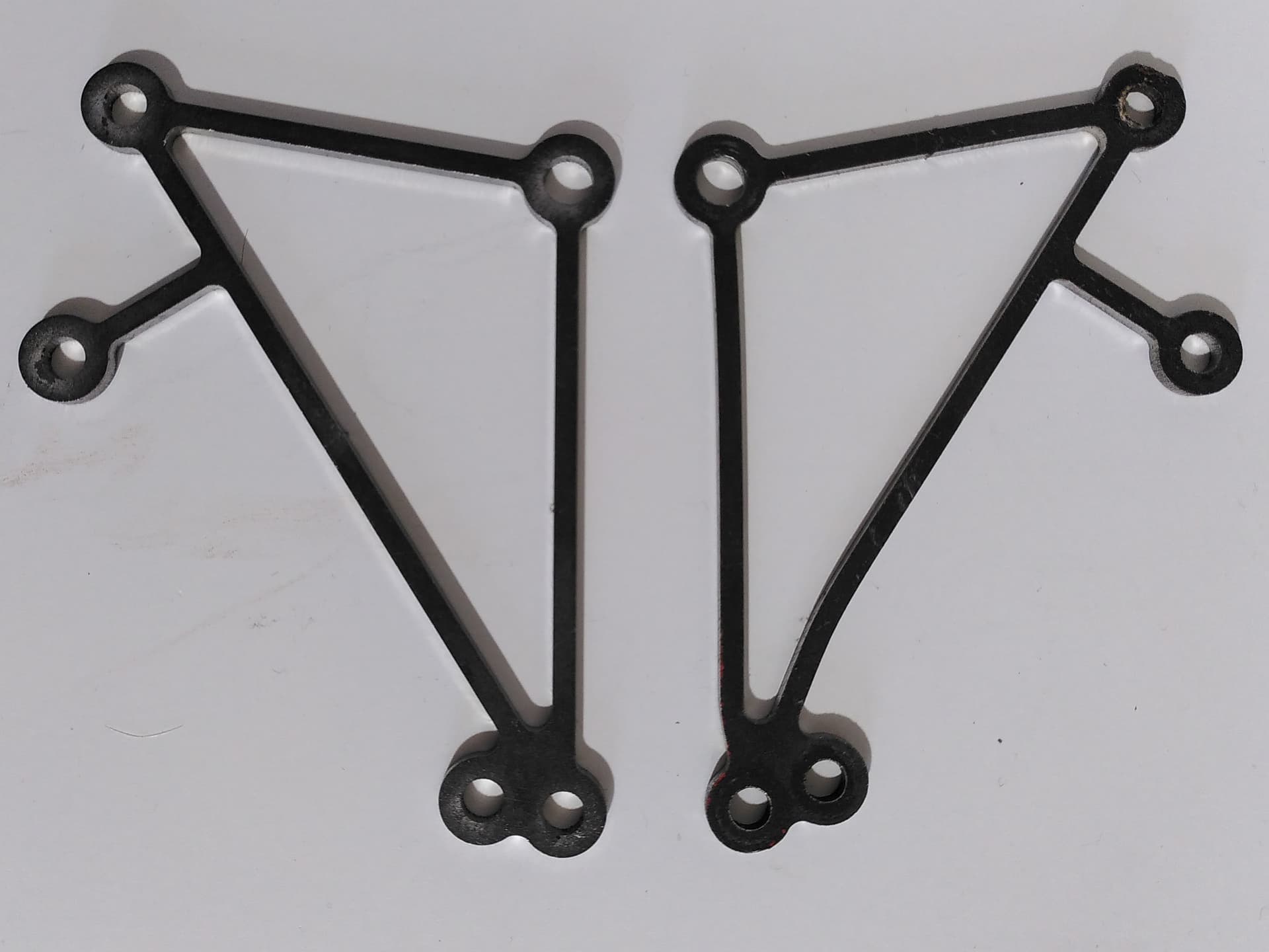

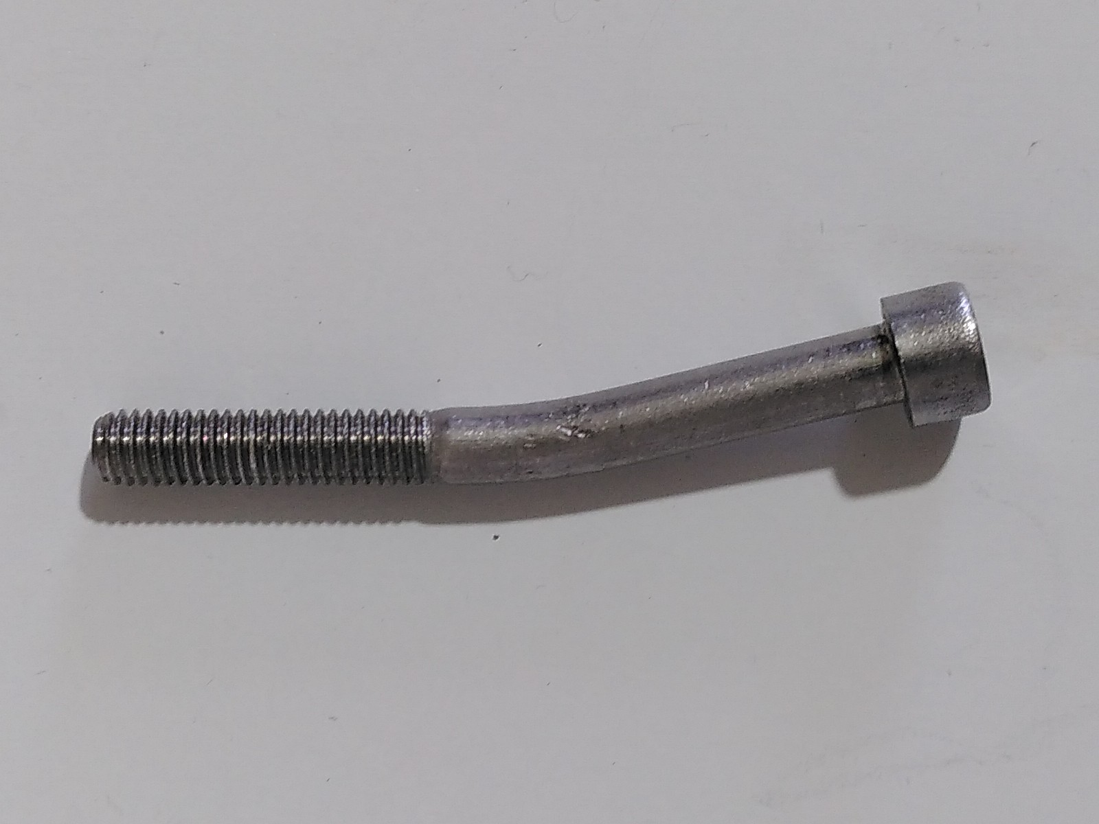

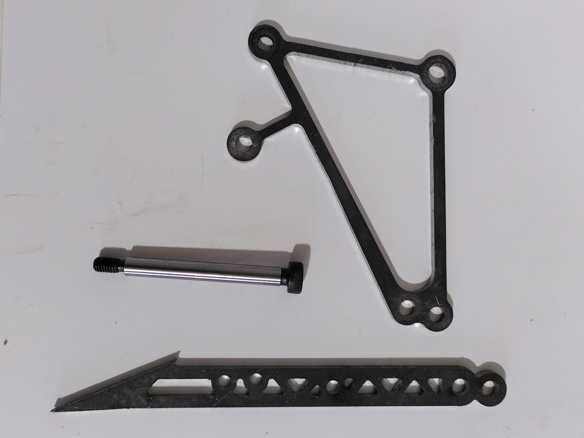

The fork mounts on the internal frames aren’t meant to be at that angle
The M6 bolt that the claw pivots around is banana’d

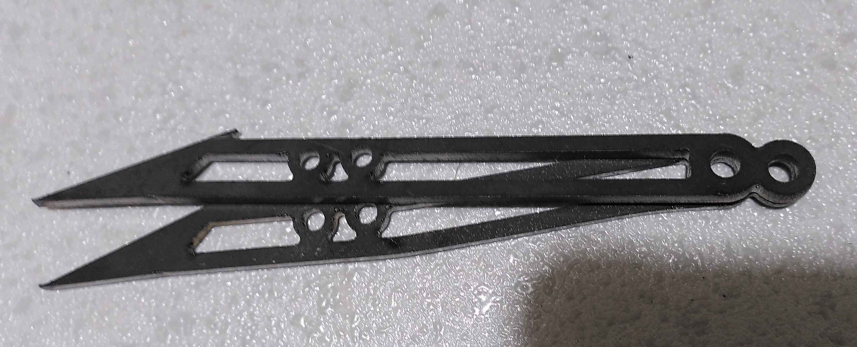

The power output was good, but it was clear that some extra reinforcement was in order - bulkier forks and frames, and a hardened steel shoulder bolt for the pivot

Actuator looks amazing - love the warning light. Superb solution.
