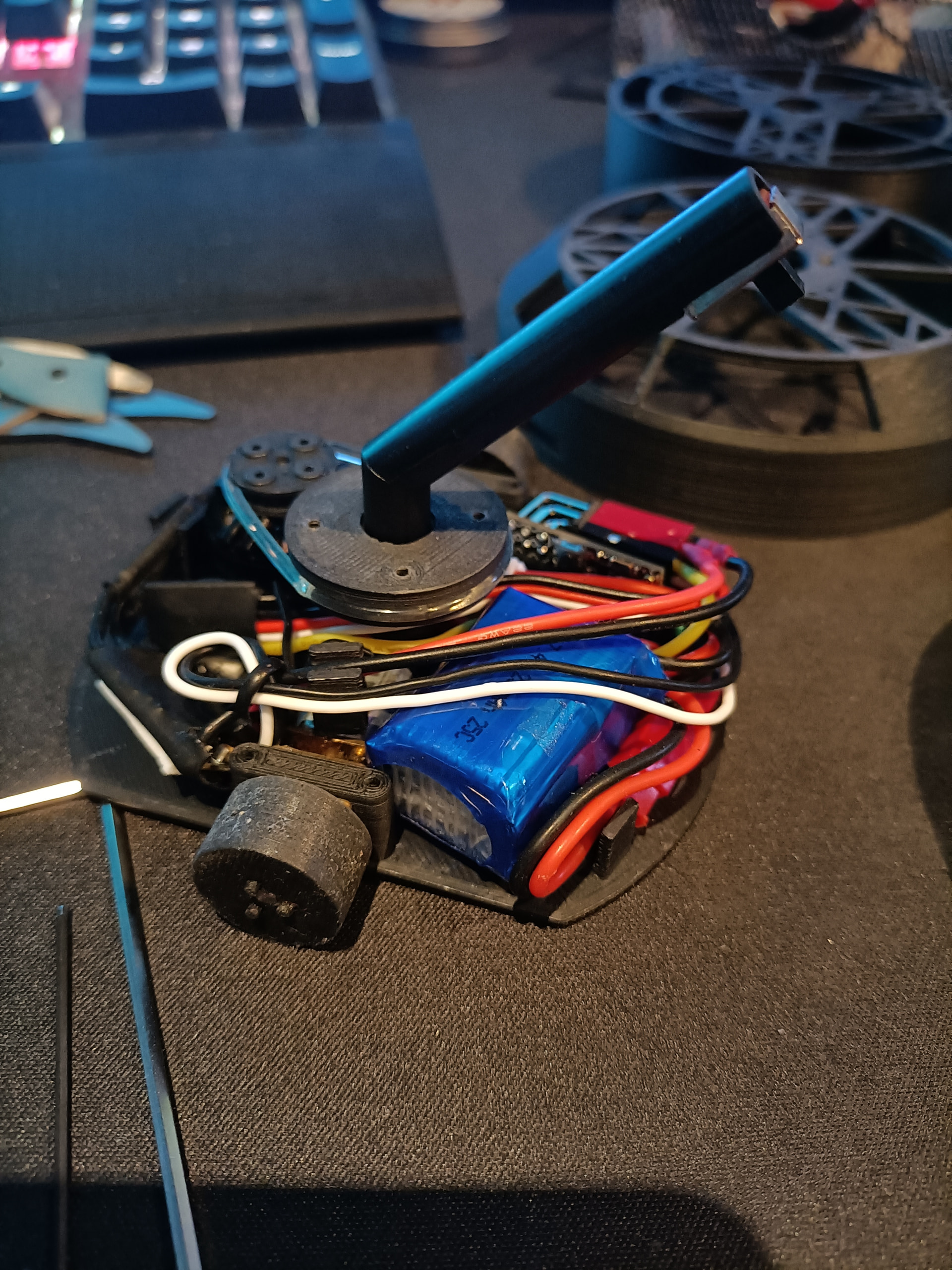

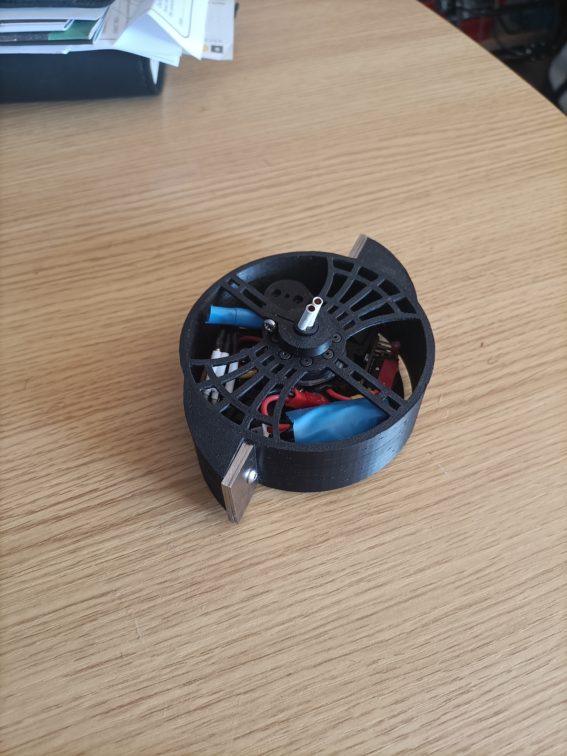

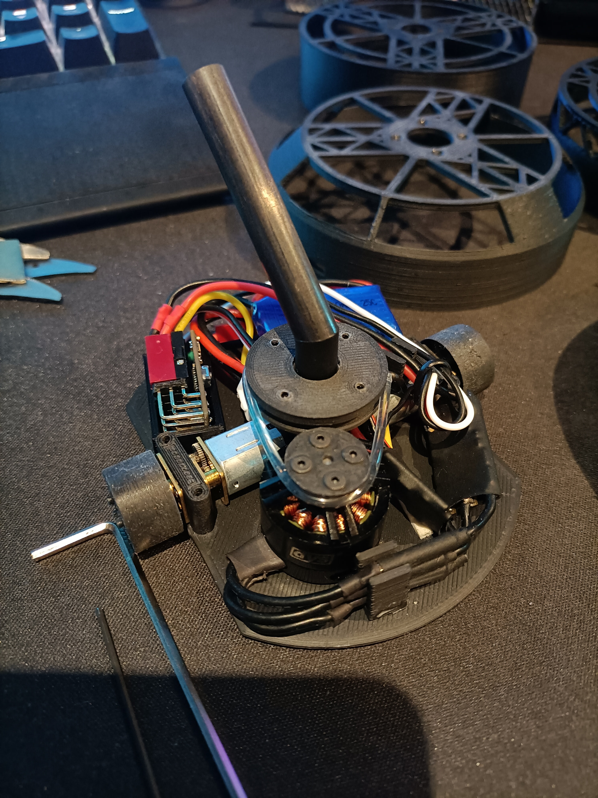

I’ve attached the 3 pictures I ever took of the shell spinner builds. If they ever saw combat, they would’ve ripped themselves or been ripped apart and have some questionable design choices, but I learnt a lot and it was good fun.
Rats nest of my first attempt, you can see the slide switch at the end of the self-righting pole.
Better second re-design, still would’ve ejected its guts.

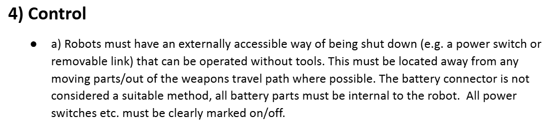

So checking out the AWS ruleset…
You’ll find a lot of people will have their switches on the bottom of the robot and that still ticks these boxes provided you also have a locking bar for the shell (AWS rule 5f) that can be removed after (or replaced before) using the switch.
Hope that helps!
I have built two FBS’s at ant scale and both had switches underneath. Neither of them had any issues, one at an AWS (many moons ago though)
I would agree that one underneath would work within the AWS ruleset. just make sure you mark on/off positions :slight_smile:
