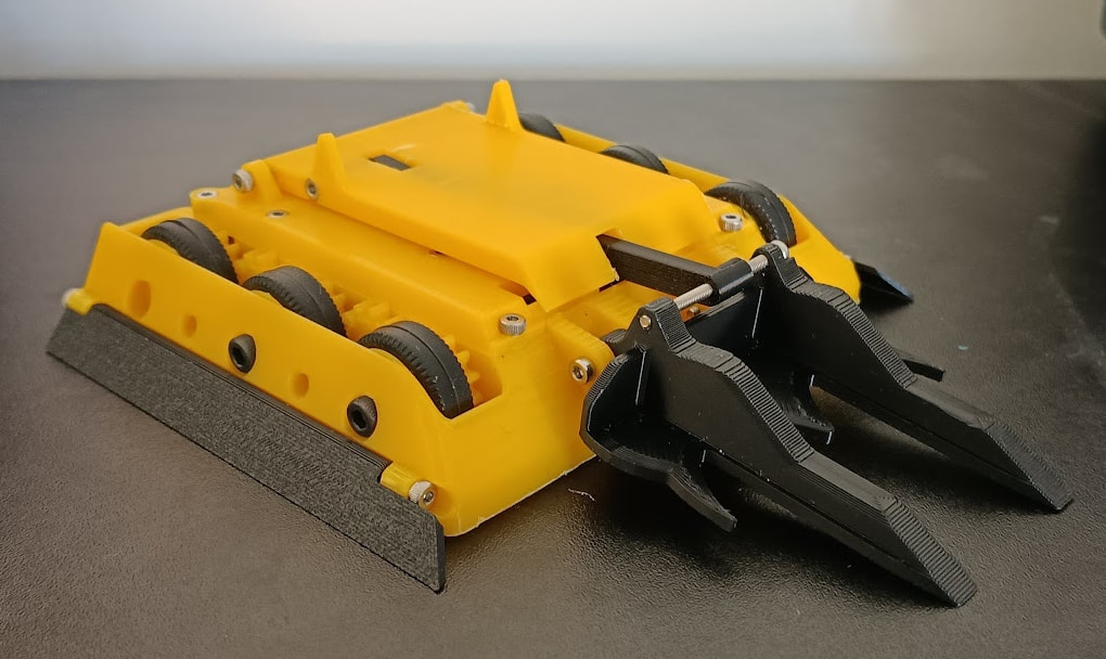

Antweight Panic Attack

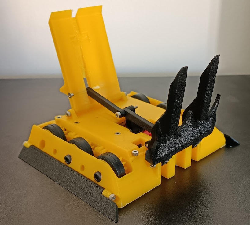

Not an exact rep but close enough. The self righter always opens with the lifting forks as I didn’t fancy using two different motors in such little space and weight allowance.

Best thing posted on here in ages. As always, love your builds - the forks are very cool. And what are those teeny wheels?!
Have also contemplated this task but always got too annoyed at the self righter, kind of one of the reasons my recent similarly coloured ant exists haha.

A friend recently introduced me to slot car tyres which seem ideal for ants. You can find a wide range on ebay for cheap. It is a bit annoying to find the diameter you want, as they are sized based on the specific slot car they are designed for, although they do show the dimensions in the images.
These are the specific ones I used for this
https://www.ebay.co.uk/itm/156326542767?var=457382018630
