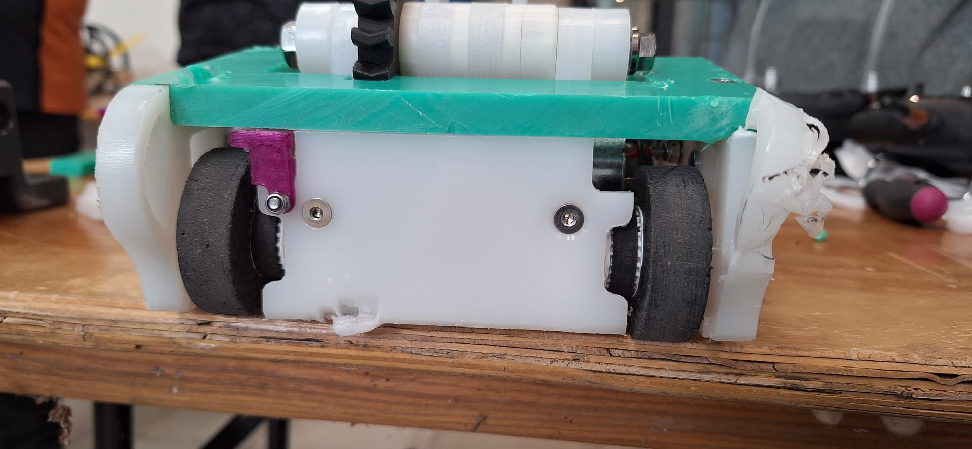

I also wanted to move my rear wheels back further out of the rear of my robot, which would mean going past the 5mm backplate as well as the rolled parts of my side panels. While I was somewhat tempted to upgrade my drive to something more powerful such as Repeat Maxes or Ranglebox Mars’, I had finally gotten the 1806/Robostars running 49mm custom cast wheels to a point where their reliability was perfect for my needs, and any upgrade would have required more internal space as well as being heavier, two things which were at an absolute premium in this design.
The new 37mm motor installed, alongside the smaller and lighter 380mAh 4S battery, down from Babróg V1’s 500mAh.
Since the original Babróg with the motors in the rear already had its wheels as far back as they could go, the only way I could push the wheels back was to move the motors to the front wheel, so that the driven wheels could have their drive axle positioned far enough back to stick out of the back. This also gave me more space to play with concerning the lifter motor, with one caveat; no matter what I did, the 37mm motor would need to stick out of the bulkheads somewhere due to its size, and with the robot already being shorter at the rear, it would push into either the wheels or the drive belts somewhere. My solution to this was to make the belts longer, and place tensioners at either side to create a U-shape, allowing the motor to fit in the newly formed gap. Technically I only needed to do this on one side, but for tensioning and driving consistency I decided to mirror this design, which would also in theory create a greater area of contact between the pulleys and the belt, reducing the risk of slipping further!
The new drive design, reusing the old wheels and with very simple tensioners consisting of 3D printed rollers and a small amount of Vaseline.
The wheels hanging out of the new design. This keeps some of the roller protection design, but also provides a major boost in mobility.

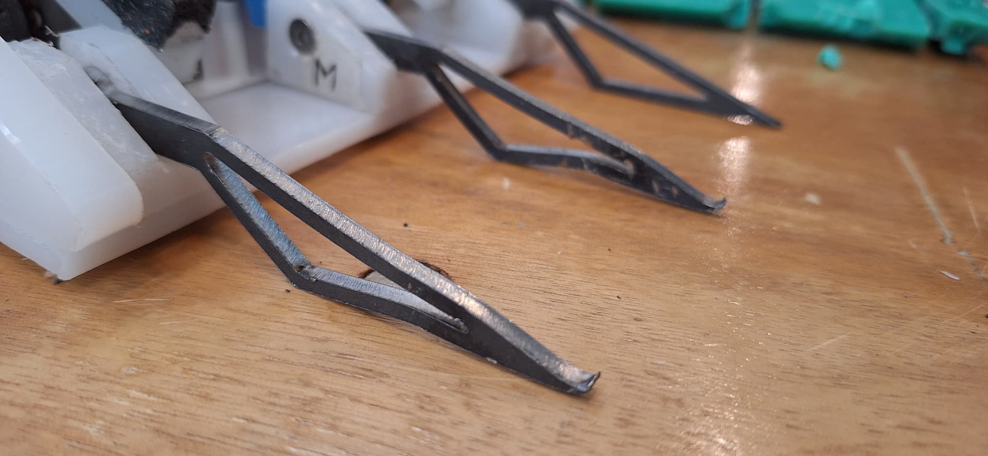

The jig I used to hammer nails into the grabbing arms, which were then trimmed to length using wire cutters.

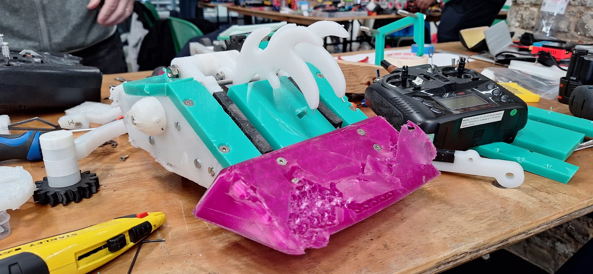

For the front of the robot, things remained conceptually similar, but with small optimizations. The fork mounts were totally remade on the CNC mill, and the hardox forks were redesigned to be lighter while maintaining the same functionality. While the front panels were basically unchanged and interchangeable with Babróg V1 (plus a tiny bit of additional weight saving), the baseplate and side panels were redesigned to not stick out as far forward before, to prevent scenarios where they would warp the front of the bot following a hit, as happened in my matches against Ultra-Violence and Digestive. I was also finally able to experiment with TPU for the first time, which allowed me to print a thick TPU wedge I could use against horizontals in place of the titanium wedge. This wasn’t quite as durable as the titanium wedge, but it was wider, scraped the ground better, and was easy to replace provided I made enough spares.
The new TPU config, coming in at around the same weight as the old titanium config.

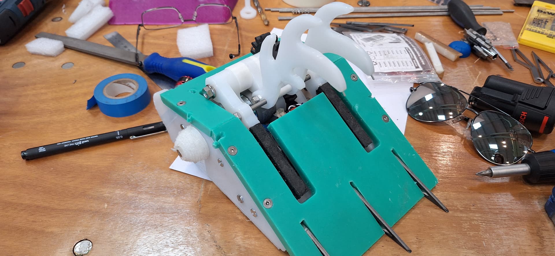

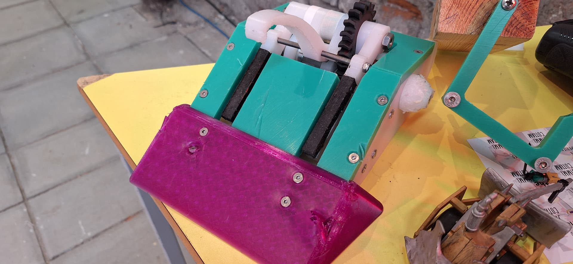

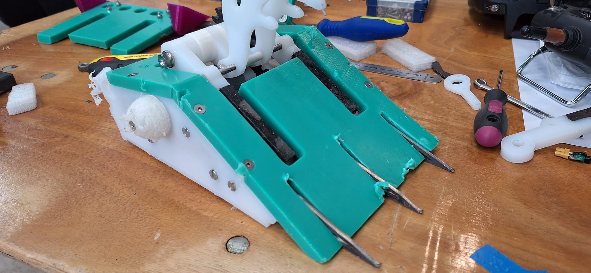

Babróg ready to compete with its new front end setup.
The main change made to Babróg for this event was to the fork setup at the front. The metal forks I had been using up until now were good at scraping the ground, but in the current BW meta they were just too short for far too many opponents, and if I got any kind of a hit which bent the baseplate or the front piece, I would be in a situation where it was even harder to get an opponent up onto the front. I was also very impressed by the performance the TPU wedge had in some fights even where it was up against verts, and so decided to bolt long TPU forks straight onto the front of the robot. This came with a few advantages:
  • I could have as many spare parts as I would bother to print.
  • I could change the angle of the fork exactly so that they would press and scrape into the ground while also allowing me to keep four wheels on the ground as well.
  • I could mount thinner TPU wedgelets in between the forks to stop any other forks from getting under the front of the bot that way, and these could be moved up and down depending on what I saw fit.
  • Because I no longer had the weakening slots in the front piece, I could actually fit longer lifter forks into the design, giving me a few more centimetres of reach.

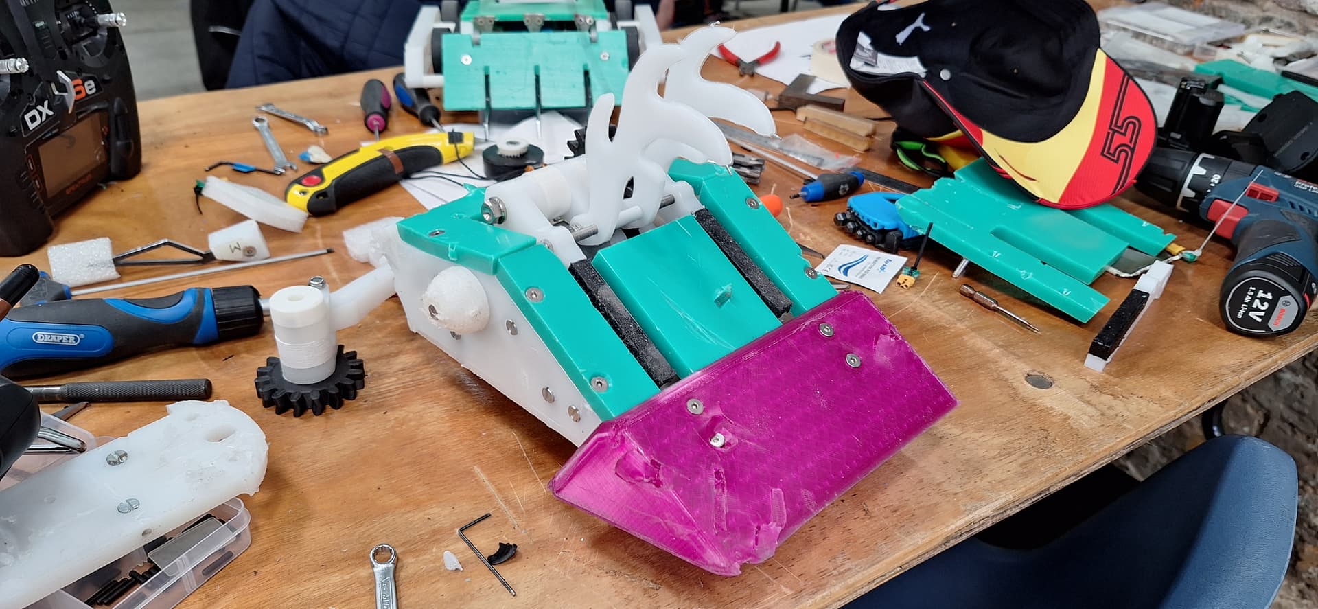

Outside of one final reprint of a TPU wedge (much thicker and sturdier than the first attempt), I was ready to fly over!
Babróg getting funky with it.

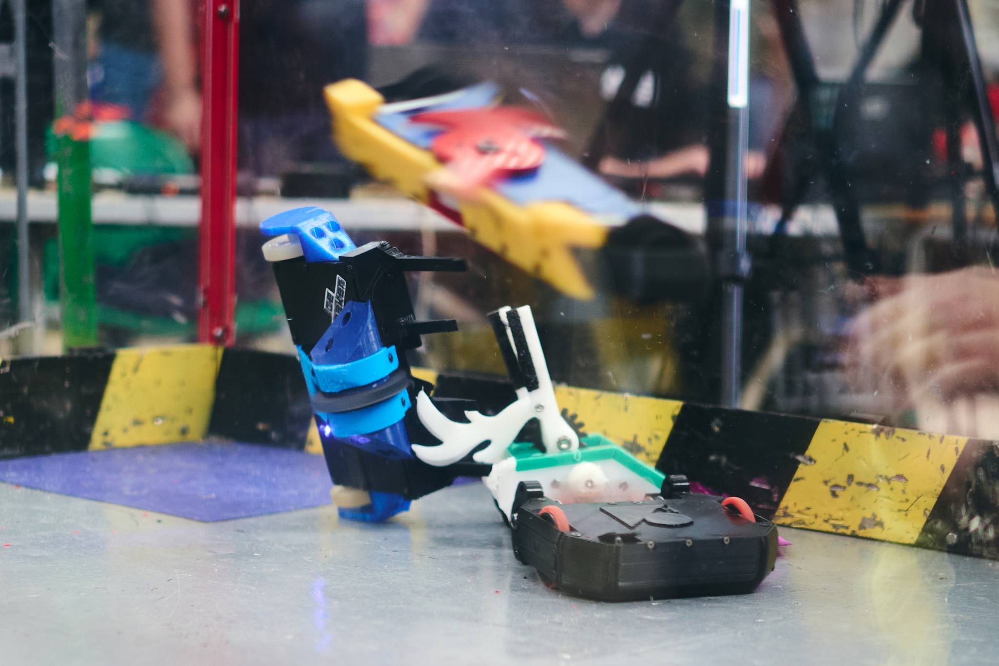

My next match was up against arguably the standout performer of the tournament, Antithesis. This crusher had gone through numerous iterations leading up to this tournament, but the builder Jed really seemed to find the sweet spot this time round between drive power, an effective front end, and a nasty crusher capable of piercing top armour, as it had done in both of its prior fights.
Antithesis with a forceful grab on me (compare this to some of the images above to see where the main lifter bolt should be).
Within seconds of the fight starting, Antithesis managed to hook onto the bolt of the lifter mechanism, and crushed the entire bulkhead right down deep into the robot (it turns out hollowing out your bulkheads can be a negative in this one particular instance). Antithesis had to let go after the 20 seconds were up, and somehow the lifter mechanism seemed to spring back into place. Afterwards we continued to have our tête-à-tête’s, but while we both had similar drive power, my TPU fork setup seemed to come out the loser against the steel forks of my opponent, and eventually Antithesis managed to hook onto the front end of my wedgelet setup, and skilfully manoeuvred me into the pit, knocking me out at the round of 16 stage of a competition once more. Fortunately I had no lasting damage from the excruciating attack from Antithesis, but if I had a nickel for everytime I lost to a crusher in the BW scene via pitting and surviving with minimal damage, despite a grab that got into the innards of the bot, then I’d have two nickels, which isn’t a lot, but it’s weird that it happened twice.
The more gentle bite that would ultimately take me out of the competition.

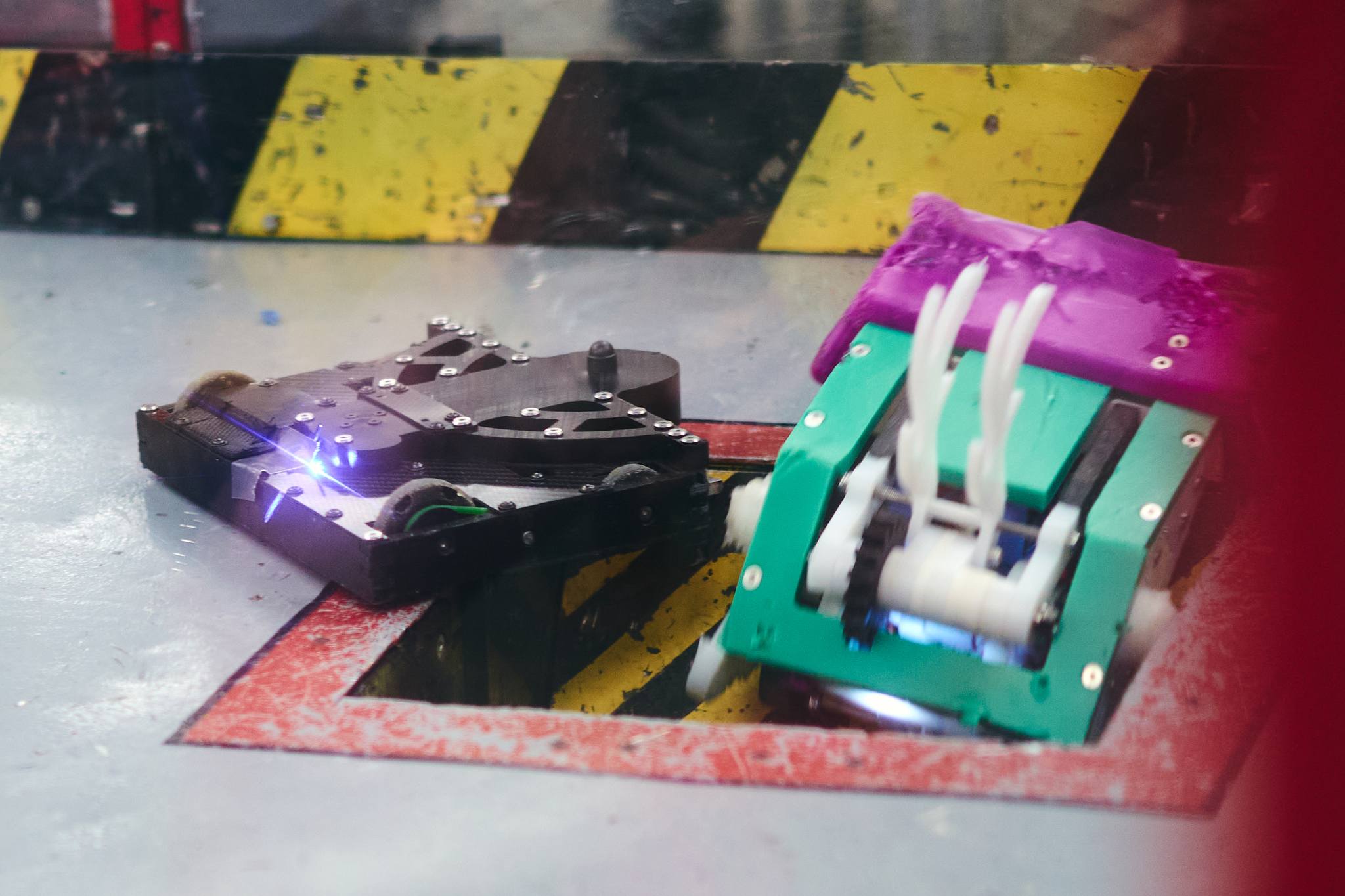

My quarter-final matchup would finally put me up against a spinner for the first time this tournament, and it was a nasty one in Just a Wee Slice. This horizontal spinner had put basically all of its weight possible into its weapon setup, and had landed some nasty blows against other competitors, including fellow control bot Bubblegum Lift which it had beaten in its round of 16 draw. I was originally going to run the new TPU wedge against him, but after a short conversation with Thomas Weatherley of Baby Dead Bod fame, I decided to run my (slightly worn at this point) titanium wedge, a decision I reckon in hindsight was critical to my performance in this battle.
A lot of dynamic shots from this fight!
Right off the bat, I noticed that Just a Wee Slice was bouncing off the titanium wedge as opposed to the plastic, which was a major confidence boost for myself. While dangerous, at certain speeds, I could almost “dribble” Just a Wee Slice around into the arena wall to slow it down, and the more dramatic hits it would score against me wouldn’t do any lasting damage. The static grabber arm was taking the hits just like it should, although I was certainly taking more and more damage to the lifter forks, and even the lifter gear as Just a Wee Slice kept ricocheting into the taller parts of the robot. Eventually, my lifter mechanism was actually disabled, though I was still able to corral my opponent thanks to the static arm, and I started to get better at keeping Just a Wee Slice under pressure while it tried to get up to speed again. Once the pit went down, my chances of success went up dramatically, and after a few close calls, I finally managed to hook onto the rear of Just a Wee Slice, and with some careful driving, got them into the pit, securing a round in the top 4 in triumphant fashion!
Babróg finally getting Just a Wee Slice into a vulnerable postion.
The damage in this fight was certainly significant, but most of it was exclusive to the horizontal config. There were plenty of slices into the top and side panels, but nothing some light carving with a box cutter couldn’t fix. The main lifter gear had actually cracked across some of the teeth, but none of the teeth engaged during a standard lift in that orientation, and I had a spare I could swap to anyway. The lifter forks had taken a proper beating, and the reason I lost the ability to lift was because one of the lifter forks had been bent underneath the front panel. This may have been an asset however; normally this config does not allow any grabbing motion, but because the lifting fork was stuck in place, I was able to bend the threaded bar connecting the grabbing arm to the forks just enough to bring the grabbing arm down on Just a Wee Slice, which is likely what made the difference in securing the win!

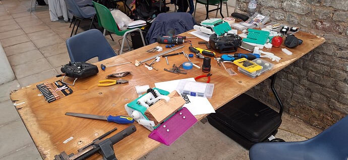

Our pit table this year, in a somewhat organised state.

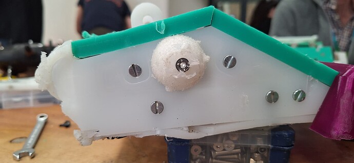

Babróg after fighting Schism. The whacks definitely had some energy, but 10mm was always gonna be super hard for a hammersaw to tear through. Having such a thick top plate does strengthen the rest of the robot greatly at least.
I however did not get away quite so unscathed.

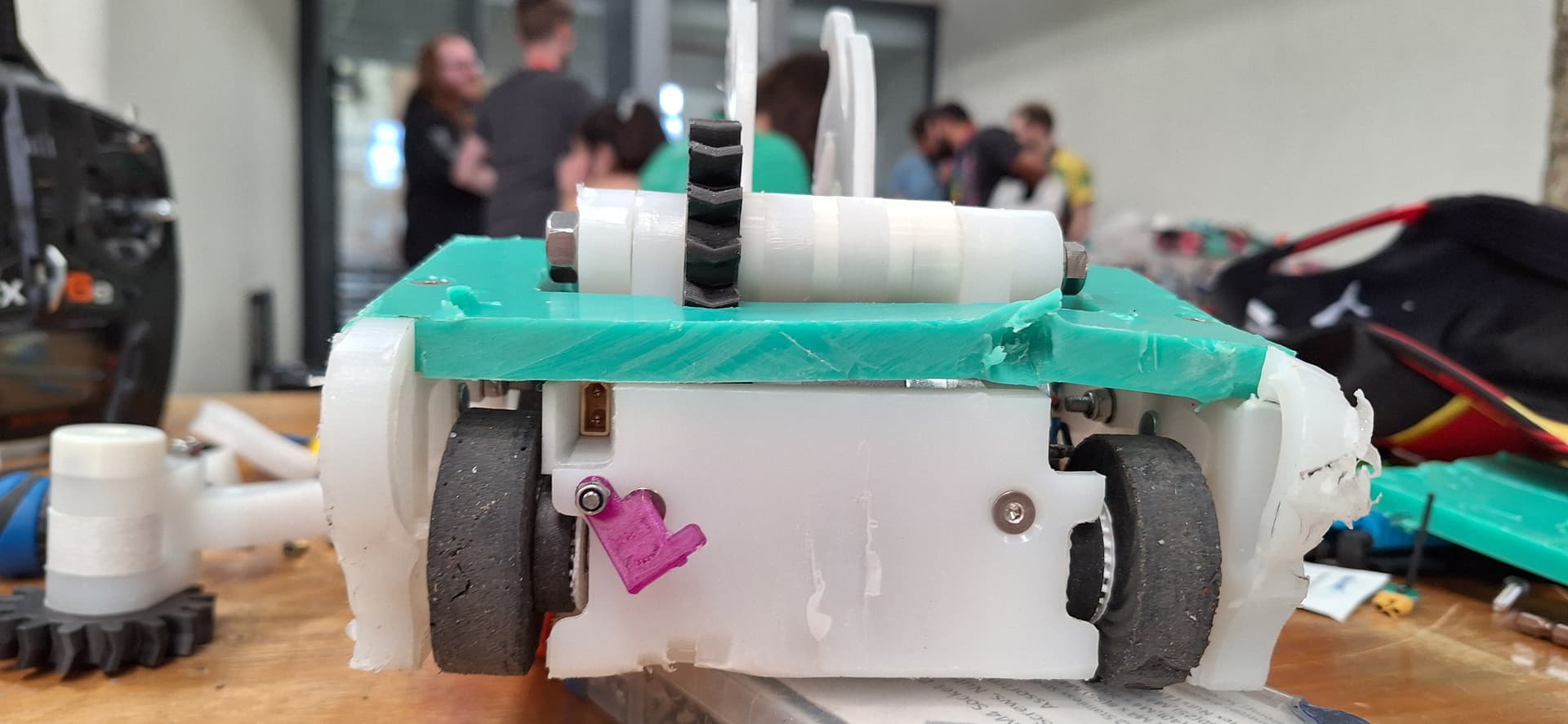

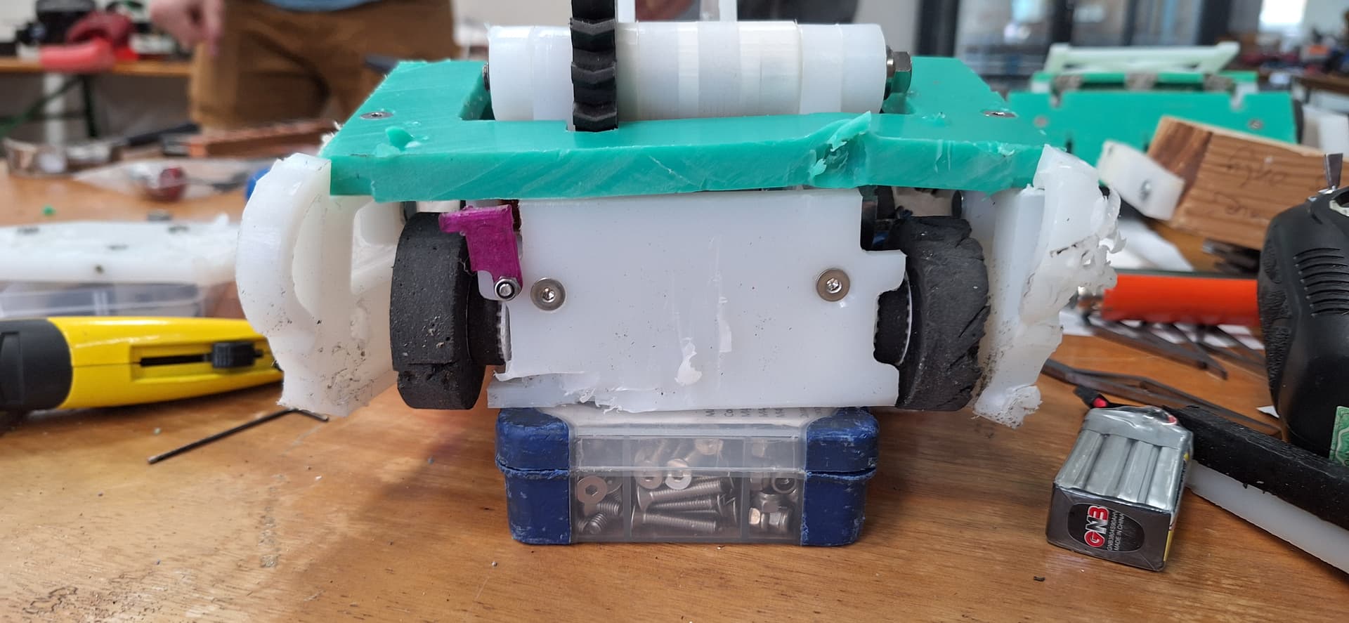

My final fight would be against Digestive, a nasty vertical spinner. If you’ll remember from the 2023 Champs, Babróg V1’s fight against Digestive was the primary motivator for many of the changes I would make, so this fight had the potential to give me a direct like-for-like comparison on how both robots would do, and if my upgrades would truly make a difference.
The fight almost started in disaster, with Babróg getting knocked on its front with the lifter all the way extended. This was a known issue, and it can technically right itself from this position, but I was definitely in panic mode here trying to avoid a count-out. Fortunately, Rob was a massive sport here, and actually helped to get me back on my wheels without using the disc, which I did massively appreciate. From here, the fight seemed to get absolutely mental; I finally started to get under Digestive more often, and even ended up tossing it a few times thanks to its own weapon’s energy, while Digestive started to land some massive hits of its own on the front of Babróg. Ultimately, after a few good exchanges, Babróg got a fork stuck under the arena wall for a second, which was just enough time for Digestive to land a final hit, knocking Babróg out of the arena for good.

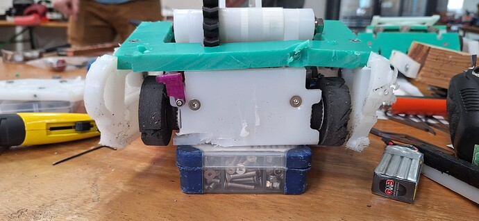

This cracker of a fight was the first time the main body of Babróg took damage, and I’d argue it took it rather well. The back and sides took some impact, and while there was some tearing of plastic all of the internals were just fine. The forks had done a decent job, although you could definitely see how warped they became once knocked, though I was ultimately happy with how they held up. Ground game wise though it was still clear that I only had a small chance of getting under Digestive in a head on engagement, and I could see how much of an advantage it was for Digestive to have such a reach in comparison. This was the fight that would affirm my decision to move to TPU forks for Babróg at Burgh 4 and beyond.
Babróg post-Digestive. The front held together decently well. The main frame is slightly bent, but still super solid, and you can really see how the energy from some hits gets transmitted through the forks.

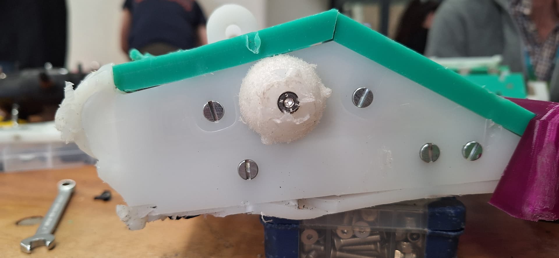

So as part of Robot Rebellion 2024, the main side event taking place this year was a homage to the greatest robot combat show to come from China, This is Fighting Robots, and due to my ahem eclectic personality, I was made one of the team captains. There is so much I could talk about regarding this entire competition, but basically the only thing you need to know was that what you saw in the final edit was only about half of the shenanigans I got up to. Regardless, I did end up in an actual fight as part of this event, and this put me up against the two control bots of Data Breach and Monterey Jack, and the horizontal undercutter of Sniper.
The key moment of the match, and me taking the loss in a respecable and dignified manner.
I was already slightly at a disadvantage since my wedge no longer sat flush with the floor thanks to Ice Breaker’s fine work, but Babróg still drove well, and I think I may have suplexed Data Breach, though it’s not too clear in the edited video. This soon became a fight between me and Sniper, whose spinner was finally tearing genuine chunks out of my TPU wedge. Eventually I managed to outlast Sniper’s weapon, but even then Sniper had a very respectable drive system, and managed a great shove on me, sending me into the pit and taking the win. As can be seen, Sniper’s spinner was perfectly positioned to peel away at the side panels, and while the robot still could drive in a straight line, it’s pretty clear this frame would be retired after this event.
The damage to the sides and rear of Babróg. These areas could be bulked up, but weight is always paramount with these competitions, and nothing has failed catastrophically yet, so I’ll likely keep this armour arrangement going for now.
