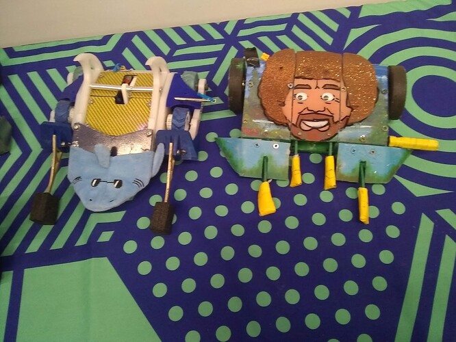

After a brief outing with Splat at RoboNerd, I decided I needed a more effective beetleweight that could still be made cheaply and safely. So set about designing various wedged-shaped flippers. I wanted the build to be a cross between Wild Thing from Robot Wars and Blip from BattleBots. Something compact and tanky, that could survive the hits and have plenty of options. I set about making CAD, in this case Cardboard Aided design. Using the electronics from Splat and an old RC servo to create a working prototype. I also need a name and, after delegating this task to people who should not have been given that power, the name Bob Toss was brought forth (thanks Sion), giving me a theme to lean all the way into.
The prototype with a mysterious sparkly brown foam sheet
Initially the flipper arm ran all the way to the floor however, I decided it might be easier to protect the weapon if the wedge stopped at the end of the chassis to allow various, interchangeable wedges/forks to be made (ala Blip). This is also why the servo is not connected to the flipper, to prevent any unnecessary damage and make it as simple as possible to repair
Completed design, with salvaged steel wedge and just enough room for internals

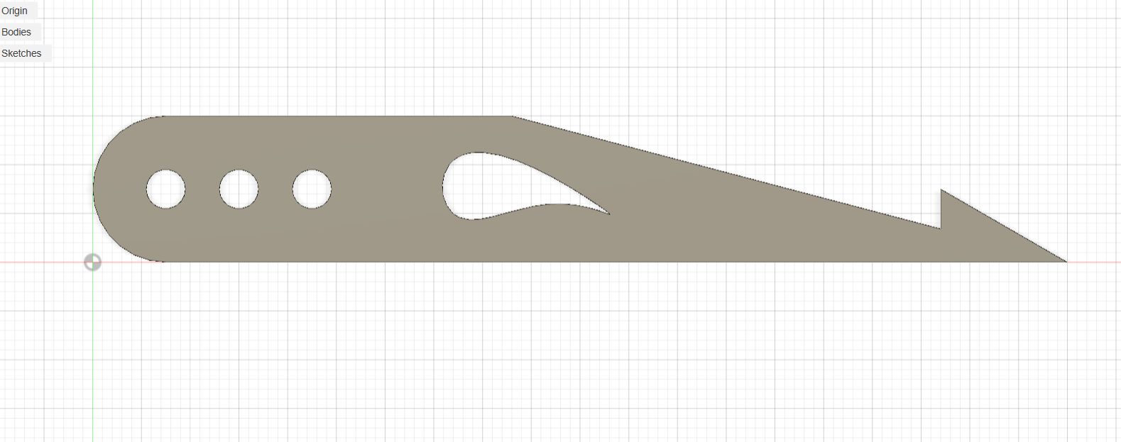

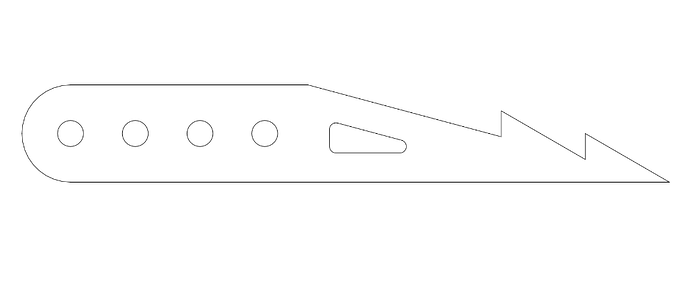

The preparation for Bob’s next event started in way back in April with hardox forks, something that I was in dire need of after being bodied by Chucky at Scouse (somehow I only got a lift when Bob was upside down). This meant I had to dive into something I’d been avoiding for the past few months, CAD software. Now I’m not technically new the CAD, I started a degree in Mechanical Engineering, dropping out after a year, and was semi-familiar with Fusion (or was it Solidworks, I can’t quite remember) However, uni was a rough time and a lot of what I’d learnt had been put out of my mind, so to speak.
So after a quick bit of research, I downloaded the free version of Fusion 360, watched a lot of tutorials, and sat down to learn CAD. The fork design came out fairly basic but I wanted to add some kind of uniques flare. So after a bit of advice from a few friends, and inspiration from ol’ Bob Ross himself, I settled on a fork design that sort of resembles half of a fir tree when standing on its end.
My first attempt with a paint droplet cutout. I was reliably informed this was a bad Idea.
Final fork CAD, with extra mount holes and double barb to resemble a fir tree.
Over the next few weeks, I slowly stumbled through the CAD process until I had something that resembled the robot as it stood and could be modified to include the forks and alternative attachments. The Fork design was then sent to be lasercut, courtesy of Sion Williamson.

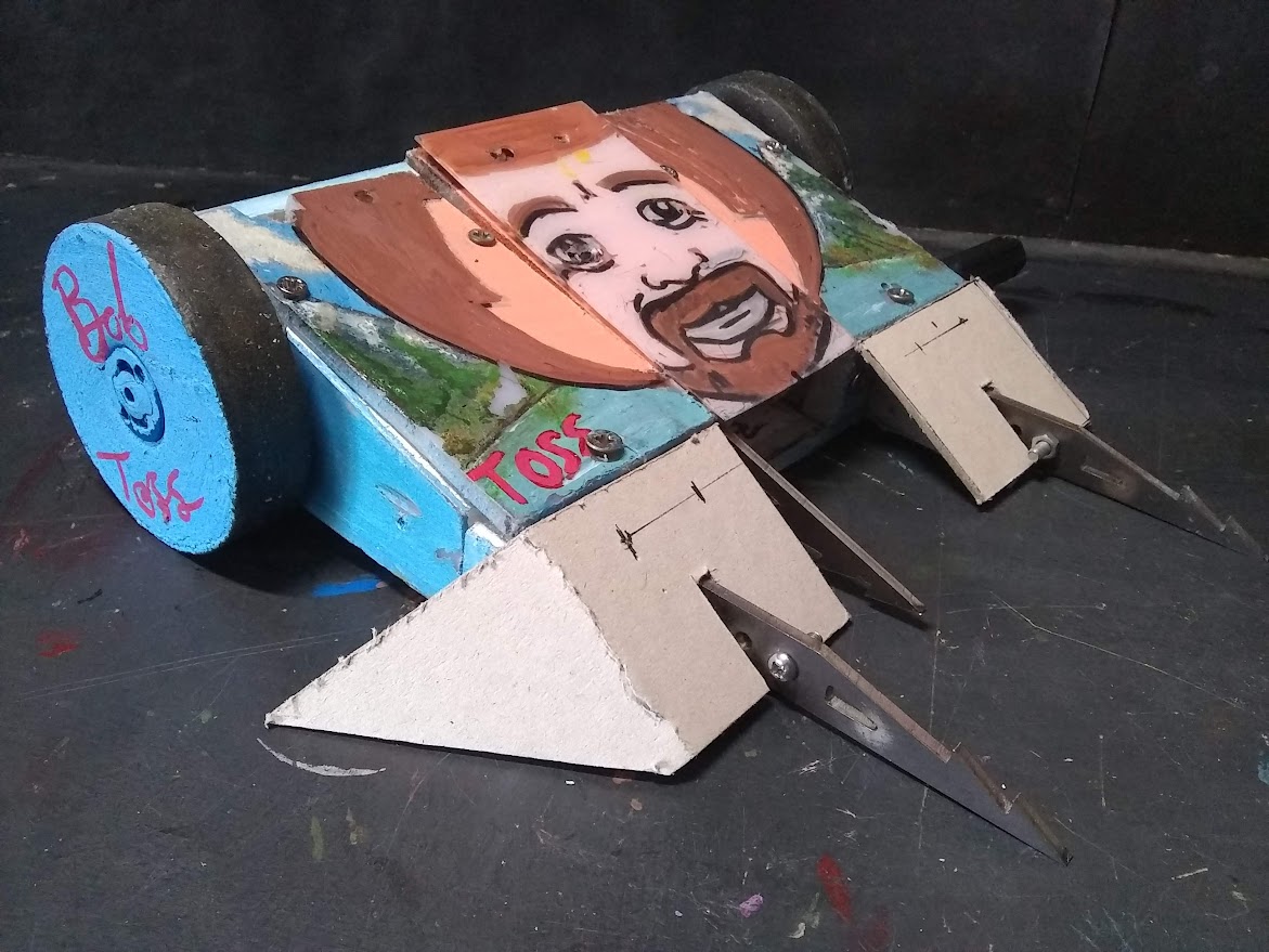

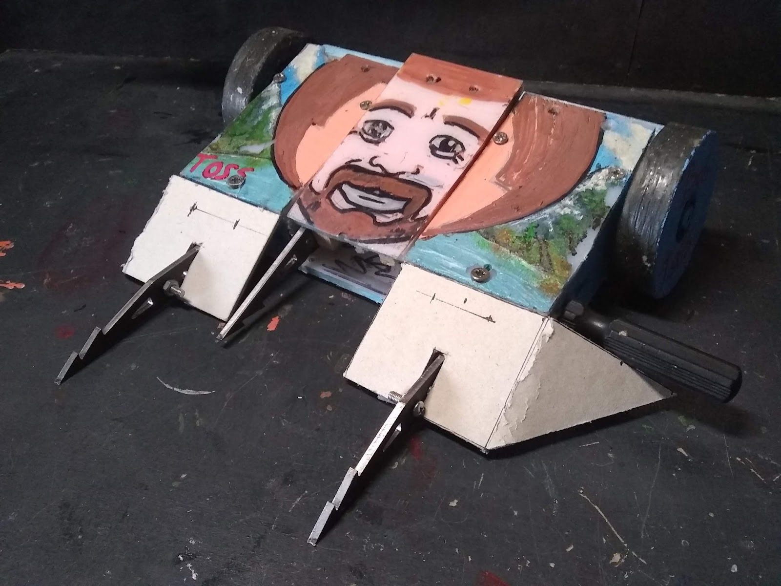

With the forks cut, thanks again Sion, I knew I needed more armour if Bob was to face another big horizontal. So I prototyped side wedges from cardboard to sit around the new forks. These would later be cut from HDPE and then heat-bent to shape. Yet another skill to learn, but one well explained by Greg on the Team HNS YouTube channel and something I will definitely include more of going forward.
Prototyping the front wedges, note the screwdriver weapon lock
While making the wedges I made sure to add a weapon lock as this was something I kind of got away with a scouse, also the flipper failsafe was set-up correctly now, don’t tell Ben. With wedges cut and bent, and a healthy amount of spares made and painted, the last job was the all important Bob Ross face. Originally I painted the face over the landscape then covered the whole lot with a thin sheet of polycarb, sandwiching the foam inbetween, to prevent the whole thing from being scratched. Now with more interchangable parts I decided to paint the face on the reverse of the polycarb, with the foam glued to the outside so the face could be removed to reveal the full landscape painting. (which painted following with Bob Ross’s Granduer of Summer in case you’re wondering…)
