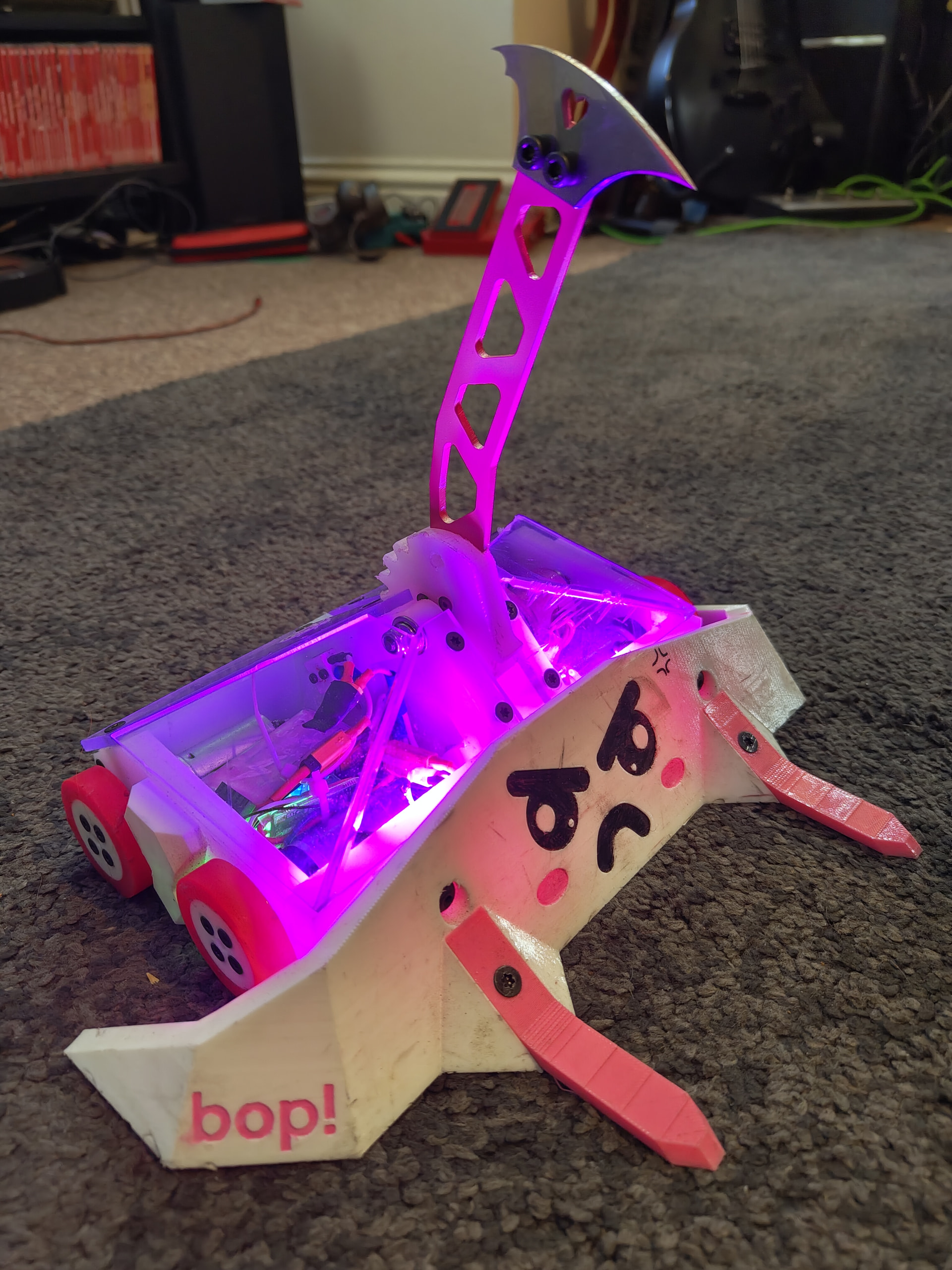

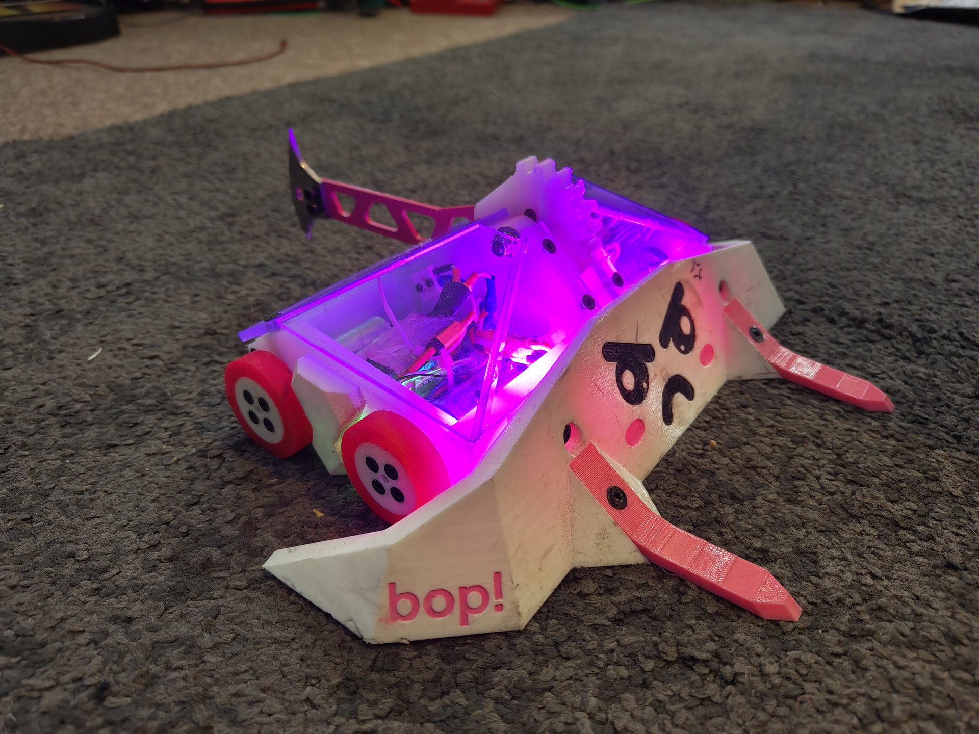

Adding colour to the wedges using paint pen. This is my ‘no pls’ wedge for horizontals. I expect it to need replacing after Bognor.

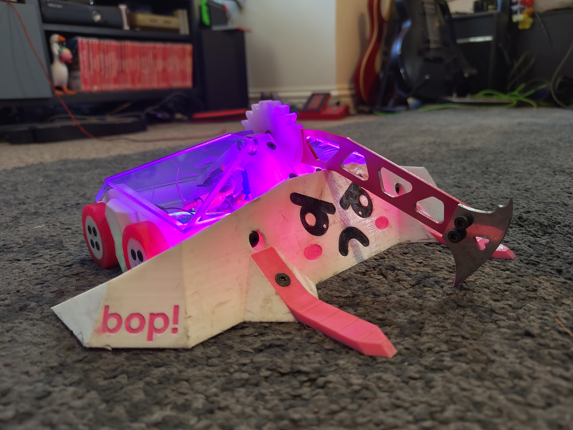

And, a few details aside, a completed bop!
:sparkles: so angery :sparkles:
:sparkles: so aggressive :sparkles:
:sparkles: so angular :sparkles:
:sparkles: so paint pen bleed :sparkles:
Super jazzed about this build. Think it’s by far my cleanest looking build ignoring the wire spaghet. I’m really excited to bring it out for some events this year and, I’ll say it quietly cos I know what I’m like, I feel like this might be my ‘ultimate’ bop! build for the foreseeable. The Fusion folder for this robot is ‘bop! x’ and while that’s a silly title in my head and definitely not the actual robot name it has some finality? Building such a silly ineffective weapon into an aesthetic box is certainly somewhat limiting in a lot of ways and this is perhaps the zenith of where I want it to be? We’ll see.

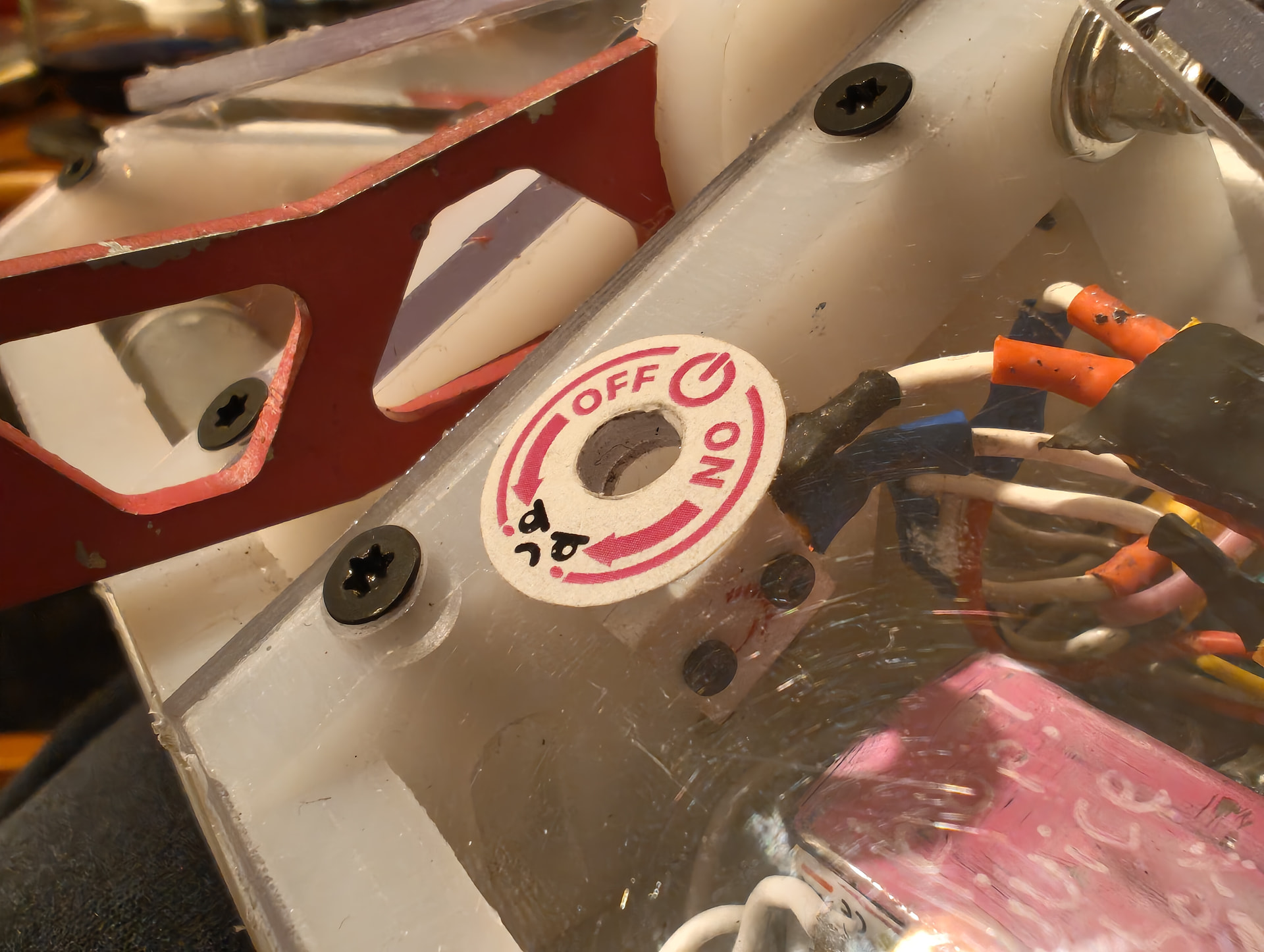

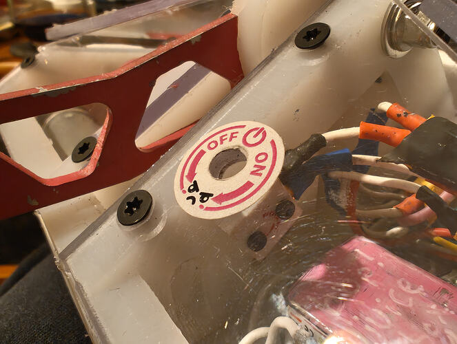

The inevitable switch to, well, a switch. No more links jumping out.

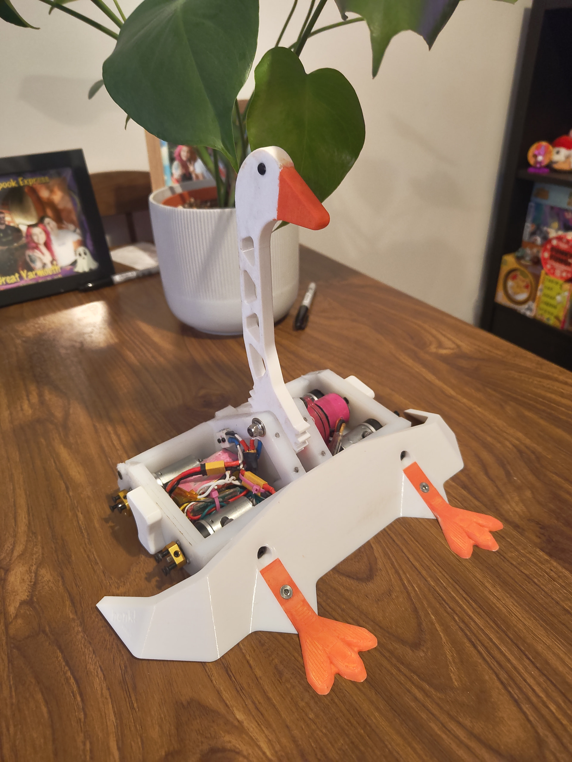

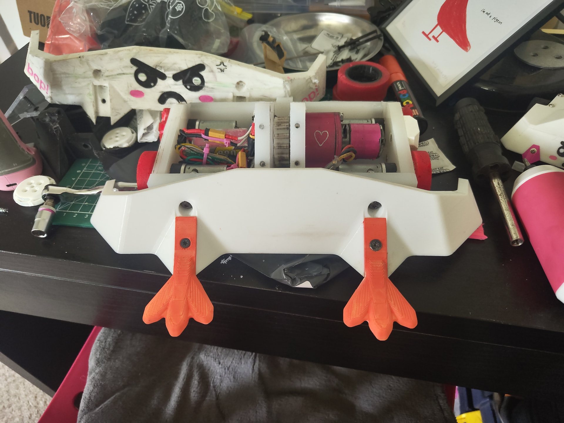

That was kinda it until relatively recently. I came to inspect the bot and… it’d grown feet?
Then some kind of… neck…
Then…
GIF-ovi Oh You Bastard | Tenor

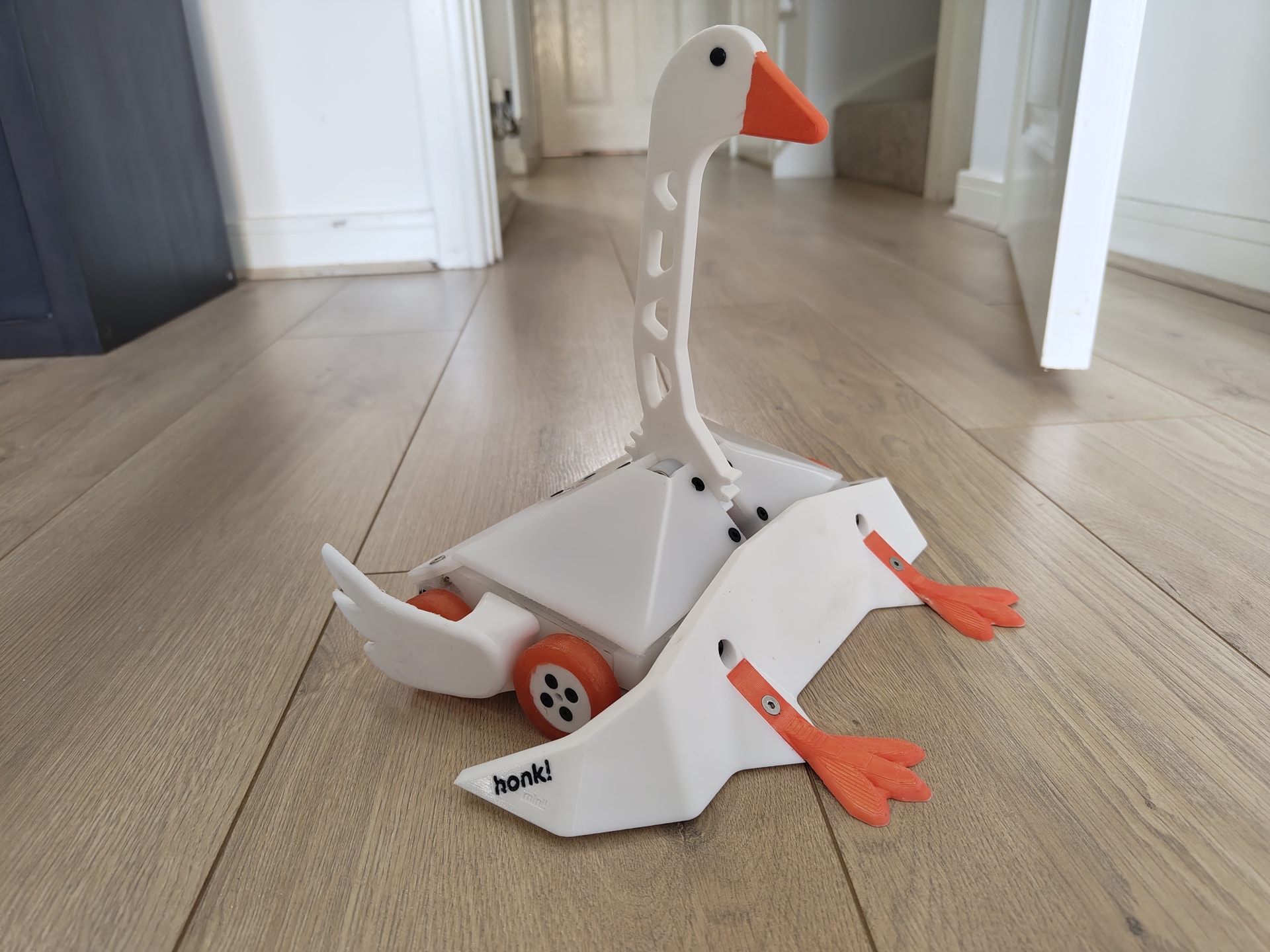

It’s just another goose.
Yeah, fundamentally this is bop!, just with an avian cosplay. Lil flappy feet, the floppiest full-tpu neck n beak, wings, orange wheels and white lids are the only changes here, but I love it. The feet are the usual bop! forks, with the ends cloned, angled, and fillets added - they were surprisingly effective. The gear and neck are the usual geometry but fully TPU (with the cutouts slightly smaller than usual for added strength) and the feather’s head scaled down to fit on.
Takes bop! which is already the nicest driving thing I’ve built and a very fun bot in general hopefully up to the next level. Obviously would never enter a full combat tournament with that neck (the tpu gear was just about hanging on after self-clutching through the competition - usually the output gear is hdpe!) but for exhibitions this is probably gonna be sticking around… :slight_smile:
The feetsies please me. So tiny…
