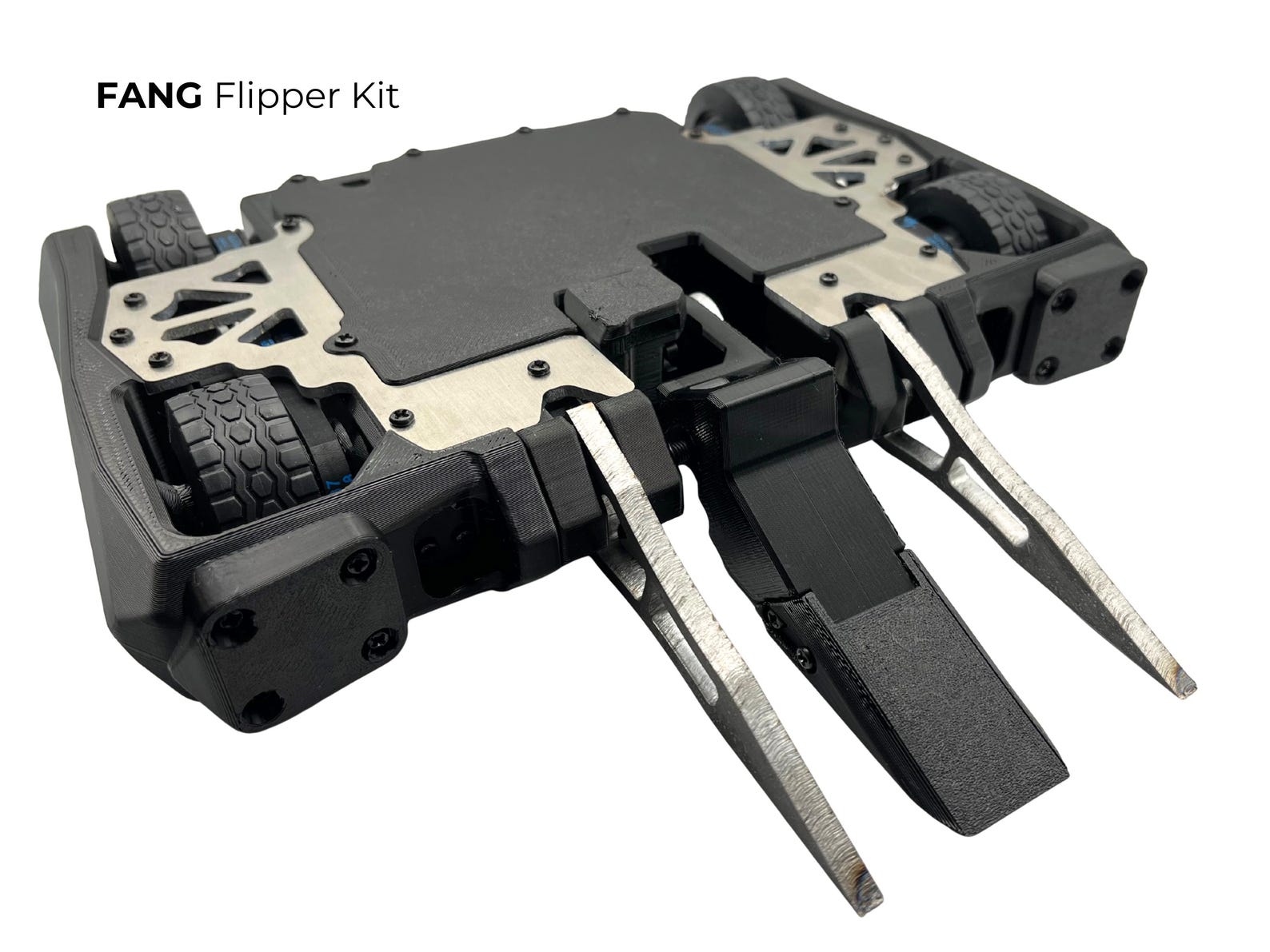

There are options, including the SSP Kit, a 4wd lifter.
this is pretty bad advice tbh, not to say the SSP isn’t a valid way into the class or a good bot, but it runs a bunch of components that aren’t easy to get ahold of in the UK without relying on international shipping, as well as a switch that isn’t UK legal (BBB rules for example require it to be a switch approved by them, specifically Fingertech metric switch or lynx switch). There are kitbots that are designed by UK builders, Andy Russell’s Nightclaw kit is a good UK equivelant to the SSP (and, imo, boasts flashier design).

I do not recommend an SSP.
yeahhh ill steer clear of the SSP just on the basis that its not really UK legal anyways, ill have go give the guides a read! thank you :slight_smile:
