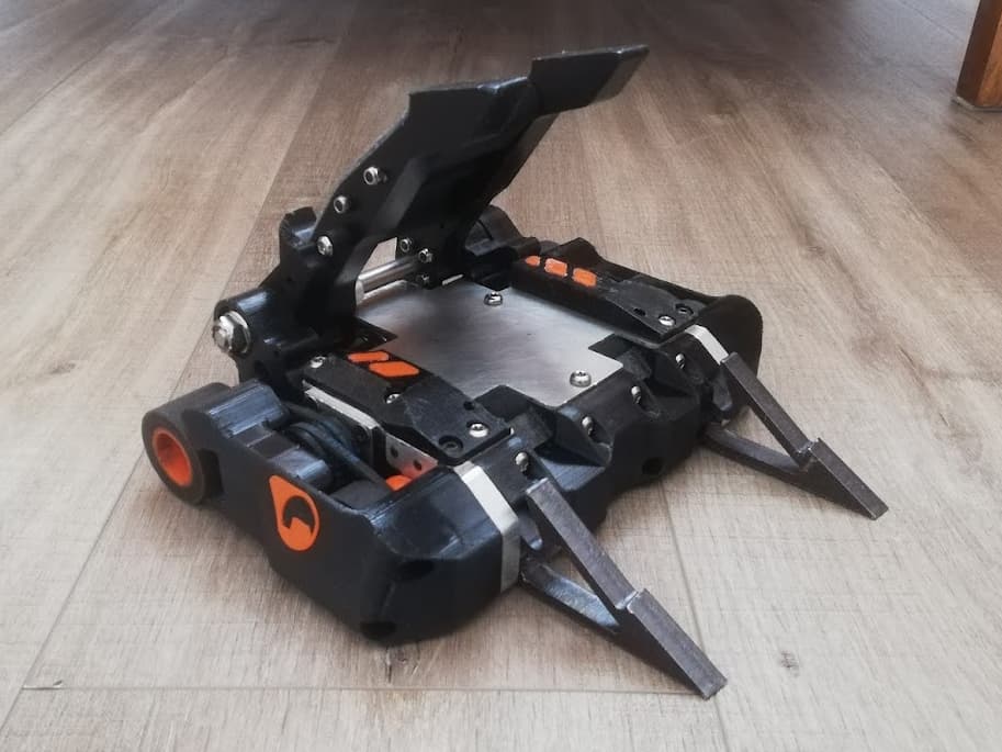

Having seen a few robots utilise brushless motors and high reduction gearboxes to power flippers in the beetle class to great effect, I decided to have a go at making one of my own. With brushless flipper builders being very vocal of the challenges they’ve faced, my main goal of this robot was to ensure necessary precautions would be taken to ensure the weapon system would be protected as much as reasonably possible.
Other goals for the robot were as follows
  • Utilise more PE500 in the chassis, as it is easier for me to machine whilst maintaining strength

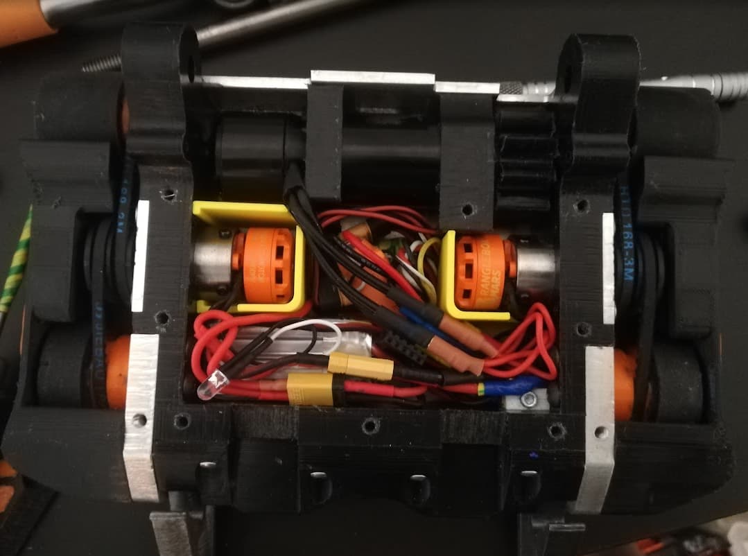

  • Drive motors will not direct drive the wheels and instead will drive each of them by pulleys to better protect them
  • Maintain compactness present on previous robots
  • Ensure ease of maintenance and repair
Here is what I’ve managed to come up with.
IMG_20251001_184505
I ultimately went with a Blip style fipper without all the complicated flywheel clutch mechanism stuff which has been substituted with just a basic gearing system.

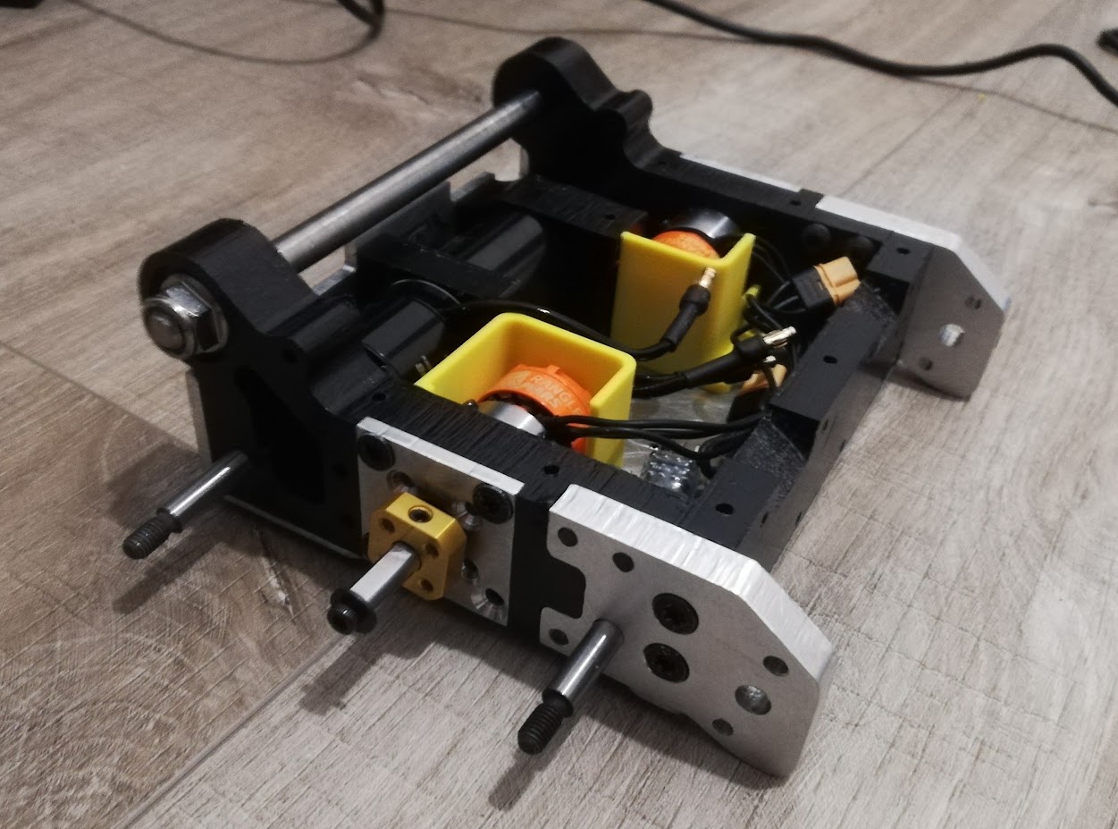

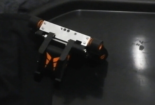

Chassis
I went with a combination of PE500 and 6082 for this build to make the manufacturing process easier for me and to leave weight for other parts of the robot. The aluminum section of the bulkhead was implemented to take on the brunt of the fork on vert impacts I’m expecting to take as I don’t fully trust PE500 to not deform as I have had that happen on a previous robot.
IMG_20250808_005911~3
Bulkheads - 15mm PE500, 3mm 6082 Motor Mounts and 8mm 6082
Front Panel - 10mm HDPE
Back Panel - 3mm 6082
Top Panels - 1.5mm 6082 and 2x 10mm PE500 Anti-Hammer saw panels
Bottom Panel - 1.5mm 6082
Motor Mount - 15mm PE500 Motor Mount and 10mm PE500 Brace

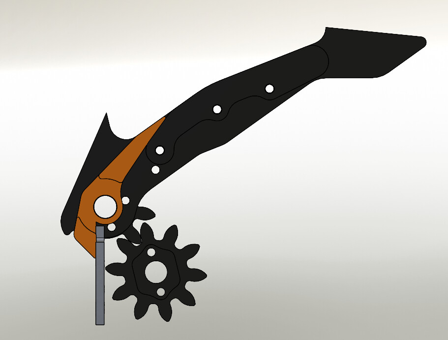

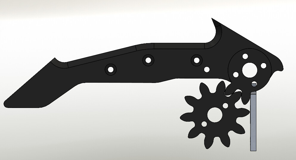

Weapon System

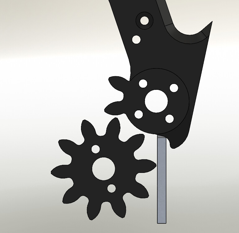

I’ve seen a few examples of clutches being used in beetles to reduce the load on the gearbox. Due to how small the robot is I ultimately decided to go against this and instead went with a more primitive method of just removing a load of teeth on the flipper gear so that it and the pinion simply disengage upon full rotation. This essentially removes all meaningfull load on the whole flipper system as the flipper gear now just skips over the pinion when the flipper reaches its limit. The one glaring floor of this is that the robot can get stuck on the flipper if I don’t retract it fast enough, so got to be carefull there. On retraction I have reduced the power supplied to 15% which shouldn’t produce enough load to damage anything as long as the motor isn’t stalled for too long.

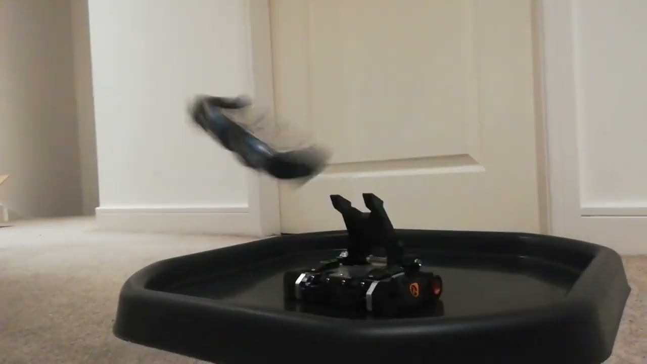

Overall, fairly happy with this. The flipper can do some pretty decent flips and has a good combination of height and forward distance which should hopefully be good for ootas. The danger of getting stuck will be something I will look into for the future. I was intending to look into a bungie style return but I can’t be bothered for now.

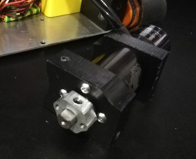

Motor - 2836 Overlander Brushless Motor
Gearbox - 100:1 28mm OD Gearbox (8mm shaft variant)
Pinion Hub - Custom 8mm 6082 Hub with M5 flat grubscrew
Electronics
Miscilaneous

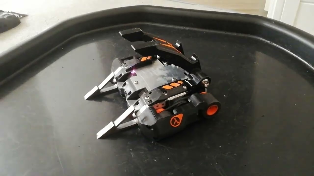

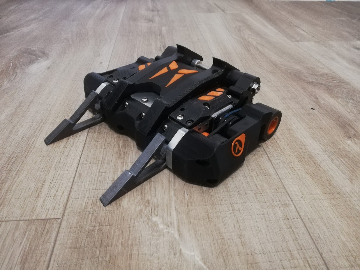

Forks - 10mm Hardox 500
Wheels - TPU with shore 60a tyres
Sidepanels and Front Fork Panel -TPU
Anti HS Wedge - THICK TPU (still to be made)
In conclusion, I’m pretty satisfied with the robot build, it drives well and seems to have a decent weapon if testing is anything to go by. I’ve got no expectations for Champs as its a completely new build and has not been battle tested, however as long as I get a couple decent flips in I’ll be happy.

Mechanism looks absolutely devastating - really nice amount of ‘pop’ from the flipper.
Very tanky build as usual. I can see this going the distance!
I had an idea soon after writing this to aid with helping it become unstuck if the robot gets stuck on the open flipper.
Idea is the the TPU part in orange flexes when the flipper opens to allow the gear to skip but can happily return if the robot gets stuck on the open flipper so that the gears re-engage.
I printed it off and am happy to report it seems to work quite nicely.
Gets a proper good somersault in as an extra
that return on the flipper is brilliant, saves having bungees exposed on the front as well. cant wait to see it in action!
I’m incredibly impressed at how you’ve packed a clutch into such a small space! I’m still a little confused at how exactly it interacts with the lifter mechnaism however. Do you have any photos or renders of it from different angles?
It’s not so much a clutch but a “soft stop” that the motor can compress enough for the partial gear in the flipper to rotate enough so the teeth come out of mesh and the motor driver can spin freely.
When the motor stops actively driving the flipper then the compressed tpu bounces back remeshing the gear teeth and allowing the lifter to be power retracted.
This is why it’s doing the machine gun noise when over driven - the flipper gear is bouncing in and out of mesh. Id wager those end gear teeth will see some serious wear and tear but it should be manageable and probably not hugely crippling
And honestly it’s a marvelously elegant approach.
Big up Ioan here tbh that’s some great problem solving
I love this. It both adds reliable self-righting, and plenty of additional “Ugga dugga” sound too.
Yeah what Jack said. Its definitly a more primitive way of doing it compared to a clutch but it seems to be working quite nicely.
The gears are machined nylon 6 so I’m hoping that will help prevent any major deformation.
What does concerm me slightly, is the how much the rest of the robot vibrates when the gears skip. Could potentially result in some unhappy electronics, so will have to wait and see.
Oh I don’t think it’s any more primitive - just a different approach. I really like it - it’s both novel and effective :ok_hand:
