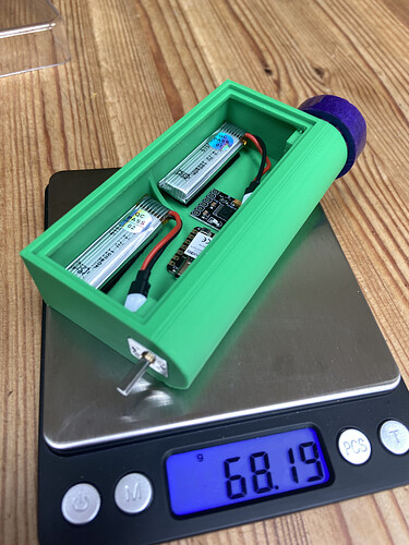

At the moment we are planning on making a 2-wheeled ant-weight, with a servo based grabber and a dustpan style scoop at the front.
Here’s a few pics of our materials and tests so far…
1000 rpm Nuts and Bolts N10 motors from BBB

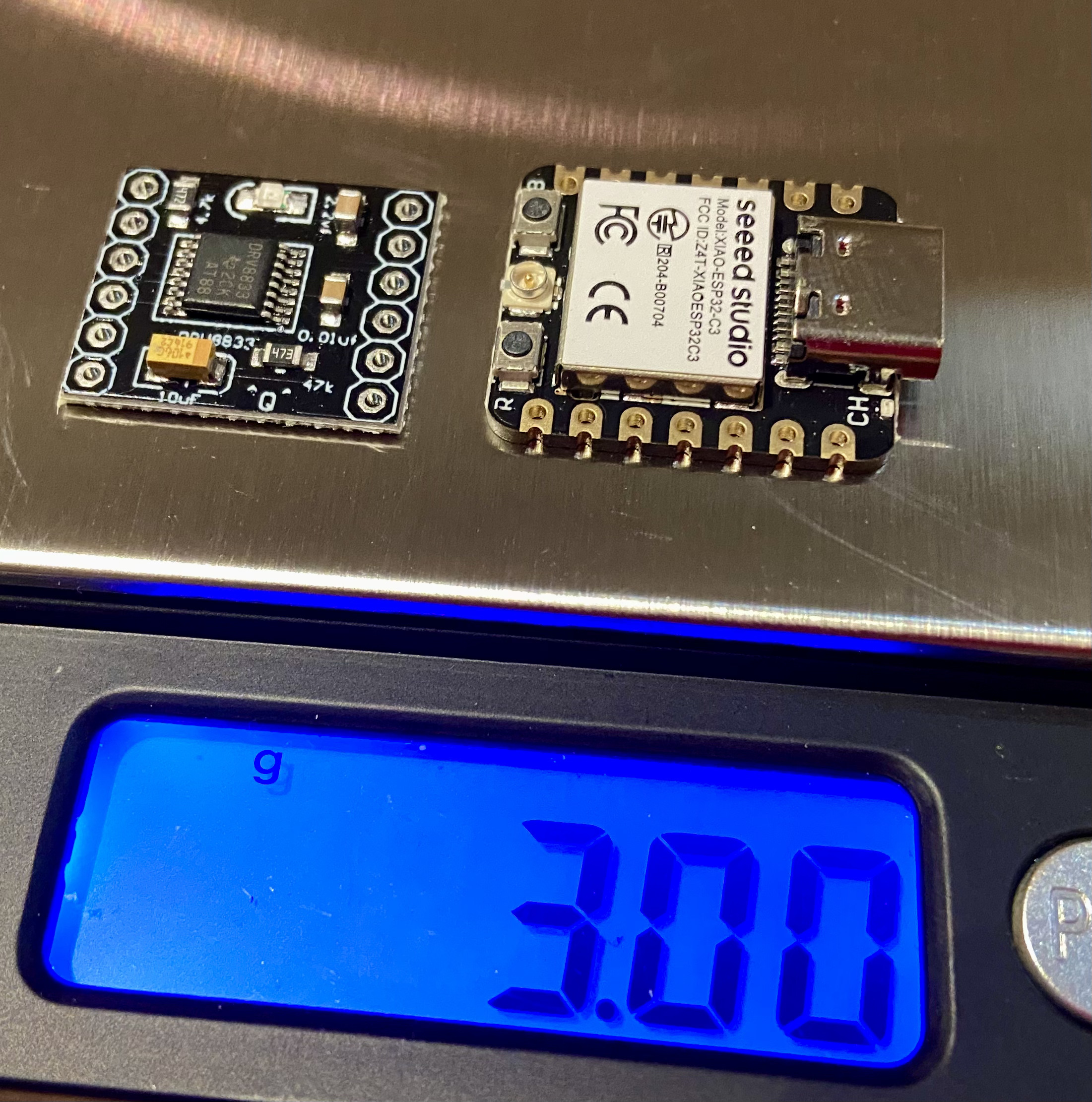

SEEED Xiao ESP32C3 Microcontroller and DollaTek DRV8833 DC Motor Driver

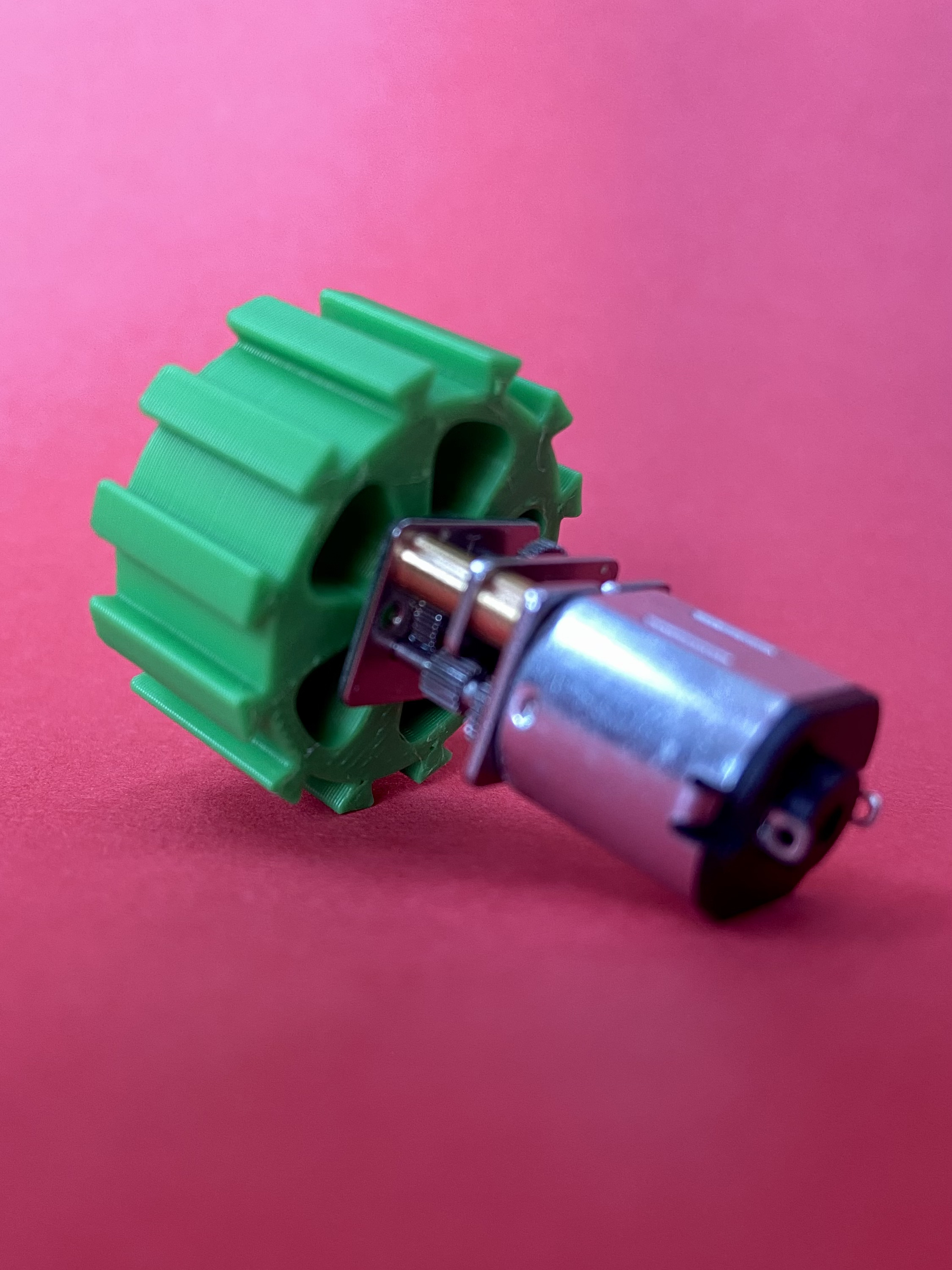

Test fit of a PLA wheel hub design

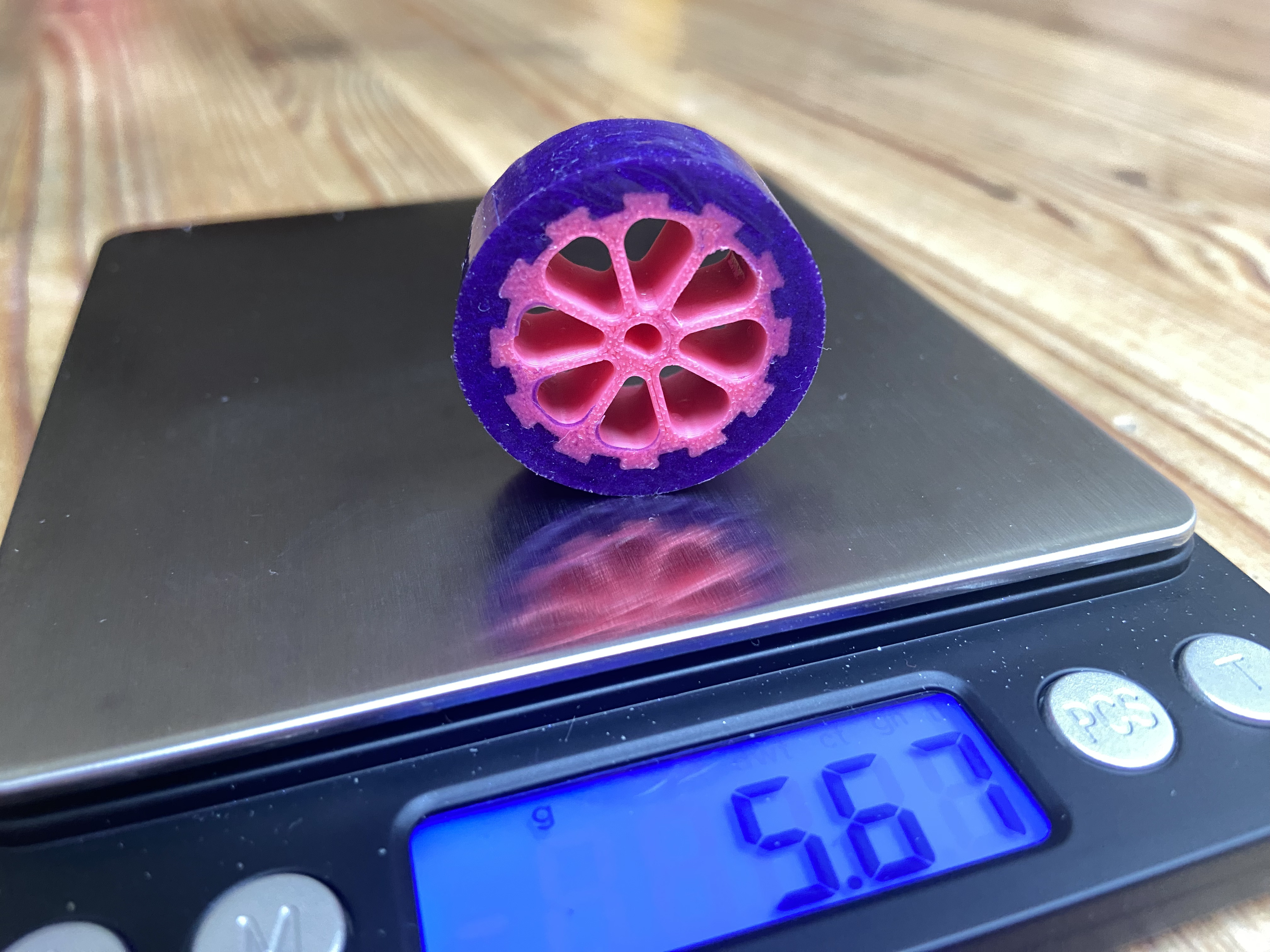

PLA hub with Duroflex 40 PU cast tyre (With added purple mica powder for extra bling)

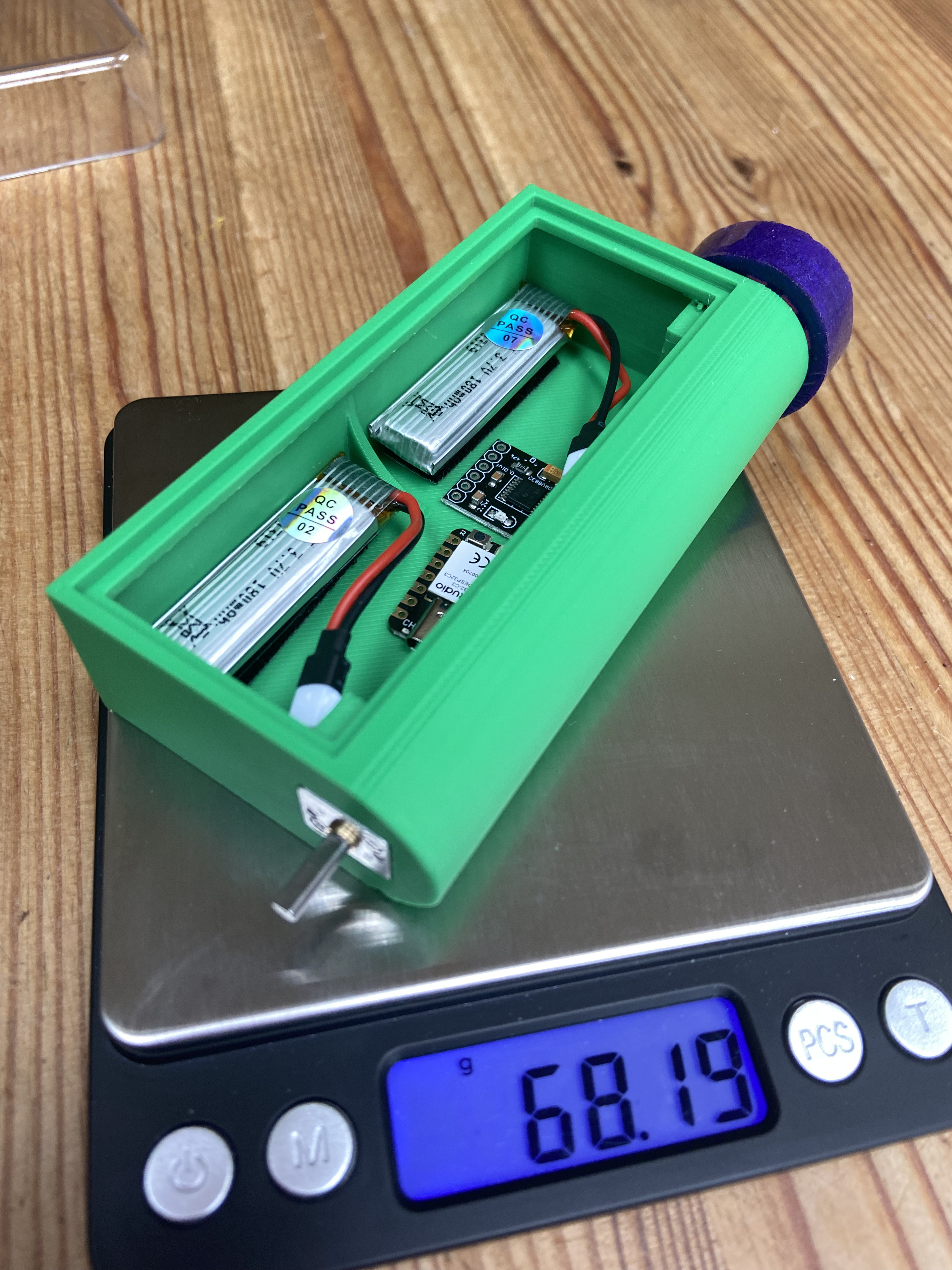

PLA prototype chassis with integrated motor mounts
…That’s it for now, feel free to ask any questions about our plans, thanks for reading!
Looking good! Are you going to design your own controller with the ESP32?

Oh amazing! That would be great, would be good to get some experienced eyes on it once we get it running. We have a basic sketch working with the ESP32C3 as a receiver, and we can control both motors and a servo with an XBox controller. I’m yet to implement the fail safe, but the Bluepad32 library has a function called on disconnect, so that should be trivial. Lastly, I’ll need to look into doing some mixing for the drive. I personally quite like tank steering, but I think my kids would probably find it more intuitive if they could drive about with just one analogue stick. Would be nice to build our own controller, maybe one day we will look into that, but for now we will just use the XBox one. Just waiting on some SMD voltage regulators, then we can get the electronics all wired up to the batteries, that should give us a better idea of the final weight for the electronics. Think I’m quite happy with the wheel design, they are not the lightest, but since we only have 2 of them and they have 12mm wide tyres, I’m happy to spend that weight budget for added traction (hopefully). Still mulling over ideas for the servo placement and the dustpan design, so plenty of things to work out yet!
