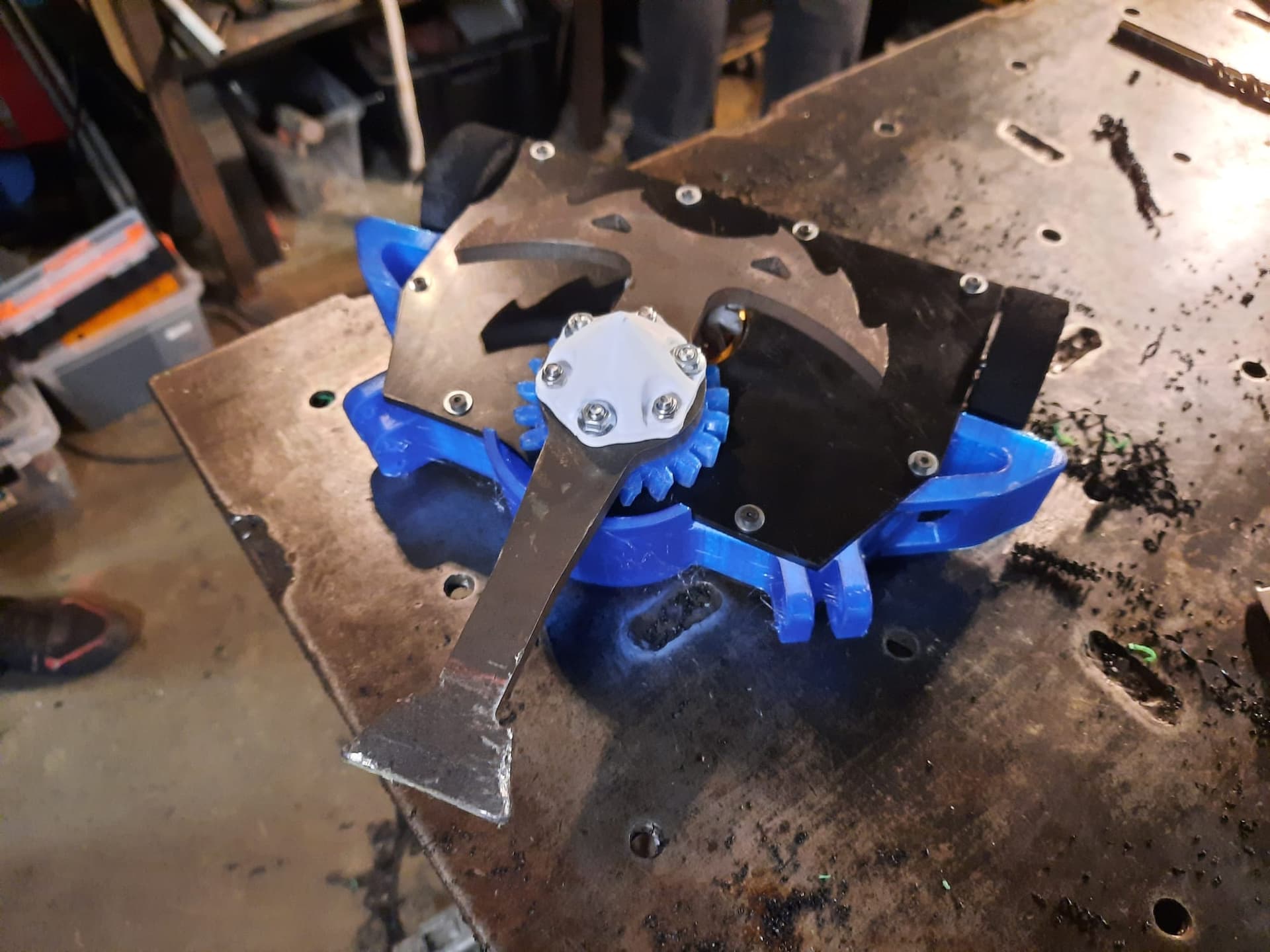

So we made a choice to go gearmode. 2 TPU gears would make it all go spiiin.
After this, i just wanted to keep it simple. I didnt see need to go Brushless on this, A. cuz of the weight the marses bring. and B. Its a big piss off weapon, it doesnt need to push (or not intended to need to)
For the top i went for some 2mm Titanium, mainly to make sure the weapon stays on. and a 4mm HDPE bottompanel for weight.
The Weapon stackup is a simple (from top to bottem) Weapon, Spacer, Gear, Shimmy and Thrusterbearing. 12mm shaft which is attached to a hexagon standoff and that has a bolt through the bottem keeping it in.

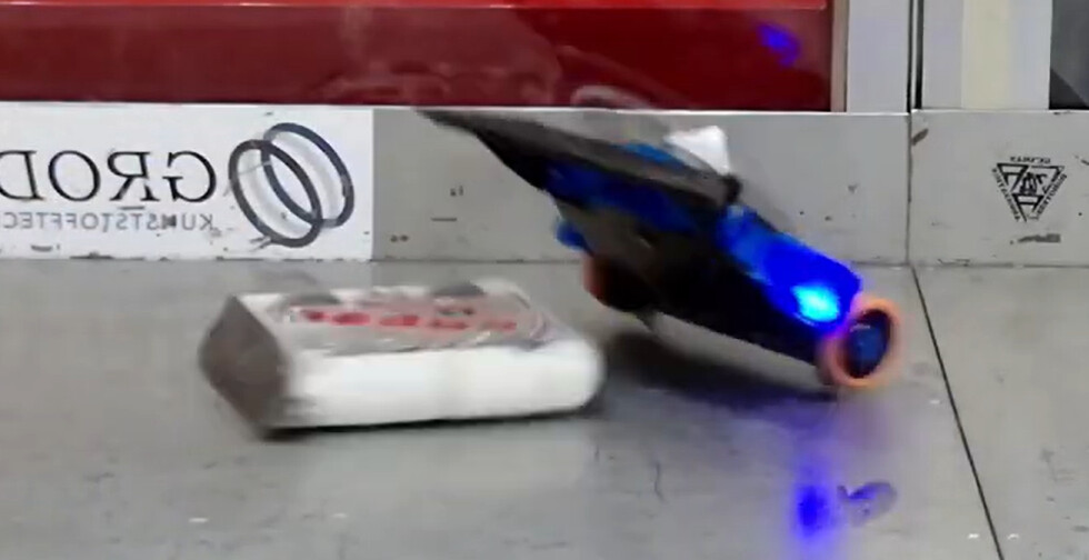

Fight 1: Ernie VS Missamphetamine
Missy in short, was not that happy. the weaponblade that was ment for it, didnt come in in time, so we lend our weapondisc. but it worked enough. just it had to fight Ernie.
Collision
So as this was ernies first fight, i was scared bout it exploding. instead, it exploded the opponent. in the 2nd hit i got, iirc the link flew out, a side panel went and just was a crazy big hit.
Collision part 2
No damage after this fight for me, well, maybe some new pants.

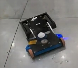

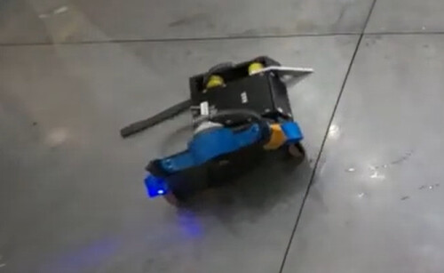

Fight 3: Ernie VS Lumera
So that guy with Missy had a 2nd bot, Lumera, which is Missy working basically.

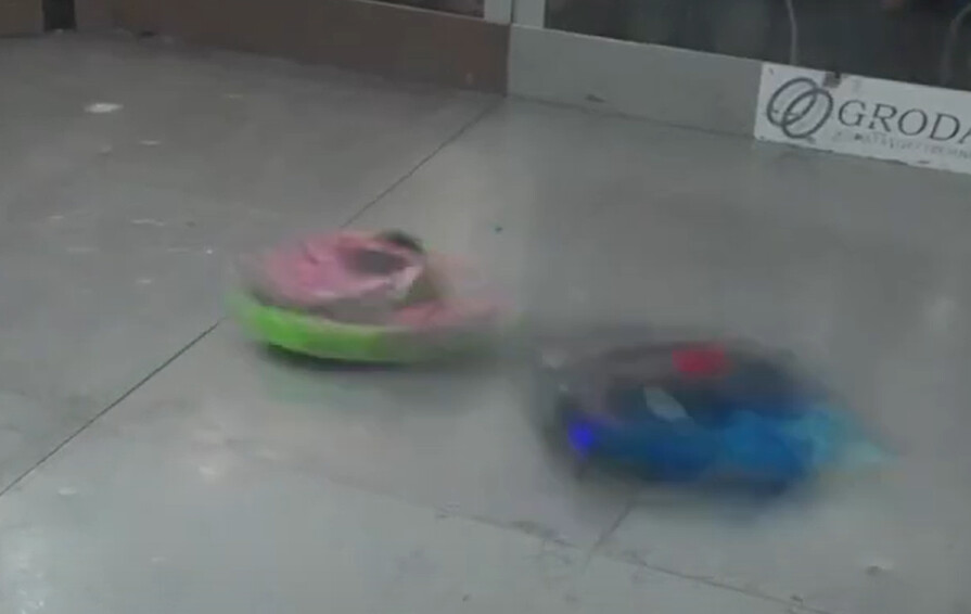

pictures taken moments before disaster
In my infinite wisdom, i decided to try an slower spinup to save my printed gear a bit, since i only had 1 spare. and ofcourse, i got boxrushed.
Not ideal
after being flipped, he kinda hit me to try and self right me. and then my link popped, and after 1 more hit, that was it.

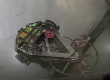

Fight 4: Ernie VS VectorClassic

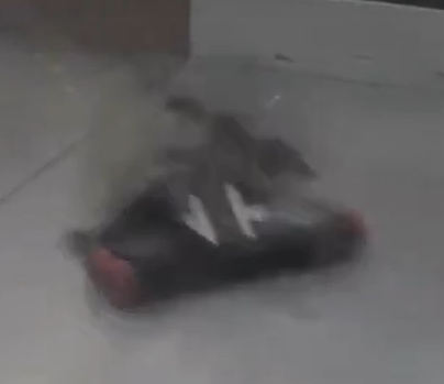

My face when horizontal
So Vector is a horizontal, the counter of my robot since you can park a bus under the weaponbar. basically, to put it simply, everything went wrong.
totally to plan
So first the link got hit, then both wheels said, no and just fell off without interferance.
To quote Daniel: Stop spinning!
after this fight, i reattached the wheels, link and fixed a motor that was slightly no longer straight. i also changed over to my spare motor gear.

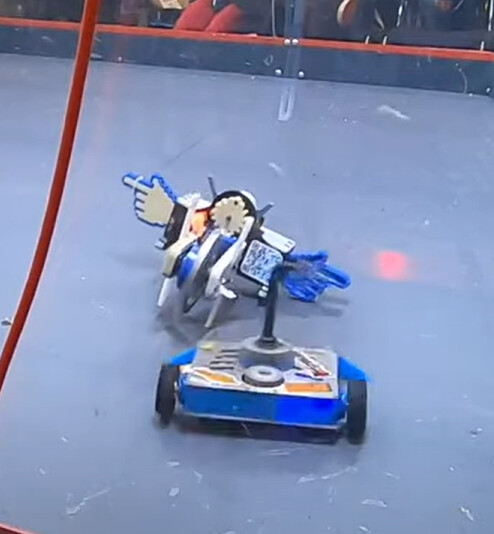

Fight 5: Ernie VS Touch Grass
For this fight, i decided to put on the biiiiig weapon. and since i didnt have the right wingpieces. it was even heavier then intended.
Touch Grass is one of the most annoying bots to fight, its really not allowed around the school. those forks are like 30cm.
Not ideal
Fight started as expected. i was on the top of Touch Grass. not where you wanna be when you got a biiiig spinny weapon. But luckily i got a hit off on touch grass. removing a whole wheel kenny, and bending a fork.
You can see the twisthubholdywheelybit flying
Afterwards i got 1 more bigger hit. after that, the weapon started slowing down, i noticed the teeth on the gears were now kinda blunt and not ingaging (tpu gears moment)
queue the fight becomming a pushing match with a cripple and a robot with a big heavy weapon on the top
Ernie best control bot

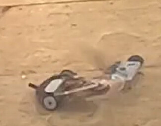

Not much to this. i fell over
Damn you physics!
after the fight i did find out, i forgot to bolt the bottem panel in propperly. not that it matterd, but, it did add to being kinda a sad round for me.

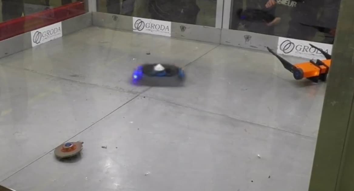

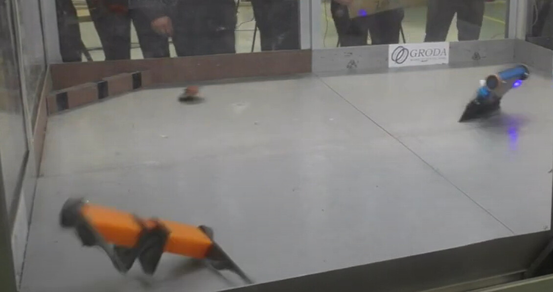

Fight 2: Ernie VS Cueião
I had to fight the Brazilians with their robot. so happy it isnt a brazilian drumspinner.
See, they can make kind bots too!!
for this fight, they stuck on the lifter config, probably since the hammersaw wouldnt do much to a big spinning mass.
on the first hit, he tried to lift me and i chopped off his lifter
the lil stump
Afterward i got a massive cross arena hit. which is what ernie is ment to do!
Ernie likes to float in pics
After many more solid hits, i became a flipper and flipped him over. and he tapped.

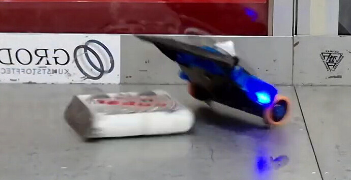

Fight 5: Ernie VS Knackwurst
A rematch where this time i cant accidentally reverse the weapon!
It started with allot of me trying to not get pushed into the wall and trying to hit him.
Helicopter Helicopter
after some nibbles slightly bending the sideframebits of Knackwurst and lots of gyro, i got a massive hit very banana ing the hardox catchy things on the bot.
after that, i got driven into the wall, shot accross the arena, and in that hit, hit my weapon motor and broke it. with no real weapon left, it became another pushing match and simply won.
Very banana

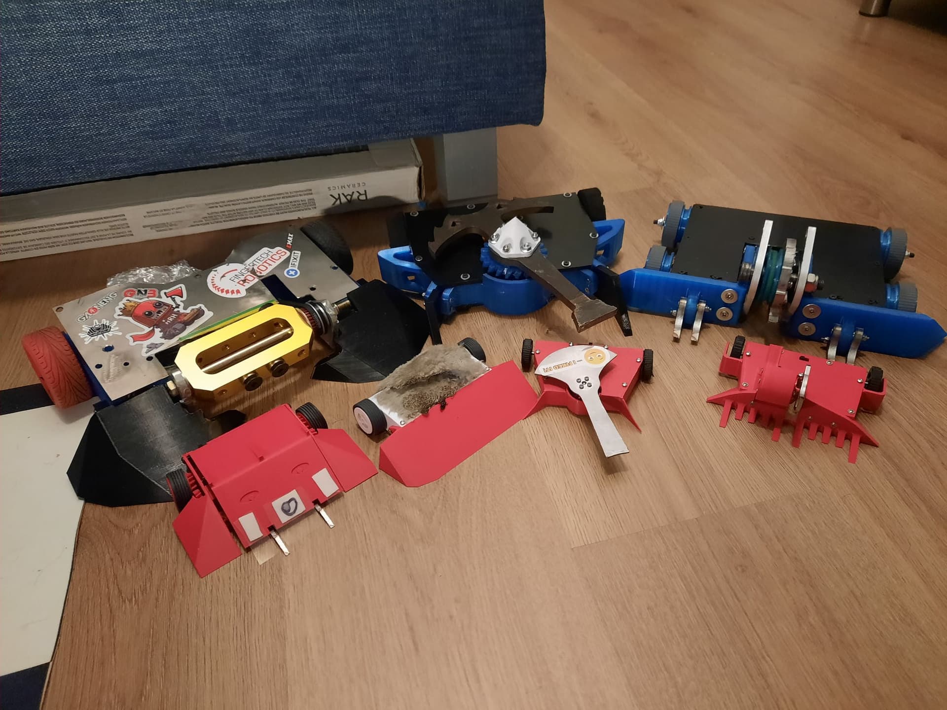

All bots were a little ruined

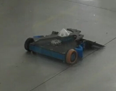

Ernie had minimal changes. the front was slightly changed to make it that i could maybe lead people more into the weapon, and last minute we changed the weapon shaft for something less flexy.
Fight 1: Ernie VS 7th Circle VS Baba Yaga
Going into the event, ernie didnt enjoy spinning up, so it was a question if it would work propperly.

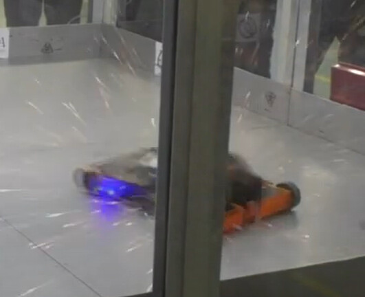

Fight 2: Ernie VS Die-Fi Hotspot
From all the bots there, i did wanna fight Die-Fi, mainly cuz i wanted to see the bang, so i stuck the biiig weapon on. and holy, we got that bang.
Pictures taken moments before disaster
ooooooooooh pretty sparks
after this hit, ernie wasnt happy, at all. weapon brokey and i had to fight a bot that was basically all weapon. luckily, die-fi went towards the pit. i pressed it. and after some but clenching driving to not get hit. i pushed it in. breaking the pit for a solid 15 mins after (sorry gareth and joe)
The bar was propper banana and unhammerable. so it was back to the trusty 1 tooth.

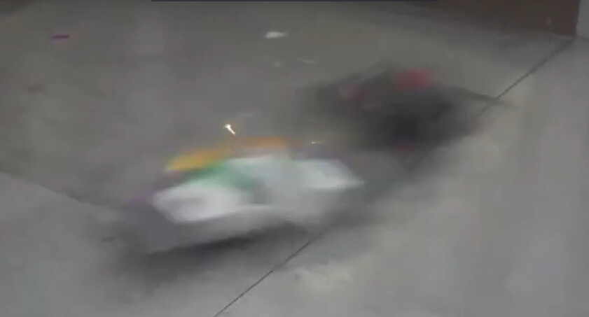

Fight 3: Ernie VS Jackhammer
I like the new jackhammer, ive seen it evolve and its become hotter every time.
and the fight was a simple, i fell over. i span down, which isnt good to do haha
nothing more to it, it just fell.

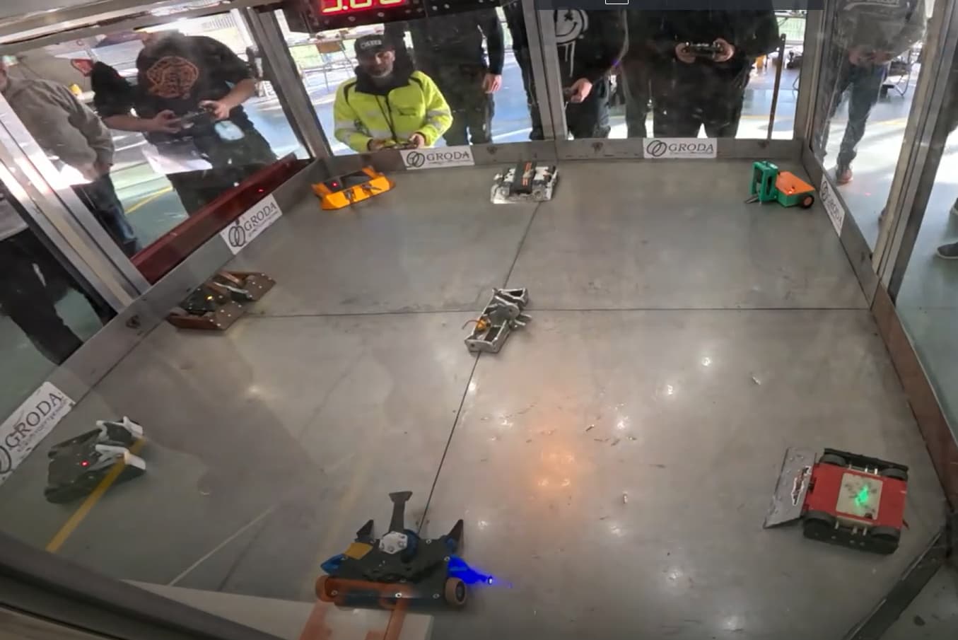

Fight 4: Ernie VS Digestive VS Kairos VS Monterey Jack
My only request was, let me spin up. at least at some point i started to. when it was up to speed, i hit digestive, and flipped it
Sparks!!
afterwards i got some hits on jack and ripped away its back grabby sticks and a wheel hub protection thingy. then when jack wedged Kairos, i got a hit on the wheelguard
Teamwork makes the dream work
Queue me ripping apart kairos piece by piece. first a fork, then the saw and then a motor falling out
its fiiiiine
after this, i had some smaller hits on jack, and then a massive one which send me near the pit, with one wheel hanging, i fell into it.
insert Dr eggman meme here
Even tho i lost, i still ruined a bunch of bots. and yes sam, this is what ernie is ment to do :stuck_out_tongue:

Fight 2: Ernie VS FUBAR
Fubar is a brick, thats it. it just doesnt die. i dont know how, but it just doesnt. so all i could do is hit him, and hope somehow something breaks.
SPARKS!!!
The fight was basically, me grinding away at the wedge. and him pushing me into the walls.
Ernie gyro moment
And then, it happend, Linkmoment! it fell out (probably from the slams). with this tough loss (which was expected). it was time to get ready for the next
I know whats wrong with it, got no link in it
Fight 3: Ernie VS Vertpilled Bitemaxxer
Now this was the fight i wanted when i got to Bochum. Biiig fuck off vert vs biiig fuck off hori. all i knew is, this would be a bang.
We inched closer to eachother, both at top speed. first we had a smoll touch, and then.
stupid pillar getting in the way
oh no
Oh No
OH NO!
oops
We had a massive hit, after it, Ernie was still moving, and Vertpilled was flipped over and without the weapon. the hubmotor became a minibot and skedadled outta there.

Fight 5: Ernie VS Eisenschweinchen
Another bot i wanted to fight. this thing has a 3mm hardox front i wanted to touch. aswel as it being a cool tracked robot. alas, when we met in the centre, there was an issue…
never imagined the new ernie being too tall
i couldnt reach him! when he did lift his lifter, i took it out, but after that it was allot of trying to hit him but not being low enough. luckily and somehow, i clipped a track of his and then did some acrobatics and took him out.
Sometimes, the wall is your friend
Ernie is also a facespinner

Fight 6: BONUS Rumble
What the chassis doin’
This rumble was just, chaos. ernie died like 3 times, but i got saved every time (thank you) and the proceeded to cause more chaos and break bots.

I just wanted to hit em and create maximum chaos (as i want with every ernie fight).
ErnieAir, Flying since 2024
There were some solid shots during the fight, and both just simply kept working. i was also totally gunning for the arm

Ernie Said: i go up
And it was lots of big hits. some roof too. but ernie kept working, well at least untill it just stopped working for no reason. i dont know what killed it, relinking it fixed it.
Somewhere in that blur are 2 robots

SPIIIIIIIIIIIIIIIN
-Ernie during a fight in Endhoven
A little bonus from a vid from @TeamPanoramic from BBB Champs 2024
Frame 1
Its Fiiiine
Frame 2
Oh Crap
You can see a slomo replay here
