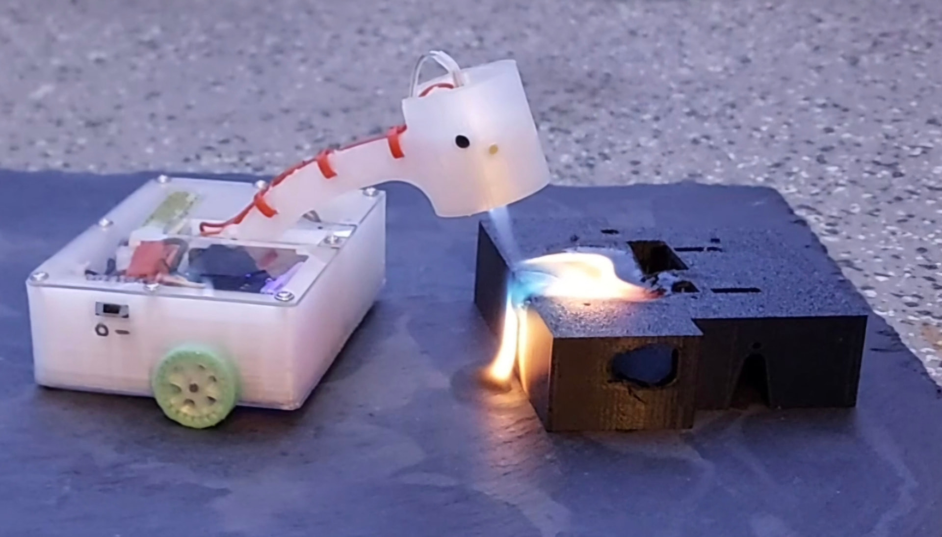

On request and with special permit after review we allow thermal weapons for antweights on certain events in Germany.
Therefore I present my latest creation “Glumanda” (German name of the pokemon “charmander”)
Processing: 1000049435.jpg…
Hmmm. I seem to have difficulties with uploading pictures.
This and the picture not uploading adds a whole extra level of suspense and fear! Look forward to seeing what you have built.
I’ll just leave the link to the picture gallery in our own forum here:
So finally here is a picture of my flame antweight “Glumanda”.

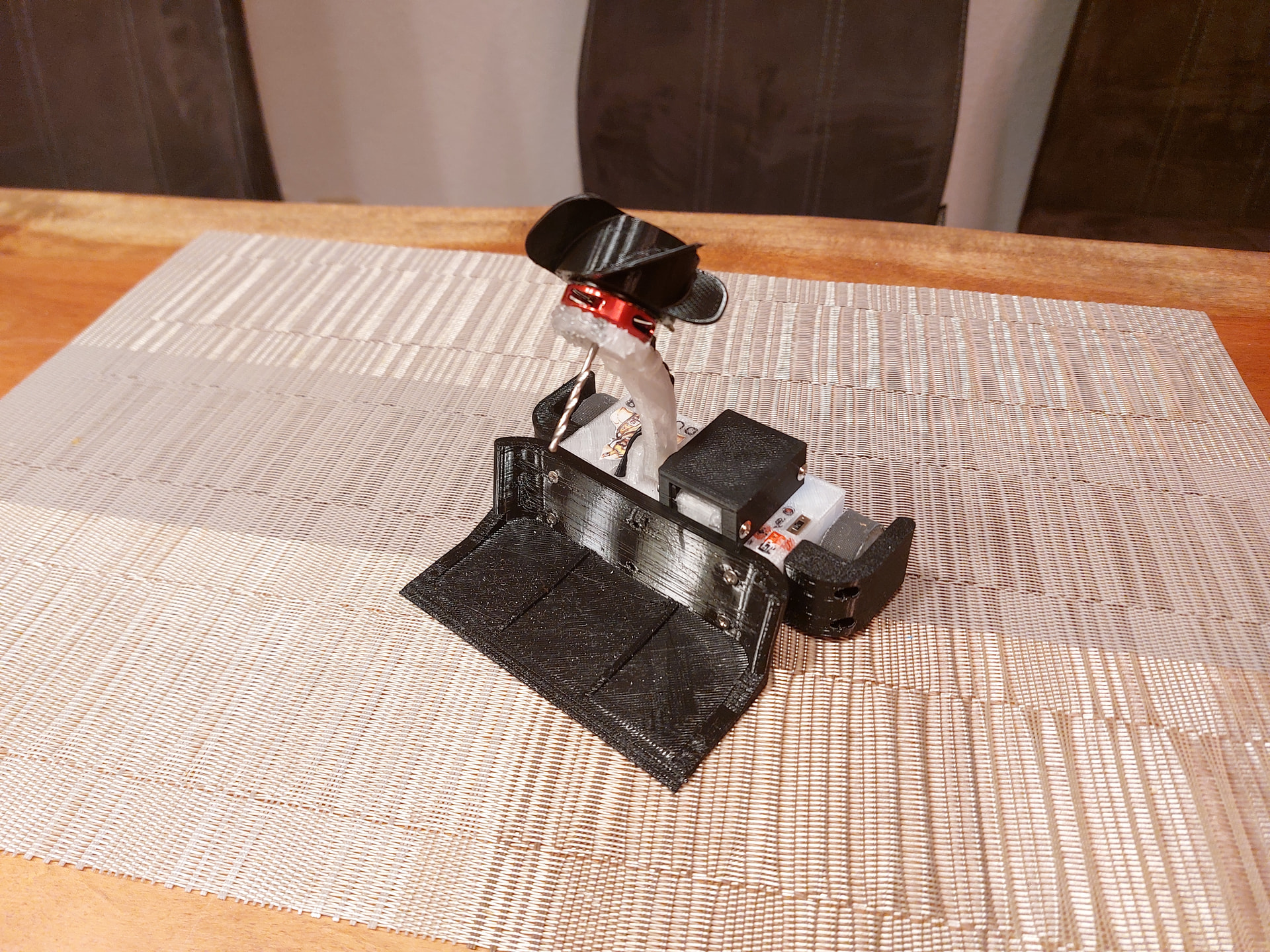

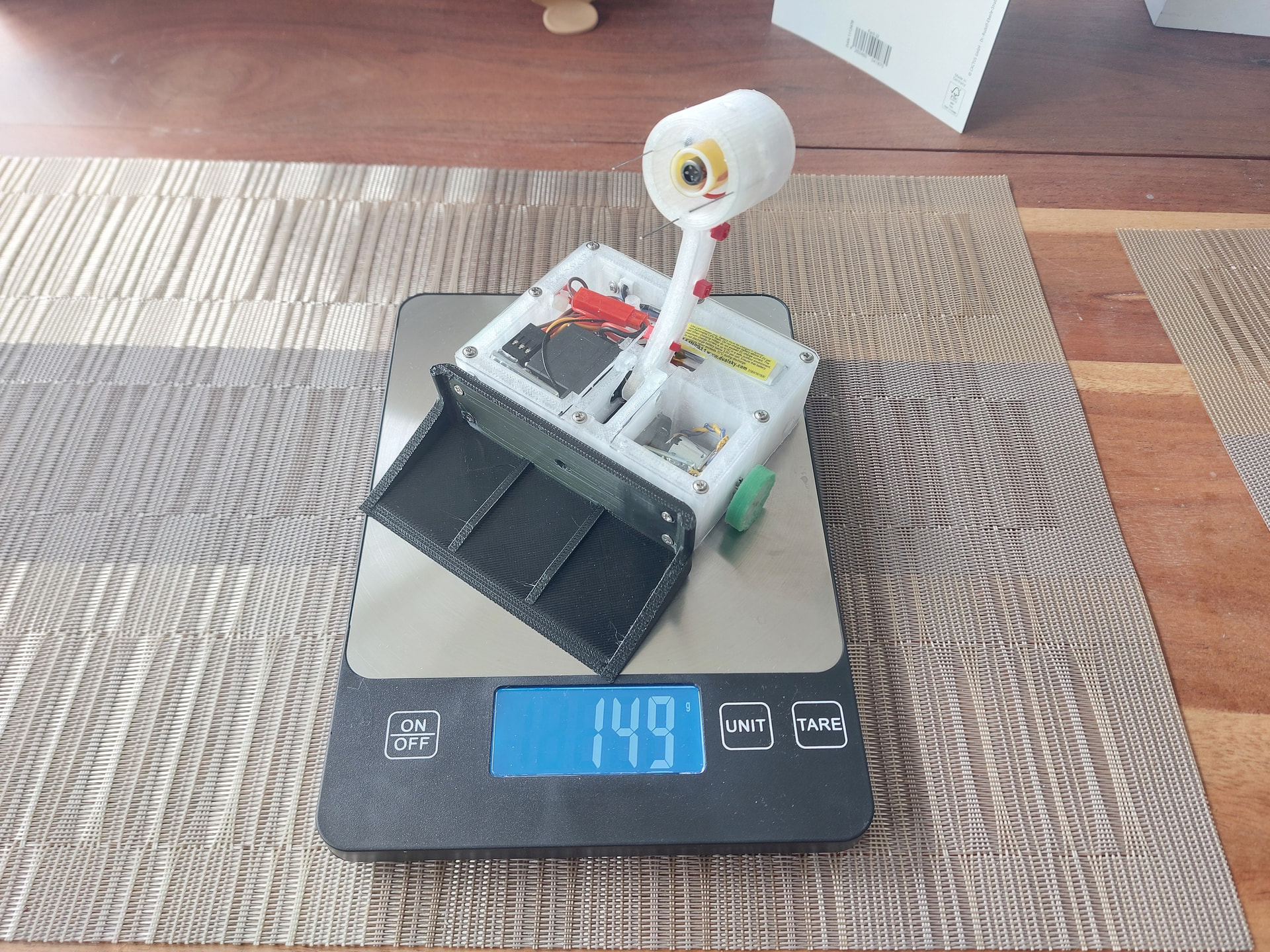

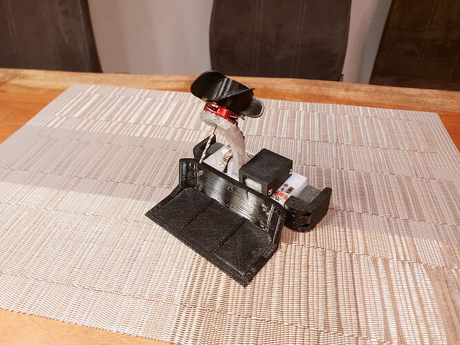

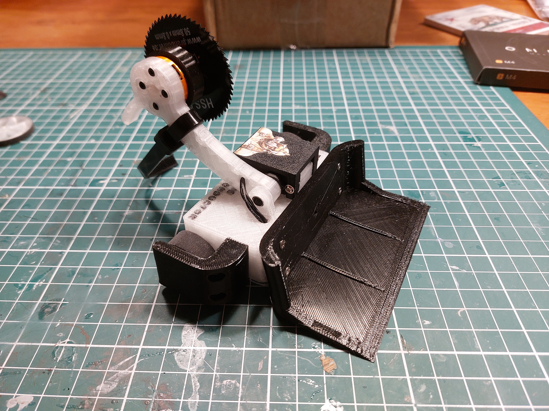

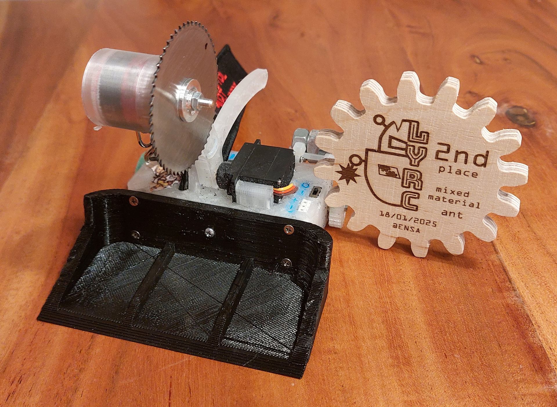

In the meantime I also made several modifications to The Conductor.
This is how it looked roughly a year ago and won 2nd place in Luxemburg:

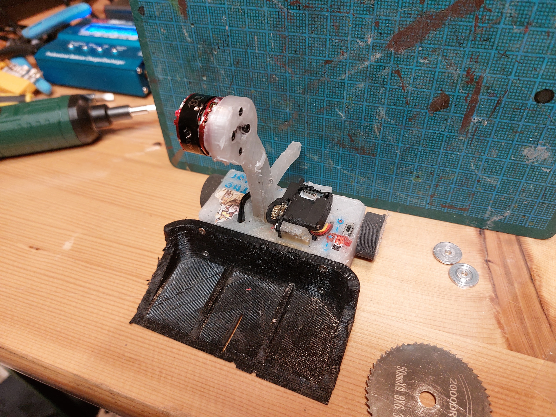

In december it got pretty beaten up in Chemnitz. That servo actually still works. :face_with_crossed_out_eyes:
And the following version will be taken to Luxemburg again on the coming weekend:

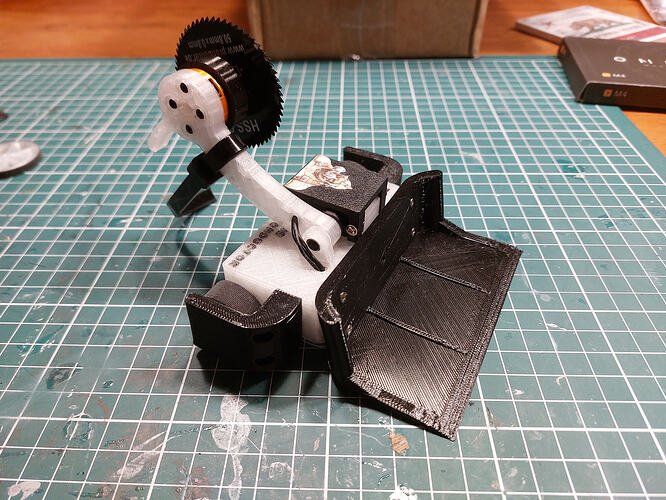

I also made a drill version of it:
The funny propeller fins on the weapon motor of the drill version are protection for the motor as well as a self-righting mechanism. The bot can actually blow itself back on its ‘feet’.

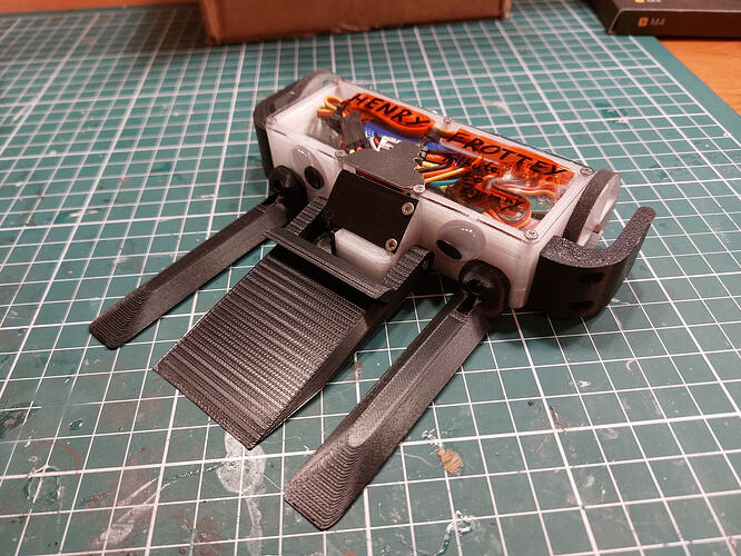

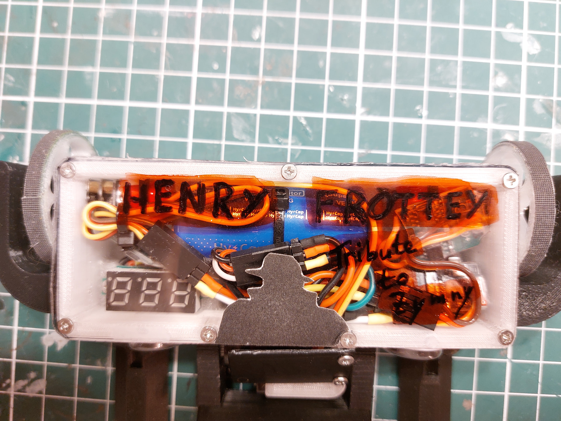

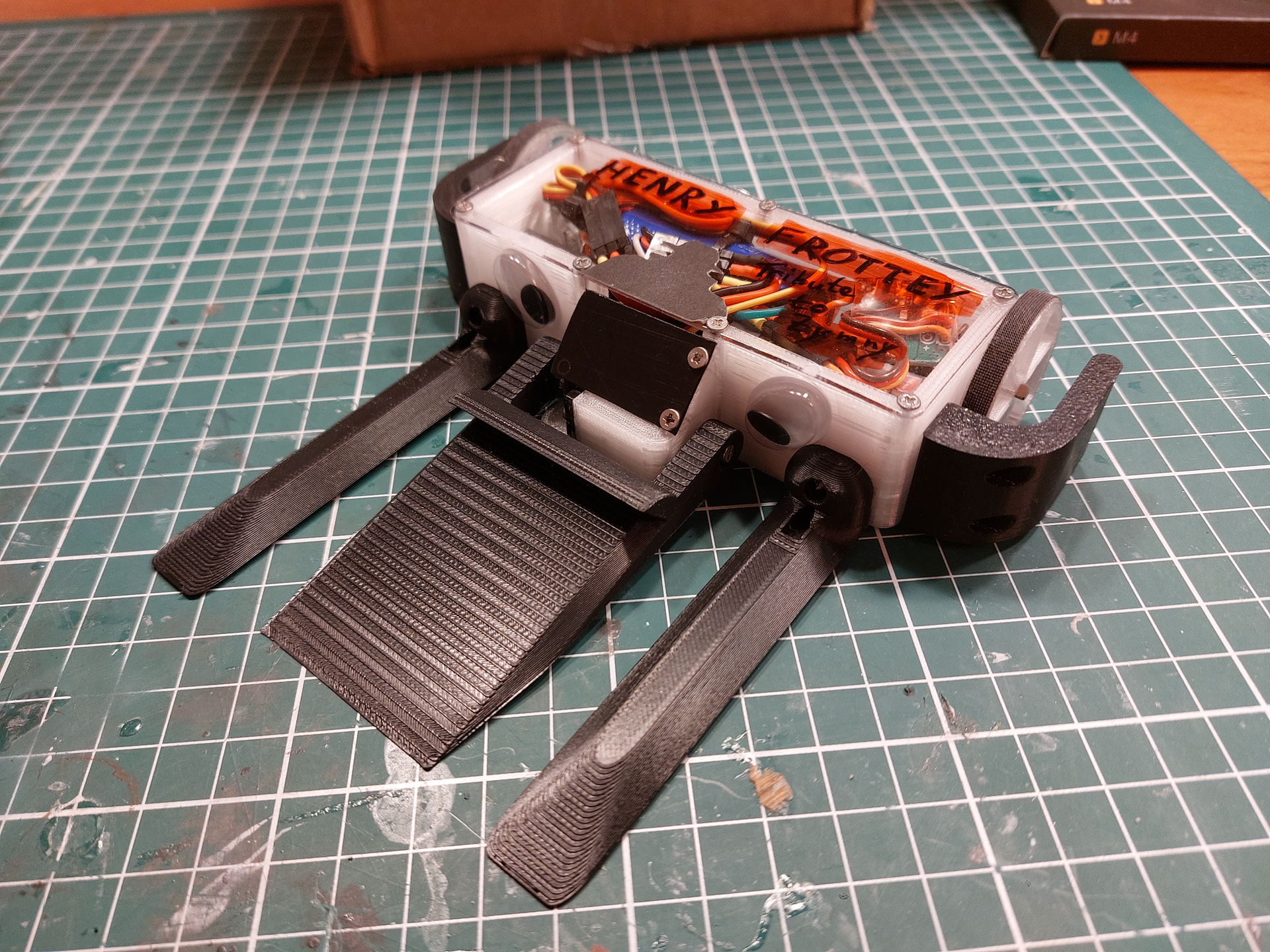

The latest thing I built is a new supercap powered ant, called “Henry Frottey”:
The name is a tribute to the German comedian Jan Philipp Zymny.
He wrote a book about a detective called “Henry Frottey”, who is always angry about his name sounding like towels or other stuff made from frottee.
In contrast to the previous supercap bot, this one runs on a single 100 F cap only and I boost up the voltage to just 5 V.
The current version with the strong 1000 rpm N10 motors only lasts for ~2 minutes under load (shoving stuff around and using the lifter). For the upcoming event in Luxembourg this is not an issue as fights will only be 2 minutes. For other future events I have to try different less current-hungry motors.
