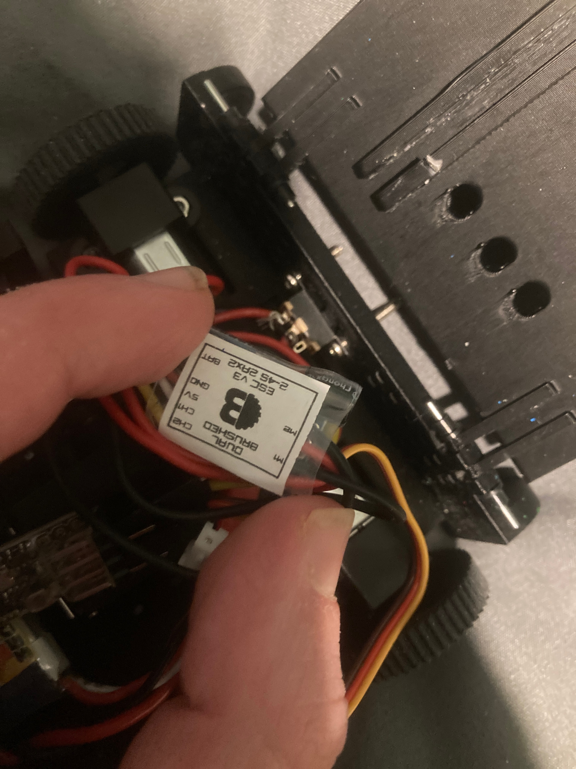

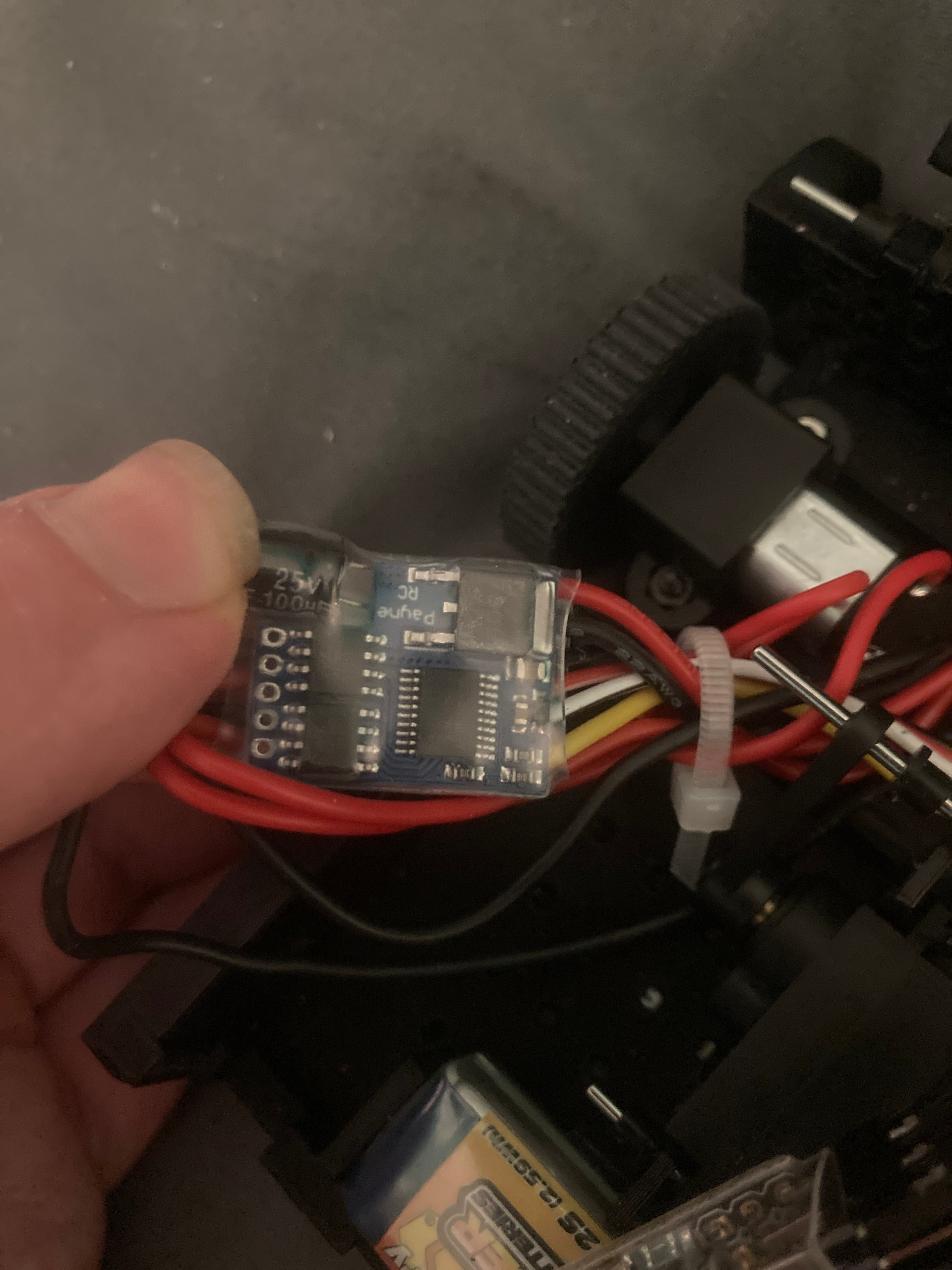

The two pics below are of the speed controller of his robot, clearly proving that it is the one pre-soldered and encased, which is the same one as mine, which doesn’t have this issue. If resetting both the model and the factory settings, rebinding, reversing channels, and changing elevation don’t work (I could change sticks mode) what other ways can correct the problem, not present on my robot but somehow present on this one, short of swapping the yellow wire and the red/white/black one on the receiver or flipping a motor over?
I think the pads the kind above posters are referring to might be under the white label under the heat shrink Leo. You might need to trim it back.

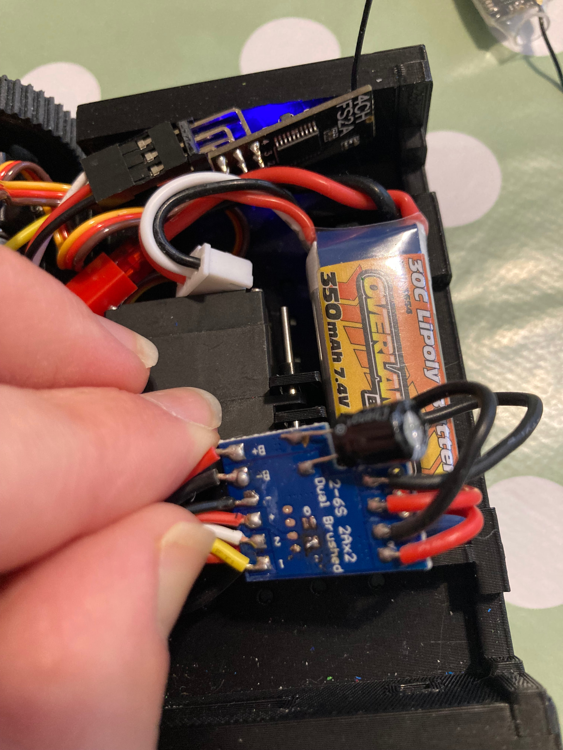

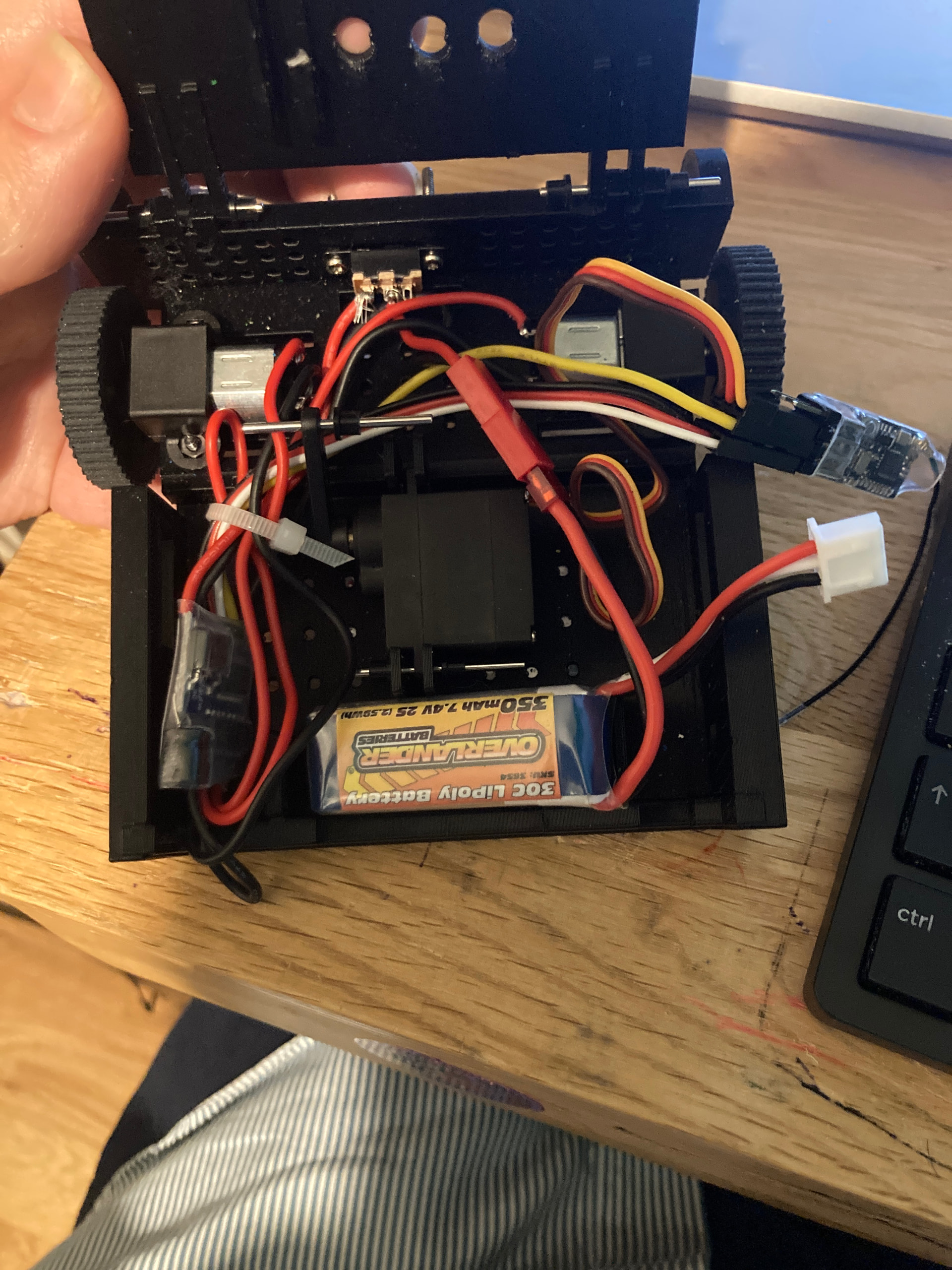

Above is how it looks now. It does move when I move the left stuck up and down, and does spin when I move it left and right, but it also spins a bit when I move up and down, and the best way for linear motion is to move it diagonally. What else should be done? Would it now be for me to solve Elvn and Reverse modes?
Elevon isn’t actually required unless you have ESC mixing off.
(edit: accidentally called it Elevron :joy:)
