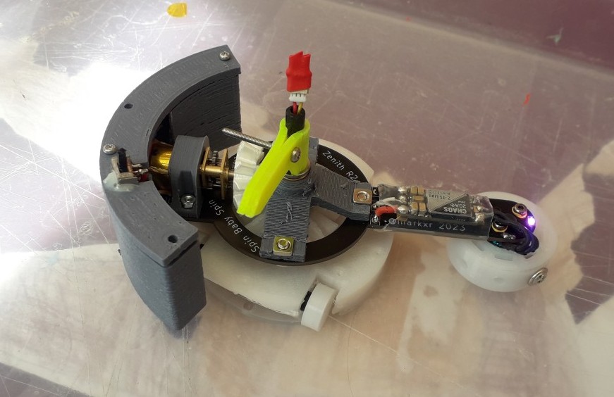

This is Zenith, which is my 150g horizontal-spinner-mounted-on-another-horizontal-spinner.
The robot is in two independent parts. The lower part is a driving chassis with 1S battery, Malenki and 4 tiny Aliexpress 6mm gear motors. It has a bevel gear incorporated into the chassis, the gubbins is accessed from the bottom.
In the centre there is a 5mm carbon fibre rod, which has a pair of wires going up to the removable link (red thing at top) which switches the power for the chassis.
The top part is a structural PCB, with various 3d printed bits and a pair of thrust bearings to make it rotate smoothly. The grey box contains a 2S pack (actually 2x 1S cells wired in series) and a power switch. There is a fs2a receiver, N10 to drive the arm around , which drives a 2nd bevel gear.
The power then goes through tracks in the structural (not just structural) PCB into the brushless ESC you can see, and drives a tiny 1104 brushless motor mounted on the underneath of the arm (like an undercutter)
The yellow thing points in the direction of the chassis, because it’s difficult to tell otherwise when it’s spinning.
It has been out twice, in 2023, and not won a single fight. although I did get “most original” at the AWS in Gloucester.
I could redesign it now to be much better, as its design was significantly hobbled by the (then current) 4 inch cube rule. It is significantly underweight.
