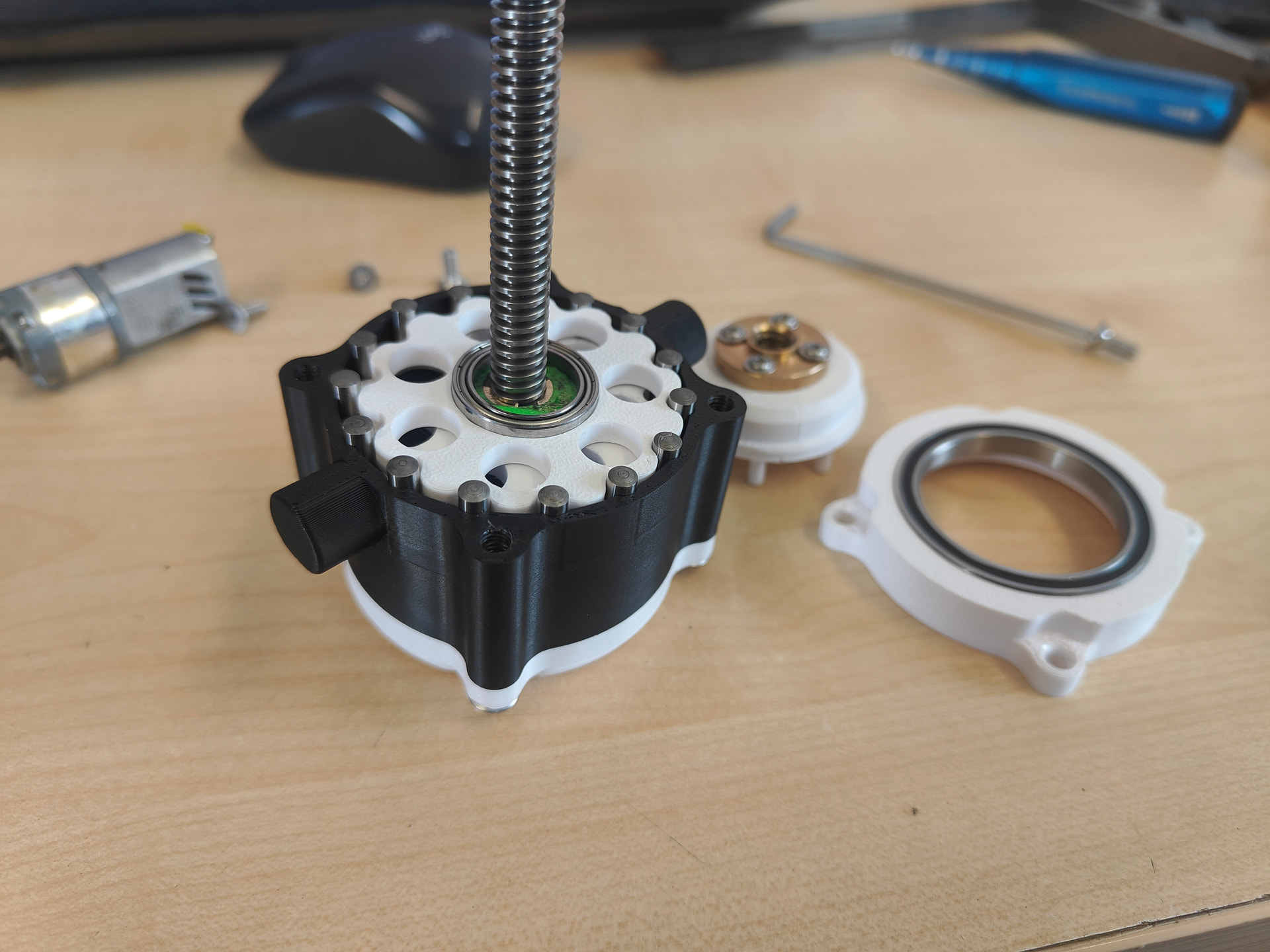

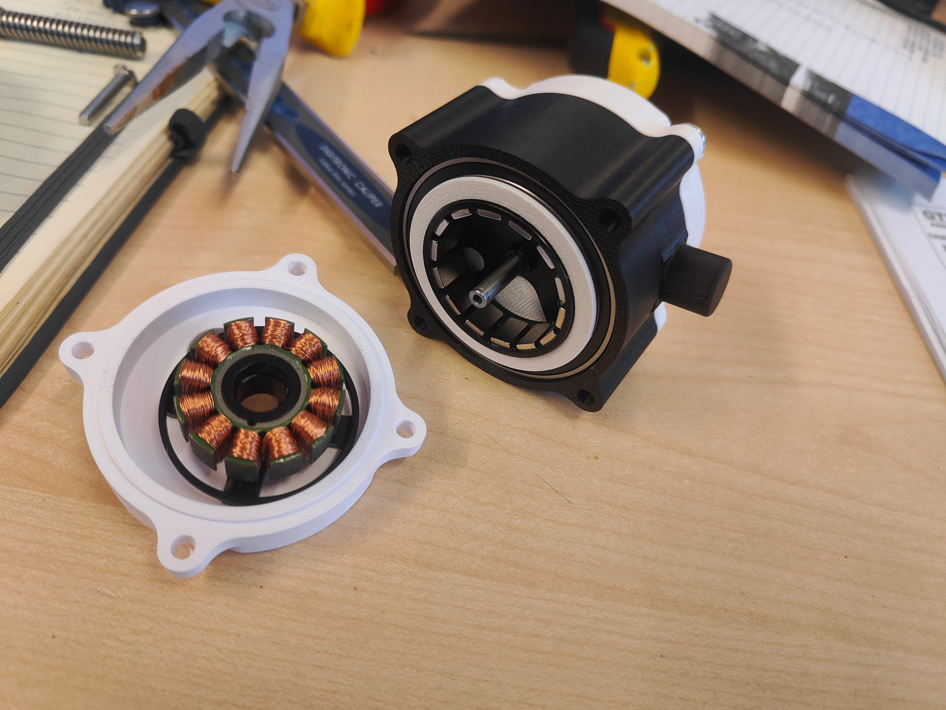

And just like that we have a prototype. 35mm AliExpress drone motor cut and bored with a bronze bushing (not pictured) shoved in the centre of the stator. The can has a hub which then mates up to a bearing which locates onto a lip on the stator mounting encap. That preloads and spaces the whole assembly without it being too sweaty or technical.

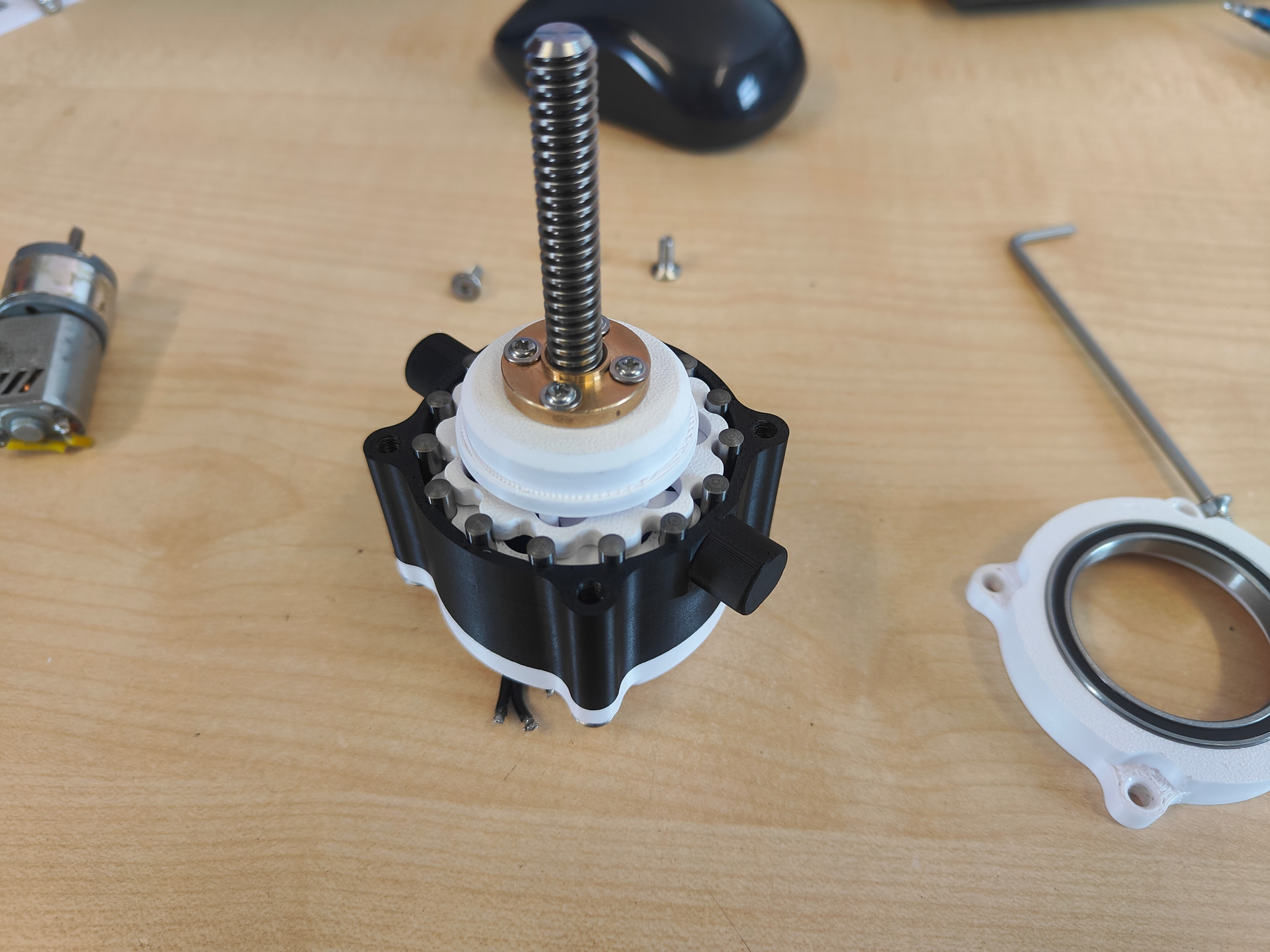

Just in case it wasn’t clear how it all goes together there are a ring o’pins which are retained by the central portion and the front end cap.
The output is plopped on and the endcap holds the whole shebang together like a family
