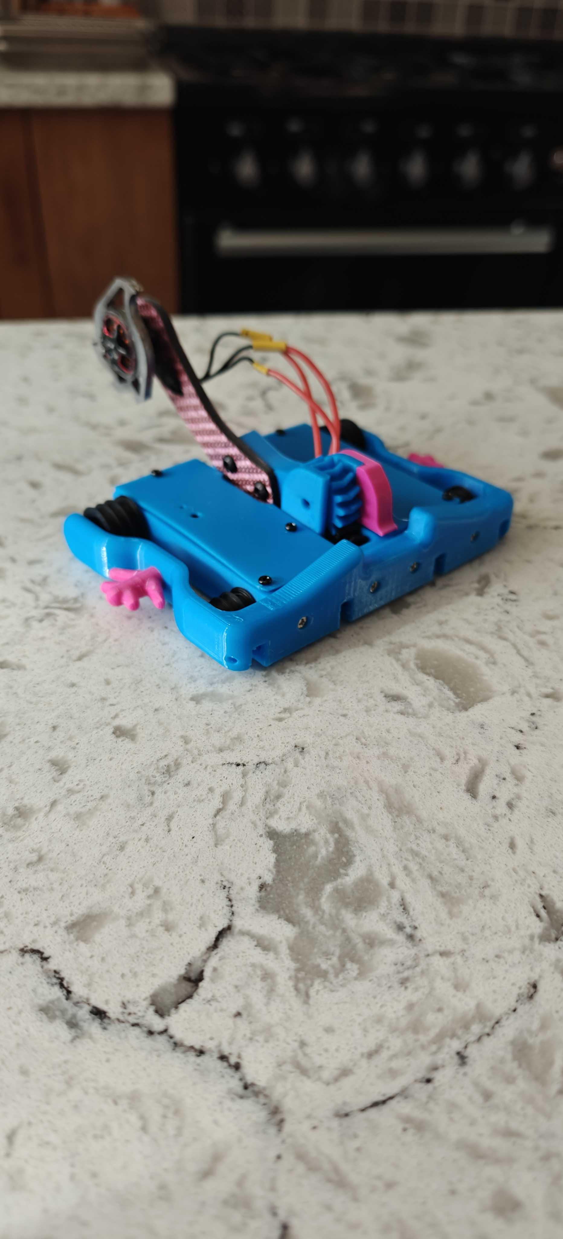

Landmine 2 is fastly approaching and I’d like to take this opportunity to document it’s current progress.
For those unaware, the robot is a 200mm, 4S, Walking undercutter, having recently caused quite the stir up from the tip speed, with a theoretical 984mph tip speed. Very epic :slight_smile: (Will discuss at the end on this specifically)
So design wise, the big change was the shuffling pods. I haven’t really tackled non-roller style movement, but have been pretty eager to try.
Voltage was a pretty deciding factor into electrical setup & subsequent design of the walker, not wanting to do the same micro BEC step down setup used in Landmine 1, decided that a full brushless system was the move, plus it’d be able to get some pretty high RPM.
Premise wise, it’s rather simple. 1404 motor runs a spur gear to another gear on a 2:1 ratio. Which turns the subsequent CAMs inside the bearings and then the legs. The motor itself is recessed into the printed mount. Which then has heat inserts on top to allow for the frame to screw into. I was pretty worried about the lack of smoothness with the walking mechanism whilst this thing is spinning, so I’m hoping the bearings provide a nice smooth transition between legs.

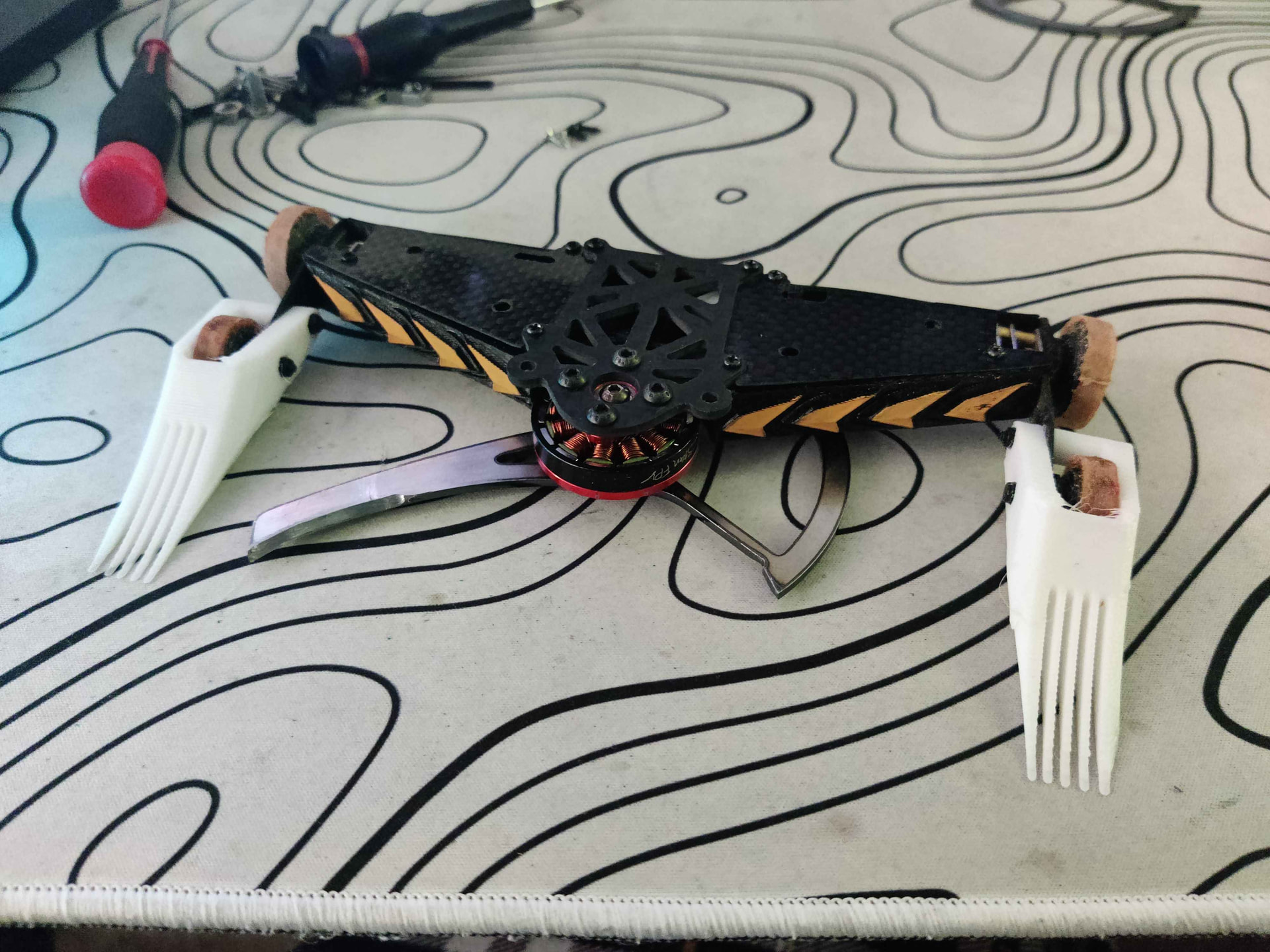

Frame wise. It’s largely the same principle. Big CF thing, with shit ziptied/taped to it. It worked surprisingly well last time. But decided to up the thickness to 3mm, rather than the previous 1.5mm
The motor on the previous Landmine was a 2204, 2300KV Gartt. Normally a pretty fucking beefcake motor for antweights, but on this robot, it was struggling a bit on the spin up. Upgraded to an StanFPV 2604 2410KV motor, which I’m hoping, along with the additional voltage, has enough torque to get this weapon going :smiley:

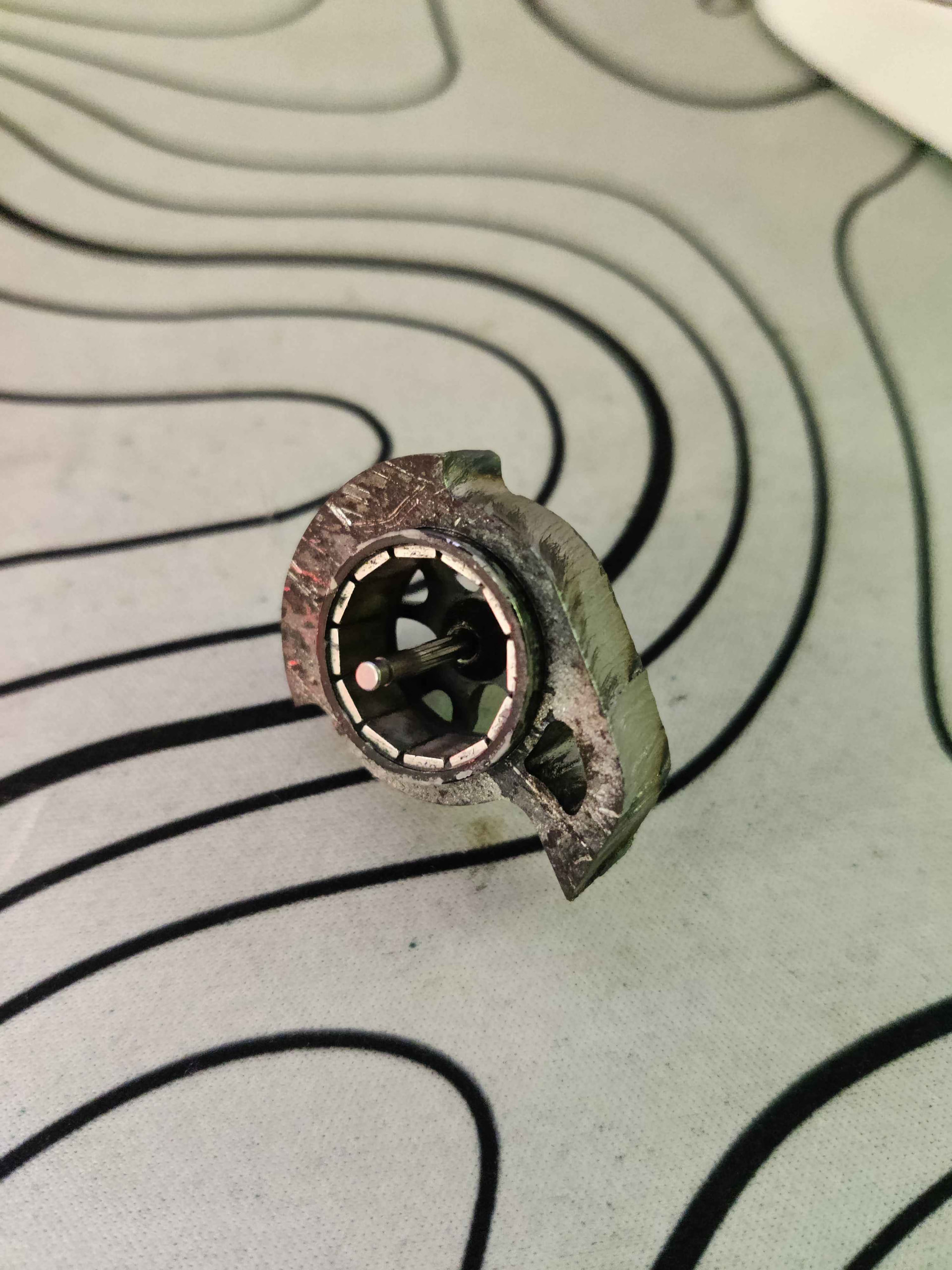

Quick updates for the above. Motors died womp womp.

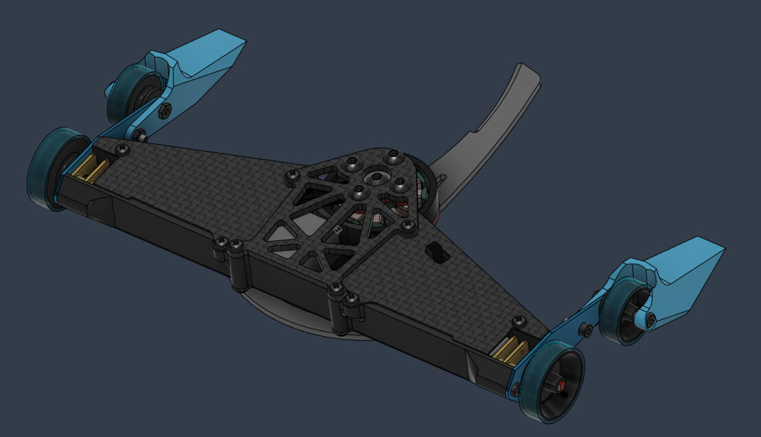

A while ago I clocked the robot Antix, super cool undercutter. Really appealing to have the whole drive assembly on these steel drive plates, including the forks.

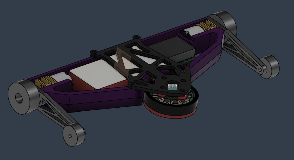

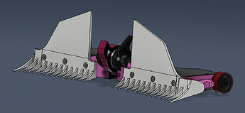

Here’s a sequence of CAD images to show the development. Starts off with a giant 4S lipo which I use in Jennifer, 3mm hardox side rails. This got pretty unholy on the weight/size side. The goal with the iterations was to shorten the depth of the robot
Drops down to a 2 x 2S Series setup, which the goal was to make the robot shorter from a depth perspective. Smaller chassis, less weight, etc, etc. But tip speed prevents 4S, so now it’s a custom 3S pack using GNB 300mAh 1S 60C LiHV cells…. fun.
The drive pods are now 1mm Titanium. I have a bunch of this stuff lying around, and titaniums springy properties feels pretty suitable for this application. Maybe I have to go to 2mm Ti, but I’ll have to see how it goes.
Weapon is a 2mm hardox bar with the gimmick of this being a sharpened blade edge. The majority of Antweights have TPU front sections. Which this seems to be a cool solution to, or getting stuck in the wall/floor.
Chassis construction is pretty easy; TPU frame, with 2mm CF for the weapon mount, 1mm base and some 0.5mm dust covers as lids.
That’s where I’m at currently, I need to look at mainly the forks. I’m not super happy with how they are visually, I’m considering some 2mm Hardox forks for it. But I want to keep the sprung feature, possibly with o rings.

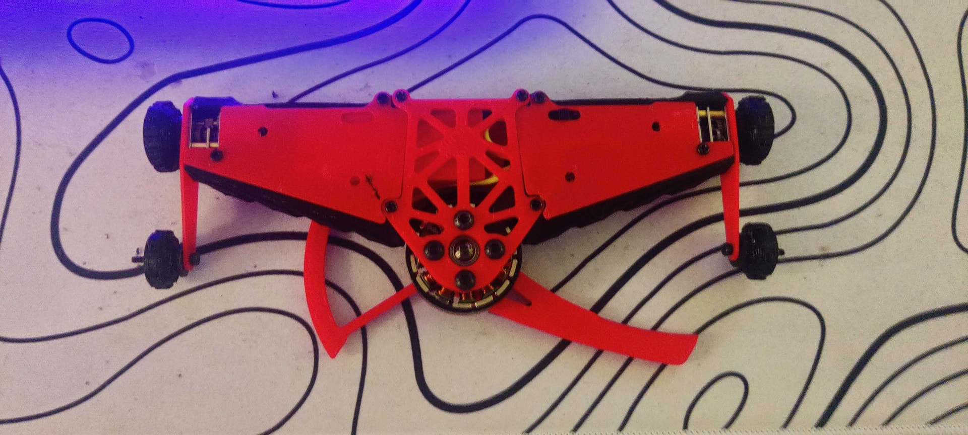

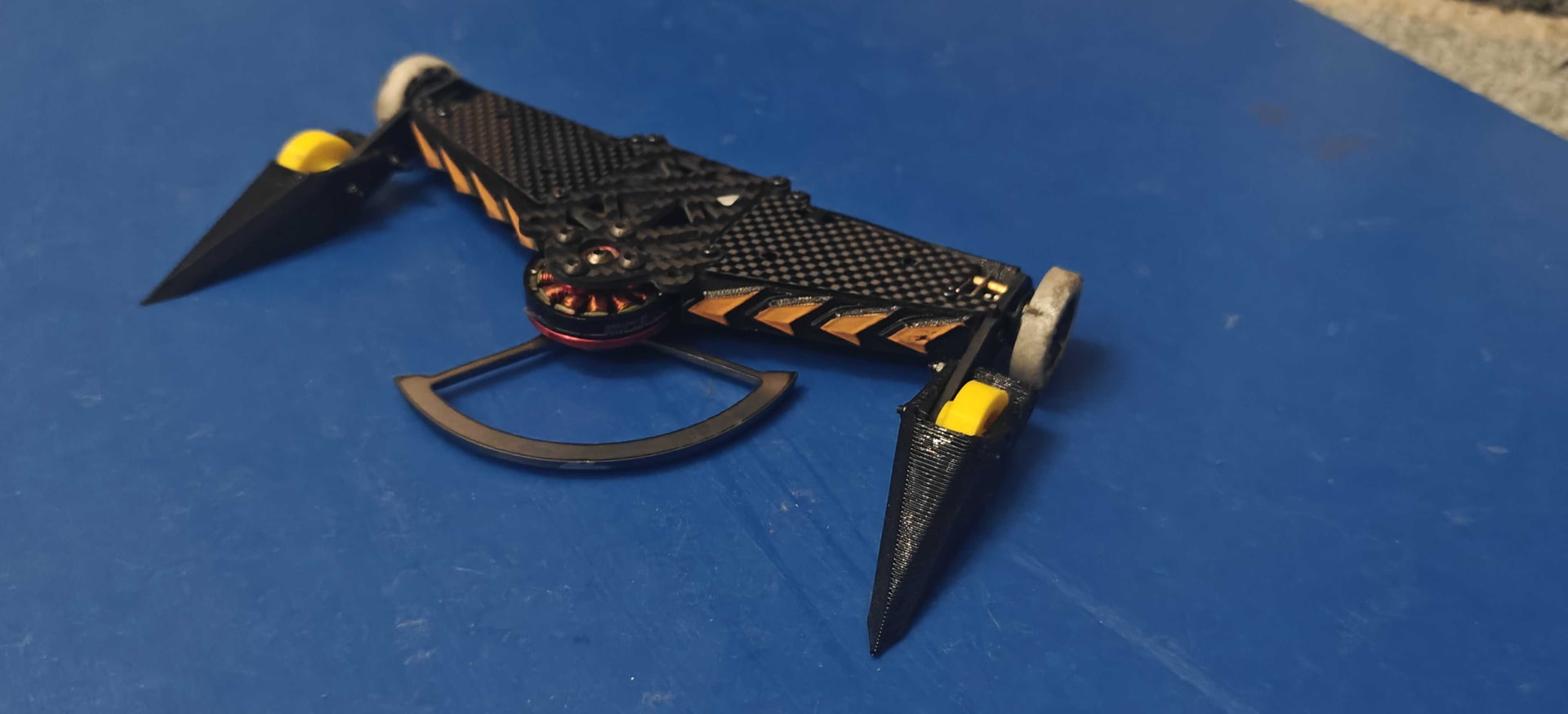

Updates since last, been a bit busy with TWLB & the ever slow march that is Aero 2. But MITE Ants VI is approaching and along with the trophies I’ve been working in my entries.

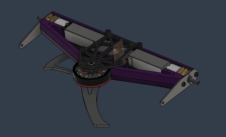

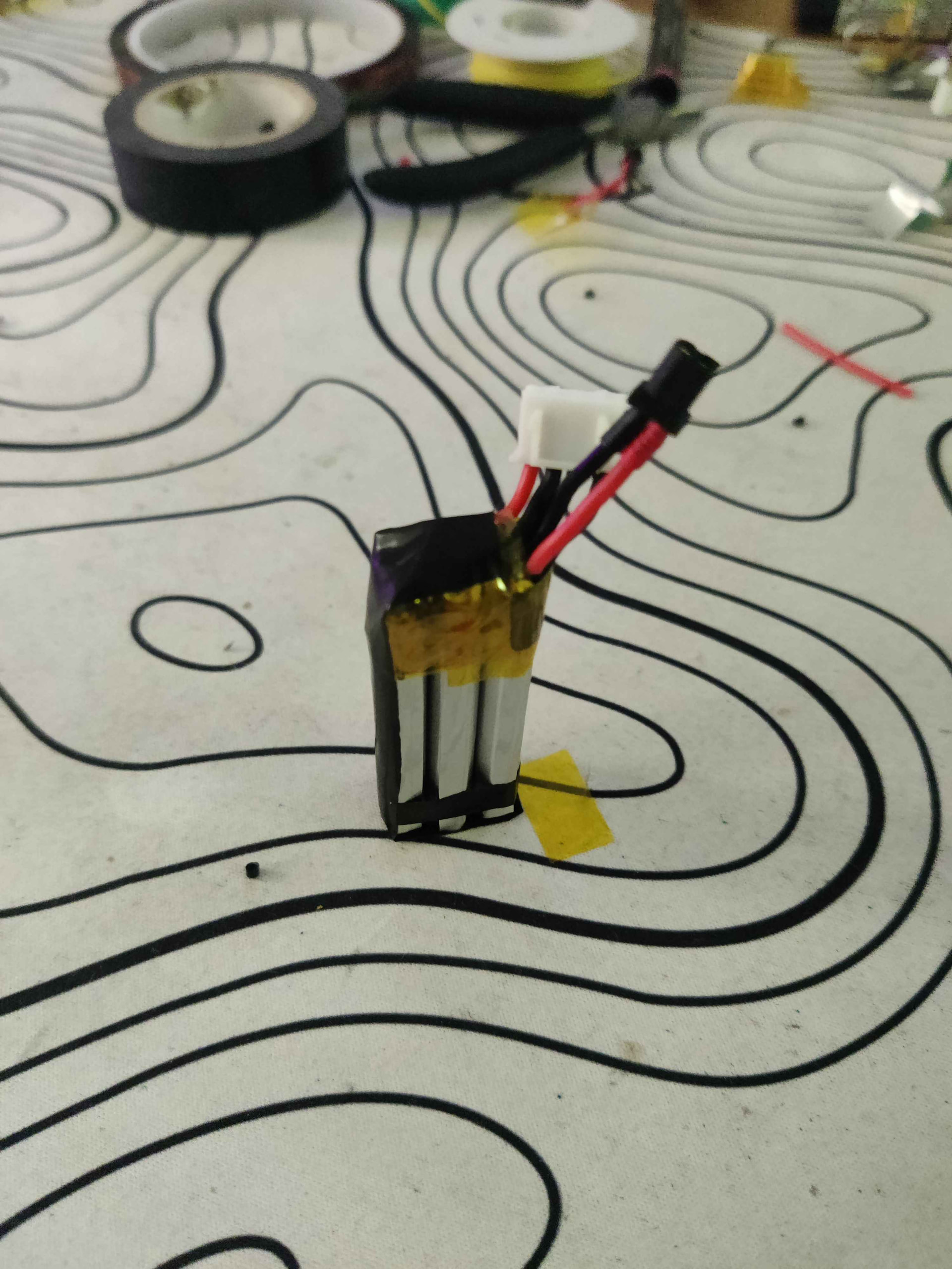

The first part of Starlight’s construction was the battery, without this, the whole project fails. So had a crack at it.
Quite frankly, was a bit of a terrifying experience knowing one wrong wire could result in a smokey end… to the battery atleast. But with some diagrams and slow approach, it was complete, was able to get 2 made for the machine.
Then the robot got a prototype, with the goal of making design changes if needed, then swapping out to real parts. Currently in this iteration there was major issues. 1. The forks still sucked and looked ugly & 2. The drive rails could pivot due to the only holding force being the screws into the TPU. So some changes had to be made.
Bit later on with a CF weapon support and forks.

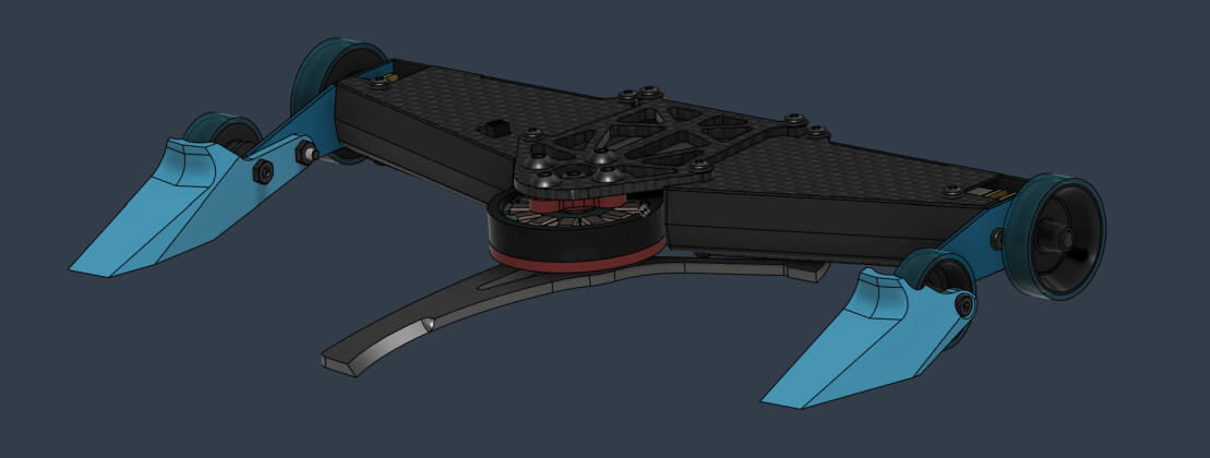

CAD photo showing the keying feature I added to the drive rails and chassis. Goal is to stop the drive rails pivoting upwards, resulting in the weapon scraping the floor.
Here’s those changes on a new chassis with the weapon attached. Slowly adding on the CF parts as needed. Still not a big fan of those forks.

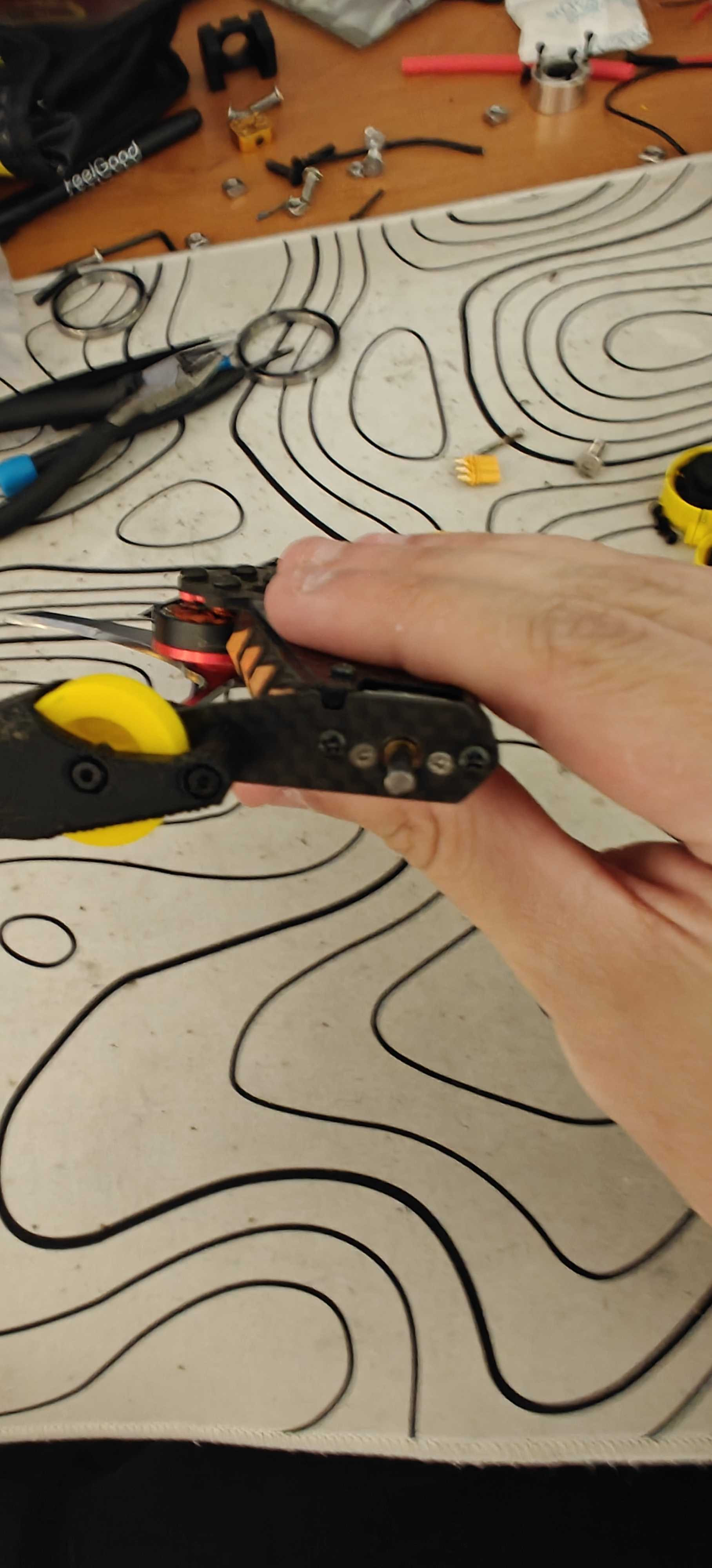

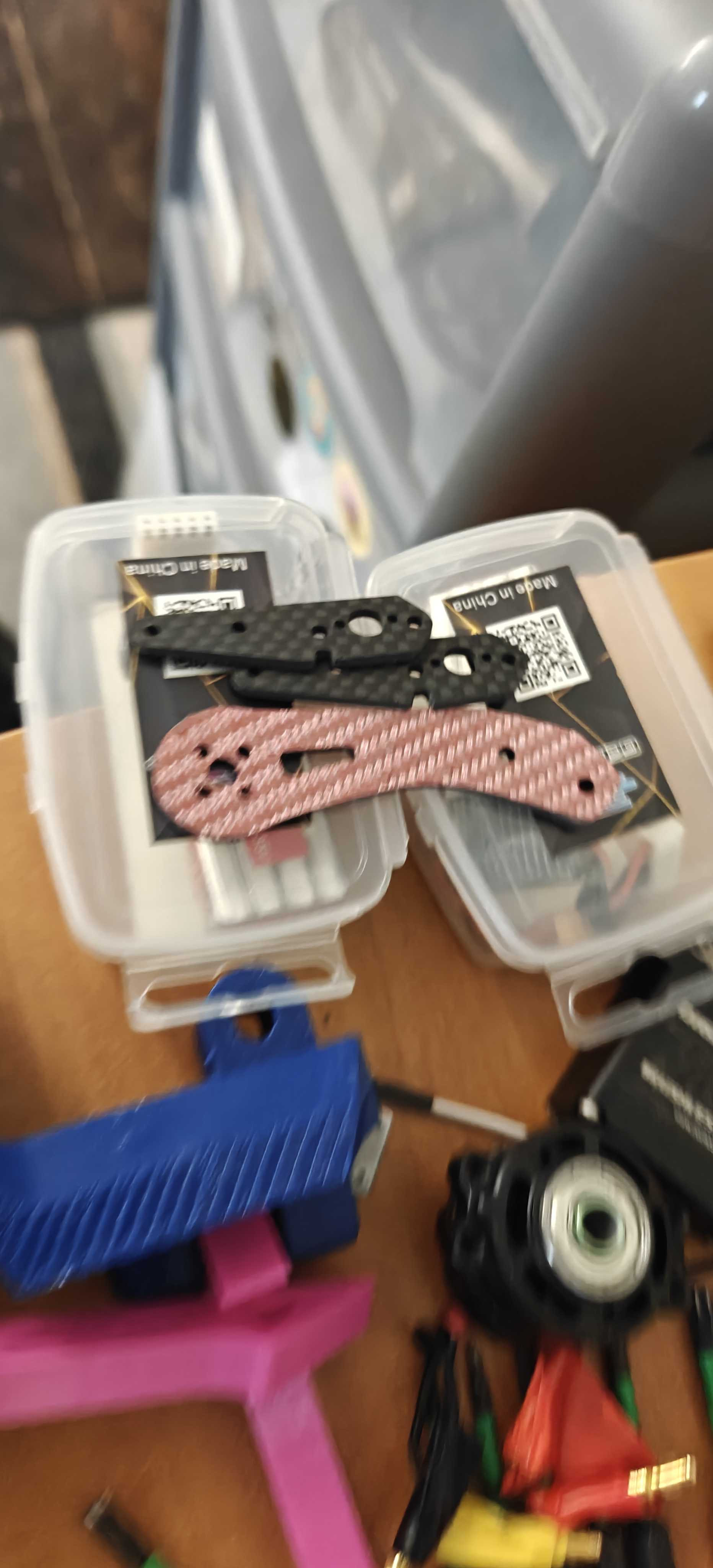

Eventually I changed from 1mm Titanium to 2mm Carbon Fibre. Couple reasons for this, main concern was there not being enough surface area to hold the drive bolts in without them tilting, the other was the Titanium I got cut with Garfie was a touch out of tolerance.
Cut with some other parts at home, first time using a 1.4mm end mill for this. Had the size available for ages, so finally got it’s use.
Countersunk in for face mounting. Super sleek.

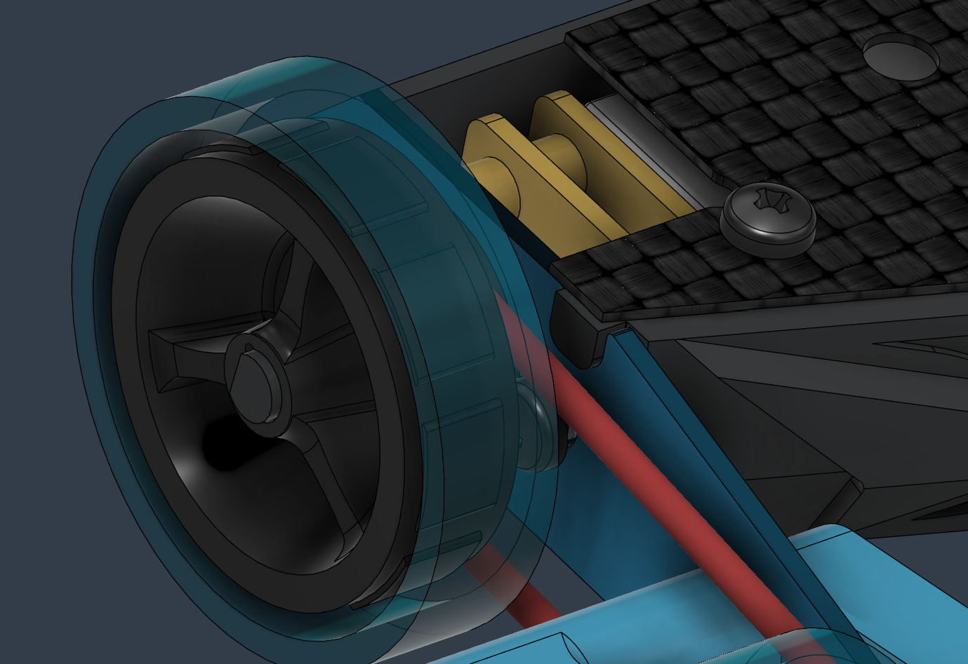

Here’s the robot with some attempt at rear wheels, the batch they came from sucked and these were the best of them. Good enough for a test fit.

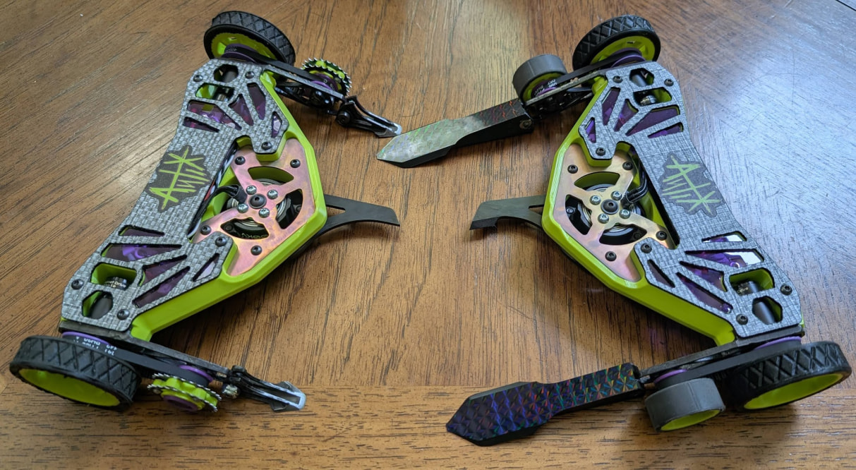

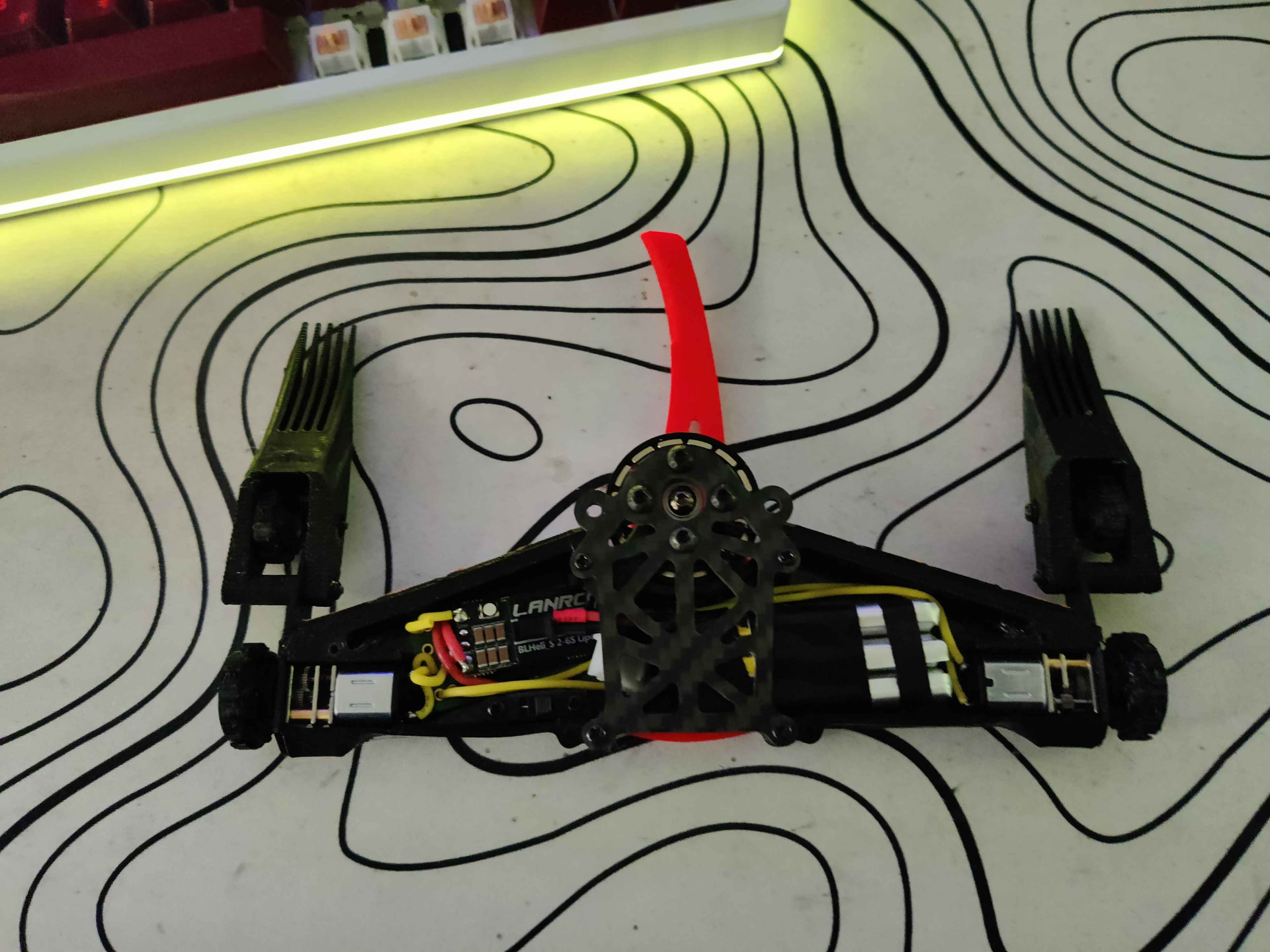

Jennifer, my 4S 4WD vertical spinner is the current defending champion of MITE, and whilst I was happy with the run it had, there were many changes that needed addressing.

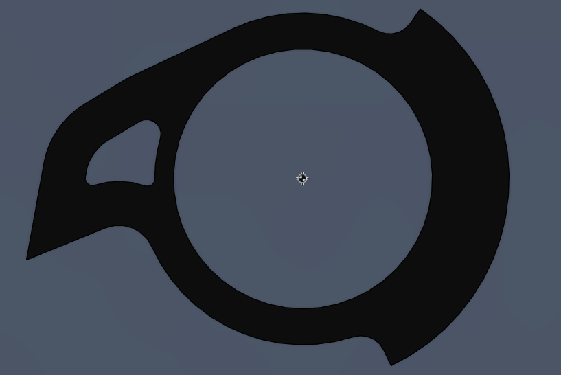

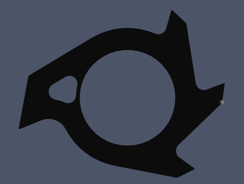

Bite. The weapon disc previously, wasn’t particularly optimal. The combination of years old design and inexperience, with a weapon that spins at a ridiculously high 62k theoretical RPM means the robot doesnt really get big bite without being at 40-50% throttle.
So designed a different weapon with more space for tooth impact. Removal of the teeth on the counterweight side to hopefully help with this. Also slightly lighter at 18.5g vs 23.1g
Weapon tolerance was a big issue at the last event, getting to a point where the weapon was sliding with the robot turning at the end of the event and throughout the event, was able to hit it’s own wires, killing the weapon. Simple change of tighter tolerance and press on. Easy.
Wire routing, just another simple change of removing some of the wire slack and adding a hole for the weapons to go through.
Other minor changes include the swap to 1500RPM motors & another config for the hammersaws attending MITE VI.
Final photo with Jennifer & Starlight, looking fresh.

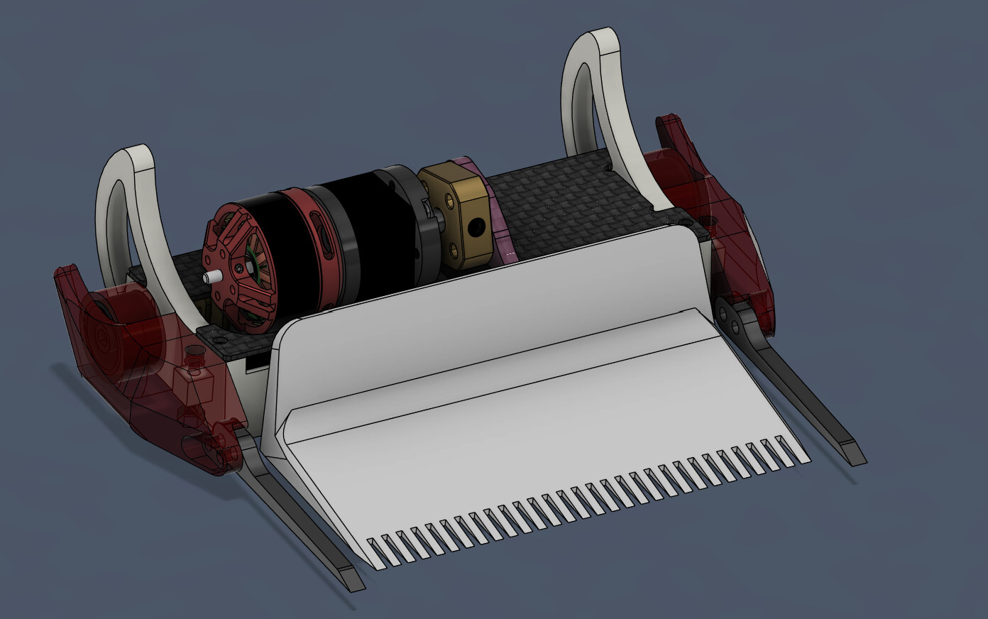

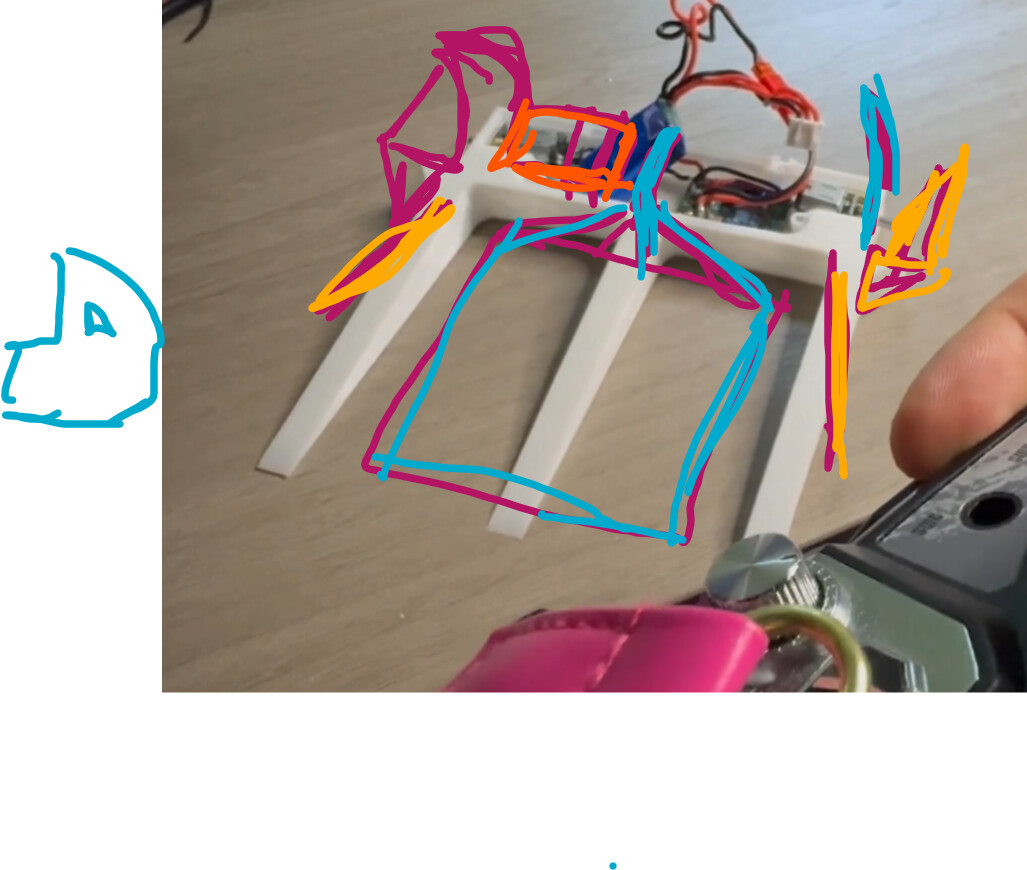

MITE VI’s 3rd entrant is still getting cooked up, but taking inspiration from Joe’s Fling Prawn in taking a big brushless motor & bolting an arm to it.
Here’s the initial sketch for the idea, on top of a robot built by Killoy RC’s Josh. But the idea is to take a rotolink mount to the roof of the robot.
There’s some design goals with it I wanted to keep along the journey of this ant and they’re the following.
3S. Joe’s a fucking chud, because he used 2S on Fling Prawn. A real drilla like me, is using 3S, because more flip. In addition to being directly mounted. Maximum efficiency.

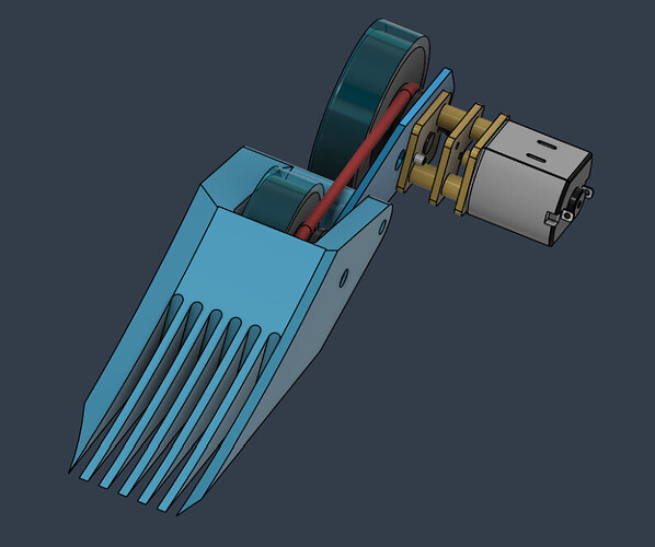

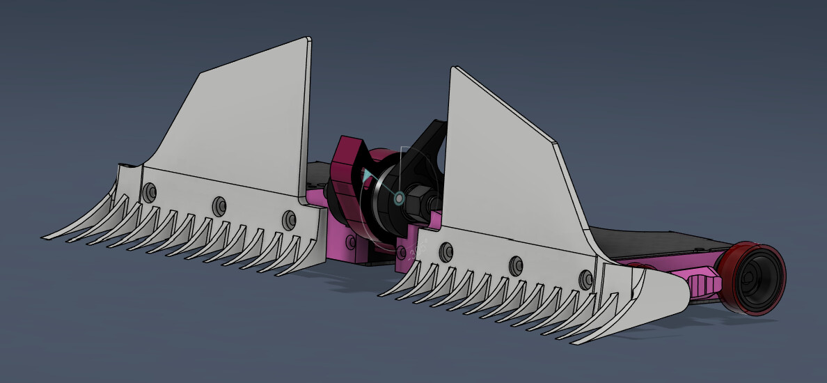

PEBA, Morgan had given me the remains of a roll because he’s a chud and couldn’t print it. So decided to take a crack at it and implement it into this robot. With the goal of using it for a future cluster bot with the lad.

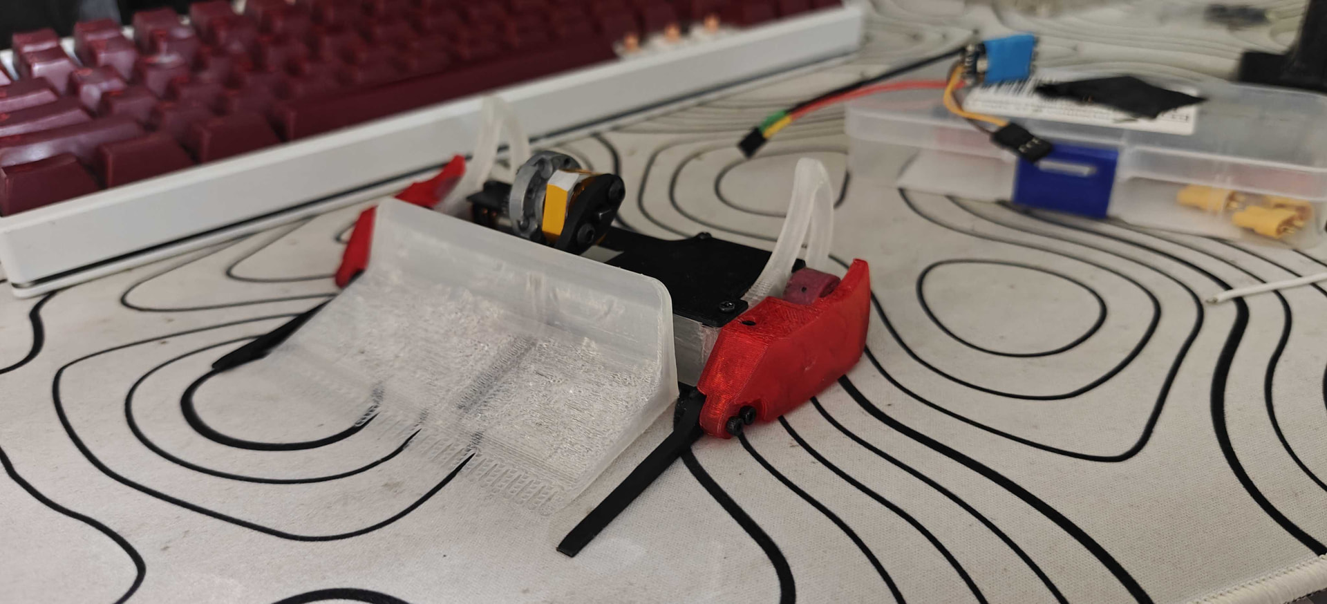

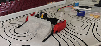

So heres the 1st rough draft of the design, PEBA chassis & plow. With some TPU guards & hardox forks to boot.
Here’s it all printed and assembled so far. The gearbox ring has gone to morgan to be squared off, with the rest of it being wired up. Still need to machine all the CF parts, but that’s sooned to come.
The PEBA printed ok, chassis was fine, but was having a bit of problems with the scoop on the really shallow angles, having it be a tad lumpy in areas. Slowing it down tended to solve it.
