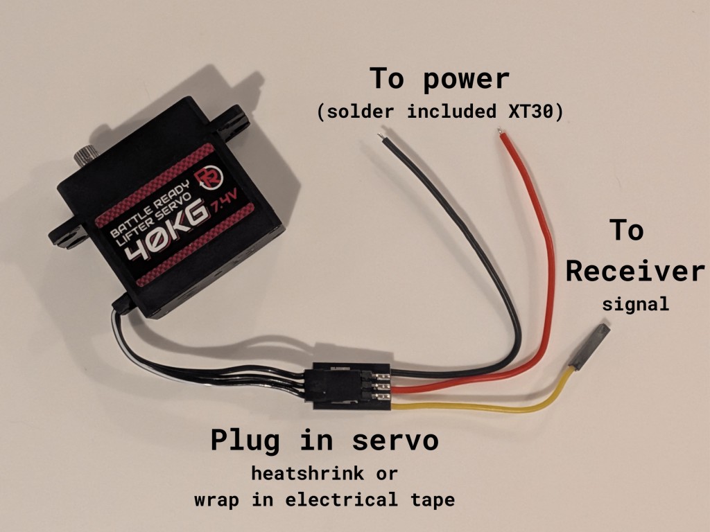

A BEC only affects the voltage for whatever is plugged into it, so your 5V BEC will provide power to only your receiver and your 7.4V BEC will provide power to only your servo, as you can see in this image from the store page

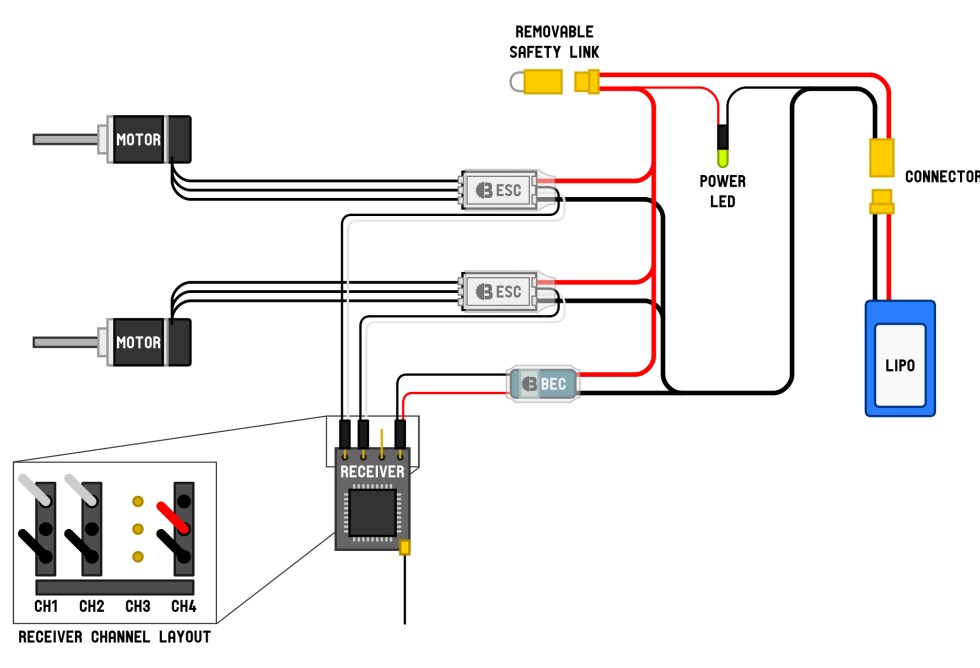

Here’s the wiring diagram of the brushless kit, to connect in the servo as wired above, you’ll need to connect the power cables into the main circuit the same way the ESCs and receiver BEC do in this image, then only that yellow wire goes over to the receiver.
Hope that helps a bit!
