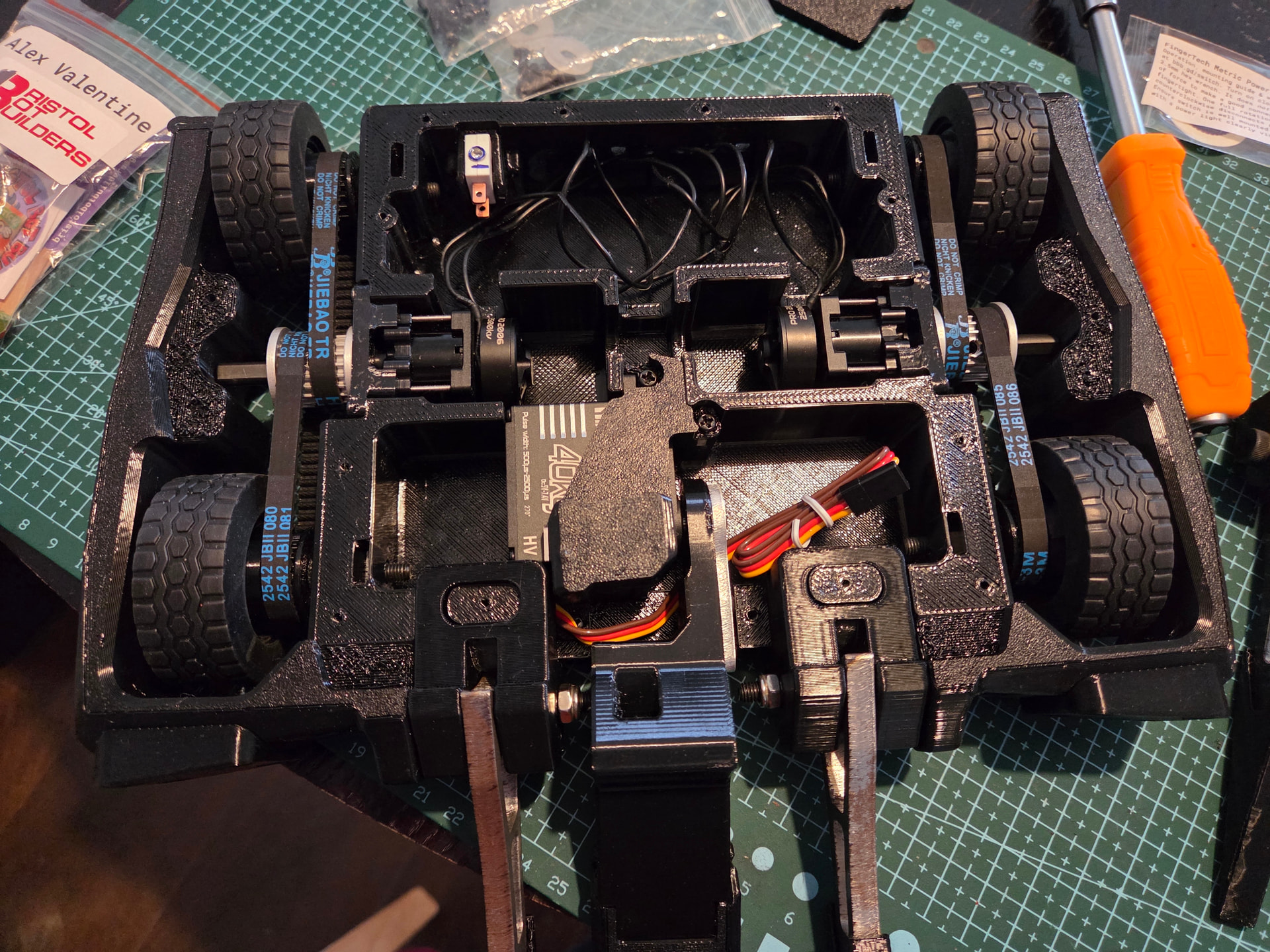

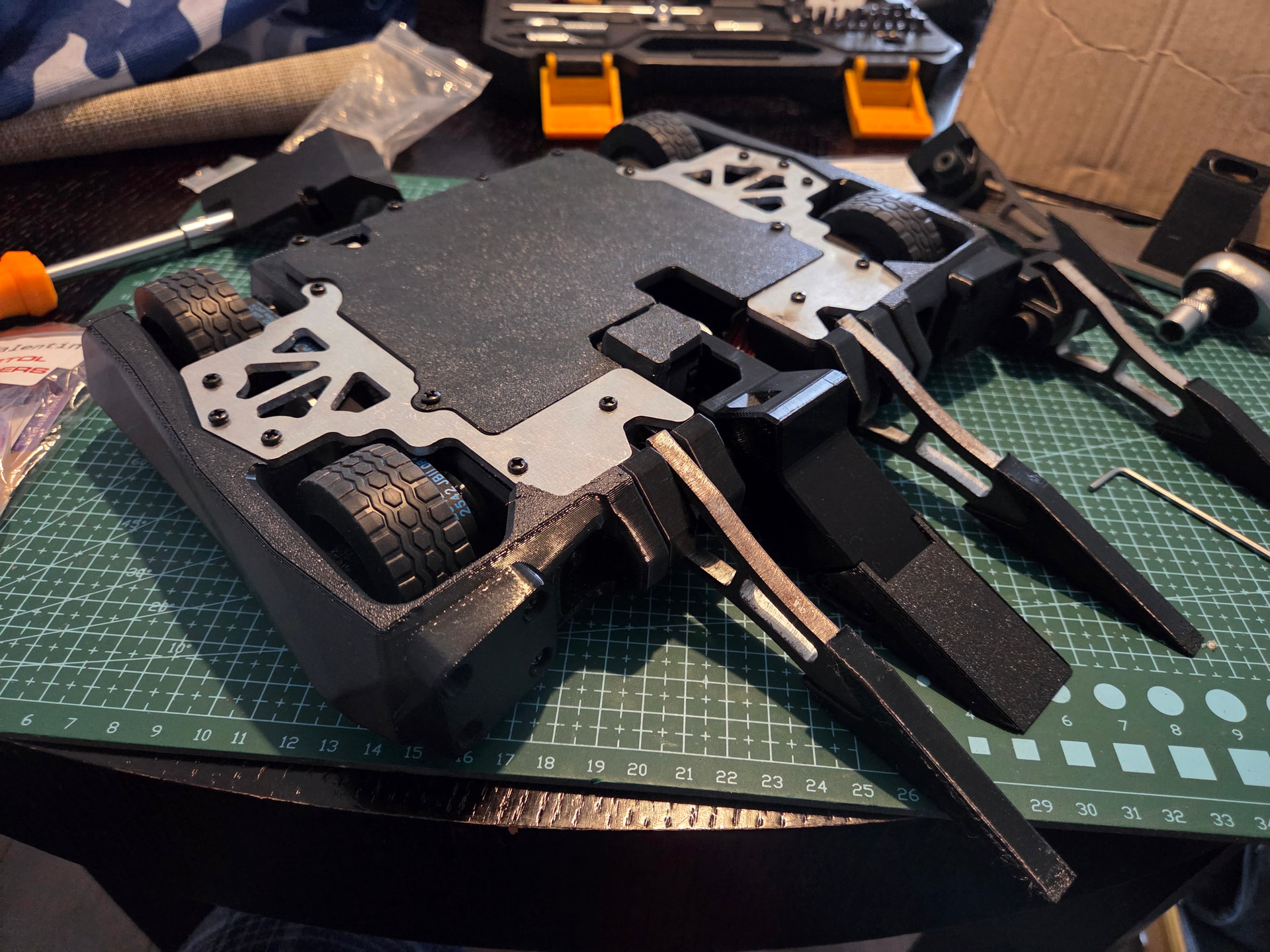

HYPERION
(New Build, started February 2026)
Status As Of March 26: Not Yet Complete.
Has been partially put together to test how everything fits (including the motors/mounts), but still needs the electronics and such sourcing and installing before I can begin the testing and prep for the events (Scouse Showdown 5, New Blood, etc.) I intend to enter it into.
PARTS SO FAR
HAVE
1 x Nightclaw Kit (with all attachments, including the lifter, wedge and extra forks; adapted to use two of the below motors)
2 x Repeat Drive Pro 2006 drive motors (4S)
1 x 12v LED Safety Power Strip Light
1 x Fingertech Metric Power Switch
1 x 4S 850mah LiPo battery (XT60, reused from Tsukikage since it fits and it’s about as strong as I need it to be)
DEFINITELY NEED (can be adjusted):
Wires
Fuse (not sure what kind I’d need for my switch; any help is appreciated)
ESCs (debating whether to do one each or a double for the drive; will also need one for the lifter)
Flysky 4-Channel Receiver
BEC (for Receiver and Weapon Motor)
UNSURE OF:
What kind of fuse to use for this kind of design? Have searched around, but never been entirely sure of what would work for a Beetle.
What kind of ESC to use for the lifter?
Anything else that hasn’t been covered in the above two lists?
Then, once I’ve got it up and running, I’ll see how much weight I have left over to potentially improve the defences up top before it really fights; was thinking of updating the standard 3D-printed top plate to one made of G5 Titanium or 7075 Aluminium Alloy of the same thickness, for maximum protection against hammer saws, crushers and such.

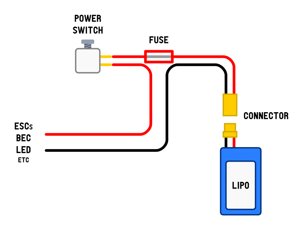

Hi Alex, answers to your questions:
30A fuse wire would work fine here, presumably same as your previous robot.
There’s a wiring diagram on FT Switch store page for using with a fuse:
Servo motors don’t need ESCs - they essentially have one built in.
Thanks for the guidance, Joe! The Fuse was one thing I was never able to exactly get my head around — particularly since it’s one of only a few of the parts I’ve never had to replace or otherwise fix — so the explanation’s much appreciated. Once I pick up my next batch of parts, then hopefully I can show you the next stage of development!
