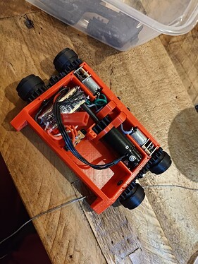

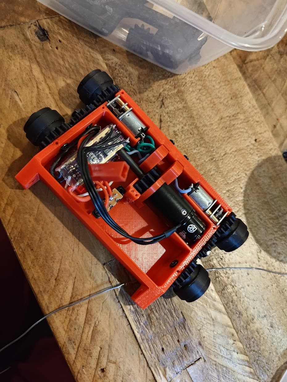

Thought I’d try some TPU and PLA-ST and actually finish an ant for one of our events for once.
Before the event:
After he was paste.
After paste: (lost all tyres, weapon mech ripped off, but servo and all 4 drive motors still work!)

Do wonder if having your wheels exposed at the front was perhaps asking for your tires to be sniped tho? :stuck_out_tongue:
Could you extend the wheel guards forwards and round to cover the front and act as feeder wedglets to get people up onto the lifter maybe?
Great wee build regardless though! - love seeing robots span multiple weight classes
Yeee, it’s good shout.
I was rushing out the cad but original plan was front wej off the wheel guards with some forks off it to stabilise the lifts too, lacking either meant both floppy lifts and a lot of abuse from a v scary horizontal :stuck_out_tongue:

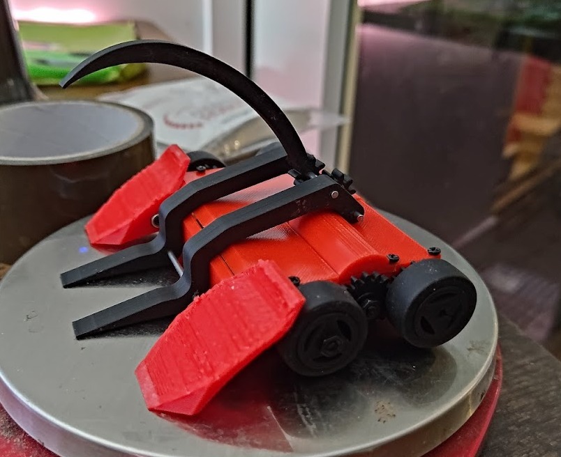

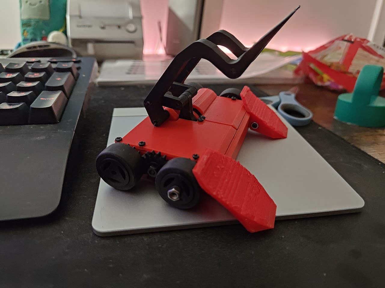

Enjoying 3D printing more at the moment, and was heading along to Bristol Uni ants so made a new grab and lift bot - all the gears!
That’s, what, 6? What will you name this new life? Very impressive gears, my only critique is that the grabber part doesn’t look all that crab like and a little flimsy. Who am I to judge though?
I love the grab and lift, I think I keep making my mechanisms way too chunky looking at this!
Is it motor driven or servo driven?
It’s powered by a 16mm repeat brushless gearmotor because I love oversized gearmotors in my bots, it’s definitely the wrong choice!
I think a servo would be well suited or I’ve seen 100rpm n20s/n10s have plenty of power too, ant physics are weird :stuck_out_tongue: - this is my fave grab&lift ant of now, and it’s running a 100rpm n10 and looks like quite small mod gears (and some nice linkages) but they’re definitely a bit thicker than mine.
I did 5mm thick mod1.2 gears, I think these would have been fine with a servo or n10, but stalling that guy out ate the gears pretty promptly. What size mod do you do for your ant weapons? The drive is mod1.0.
it being the night before the event I didn’t have time for a major redesign so made a flipper linkage version with more material around the grub screw connected to the weapon motor shaft
I’ve been using MOD2 gears in my ant weapons, and 1.5’s for drive for quite a while but I purposely design them to mesh very poorly in the drivetrains so bits of arena debris don’t stall my drives out, and big teeth really help with this.
MOD2 has always felt like overkill and its really hard to package comparatively but my failures tends to be stall torque, stripping the bores or bending mounts as opposed to teeth now which is nice
