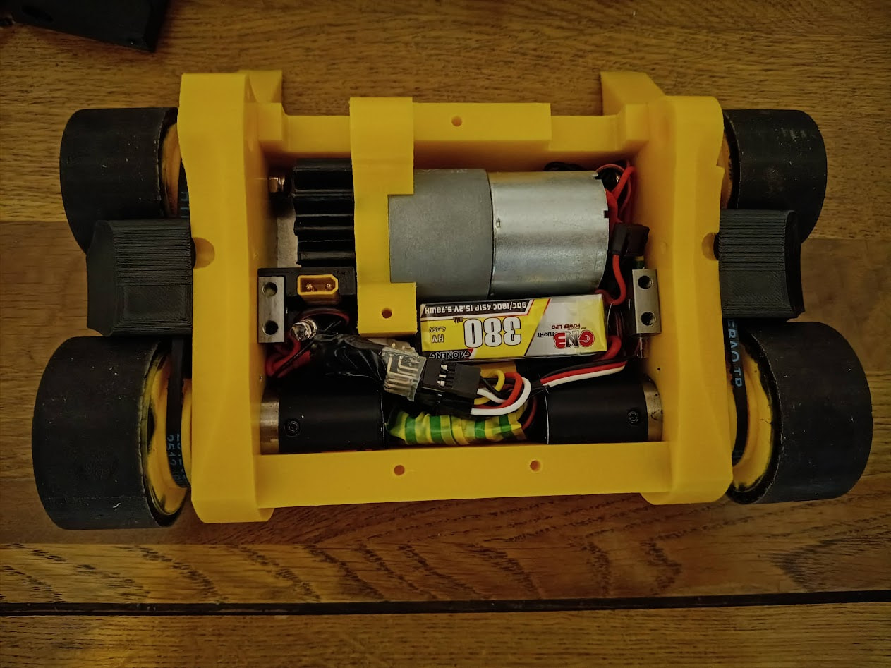

Since the supply of these motors is finite, I wanted to design something that wouldn’t take a large amount effort to manufacture. This meant no large thick aluminium pieces I have come accustomed to in all my builds, with the few aluminium parts being relegated to just the motor mounts and the bottom panel. I decided that as a change to my regular design philosophy, the majority of the frame would consist of HDPE. I have slowly incorporated HDPE into some my more recent robots such as Clump and Cascade, and have become a lot more confident in designing around some of its main weaknesses, the main ones being reduced thread strength and lack of rigidity in comparison to aluminium.
I still haven’t found the urge to fully commit to a spinner yet. I have one designed and the initial goal was to get it built in early 2026, but upon reflection I ended up going against this as I’ve gone too far down the control bot rabbit hole to convert to not so controlled chaos. I ended up designing yet another lifter which uses, you guessed it, another 37mm Pololu brushed gearbox motor. These motors are just too reliable, I am still yet to break one and like the mars motors I have a couple lying about so it would put those to good use. In terms of the type of lifter I wanted to design, I am a really big fan of Dylan Stanley’s robot Chucky, and ultimately decided to create something inspired by that.

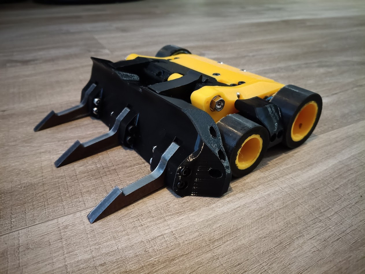

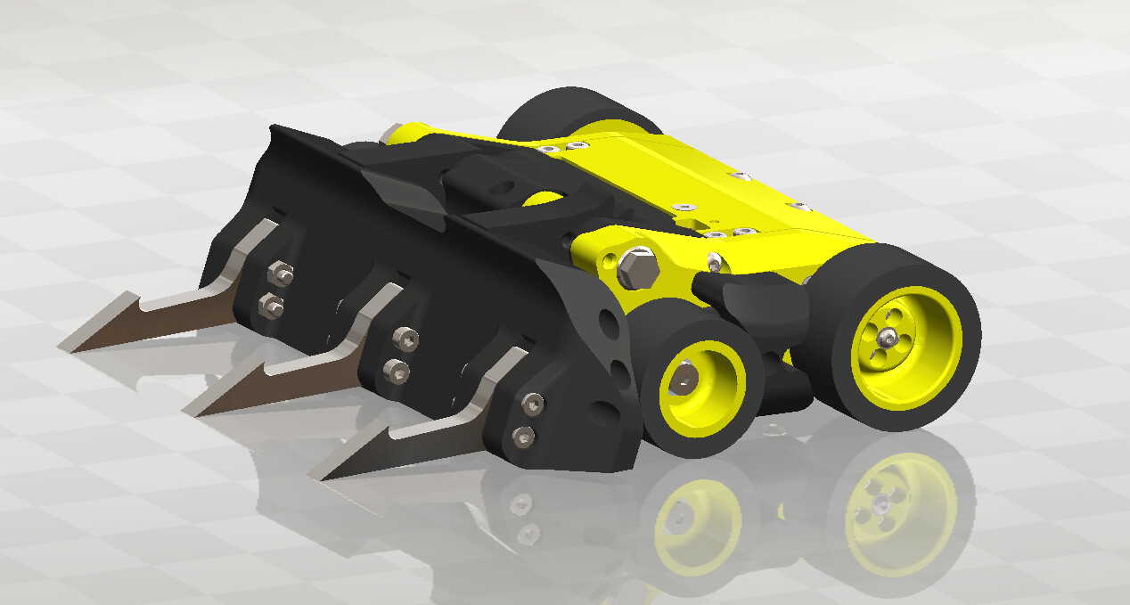

After some CAD, and many hours in the garage tinkering I came up with this.

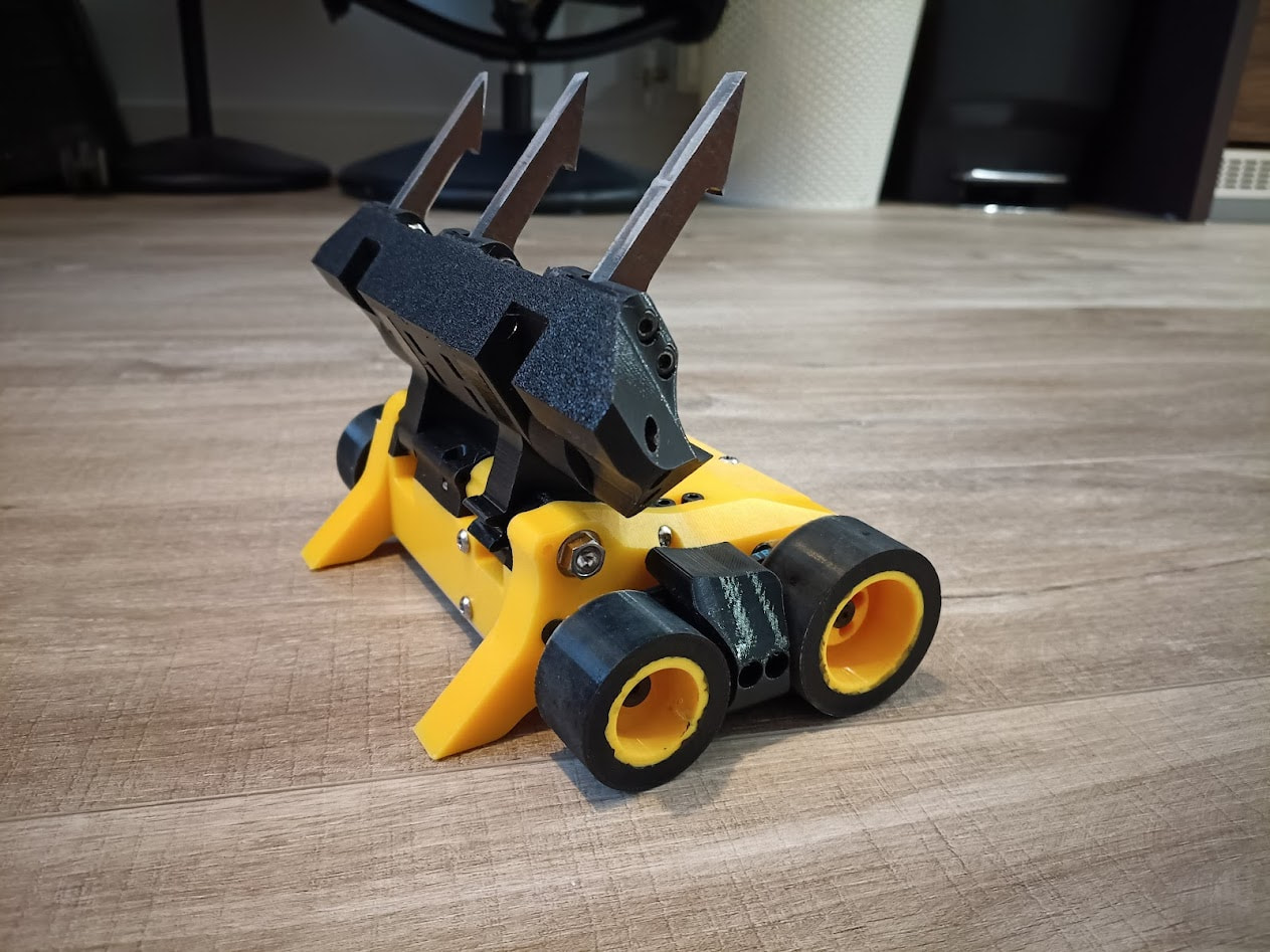

With it having bull dozer like characteristics I ended up going with a yellow and black colour scheme mirroring whats found in JCB vehicles.
Overall I’m beyond pleased with this. Most of the design was based on what I thought would be fun vs what would be more practical. There are certainly some aspects I would change if I was designing it to be as competetive as possible, mainly referring to the moment forces involved with lifting as it is likely to topple forwards in some lifting scenarios.
