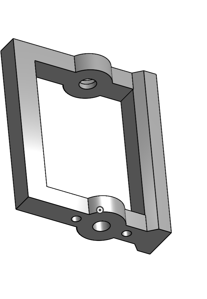

I haven’t designed the weapon yet right now I am trying to work out what I should use as I am make my first drum spinner and I can’t use AR500 or titanium

What material would you recommend for a weapon like this?
That’s honestly a strong candidate for the Hardox’s/AR500’s/Wearplate equivalent but I can see a realistic case being made for 4140 - potentially left unhardened.

That design ties in very neatly to what I was mentioning earlier about DFM (How is someone going to make that part? Has it been drawn with that in mind? Have you made your life as easy as possible?)
First off - without selecting a material it would have been impossible to know how much weight you have tied up in the weapon itself. Definitely something you want to check ASAP once you have settled.

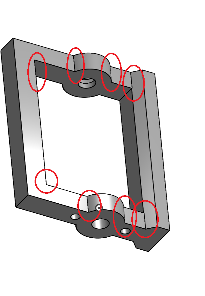

Coming back to the ease of producing the part you wish, you’re going to want to consider getting a radius in those corners. Twofold, one being that it’s so much stronger than a sharp 90 degree finish (sharp internal geometry is where stress will be concentrated and cracking can appear) but also that it’s much much easier to produce. Think of how things are going to be machined, with a circular cutter which will leave a radius of its own diameter but can easily cut a rad larger.
That part as drawn can be produced but it would require more expensive and slower processes and ultimately end up with something less good potentially costing more money.
Now that we have a better idea of what you are trying to achieve I’m sure people will be able to add their input.
I would just like to say that image is a concept which I made in 5 minutes to show you the kind of weapon I want to make
To be honest I have no idea how to make this kind of weapon I am just making it up
