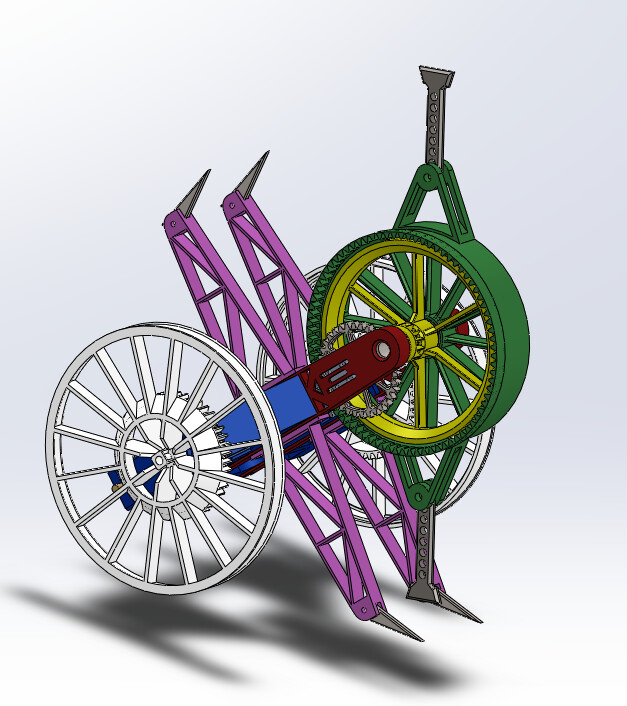

So.. I’ve seen most flavours of vert, and there’s some advantages and dis-advantages to them.
They hit hard, and recoil is back and up, but turning is a big problem.
their prevalence is also slightly annoying so.. I thought I should see how silly I can make one..

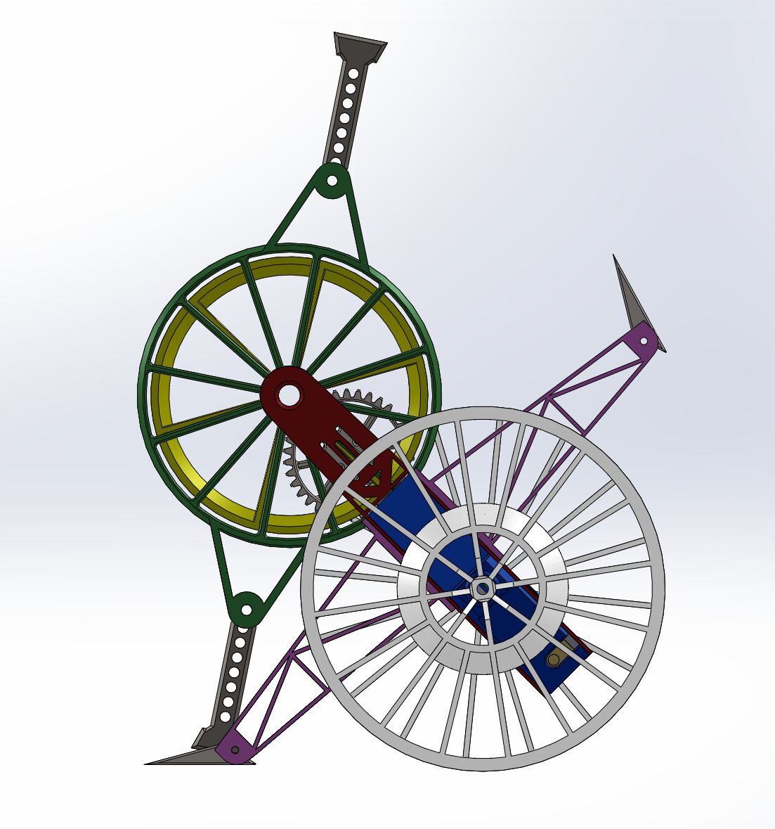

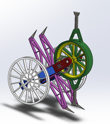

Firstly I wanted to get rid of the gyro effect, so I figured a reverse spinning counter-gyro has to somehow fit in it..
Secondly it has to have a high tip speed and good engagement.. the best way to get both was to go big.

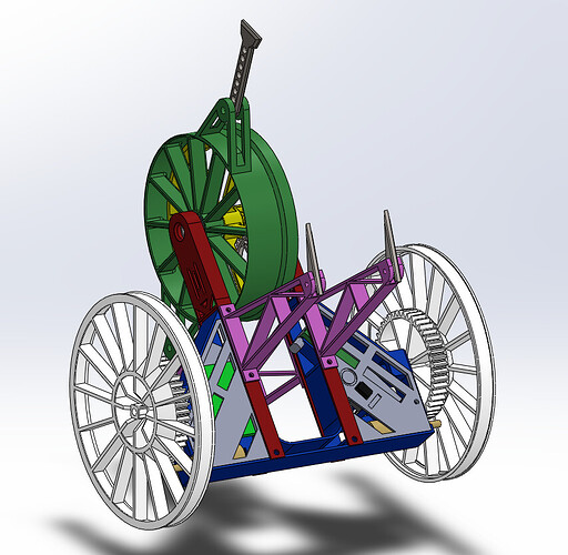

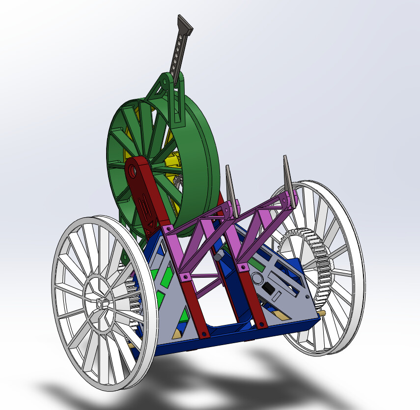

That lead me to make a 200mm diameter weapon and the realisation that to make this in any way usable it’ll need big wheels to self right (as there’s no-way there will be enough weight for another mechanism)
Following the big wheels train of thought, I recently took damage on my other big spinner Gen.Grevous and while a big slice was taken out of one of it’s wheels it did nothing to affect it’s mobility. so.. big damage absorbing wheels are the order of the day..

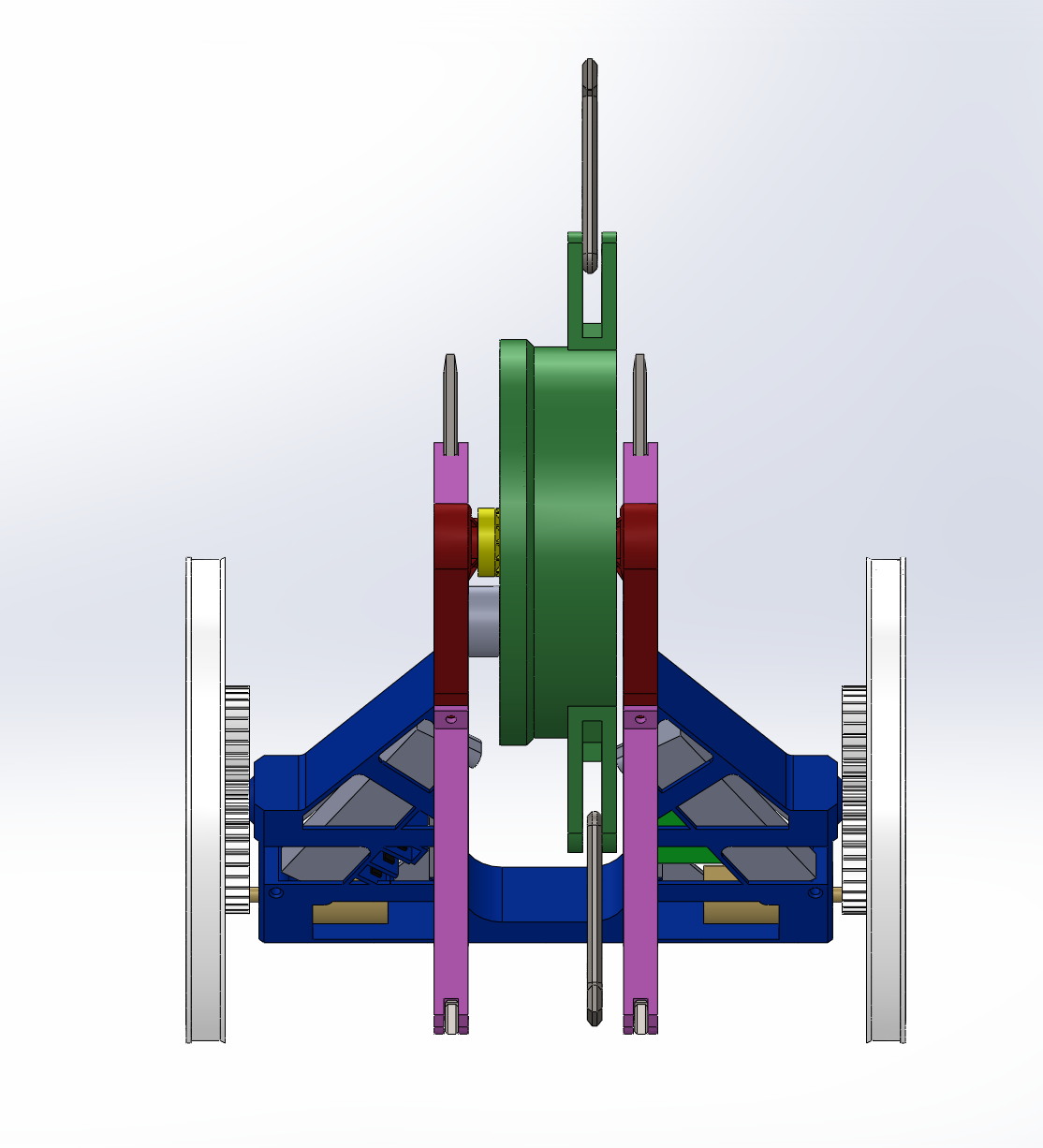

This lead me to a bunch of maths and ratios and COM fights to this..

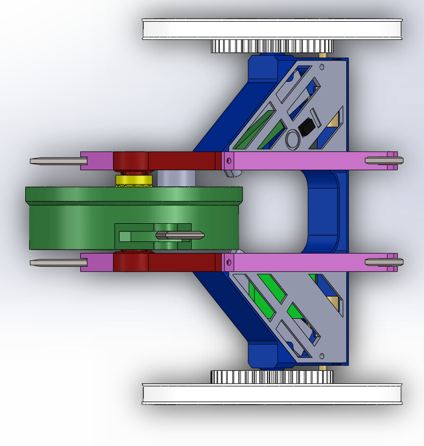

The counter gyro (in yellow) spins way faster than the weapon hub (green) this effectively removes the cornering gyroscopic forces (they still exist on the axle, but counter each other out)
Weapon will eventually be asymmetric for more engagement, and if it works then the ends will be hardox.
Target tip speed is >500mph, and with a 6500kv motor it should achieve that.
drive is geared the same as my other robots, so it should be quite fast and manoeuvrable.
current calcs have it very close to 150g, but hollow infill will probably make it lighter on a few parts.
Wish me luck.. and if it works.. I wish you all luck against it..

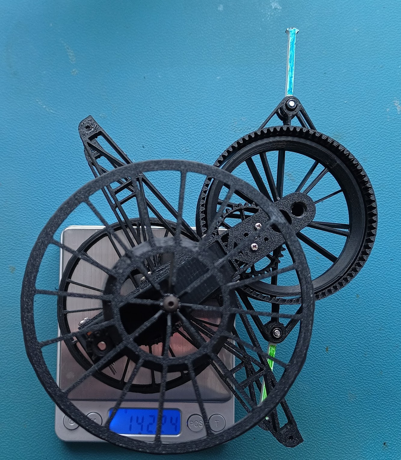

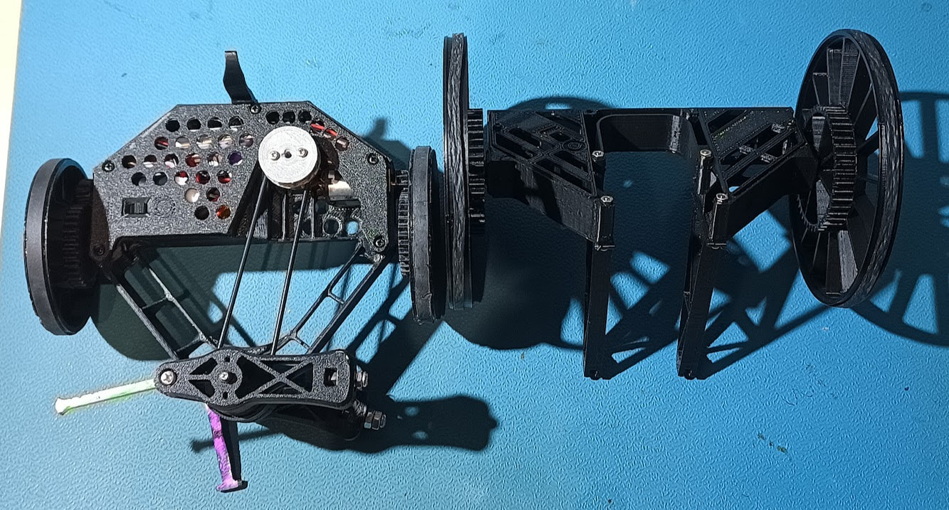

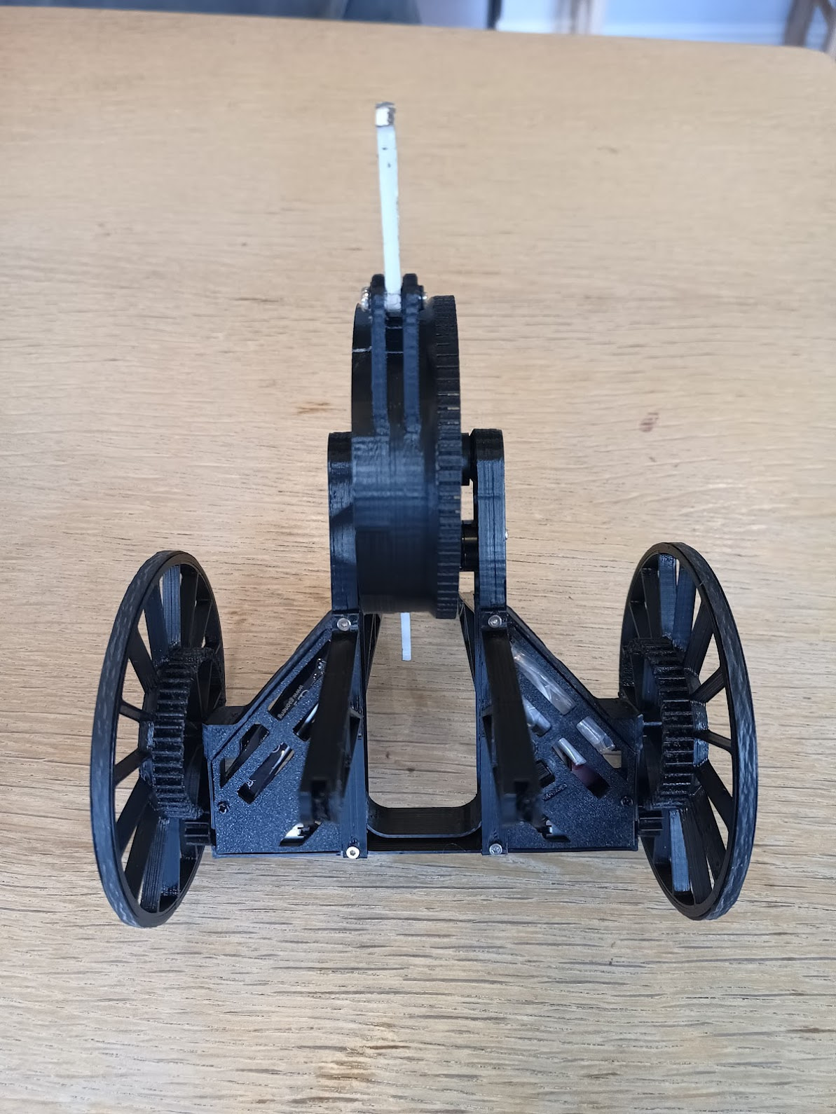

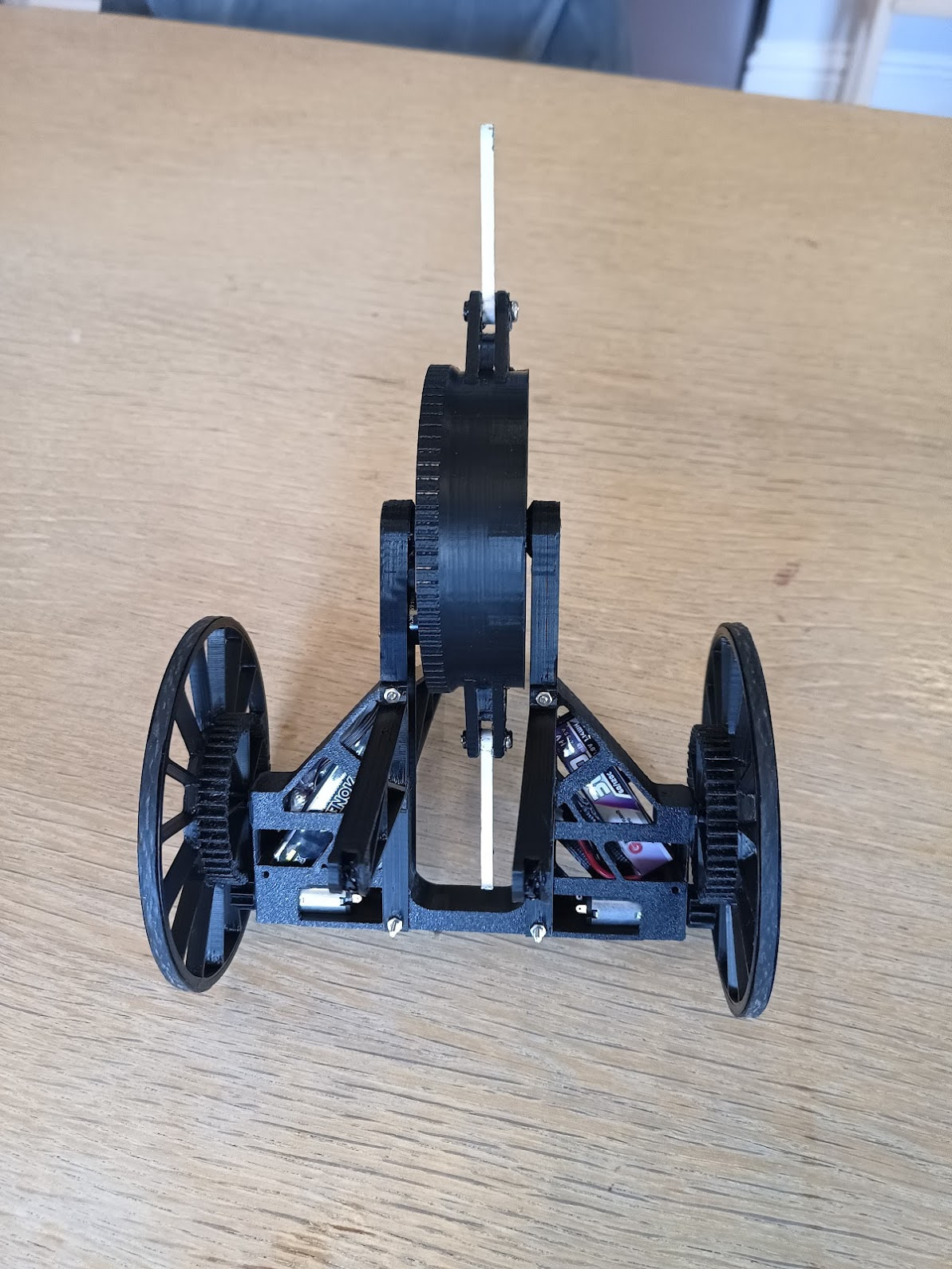

1st ABS prototype built
Carbon weapon shaft, everythign fitted except the forks, malenki and wiring..
~7g to spare!
gonna be interesting to test once the malenki arrives, still to check:
Self righting, max weapon rpm, will it explode?
but… We can get it in weight.. so that’s one hurdle passed.

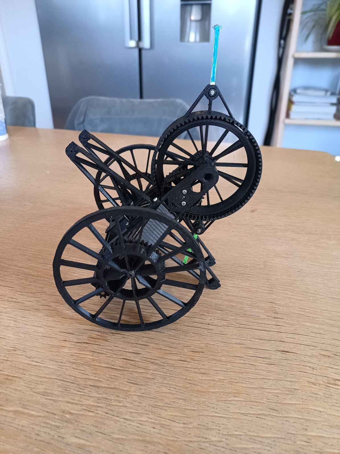

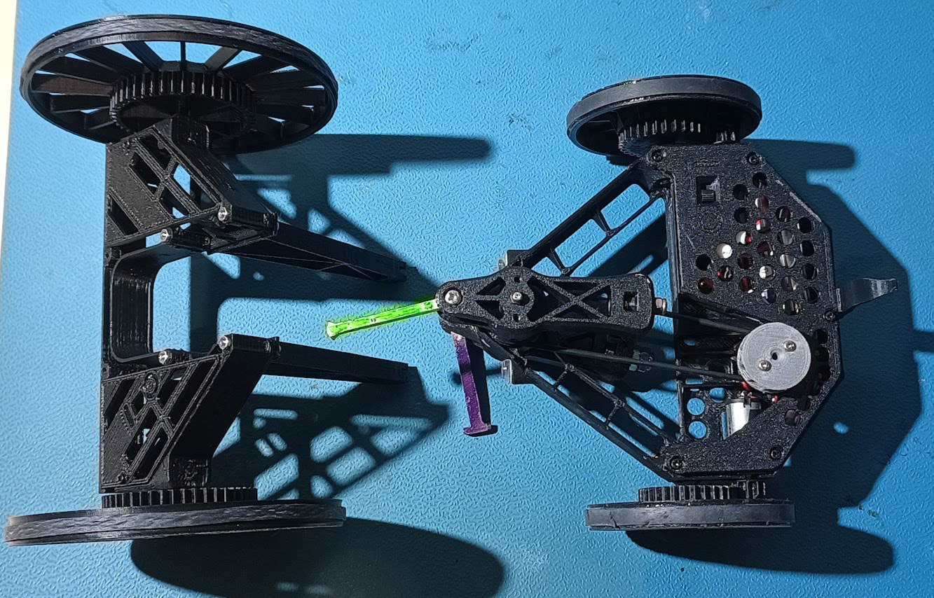

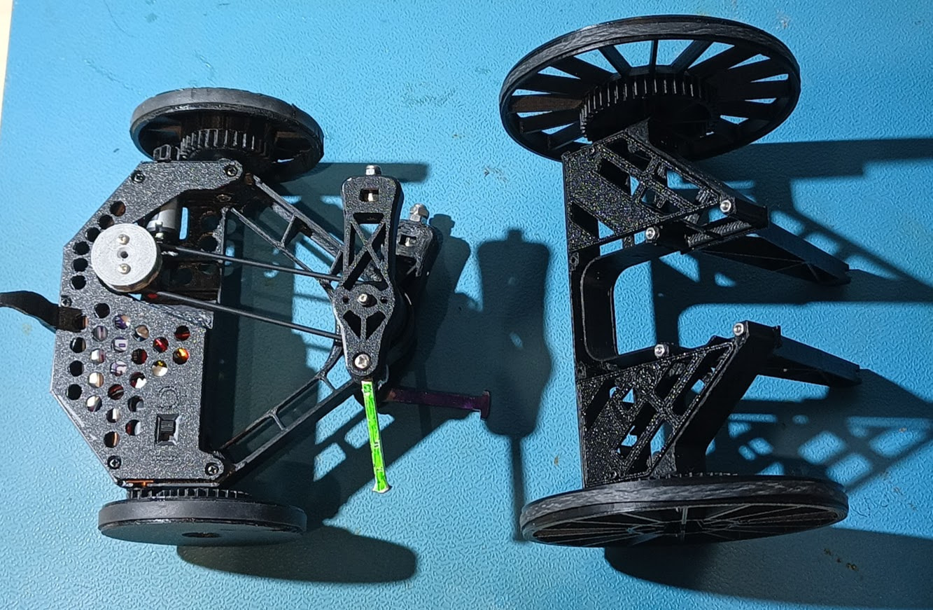

does this fit within the 4 inch cube?
Nobody really does that anymore
It only just fits in the 150mm square, with the flails extended (and forward) it’s a little over 200mm long.
yep, sounds about right…
It’s also supposted to have 1 Hammer one the spinner (and a counterweight)
no bigger hammer in antweight was the challenge :slight_smile:
Update:
Malenki arrived, I’ve got it wired up, and driving.
The good:
drive works as expected.
it can self right from any angle.
Weight 148.15g
The bad:
The weapon motor is (as suspected) overgeared.
no weaon spinup and a hot ESC from trying..
solutions:
I have a lower KV 1104 motor I could try. (4300KV vs 6500KV)
I have the Grieveous power train. (2700KV)
I could add a 2nd stage of gearing (or belt)
I could integrate a clutch into the input gear so the motor can spin up quickly, with the weapon lagging behind.
all of these have disadvantages.. and I really wanted the >500mph tip speed.
any suggetions welcome.. (I may take a break from this design to mull things over)
