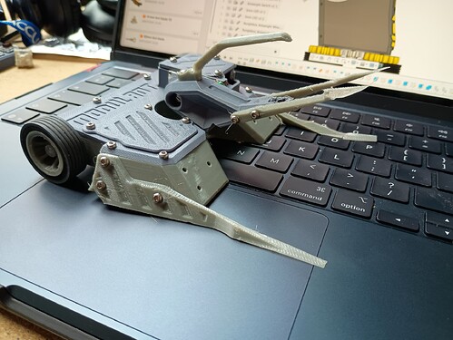

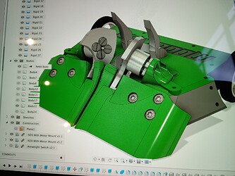

In January I started working on the first draft of this, with configurations for a lifter, vert and horizontal spinner.
This ended up working reasonably well, and designed a few more options before publishing it.

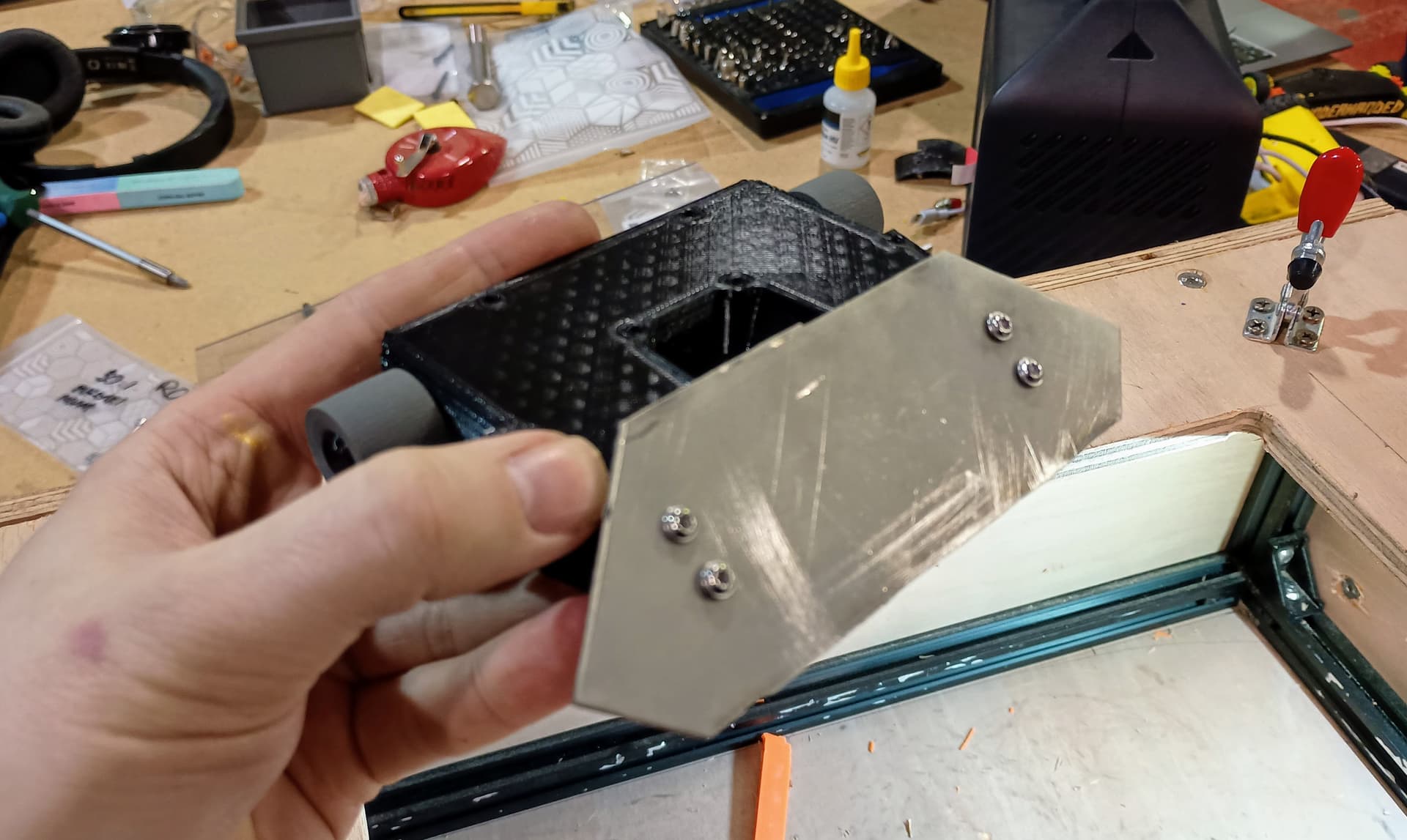

I designed a wedge to enter into a friendly rumble, and stuck a little piece of grade 5 titanium on the front as a joke.
I worked on this a little further to make some more configurations over the next few weeks

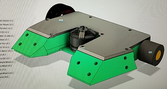

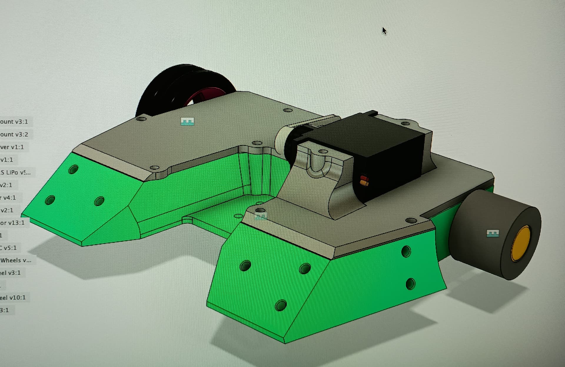

This worked out pretty well, but eventually I reached a point where I had to make drastic changes to the design and it needed a V2.

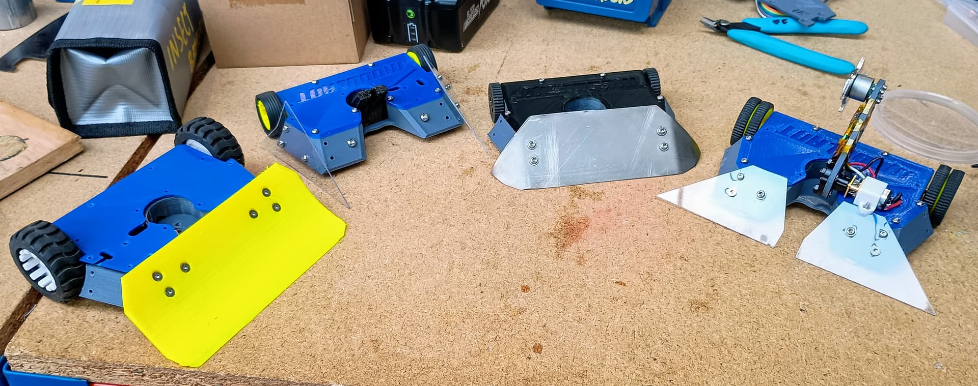

V2 built upon the first design, keeping the armour panels, shortening and widening the robot to allow for larger, easier to source batteries and stronger mounts for weapons.
I had started working with a local school on a robotics club to try and build a community local to me, and the battery changes were absolutely paramount as my little aging mountain of 180mah nano-techs can only last so much longer. The increased runtime means they can be used for STEM events without having to change the battery out every 12 minutes which is a plus.
As it currently stands the V2 has a flipper, lifter grabber, wedge, hammersaw and horizontal variants, as well as a silly dual vert option which I only ran once.
