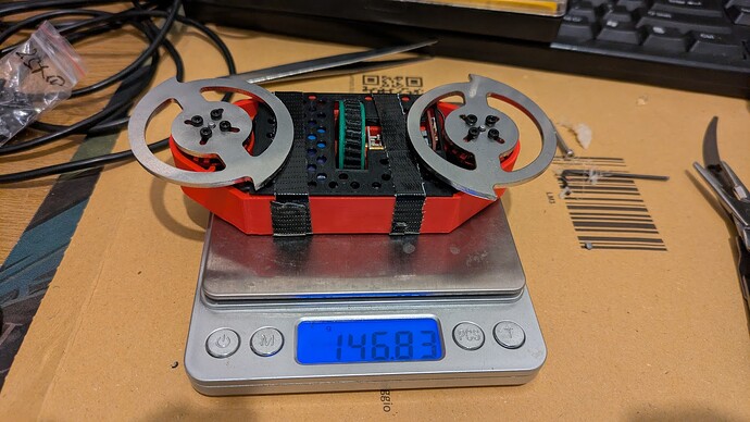

As with many antweigths, the biggest challenge was weight. For want of any real idea of how heavy a spinner needs to be to do damage I bought a pair of the lightest discs in the Monsoon Robotics shop, coming in at 21g each.
Coupling those to a pair of the standard ant weapon motors + ESCs from the BBB shop brought the weapon stack to ~82g. Add in a battery, an N10 + Brushed ESC for the drive motor, and an ESP8266 for control, and we were left with ~24g for the chassis. Thatâs not a lot of grams.
We originally wanted to have one spinner mounted âupside-downâ as an undercutter, so that weâd be able to hit at different heights, but we just couldnât get this shape small and light enough. After our best shot died on the print-bed, we sacrificed our original name choice - Centripetal Farce - to its memory and rebranded as Chinoops.
Even with the much simpler symmetric chassis configuration, it took many iterations and much pondering about component positioning to get below the limit. However after several late nights with Fusion and much resoldering we made it underweight.
3 whole grams underweight infact! (Most of which were immediately spent on googley eyes and decorative/protective duct tape).

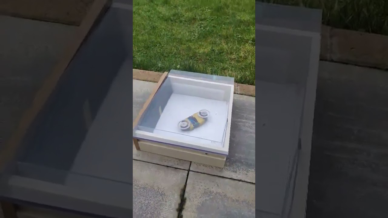

Meanwhile the coding had mostly been surprisingly straightforward. Hereâs some footage from our first test to see if turning could be achieved:
Yes, my test-box is a reinforced draw⌠watching this back I realise that there really should be something heavy on top of the 6mm polycarb lid just incase. Lesson learned.
In addition to basic steering and spin-up, we decided there should be a button that would stop both spinners incase the speeds ever got really weird and we wanted to reset. This had the fun effect of undoing all prior steering in a single sharp jolt (as happens at the end of the video).
Unfortunately, the first time I tested this feature the back-emf from the motors killed the ESP, bringing the projectâs ESP death-count to 3.
Adding a BEC resolved this problem.
