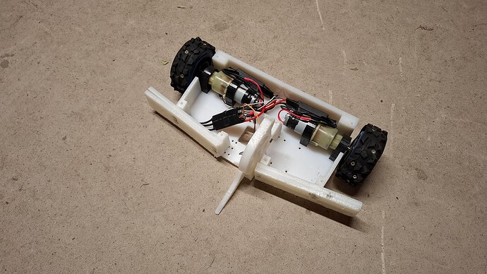

Here’s where I began at the start of Sunday:
Drill motors and wheels with ESCs intact, and a brushless ESC that needs to go. The plan is a simple 2WD pushbot using two PM12lb forks.

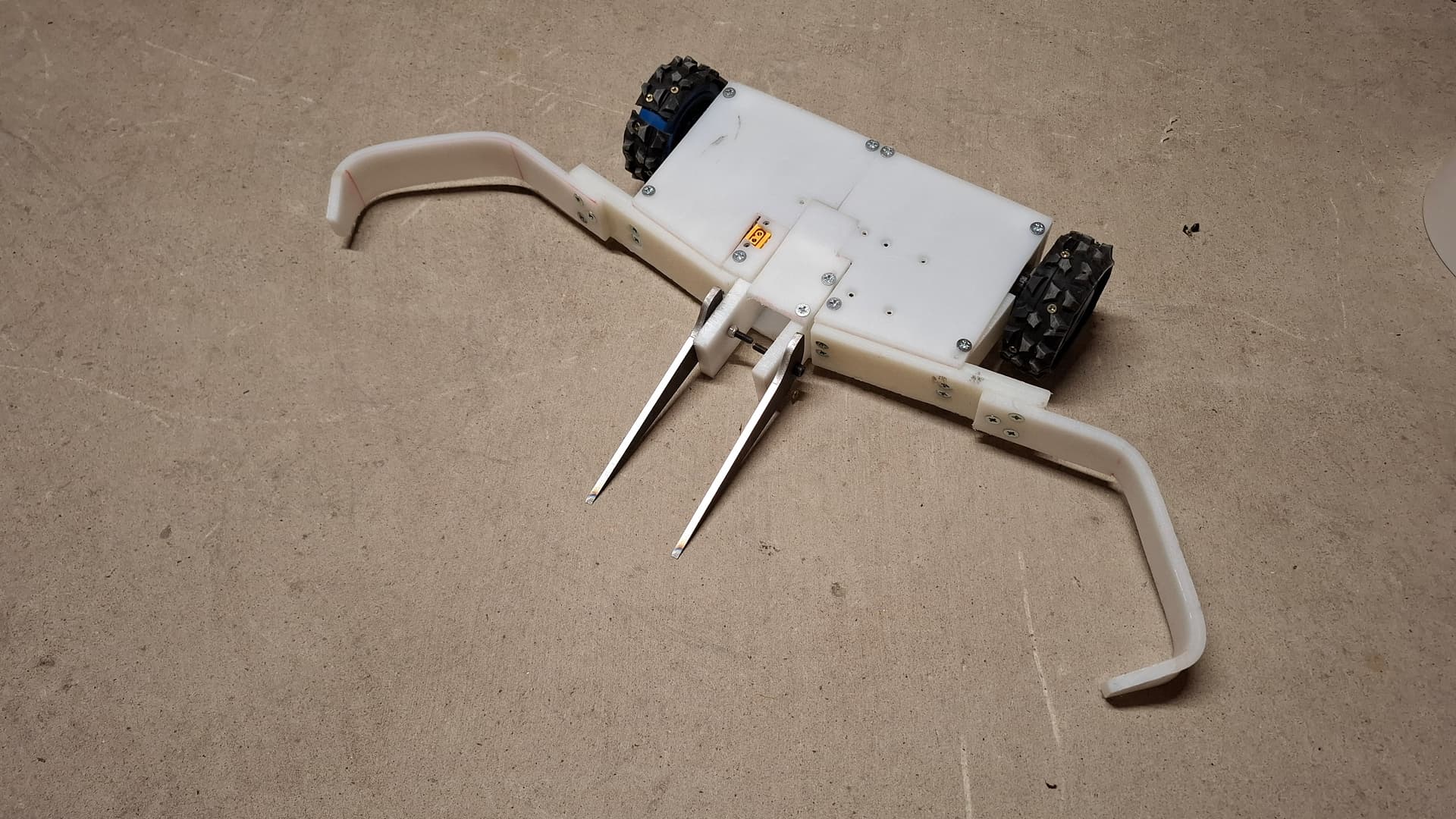

It’s up an running again, now as “Waste Electrical and Electronic Equipment”. The wings are inspired by The Widened One and should help with controlling opponents. Being drill motors in a ~3.8kg bot, it has a lot of torque - enough that it pops wheelies, and can invert itself! The forks are compliant, so they run both ways up at least.
All of the plastic additions were all done with hand tools rather than me reaching for the CNC, and I found it oddly theraputic to go back to my old style of building for once (albeit with more guesstimation and eyeballing!).
