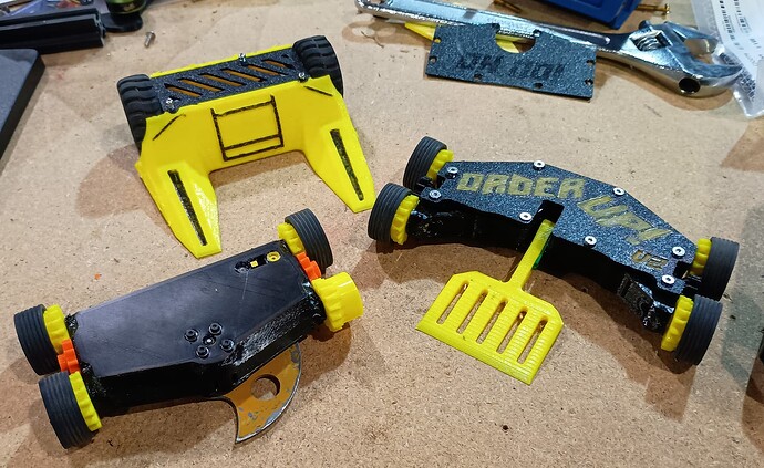

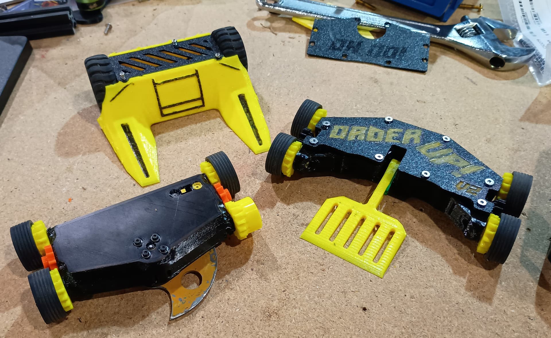

So about 9 months ago, I was inspired to make gear-drive a thing again, and to use my new fancy paper-takeup roller wheels to do it. They’re about 20mm in diameter, and offer unbelievable grip but are incredibly heavy compared to a normal wheel.
Took a while to set on a design as I couldn’t get a vert or overhead to work nicely, but then
Underhanded Tactics, my 2nd favorite robot I’ve made yet.
Pretty messy spaghetti wiring but it worked, and was fiercely non-invertible, but it worked, and worked well enough that it warranted a further development.
There’s been a few revisions, but I’d say we’re still at V1.3 rather than a true V2. Initial changes were to lose the wheel hoods as they were a faff to print, and didn’t add to anything other than adding biting points. Also fairly important to fix was the fact it didn’t drive inverted, initially I tried shifting the wheel position, but got stuck trying to work around the 20mm wheel diameter.
The biggest quality of life change was to fix my usual issue of lids containing components, as the drive motors were stuck in the lid, and the weapon motor in the top it made disassembling this a complete pain.

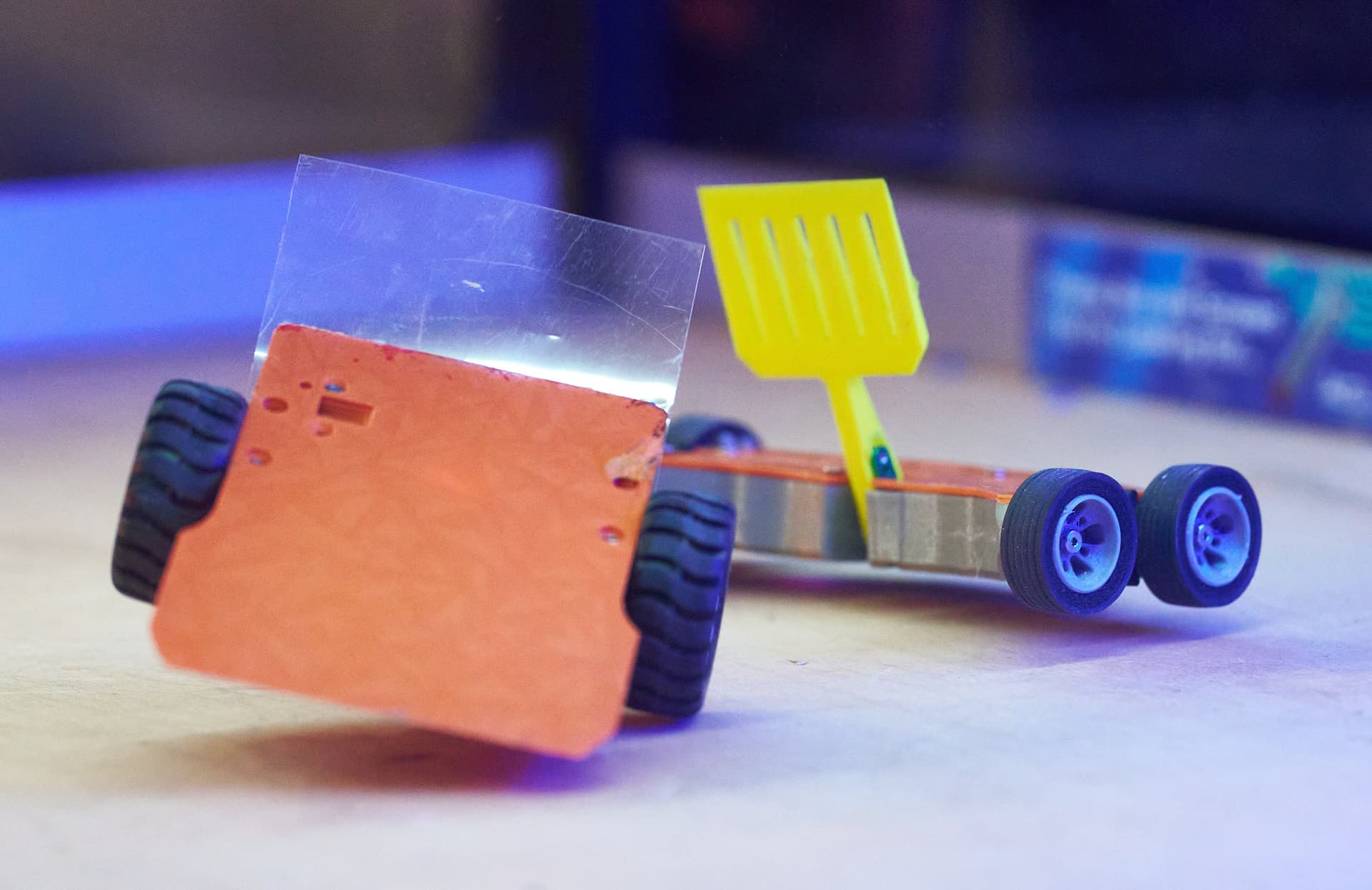

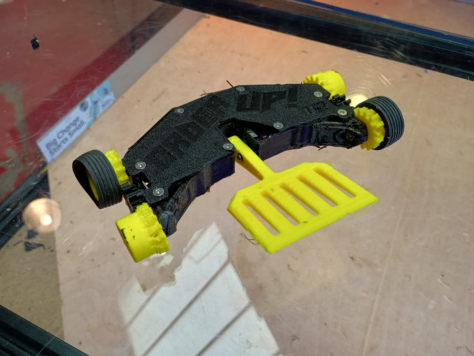

Sometime around when I was working on “Mr Stihl Your Girl” I was playing around with gear drives and trying to use them to make a lifter. I don’t think I’ve got any photos of the early cad but it was based around lifting from the rear with a high power servo to transfer the weight into the centre of mass so robots can be effectively carried.
After playing around with lifter ideas I decided to just make something silly and put a spatula on it, and Order up! Was born.
It uses a wing style servo to control the TPU spatula, and my joke robot actually turned out pretty good!
The V1 had (nonfunctional) protective skirts and feeder wedges which could be attached to the front of the robot.
The TPU spatula actually transfers a reasonable amount of torque, and it can fling robots around 50-60mm into the air on a good launch.

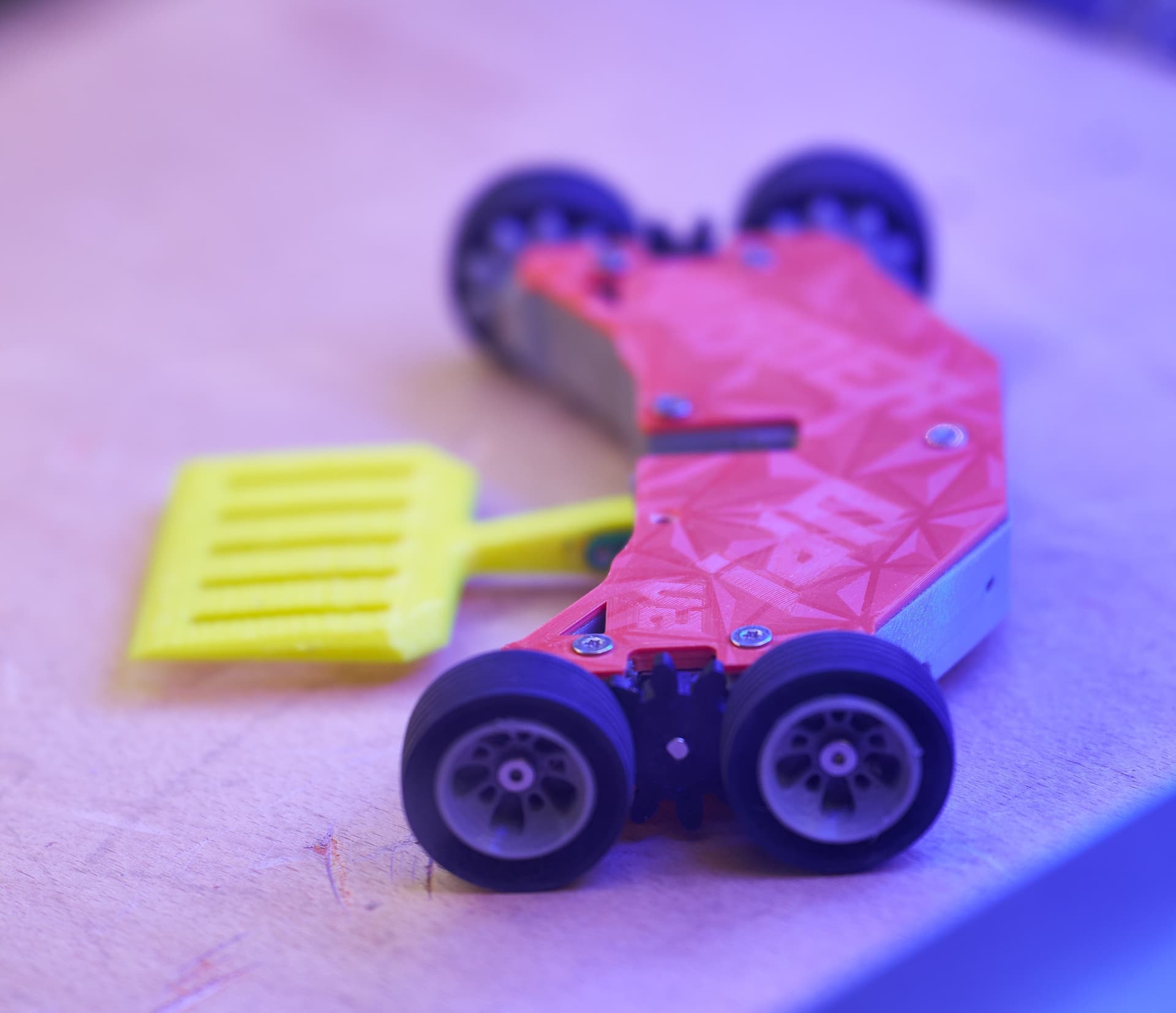

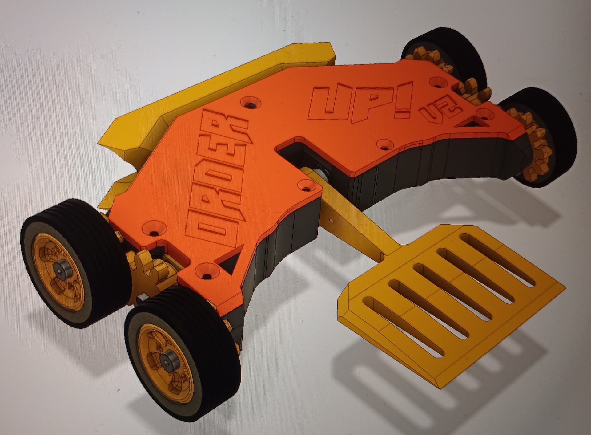

The wedges and skirt put version 1 overweight, so after some chopping, changing and general shrinkage V2 was born.
V2 was shorter, thinner and drops pretty much all the attachment points for an anti-horizontal plough for the rear.
The body was thickened up, and designed to be made in TPU to better resist getting split in half by verts.
The large wing servo acts as a stiffener, and with a rigid PLA top plate stops it being a floppy mess.
Still no plough for this event, and these are the last photos of V2 as about 20 minutes after this Ellis turned it into a pile of parts again.

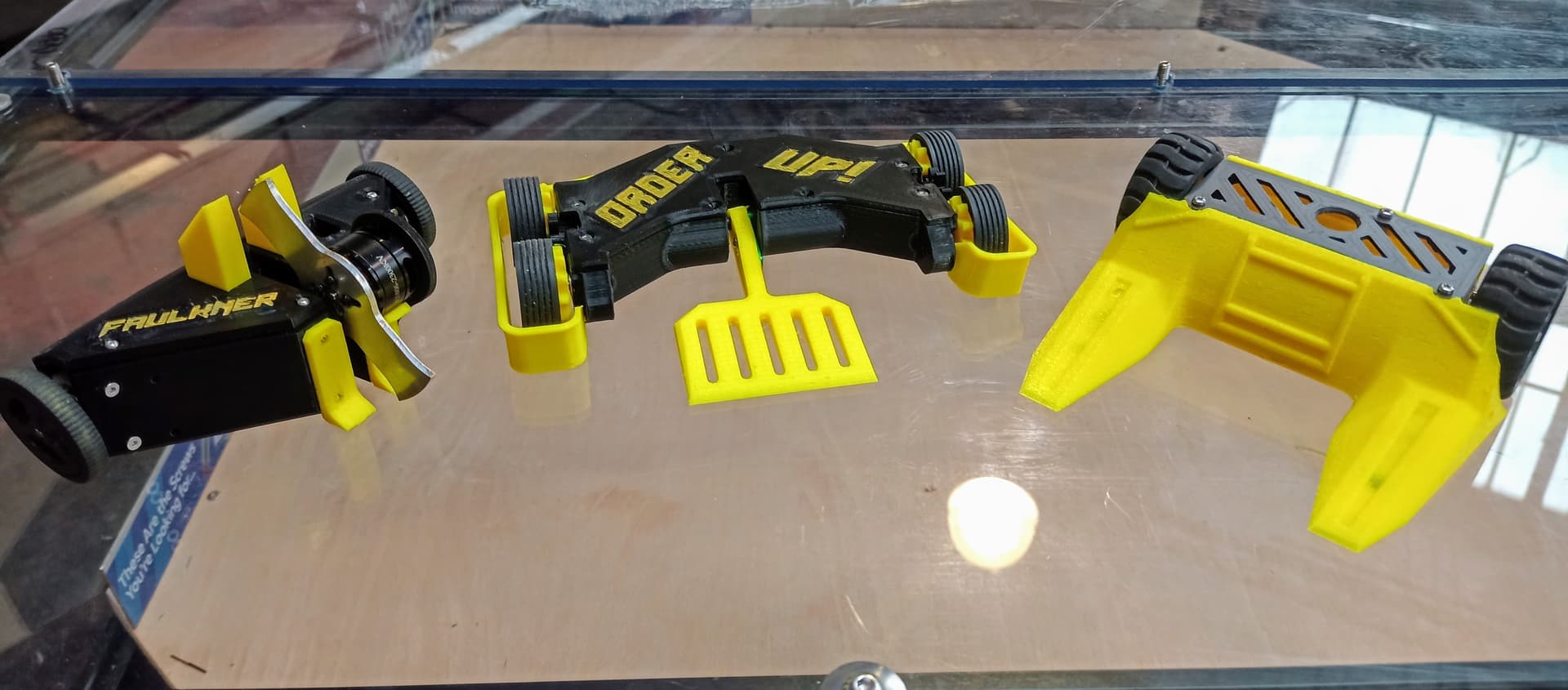

I don’t actually recall making many serious changes, but I entered myself into Dojo Ants in January and figured it would be fun to bring along.
I’d initially planned to bring underhanded too, and in an effort to reduce the number of spares and increase common parts I bodged the wheels designed for underhanded onto this robot, and with massive abuse of gear profiles and the offset face command I had V2.1.
I don’t believe there’s any photos, if I find any I’ll post them but it didn’t last long, most of my practice fights are against vertical spinners, and they have a habit of snapping portions of the lids off and exposing the battery.
Numerous changes were made to remedy this and further stiffen it, but the main two were to move to 72D TPU for the body, and to relocate screw holes and increase the number of fasteners in the lid. Now at least even if the lid cracks there is less chance of catastrophic component ejection.
Order Up! V2.2 went 2-2 at dojo, which was far better than expected, making it my best ever event and most successful robot by 200%!
I just love this guy, due to the TPU arm and the indirect drive, there’s very little to go wrong and it lasts a long time between repairs. With a bit of soldering iron welding (and 4 lids) the same chassis has ran for 3 events and survived around 8 minutes of spinner exposure.
There’s developments in the future planned, but it’s just so fun to drive it’s likely to stay as it is for a good while yet!

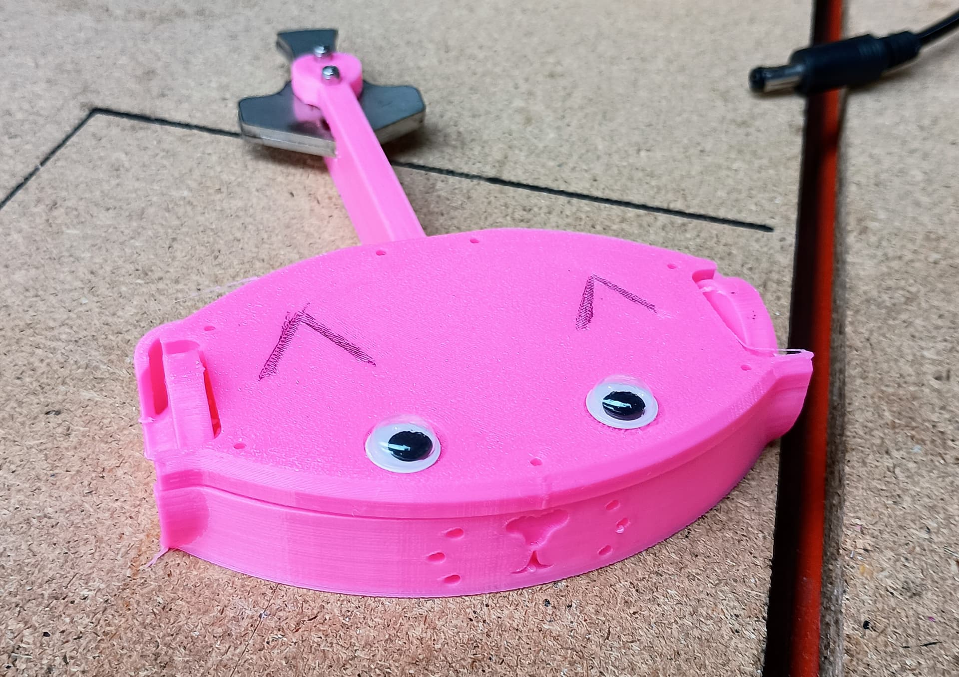

It been a while since I’ve updated this, it feels like I spend more time now helping other people with robots rather than building my own.
A few highlights of the robots I’ve built since the last post, two fo the silly ones first.

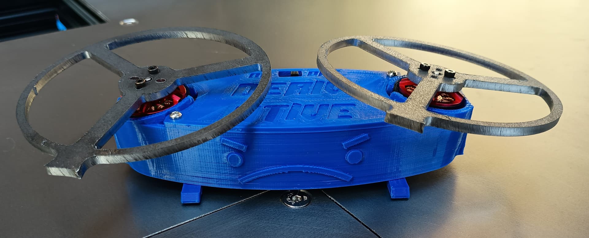

Derivative - a 200g Gyro walker, with twin 100mm 43g blades. Truly terrifying, built as an example and promptly scavenged for parts.
Silly, unstable, and very similar to other robots.

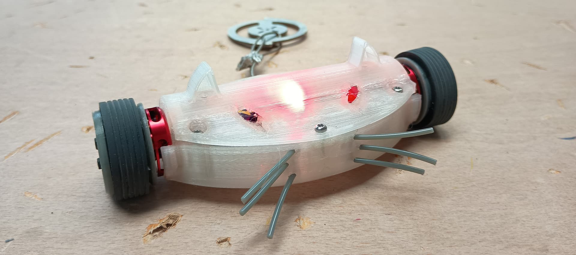

From the ashes of derivative (because I didn’t have to rewire anything) came Neko
Photos don’t really do this justice, dreamt up after an inside joke with another driver inspired by “gamer girl headphones”, this transparent menace has 6 different RGB LED’s in it. The flexible tail was just thrown on with some crimps, but it held up to a few full power hits, and when it got up to speed it was really something.
After a few laughs we realized it actually had potential as a sit and spin/melty and changed the body to TPU, and gave it a slightly more rigid tail. I don’t have any photos of it not spinning, so here’s what the body looked like before assembly, it’s got a little 4mm stainless tooth to give it some bite.
It’s actually reasonably effective, and can deliver some massive hits. It’s currently being redesigned to decouple the drive motors from the wheels, as it’s got an annoying habit of destroying 1806 cans on a decent hit. I’m looking at going to something more 14xx or 11xx for drive with a gear reduction, as its never going to reach top speed and it really doesn’t need to.

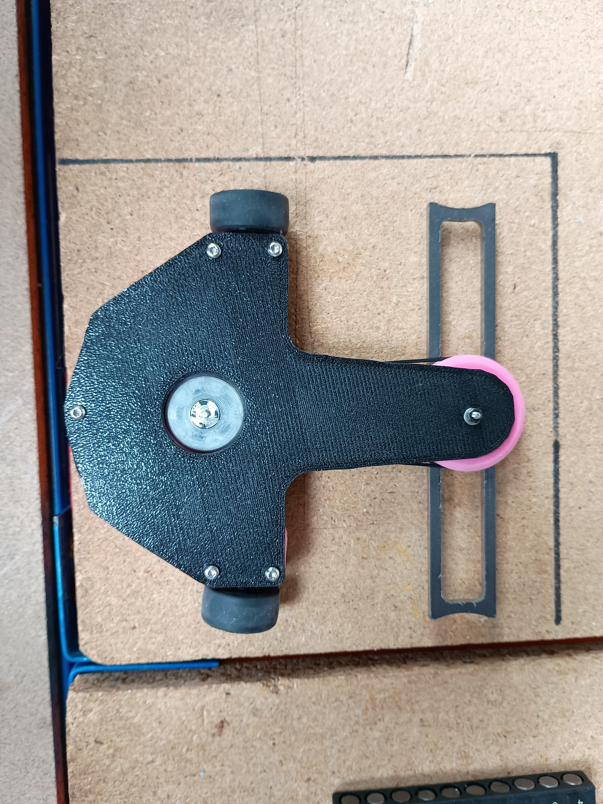

Capybara - pretty much just a weapon delivery device.
It’s a big horizontal and does big horizontal things, but at only 124.5g with a battery as it’s pretty much made of tissue paper.
It’s a glass cannon and has some minor weapon clearance issues on the first revision, but it’s been fun to play with so far. Very much the spiritual successor to Transvector in construction style, and it was originally meant to be green too!
Looks good! I like the traditional bar on it, the overall design looks pretty solid
I’m intrigued by the bar design; have you tried that geometry out in practice? Gut feel says it’s going to become less rectilinear with a few impacts, but one never knows without empirical evidence.
Blade was just thrown onto another order for vibes and the look factor mainly, it’s far from optimal.
It’s had a few test hits but nothing serious yet, each beam is 4mm wide x 3mm thick hardox so it should take some mild punishment but it won’t last long. I think it’s much more likely to just deflect on a wedge and cut its own supports or belt before any real blade stress. I’ll give it a run in the test box next week and see how much it deforms.

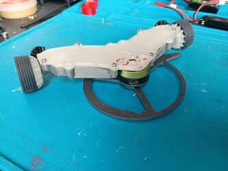

Another stupid horizontal I found in the parts bin - this actually came first. All the silly motor drive was to see how far into the blade radius I could put essential parts.
I had a very particular outer profile in mind when this was first thrown together, and it was to fit a 140mm disc on an antweight (135 in photo). It never got past the test prints but someday I might throw some electronics in it and give it a spin.
This is a fantastic looking bot - so cool!
whole thread is a collection of really interesting and fun designs. I’m a big fan of order up in particular
I really like the XL under cutter above with the gear drive you should definitely explore that more - it would be a beast in the arena
