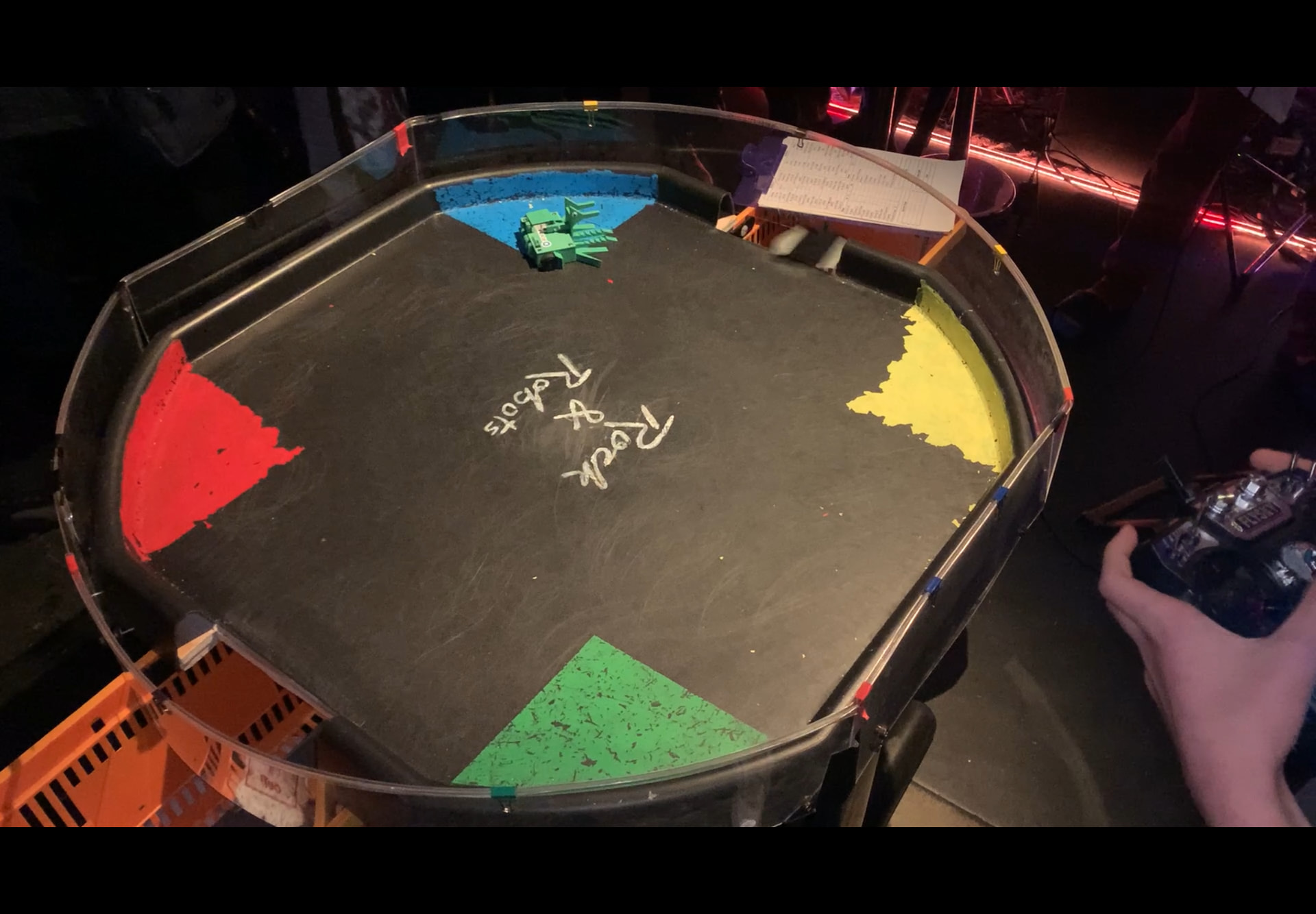

If you want something really basic and PLaNT focused you could do a rock and robots style (empty) sandpit.

Oh sorry most of the events I’ve gone to so far is GRoCS where they call it PLaNTS but don’t allow destructive weponary. My bad. Obviously if you didn’t want sportsman then a rock and robots arena wouldn’t work
