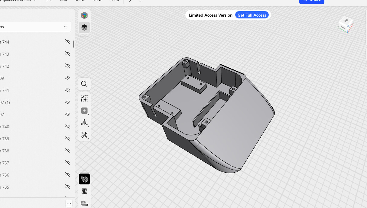

well, the new design has a more sloped wedge, 3mm walls (due to nugget being significantly underweight) and some more new bits to deflect horizontals and all that (wedge at the back too)

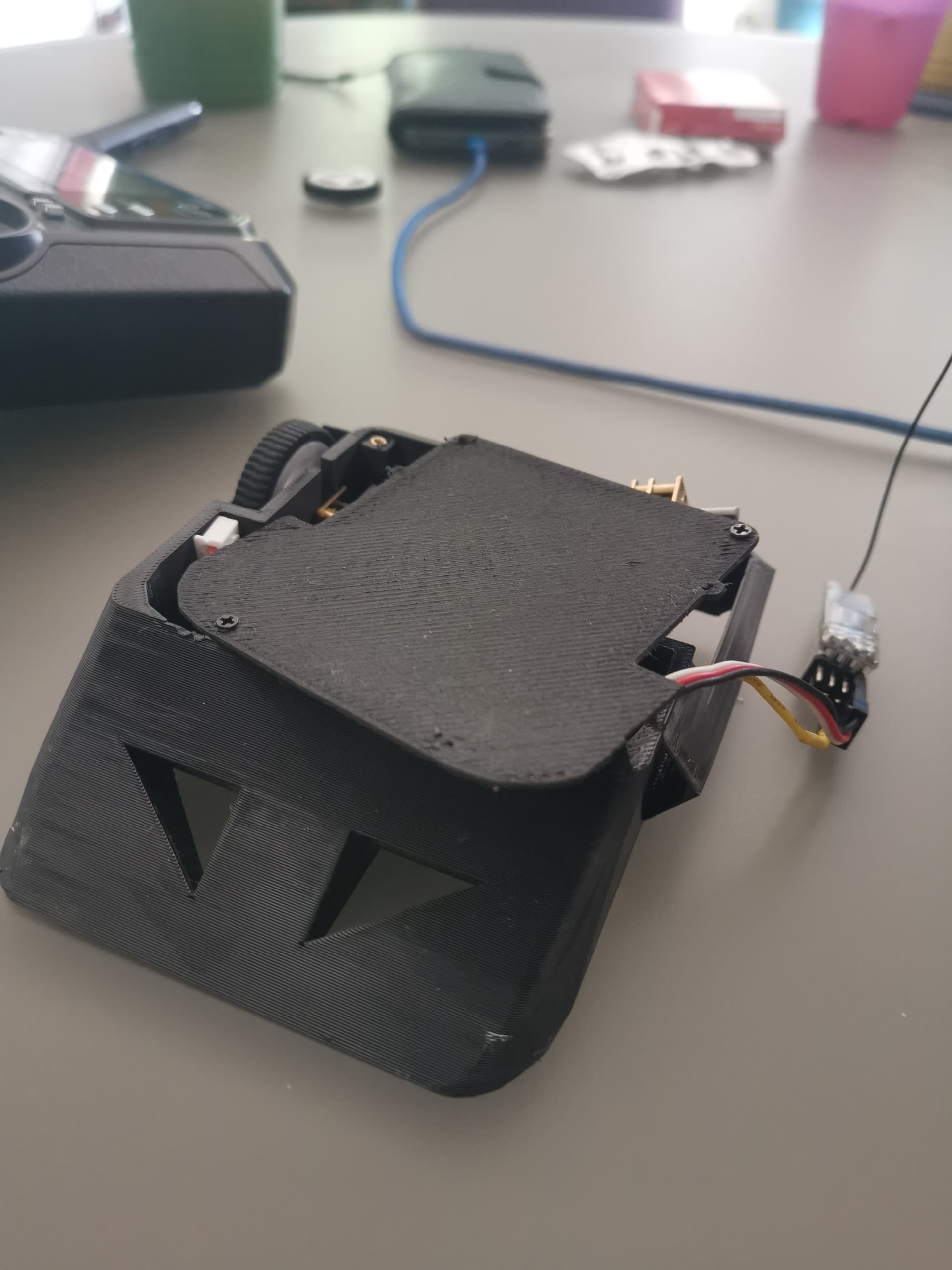

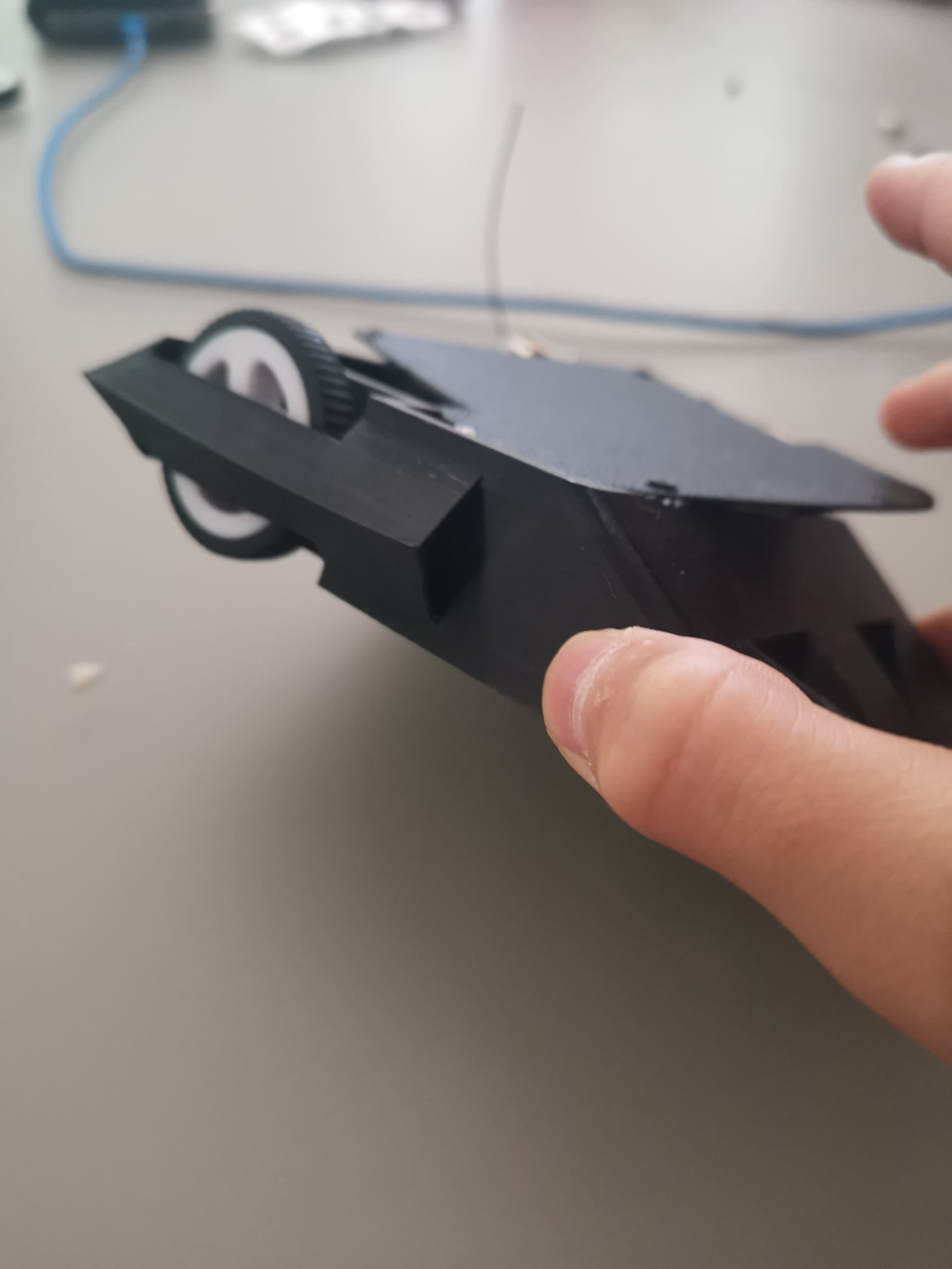

New version printed and TESTED! It drives at like 1000mph (faster than me sprinting) and can can run 8m in 2 seconds. One downfall is that the motors overheat a lot and some of them seize up after a while. I’ve added some soda and wheel protection so now boxy nugget V3 is complete!
Might add a flail and the ggogly eyes soon but as for now it’s around 120g
Sorry for me being off a while, since then I have resoldered the motor after it got destroyed (hint- 3000rpm n20s on 3s) and it works great. Because it overheats so quickly on full throttle I am now using a dandy little 2s lipo!
