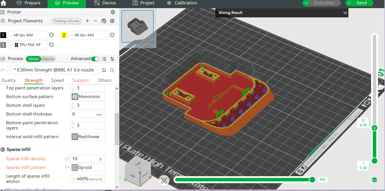

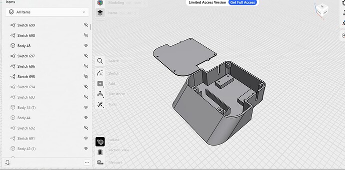

Ok, so while I work on Tombpebble, I have vaguely decided to revive my old wedge bot. I am currently printing it in tpu 95a for some flex and a nylon lid to hold it all down. I have some bits of 1mm poycarb lying around so i think I could use that to protect the big chunky wedge. This’ll be a fairly indestructible bot and is pretty much a prop stand to pour my non-malenki drive setup into. Hopefully I’ll have some fun with this one!

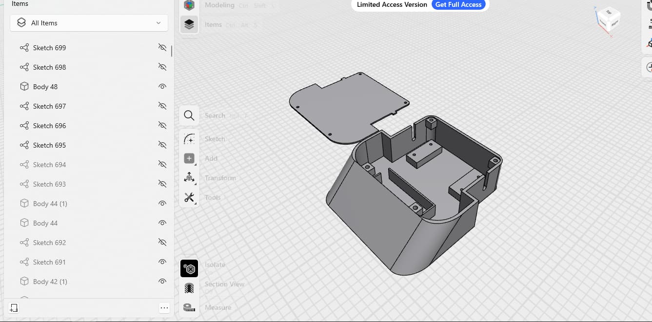

So here’s how thw cad and the printing’s going-

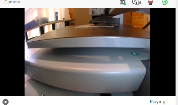

This is, like happening as i type right now so hope the print goes well.
The print was abysmal (as my prints normally are). Im turning to the more trusty 64d tpu to sort this one out. Hopefully this works.
If you’re printing TPU 95A, you need to print it sloooooow. And I mean bringing the print on all of the options down to 20mm/s, with the small perimeters to 50% and the travel speed to 200 mm/s, and set the heat to 220-230 celcius and a retraction length of 3mm at 20mm/s. That’s what I use for Overture TPU 95A, and it comes out fairly smooth, but it helps to experiment a little.

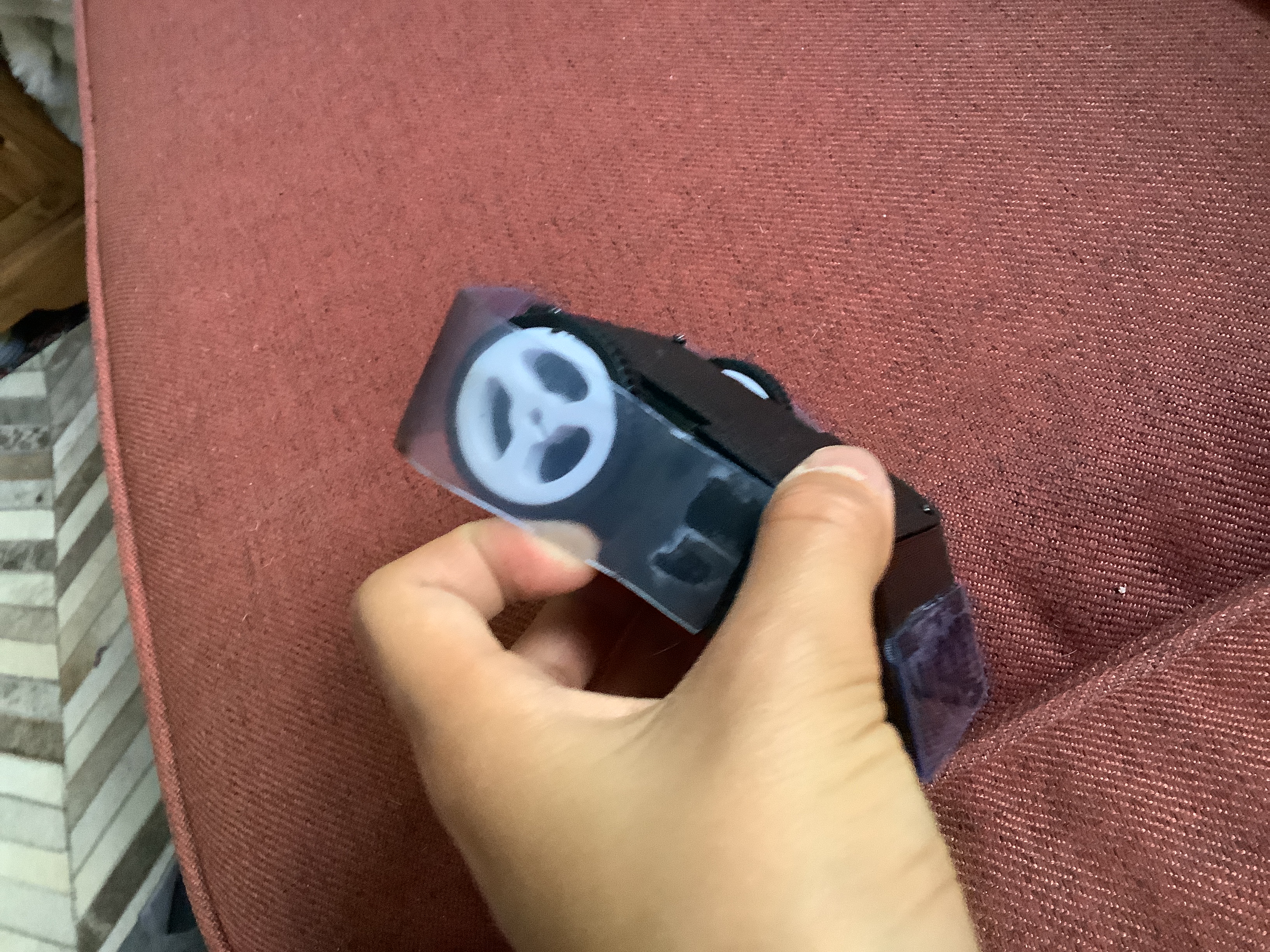

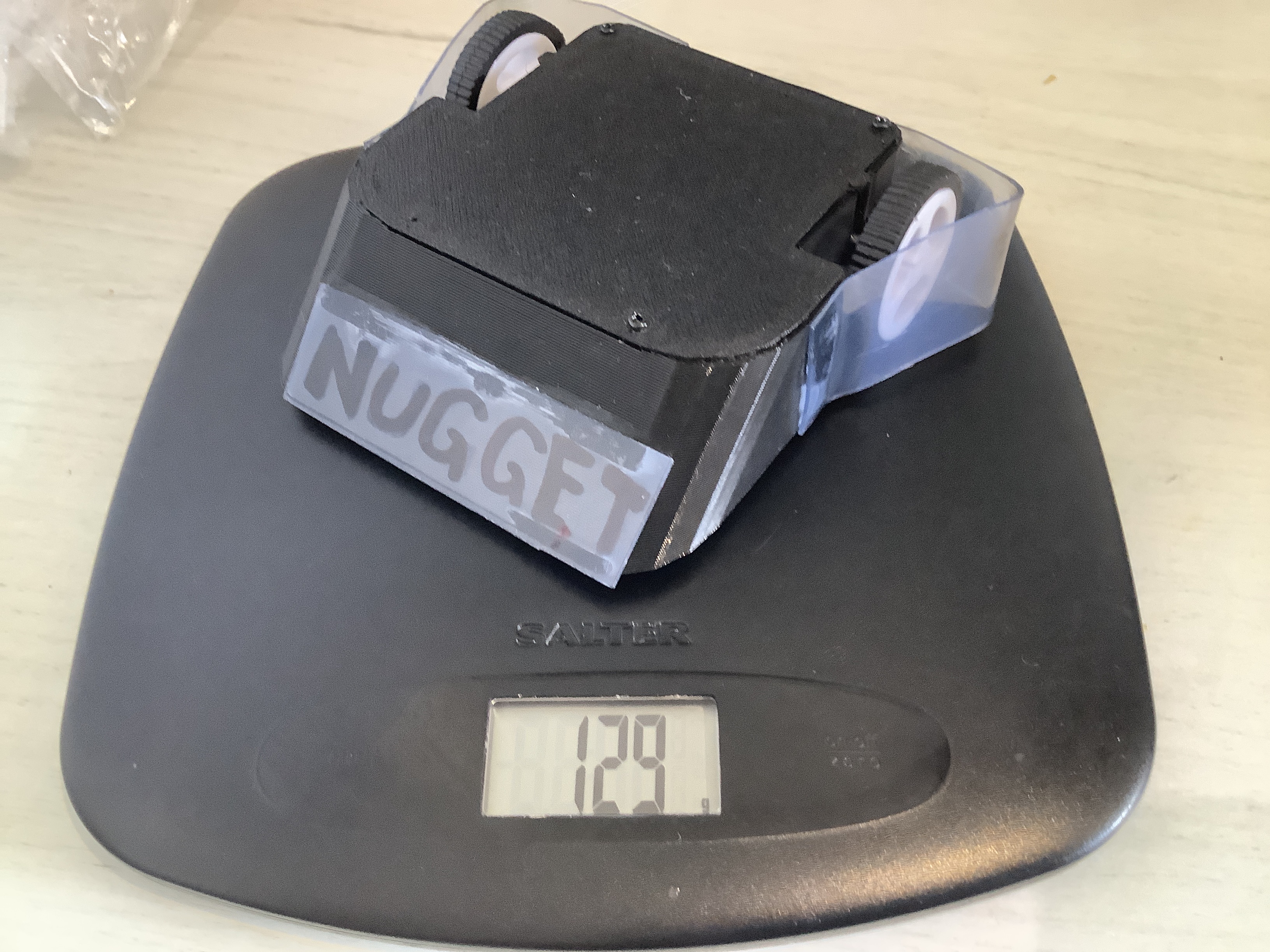

Thanks for the help-I might try it out whenever. But at least now I have this little guy! The print came out smooooooottthhh and oh boy does this lad look handsome! The polycarbonate armour works well with the aesthetics of the whole thing.
And the best part- IT WEIGHS NOTHING!!
cough cough I mean, 129 grams
The lid is kinda a pain to take off so I’ll show his guts later.

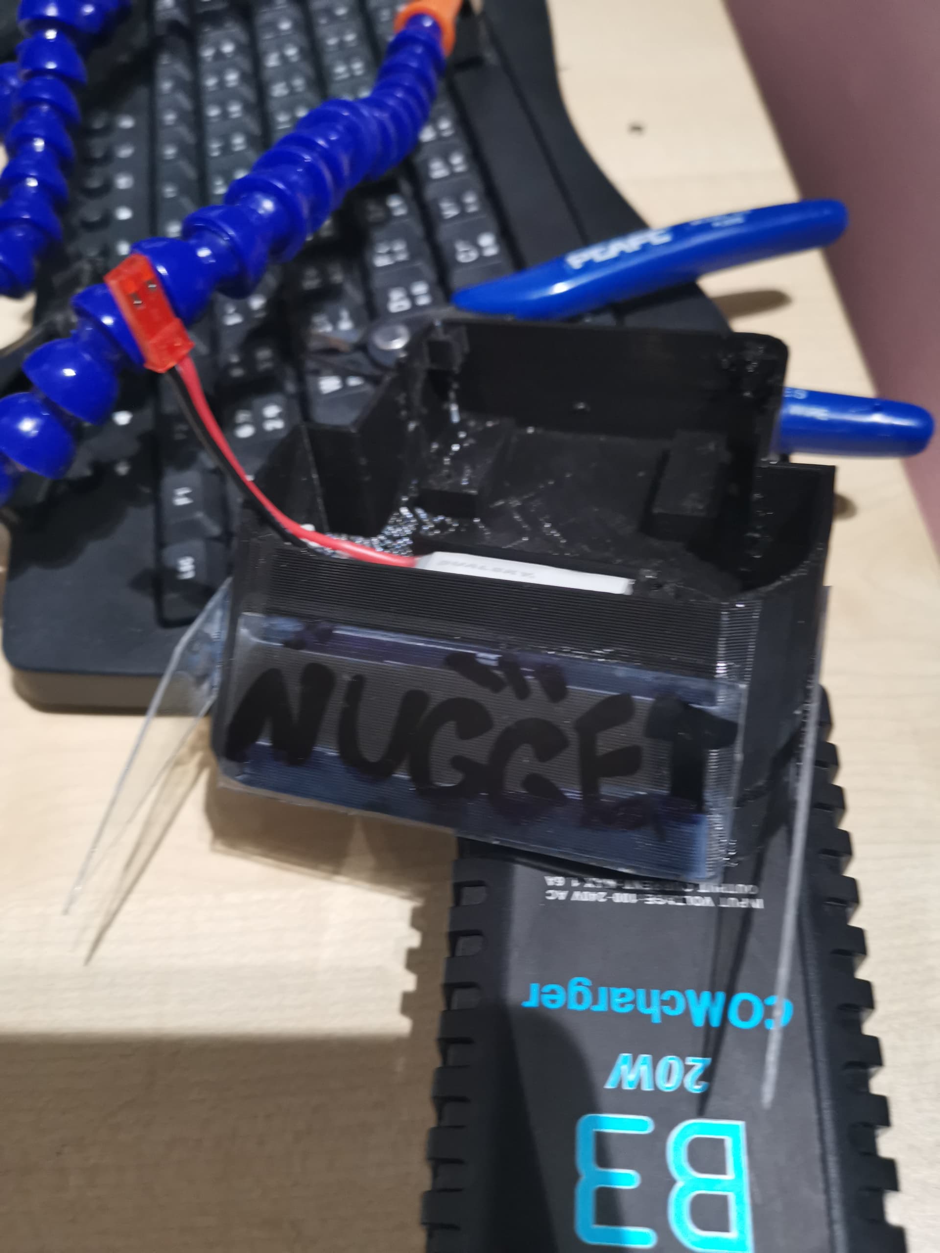

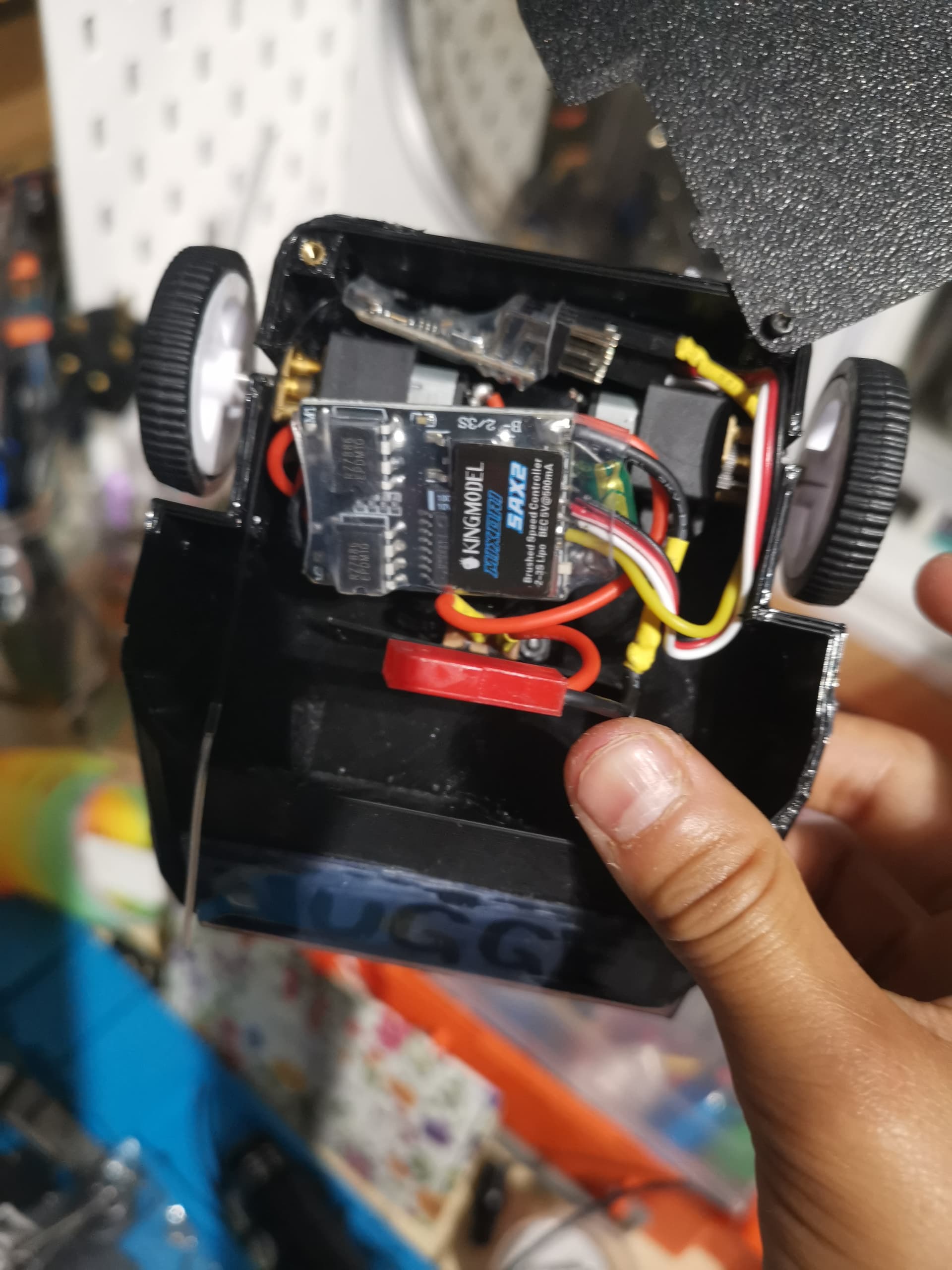

So now the old fs 2a is acting up, the bind button has gone on holiday somewhat, so no tests yet. I have printed an improved chassis with more blingy polycarb and it looks and works better… hopefully
Nice new chassis and promised guts
So now I just need to bind it. I have soldered up a fresh new fs 2a to throw on and it does enter bind mode but stops fast blinking when i power the transmitter on. I know that the fs 2a sees the tx but just dose’nt want to bind. I should try updating the tx software but i’m kinda stuck… any help would be nicely appreciated (from nugget and i :wink:)

OK, so I have figured out (totally on my own) that the fs 2a is probably DOA. I mean, the malenki on TombPebble binds up fine, so an educated guess could determine that.

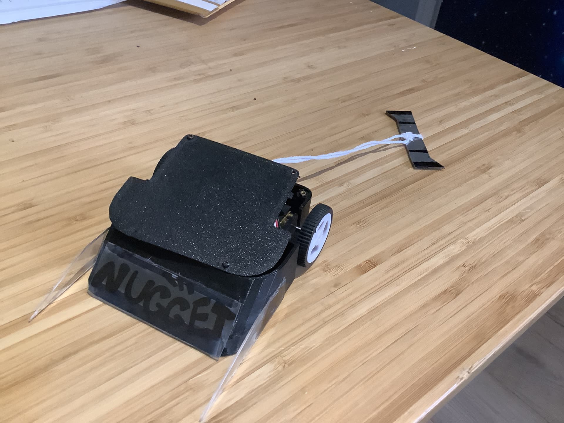

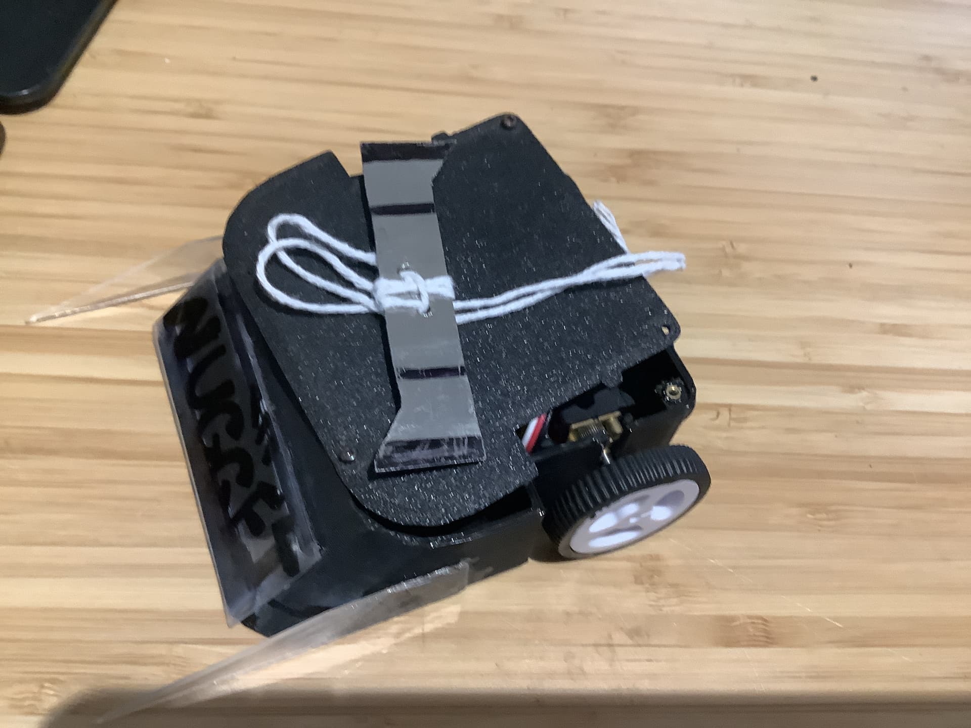

Now Nugget has a very very jank self defense mech - THE TAIL OF DOOOOMM! (btw, hamster’s tails arennt even that long but who cares) Its just some cotton string witha 316l bar on the end of it. foldable to fit in the 4" rule and 150mm rule. Technically this is not a spinner (for r&r) but if it isn’t allowed i’ll just.. snip it off?
I guess it’s just a cute flaily wedge bot
I’m sure the BBB ant events would welcome it with open arms.

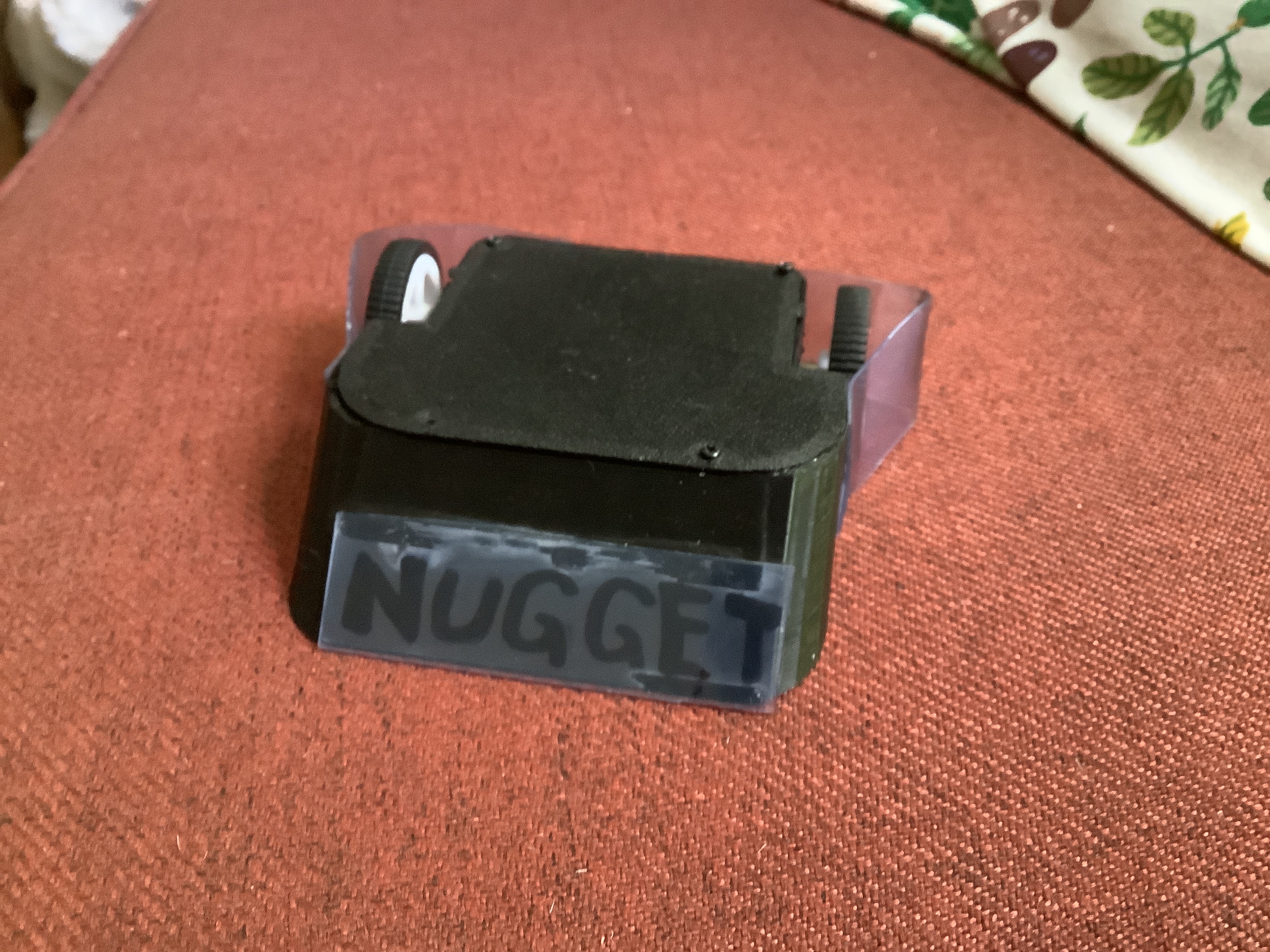

UPDATE
Here’s the new nugget, ready to eat.

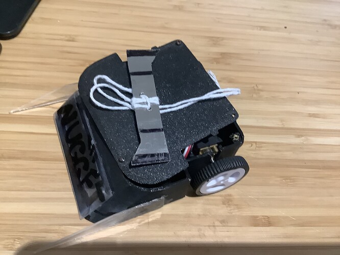

fold modeee
I just read the Eli Gumble website rules and it said “it must be no wider than the pit (200mm)” so maybe I’m fine. (200mm is a lot do you think?)
