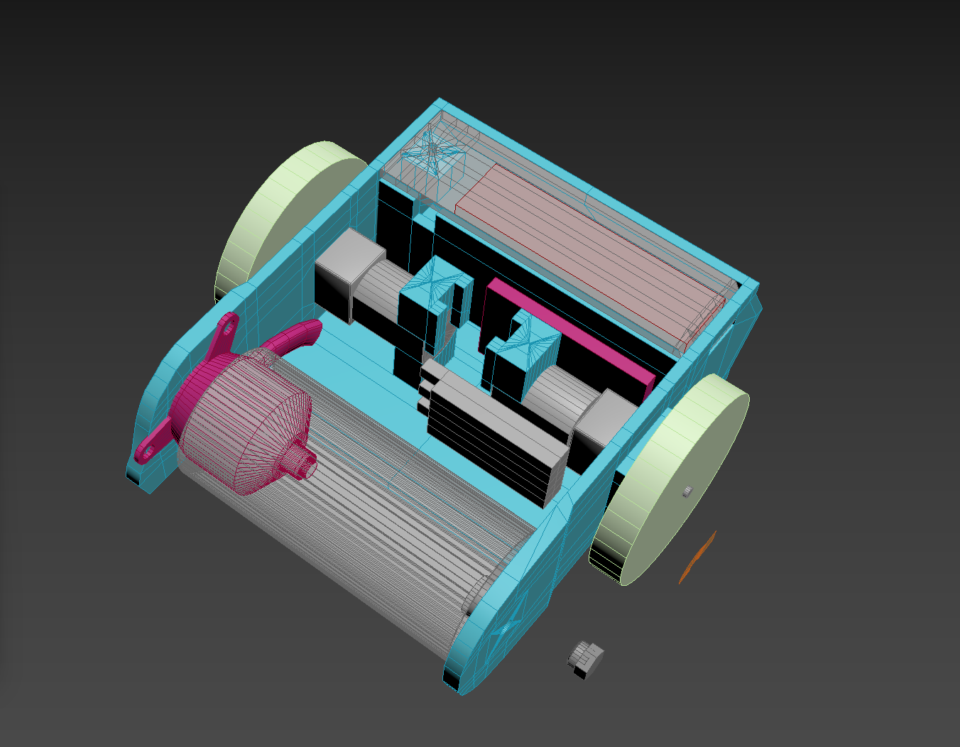

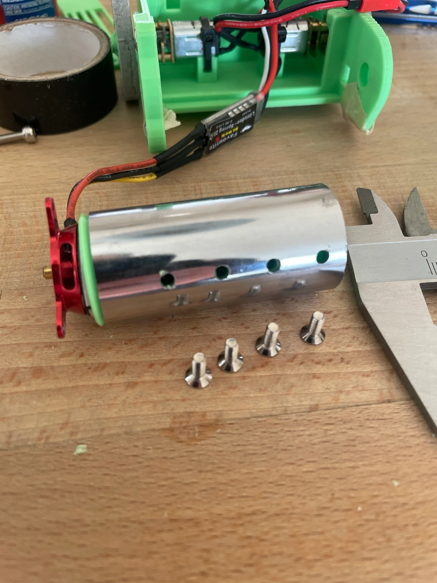

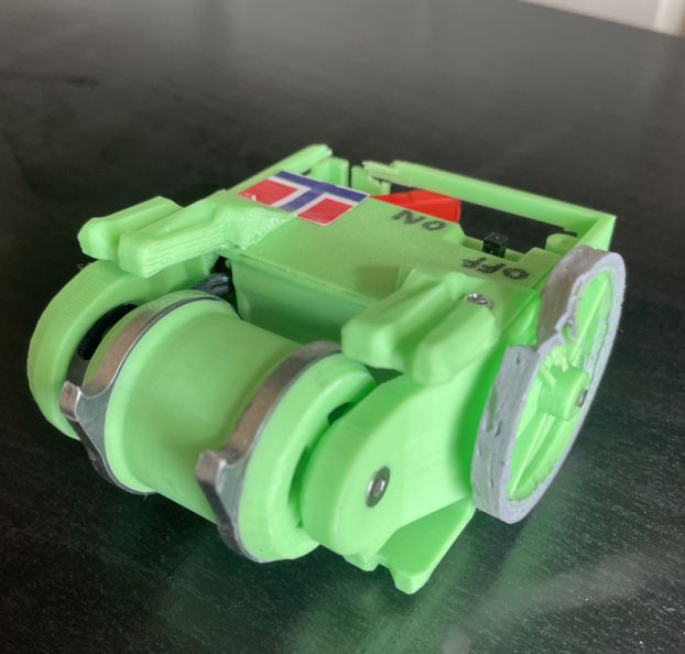

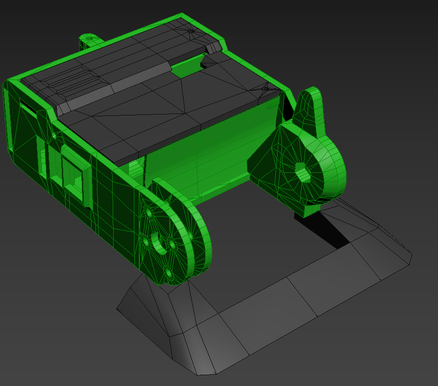

My original idea was of a wide belt driven drum spinner, with a pla+ inner core and a steel outer shell cut from a curtain rod for an extra layer of armor and coolness factor. But I had a difficult time sourcing ideal options for belts, so I went for the outrunner option instead.
I decided to put the wheels in the middle, so I can do odd maneuvers and flop about to confuse the opponents and myself. The battery ended up in the back, but then I only have to avoid being hit from behind.
I have begun to learn proper CAD tools, but for this one I used 3DS Max, as it is a program I am familiar with because of my background in visual effects and 3D/game development.
It looked promising, but.

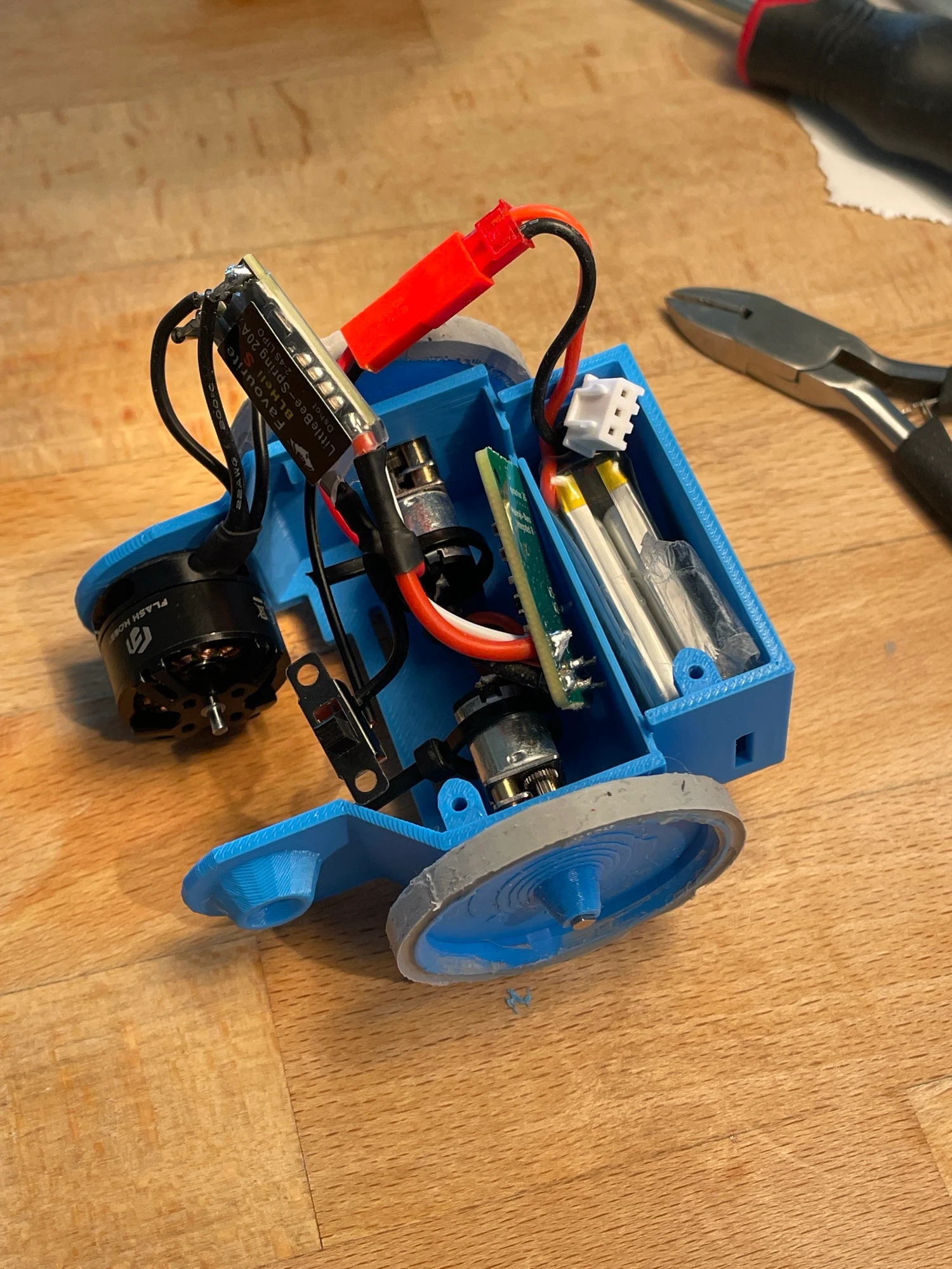

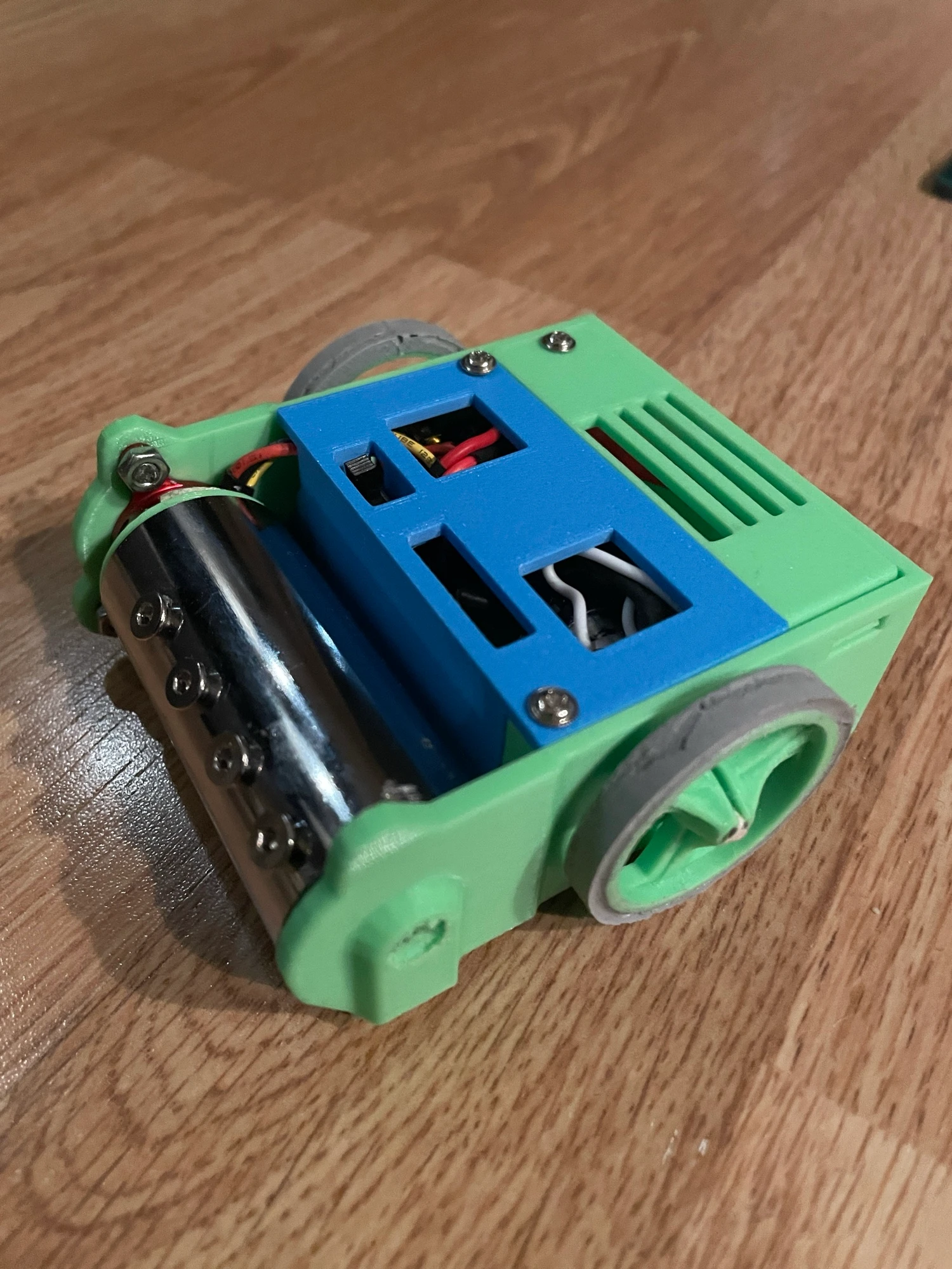

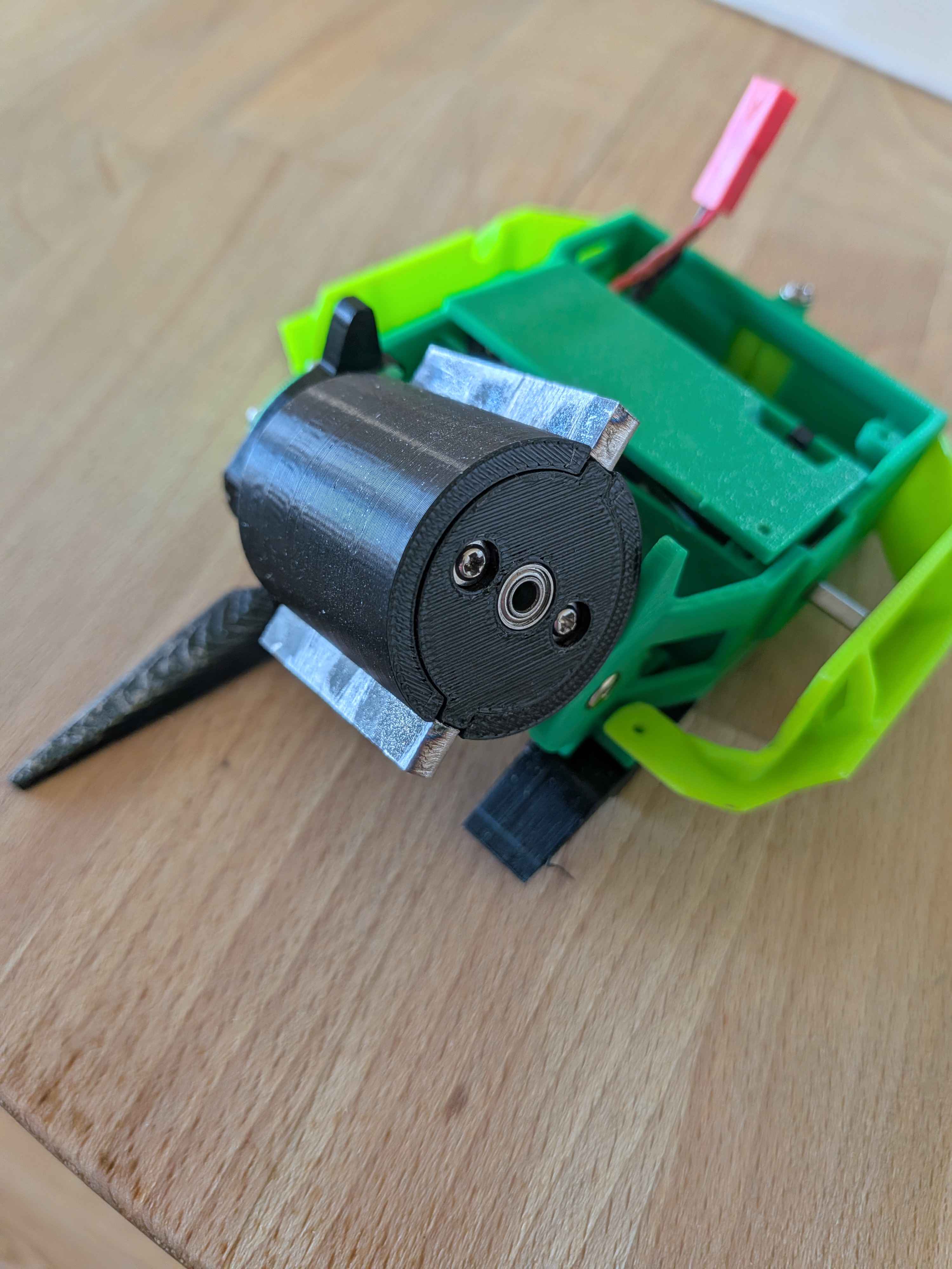

The prototype was fun to drive, but hopelessly unbalanced. Also, this particular make and brand of motor went out of stock, so when it breaks there is no replacement.

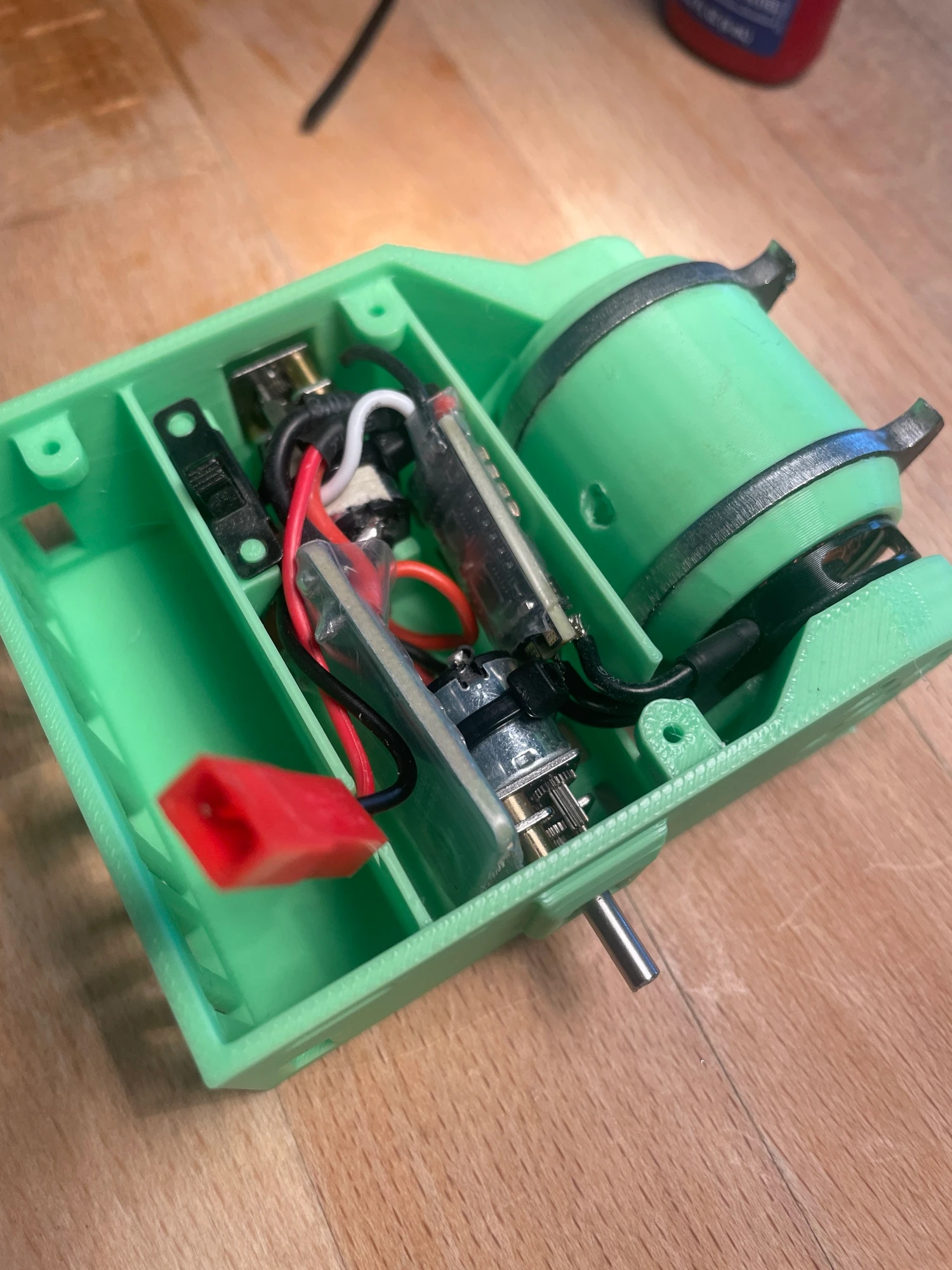

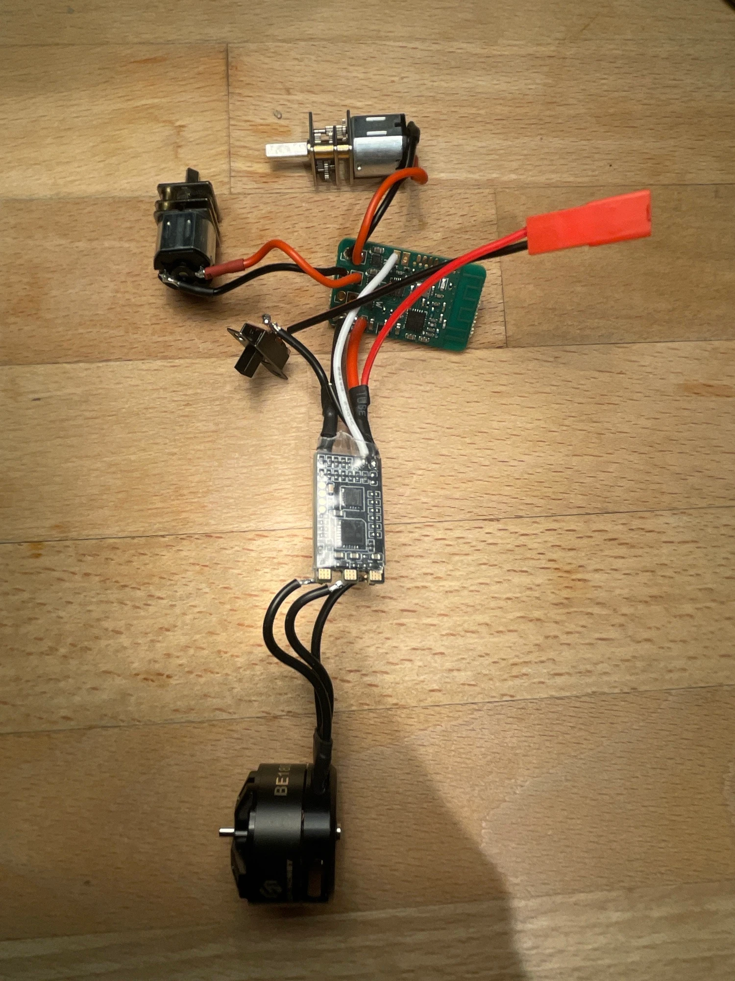

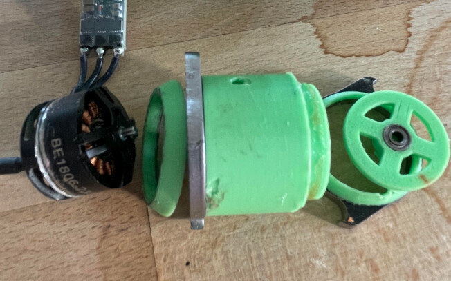

In its place I bought a few 1806 motors, but I had to redesign everything and forego the curtain rod, as the motor diameter is too big.
The Malenki is just brilliant.
It is ending up as a weird, tiny, cube shaped Minotaur.

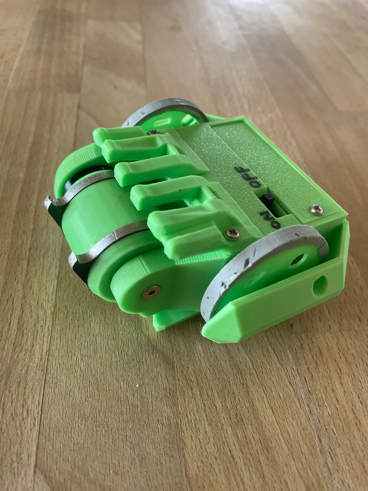

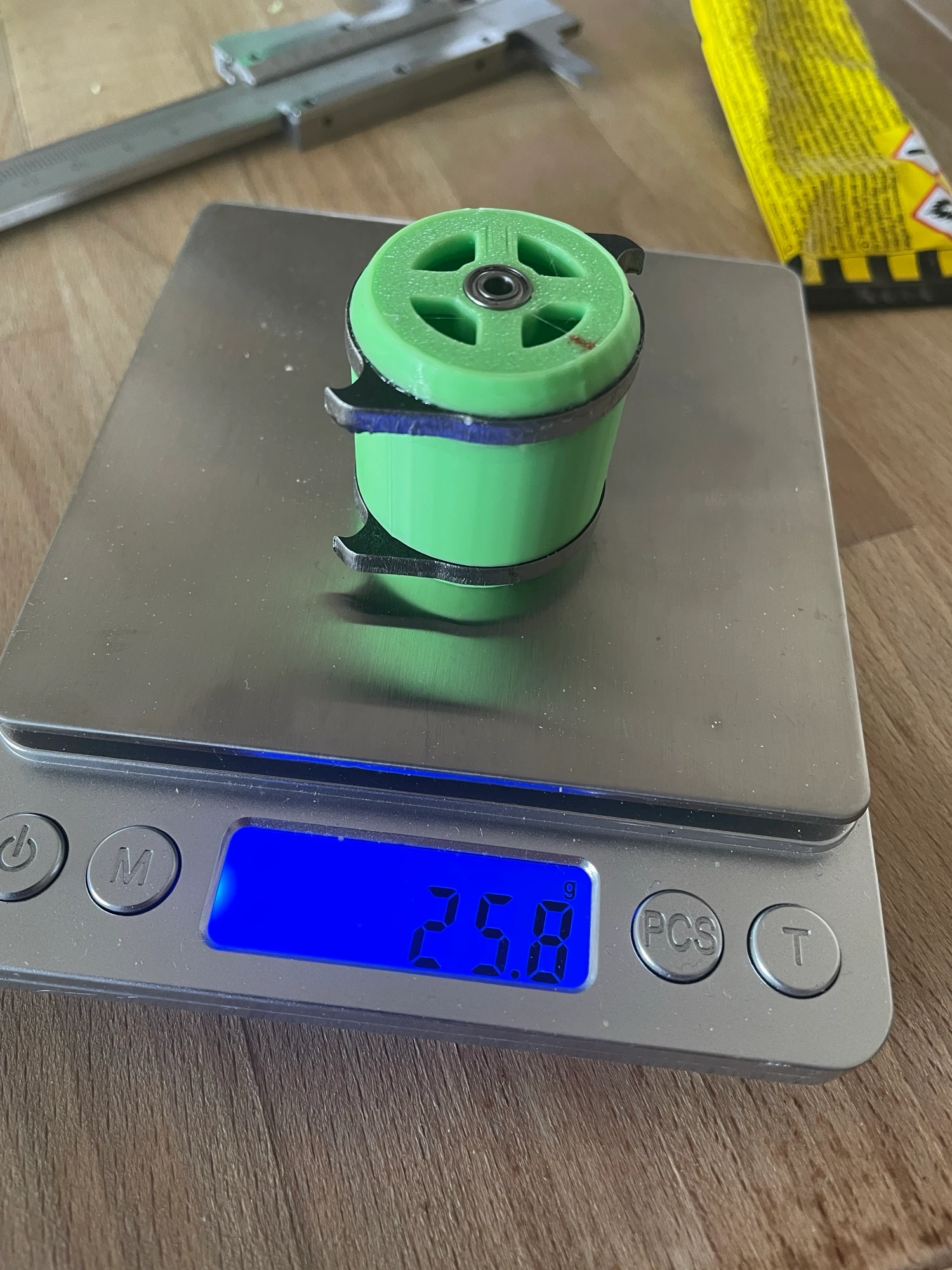

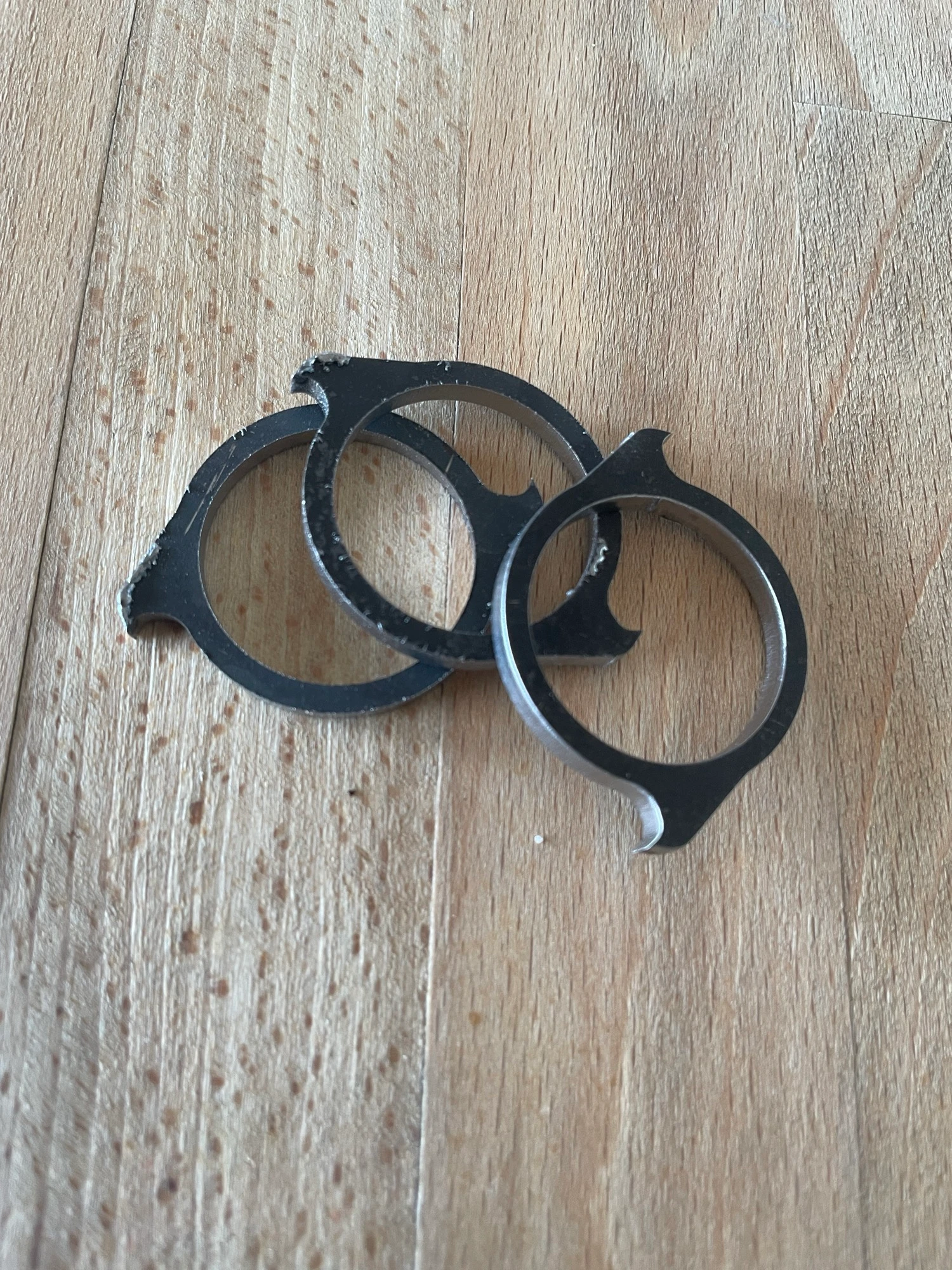

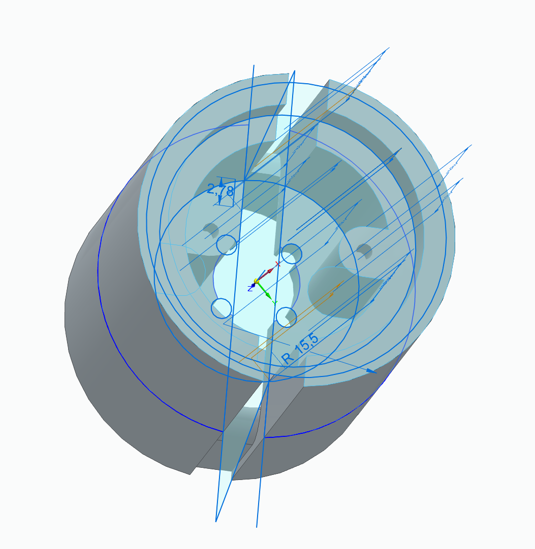

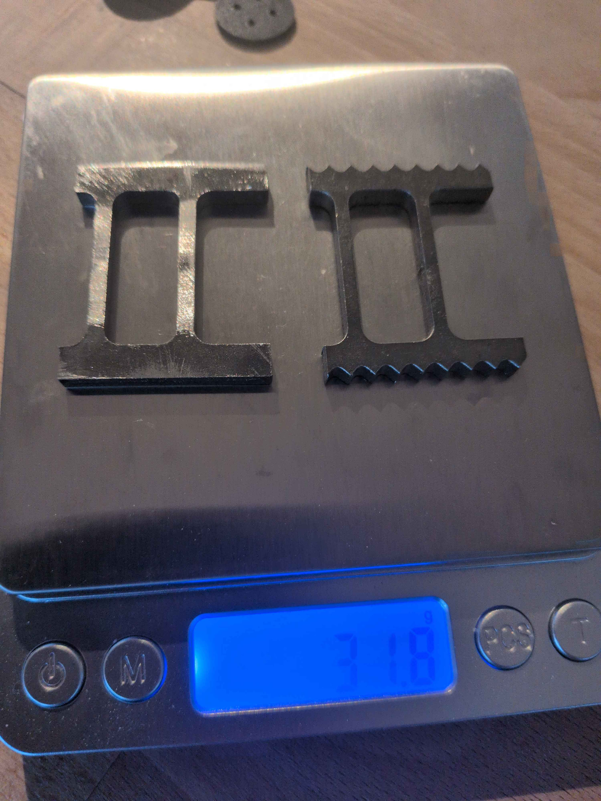

3mm hardox. Designed them myself in Solid Edge and had it cut by Scandcut over in Sweden. I also designed and ordered some forks and blades for future projects down the line.
I was planning to use 3 discs, but I had to invest weight elsewhere.
I needed some type of skis for running about without having the teeth making impact with the floor, so this is what I came up with. The wheels are made with bathroom sealant, crude but cheap and feels grippy enough!

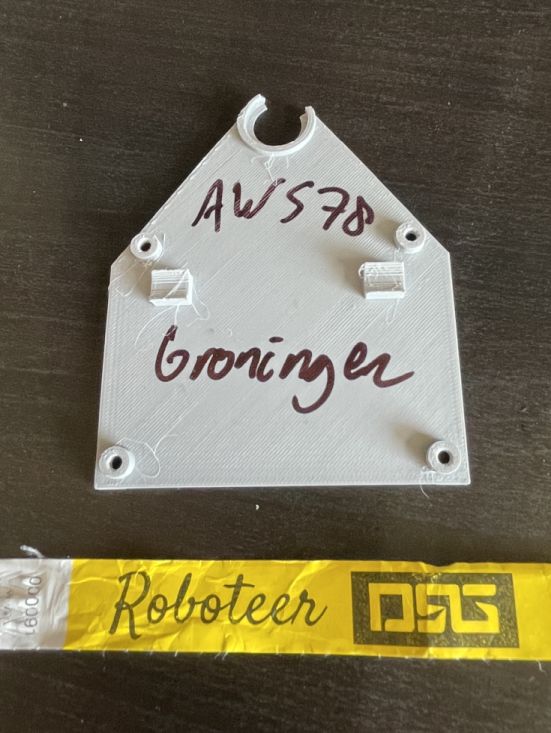

Back from Antweight World Series 78 in the Netherlands
A trophy/memorabilia I got from one of the organizers. I didnt fight this bot in particular(Raspberry), but they decided to give me something to remember the event by, thanks :grinning_face:
Though I only won one match, I’d still call it a success as everything worked as it should without gremlins and tech issues through four challenging 1v1s, one boss fight and the final gladiator match. And I am pleasantly surprised my soldering held up against some really gnarly hits.

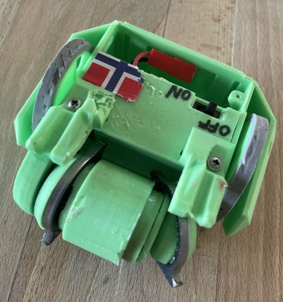

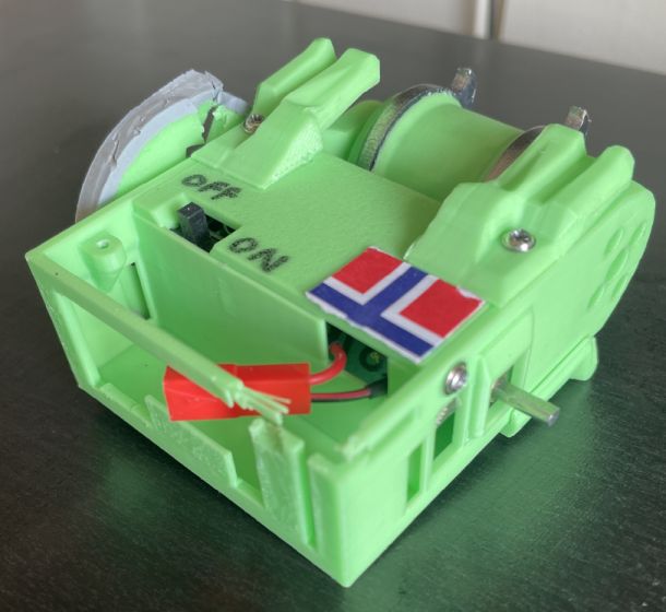

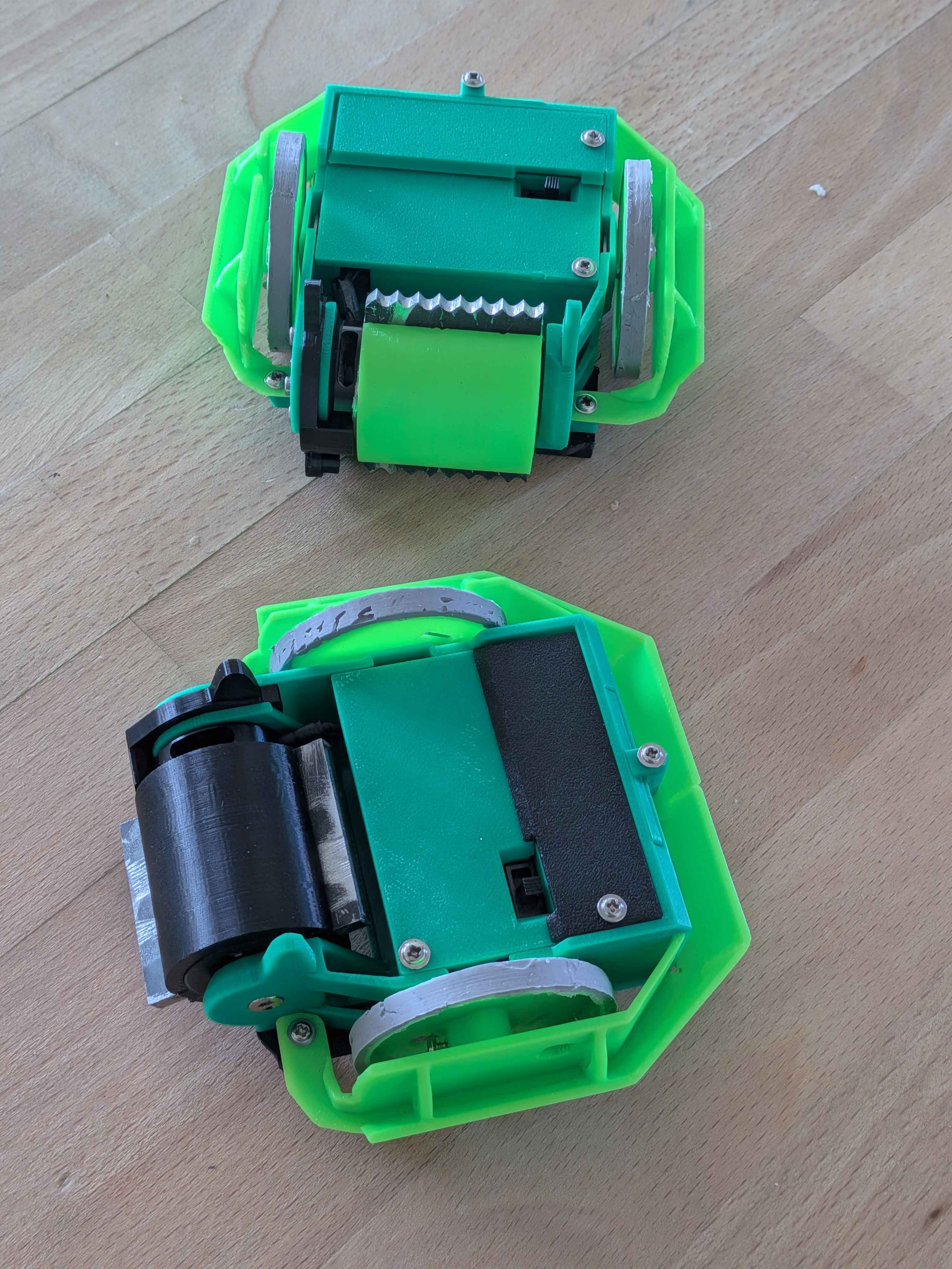

This picture is of the primary bot after the first 3 fights
The whole side armor package came loose in the impact from Buzzkill, partially exposing the battery. They demonstrated good sportmanship and held a distance as I was kinda immobilized anyway and tapped out. I used locktite glue to hold the side armor in place, but it does not fuse the PLA+ together at all, causing it to come loose instantly.

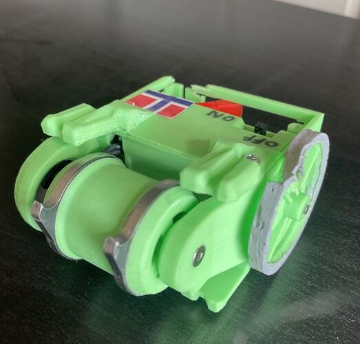

This is the spare bot after the last fight+boss+gladiator fight.
I learned that PLA+ and locktite superglue are sub-par components for a drum at events like these :laughing: It held up to vertical impacts(for a while) until I made repeated contact with the arena and driving at full speed into the beetleweight a few times, causing the hardox ring on the right side of the bot to come loose, impeding the motor and likely causing some overheat issues. But even if I had used a proper glue, the plastic component would just not be strong enough for horizontal hits anyway I think. The final blow happened in the gladiator fight where I drove into the Italian thagomizer, jamming the drum completely! Luckily the esc or malenki shut down immediately before it caused an overload/burnout.
The hardox ring caused some wear and tear to the motor as it spun loosely, but it seems to only be superficial. The only casualty over 6 fights was one n20 motor, so I count myself lucky !

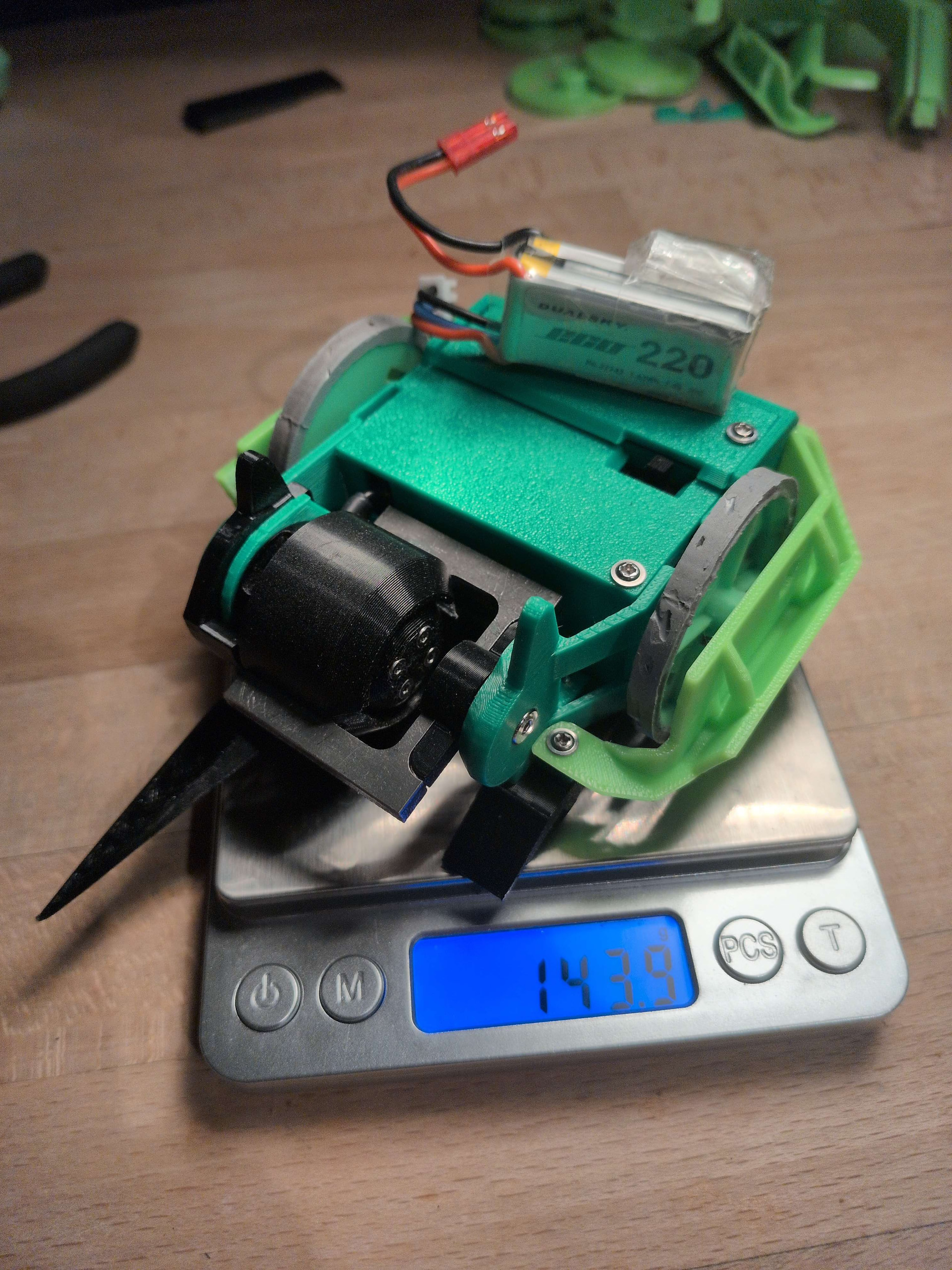

Slowly getting there… I’m making the design semi-modular with options to attach different wedges and prossibly different type of wraparound armor. Also bought a new battery with a 160mAh capacity, that weighs only 9g that will hopefully run a whole 3 minutes.
The part that held the ball bearing shattered in testing, so I am making it one big unit.
Hopefully now it can launch things without exploding. It didnt add that much extra weight either.
Almost done with this revision now, only a wedge to go. I experimented with a type of silicone rubber for the wheels, originally meant for making casts of pine cones and rocks and creating plaster ornaments and stuff, but it failed hard, so I went back to the trusty bathroom sealant and TPU for the rims.
