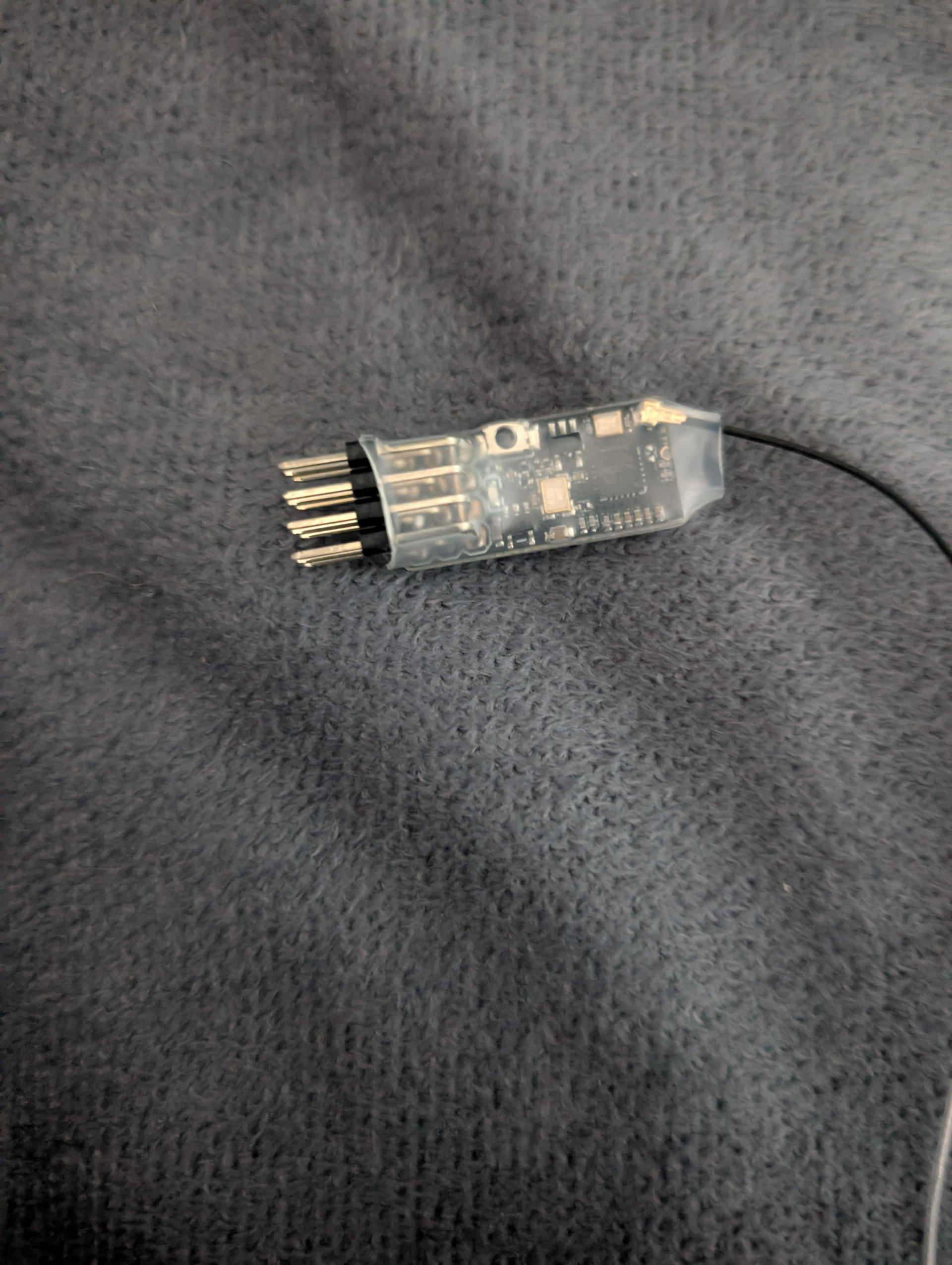

I am new to battle bots and over the last year I have been building my bot Pyro I have had 2 different occasions when my receiver failed and I like to get some advice about how to fix it or stop it from happening
This is the receiver I am using it is a FS2A-4CH receiver

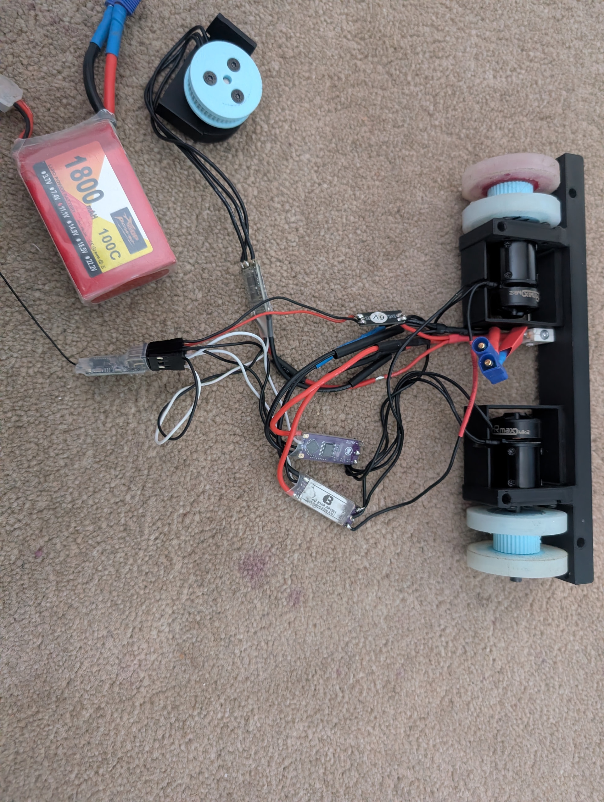

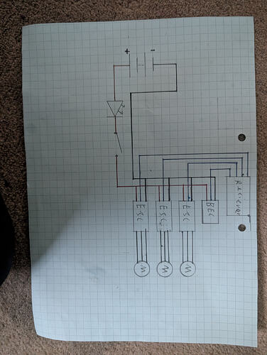

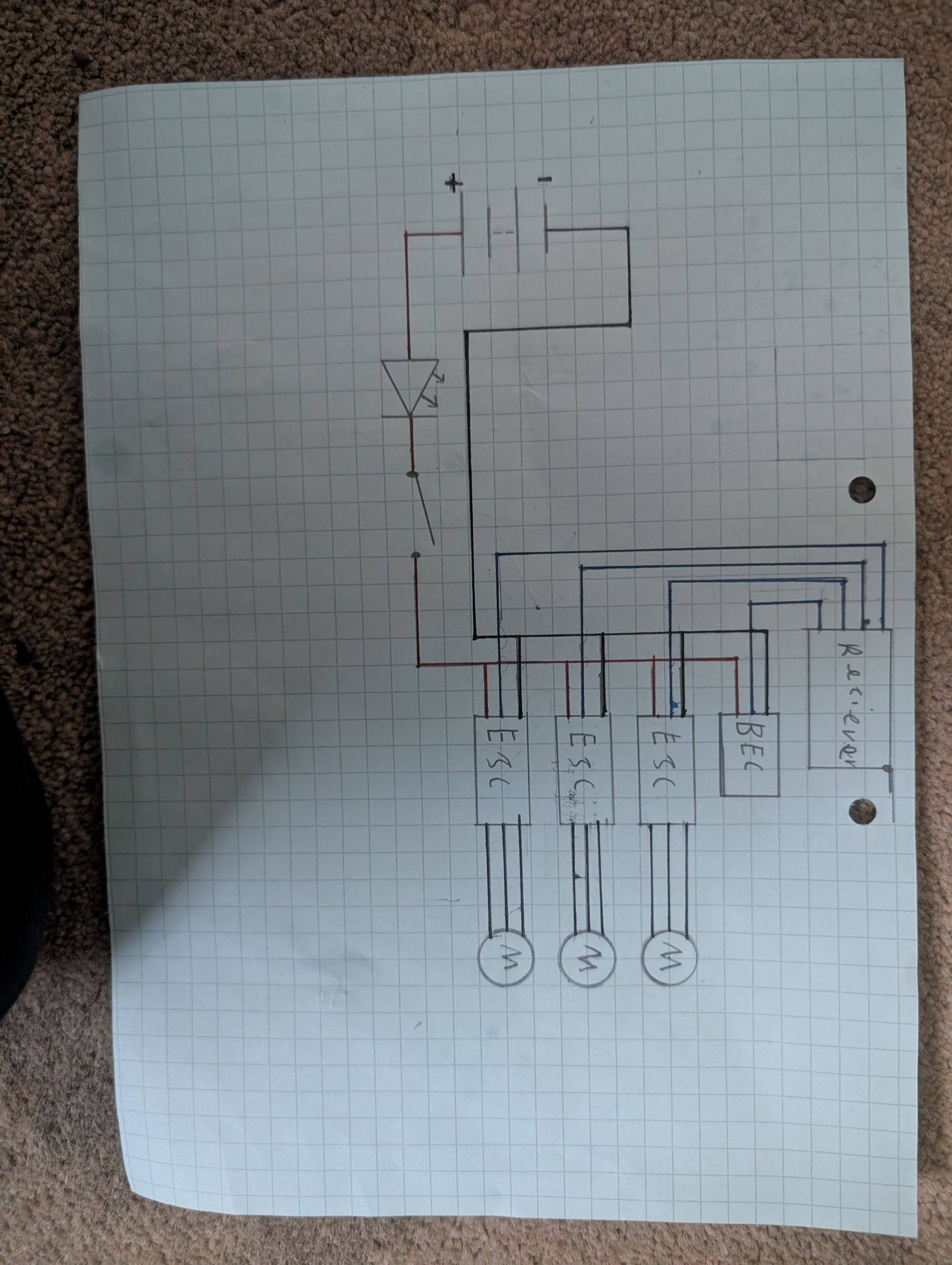

Here’s a photo of my full circuit wired in with the battery and a circuit diagram
Also when I turn it on the motors just keep buzzing and I have no control
Hi Simon! Thats a nice looking start on your beetle, those double wheels are very interesting
You have the ground and signal wires the wrong way round
Ground should be connected to the bottom pins (the ones closest to the board) and signal to the top
Thanks, it works now
Glad to hear!
Would lastly just recommend based on your wiring diagram to change the position of your LED - it’s unlikely to enjoy so much current being pushed through it! Stick it on its own parallel branch as you have your ESCs and BEC :slightly_smiling_face:
