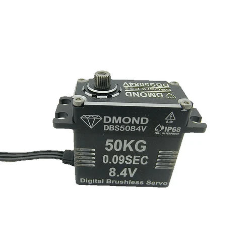

I’m about to build a beetle myself so I don’t have too much experience but I reckon that the one recommended on the bbb parts list is good as a starting point.
In general though, I’d look for a servo with metal gears and that has enough torque for your application.

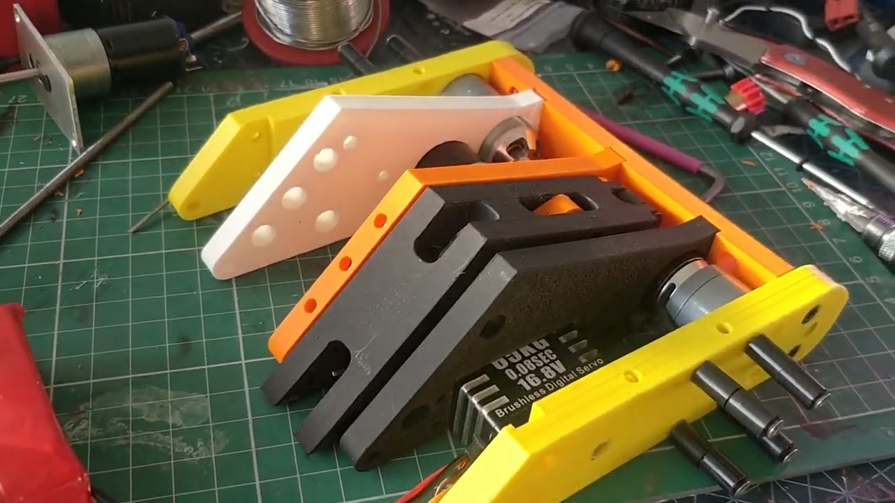

I ended up using this on MotherLoaders little 4 bar flicker. Basically because I wanted to run 4s for extra spice. 12v servos are plentiful so if you’re only running 3s you’ll open up options
Money Money but they are cheaper now than when I bought them. Boo.
