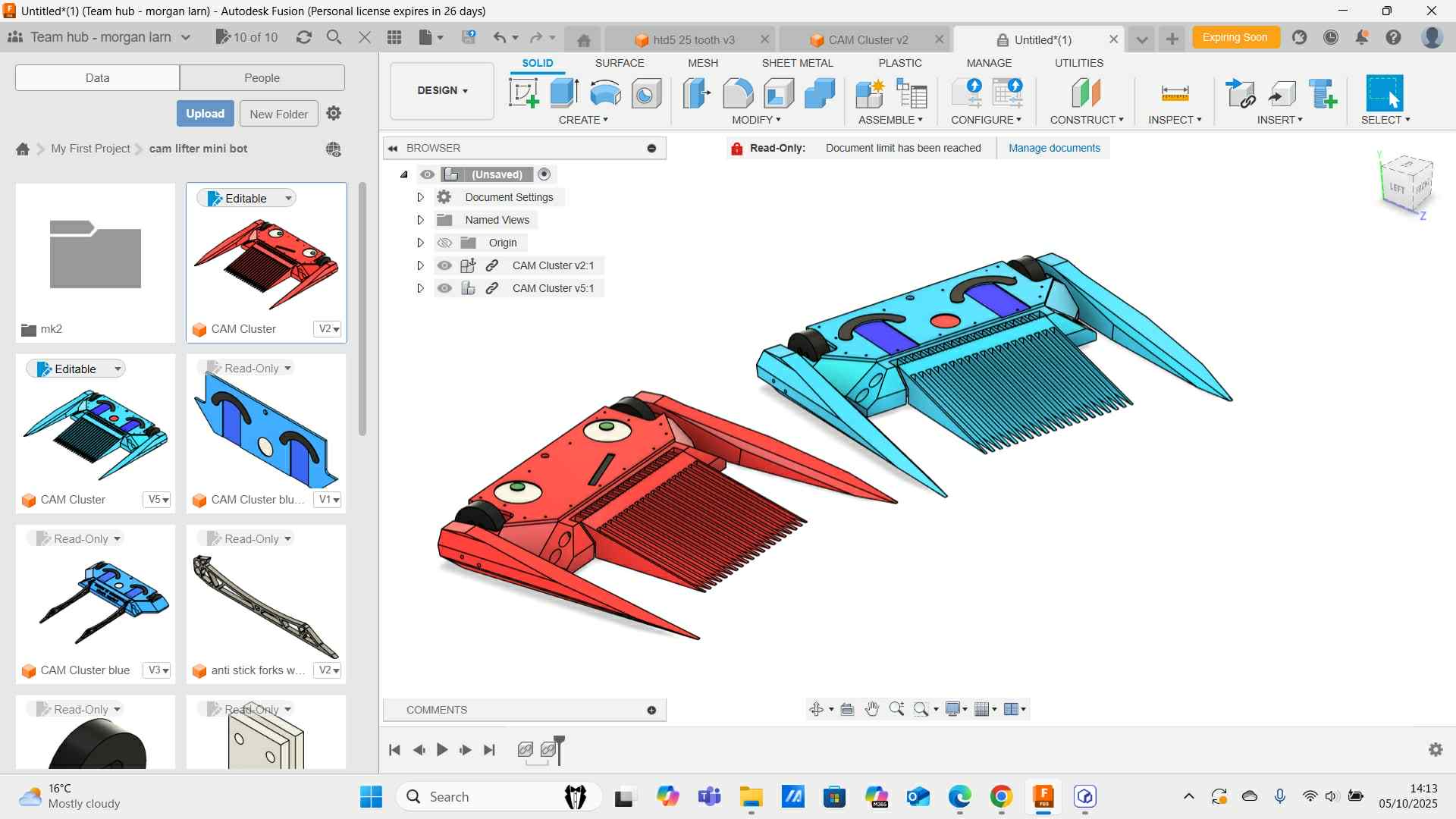

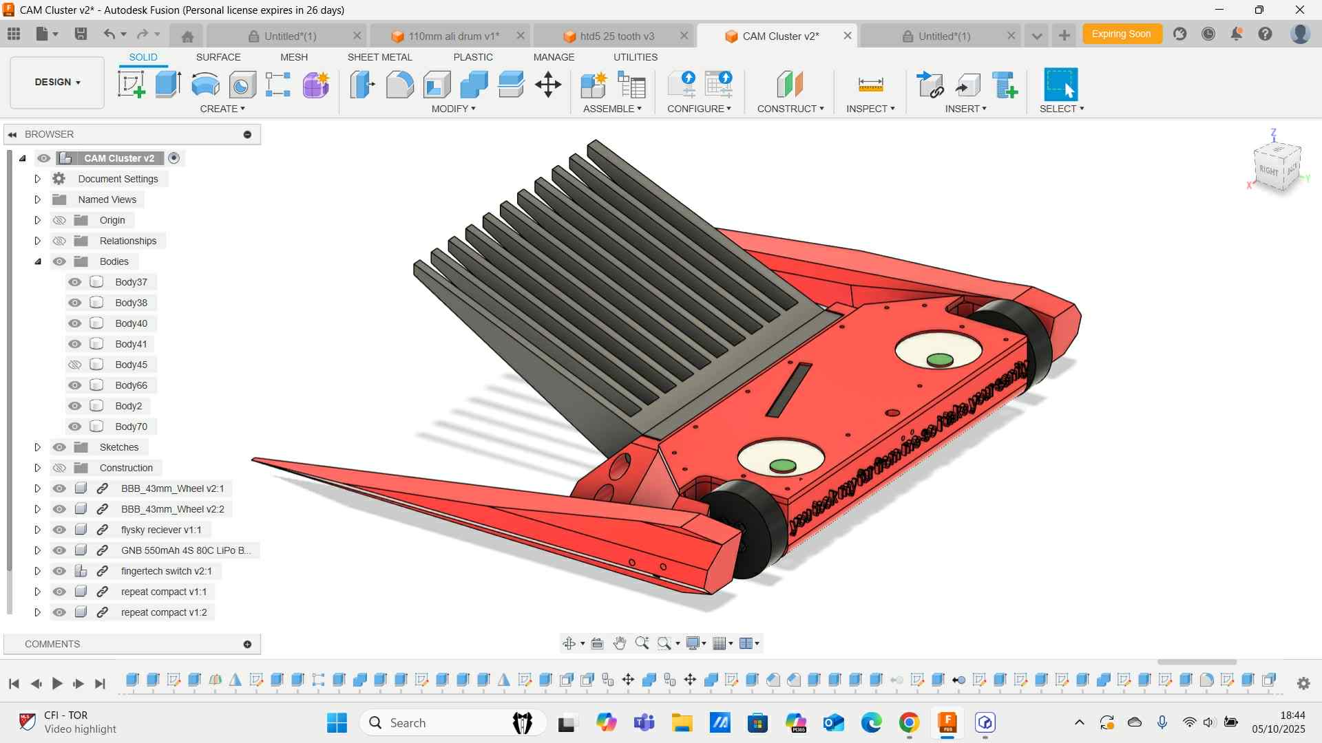

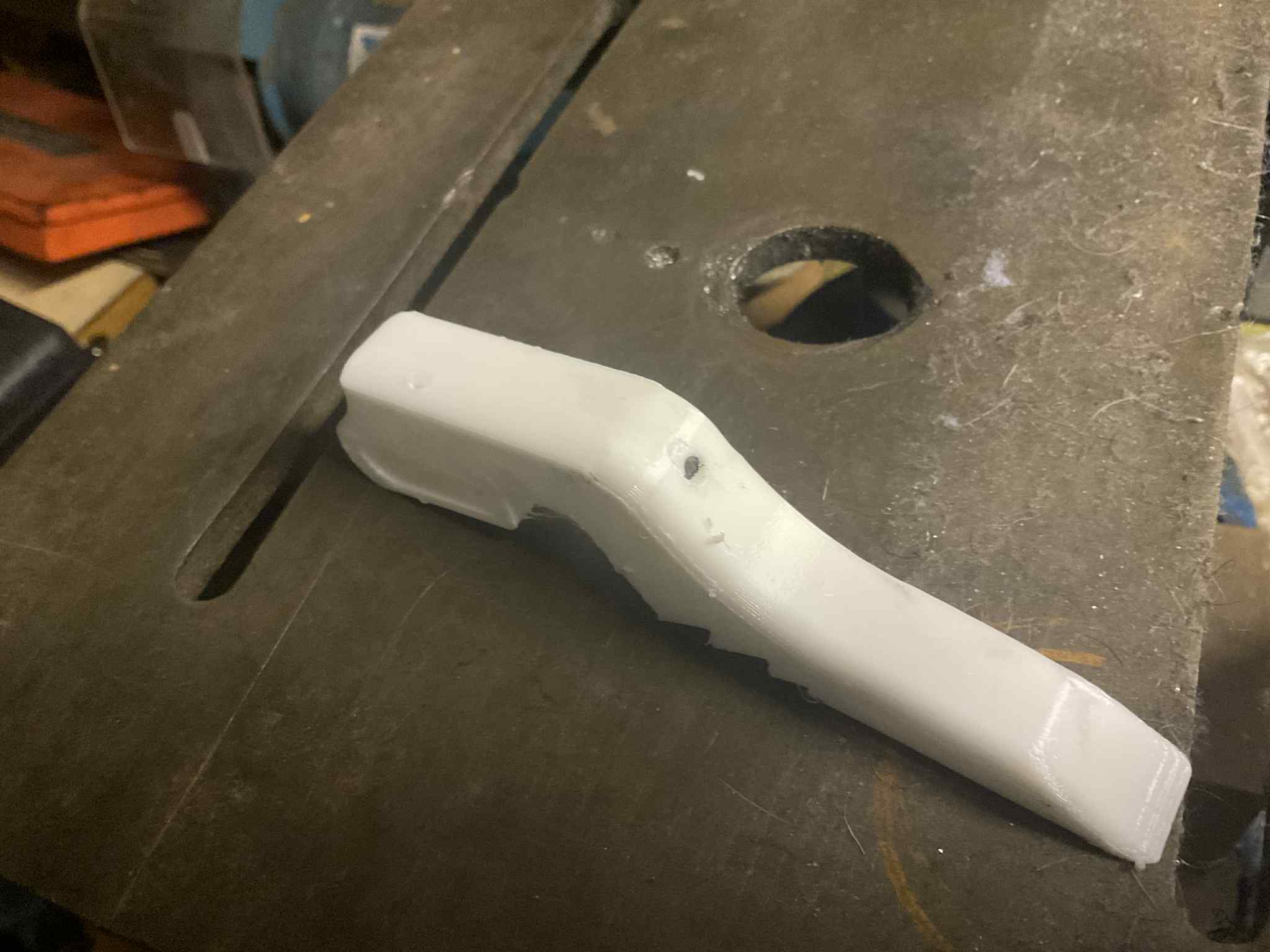

the design for rovengers 2 started when i showed simon some cam lifters which he started to design and came up with this beast
they had 4 servos between them and some 3mm hardox forks. would of been very annoying to face
however as time went on and we signed up for champs we realised we really didnt have time to make them with cam lifters so we pivoted to these

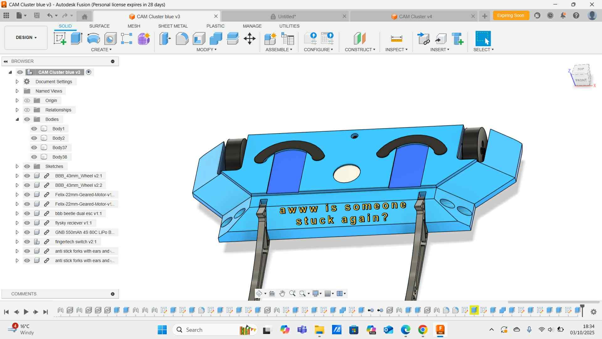

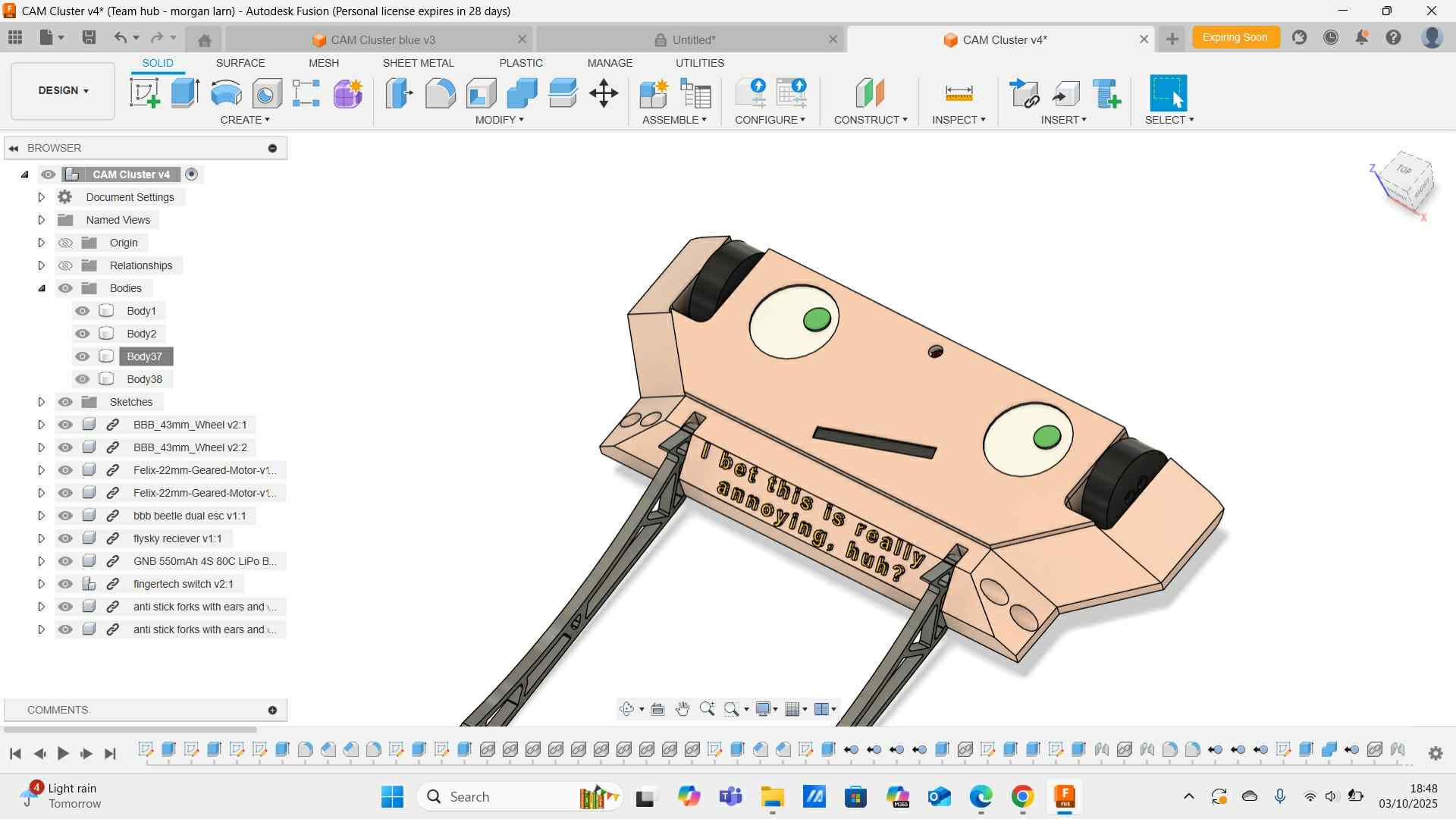

it was around this time we also decided the main weapon should be rage bait hence the faces and slogans. we did mess with the idea of printing them red and spraying them skin-tone
this was built and we hastily did the POM for them however we were worried with the brushed drive and dolos’s horrible forks we would get stuck constantly

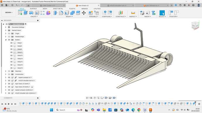

around this time however i was watching some nhrl for some sion action and ended up watching hook em a cluster with tpu forks and a small front lifter which did quite well. this sparked an itch to redesign our clusters to more closely mirror these https://youtu.be/qjYnOyVG54o?si=aUXuEbQFW_V7x3lD

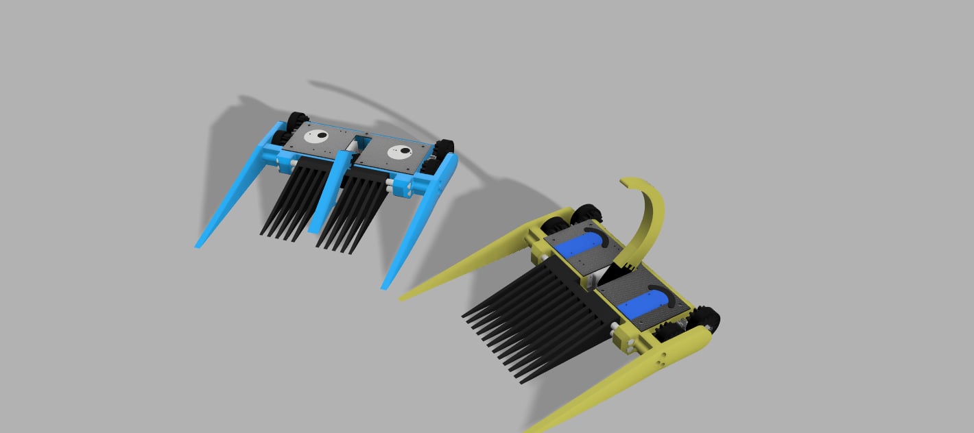

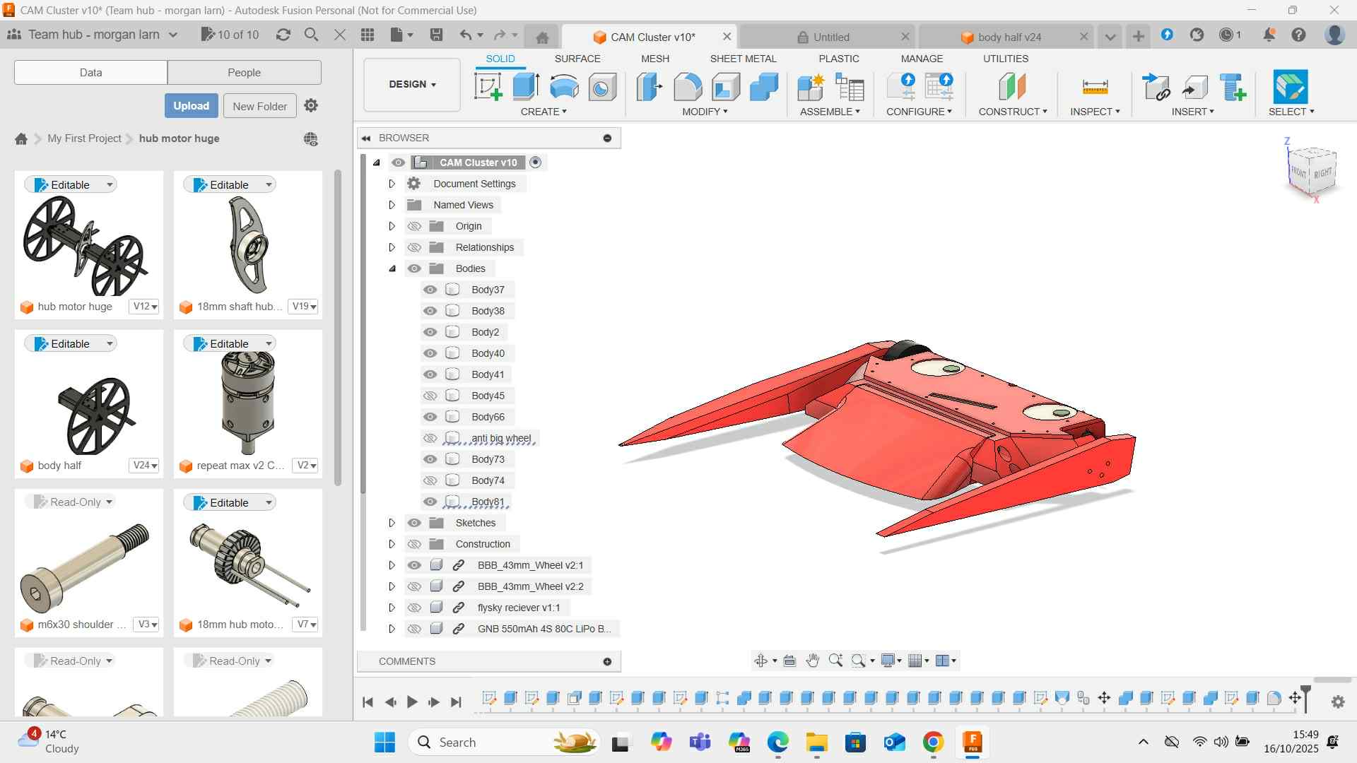

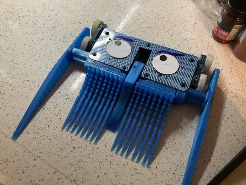

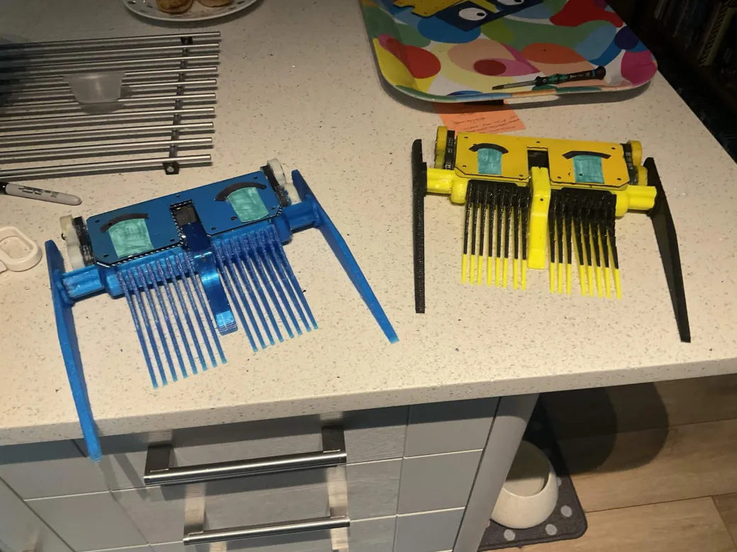

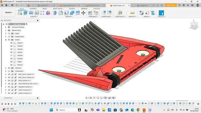

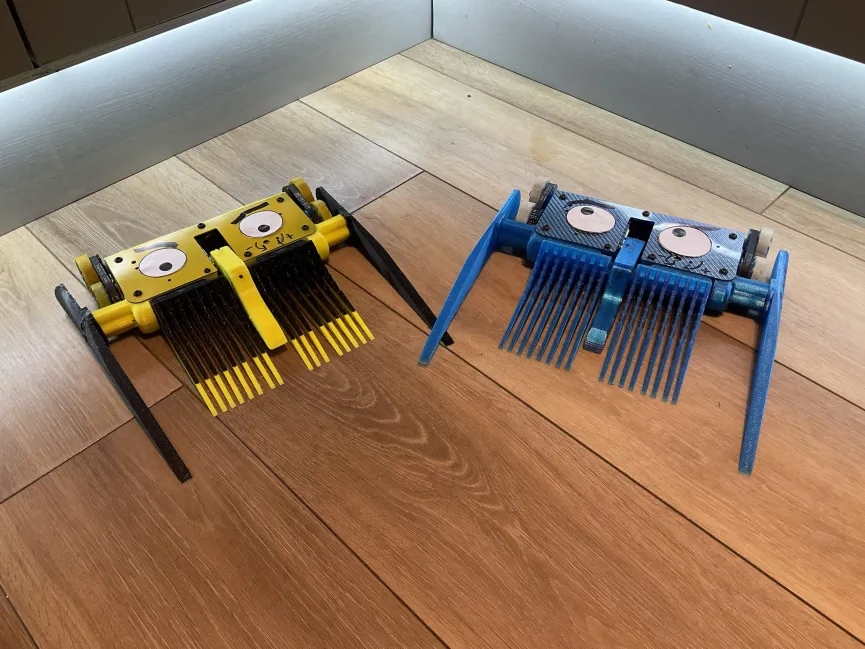

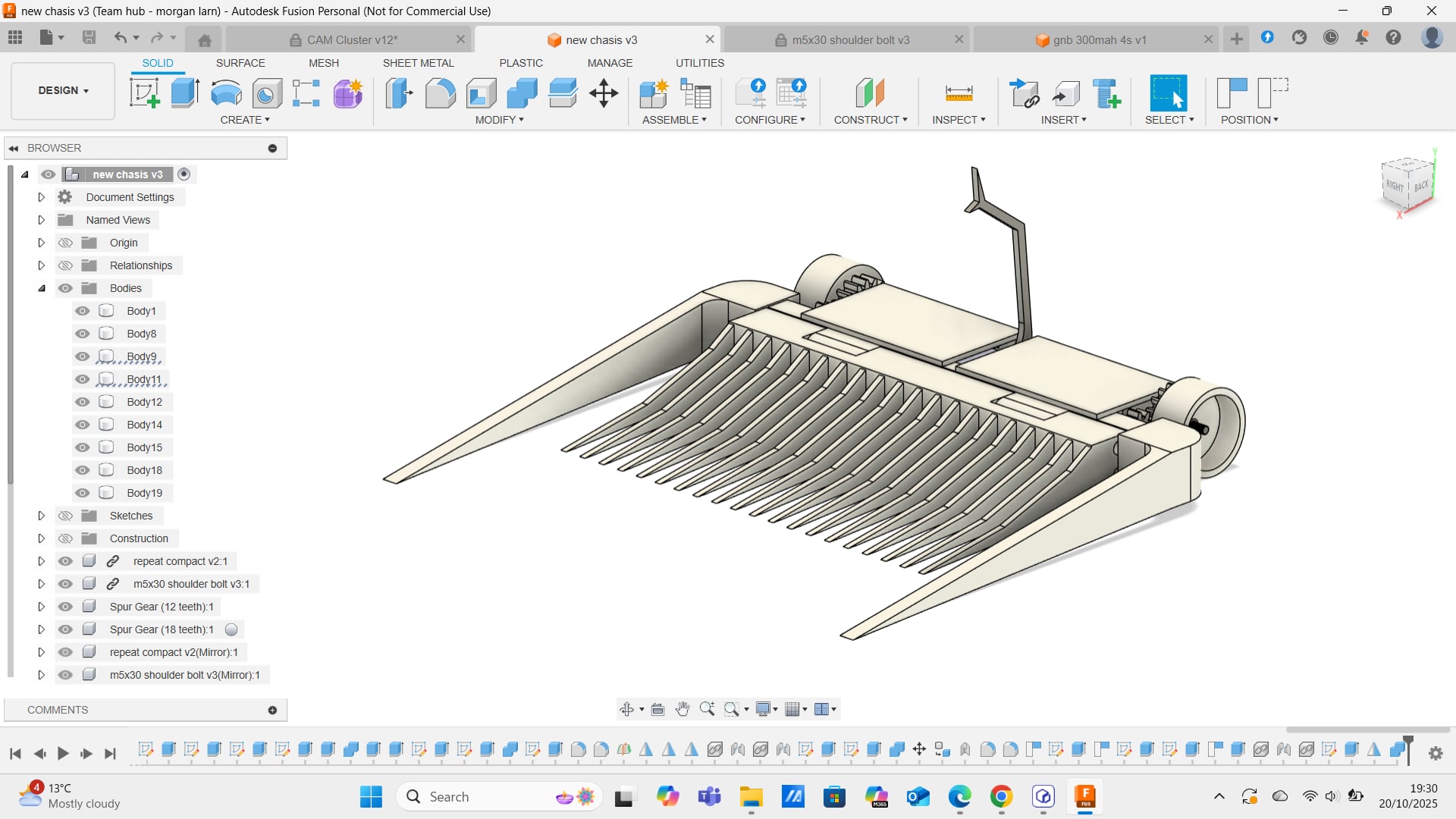

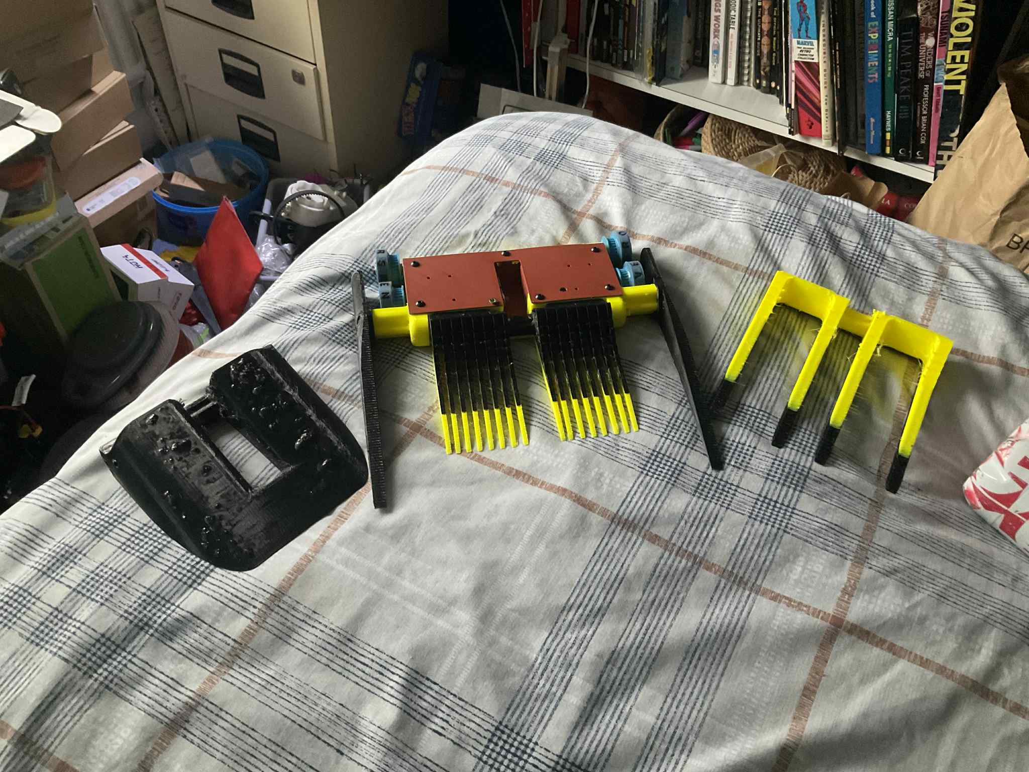

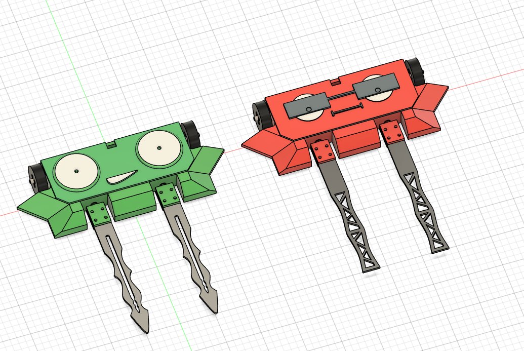

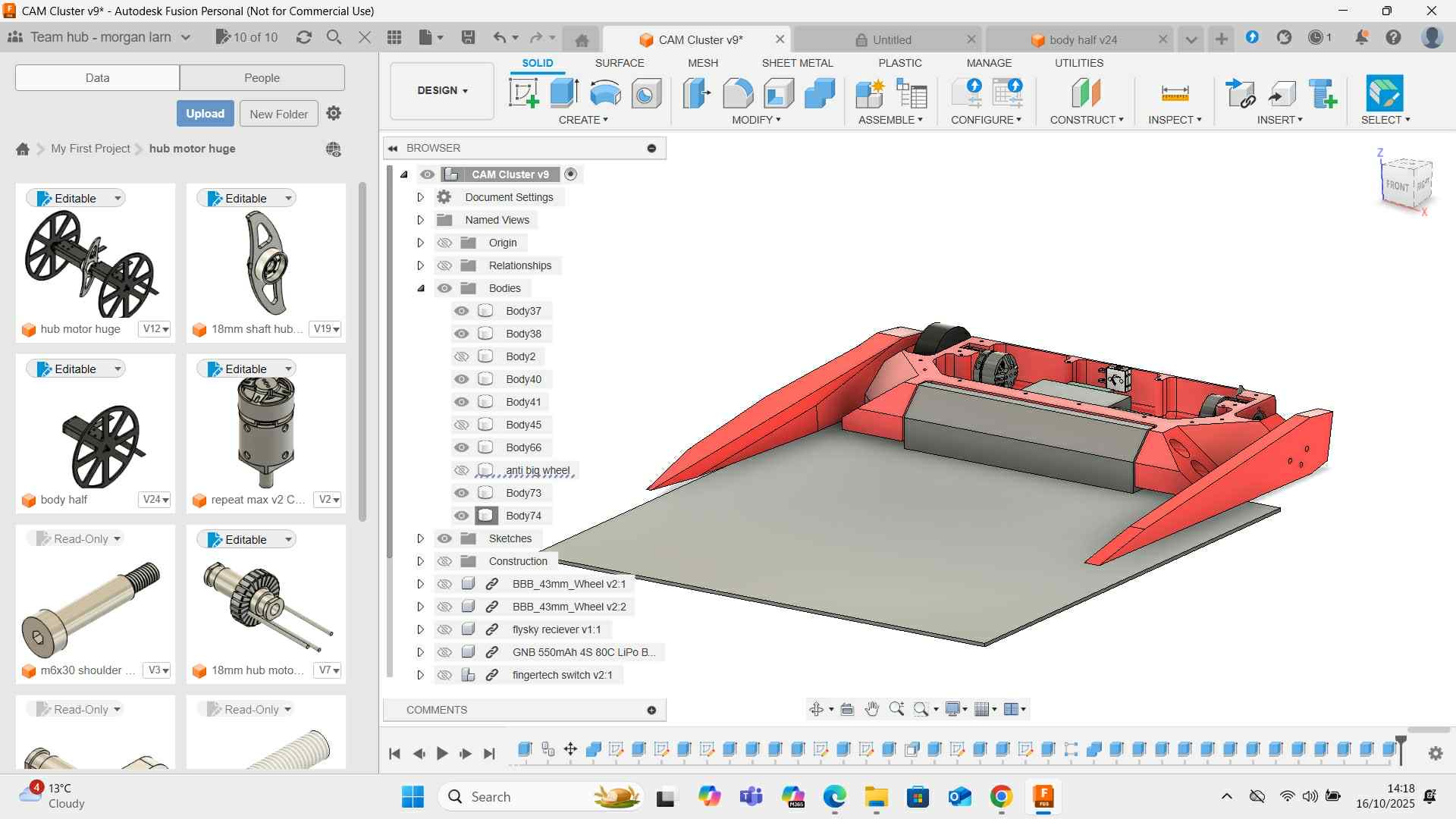

so we came up with this

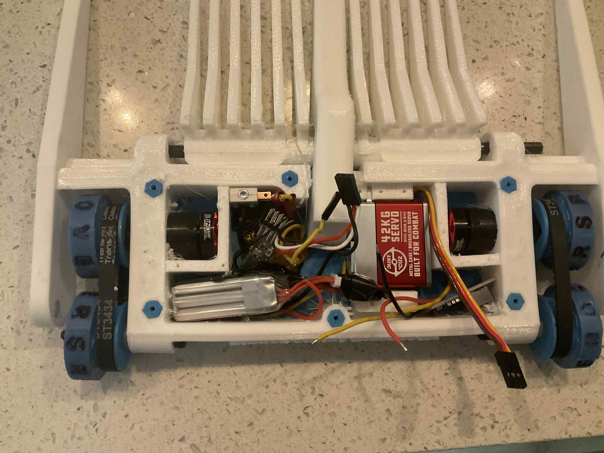

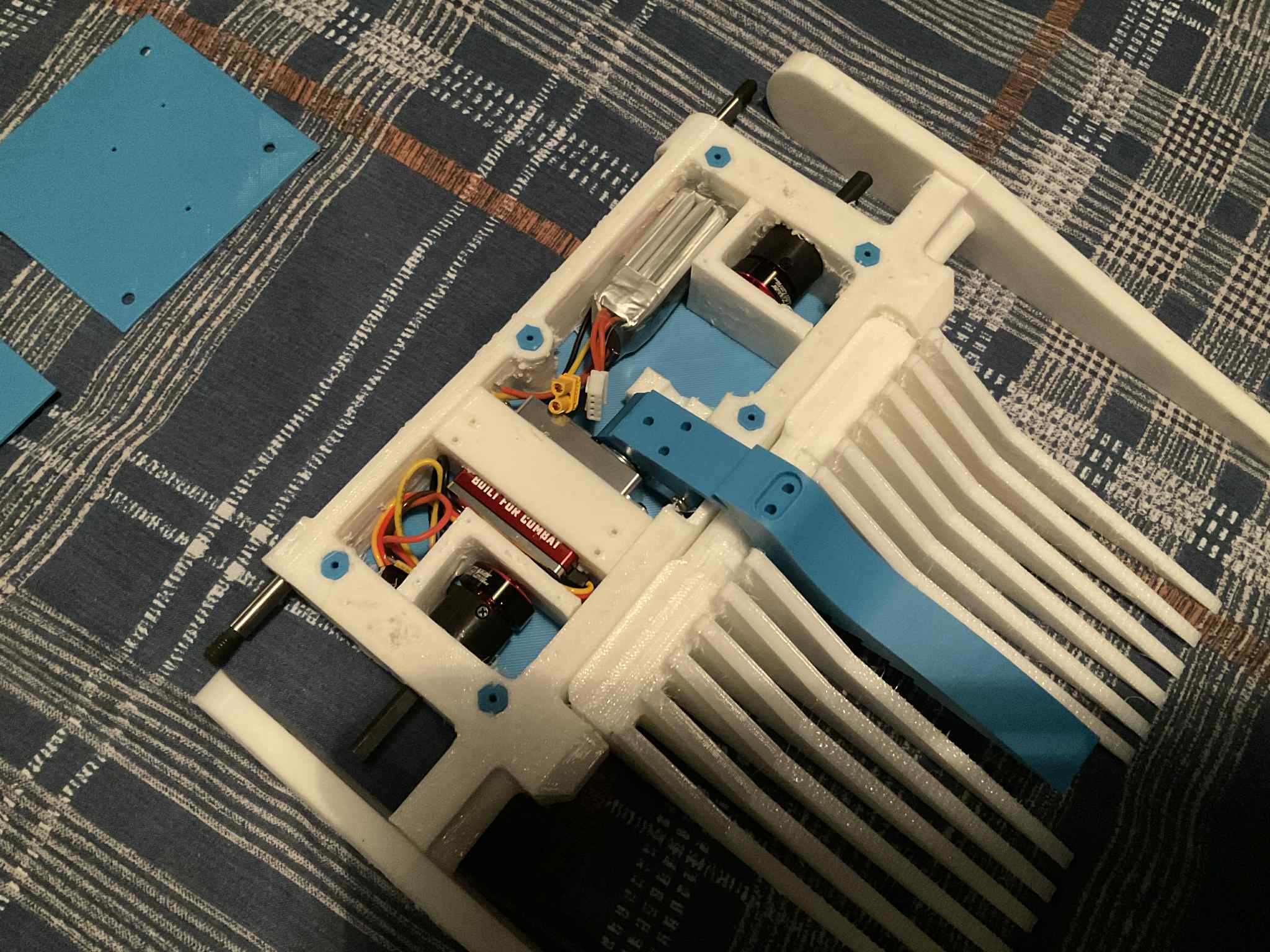

baleen forks to get under verts and large outer forks for corraling smaller bots (each robot is 300mm wide) this fitted our wanting to make them annoying and competitive so we decided to press ahead with these for champs. so a rush build was in order
they are powered by repeat compacts with a 4s 450mah battery (could of been much smaller) and some lego bbb wheels from the store which gave excellent traction. they also use the same fork mounting system dolos uses with 8mm hdpe rods

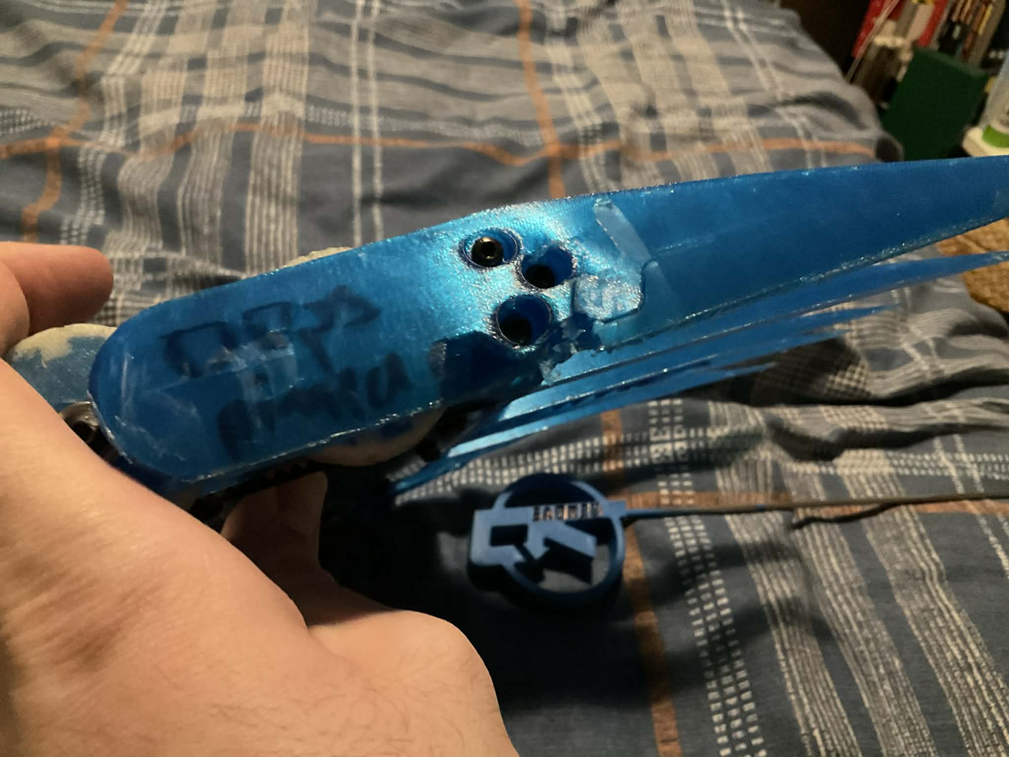

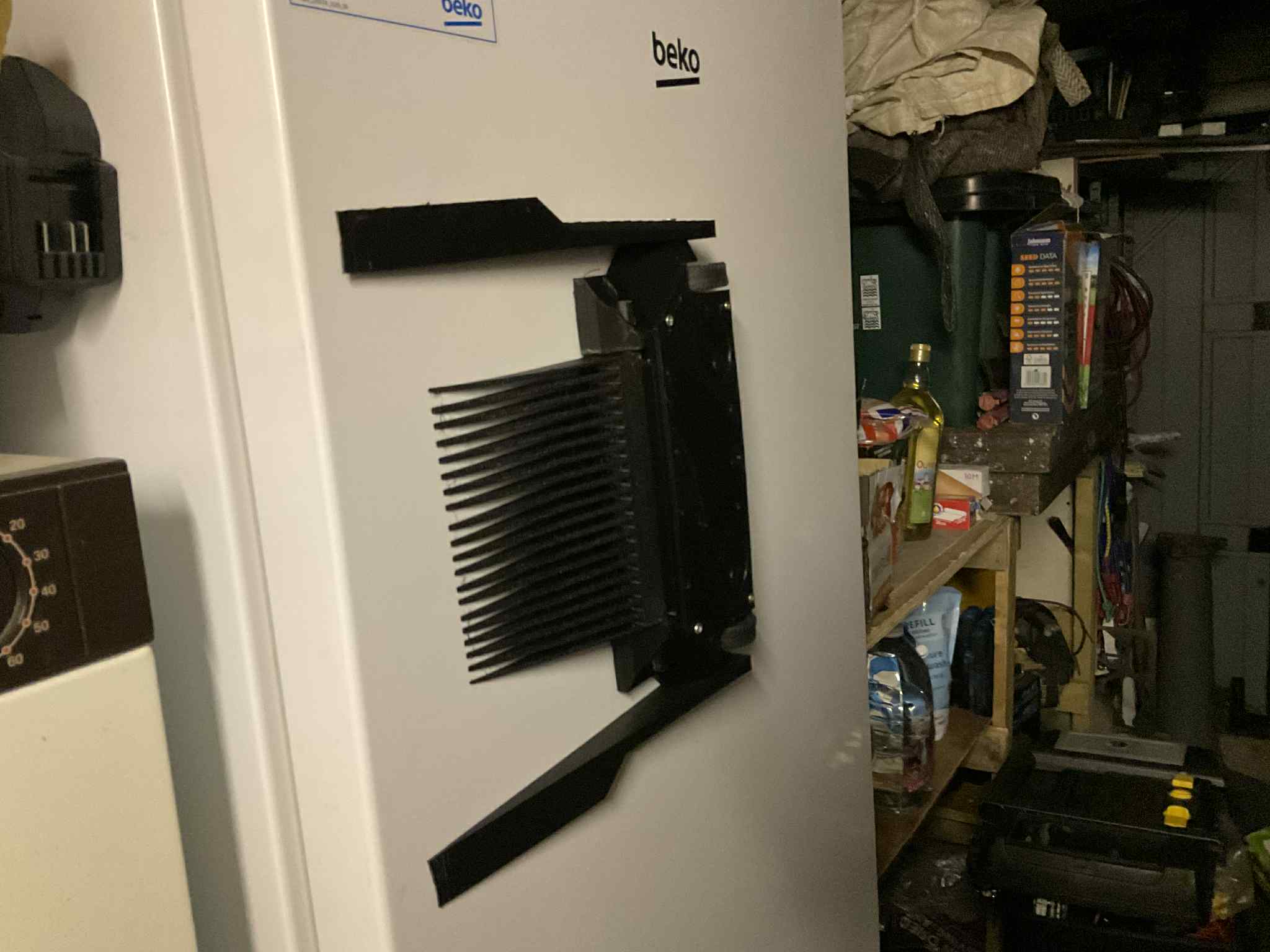

we also messed with some magnets

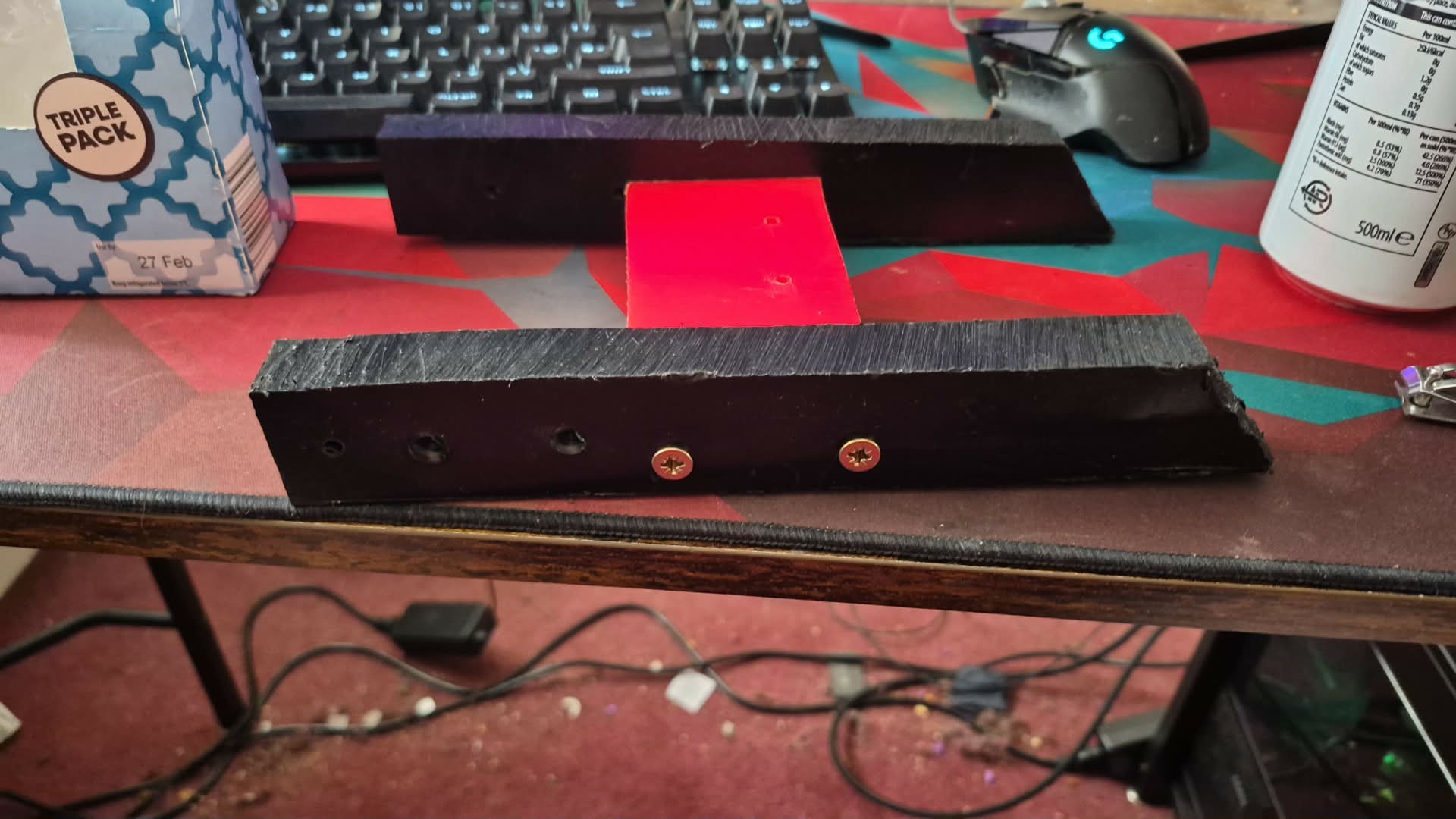

these were about 2mm off the floor so on the real versions we went for the magnets 4mm off the floor with spacers if we wanted more traction

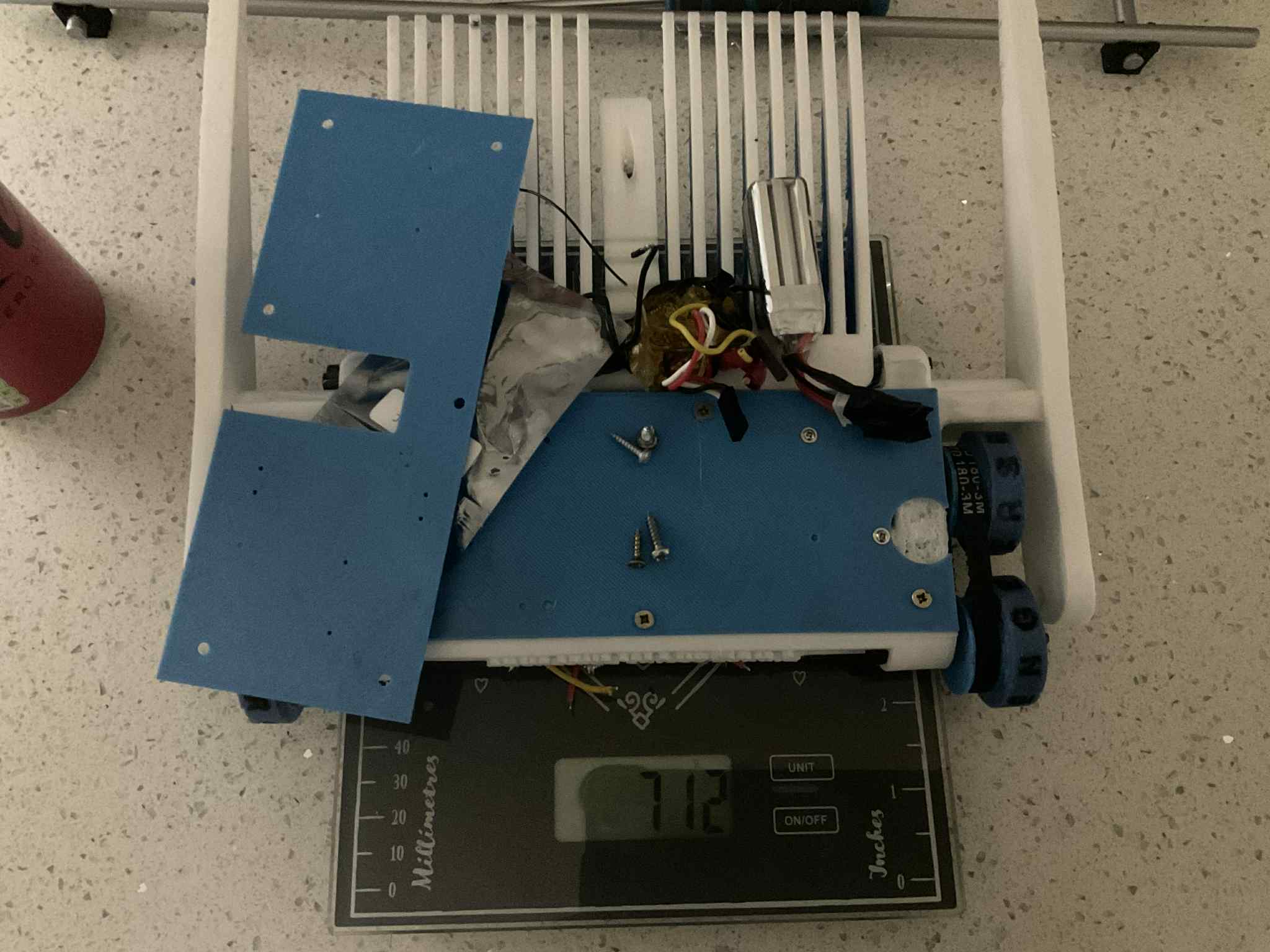

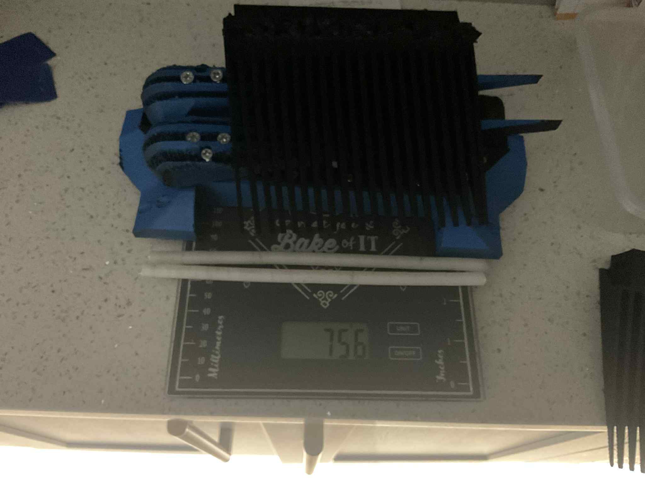

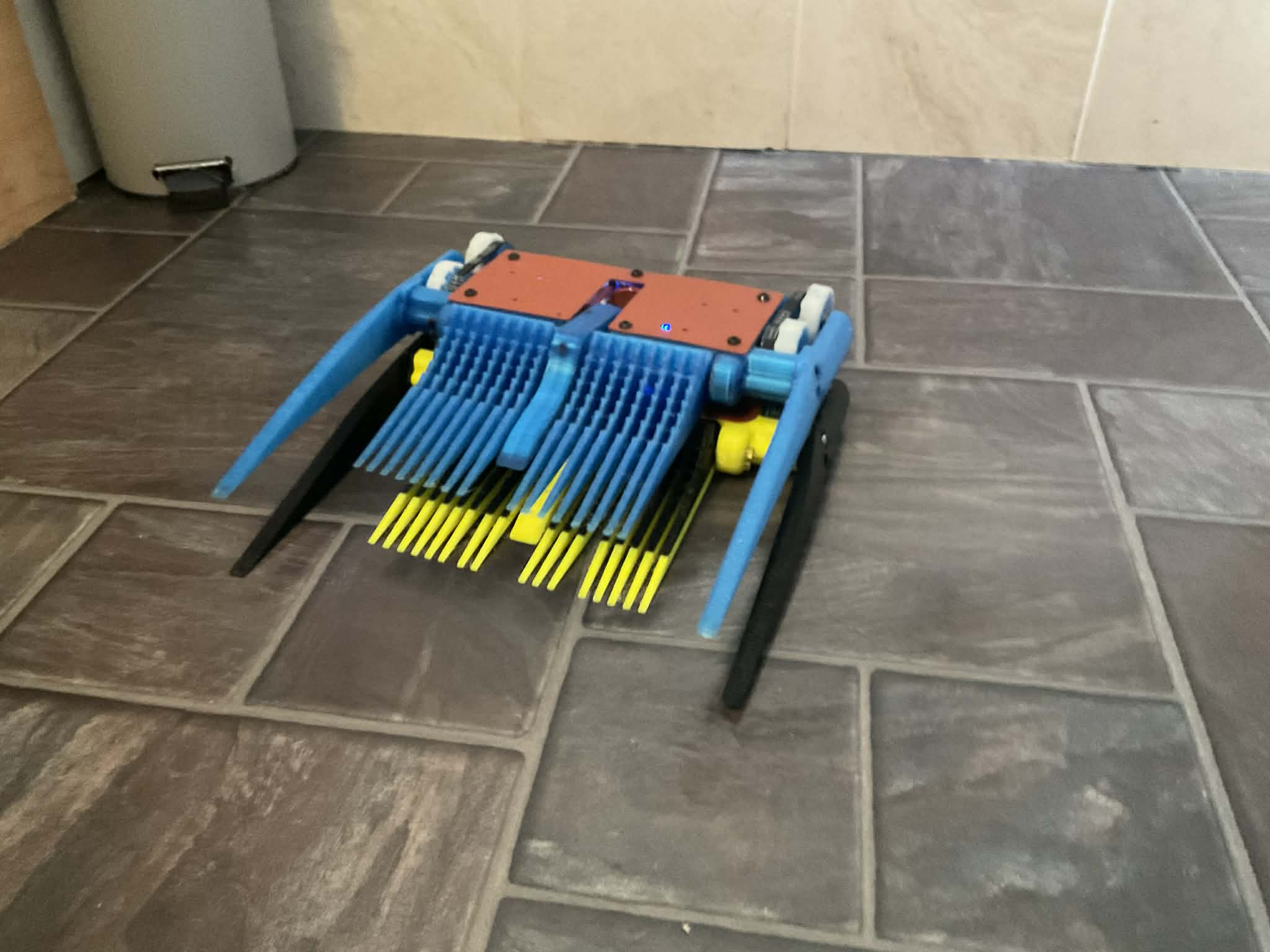

however with my printer running low on filament and time also running short (like 1 week away from the comp) it was time to build the second bot
this came together much faster as you would expect and i made sure to print it a bit lighter just incase we had weight issues
am i glad i printed them lighter haha. just 1 gram in it the night before the comp
took a final glory shot before hand and we were good to go.

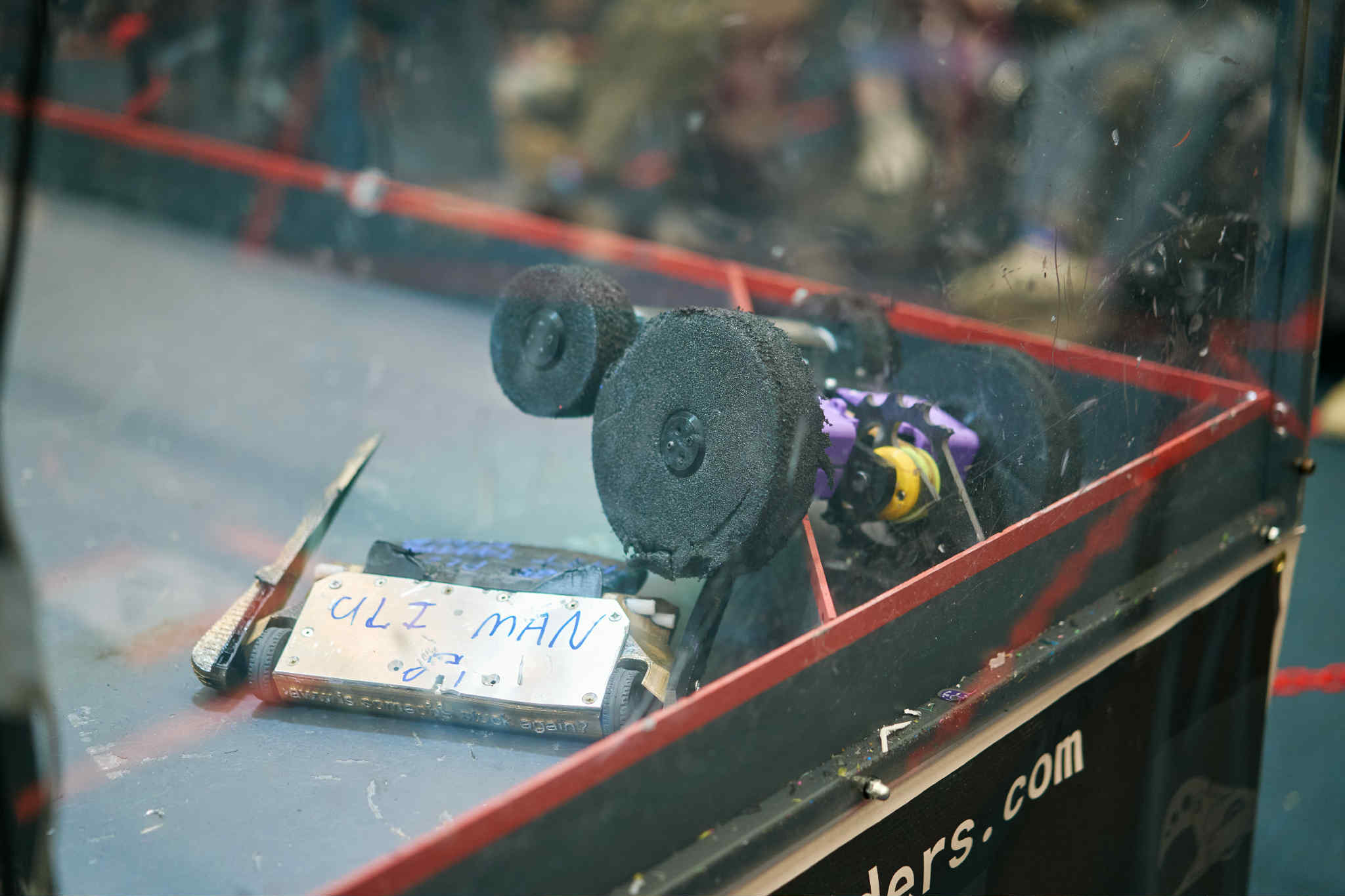

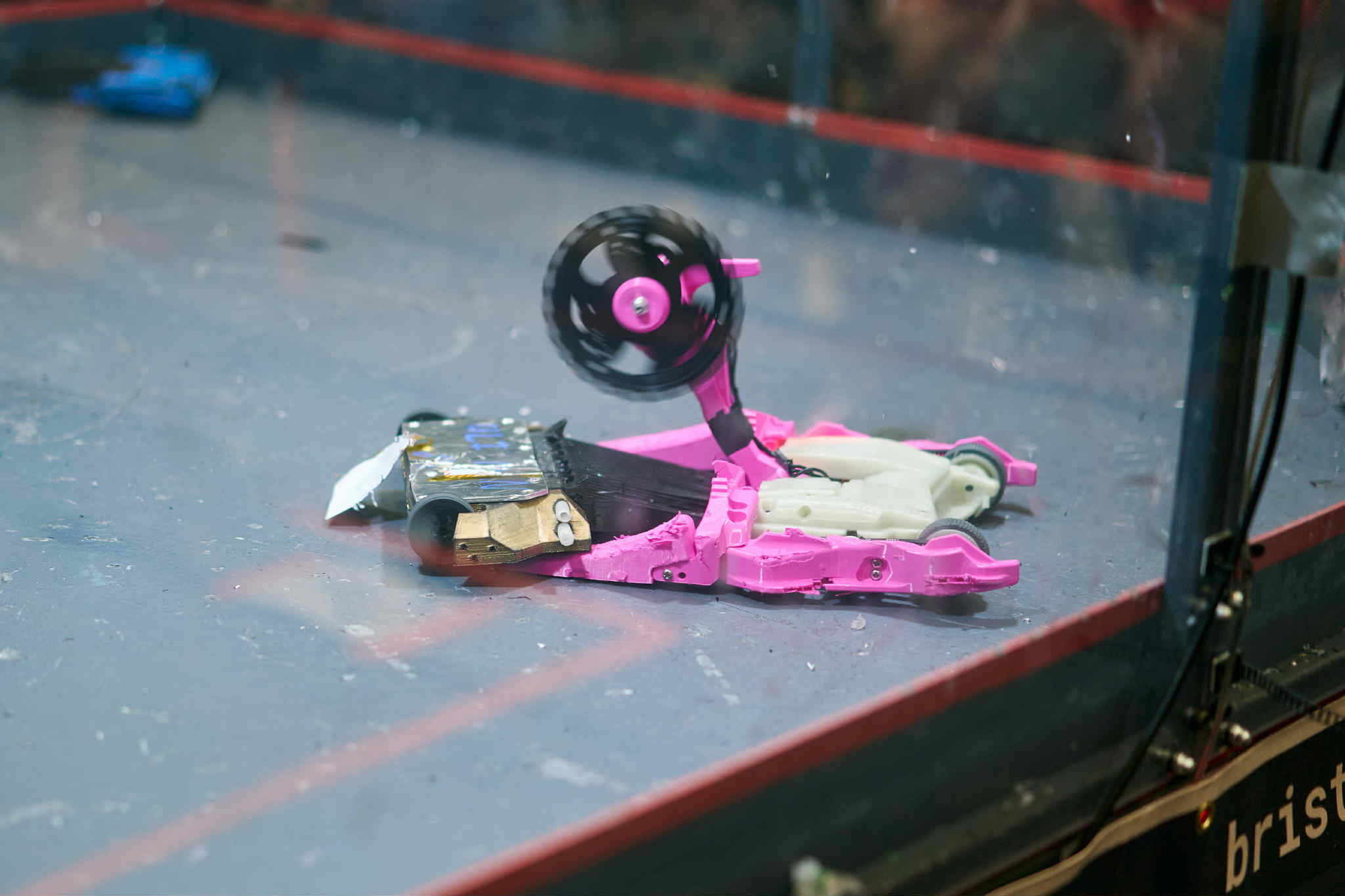

Eventually we learned our opponents for round 1 would be Lilith and Mo Problems. now we really didnt have anything for mo other than 1 horizontal wedge so i put that on my half and simon ran with the baleen forks to counter Lilith. our plan was to hang back to wait for lilith to box rush mo and then whenever lilith tried to run we would feed it back into mo. then hope for mo to die
as you can see in the event above this didnt exactly go to plan. dave rushed us instead and took a couple massive shots from mo disabling it. at this time simons half died and then came back with 1 side of drive so it was down to me to 1v1 mo. i decided to try and bait rob to hit me near the out zone and it somehow worked! mo went over the wall and we went on to the top 32
simon for some reason decided these were the best bots ever and ran with that in the interview :rofl:
wedge says “mo pls hit lilith”
sucks to suck rob (love ya)

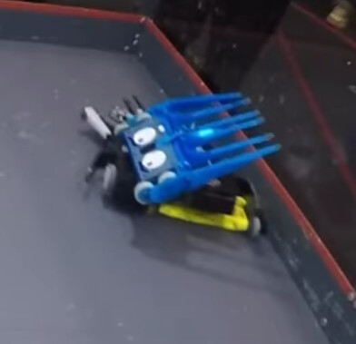

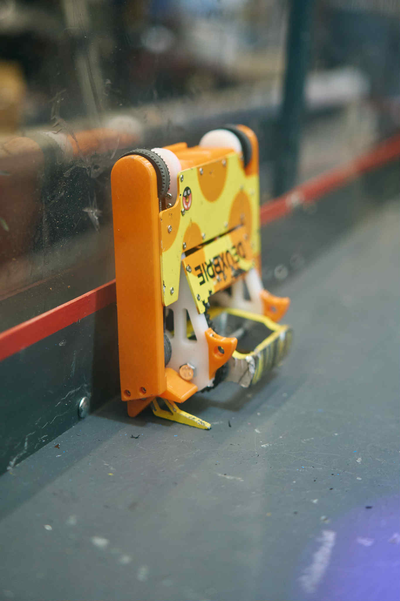

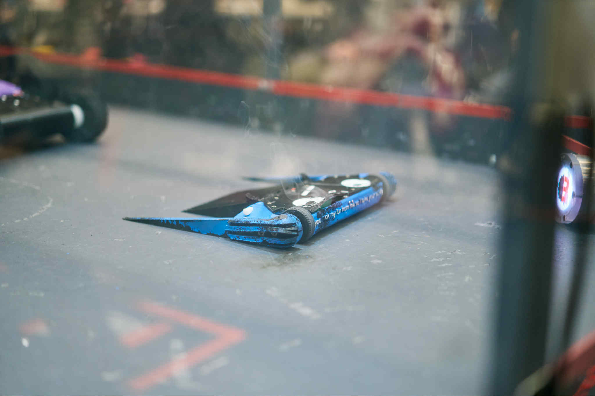

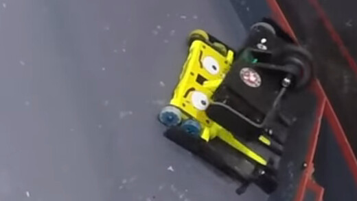

this put us up against duexbrie and cheese themed 4wd egg beater with a unusual aluminium beater. we figured we should be able to get under from the front fairly easy and hoped that there weapon would hit the floor enough to disable it. it being aluminium didnt really matter for use given we are all tpu it would bite regardless
this nearly went very badly as i got inverted and beached almost immediately. leaving simon to carry and carry he did. brie hit me after i was immobile and killed there weapon. giving simon the opening to ram them against a wall and immobilise them
we had no damage after this fight and were into the top 16! so anything after this was a bonus

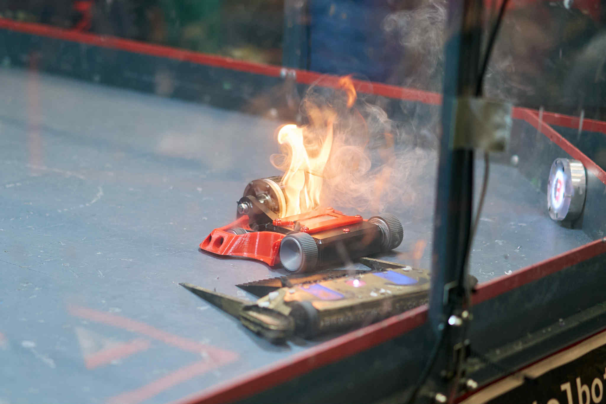

this went to plan from the early moments. we were able to pin revron several times. sadly he did manage to get a hit on the back of blue which was party my fault and killed one of the drives. so i knew then we needed to get it down the pit asap to avoid it getting a hit on me knocking us out
moments later however revron burst into flames as there weapon esc gave out handing us the win. although lucky in that it caught fire i was pretty confident we could of won regardless as we were out driving them
damage wise Simon got onto wiring back in a new motor and i went and ground out our aluminium lids for motor clearance like we did to the tpu ones as we next had swoop

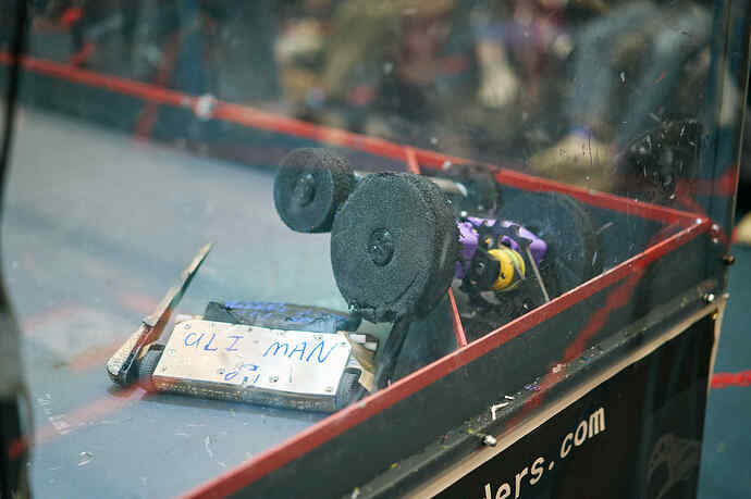

this didnt go to plan and smoop got a couple big hits on blue killing another drive motor and causing it to emit the magic smoke
ouch

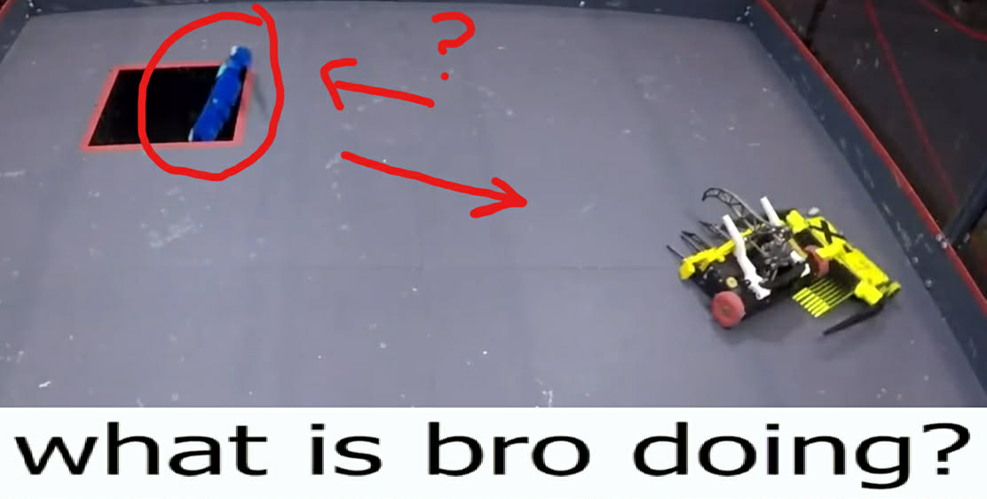

this left just me driving gold. however i did feel i had a chance as smoop hadnt really managed to bite me and i could mabye get it to bounce in the pit or the out zone

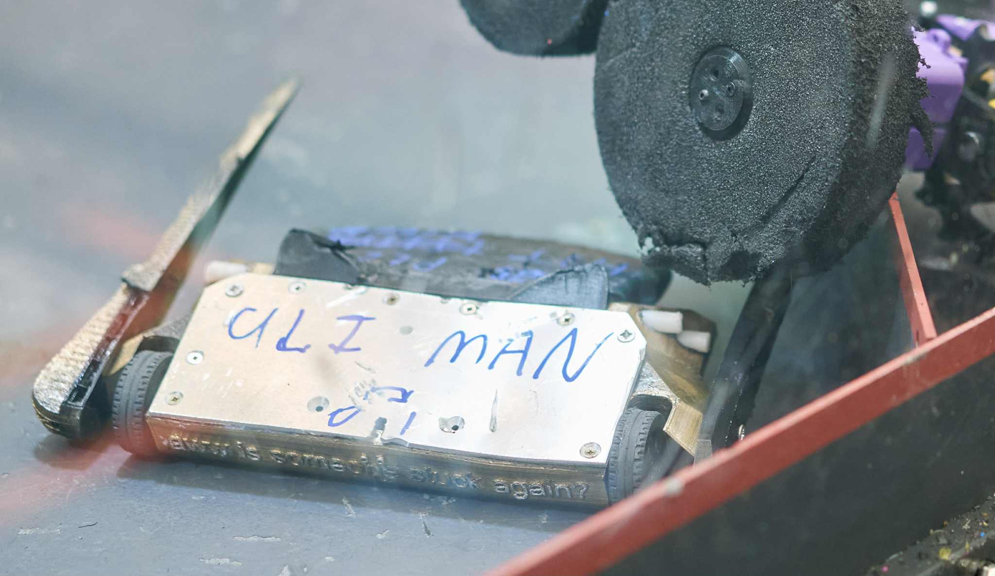

and we somehow did it! i rushed for the pit release and swoop managed to bounce themselves onto the sidewall and with a fortunate driving error drove over the wall and out
this got us to the semi finals against chopstick….oh god

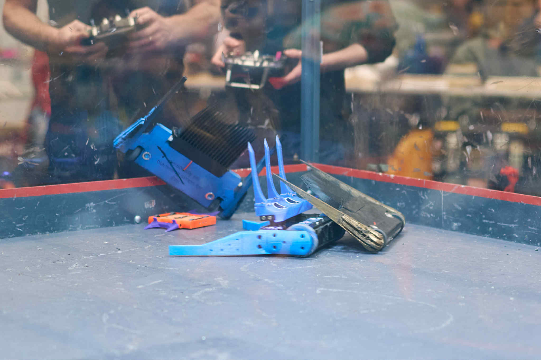

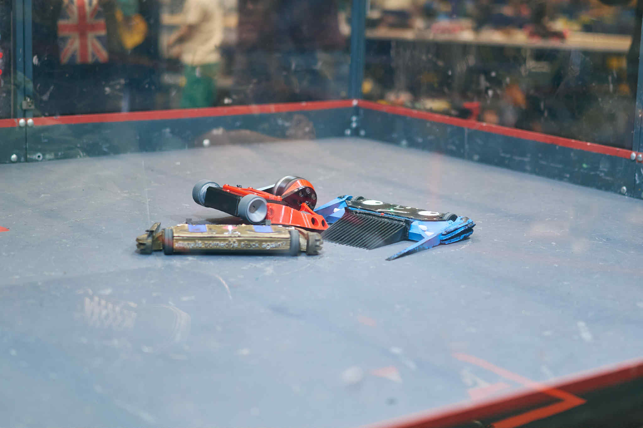

of all the robots going to this event this was the one we really really didnt want to fight. and with a big repair job from swoop we were left scrabling to get them into the arena. the legend sion lent us a drive motor for blue as we had went through our spares with the ali top armour on both and one of the four long forks between us we made weight and got into the fight

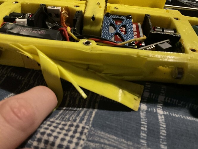

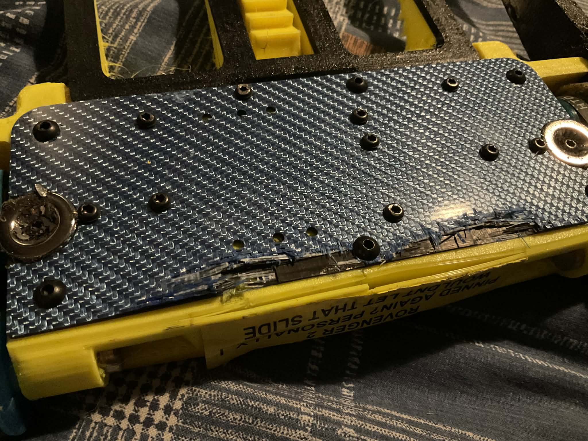

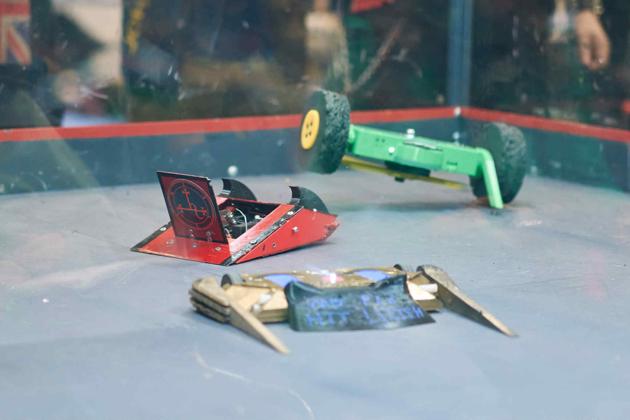

blue got flipped very early on and with a massive belly shot was killed in one hit leaving just gold left. i did manage to get round chop stick for a while and the ali lid worked way better than expected but i just couldnt do anything to get them towards the pit. eventually they got an excelent pin and cut through 2 of the wires to one of the sides of drive. and with the other side propped up on blue we were out

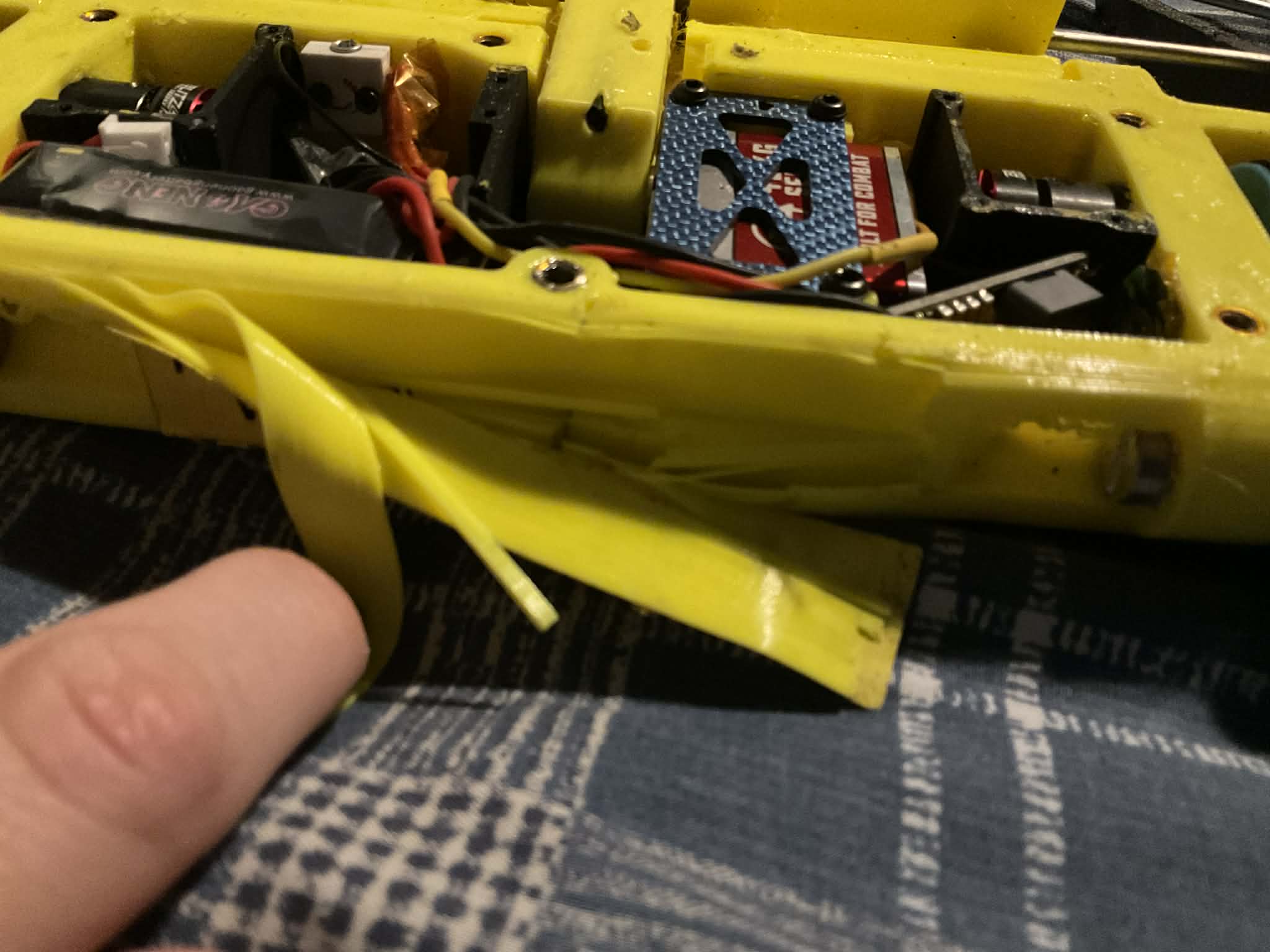

this left us with our biggest repair job of the day. we opened up blue expecting a repeat to be cut in half or something. turns out chopstick had cut through the battery and somehow didnt catch fire. despite us sticking warning labels on the bots andy ignored them and stabbed our lipos smh
(pov youve just asked simon to wire up a 3rd brushless motor in 2 hours)
this meant we could get both into the arena for the third place playoff against chucky
(you can see the massive cut in blue from chopsticks)
sadly we didnt realise but one side of blue got filled with what we can only assume was swaft from the lipo jamming up the motor (sorry sion) we tried our best but untimatly chucky had way more drive power and the flipper meant we could be rendered pretty useless without a way to get back over. we were able to get under chucky from the front with the forks but this didnt really matter as sadly blue did get beached twice on the little mini bot but chucky rightfully got the win (really we should of been counted out when we both got stacked and each other and were quite lucky the mini bot was jammed under us causing an unstick)

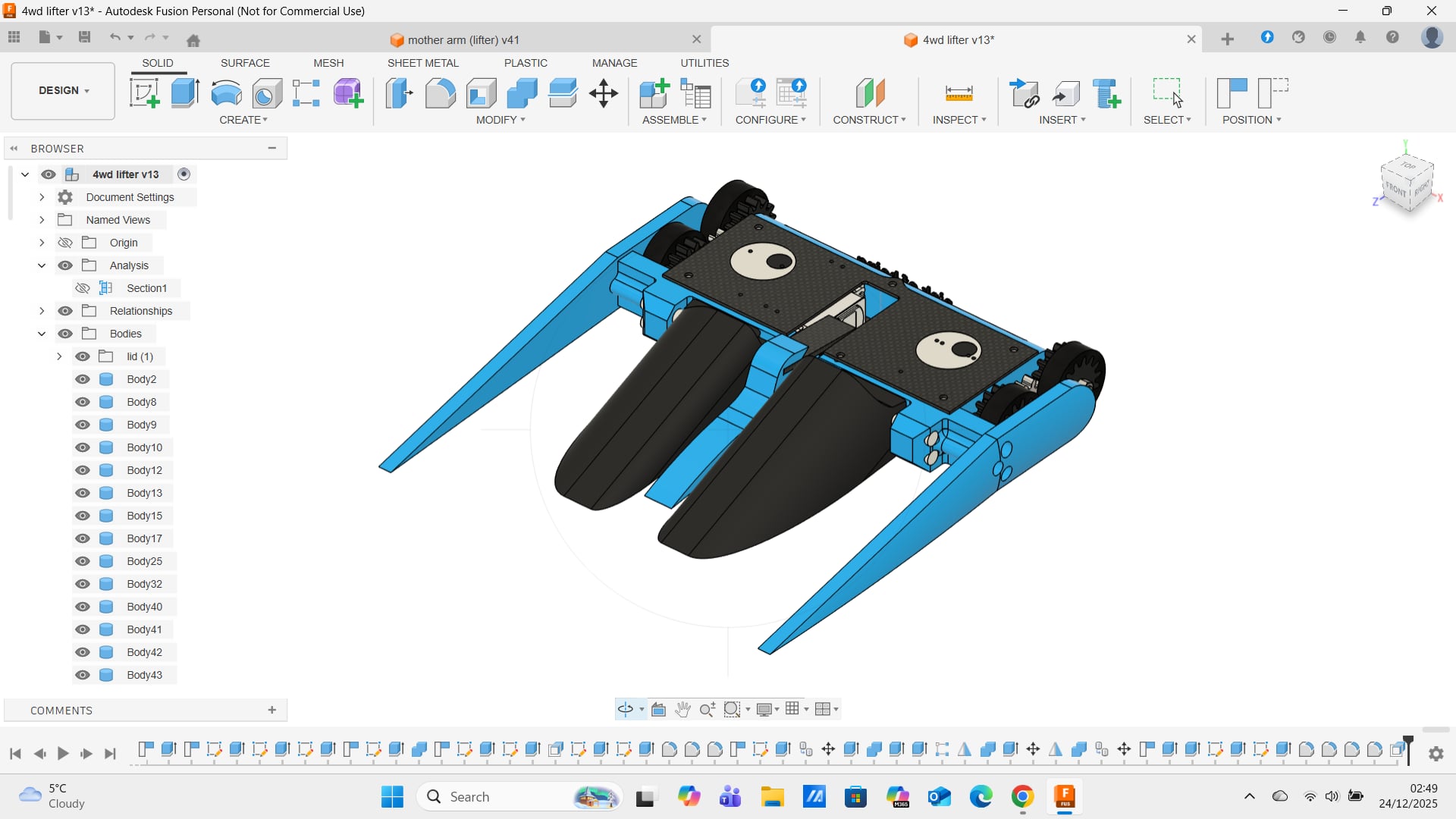

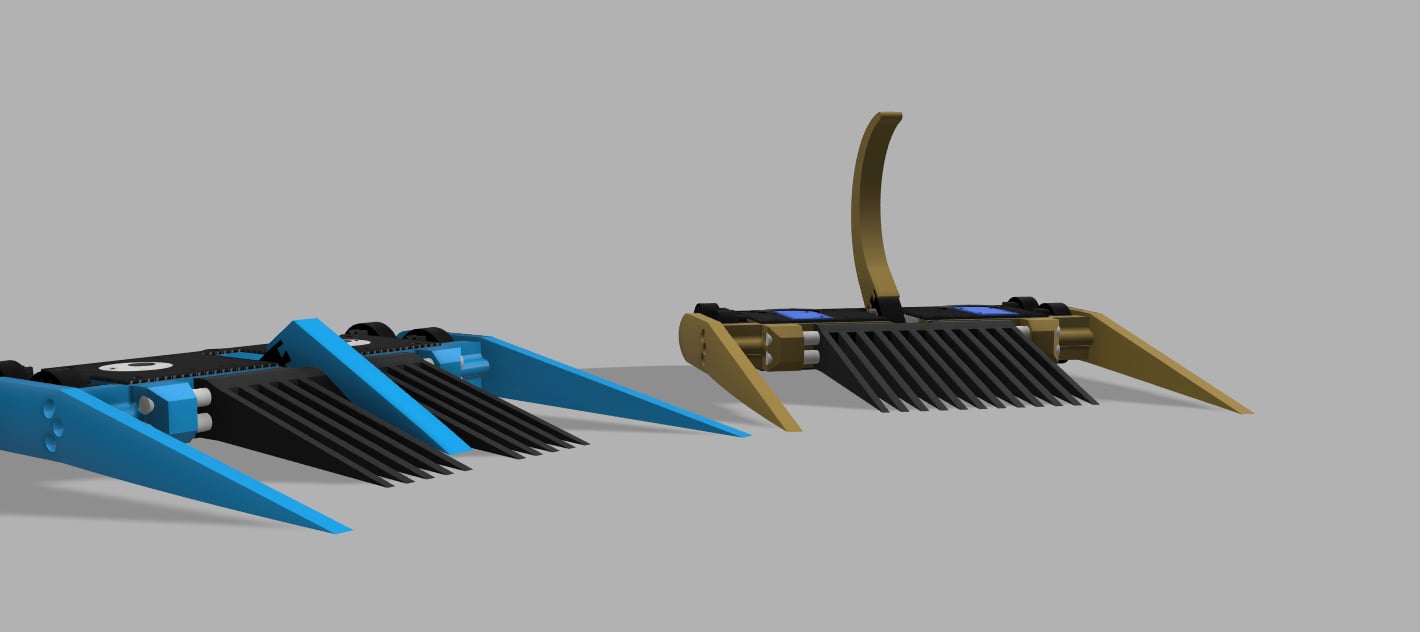

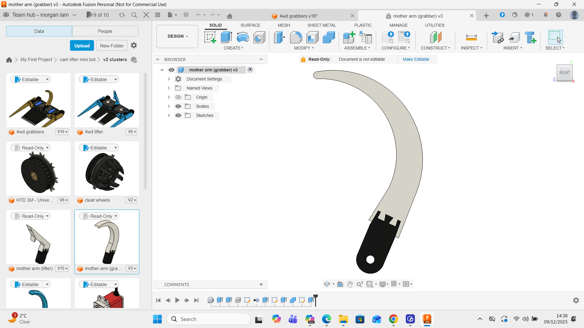

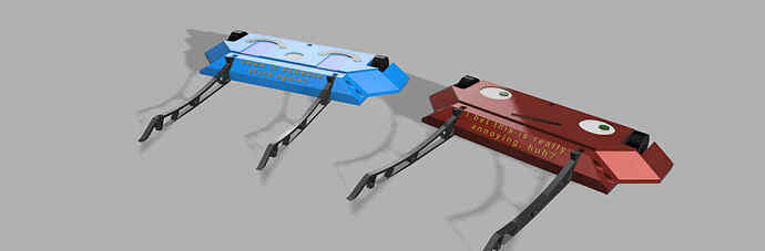

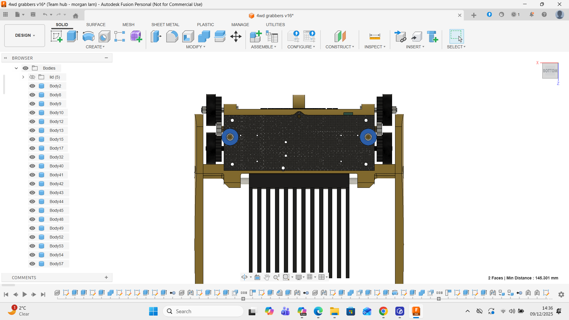

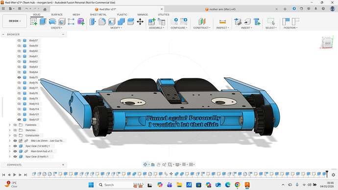

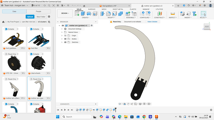

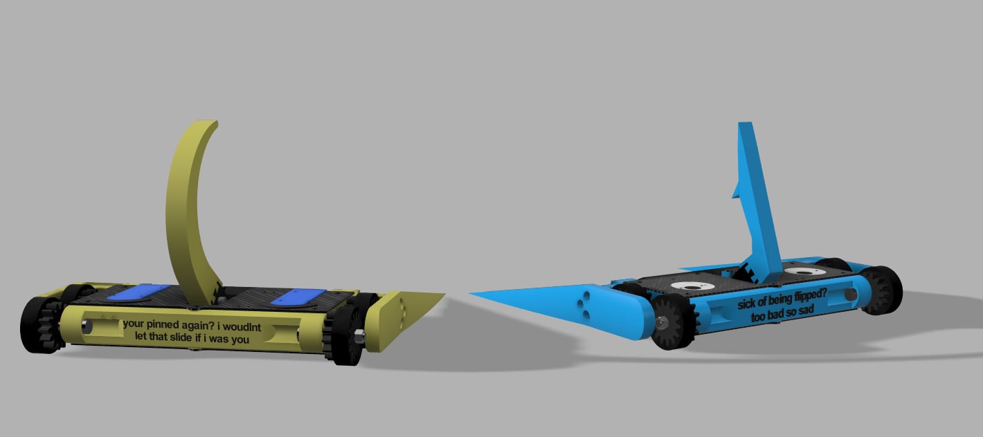

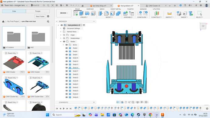

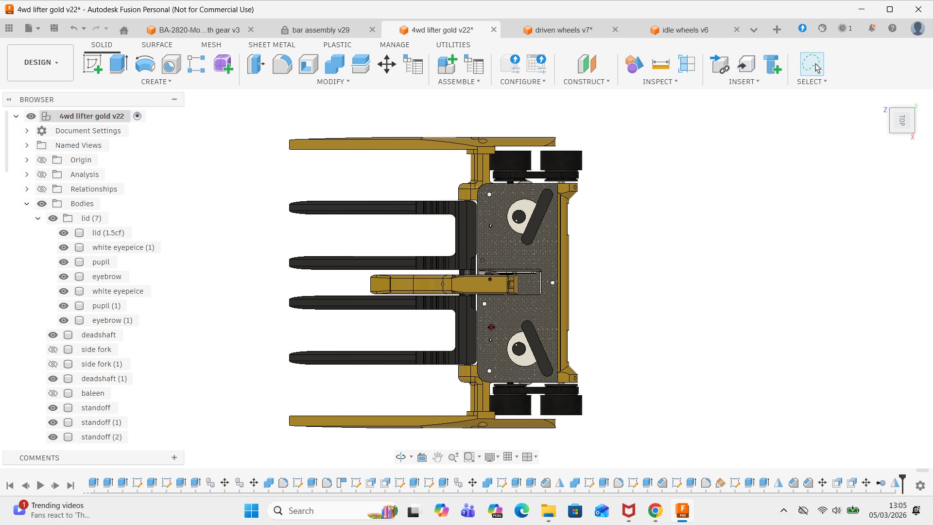

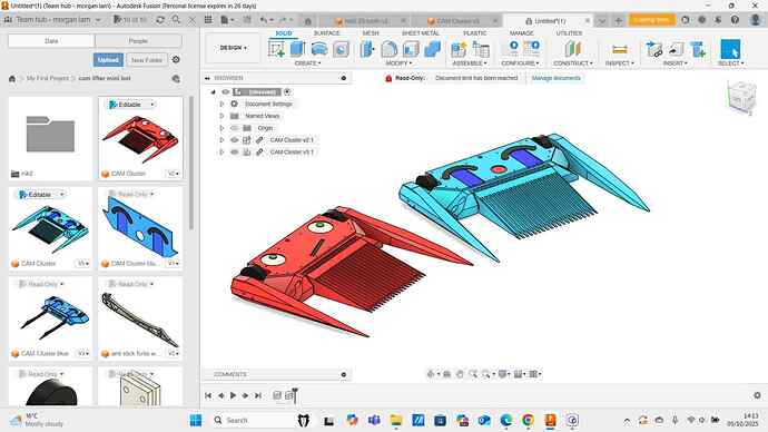

some very rough cad for a v2, with a lifter/grabber so we can self right and hopefully unstick ourselves much easier as well as other more control with a grab
until next time! rovengers assemble!

Well a v2 is now more officially in the works
The main things we wanted to improve from next time is getting some proper weapons on them. the wedges were fun but we always felt having some way to influence the battle would greatly improve them so we have a servo and either a lifter (that can double as a grabber) or a pure grabber depending on the opponent and we good we need our ground game to be. these can be swapped with a dovetailed secondary arm so we dont have to remove the servo every time and can swap it out much faster
the addition of weapons lets us also self right and wiggle off of walls which was a big issue in both the fights we lost
they are also got a bit smaller
slightly less wide and the body is less deep allowing for more armour on the bodys themselves
we also moved the motors forward to avoid being hit in the back and breaking them, we are going for the just cuz blitz lights as they are a bit smaller and come with a 6mm shaft standard. the other main change is 4wd this will let us put full power down much easier and allows us to run magnets much closer to the floor as we wont need to worry about the front forks flexing and them touching the floor
magnets in blue
wiring has also got tidier with the motors actually sealed up now.

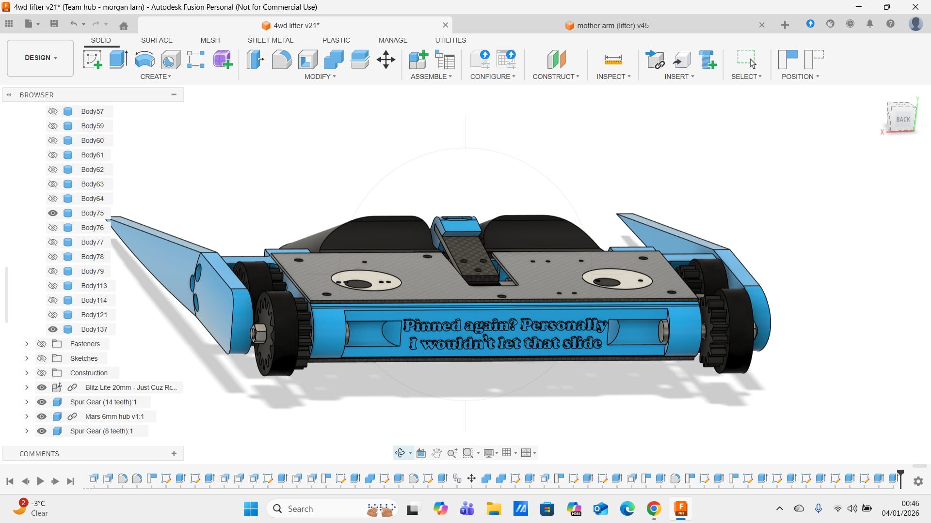

the other main change is the armour. its now 1.5mmcf top and bottom with a thicker tpu back to better avoid rear shots from verts. along with there being much less back there that can be damaged. the front and ground game remains moslty unchanged with 8mm hdpe rods holding in the front baleen with a slight angle change on it and also changing the spacing so we cant get stuck together if we go nose to nose
for anti hs we will have 2 options. one which will be a ti plow the other will be the standard tpu front. this will force opponents to pick between a stabbing black for tpu or a blunter blade to deal with metal

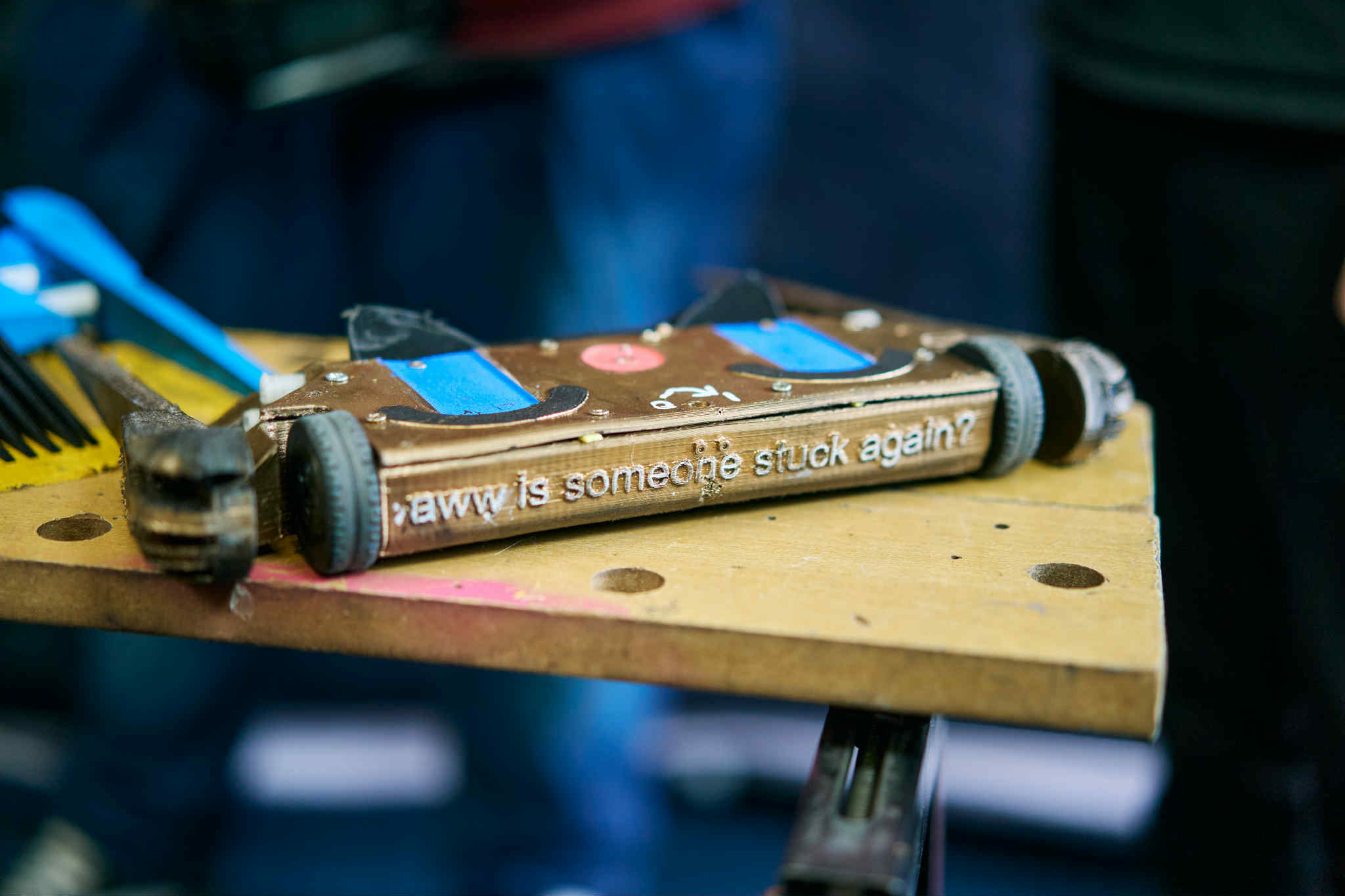

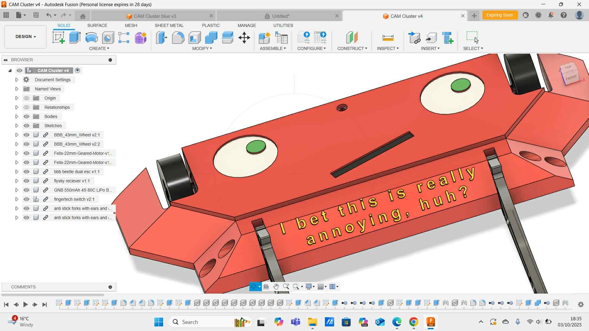

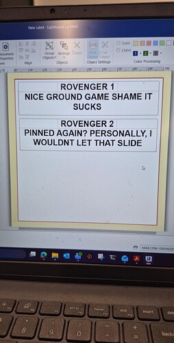

and of course the main weapon from last time returns in the from of insults written on the back upgraded as well
overall we are pretty excited to get these built and are hoping to be able to get them into brawl, if not another event later in the year

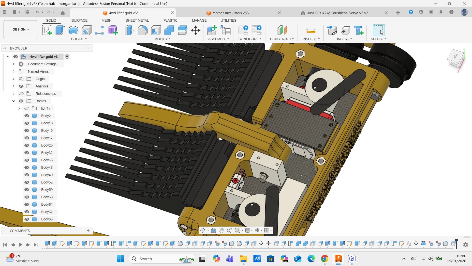

with brawl fast approaching i figured now was a good a time as any to write-up the build process of these new clusters

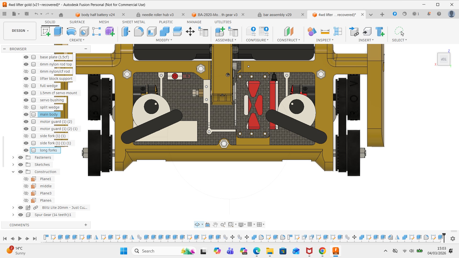

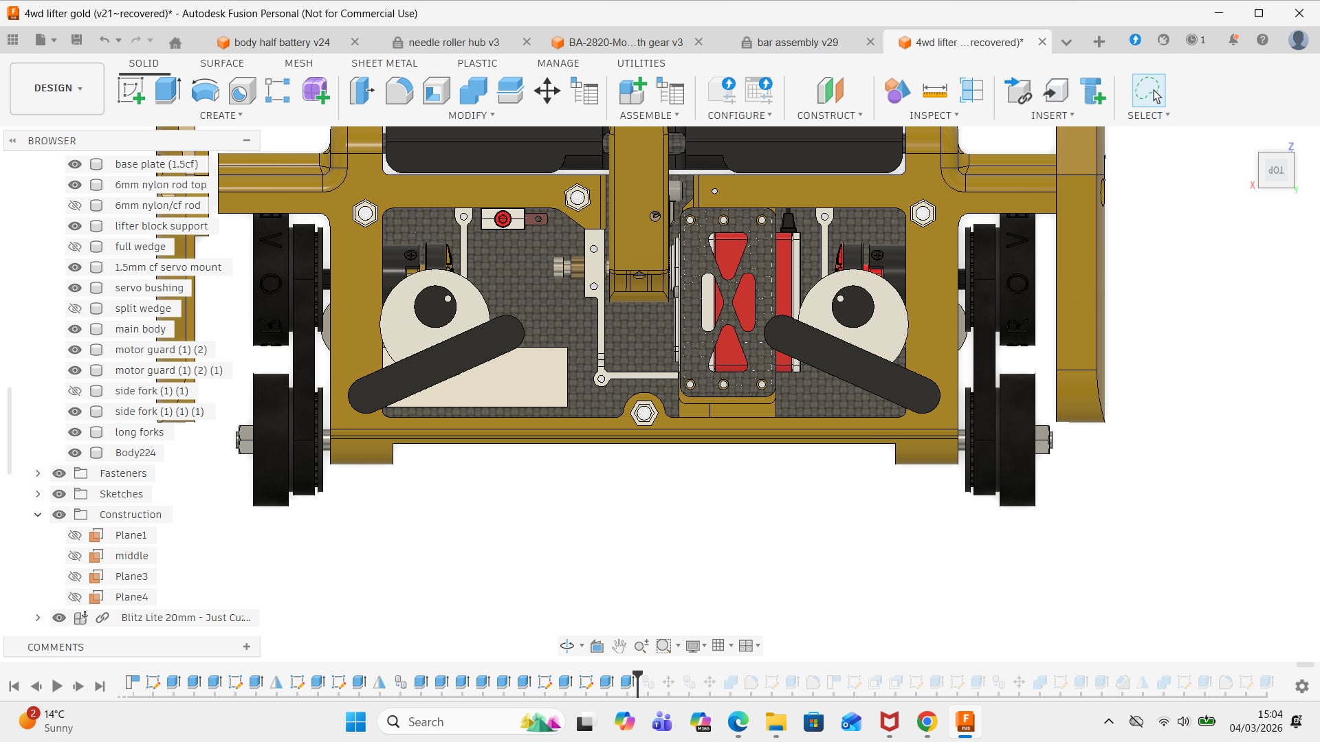

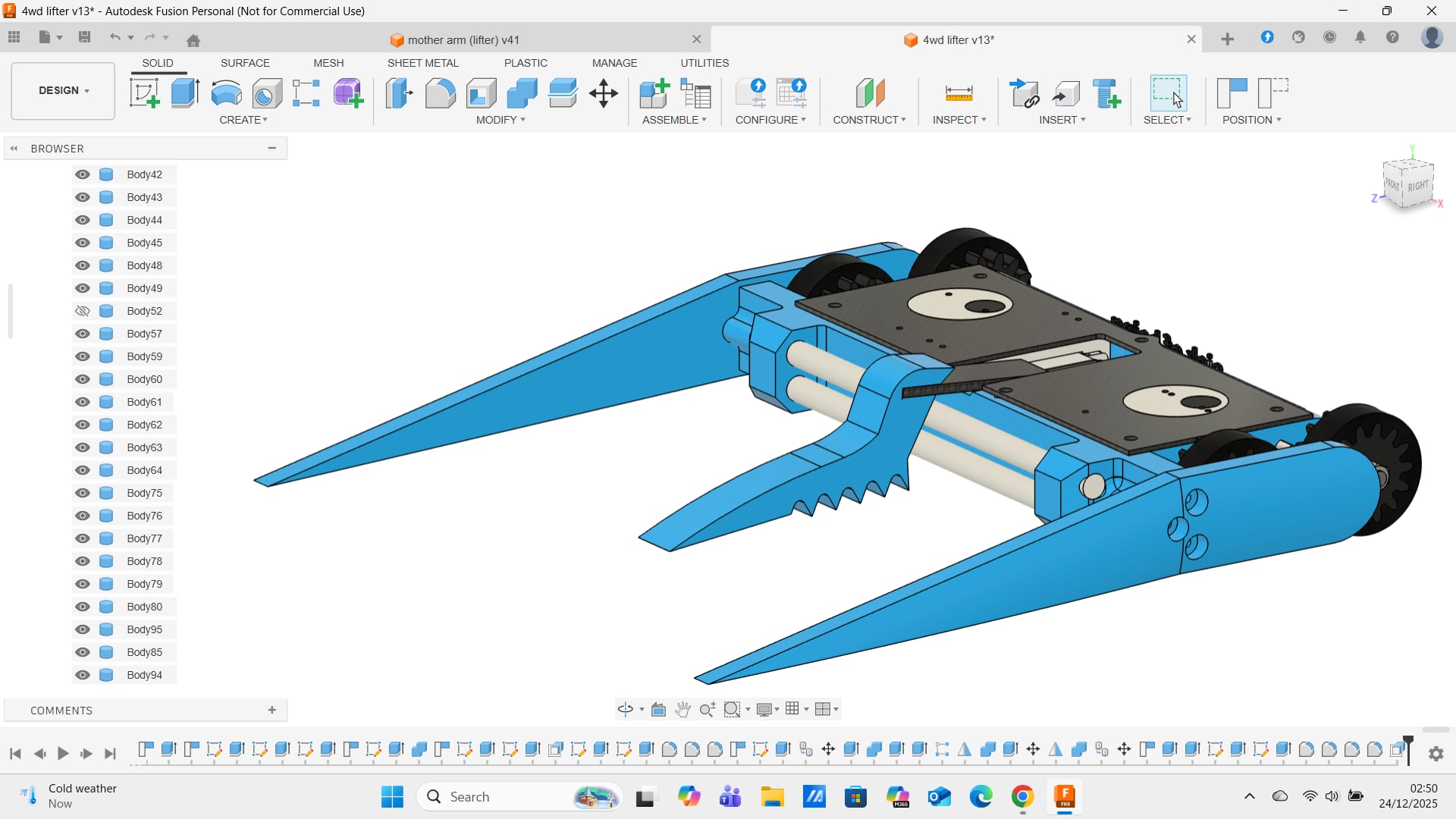

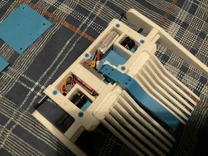

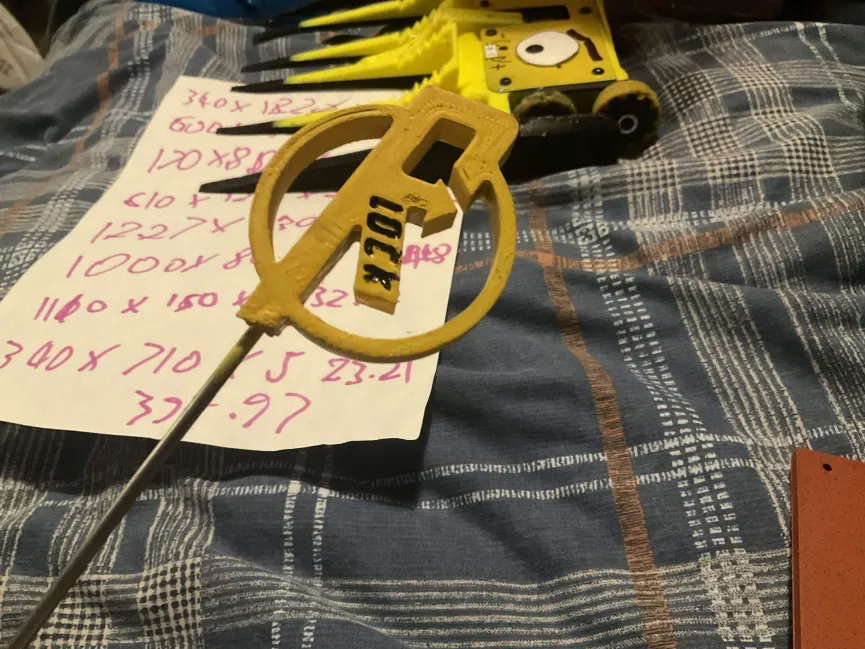

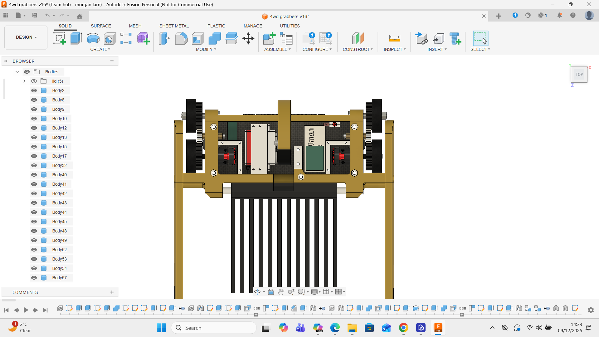

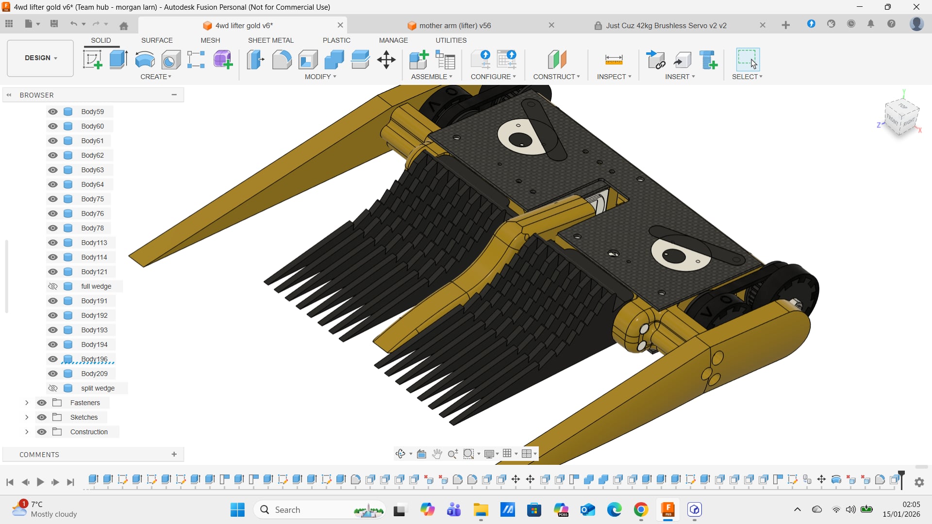

these are the first time ive actually built a beetle lifter (that wasnt 360) so there was a bit of a learning curve, starting with the cad, they mostly stayed the same as the previous post externally but the insides changed allot as the build progressed, rather than jump between cad and reality ill just do all the cad stuff now
rear armour with large chamfers to get the shoulder bolts inplace
unused split anti hs config, we decided to go to a solid jointed version for strength

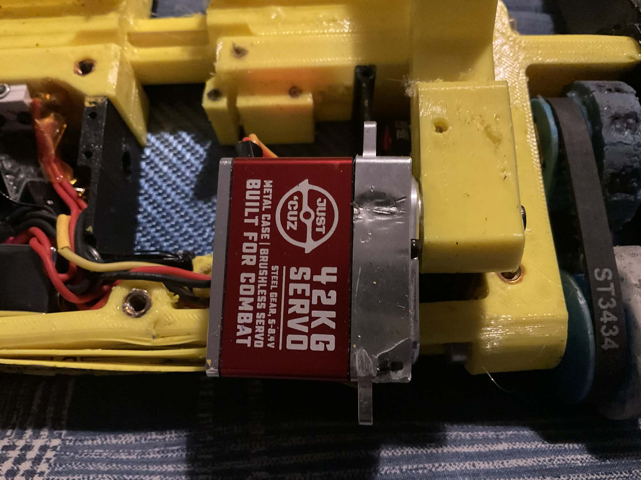

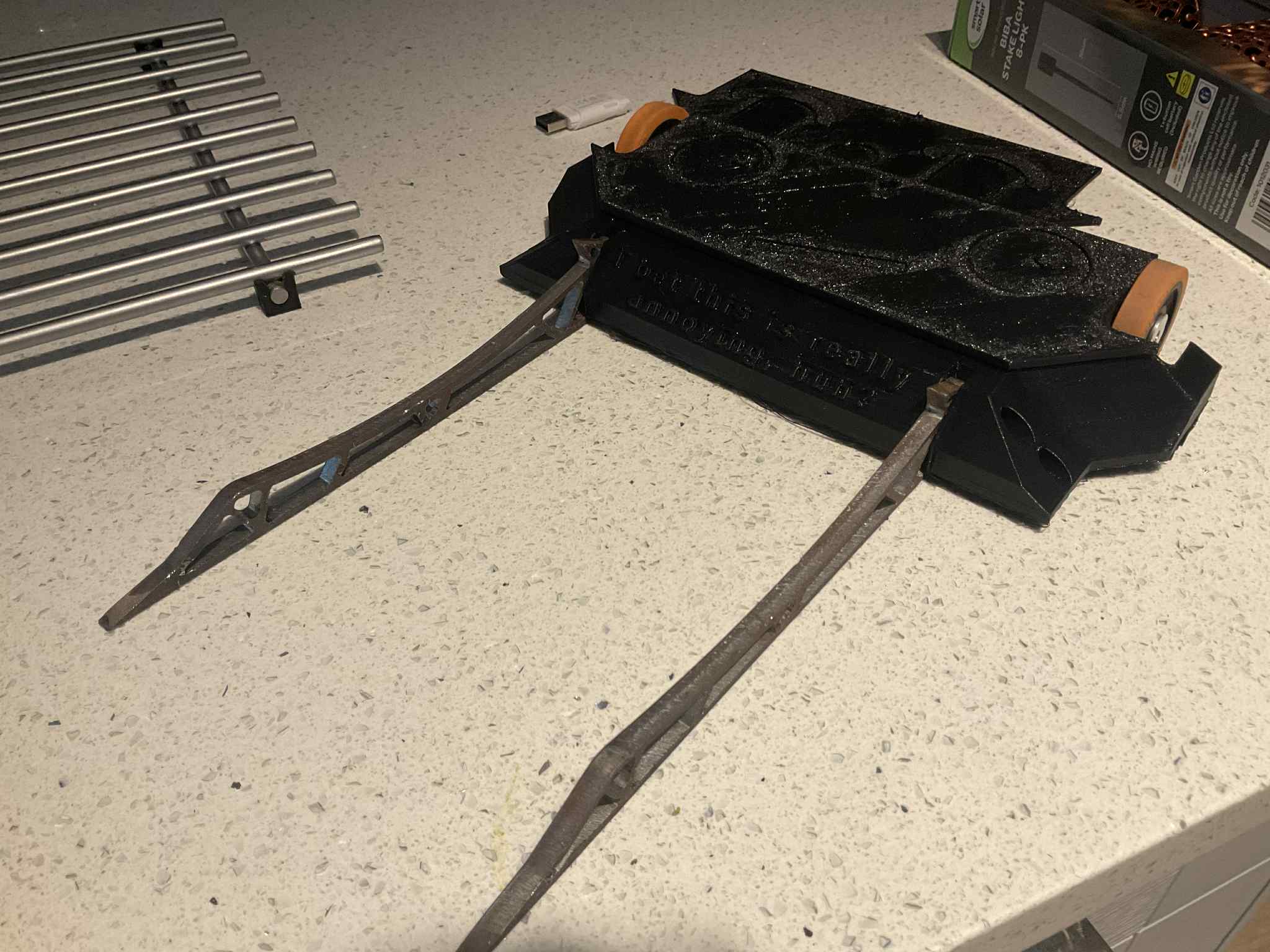

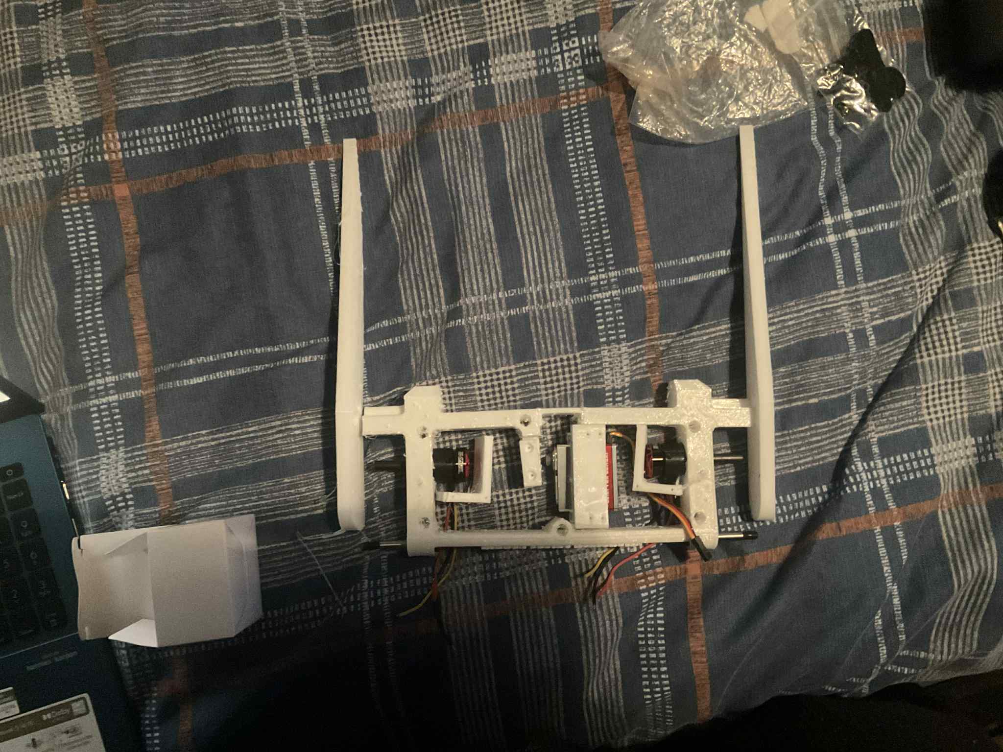

and finally how the front rods work in the bot. we decided to move away from hdpe rods as for tpu forks they were overkill and difficult to put in if the holes missaligned (plus for some reason aliexpress refuses to ship me 8mm rods and instead ships me 12mm) so we decided to go to either cf (for stifffness) or polycarb(for less splinters) we will try both and see how they fare

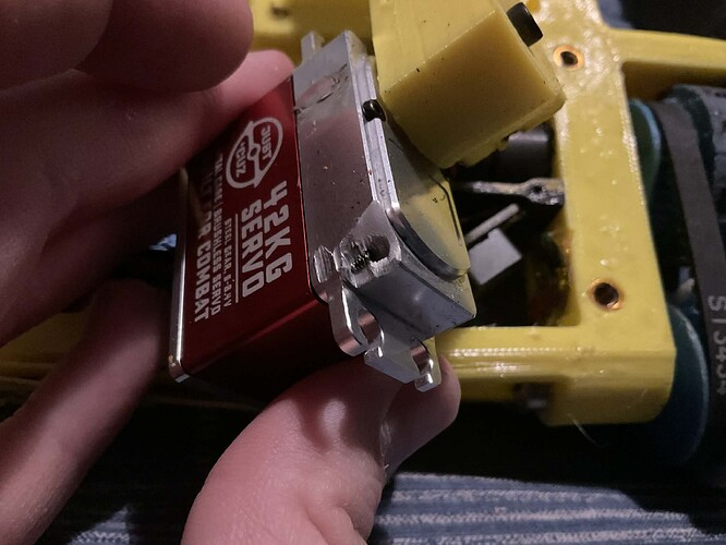

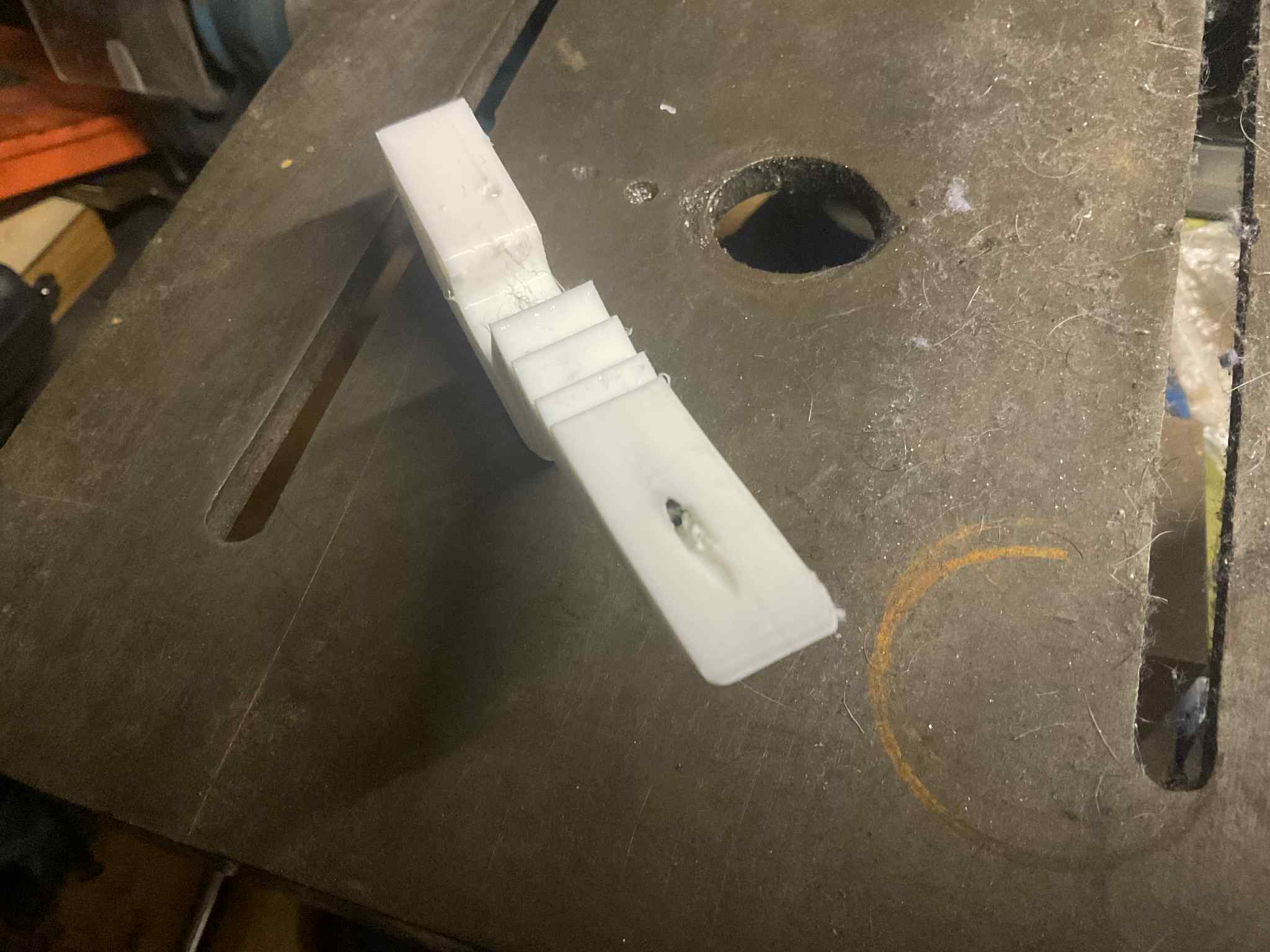

after some testing we found the cf assembled lifter arm just wanst going to work and so decided to go to a tpu arm with cf rods inserted into it as well as a redesigned servo mounting system, previosly it looked like this
which was a tpu U shaped peice that the servo screwed into and then bolted to the base. this was going to prove tricky to impliment so instead I borrowed heaviliy from the ssp kit and had a cf cover over the servo and some nice keying features for it to rest into. talking of these are pretty much 2 ssp kits in terms of drive and weapon power which is kinda funny
with the cad pretty much complete it was onto the printing process. they are all printed from tpu as all things should be with some pla top and bottom plates for testing

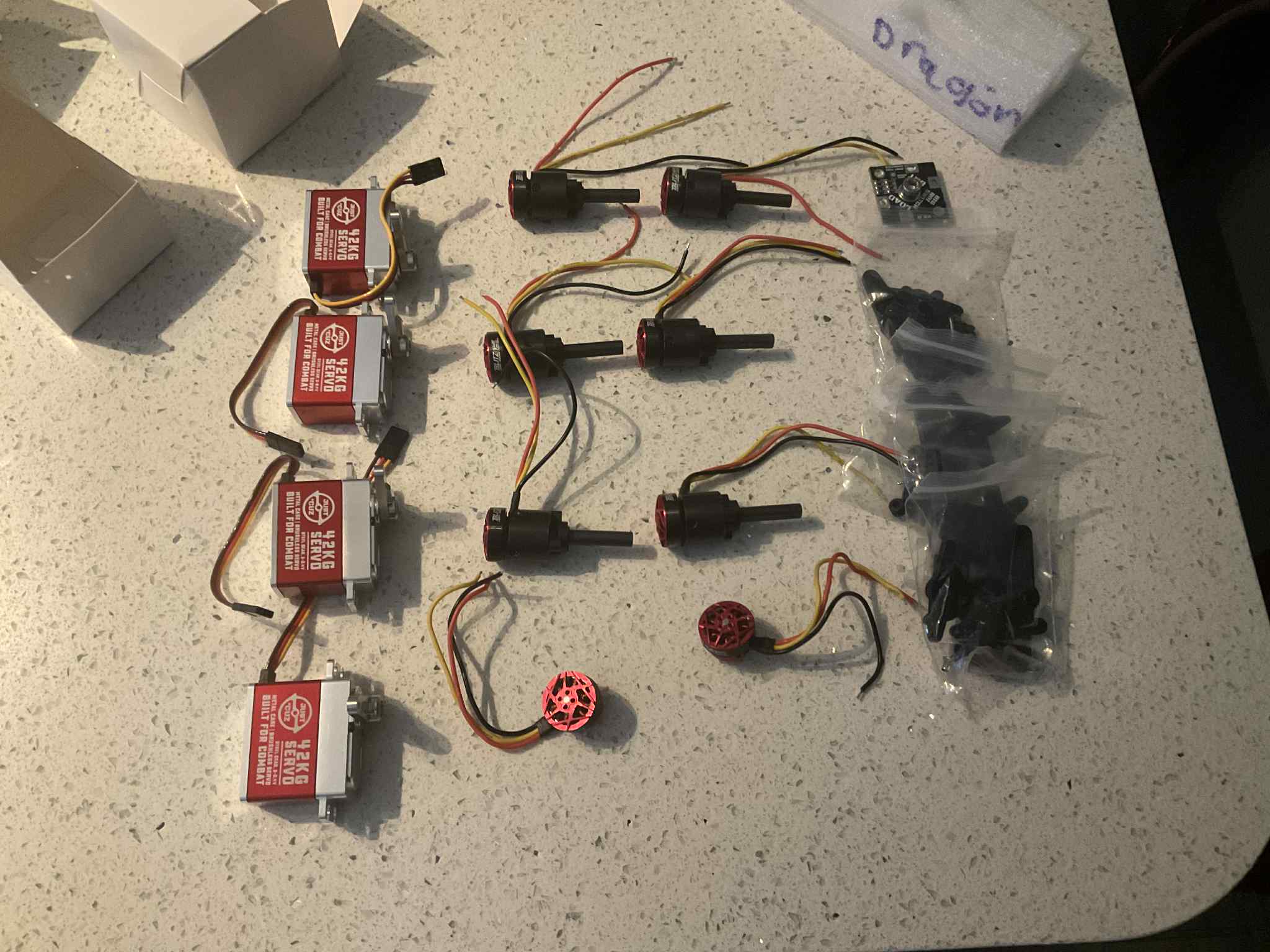

printed parts and all the goodies i bought for them (oof my wallet)

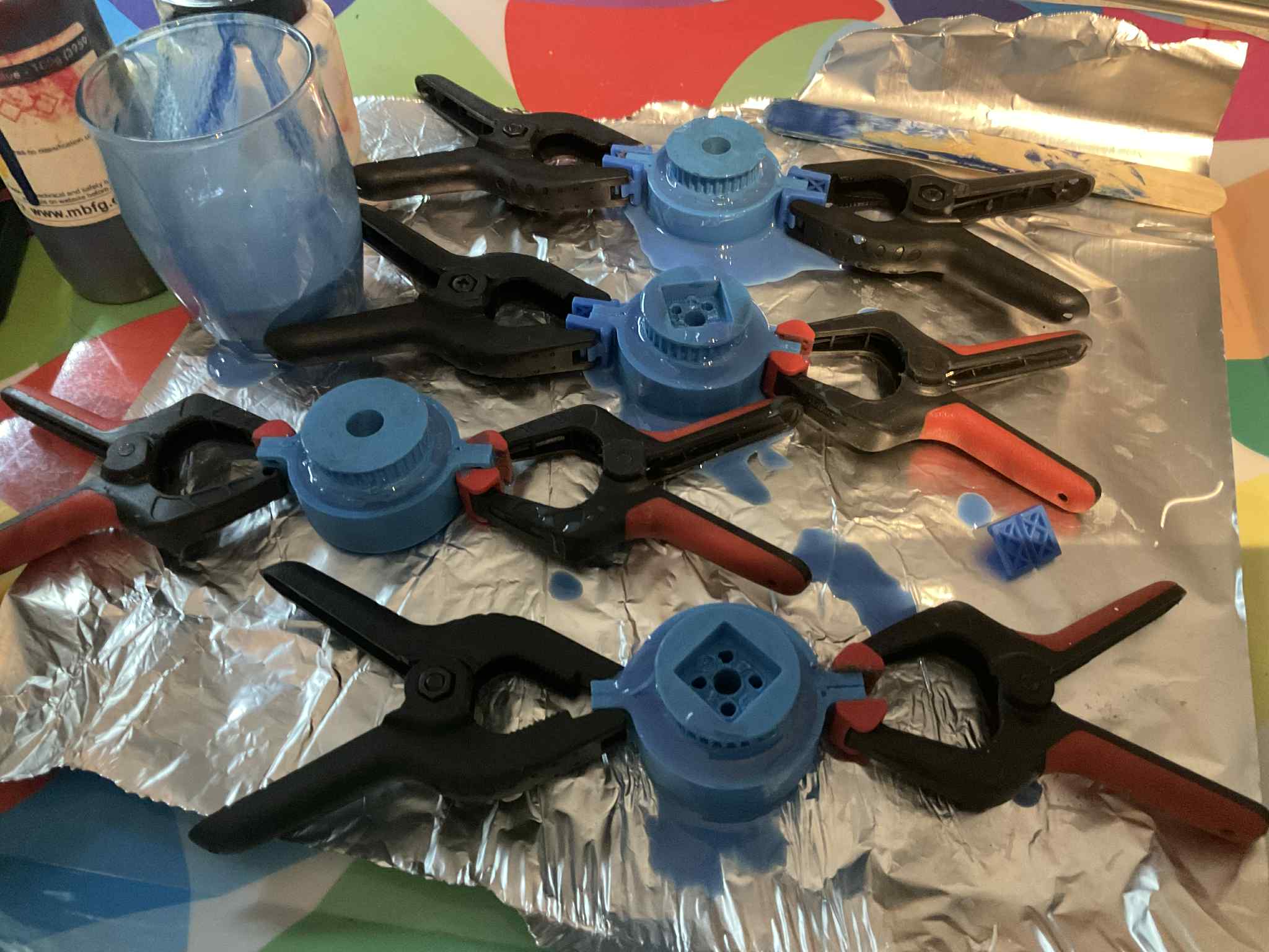

decided to cast up some wheels much earlier than i usually do because i wasnt sure how the drive belts would react, turns out they did pull a little tighter on the tpu than normal and so i had to toe out the rear deadshafts by 2 degrees

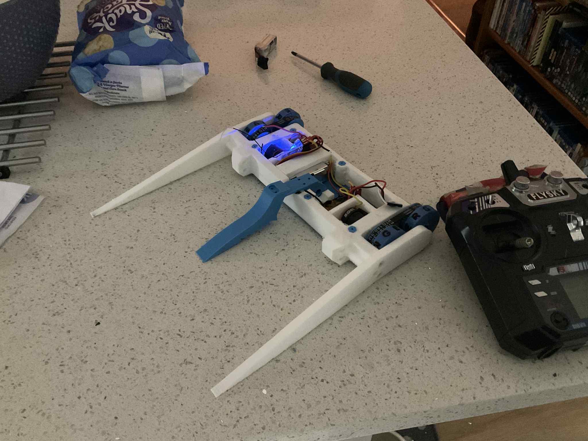

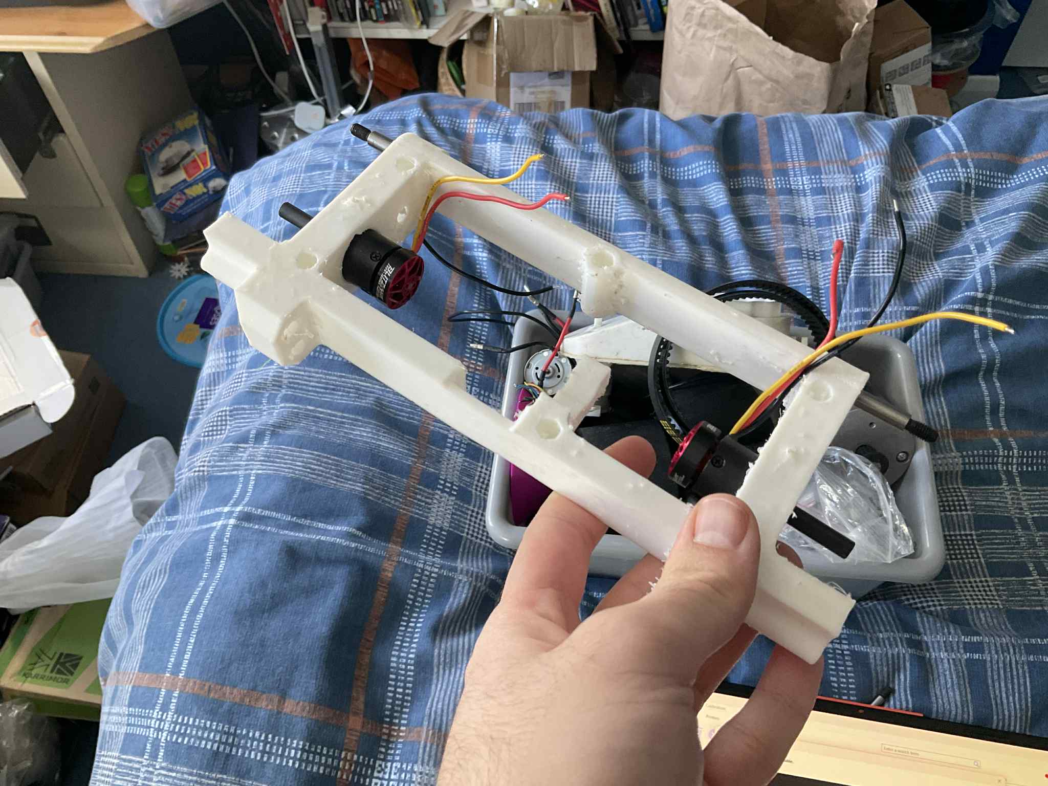

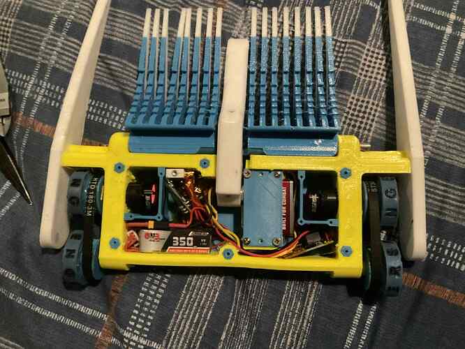

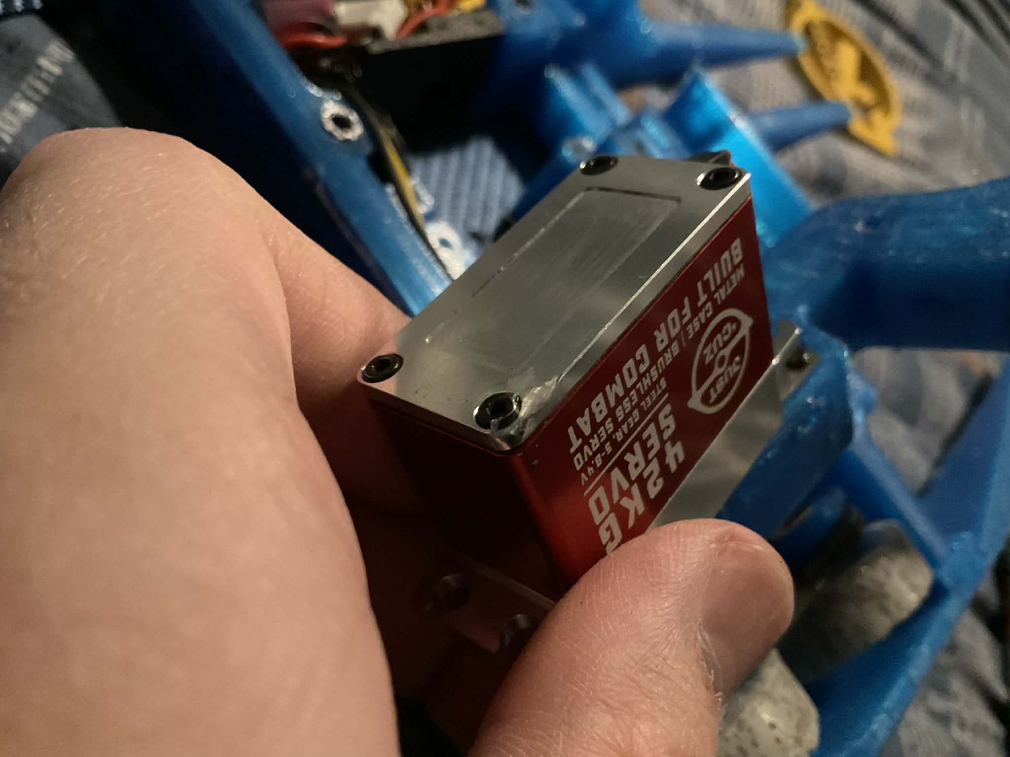

did a first electrical test fit and powered on the servo to get a feeling for self righting

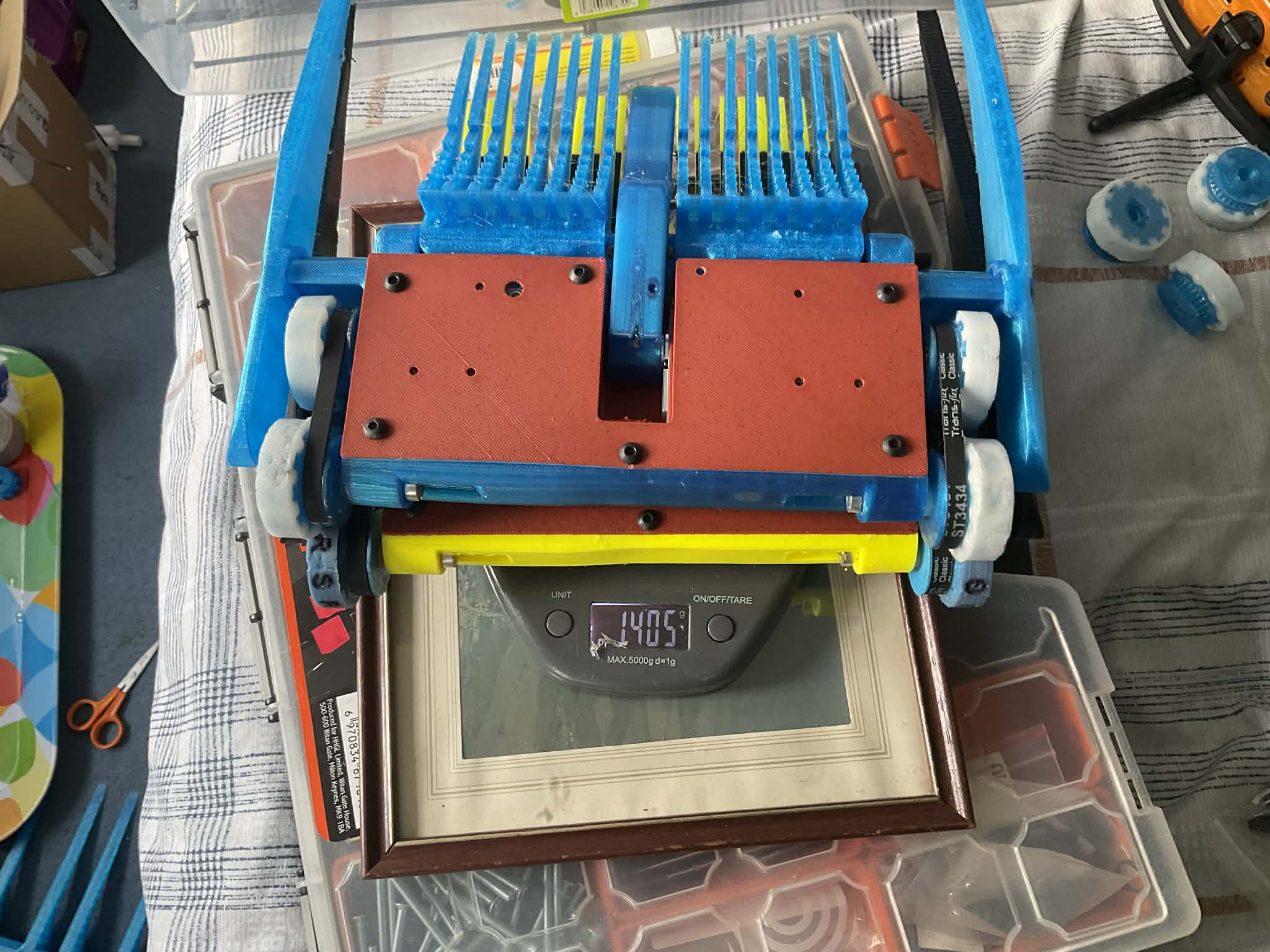

next up was to weigh it and then do a full wiring job. was very happy with the wirring less happy with the weight. the prints were all lighter than the real deal and it was missing the carbon fibre so i decided to make some custom rear axels
so i made some magnesium rear axels and custom nylon bushings saved a crap tonne of weight and was going to be much easier to assemble with a bolt instead of a nyloc
and as you can see they saved a crap tonne of weight
all the set-ups for the bots. we got an anti hs wedge, a baleen config and a long fork config thats lighter to run ti lids/other attachments

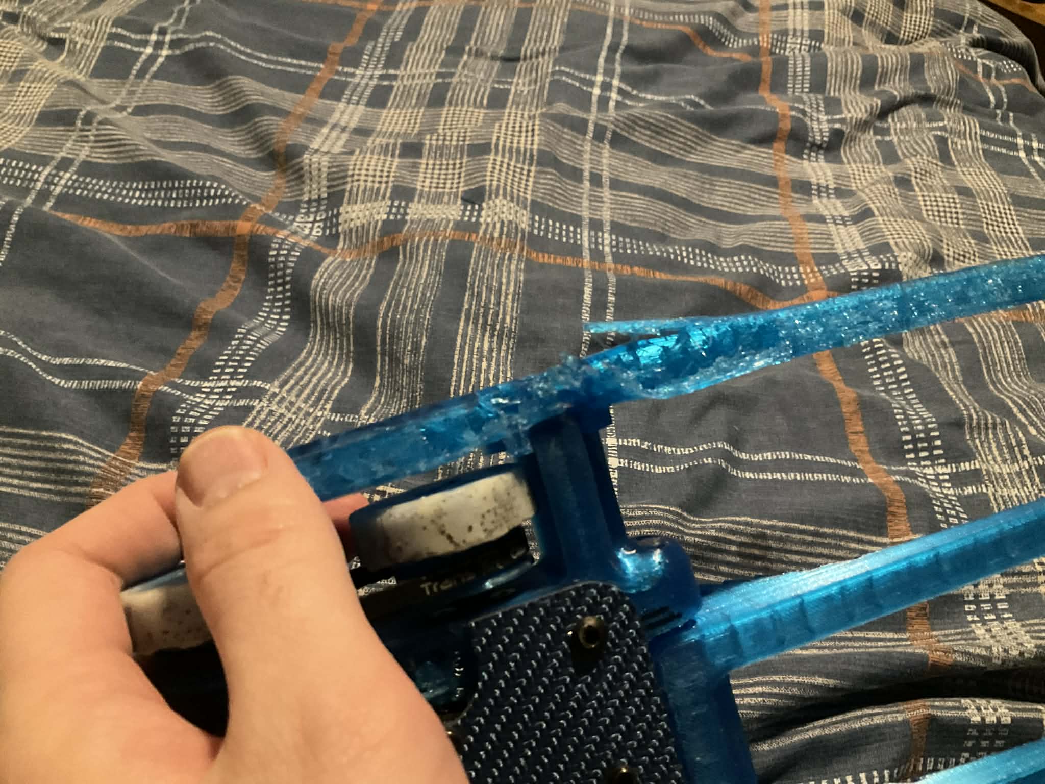

next up was trying out the lifter arms with the cf rods in the tpu prints. its crazy how much stiffness this adds and would recommend others give it a go the rods weighed nothing and was much stiffer than a solid tpu print
with all the prototyping on the first version the second version came together very fast and they both came under weight minus the cf

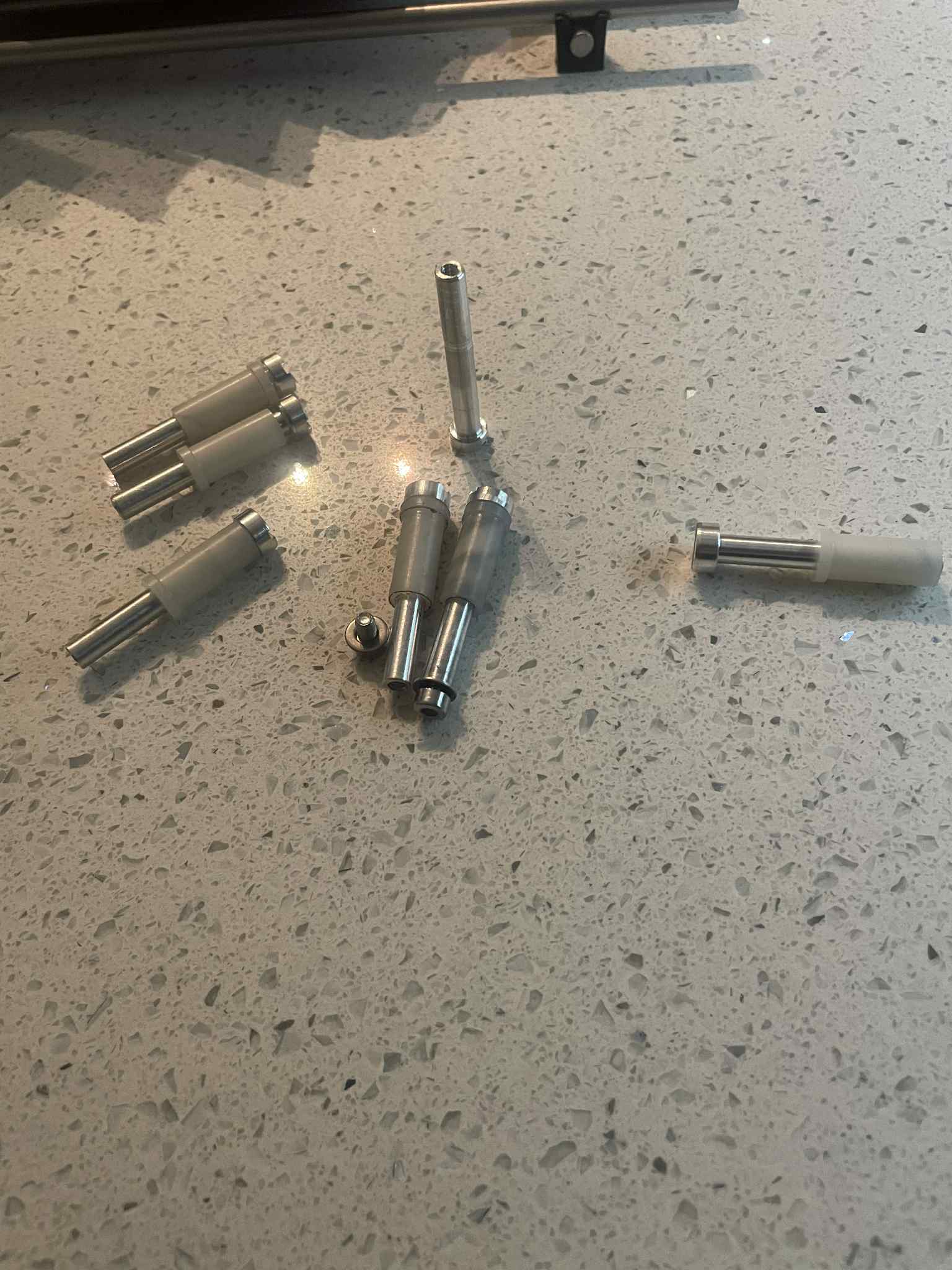

another new thing i did with this build is actually designed all the bolts to use the same 1 or 2 tools rather than the usally birgade of screwdrivers i bring with me so these use plastites which is my first time using them and my god are they so much better and it means the top can be removed with a 2.5mm allen key and a t10 torx bit (i bought 2 of each for extra try hard)

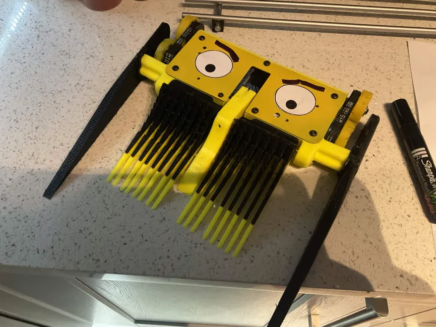

so yeah thats the bots done for now, they just need the cf which should be arriving soon and then a paint job!
turns out theres another cluster going to brawl, if anyone with access to mess with the draw is reading. come on that first round melee would be really funny :rofl:

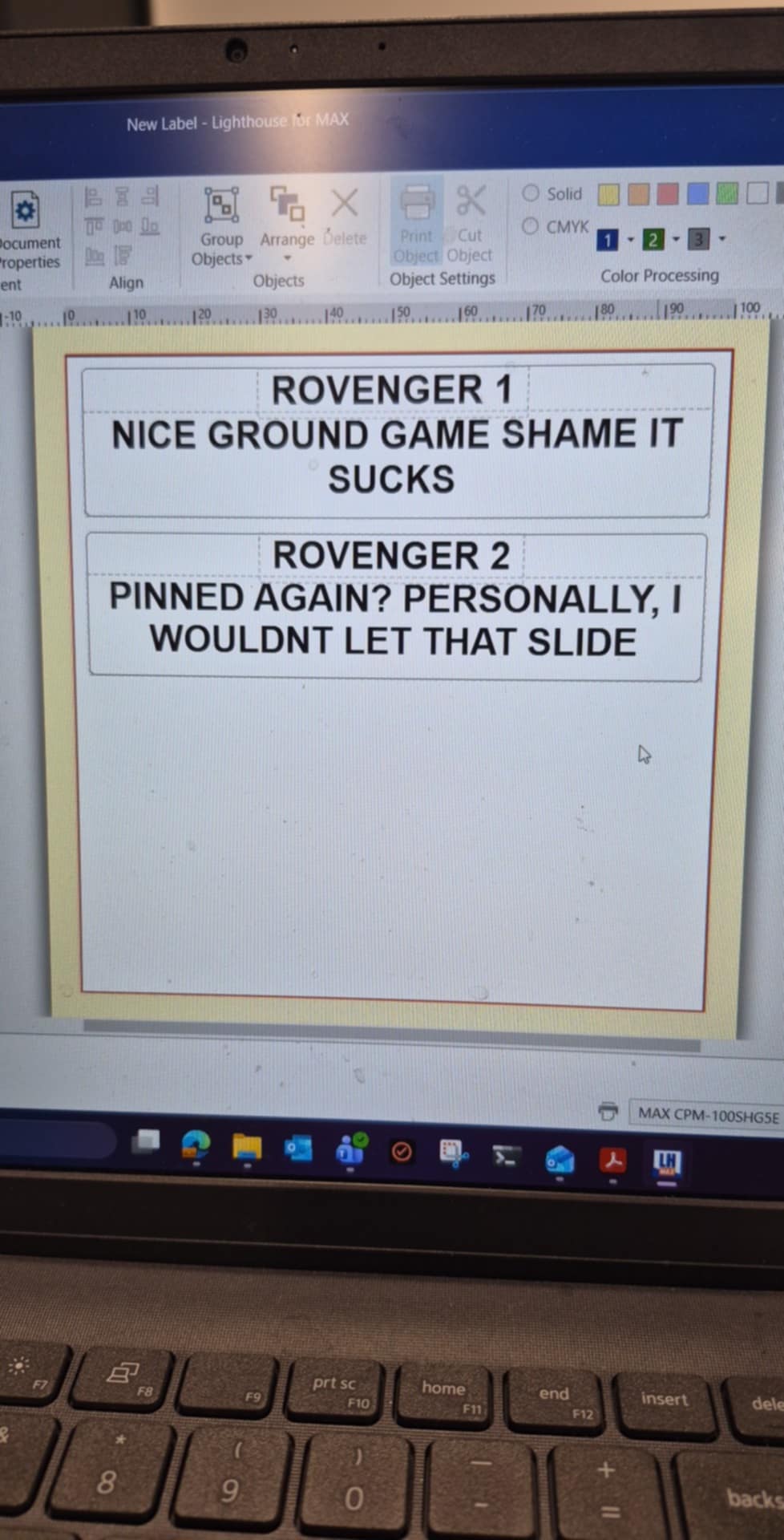

although because these are the rovengers and we wanted to really play them up this time we went and did these
because why not
simon also cooked on the new rear logos
so with that we are 90% of the way done for brawl the last few things are resoldeirng some 7.4 volt becs to replace the 5v becs some more wheels and fitting the carbon fibre. our hope for this event is to get some non cheezy wins and mabye recreate some of the magic from there first run since these ones are sooo much better than the last versions, which of course means they will go 0-2

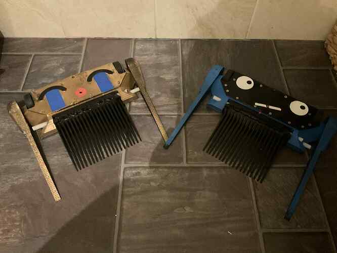

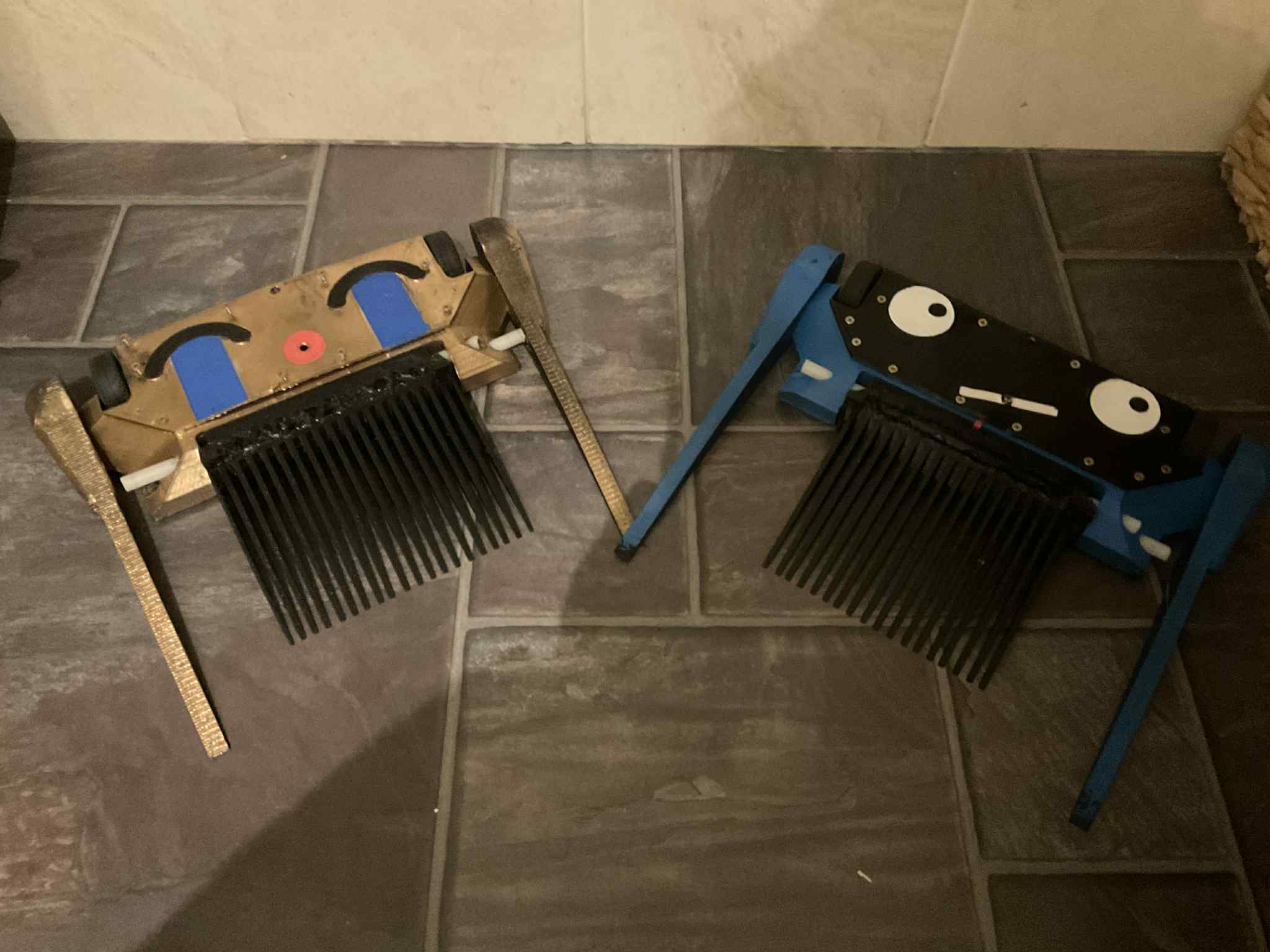

the carbon fibre arrived so it was time to pretty them up!
the gentlemen looking very dapper

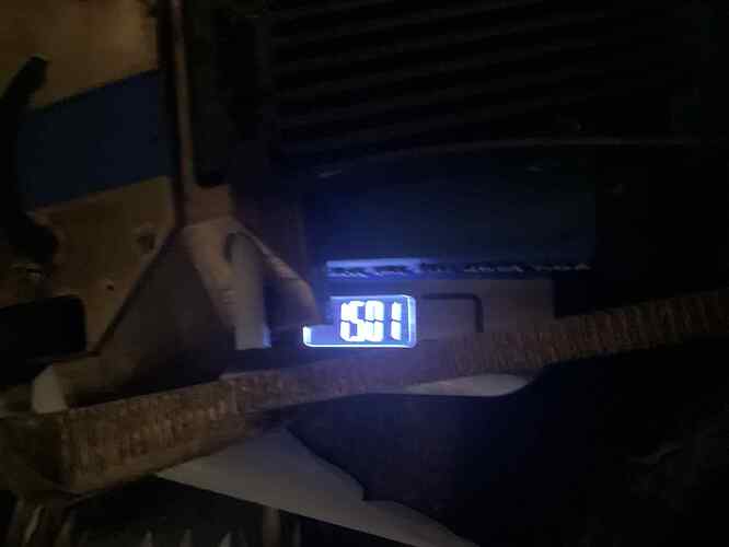

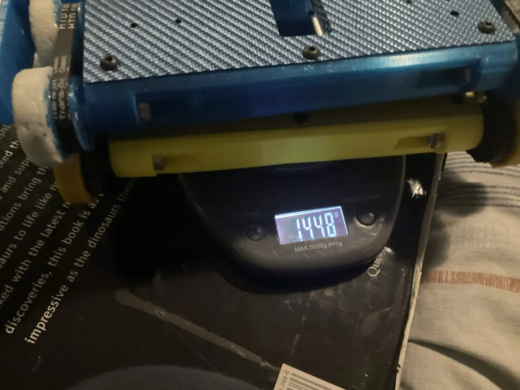

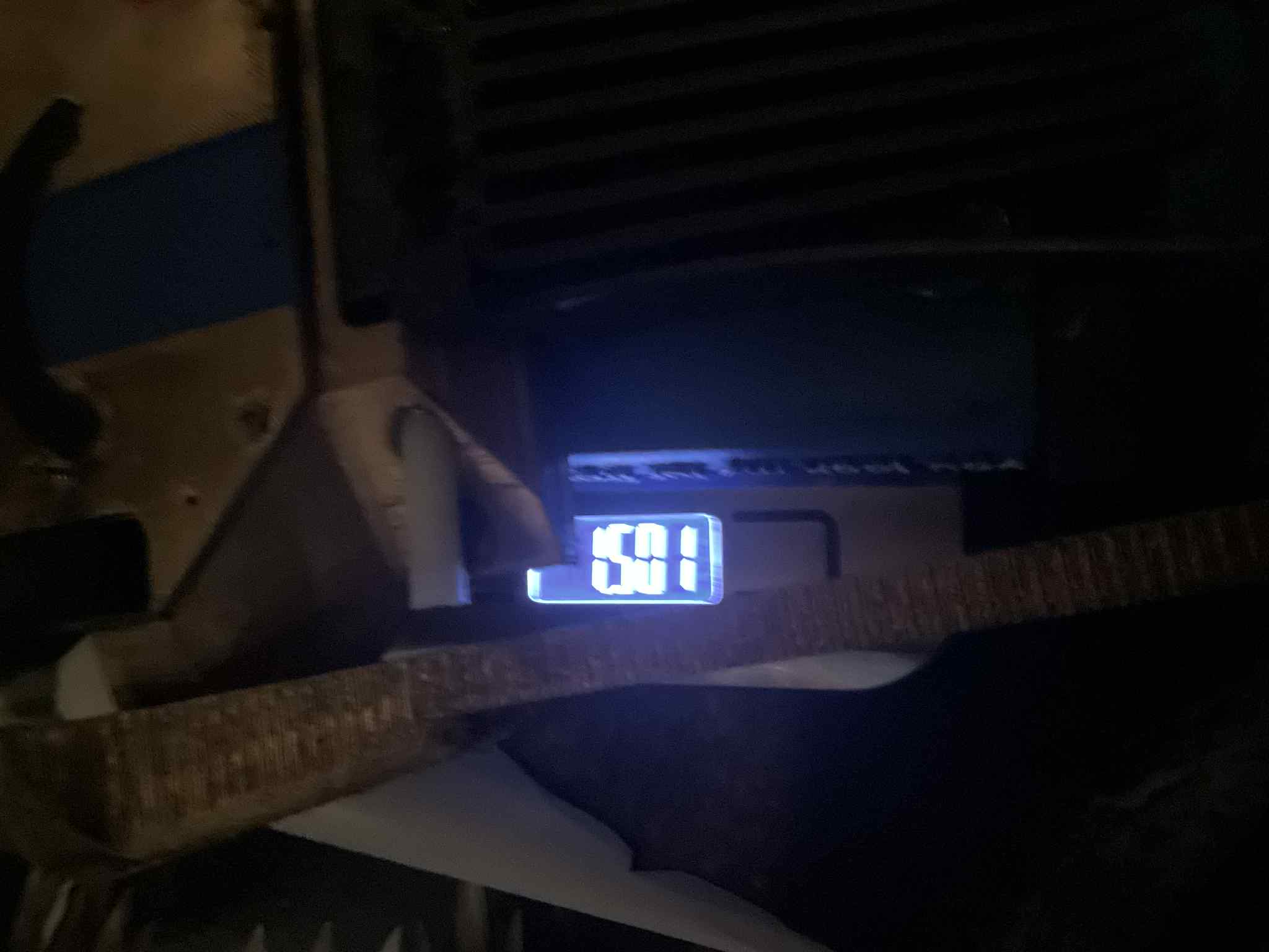

and in weight! its nearly light enough to run the ti lids ontop of the carbon fibre as standard
talking of Ti i gave the anti hammer saw/crusher top armour some unique personality too. these wont quite run like this as we will need to swap to lighter side armour but it means we have 1mm of titaniium a tpu air gap and then 1mm of carbon fibre underneath with some small ti bits we can strap on the lifters too. should be pretty strong

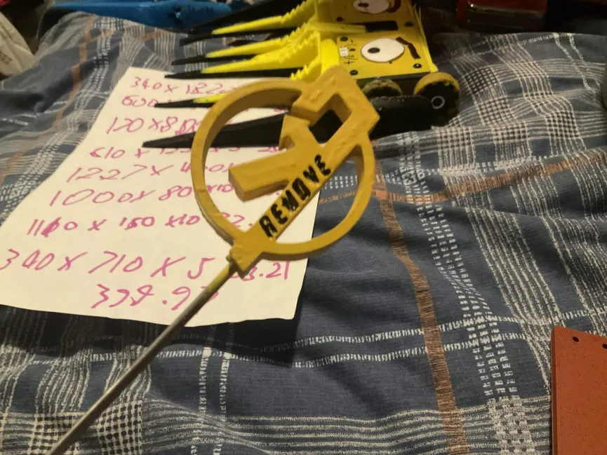

finaly bits now are a cradle which simon is working on
, some locking bars and a few more stickers for the rear of the robots
I also need to mess around with the magnets a little. honestly we are tempted to run without them since we havnt really been able to do much testing with them and on wooden floors they drive really nicely. since the 2 options we currently have for magnet at nearly no force at all or stick to the fridge level force which feels like allot to put through these fairly small drive motors. we will likely see on the day

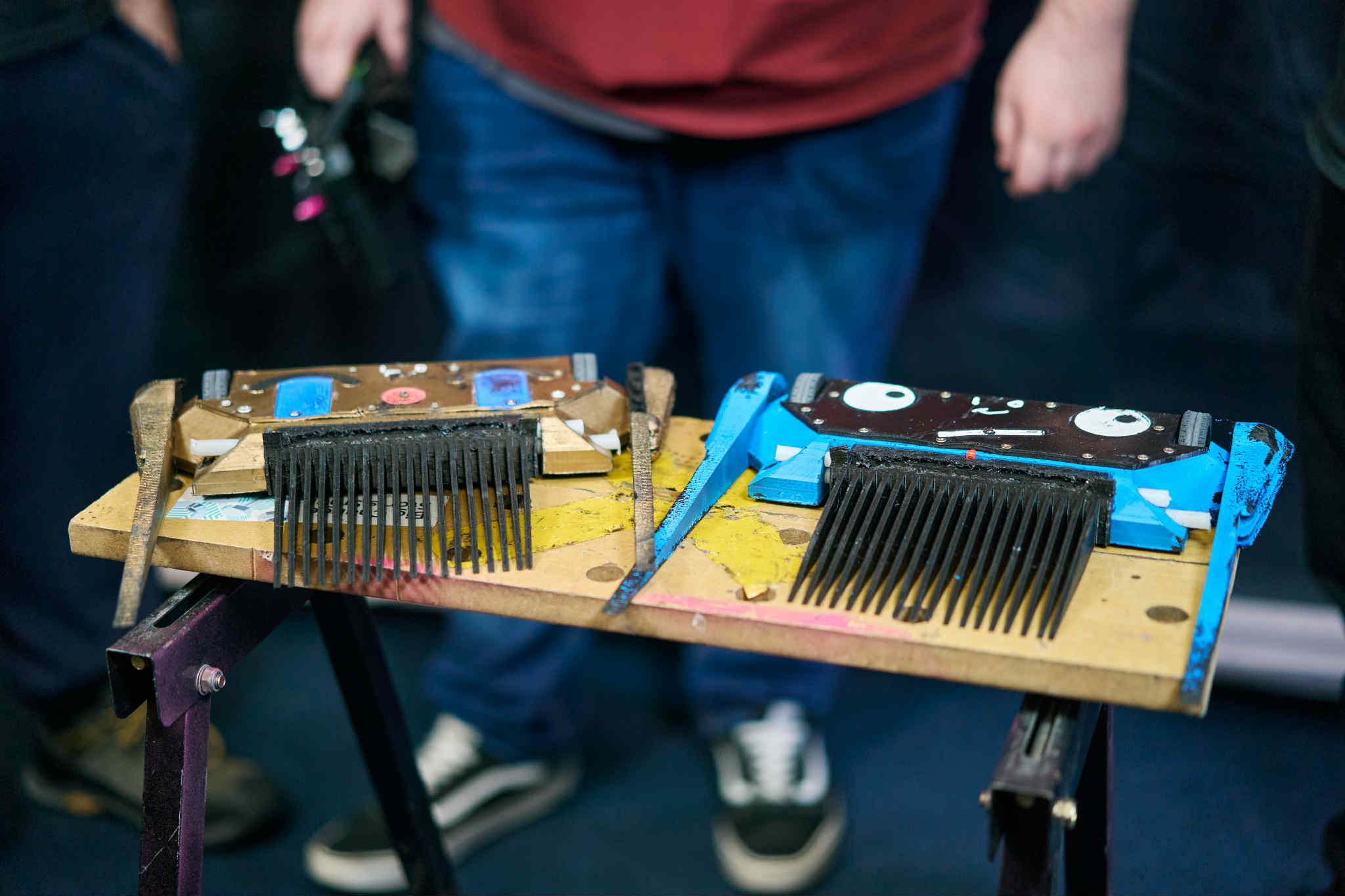

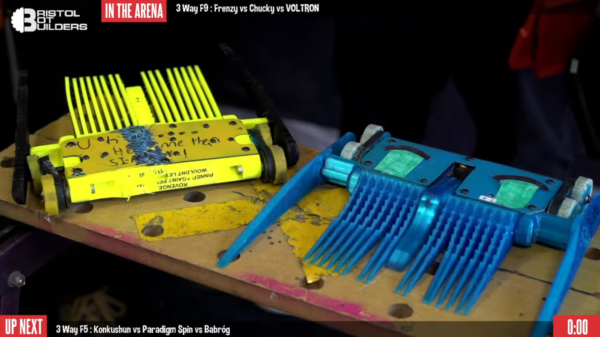

as we were all prepped we thankfully didn’t have to do too much to get them prepared for the tech check just had to set-up Simons transmitter and do some adjustment to get it to failsafe, i also made some fun lock bars

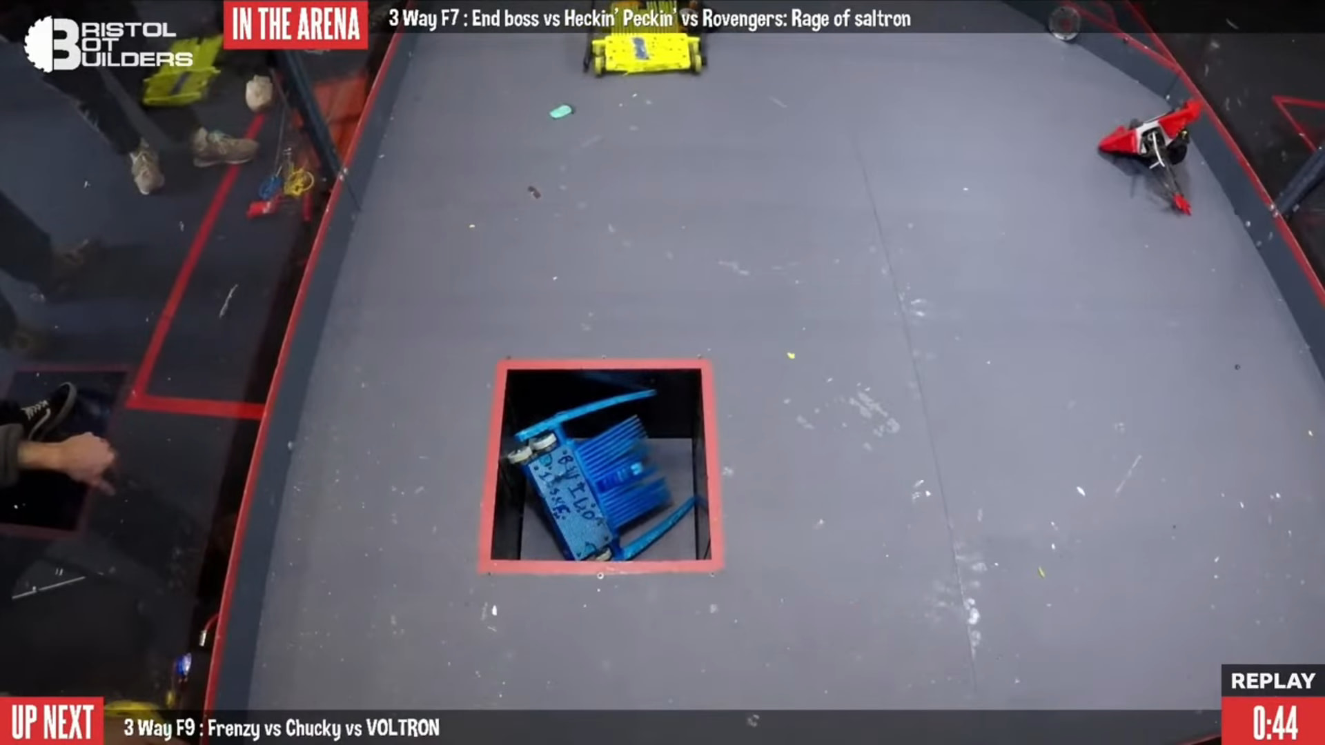

this is when we got our draw, heckin peckin and endboss. although we were nervous to face such a powerful bot we were looking forward to seeing if we could hold our own, endboss was also in the fight
as a result we kept our front baleen and found the weight for run our ti top armour by removing the untested magnets we werent convinced this would stop the crusher but it had to be better than nothing. our tactics were pretty simple, try and keep endboss contained and let heckin peckin get a bite although really it would be a game of survival
loading in was fun as my transmitter decided to troll me by not binding despite doing so like 5 minutes prior. a quick power cycle on the transmitter solved the issue. nothing like a little prefight heart attack
it goes well initially with us getting under end boss but in one massive shot to yellow we lost a side of drive and the lifter. heckin peckin was flipped and out of it leaving blue and a hobbling yellow. simon did as well as he could running with half the weight but eventually ended up in the pit and i was propped up on the side wall
you can see the damage to the belly of yellow in the interview

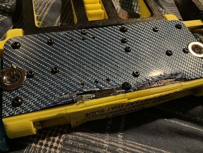

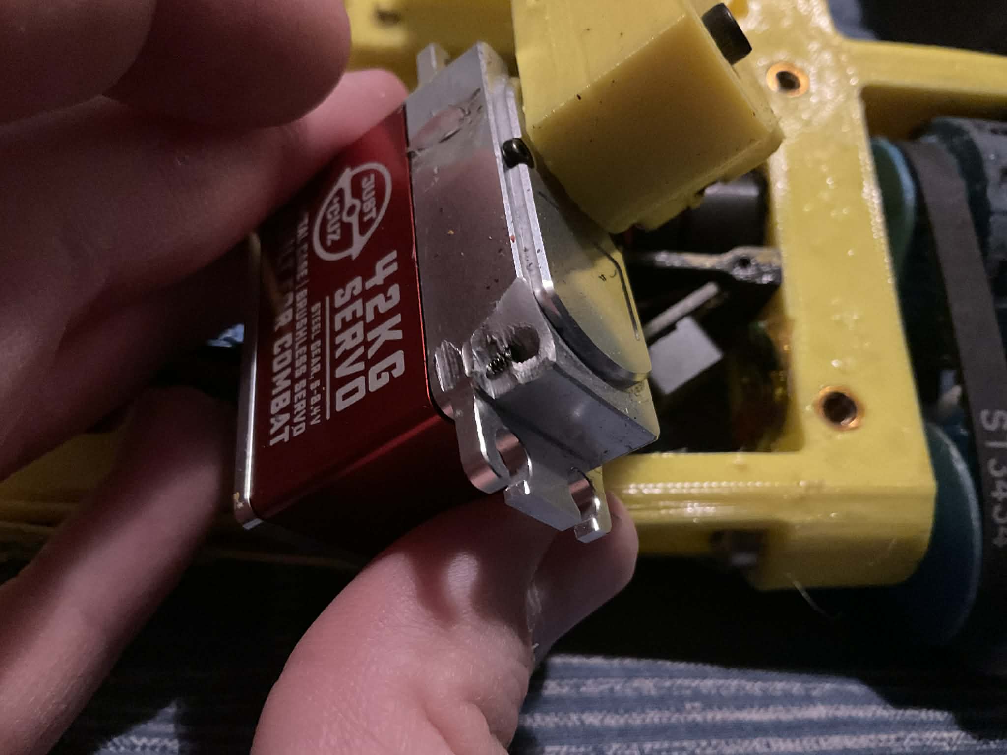

damage wise it seemed allot worse than it did at first. the new friction repeat hub had slipped off one of the sides of drive jamming it up, although it had also broken a wire when being hit in the back. the servo had taken a hit from endboss jamming it up we also found the bec had lost a component and so was dead also. in about half an hour we had yellow back up to full strength replacing the bec with a lower voltage spare and bending the servo case out the way of the gears. blue had a belt cut so we replaced that and it was good to go again however after the event we found it had also taken a hit to the servo. must be said these servos are durable. both baseplates were write offs but we had loads of spares so wasnt a huge issue
the tpu side armour also took some damage but we felt no need to swap them

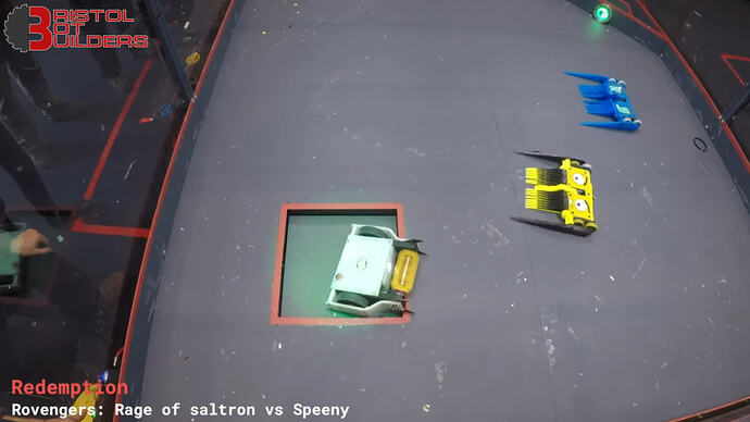

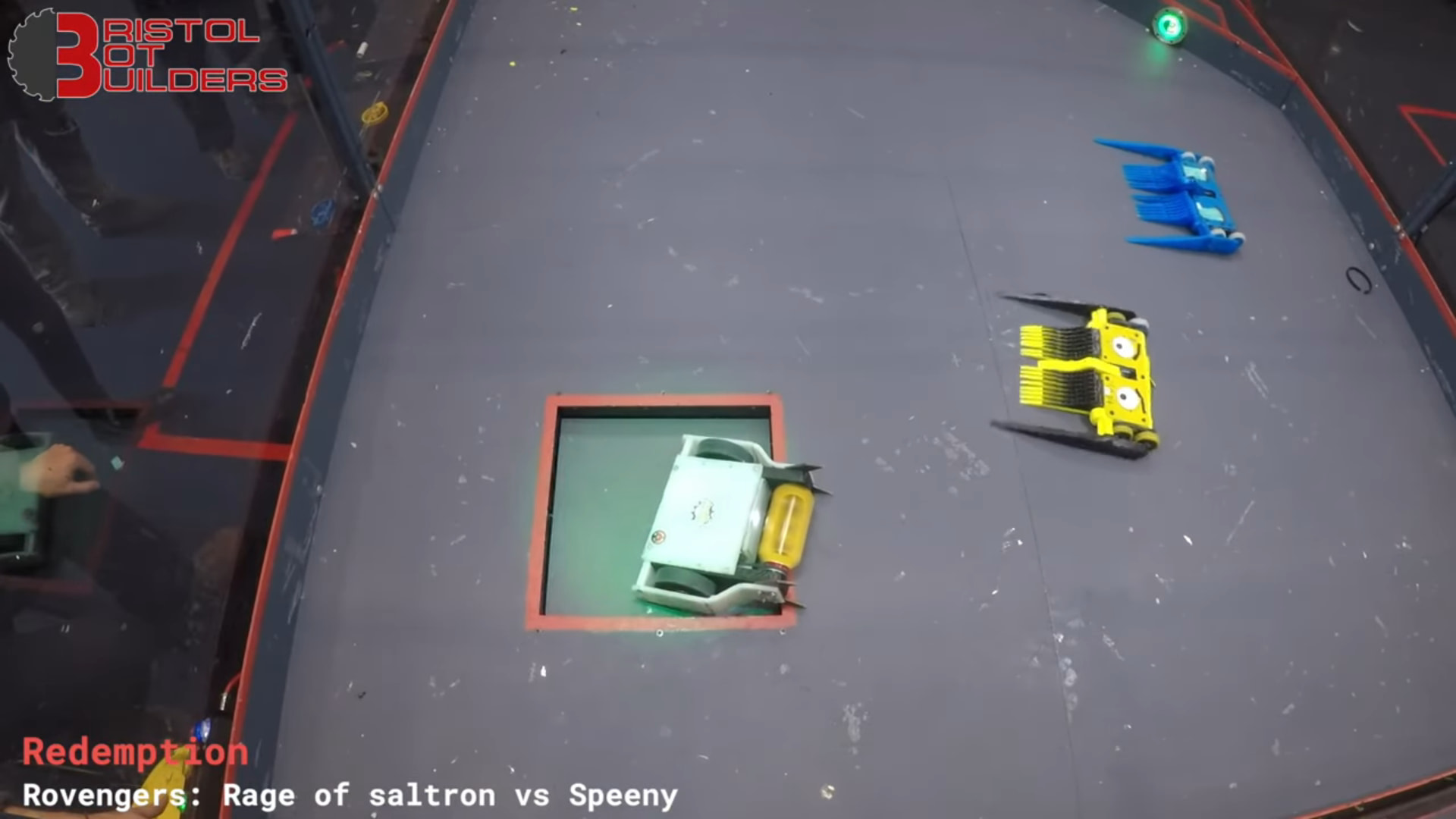

next up was our redemption fight with speeny
we had faced speeny before as a cluster team a few years ago but it was suffering majorly with spin-up that time so we knew this time would be more tricky. we kept the same attachments this time we me going to the normal top armour to free us up some weight (not that we needed it)
fight begins and blue gets a driveside hit very quicky cutting the belt and pulling a good chunk off the wheel meaning it had 1 side i managed to get under speeny a bit but then speedy got some hits into yellows base pulling out of the screws out high siding it slightly leaving us with 2.75 sides of drive between the two of us happily at this point speeny found itself over the pit as it was lowing giving us a lucky victory
damage wise we had to replace the belt on blue as well as a wheel and some wheels on yellow also as they had taken some hits too. the screw in the base was replaced and retightened. we decided not to swap the baseplate as although a little frayed it was good enough

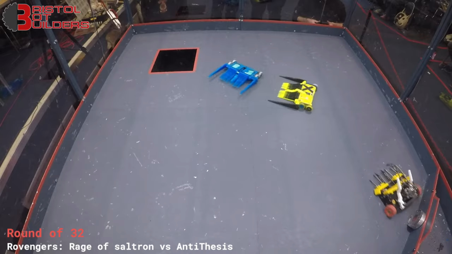

Next up was antithesis
another crusher so we went back to the top armour and we swapped to our guard-less side forks which was fun due to all the bent bolts from endboss and speeny
we did this so it would be harder for us to get stuck and easier to drive off forks our tactics were to overwhelm antithesis with constant attacks and try to keep it flipped over
this initally went great i managed to grab with the lifter and parade it around the arena antithesis was able to get some pinches but not into anything critical, felt like it was pretty even so far even if we nearly had a friendly fire
until
sadly simon binned it leaving me in a 1v1 even with antithesis dropping a wheel jeb is a great driver and got a good push and got me down with 20 seconds left. although honestly we would of been obliterated by scratch so probably for the best
being out we decided to get in on a whiteboard i upped my drive power to 70% and we fitted magnets to test them out and my god were they so much nicer to the drive and actually had pushing power. the lifters also did something being able to flip over kelper
although they did get some nice shots on blue. sir lance a frog was also able to get some good lifts on blue and keep us separated however the pushing power was really shown here
yellow was able to shove 2 and a bit beetles across the arena which for a cluster we felt was pretty cool so 100% be running magnets next time
despite simon breaking out his party trick we were able to win the fight pretty convincingly, even if trying to get sir lance a frog down the pit at the end was a bit tricky. 70% was just a hair too fast for me to control easily haha
overall we were very happy with how these robots turned out. the lifters although not massively effective gave them allot more character and versatility being able to self right or grab/lift our opponents so will be keeping them for future
in terms of changed we will be keeping the magnets but we need more protection around the rear of the robot so we adjusted the cad for some initial changed
this change also gives us a bit more room for wires as we found they were pretty squashed at the back
as well as beef up the wheels to 17.5mm wide vs the 10 currently so hopefully make it harder to land hits on the drive belts and to allow for more durable rubber.
this does mean thinning the wheel gaurds a little but we arent too concerned as although they began to fail on blue by the end of the day it had seen allot of spinner hits
we are also thinking to add some CF rods in the sides to stiffen them up to allow the belts to grip better as currently the reat wheels really dont feel like they grip very well at all. this may also be solved by going to a stiffer tpu to print the pulleys out of or just making the distance between the two wheels longer to tighten up the belts
electronically we will be keeping them nearly identical. maybe look at going to a catalyst receiver escs combo as well as the repeat besc for a bit more power from the higher voltage as yellows lifter did feel very sad after going back down to 5v vs 6v
in terms of there set-ups i think we will be trying to use the long fork config more as it did give us a great control edge in the rumble but this needs to be tested in a 1v1, the baleen we will 100% be keeping for robots with longer forks or drums but the long forks did work really nicely to high side our opponents. finally we will also be looking into setting up a switch to let us go between grab mode and flip mode as holding the lifter open during combat seems pretty annoying
overall we could not be more happy with them! hopefully there next event will be april dojo for a proper shake-down of the magnets and other small tweaks
