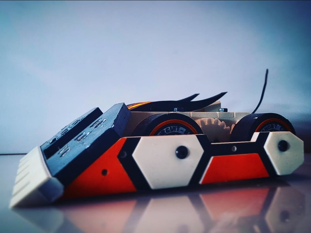

Hello everyone. I totally did not forget that this forum exists and that I’ve signed up for it a while ago.
I thought I’d share some pictures of my bot Ryu-Kishin. That bot that showed up to the beetlechamps in 2022 that got knocked out by Icebreaker in round 1 and didn’t redeem itself against a very boring bot.
This one
After the champs I wanted to rebuild the entire thing.
I learned what worked and what didn’t in that version. I started by designing the thing in fusion and printed out some hollow parts to get a feel for the dimentions of the thing.
I quite liked it but it had to be modified a bit.
What really did work on the old version were the 10mm hdpe site pieces. The old ones were made by Cosmin but this time I went to a local makerspace to have them milled
I took the internals of the old one that were still in working order and just threw them into the new one
At the champs I was in a whiteboard rumble with a lot of other lifter bots. one of thos was a bot that I refuse to pronounce the right way… it was abracacrabrara or something along those lines. They managed to get their lifter right between my wheels and lifted me up so I couldn’t do anything for the majority of the rumble. to combat that I decided to ad a little tpu piece between the wheels on the new bot.
Also the lifting arms were made from scratch to help the bot selfrighting. (the whites being the new ones)
the rest of the build went smoothly. I entered into one of our german MMM events and it somehow made it to second place only loosing its final fight.
I’m quite happy with how it turned out but I’m still working on improvements. Next thing I want to try out is running the weapon with timing belts instead of that ugly looking arm there.
Thanks for the attention.
See you next time

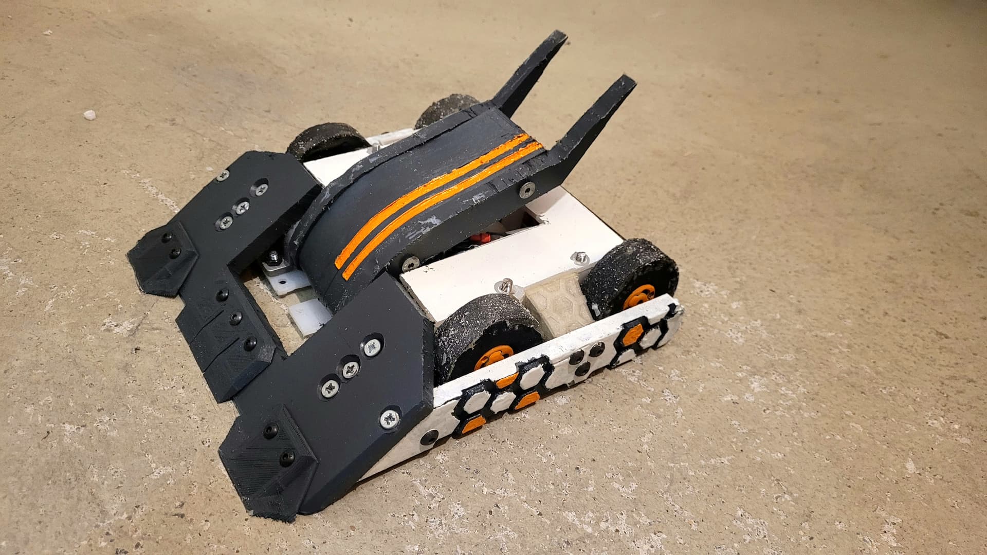

The overall design hasn’t changed much since last time I posted but I continued working on the bot. Did I mention that I wanted to operate the weapon with belts? Yeah… I tried that and it failed. I bought some pulleys for the servo and printed a belt as I couldn’t find the right size for a reasonable price. All the belt did was slipping and the powertransmission didn’t really work out.
So I went back to the old and proven HDPE linkage between servo and arm. A new servohorn made sure I had the full range of motion I always wanted.
I also added a steel lip to the hdpe wedge to make the wedge work more as a wedge than all the other wedges I wedged on the wedge before. wedge.
I used the same material to also ad a single fork (because of weight reasons)
I gave the wheels some attention as well plus I freshly painted the chassis and entered the thing into MadMetalMachines vol. 31 last weekend.
It performed quite well there, bringing home yet another trophy. But this time one that I didn’t get before
I want to do rapture at some point and I feel like this version should perform way better than V1 back in '22. There are some more changes I’ve planed for this one but I’ll see if that improved the bot or if it makes it worse.

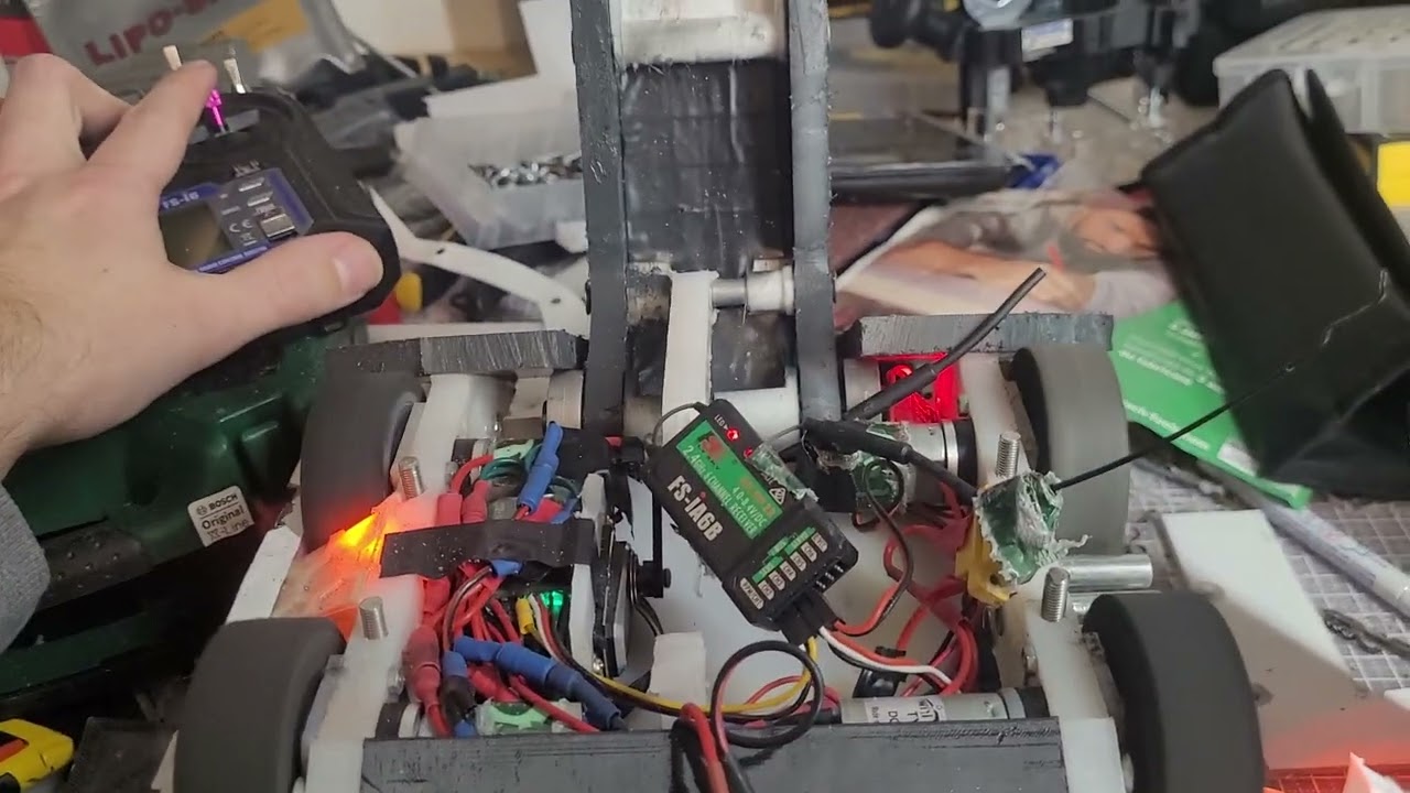

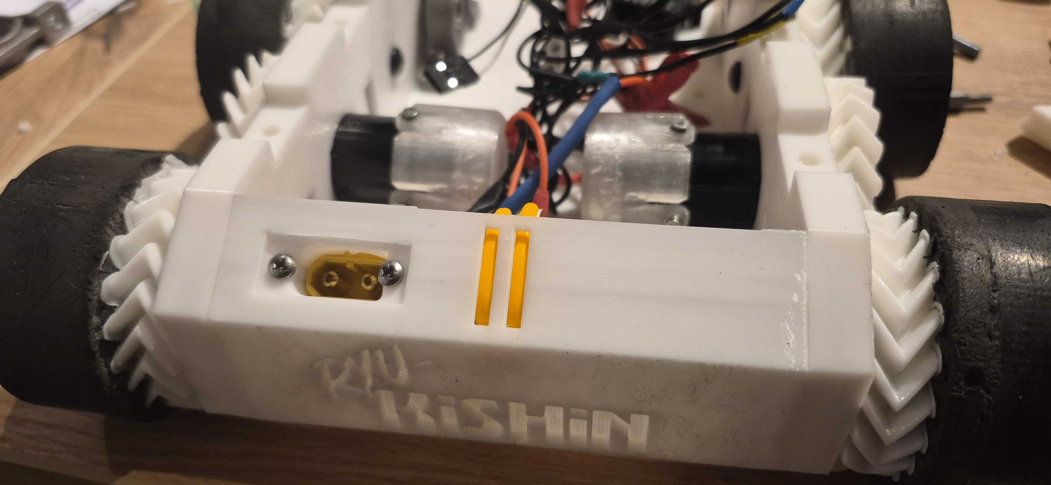

Today I started up the bot for the first time since the event and I found out that the bot is having an esc issue.
I had the very same usdue with the other dual esc I used before the event and just switched it out for the spare one I had. Now both have the same Problem:
Does anyone know what causes the sudden direction change? It happens by driving forward and backwards.
Hey Jonas,
This is possibly caused by motor noise - see the store page near the bottom with the bit about fix for noisy motors and adding capacitors.
I’ve just given @Gareth a poke in case it’s anything else instead :slight_smile:
Yes, looks like interference. Caps on the motor work great, separating signal and power cables can help too. The further they run alongside each other the more interference the signal wire will pick up. Not always possible on a combat robot I admit…
That actually did the trick!

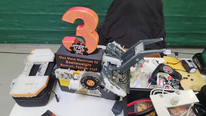

I took the bot to MadMetalMachines vol.33 last weekend. It didn’t perform as good as it did in the past. Got a bye in round 1, a close win to an undercutter in round 2, had to forfeit a fight in round 2 due to a loose solder joint that I discovered right when I was loding in the bot for round 3, a loss to a hammersaw and another close win against a vert. I ended up somewhere in the middle of the field. Got some serious traction problems on the still rather new steel floor. But I got to fight babrog in a whiteboard Fight and got to meet Killian Murphy in a big rumble. Meeting Eoin again after 6 years was definitely a highlight. Last time was at buggle 2.
I basically just changed the visuals on the bot but I think this version is now retired. Got some plans for the next version that doesn’t necessarily involve brushes.

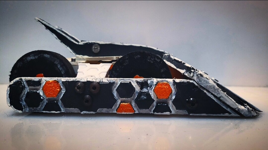

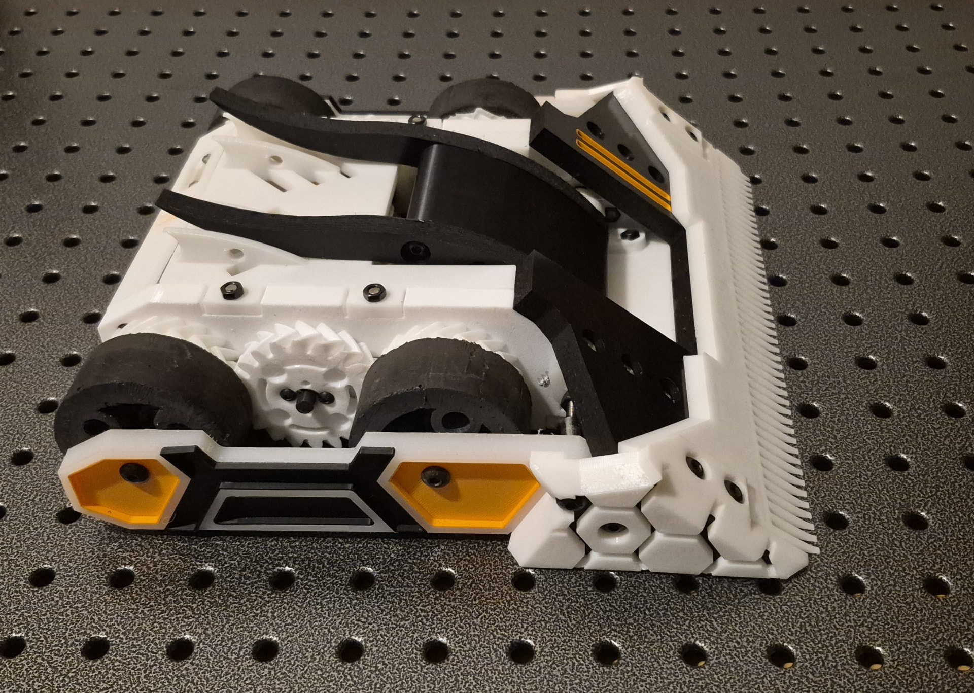

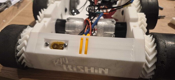

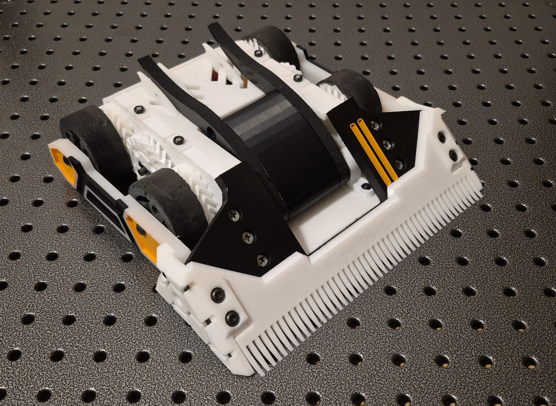

That took some time. After the event in April I was dedicated to build a new version. Brushless drive and better grip on the wheels were the main goals. I’m sure I could’ve easily still used brushed drive motors but I wanted to cut some weight.

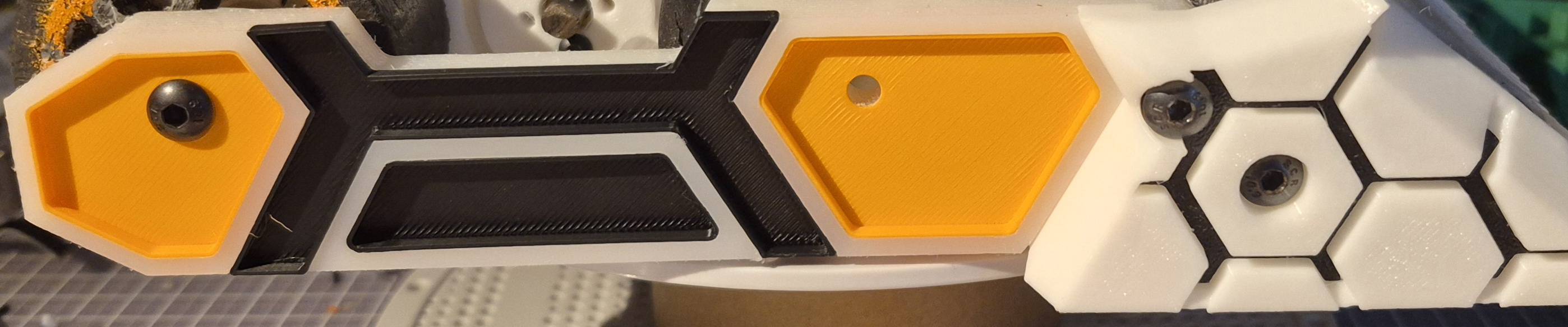

I’ve build the entire bot from scratch. It now uses 3d printed gears, a milled wedge and custom wheels. The lights are back in the lifting arm as it makes it stand out a bit. It’s still very close to the weightlimit but it should pass.
I like the way the little guy looks like and we will find out how it’s gonna perform next month. I’m not aiming for any trophies but I hope it finally gets to do what it’s meant to do: control. Hopefully no more sliding around as if I was driving on ice. Fingers crossed :crossed_fingers:

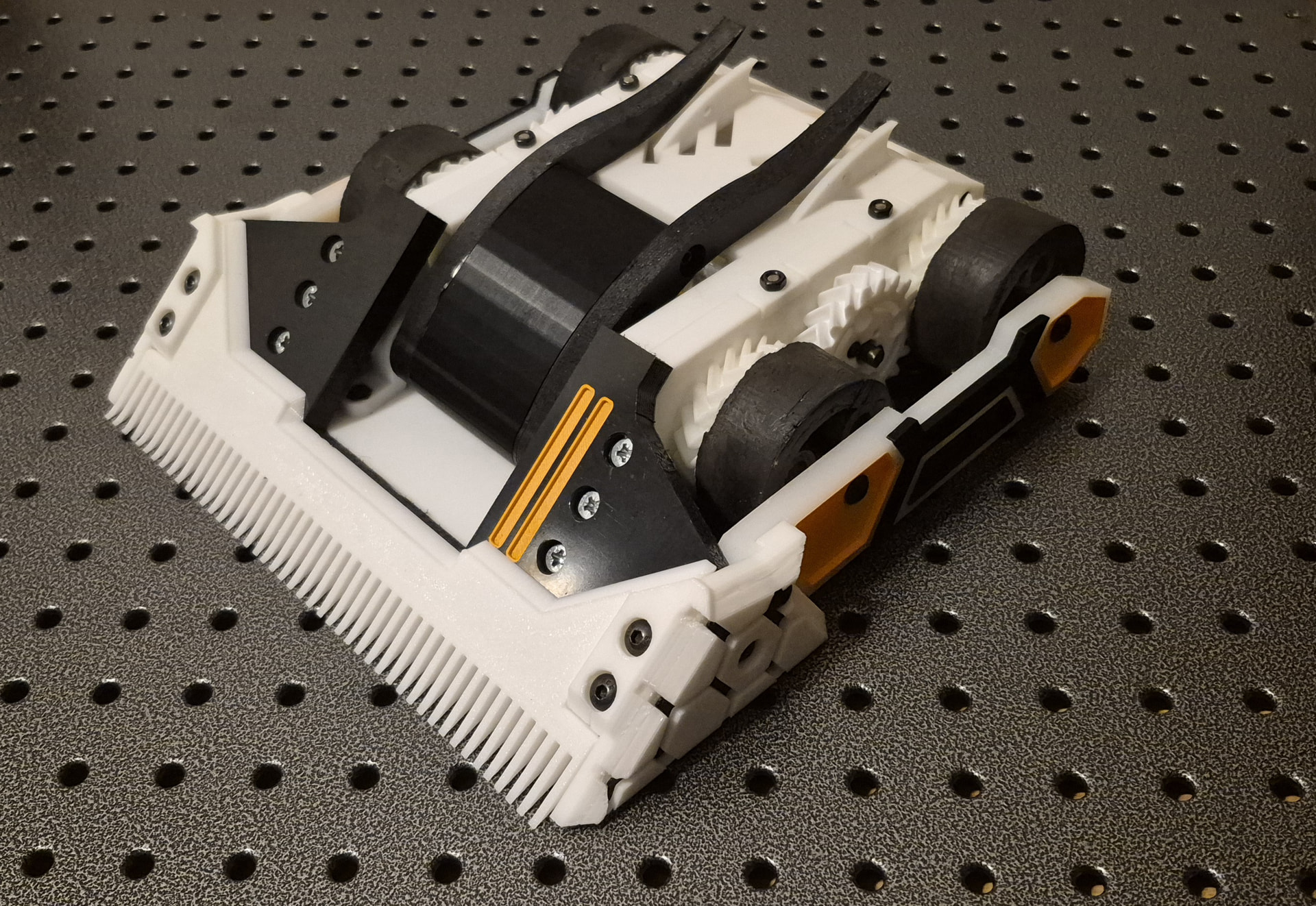

I started this builders Blog after the champs in 2022 and here we go for the 2026 comb.
I hope it performs better than it dud in the past but we will find out.

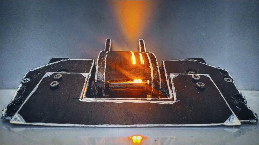

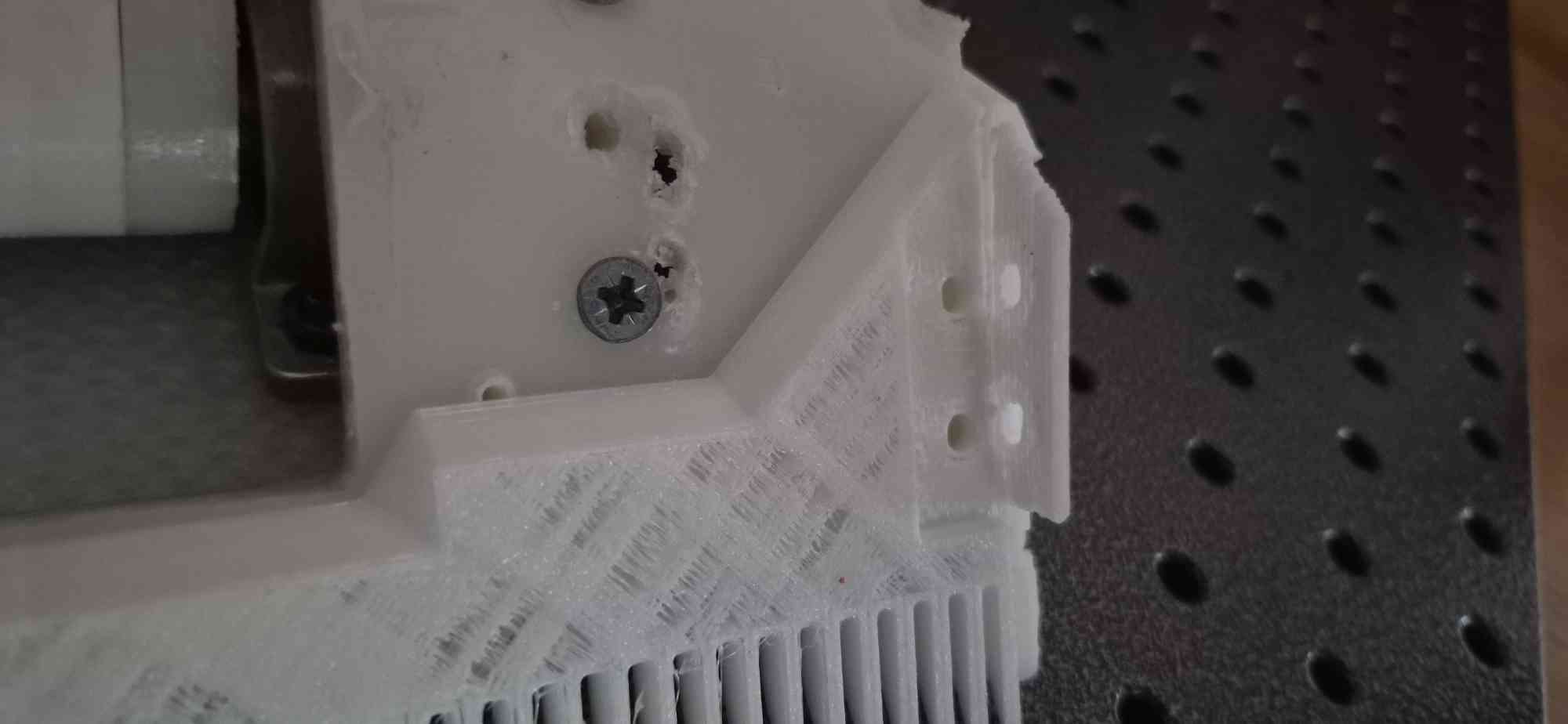

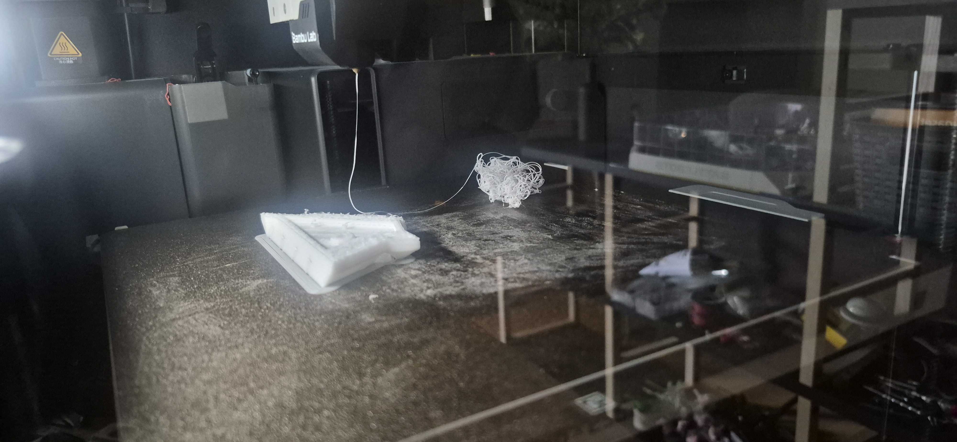

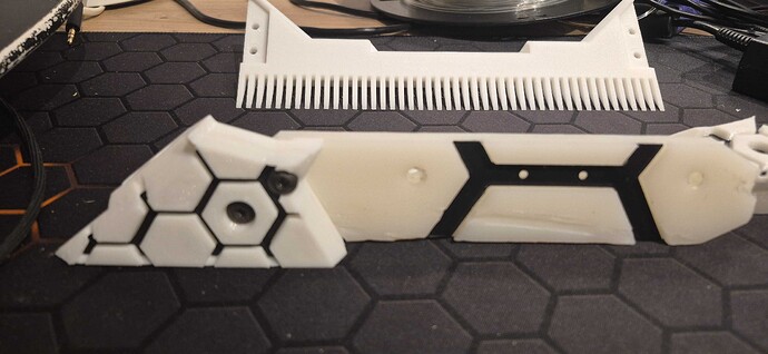

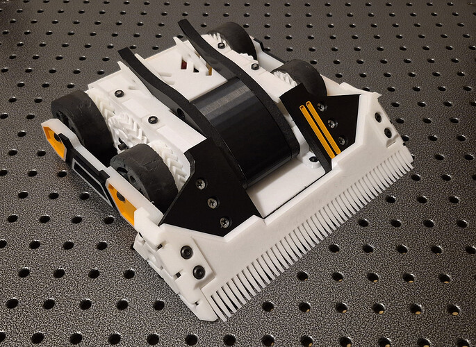

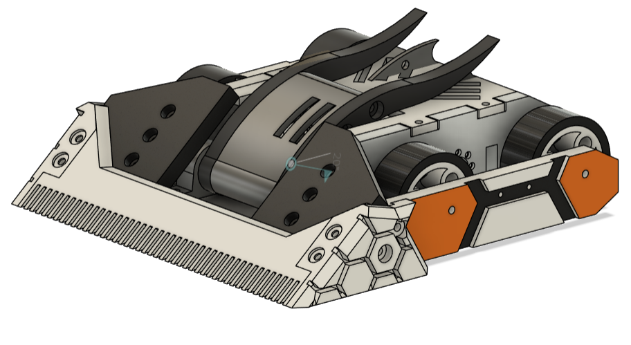

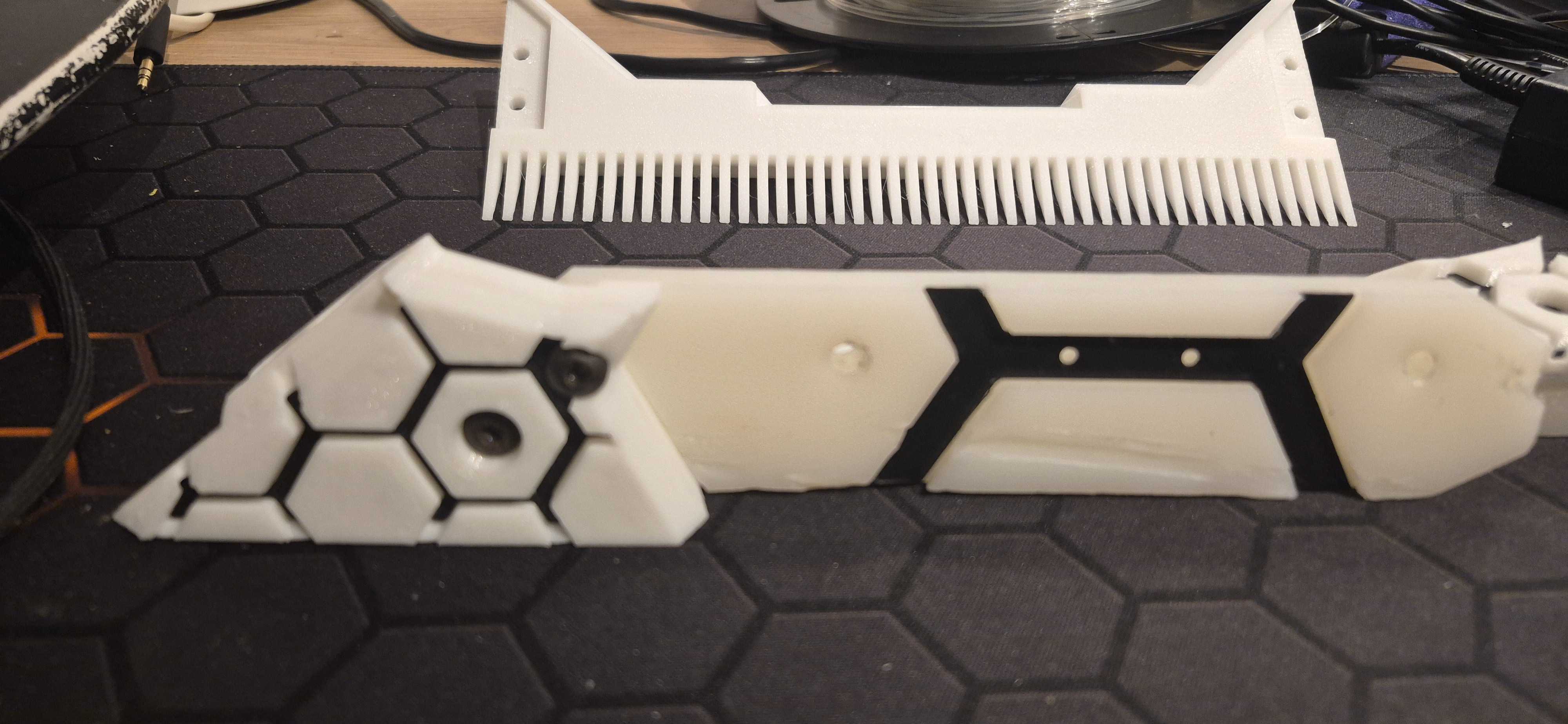

Improvements started with the CAD. I didn’t have too much time to design the Bot from scratch but I’ve made some changes. Notably the front. It’s using a hdpe wedge with a tbu comb so I get the resilience and flexibility of both.
Printing was a bit of a pain in the butt even after drying the TPU for a day. But it eventually worked out.

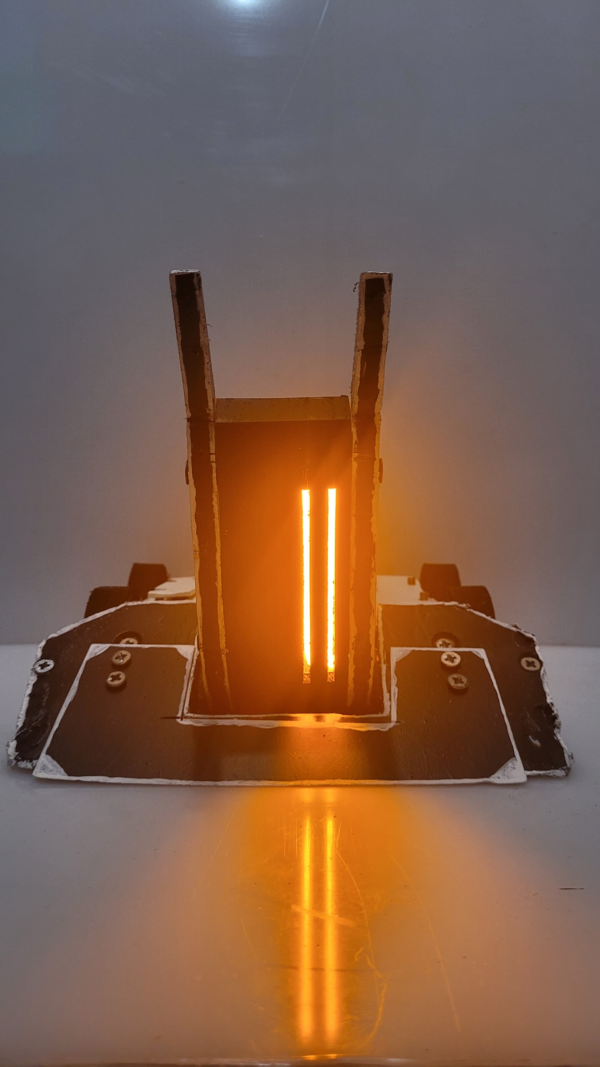

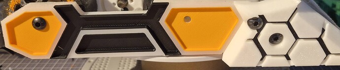

I changed the position of the light to not have the powers signal run into a spinner.
Don’t hit that. Please.
I ran into some weight issues. So I had to mill, cut and solder some stuff but we’re looking good I think. I also had to solve the issue of the bot not selfrighting anymore but I managed to figure it out with some help.
Huge shout outs to Ioan, Craig, Nick and all the others that helped me during the process.
And here we go:
