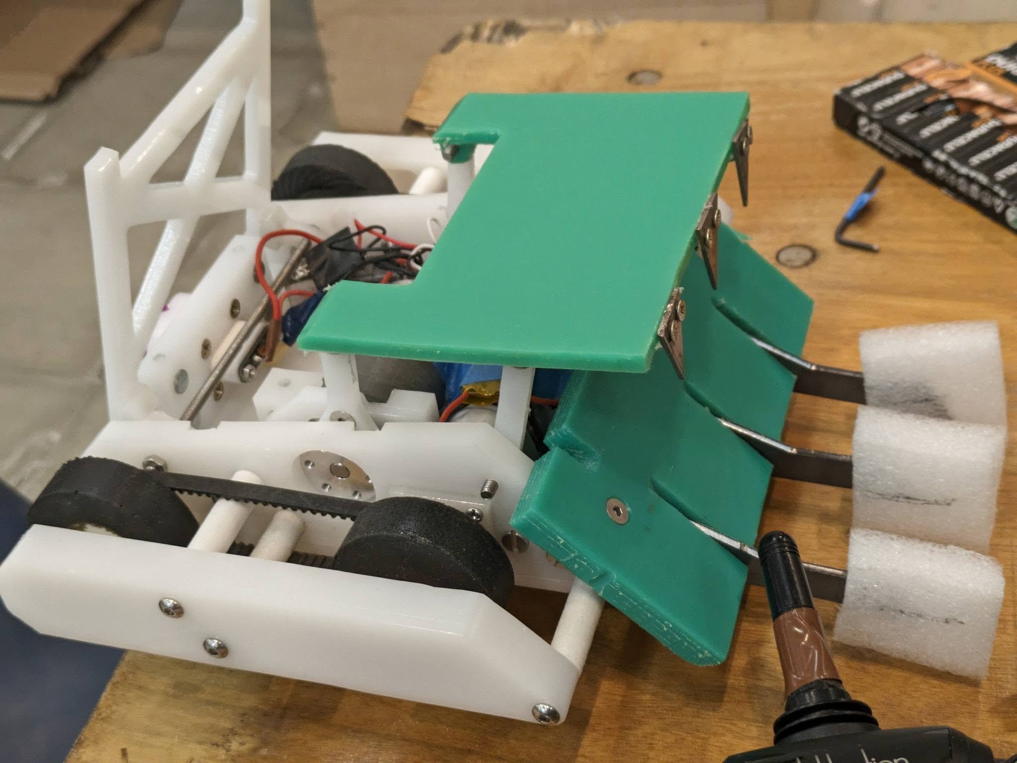

The old servo never necessarily failed, but that was mainly because it was never actually used, and I still have major doubts as to its effectiveness. With this in mind, Schnake now uses a 37mm 80rpm 18kg-cm Pololu motor, similar to those used in other grabbers and lifters in the European scene. This allows me to do a few things. First: a motor setup that’s far less likely to self-destruct and far more likely to grab and hold something. Second: I can now use a simple brushed ESC for control, allowing me to move away from the bulky and complicated dual UBEC setup used before. A new much smaller voltage limiter provides power to the receivers. Third: I will now have the motor connected to a separate receiver, which I will control while my dad drives. This alone will allow the weapon to work much more easily in tandem with the rest of the bot, while my dad can fully focus on driving.
The new electionics smushed in. The battery and electronics will swap places, but everything fits in snugly.

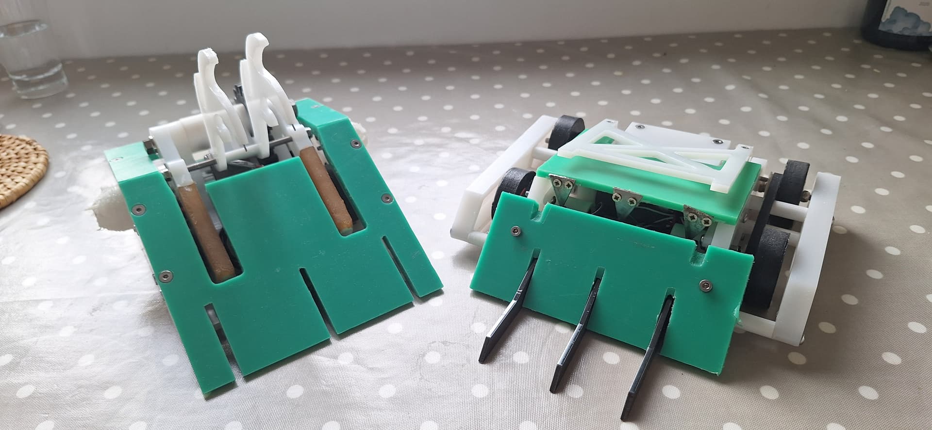

All of these changes have resulted in a nearly total rebuild, with very few parts perfectly carried over (most notably are the grabbing panels, simply because they took a ton of time to make and I’m not doing that again in a hurry). All of this is being written before Schnake V2’s debut at Robot Rebellion 2023, and while a lot of stuff could still go wrong, we are confident that this iteration of the design should perform much much better than before!
Schnake from the back, now with a much cleaner action on the grabber.
Schnake from the side with its new, more aggressive side profile.
Schnake and Babróg, ready to take on the best of the UK!

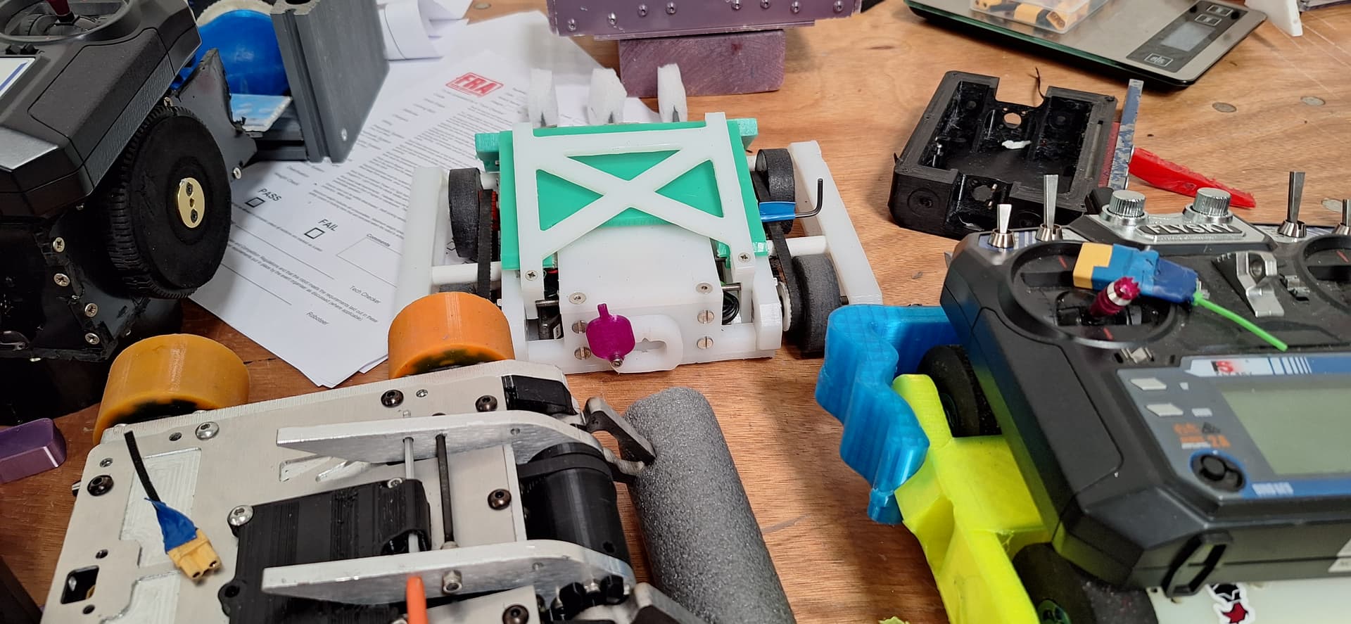

And so, in record time, the new Schnake went from CAD to reality in record time for me, around 5 weeks (or roughly 11 “Ellis’s”). The robot seemed to drive far better than both previous iterations (I was now running the new BBB brushless drive ESC’s), and the self-righter, as gammy as it was at points, seemed to genuinely work! The bot maintained the dual control system, where my dad drove and I operated the weapon, and we were feeling fairly motivated flying over to Robot Rebellion to see just how much of an improvement this design would be.
Schnake V3 in a ready state! Unfortunately I have a bad habit of not taking as many “in progress” pics with the Schnake family due to them not being my main bot, as well as the speed at which they tend to come together.
