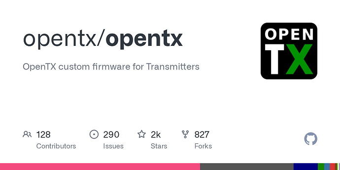

looks like there may have been an attempt to put OpenTX on the FS i6
May need some digging to see if it’s actaully doable.
There is another alternative FW for the FS i6, ERFly6
https://www.rcgroups.com/forums/showthread.php?3961635-ER9X-for-FS-I6-and-FS-I6X-(ERFly6)
