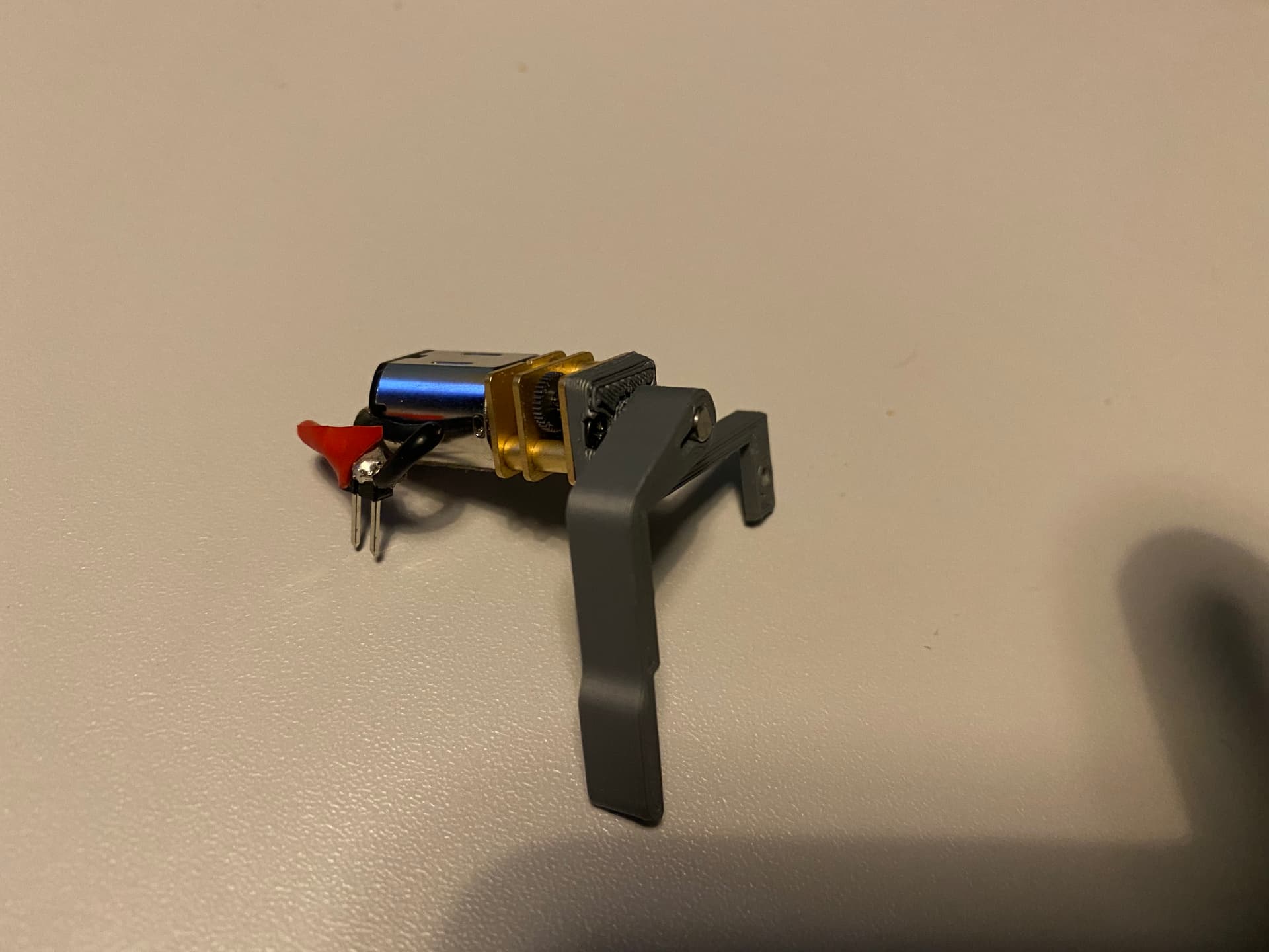

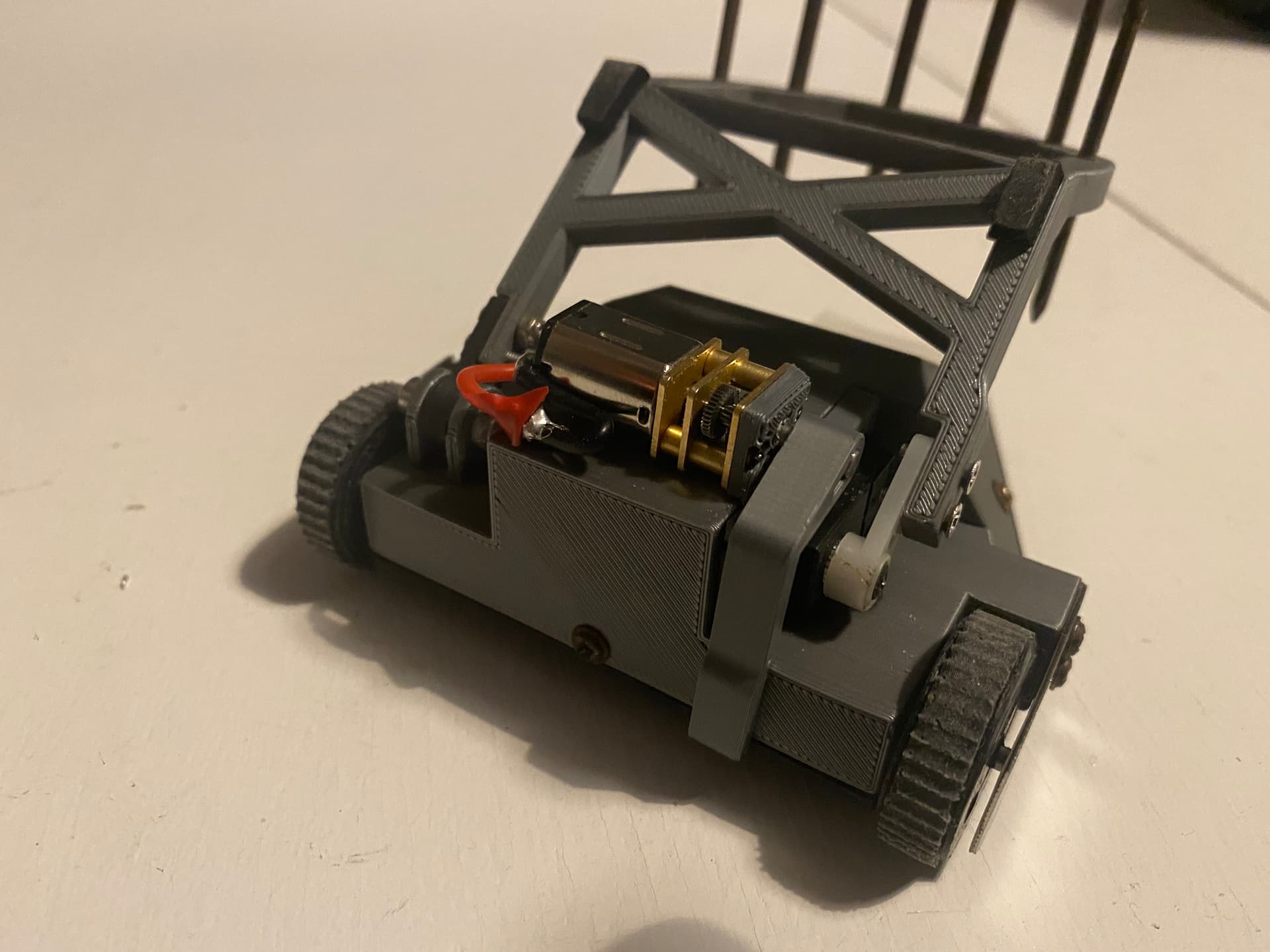

An N20 with an arm attached to it can do in a pinch, if you design it right you can keep the weight down a lot.

What rpm n10 n20 motor do I use and do you maybe know where to get it? Like what motor is the one on your photo Liam?

I’m using a Pololu HP 6V 250:1 120RPM micro gearmotor. Basically a N20 with a lot of torque (so much that it can break itself if you stall it too long/often).

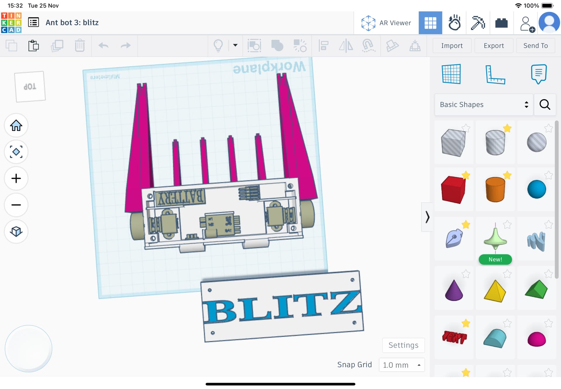

Ok I have finished designing (I think)
