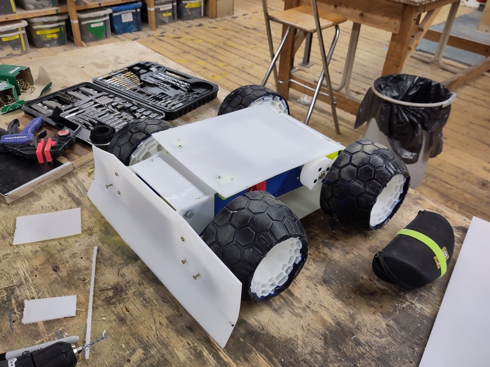

Last weekend I had an INTRUSIVE THOUGHT that I don’t actually have a functioning beetleweight of my very own, and it was the BBB champs signup shortly, and maybe that the latter was a timely occasion to rectify the former? So the intrusive thought became jsut a regular ol’ thought, and I figured I could make a simple, fun to drive beetle based on the Hobbyweight I made for Dojo (and have never written anythihng about ever), which is essentially a big tonka toy-come-moonbuggy thing:
This was lots fo fun to drive, for the 30 seconds or so before it threw its drive belts.

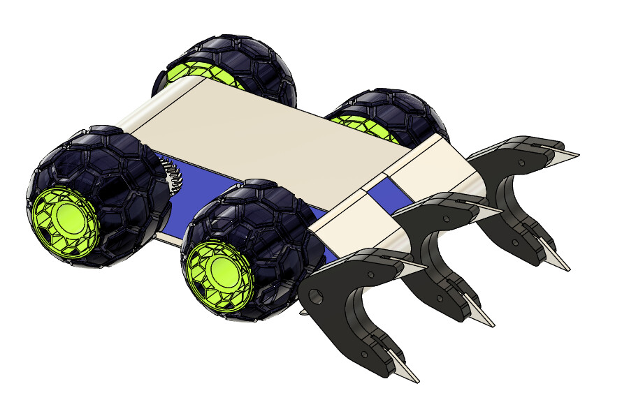

After a few hours of CAD tinkering I have this:

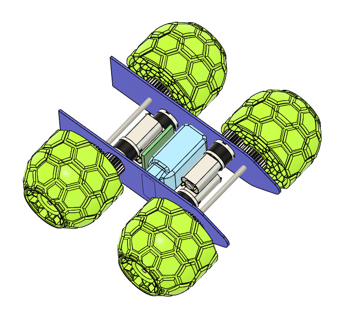

Drive is all classic BRUSHED, with a slight reduction (something c. 2:3) as the 80mm wheels might be a bit much otherwise. The insides will be quite sparse:
If I have time, inclination and available mass, there may be a small vertical drum on the front as well, but the current baseline is jsut a selection of wedges, dozer blades, forks, etc.
