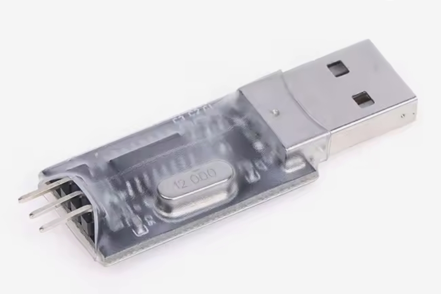

i’m guessing i need something like this?

Yeah you’ll need a usb link, I’m stuck between blheli32 (oldschool) and AM32 so I can’t give you an exact product recommendation. I’m pretty sure you can use an arduino in place which, if you have one hanging around is probably worthwhile.
