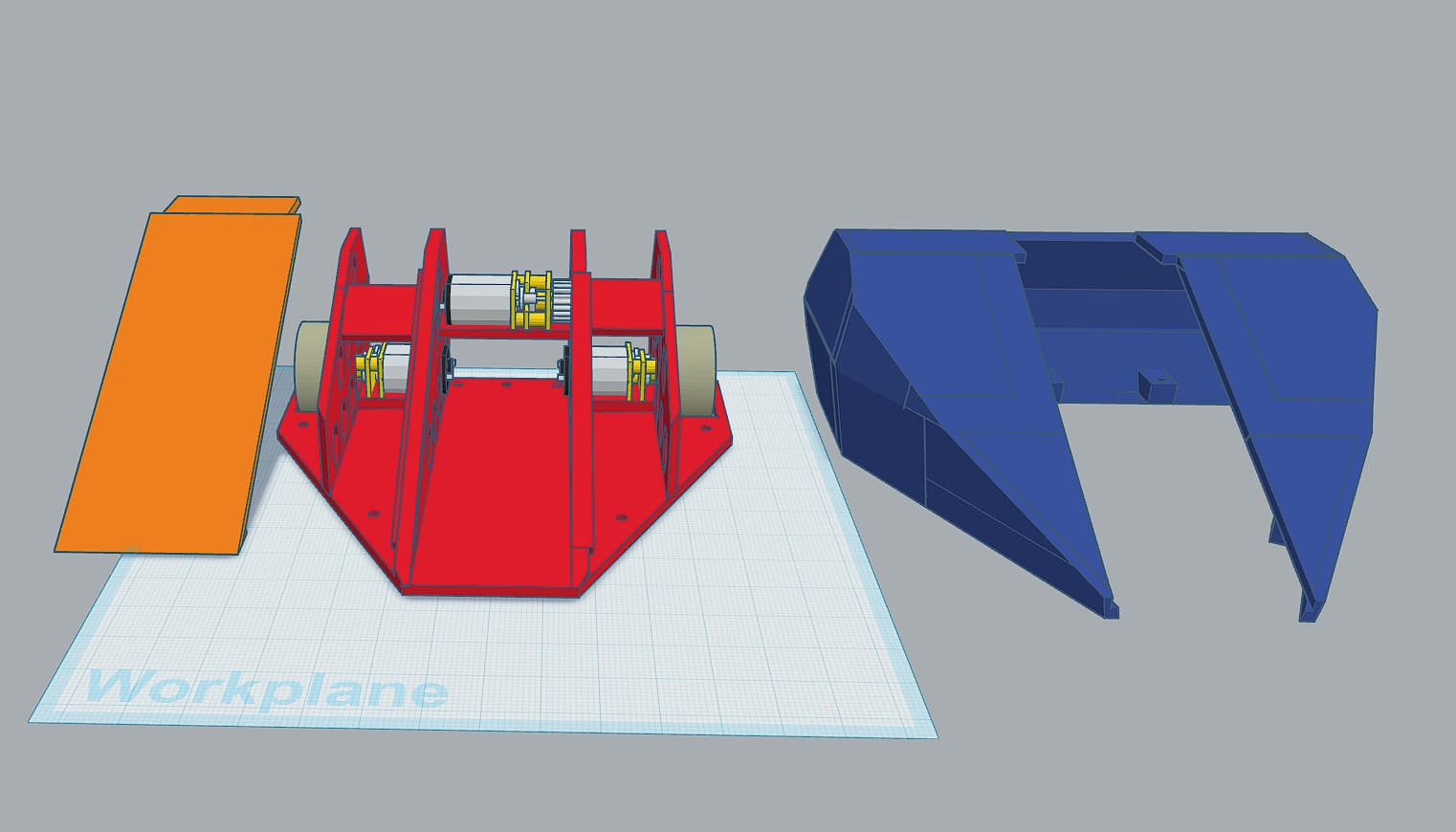

So this is the design iv been working on for a few days, its still got a ways to go yet, but it certainly has the basics down.
Love the fact you are pushing yourself with a spring flipper on your first build!
general shape of that machine looks great!
Have you come up with any concepts yet for the spring mechanism?
hey @James_Draper so iv been looking and trying a few ideas out, i think i might just try making a simple slip gear mechanism and see how that goes, thank you for postive feed back on the design i really appreciate it

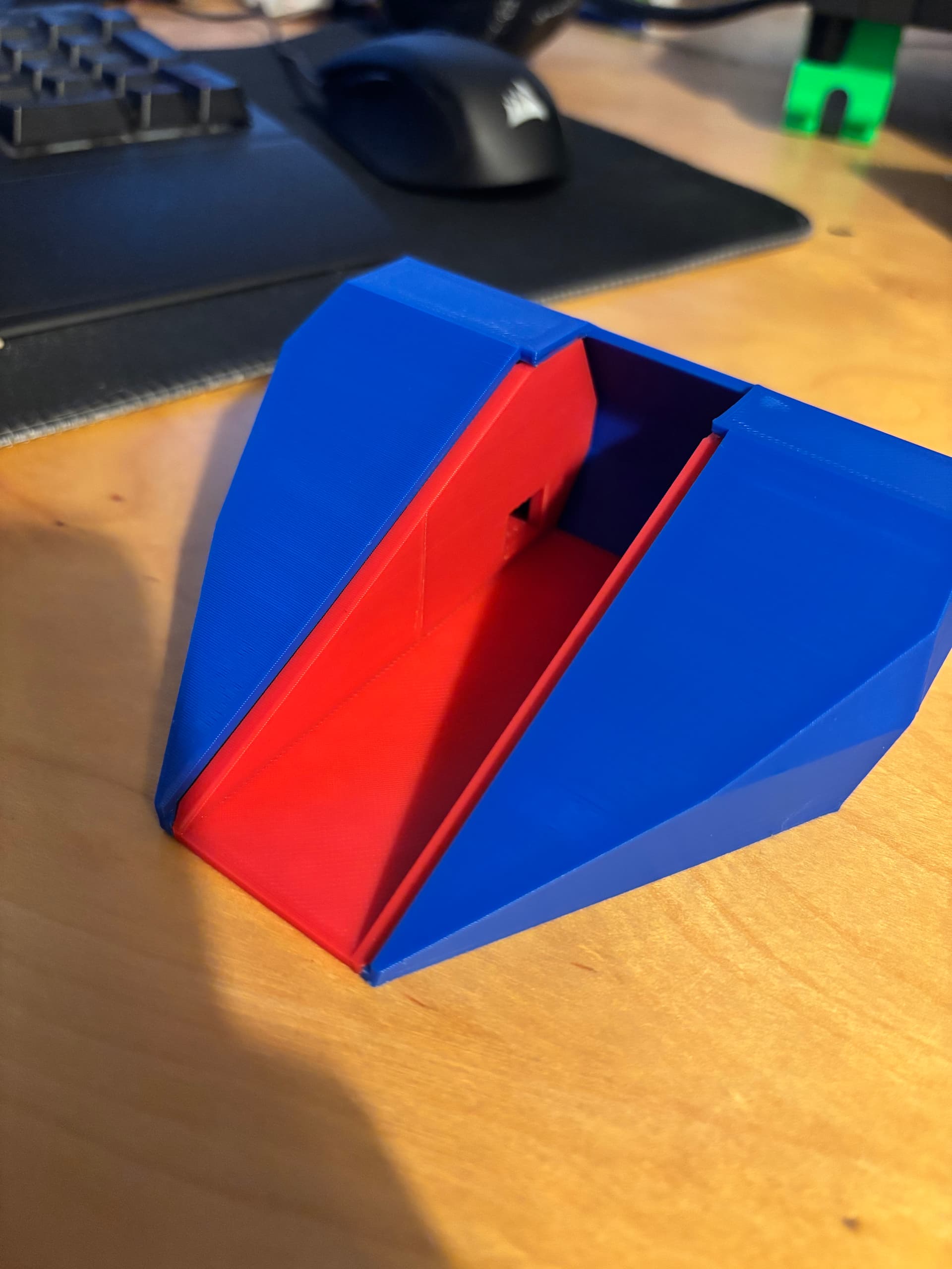

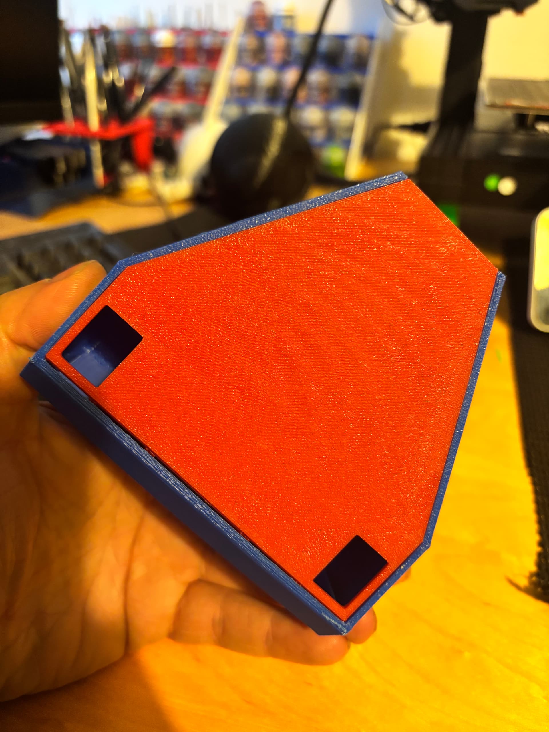

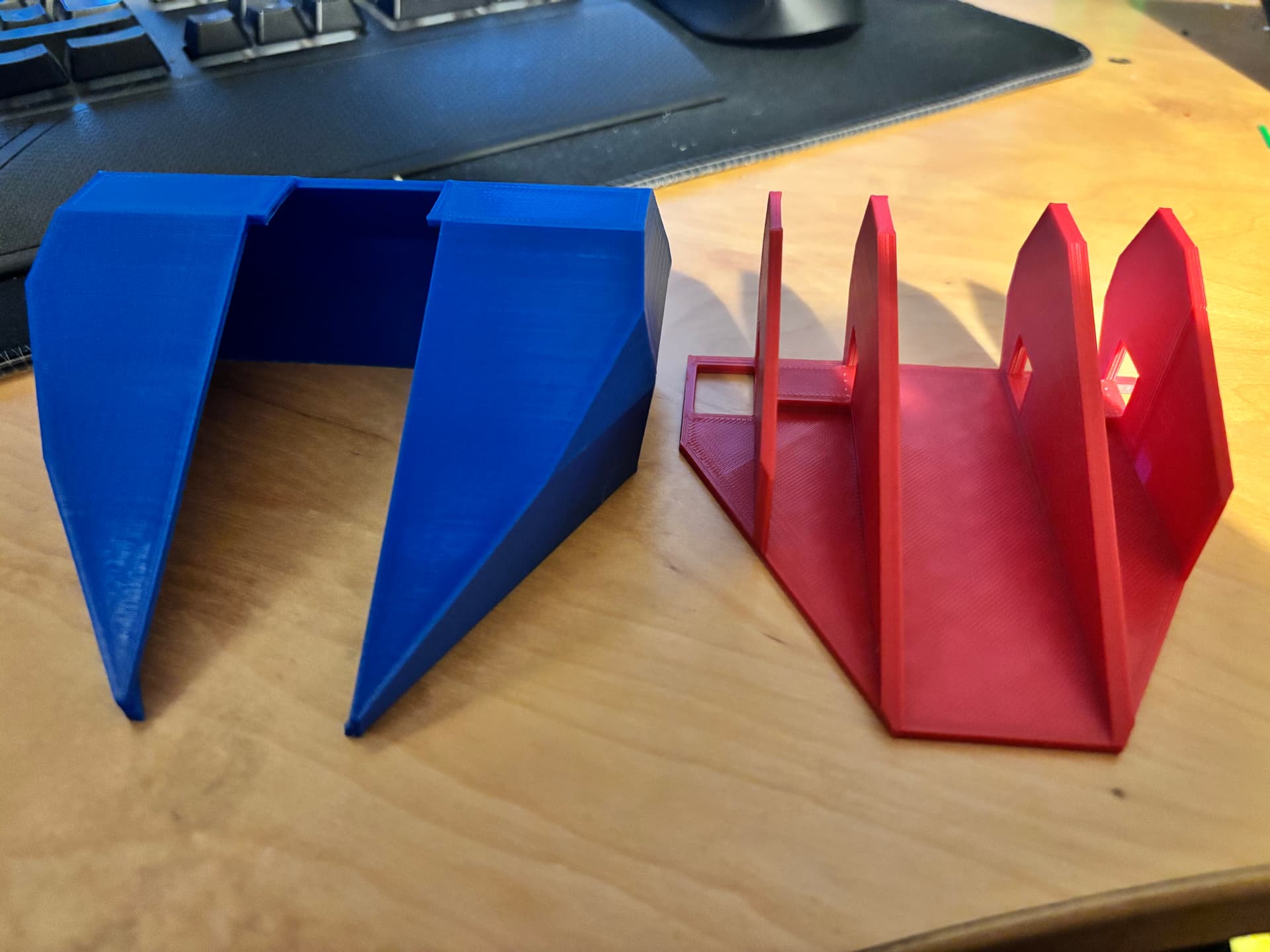

so here is a little update on what i have done so far, so iv printed this in PLA just to test fit it and make sure i got my measurements right, my overall plan was to print the chassis in Nylon, but i have burnt two printer hot ends out trying to do so, so I’m going to risk it and print it in PLA+ and see how this holds up, but for the body I’m going to be printing this in TPU, to try and absobe some of the overall shock being transferred into the chassis.
