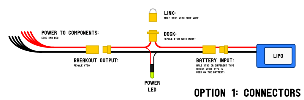

How does a removable link work? It says online that if a spinner hits the link then your bot would just get immobilized.
Thanks
A removable link is just a plug of some description that completes a circuit, in the same way a switch does.
If a spinner hit your switch it would also be immobilised,
Do you have any recommendations of where i could possibly buy one?
It’s just a connector with a wire loop - so at antweight that would typically be a JST and the circuit Harry’s posted above.
But if you’ve used a switch before I’d use it again it’s pretty much the standard.
