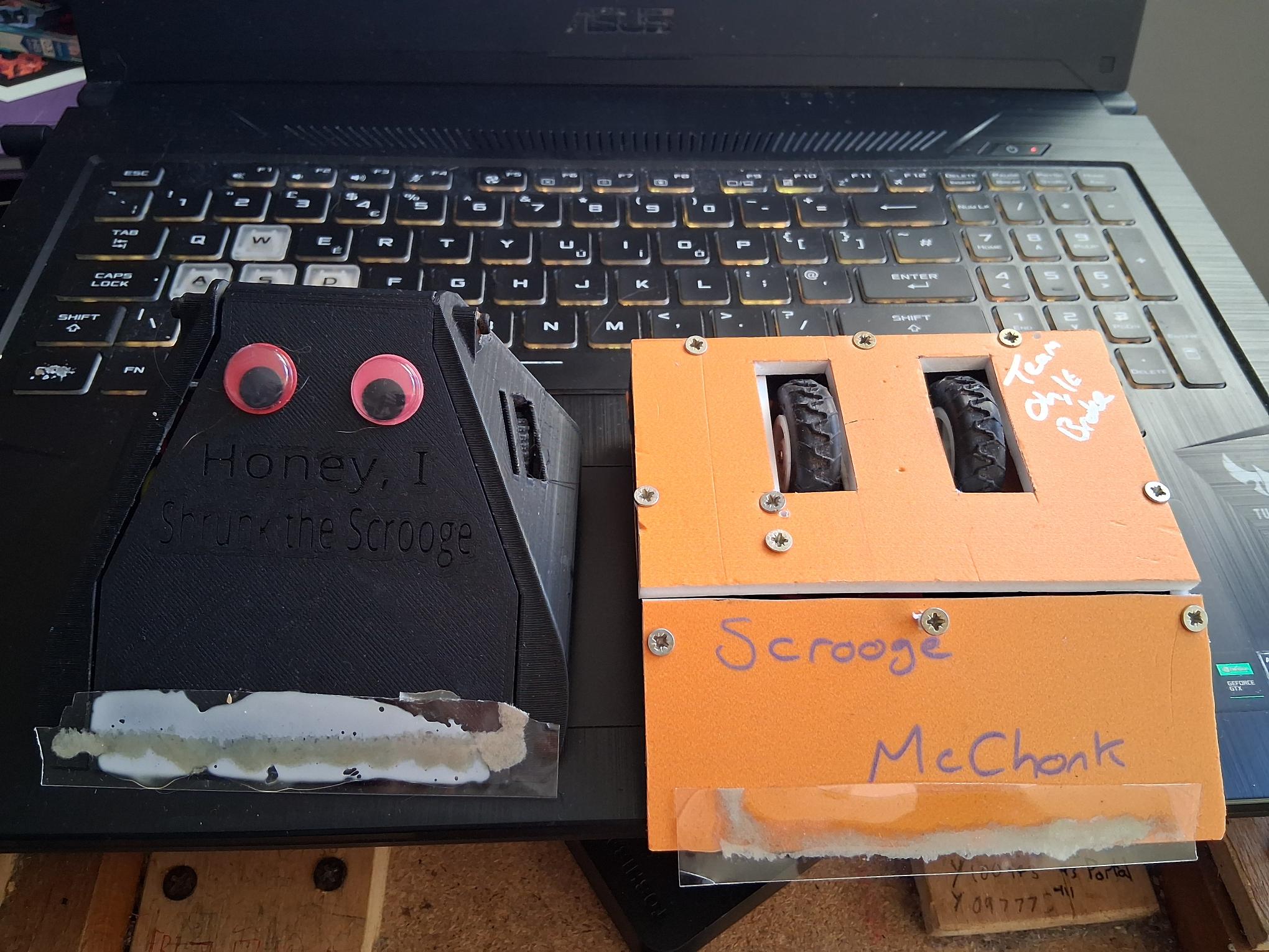

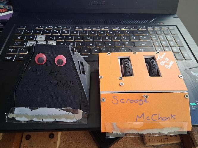

These two - Honey, I Shrunk the Scrooge and Scrooge McChonk, continue the long and noble line that started with Scrooge McDerp (it lost everything it entered, but in fairness it was a tiny RC stunt car from Smyths with aluminium bolted on as a truly horrific wedge that was lop-sided and didn’t touch the ground) and continued with The Revenge of Scrooge McDerp (an equally terrible cluster of 2 similar but different Smyths stunt cars armed with thin aluminium wedges that accidentally beat a vert while being utterly useless) before The Second Coming of The Revenge of Scrooge McDerp… Again came along - check out the Botfest 7 review for that story!
Honey… is a serious robot for serious competition. I need to do a little work to get the flipper to fully retract after its first firing, which I’m unsure how to fix right now, but otherwise it’s a solid robot. I had a friend design/build it and I can’t remember for sure what it’s printed from now, but I think it’s nylon. Either that or it’s some variant on PLA and I will be making many sad noises when it gets obliterated. Time will tell.
Scrooge McChonk was a silly idea I had to rip the motors from a third different Smyths tiny RC stunt car, put 2 wheels from the original Scrooge McDerp on them (they’re lighter than the wheels it comes with, with the same motor attachments) and build a wedge out of a chunk of foamboard I have yet to fully use. The result was an underpowered, close to the weight limit mess. But it’s FUN. I’m mainly using it to see how the armour handles spinners - if it goes well, I’ll use smaller pieces in strategic areas on future builds. I’m assuming it will not go well.

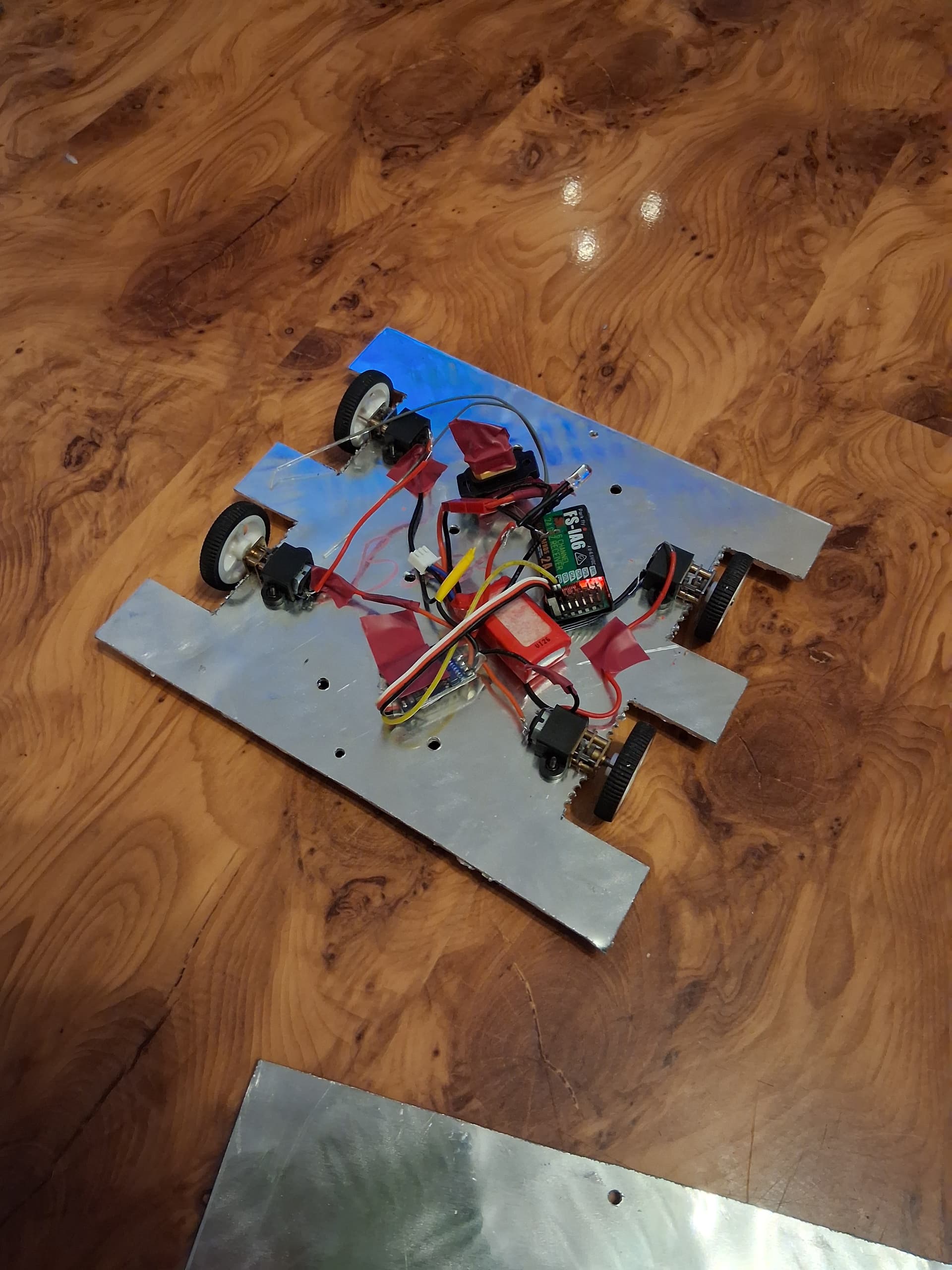

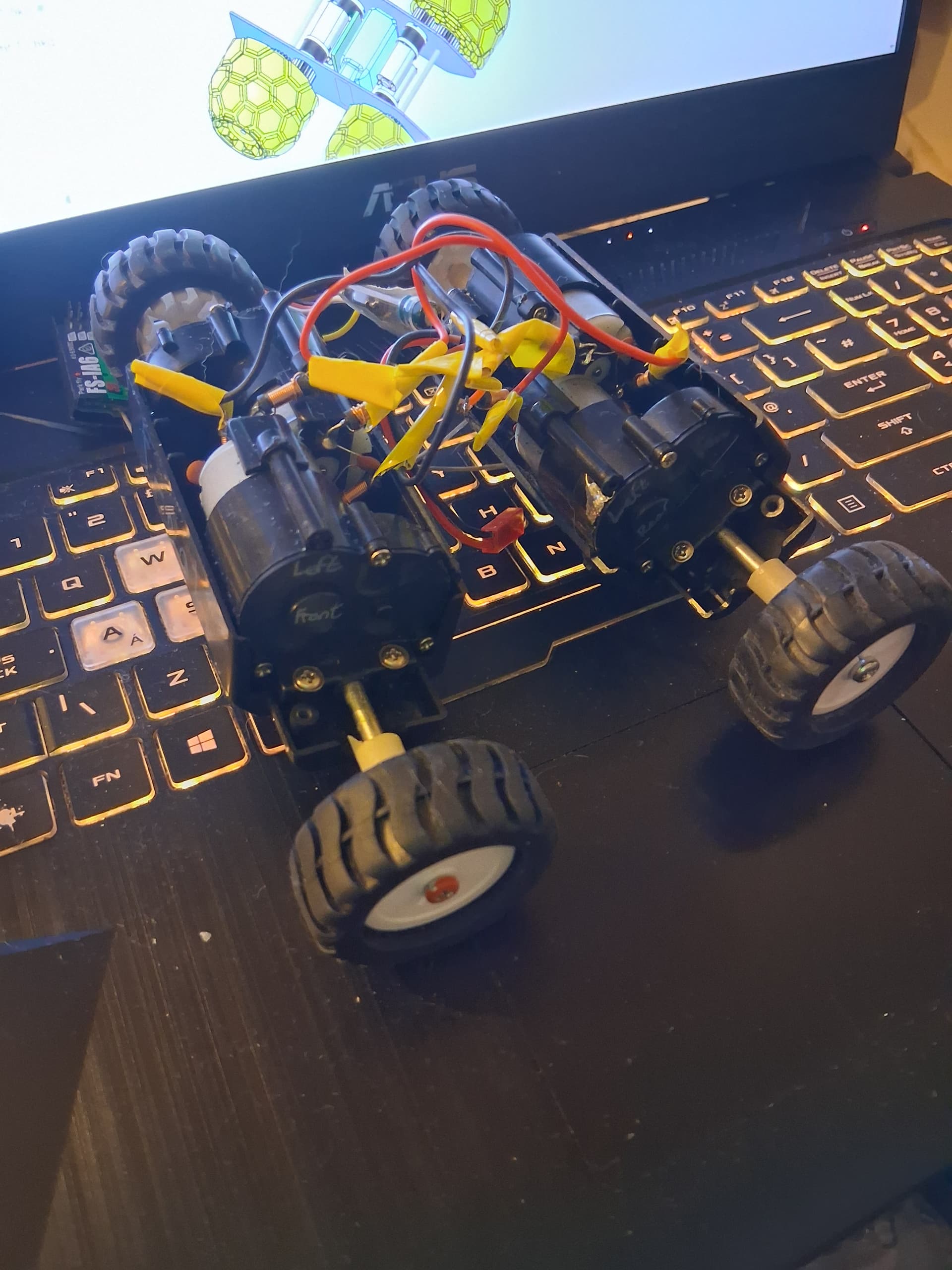

So, because I am an idiot and it’s funny, I’m throwing together my first beetle. It is as yet unnamed, and will be a literal box on wheels. I’m doing this on the cheap, so the only thing I’ve bought for this (ages ago) is the safety gear. The 4WD system is bodged together out of two drivetrains from old RC cars, and the ESC/battery are the same as I’ve been using in my ants. I don’t expect any success, but it’ll be fun to play with something bigger for a change.
The drivetrain:

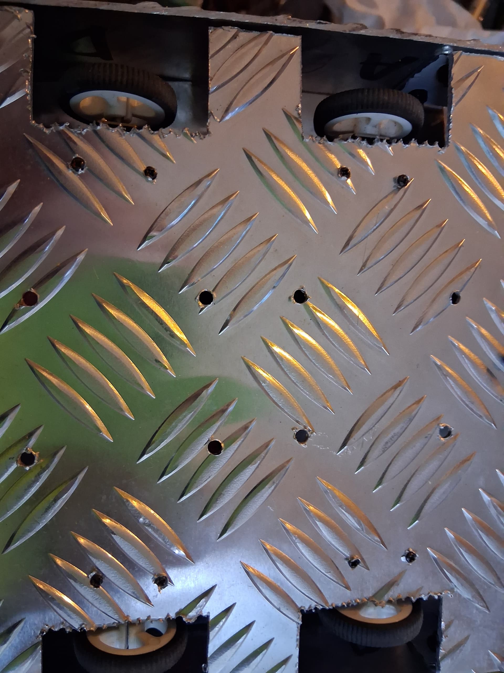

So for those who don’t know, BotFest 8 trialled a sportsman beetle tournament. I, technically, entered a beetle named Y. Which on many levels was a valid question. The drivetrain mentioned above did not see action, largely because I managed to break one of the motors (but also because I ran out of time to cut the chassis, having forgotten to leave space for the motor housing as well as the wheels to protrude, so… yeah, go me). Instead I ran 4 N10s, which helpfully were mismatched. The rears were faster than the fronts, but everything was underpowered. It was an ant internally, with the link and LED wired in. Except the LED was dead weight because on the day it wasn’t working - seemingly having blown during testing. Might need a higher rated light for next time!
Y testing the night before:
Y looking extremely professional from underneath:
Y from above - note this is after the tournament, and the damage is barely visible. Probably not at all in the photo. Death Grip BW barely scratched the aluminium!

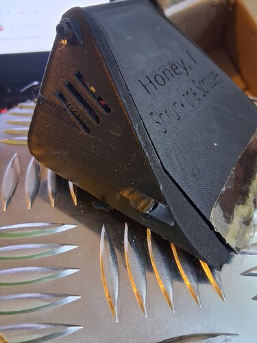

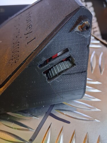

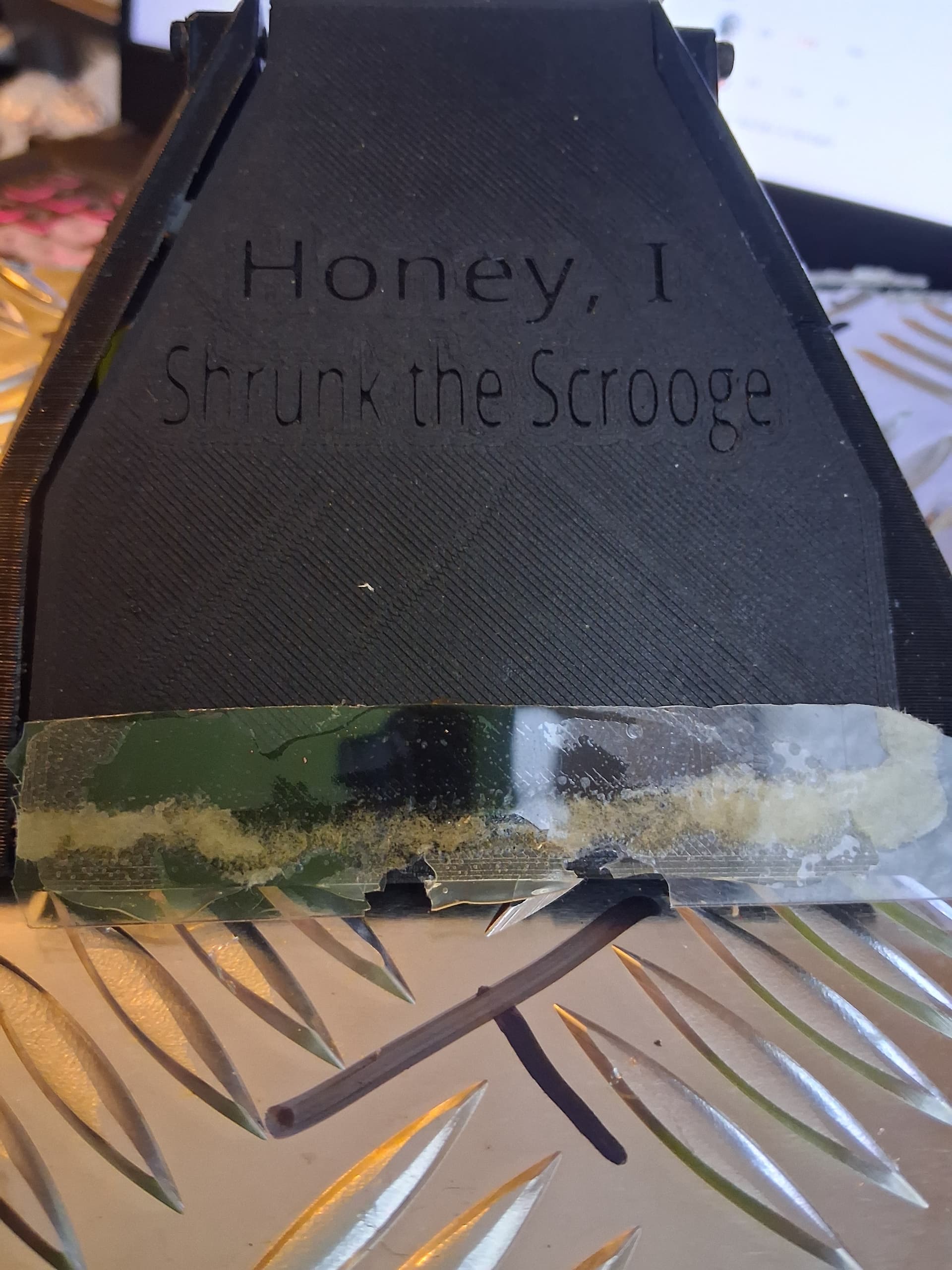

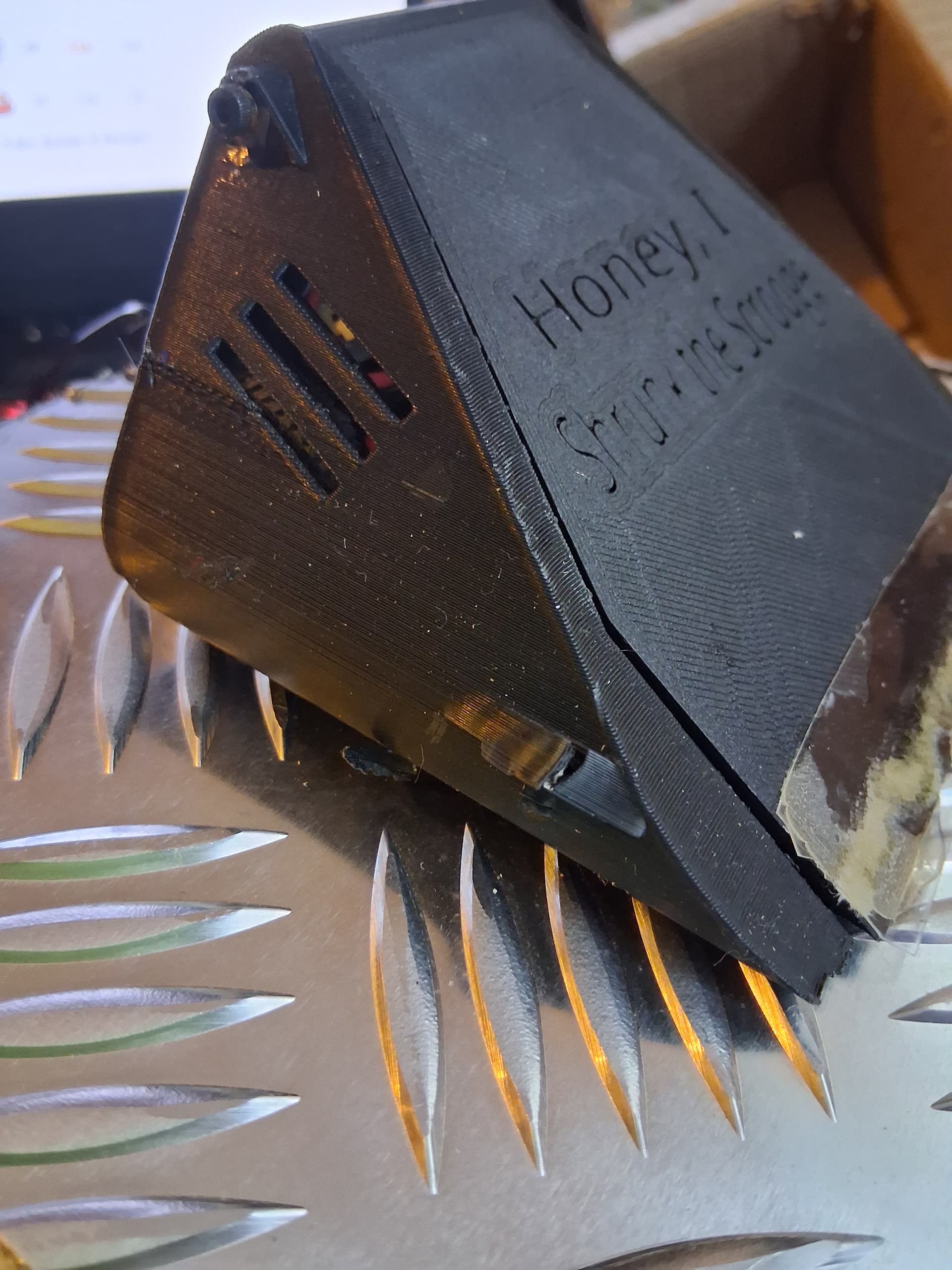

The damage:
Nothing terminal, but looking closer at the chassis I’m wondering if the crack is enough to reduce the flipper power to the point where the srimech didn’t do its thing. Luckily it still worked aggressively, but… yeah. Don’t do crack, guys.

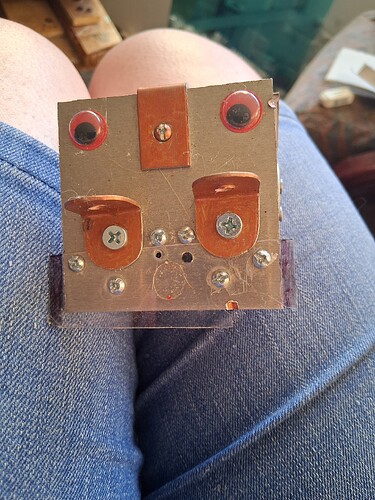

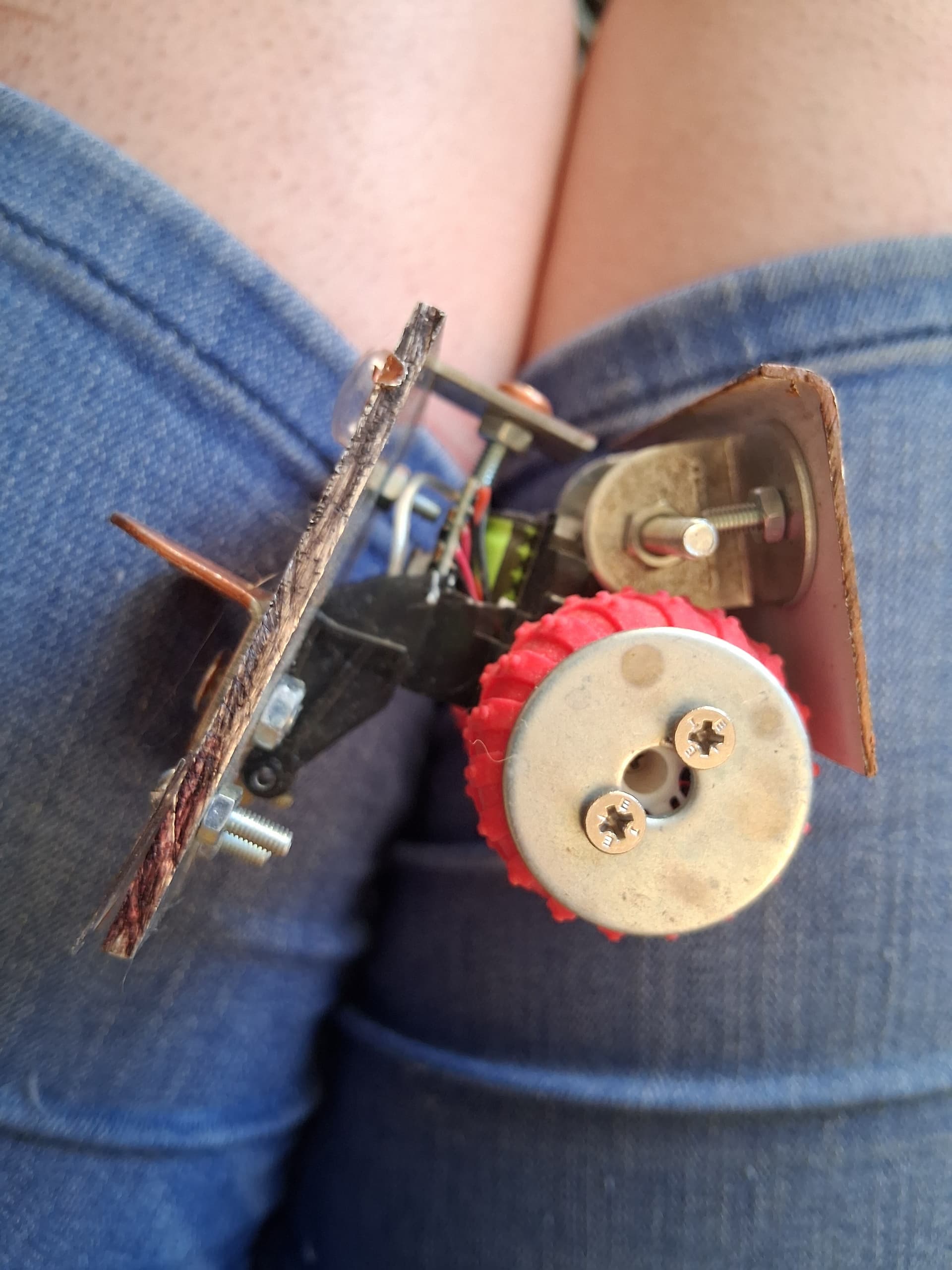

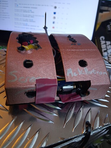

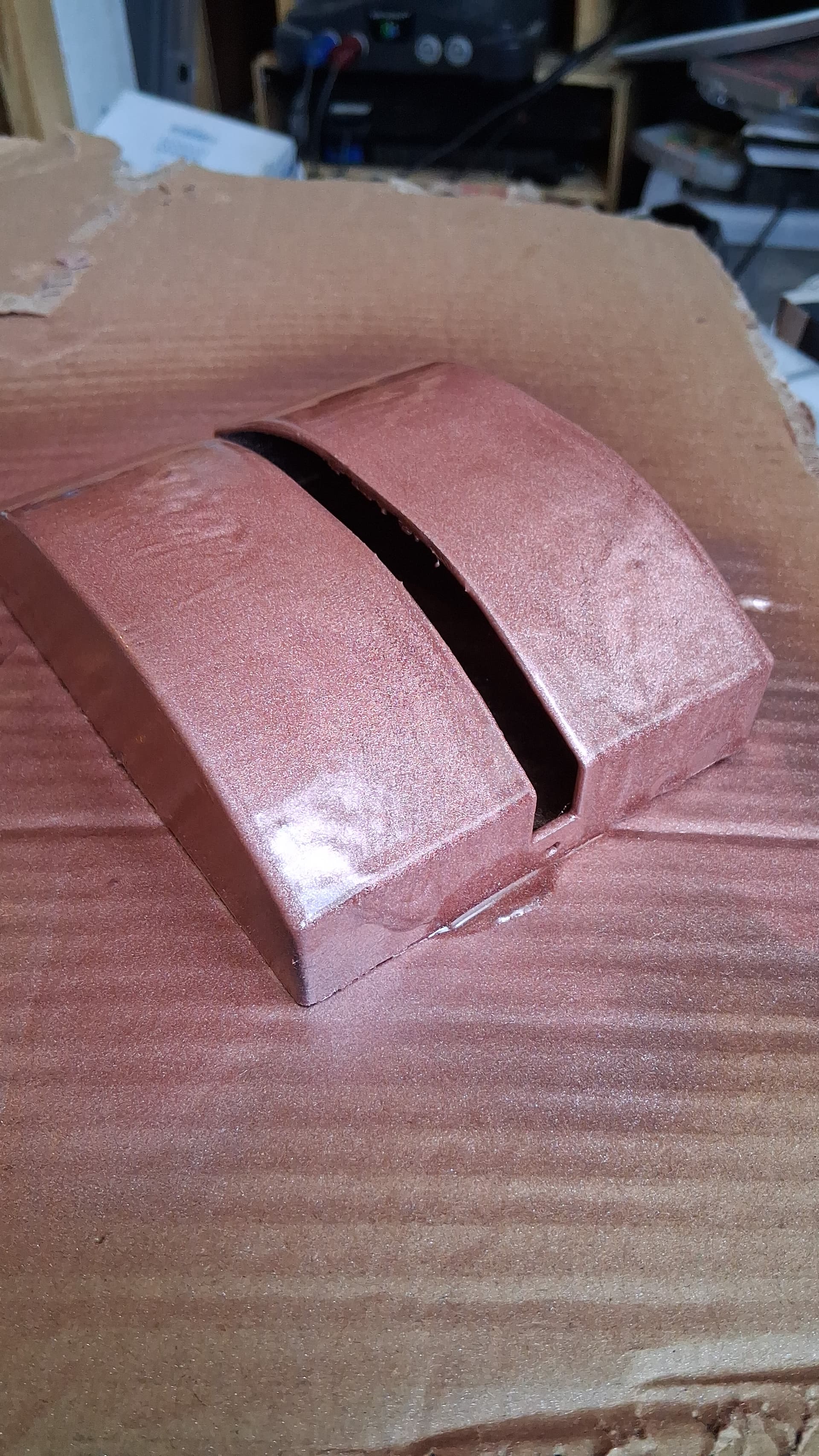

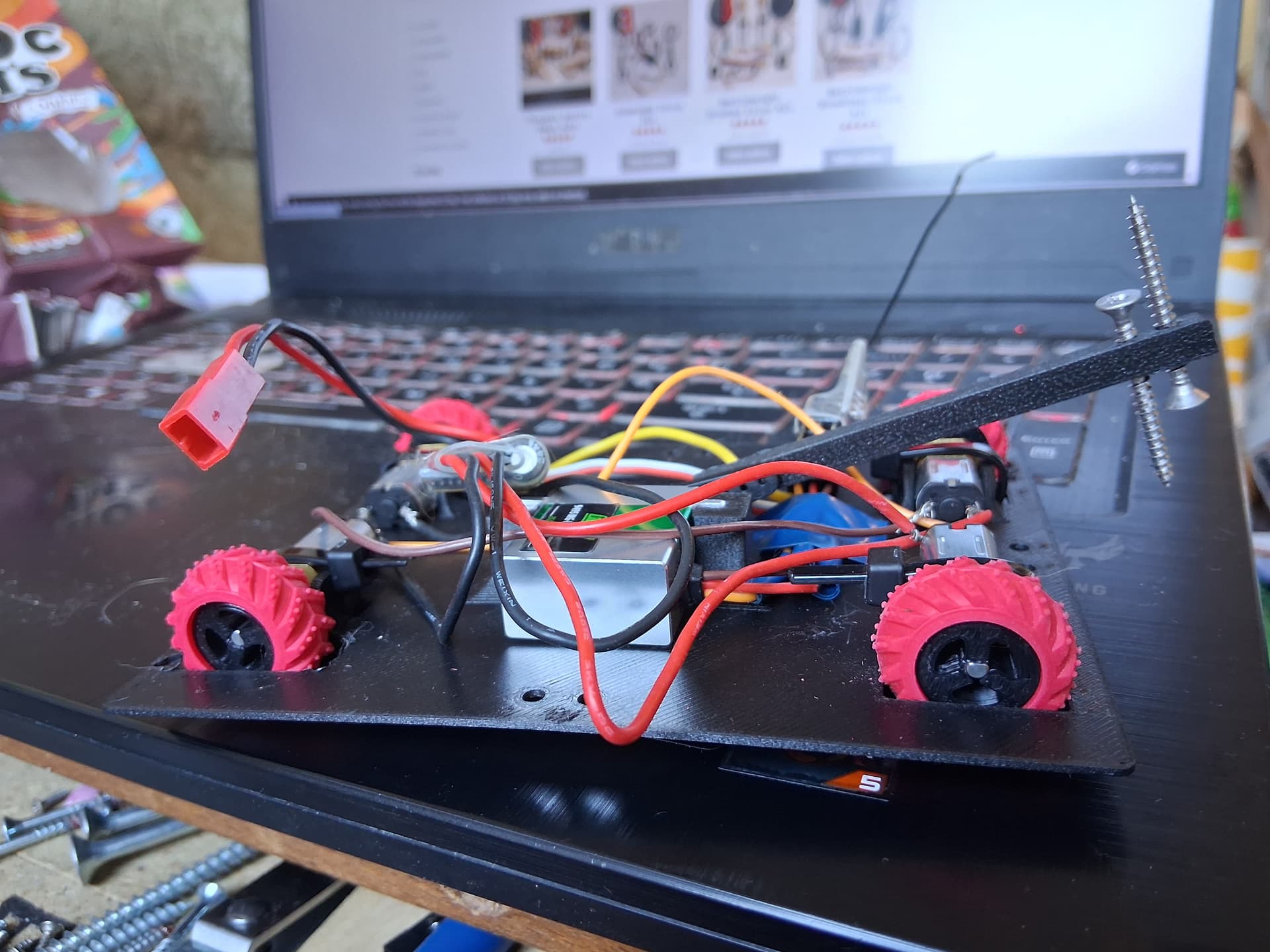

Now, I teased a third robot before, which I was still waiting to receive from Ranglebox at the time. I present to you, Scrooge McKillertron!

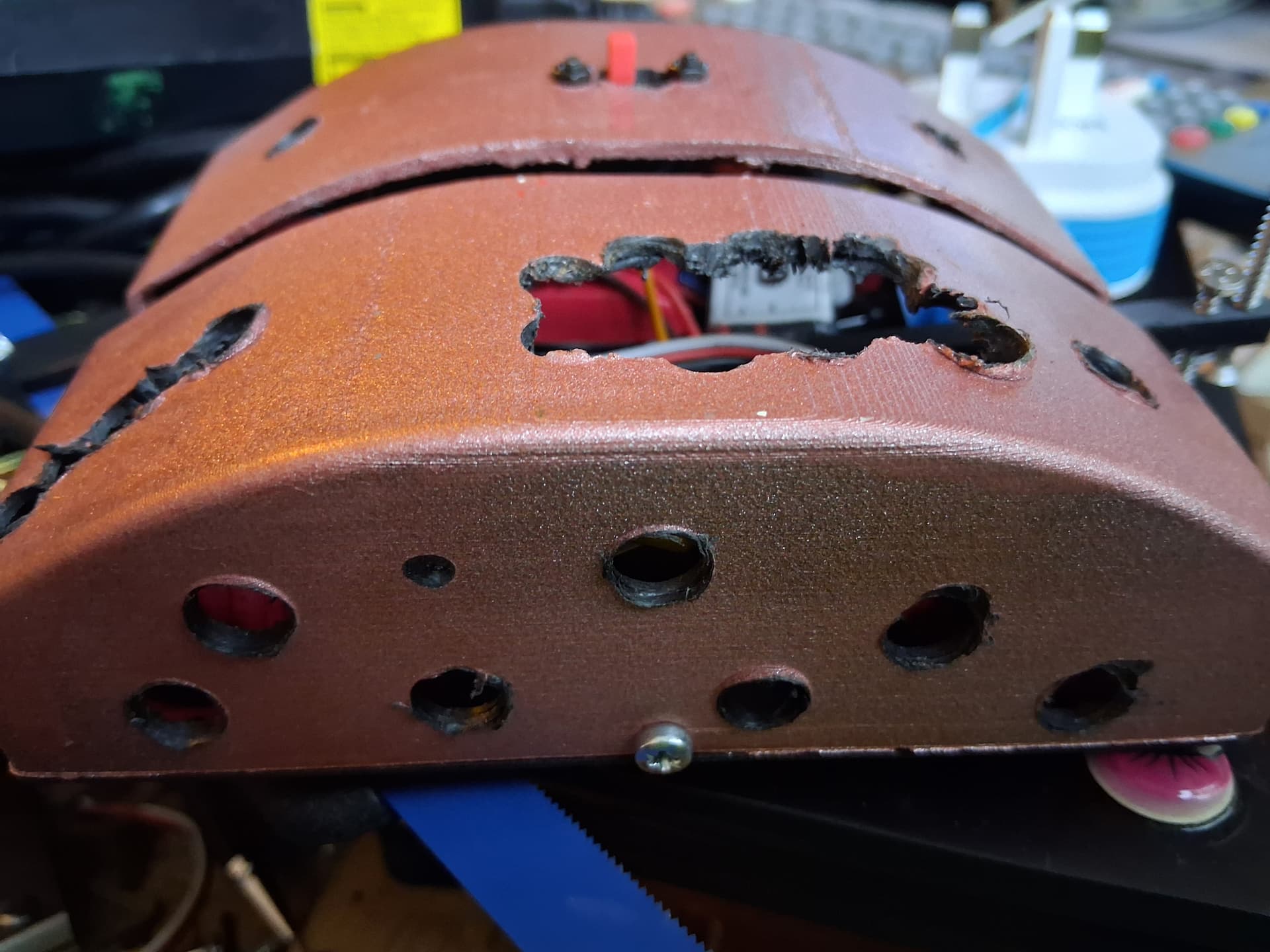

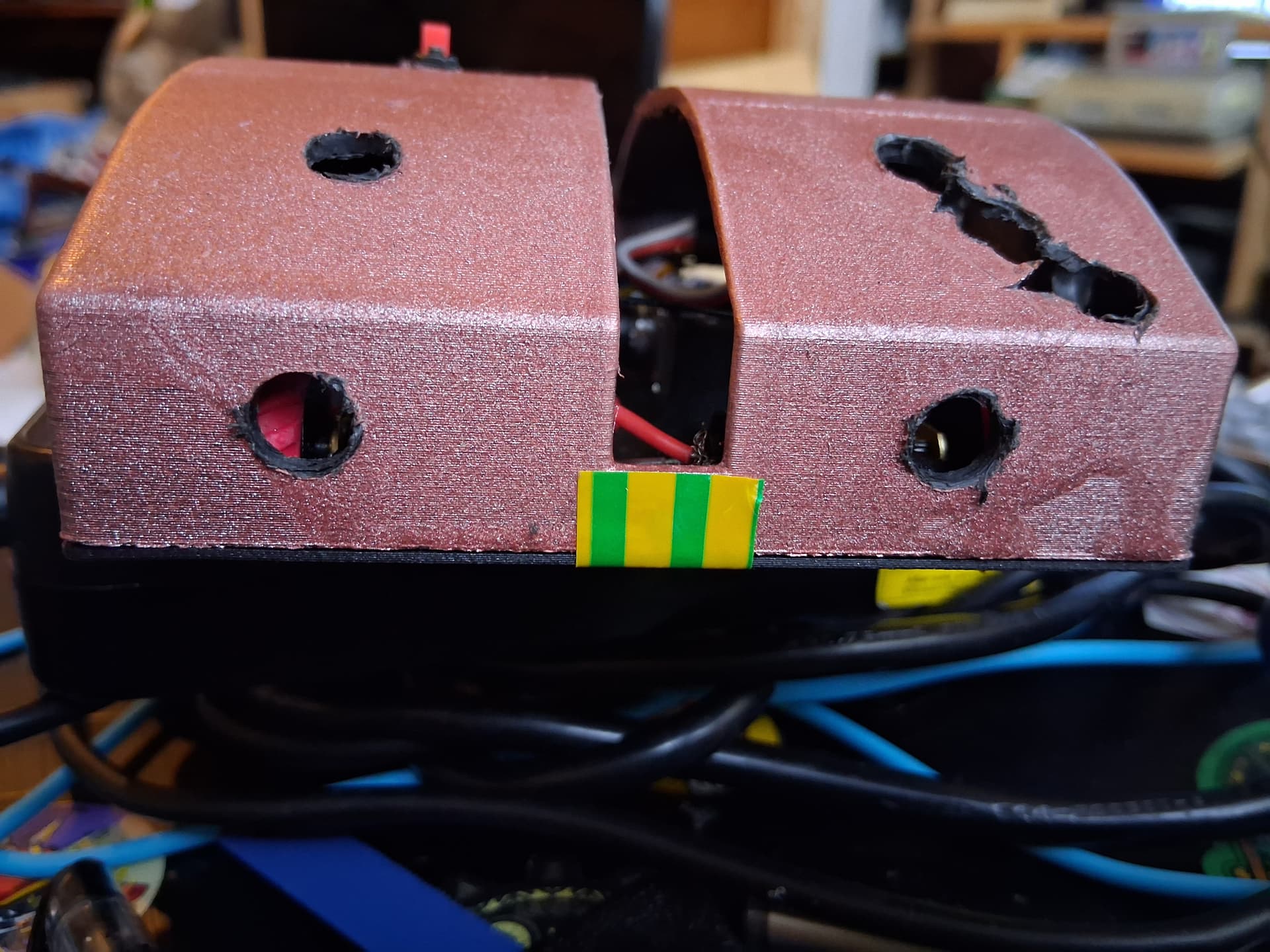

One of my aesthetically best builds, but everything else was a disaster. The base was only 1mm thick, so extremely flexible, and the whole robot weighed in at 170g. Which, it turns out, is actually too heavy even for the more relaxed BotFest weight limit. Oops. Time for some Razer holes. Which did not do as effective a job as I hoped, so it ended up looking like Razer itself gave me them:
My poor butchered baby! To add insult to injury, the switch broke and I had to leave it turned on after tech checks until the first fight. Which thankfully was against a nice, easy opponent, which you may have heard of. Dissector. The switch broke again before any contact, so I let Dissector get a couple of bites before tapping out. A new switch was kindly donated, leading to a more functional robot for the rest of the day.

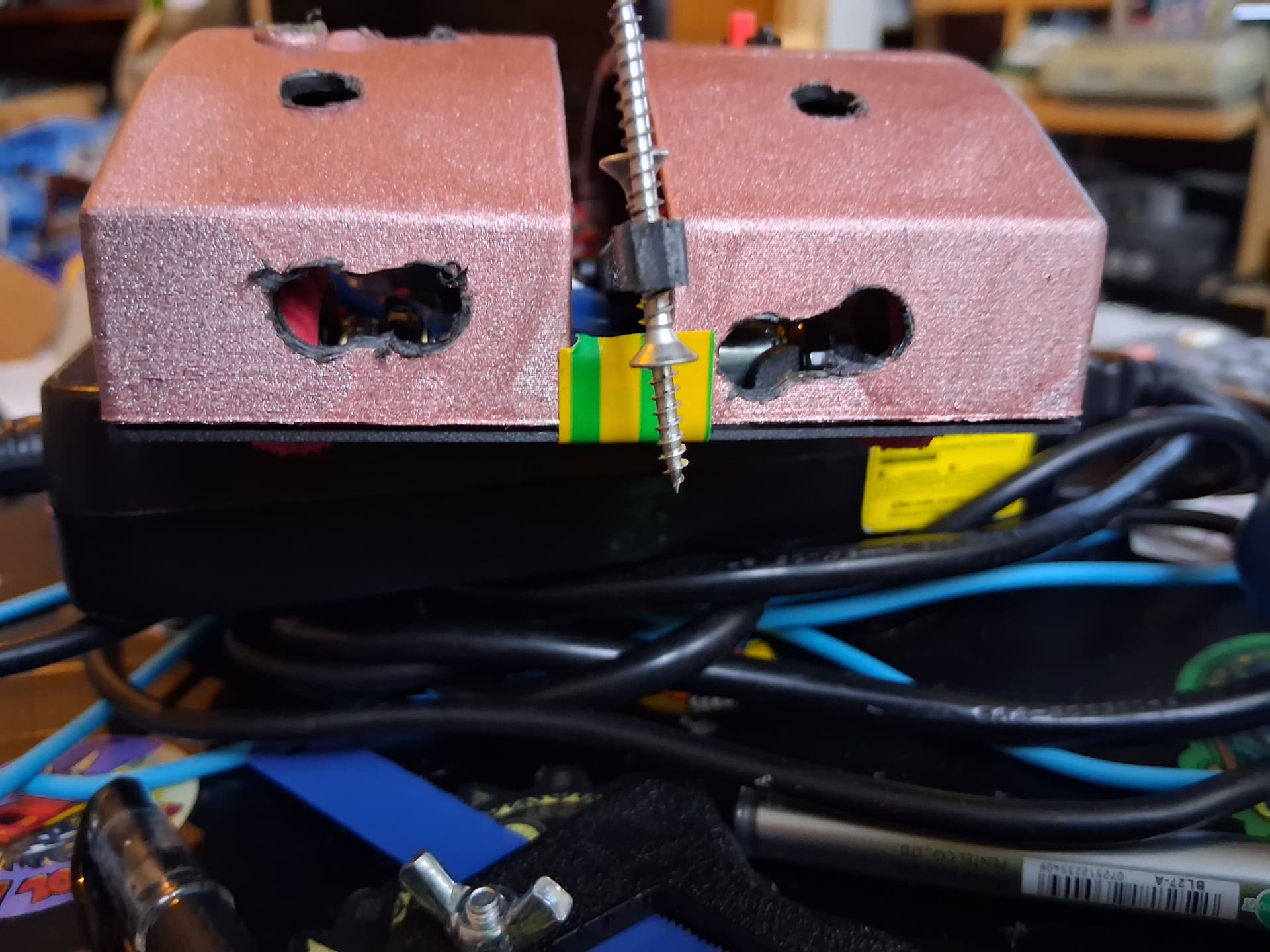

OH! I forgot to mention. I set it up upside down to show off the axe’s self righting capabilities. The axe promptly sheared. Before tech checks. Another axe, from Kit 3, was donated to the cause.

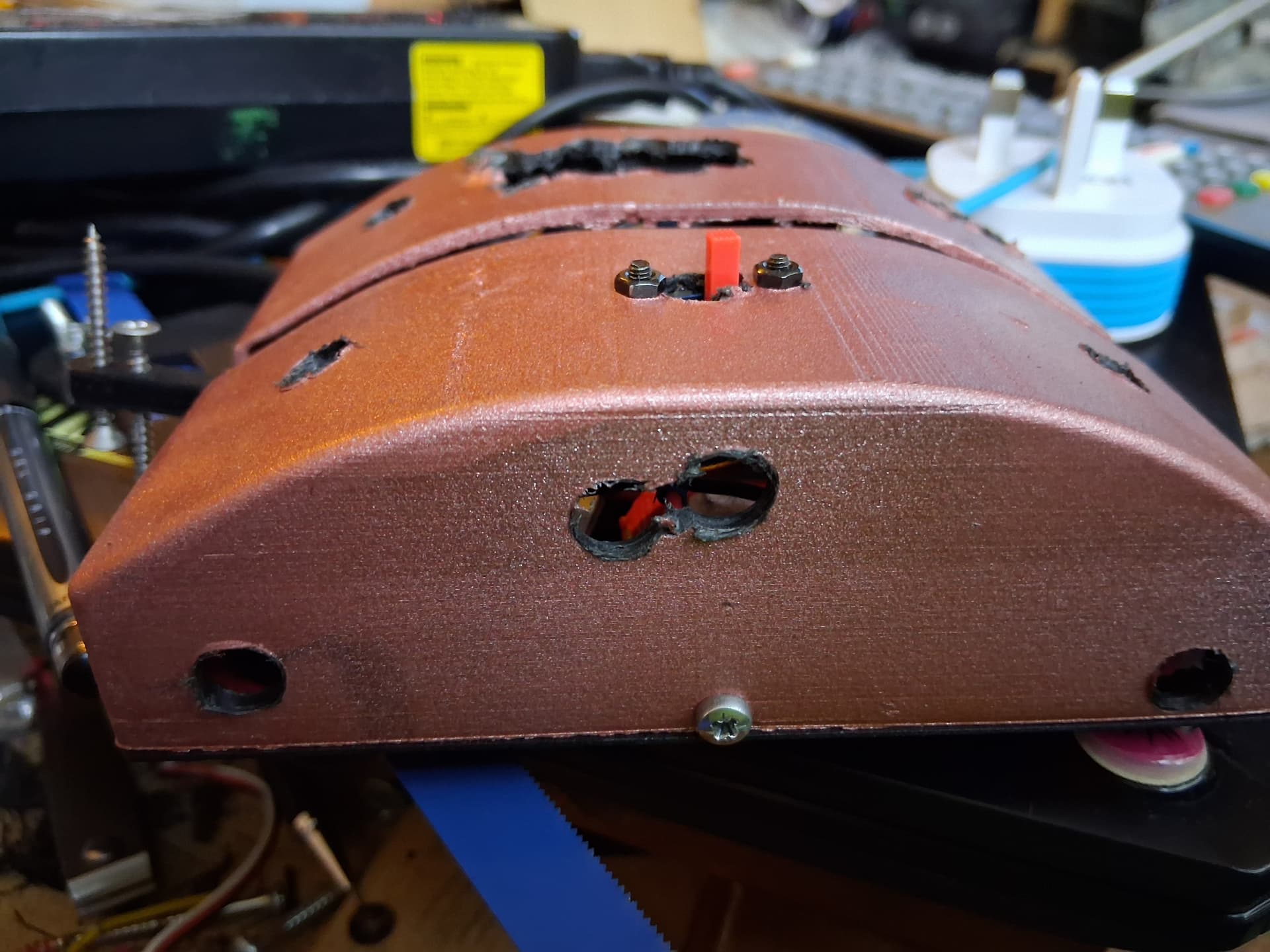

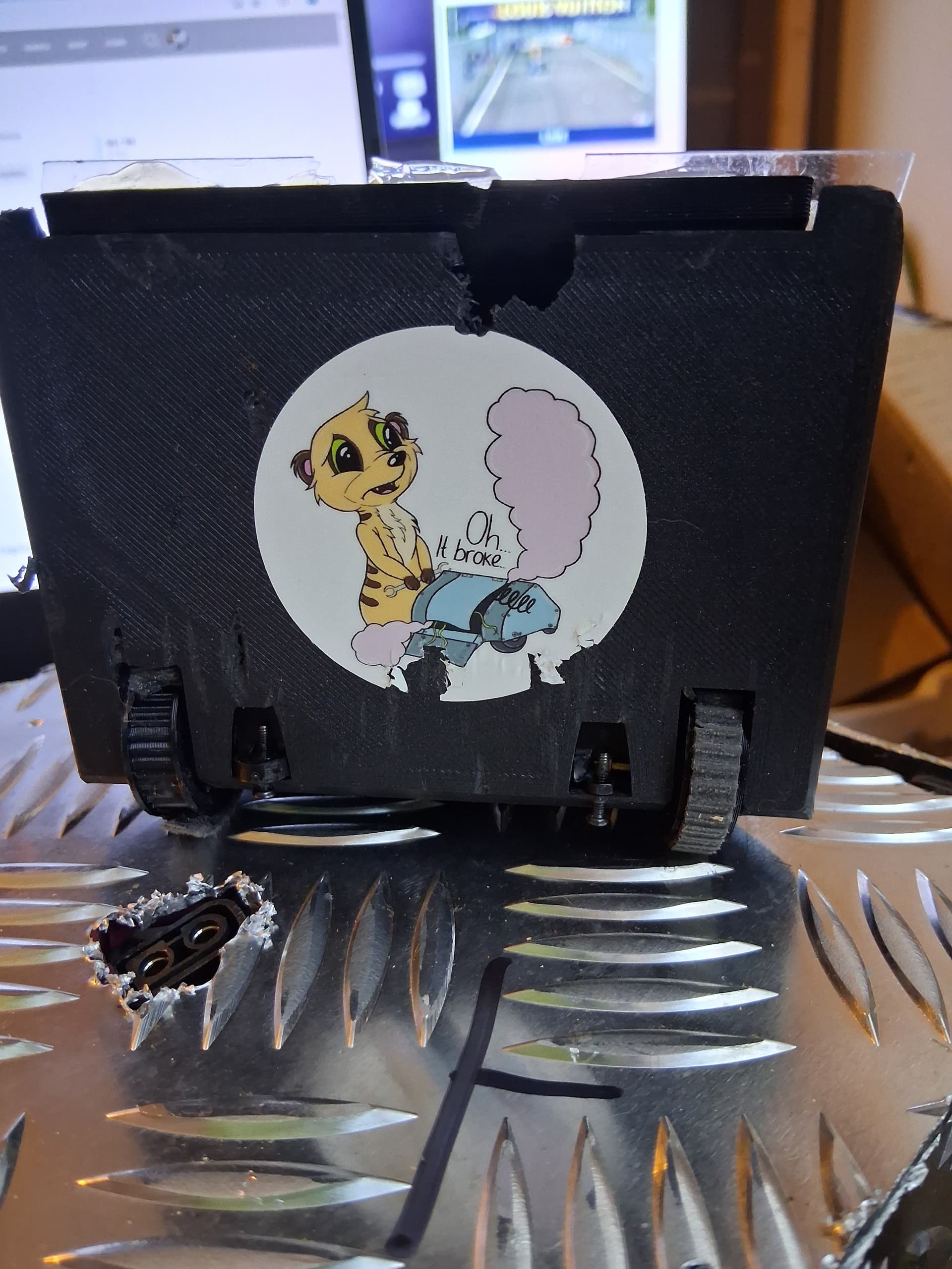

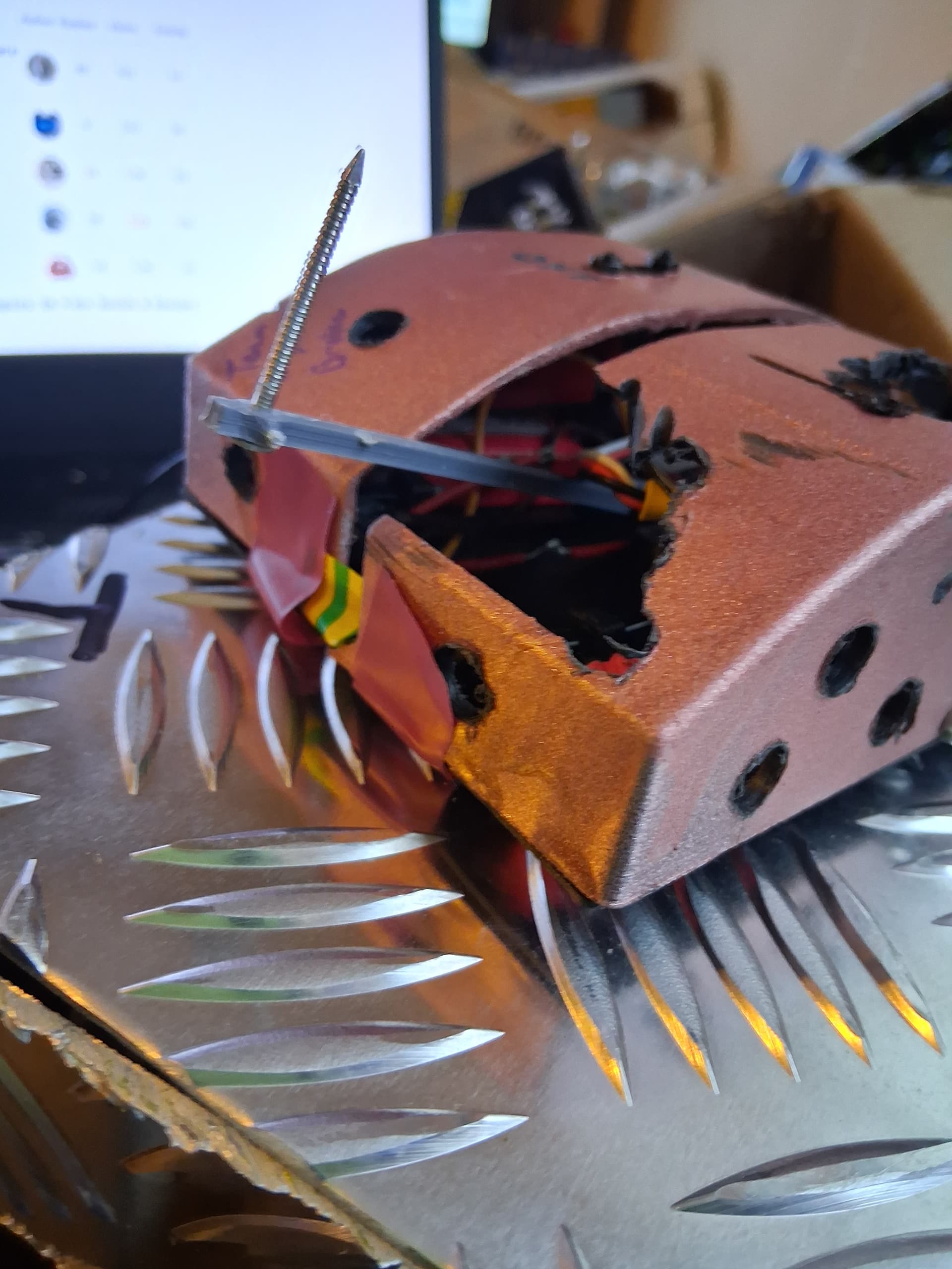

I feel like there’s a fight missing from the videos I have, so no idea what happened against Shego. I lost, that’s definite. But finally I faced Courtesy Bar, loaned to Theo, who claimed he went easy on me. He either lied or has no idea how much damage a vert can do. The lid was bisected, a chunk was removed from the base, and the axe arm came off the servo (although that happened almost every fight, I had to remove the bolt from the servo for weight purposes…)
Next time I’ll bring this back, but I’m switching the axe for a flipper. And I’ve redesigned the lid, so hopefully I won’t have to go crazy with a drill.
The damage (and replacement axe):

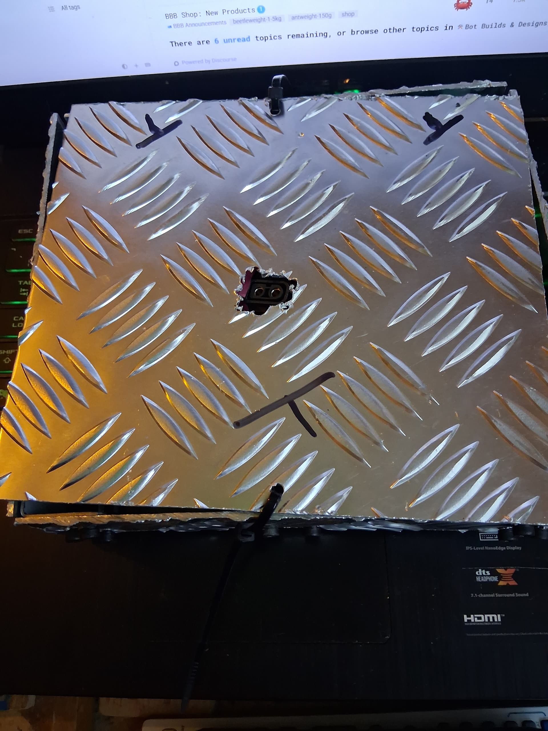

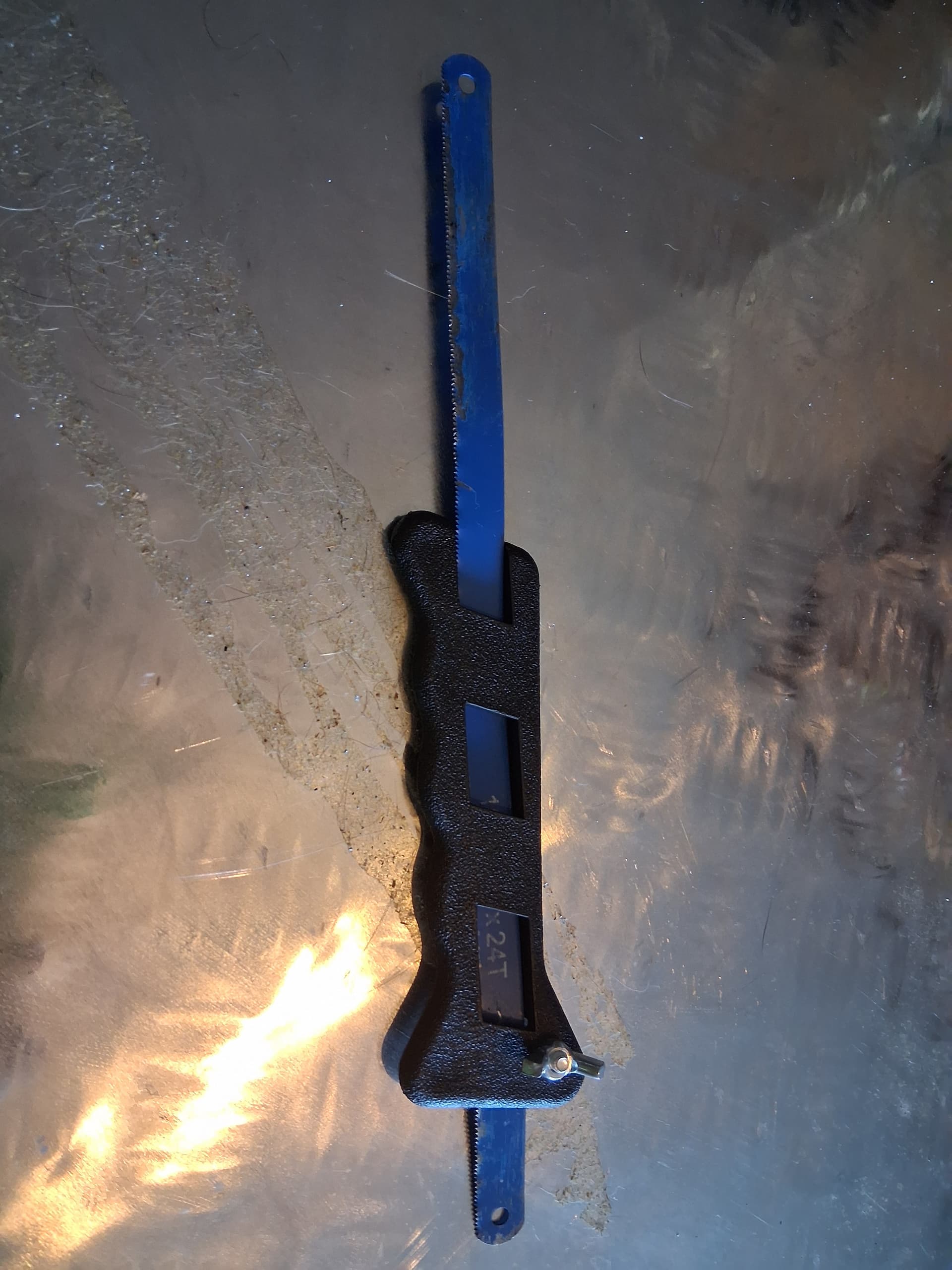

Bonus pics: I bought a new hacksaw purely for Y, because the frame of the standard one limited what I could cut.
Before:
A really nice tool, if a little flimsy.
After:
It literally got beaten by a flat-packed box. Not sure what the next tool will be. Might have to use a power saw.
